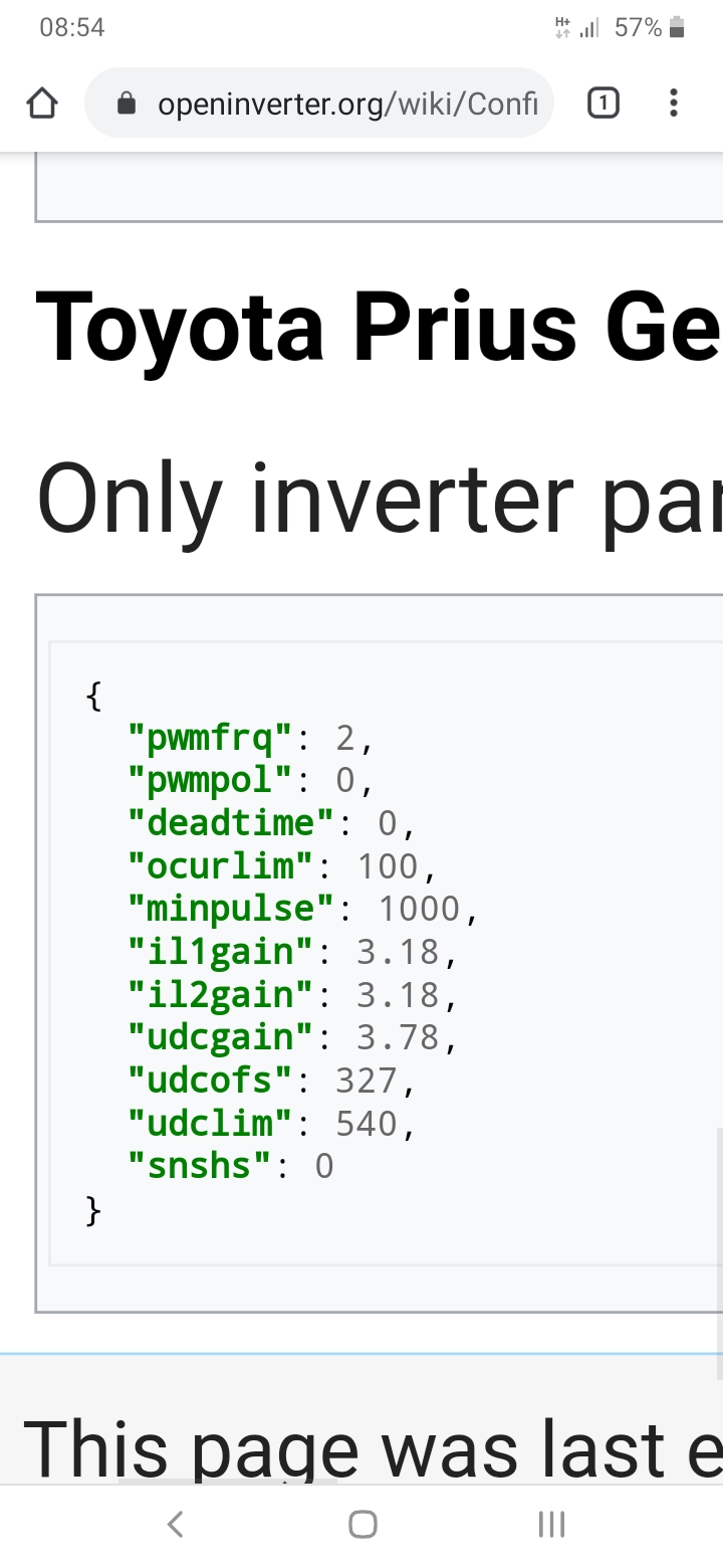

Added Prius Gen2 parameters to the wiki: https://openinverter.org/wiki/Configura ... 2_Inverter
It is only inverter parameters. I will flash these on all boards from now on.

johu wrote: Fri Jul 10, 2020 1:05 pm Added Prius Gen2 parameters to the wiki: https://openinverter.org/wiki/Configura ... 2_Inverter
May I ask why deadtime parameter is zero, isn't that a reason why Damien burnt capacitors in Gen 3 Inverter?

konstantin8818 wrote: Sat Jul 11, 2020 5:57 am
viewtopic.php?f=14&t=817&p=12662&hilit=deadtime#p12662

Post by SciroccoEV »
konstantin8818 wrote: Sat Jul 11, 2020 5:57 am May I ask why deadtime parameter is zero, isn't that a reason why Damien burnt capacitors in Gen 3 Inverter?
That was my idea, go back to page 1 of this thread.

SciroccoEV wrote: Sat Jul 11, 2020 6:28 am That was my idea, go back to page 1 of this thread.
Got it, Damien's Gen 3 board controls high and low sides, so dead time must be set.

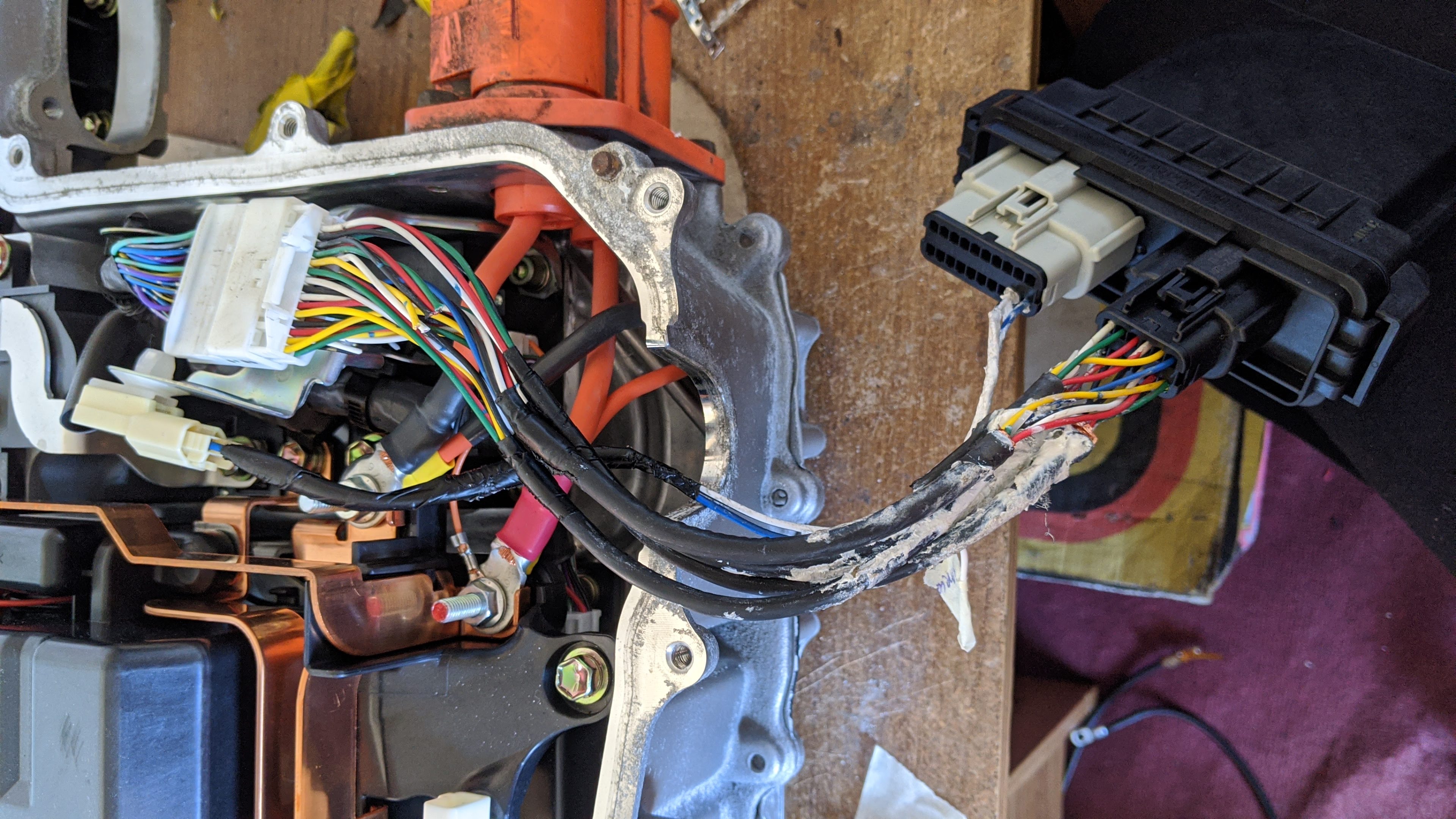

LRBen
Posts: 608
Location: Somerset, UK
Has thanked: 121 times
Been thanked: 290 times
Post by LRBen »
MattsAwesomeStuff wrote: Sun Jul 12, 2020 12:11 am We should probably create a page just for the inverter itself and the breakdown, and then from that link the two project pages that came out of it.
Even if it's not much more than a placeholder, it's going to mislead people if they can't find content about it.
I think that would be a good idea. Even just the basic information from this thread would be fine with a very basic overview of putting it all together. If there was a page created for this project I would be happy to populate it with what I learn as I go.
I do have a question about the initial setup. On the info sheet it says to connect the 2 pole power connector to 12v and GND. Does that mean the 2 pole power connector to the 12v and GND on the control board pins or a 12v supply and GND?
I am assuming it means a 12v supply and GND as when I set it up like the attached photo I get nothing.
So just to clarify. I need a 12v supply and GND to the inverter board, and 12v supply and GND to the 2 pole power connector on the inverter itself?
Just want to make sure before I pop something.

LRBen wrote: Sun Jul 12, 2020 5:49 pm I do have a question about the initial setup. On the info sheet it says to connect the 2 pole power connector to 12v and GND. Does that mean the 2 pole power connector to the 12v and GND on the control board pins or a 12v supply and GND?
Figured it out. Inverter needs 12v and ground, so does the control board. Got it running now and giving me a voltage reading on the HV DC line.
Next up for me is the delta light test.
