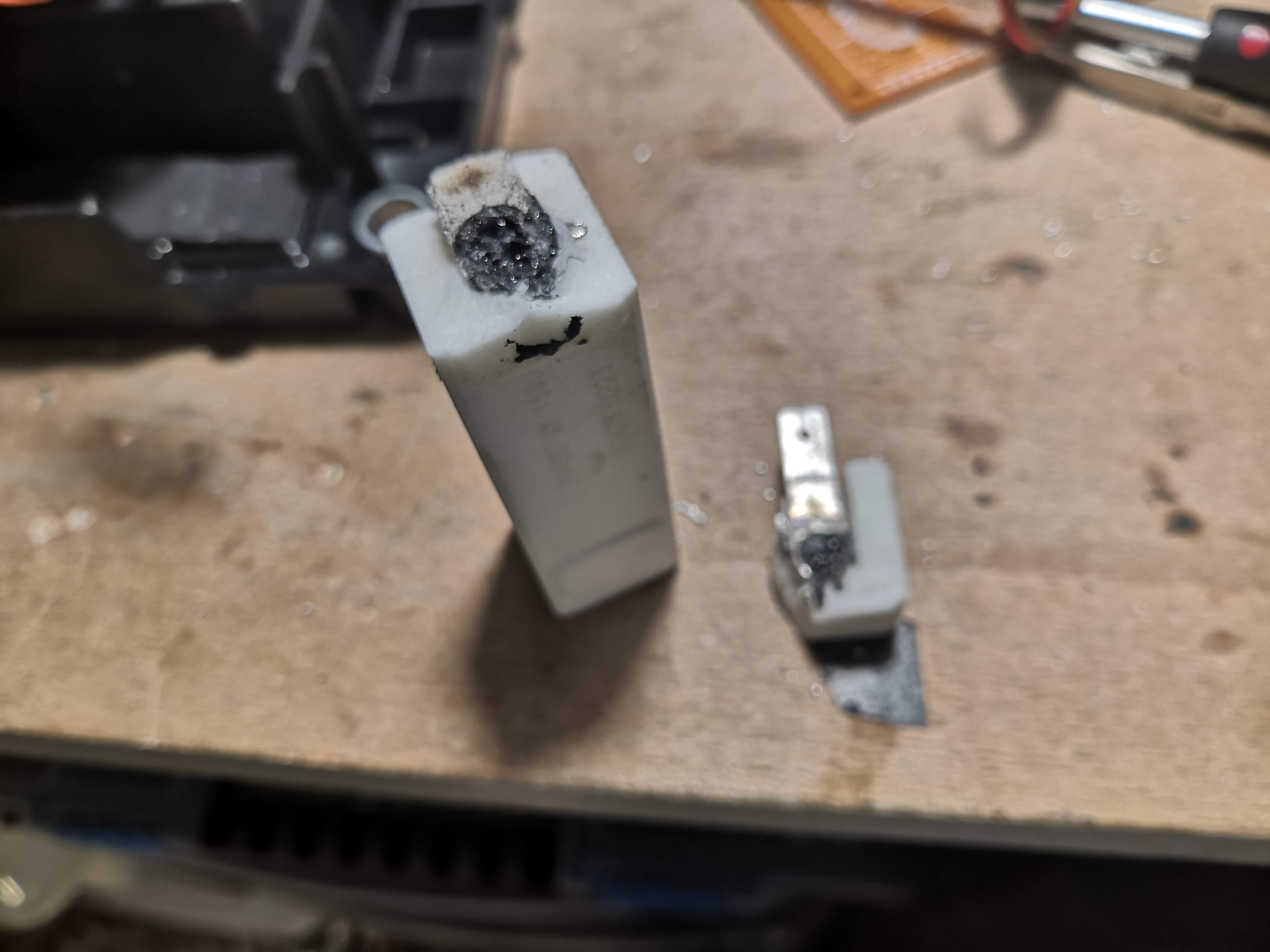

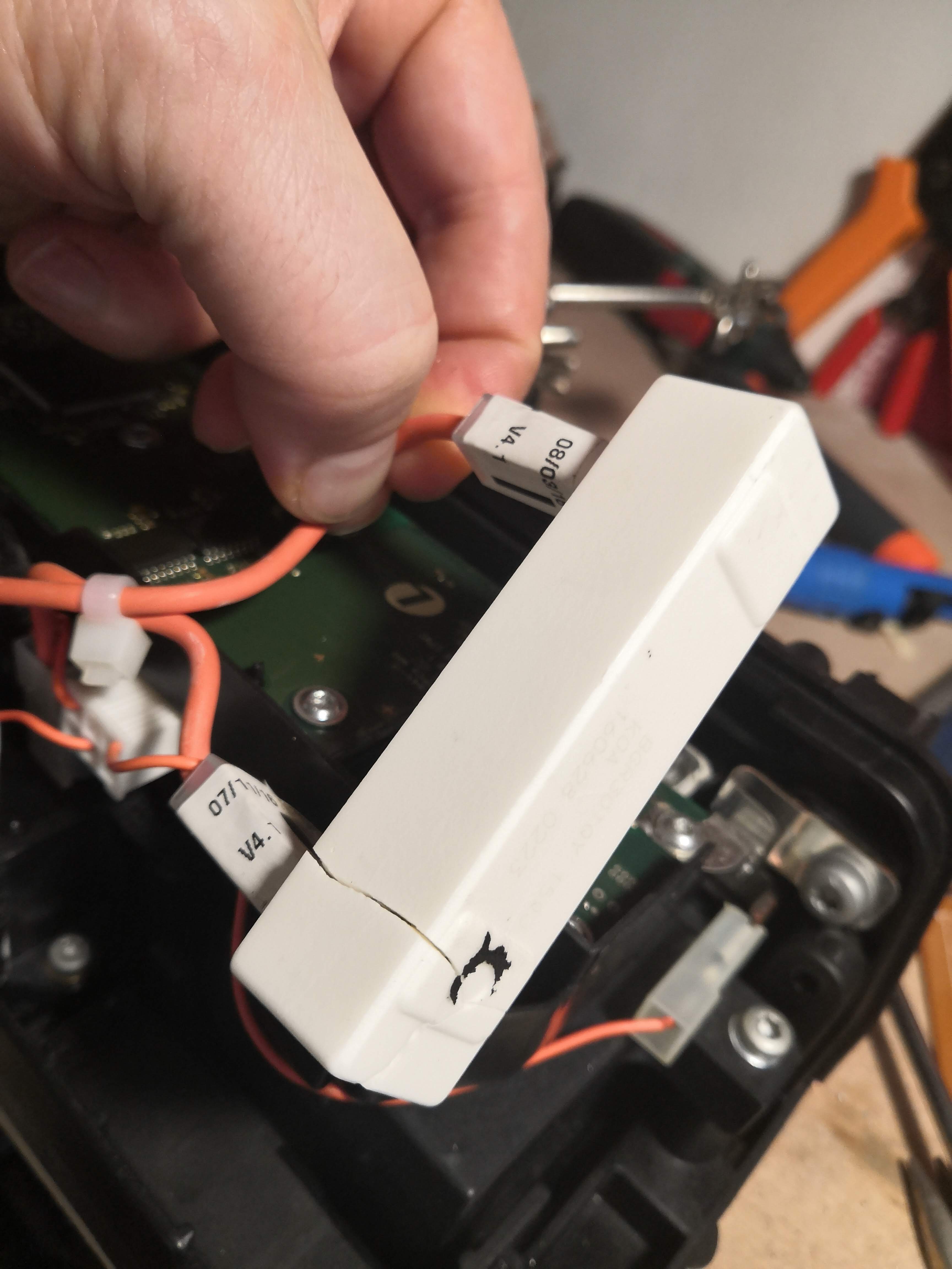

I just confirmed the failure mode for the S-Box when you accidentally pull current through it without the main contactor closed. :o
Not sure how it happened (question for another thread) but my pre-charge resistor is now in multiple pieces and nicely charred in the middle. Everything else looks OK but not yet tested.
Has anyone in the UK found a supplier for these particular KOA resistors? Be nice to do a straight swap if I can, given the available space.
EDIT: I found one on ebay from Spain - a KOA BGR 30.

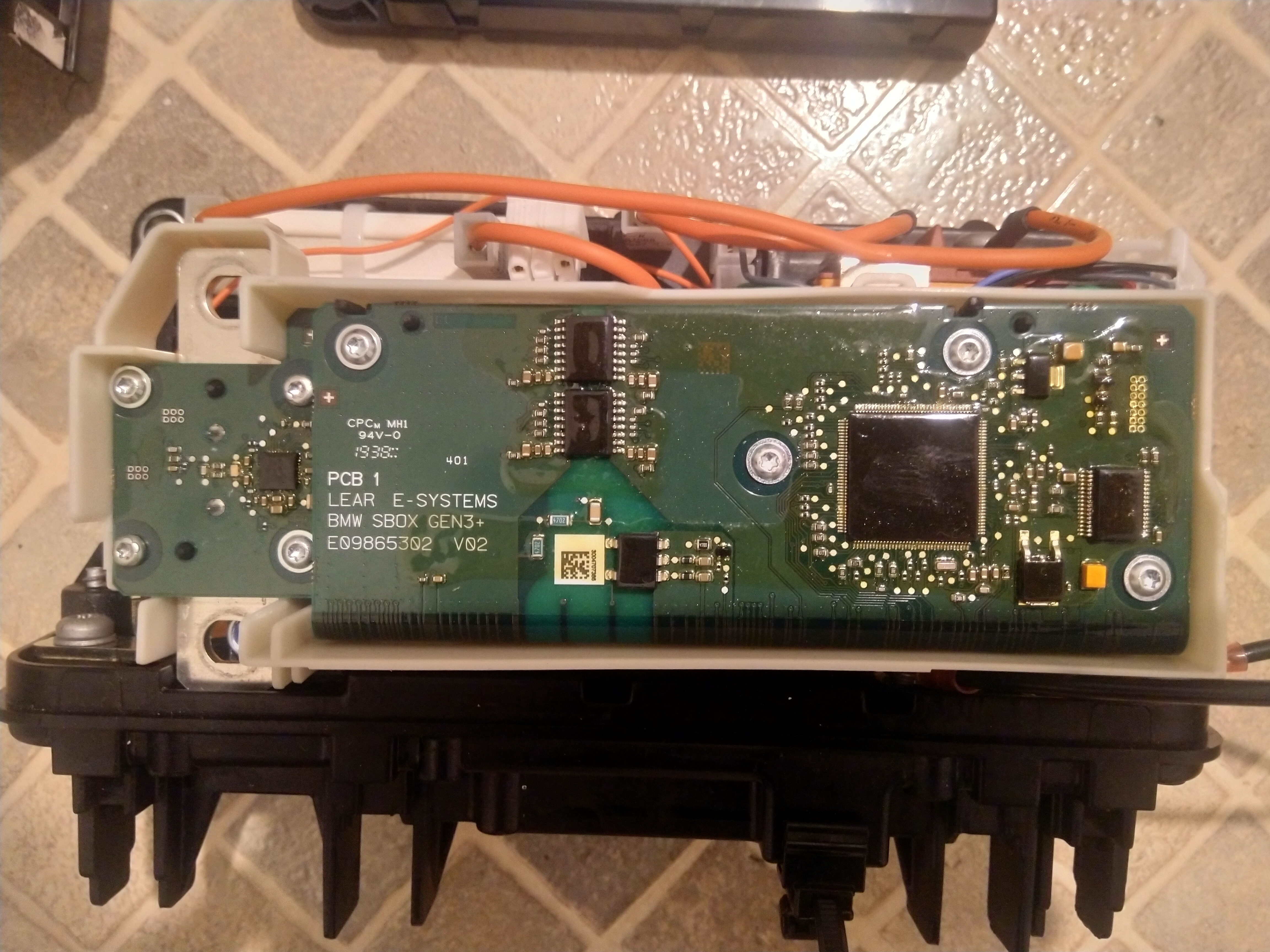

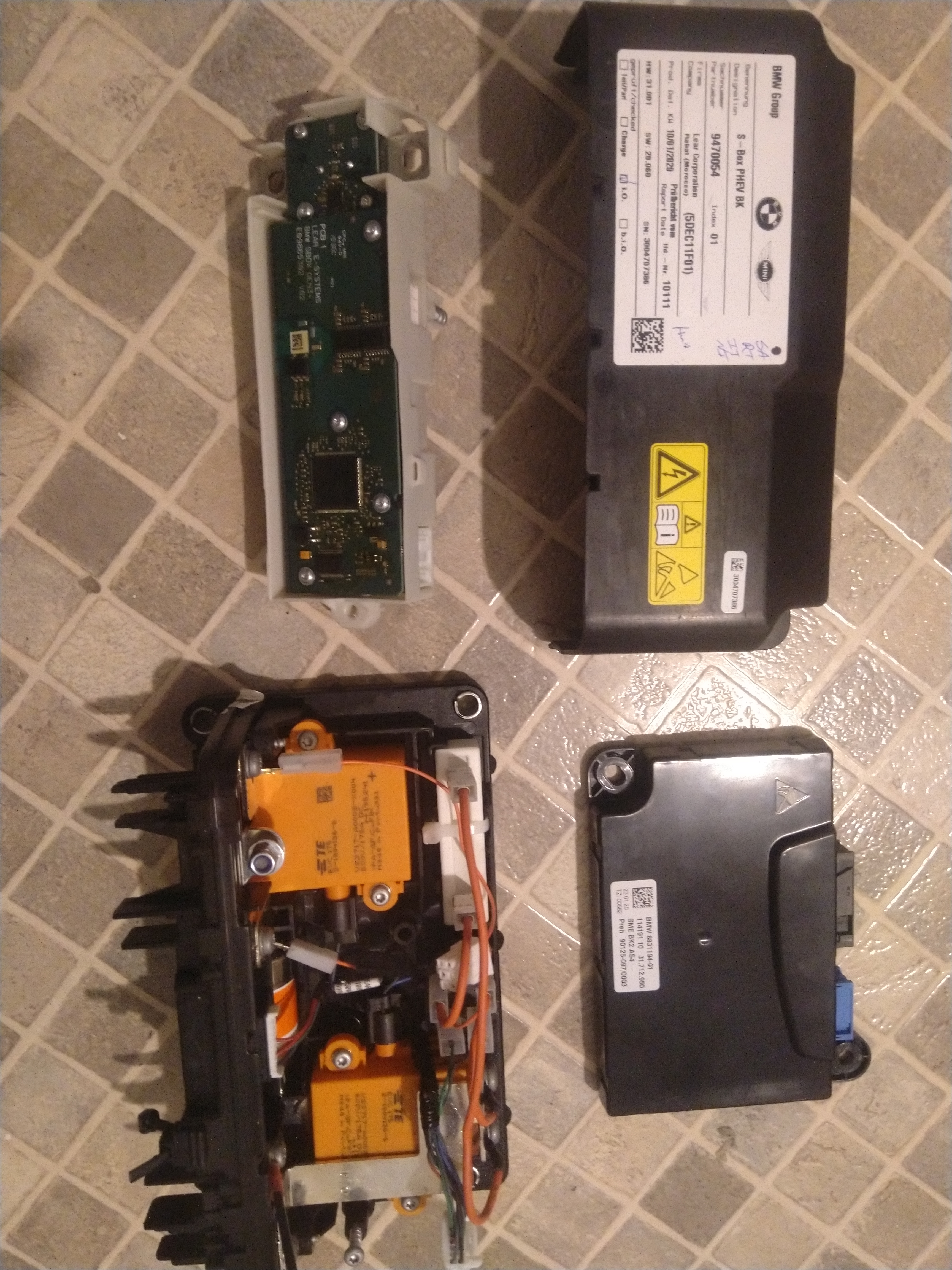

Post by 180jacob »

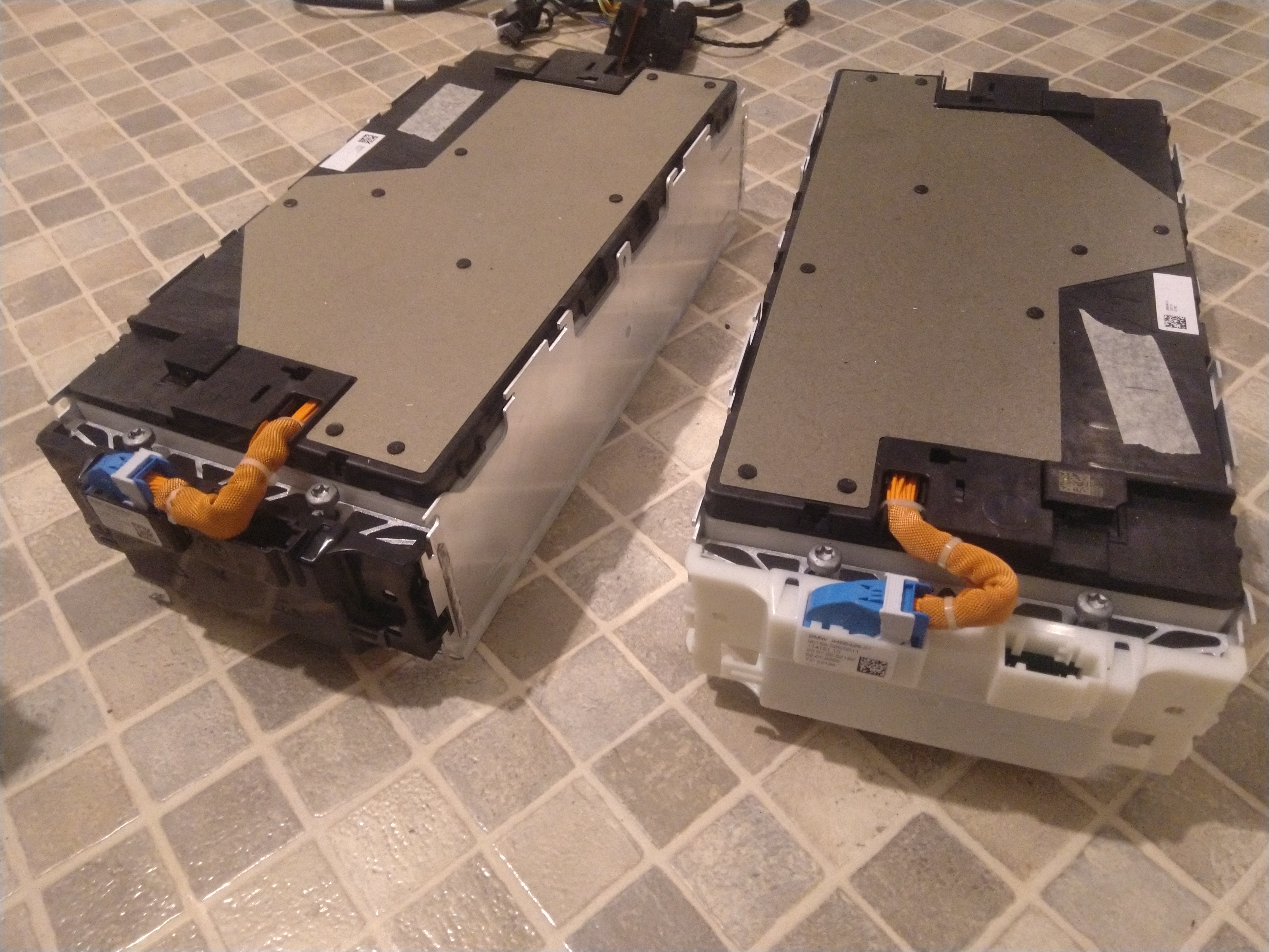

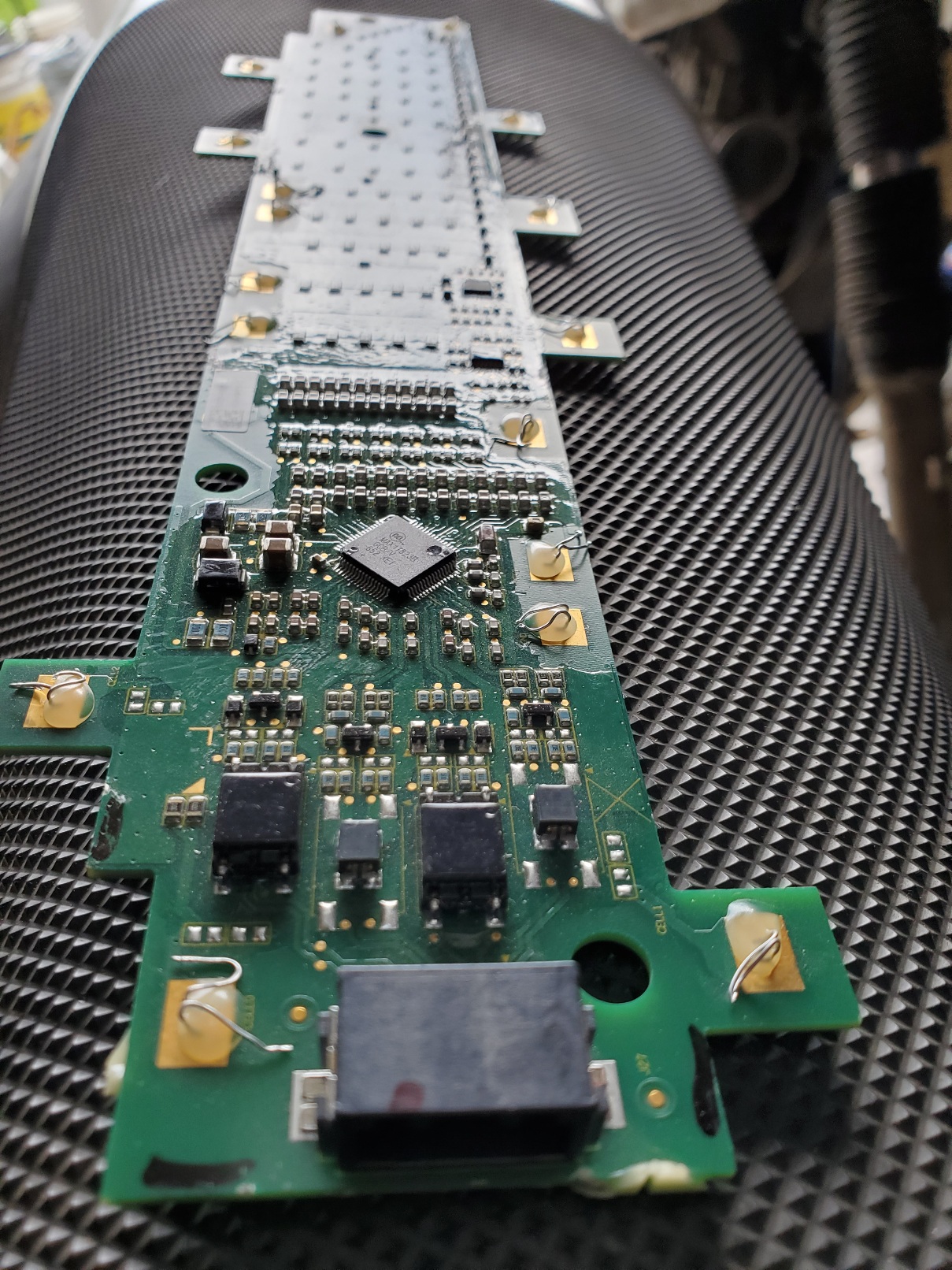

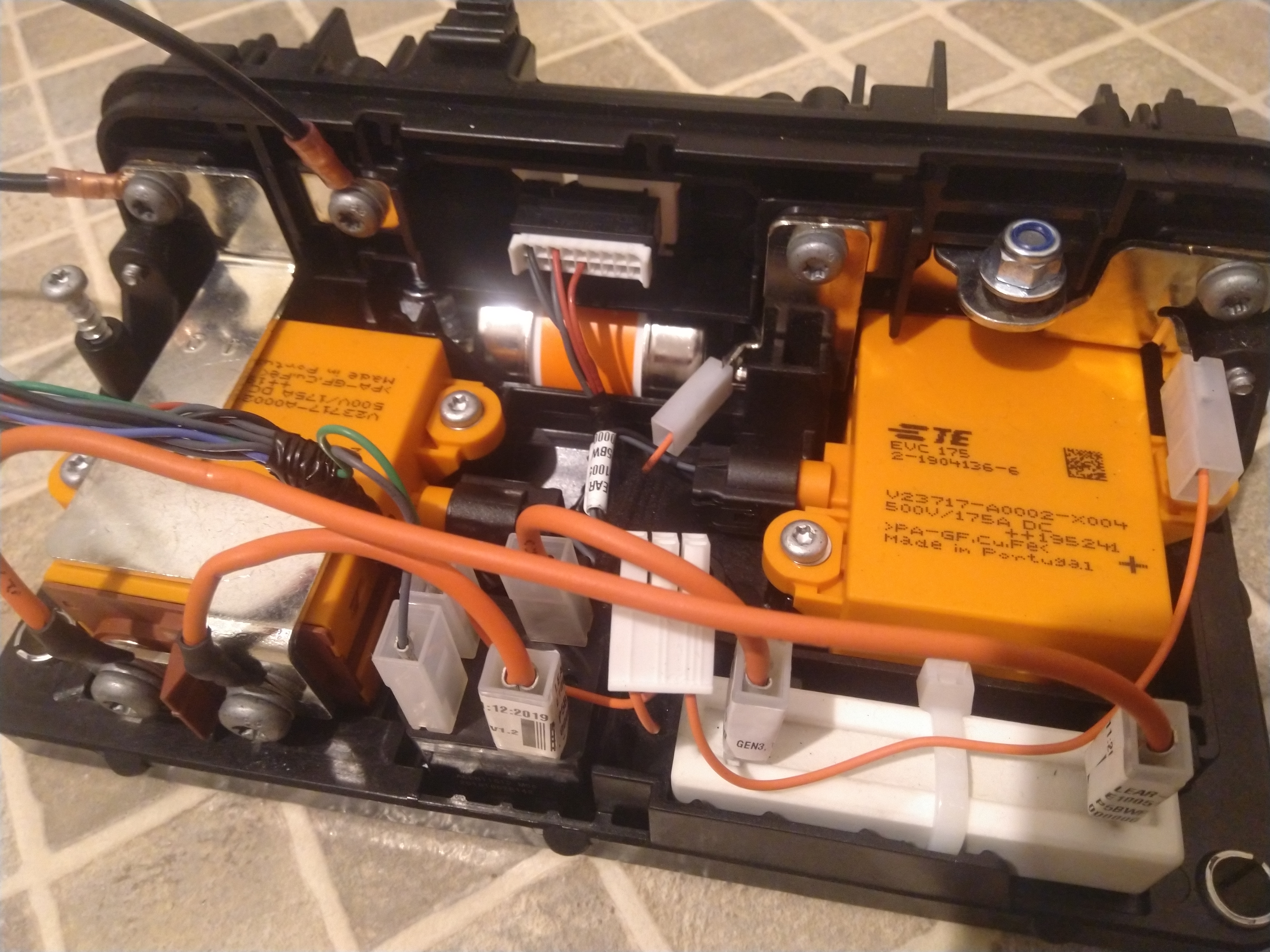

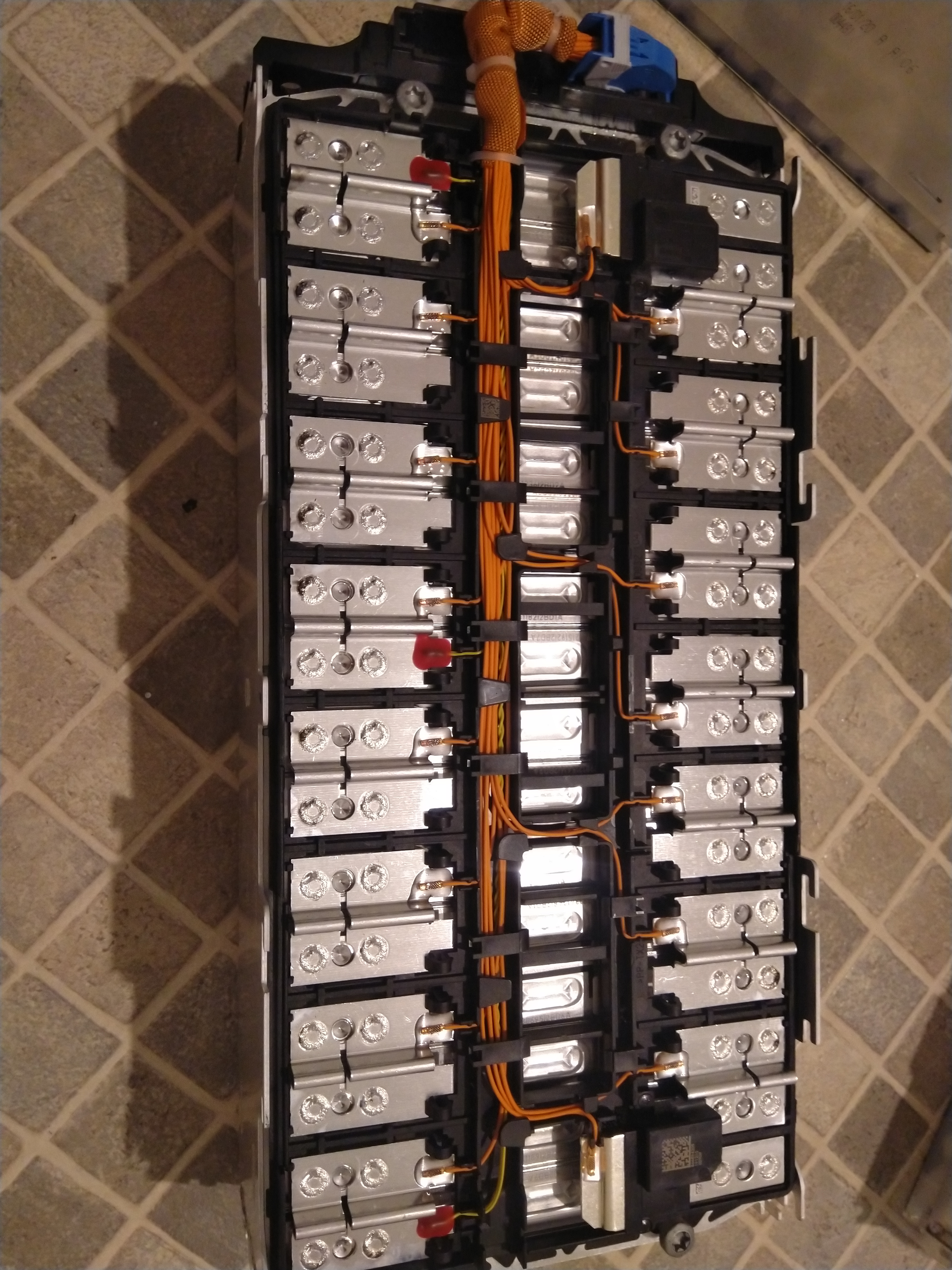

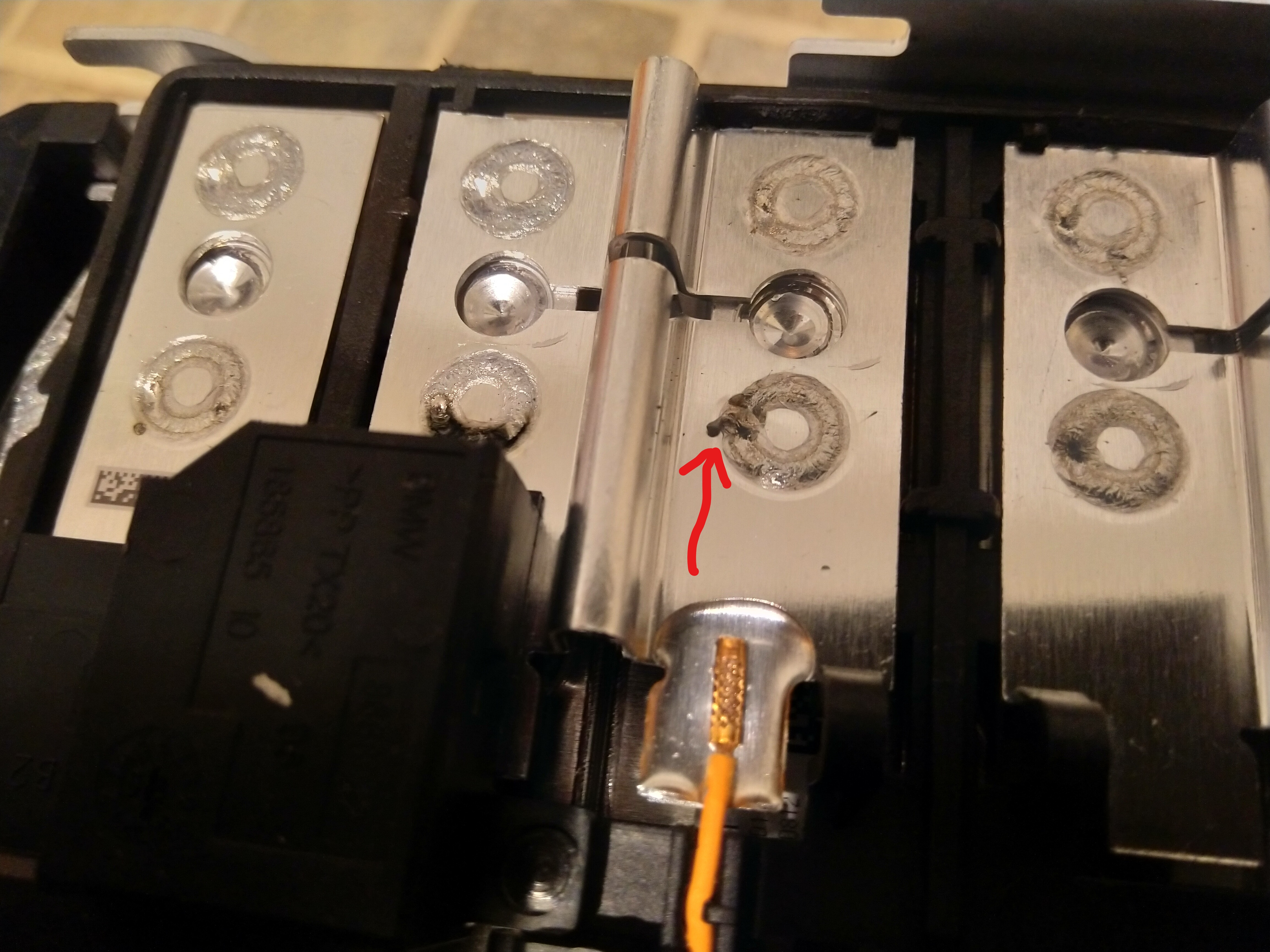

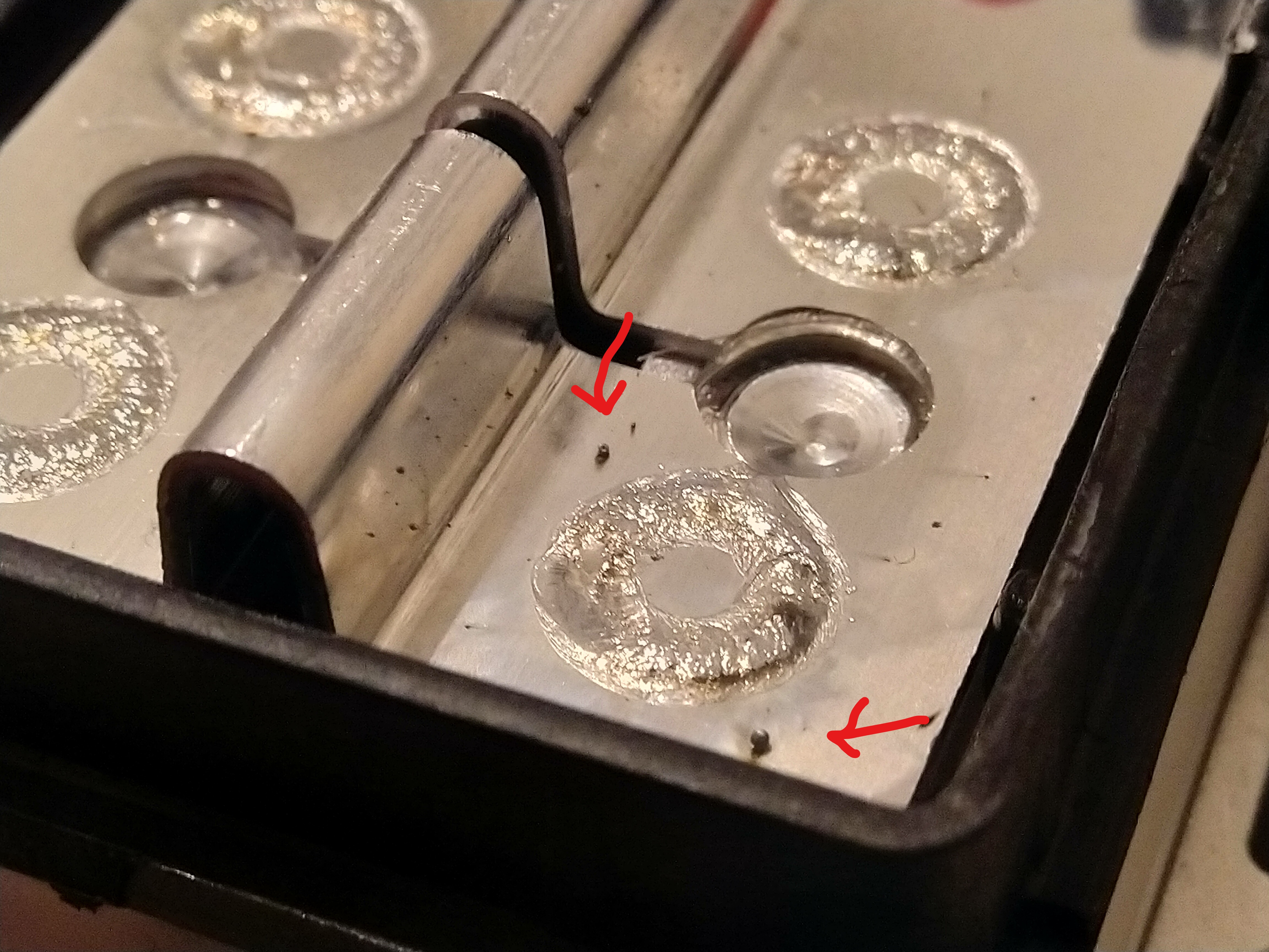

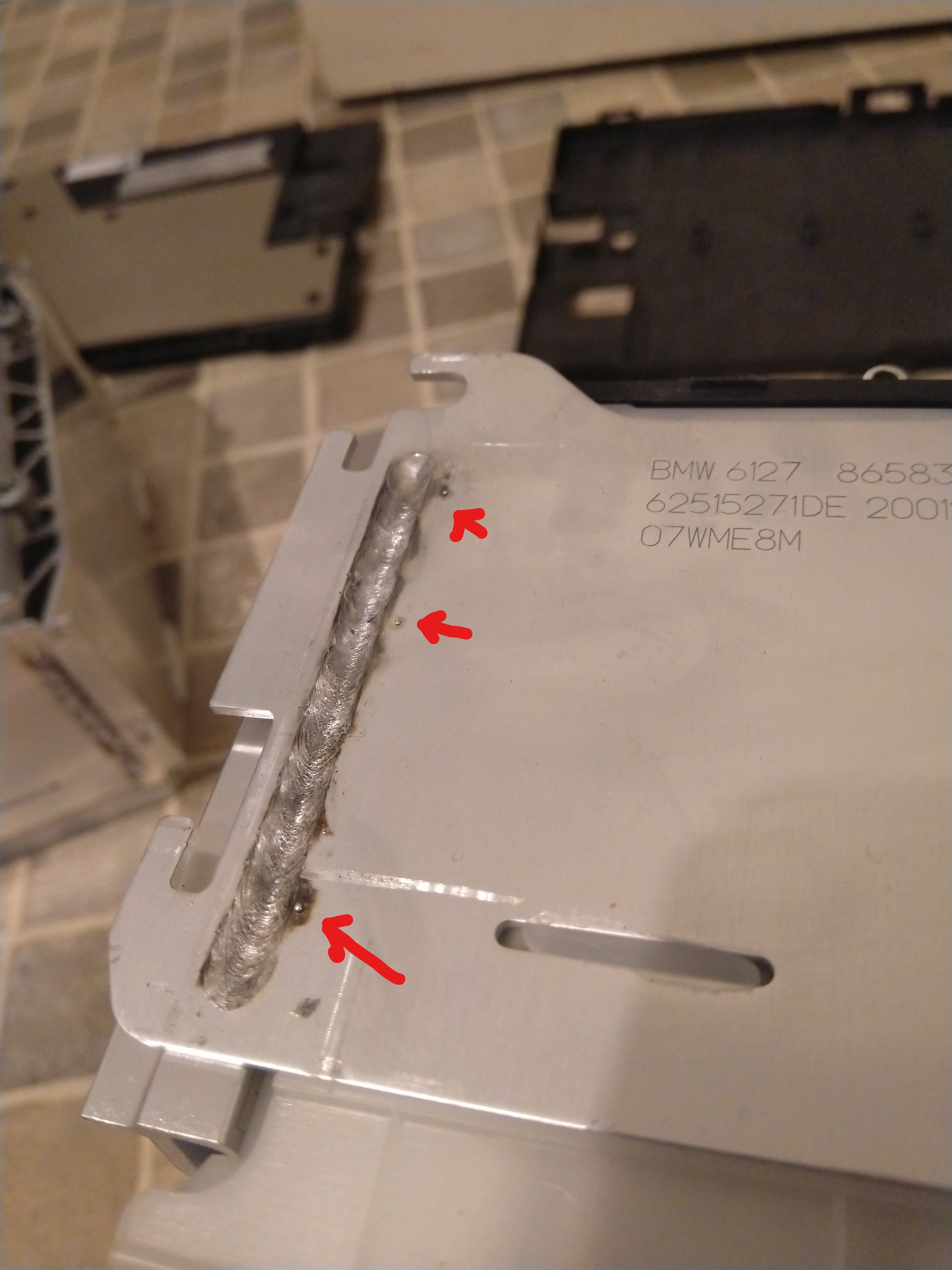

I recently purchased one of the newer 12Kwh 34Ah packs and thought I would highlight some of the differences I have noticed to the information that has been posted in the thread so far. This post will focus on the technical stuff, details of the purchase are on my project thread here: viewtopic.php?p=25620#p25620
This is supposedly from a 2019 BMW 3 series G20, but given the pack is dated 6th Feb 2020 either it had a new battery or the listing was wrong.
Physically the modules are the same size and shape though I believe they are slightly heavier (I don't have an older one to compare), the most visible difference is the card/foil piece moulded into the top cover. I don't know what this is for but I guess it's some kind of heat or emc shield?
Once I had the pack fully dismantled I found the most negative module has a different CSC with a white case. Pinout and wiring are a bit different, see below.
The loom for the CSCs is completely separate to the one that goes to the contactor s-box which is convenient unlike pictures I have seen of others where they are bound together.
The end of the loom which connects to the master has far fewer pins populated compared to the picture that OutlandishPanda posted here: viewtopic.php?p=13845#p13845, the pinout is similar with one important difference, CanH and CanL are swapped around!
The S-box is also quite different.
BMW must have listened to Celeron55 calling the Panasonic contactors 'whimpy' here: viewtopic.php?p=22123#p22123 because they have fitted these 175A contactors from TE. The exact datasheet is not available as it is a restricted product but this is the closest public version which I think is the same just with a lower voltage rating and 90°connector position. https://www.te.com/commerce/DocumentDel ... -1904070-1
It says they should be good for 500A for 30s anyway. Also has an economiser built in.
The precharge sense wires are attached in different places, and the connector has fewer pins populated. I plan on wiring directly to the contactors anyway so didn't investigate this further.

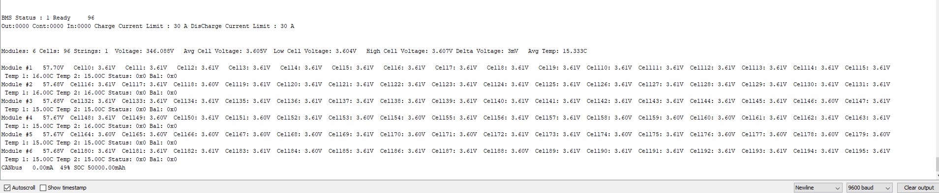

Despite all the changes, SimpBMS still read all 96 cells fine, I haven't checked if balancing works yet as my pack only has a 3mV delta.

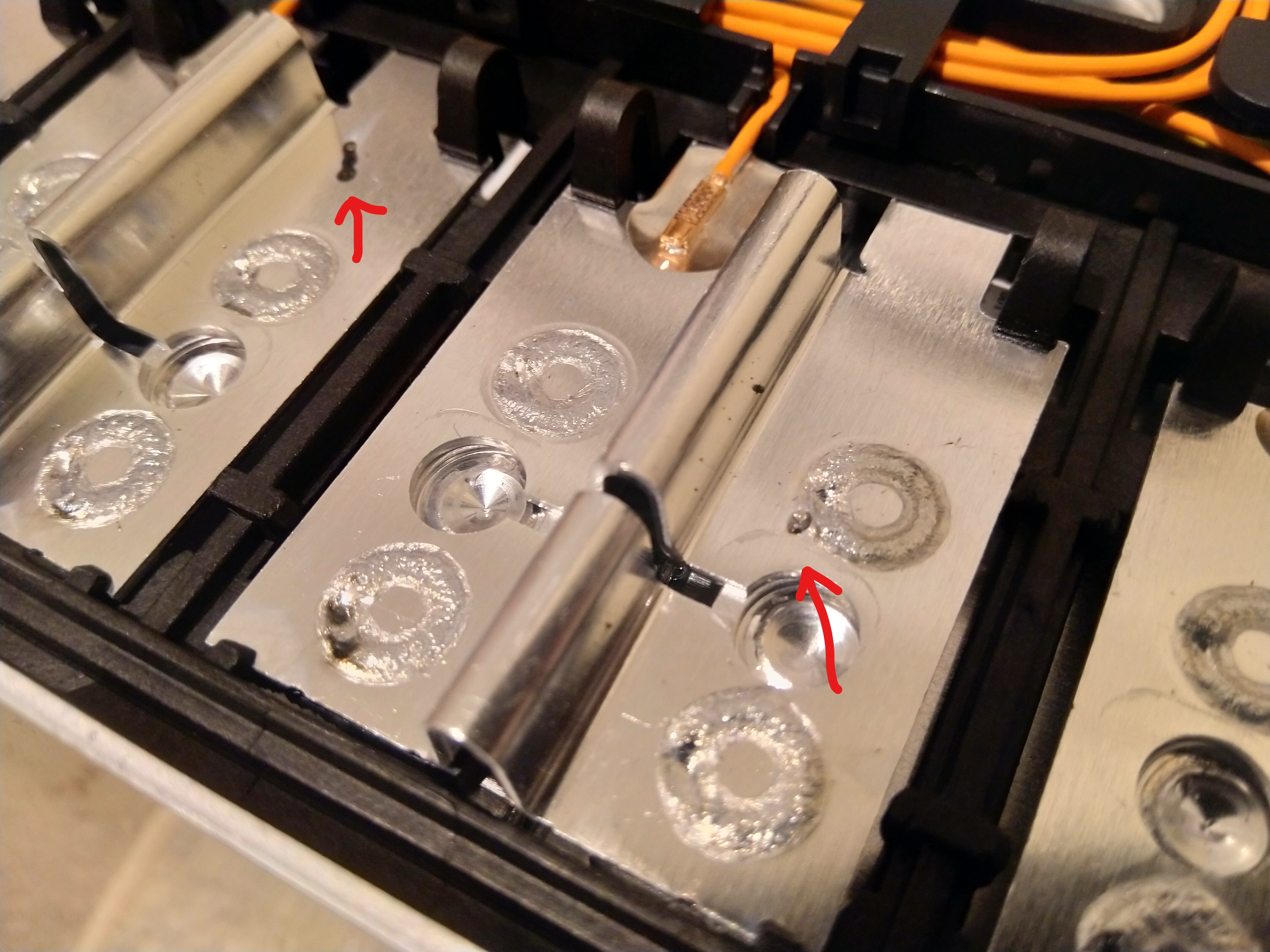

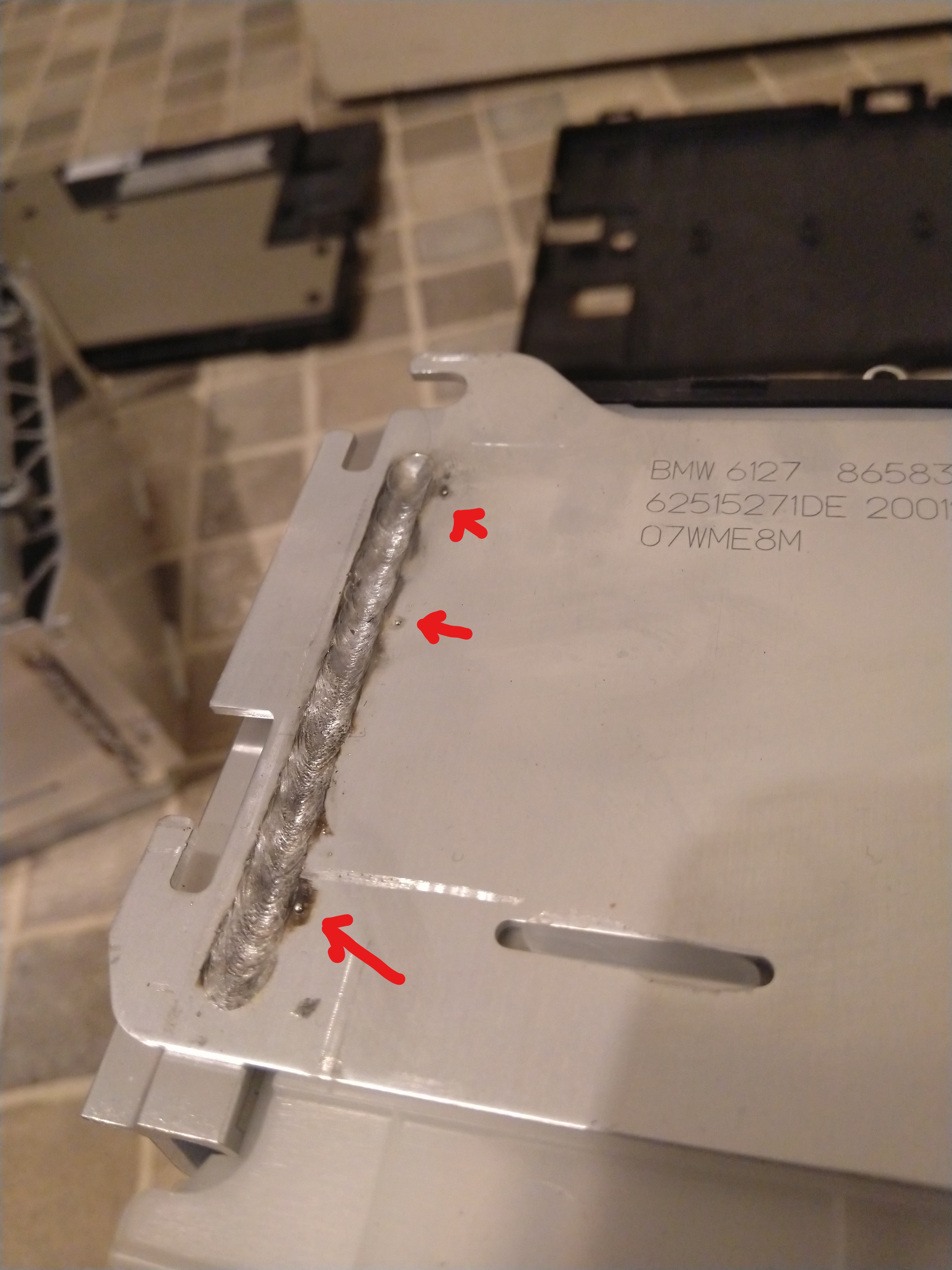

I suppose you didn't find any debri between modules as described in the recall?
180jacob
Posts: 45
Joined: Thu Nov 12, 2020 10:55 pm
Location: South West UK
Post by 180jacob »

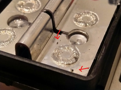

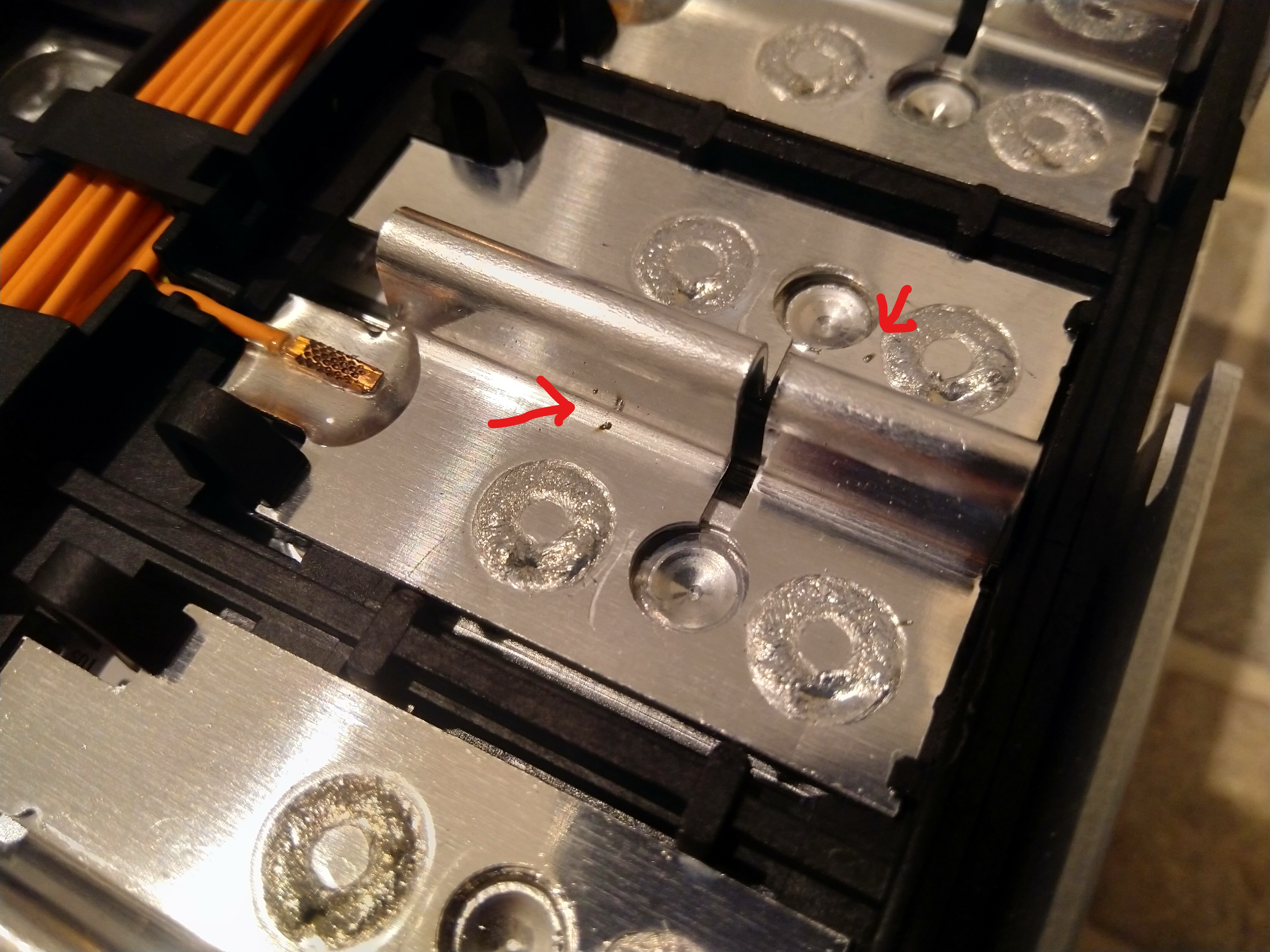

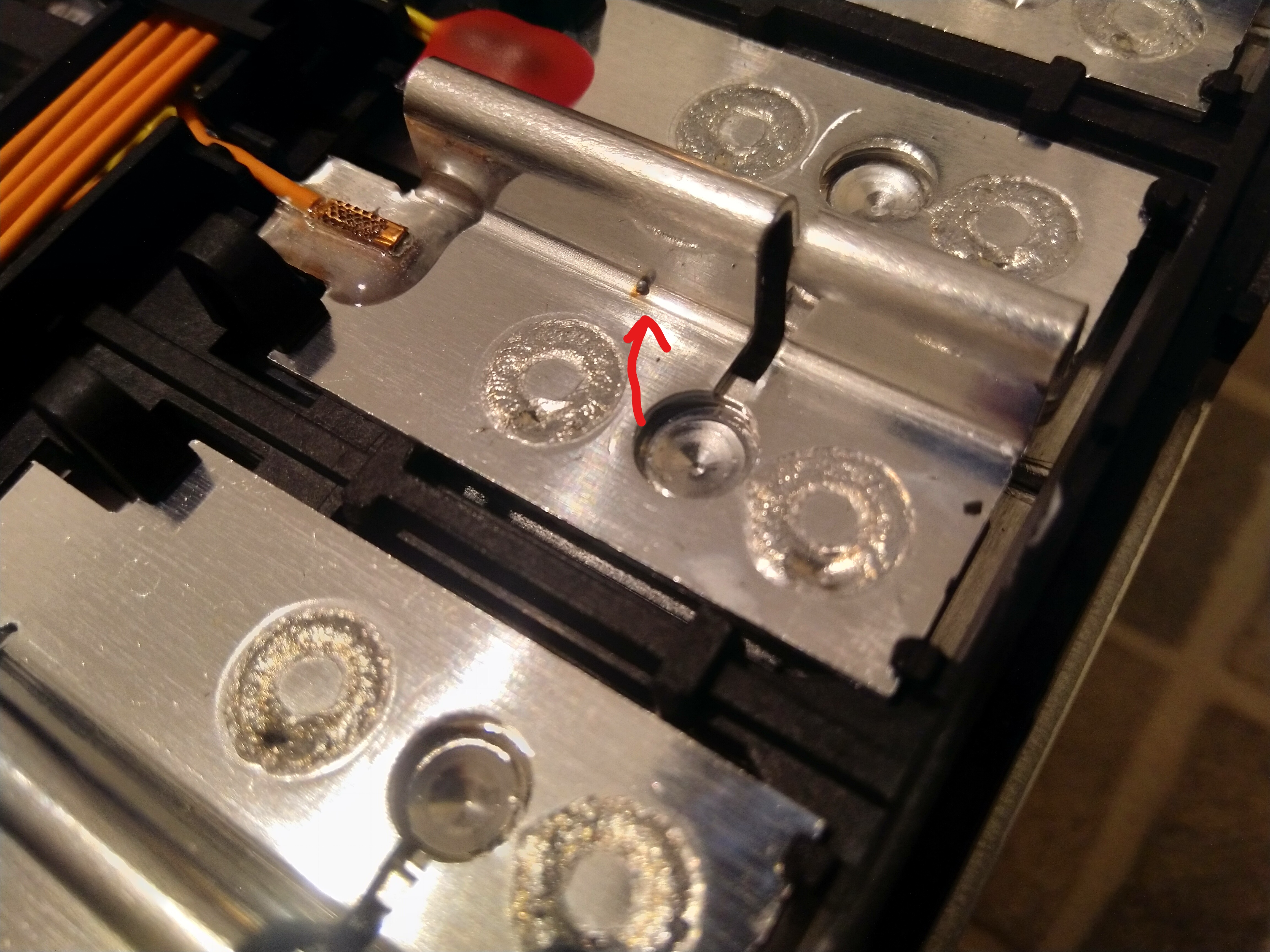

celeron55 wrote: Mon Mar 29, 2021 7:50 am I suppose you didn't find any debri between modules as described in the recall?
The article refers to: "welding debris left inside the pack that could create a short between modules. The component manufacturer is listed as Samsung."
I cant see any reason why there would be welding going on anywhere near by when the packs are assembled, it all bolts together and I certainly didn't find any wire/spatter/debris large enough to cause concern.
The only thing I can think of at a pack level is that the sides of the modules are laser welded and in my case there were a few tiny bits of spatter remaining.
I cant see this ever (even considering the number of cars involved) causing a short between modules. More likely (though still very unlikely) is that spatter from welding the cell connections causes a short between cells. I found the following examples in my pack of six modules, whilst the welds aren't all perfect, the spatter is very tiny and not enough for me to worry about. Obviously there are probably packs out there that are worse, and it doesn't take long to check and remove anything upon receiving a battery. Laser welding is a difficult process to perfect and control so I can empathise with the manufacturer.
I think you would have to be very unlucky for any of these to find themselves in a position where they could cause a short (most are strongly attached anyway) and even if they did, chances are it would just melt back until there wasn't a short. I could have completely missed the point of the recall and maybe they are referring to something else entirely, I don't know as I didn't find anything else in mine.

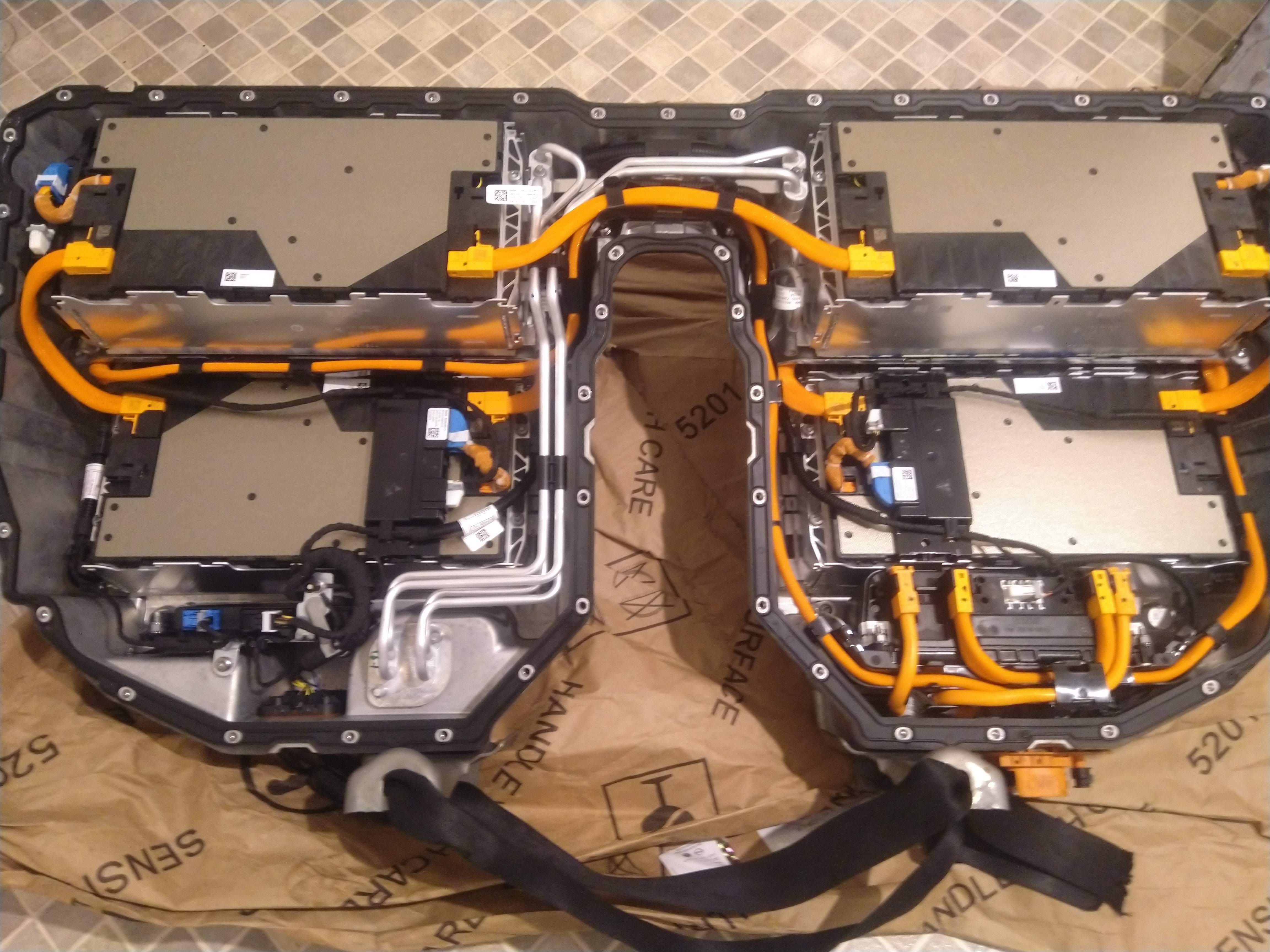

Thanks for the above, very useful! I've just pulled apart an x5 pack (oct 2020, 12kWh). Each module weighs 13.05kg including bms slave, according to my bathroom scales! (Updated the wiki with this and dimensions, excluding the ~23mm for the BMS slave)

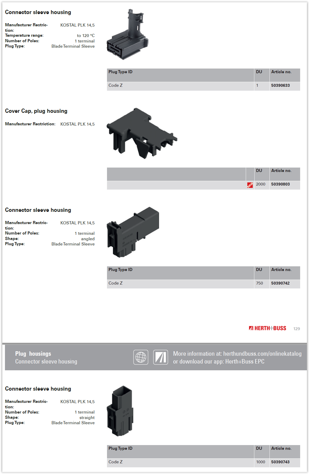

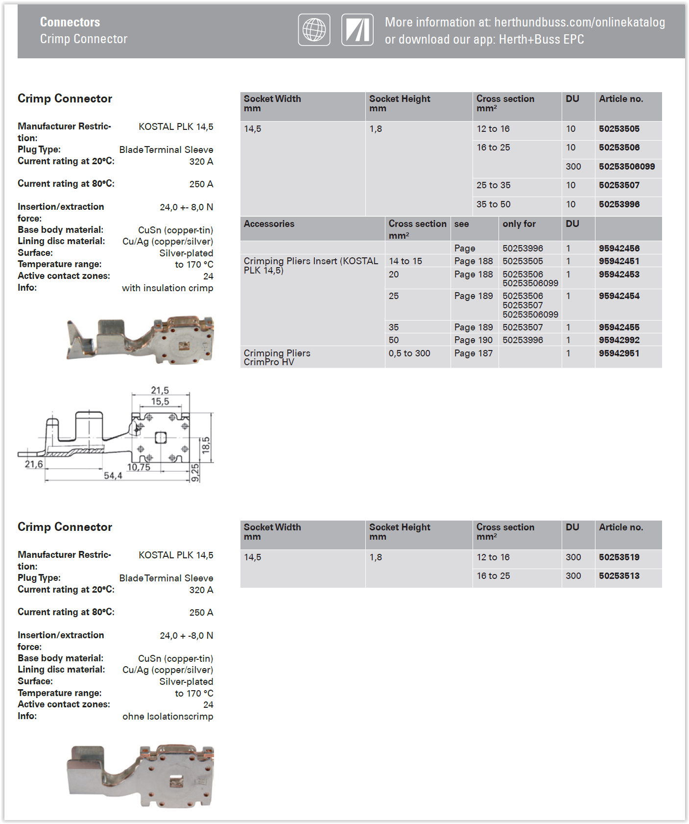

For those who are looking for the HV-connectors of these packs, Just found them. Seems to be the Kostal / Herth-Buss PLK 14,5 system.
Contacts:
Housings:
Found a supplier for the contacts (https://www.automotive-connectors.com/c ... =433&q=plk) just ordered some, unfortunately no supplier for the housings yet. Seems that the straight ones are packed per 1000, and no one stocks / sells them in smaller amounts. Anyone have a tip ?

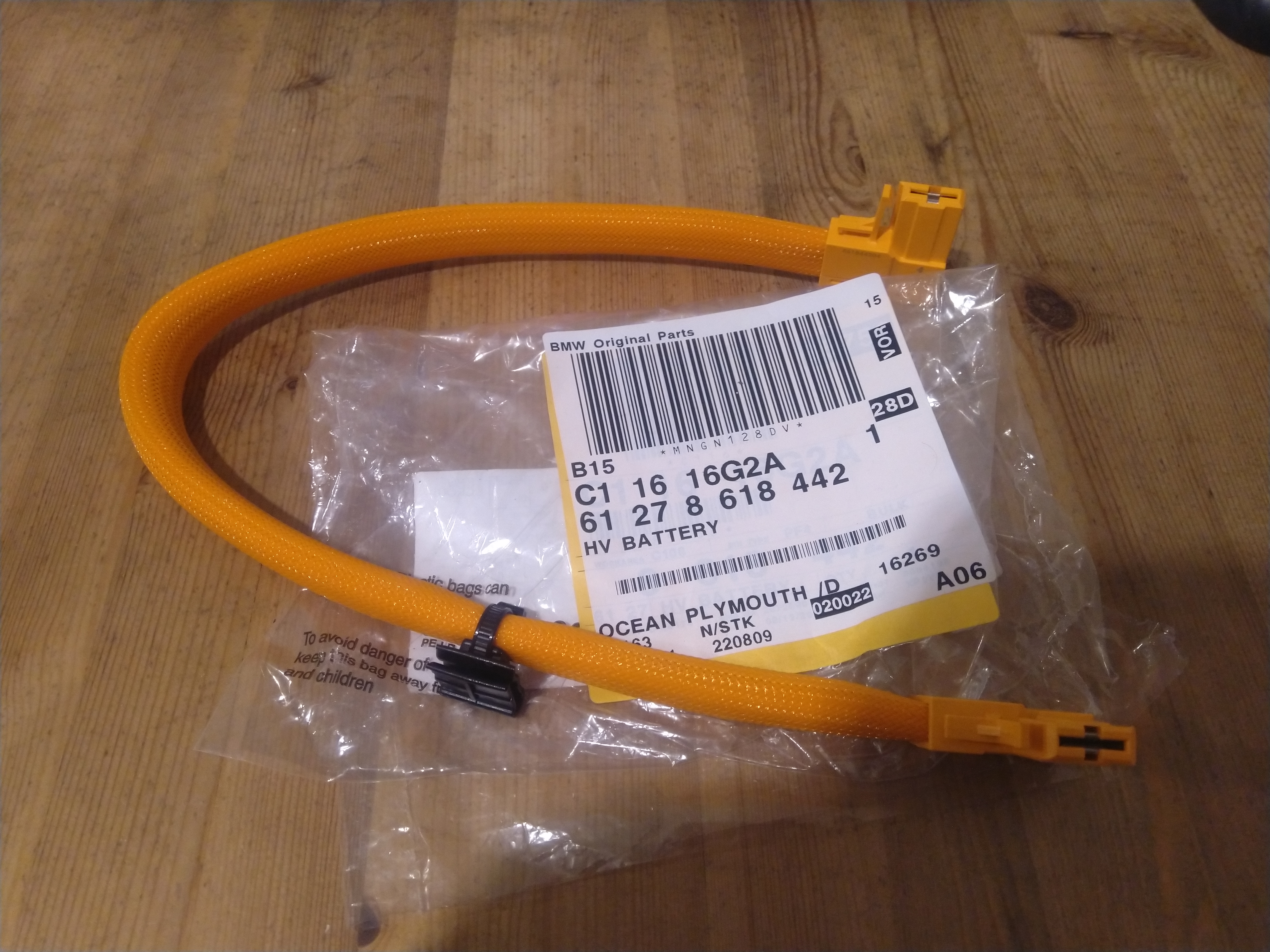

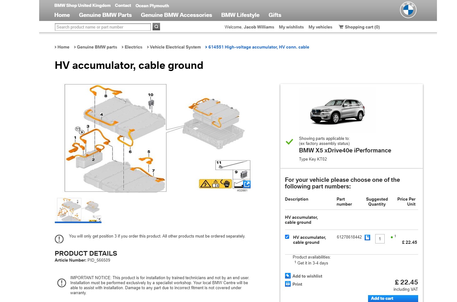

FJ3422 wrote: Thu Apr 15, 2021 12:45 pm and no one stocks / sells them in smaller amounts. Anyone have a tip ?
It's worth checking the BMW website, I had to buy another cable to go between modules and it was very reasonably priced at £23. Pretty much every part of the battery pack is available except the modules themselves. I'm normally a VW guy, but I have to say I am very impressed with BMW for this service. I cant think of any other brands enabling or even allowing the general public to order specialist HV parts directly online?
Most of it is still cheaper second hand with a bit of haggling on ebay but for things that no one has its the next best option.
For info, this cable is 500mm long and is actually cheaper than some of the other part numbers for shorter cables, no idea why, it still fits the same.
https://shop.bmw.co.uk/INTERSHOP/web/WF ... le_Welt-UK
