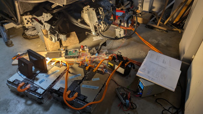

So, after spending some time trying to get SimpBMS running on a ESP32 I decided to put that aside and start testing all my components chained together to see if I was able to get a "first motor spin". Previously I tested all components separately using Zombieverter v2.17, that all worked out well. Recently I flashed to v2.20 and some things behaved a little different from what I knew, after a super fast Q&A here on the forum (Thanks Mitchy and Tom) things we're clarified.
For the first spin I hooked up 4 BMW modules (I understood the Outlander rear inverter requires minimum 200V to operate) to the S-BOX and from there is was really easy peasy lemon sqeezy! With the initial tries, the throttle actions gave a kinda choppy motor behavior, but after some modifications of the REGENRPM and THROTRAMP the behaviour was really smooth!
Trust me, I know what all wires are for ;)
Next step in the process: test the Outlander charger. I the mean time I will continue the mechanical side of the build.
Cheers!

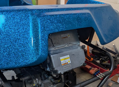

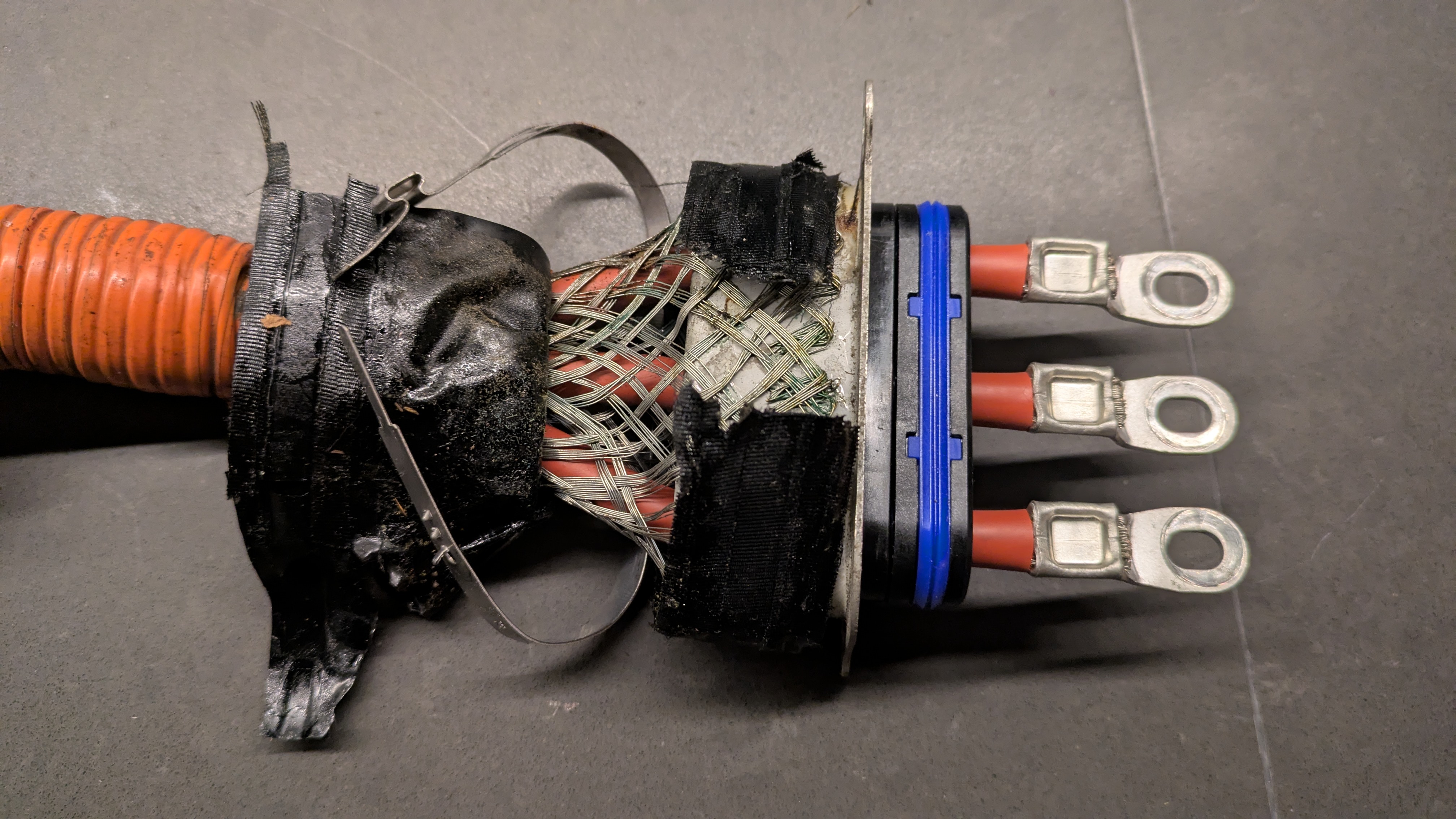

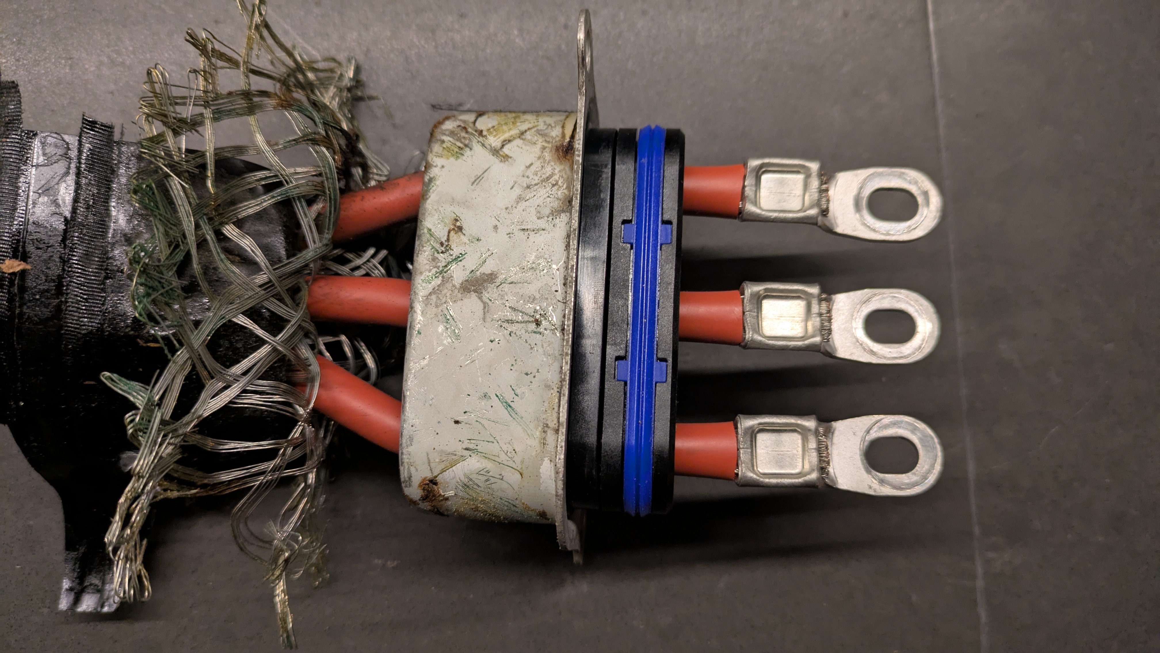

Today I did some minor work on the conversion project, a bit of motor alignment and measurements for some laser cut brackets.
I also test fitted the Outlander inverter and after trying serveral locations this seemed to be the most logical one, other positions were to close to the wheels for my liking. Especially since the back of the buggy is totally open and water can splash around freely on wet roads.

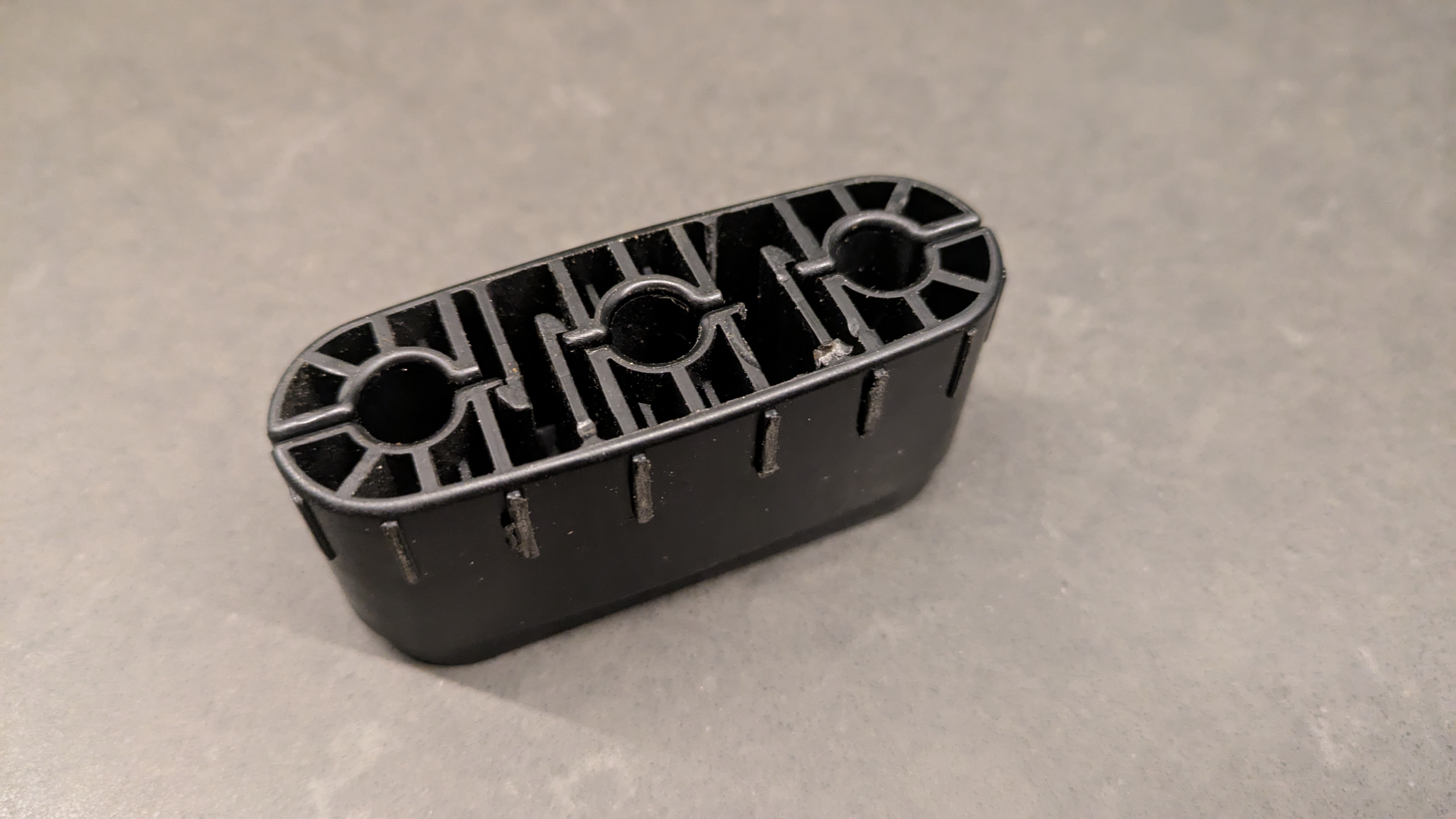

Unfortunately the cable (part #9499D147) motor and inverter is now to short. Preferably I'd like to build a new cable using the original cable connectors/clamps. I tried to disassemble the original connector, by gently tapping the plastic part I was able to remove it's metal housing. Unfortunately, some of the plastic broke during the process, the plastic is really brittle!
So, the idea at this point is to reuse the plastic part, preferably I'd like to buy a fresh new part, and build a longer motor cable. Here on the forum I saw 3D printed parts as an alternative to connect a cable to the motor/inverter, but I'd like to stick to the original connector if possible.
Does any one know if this plastic connector part is available from a dealer of after martket supplier?
