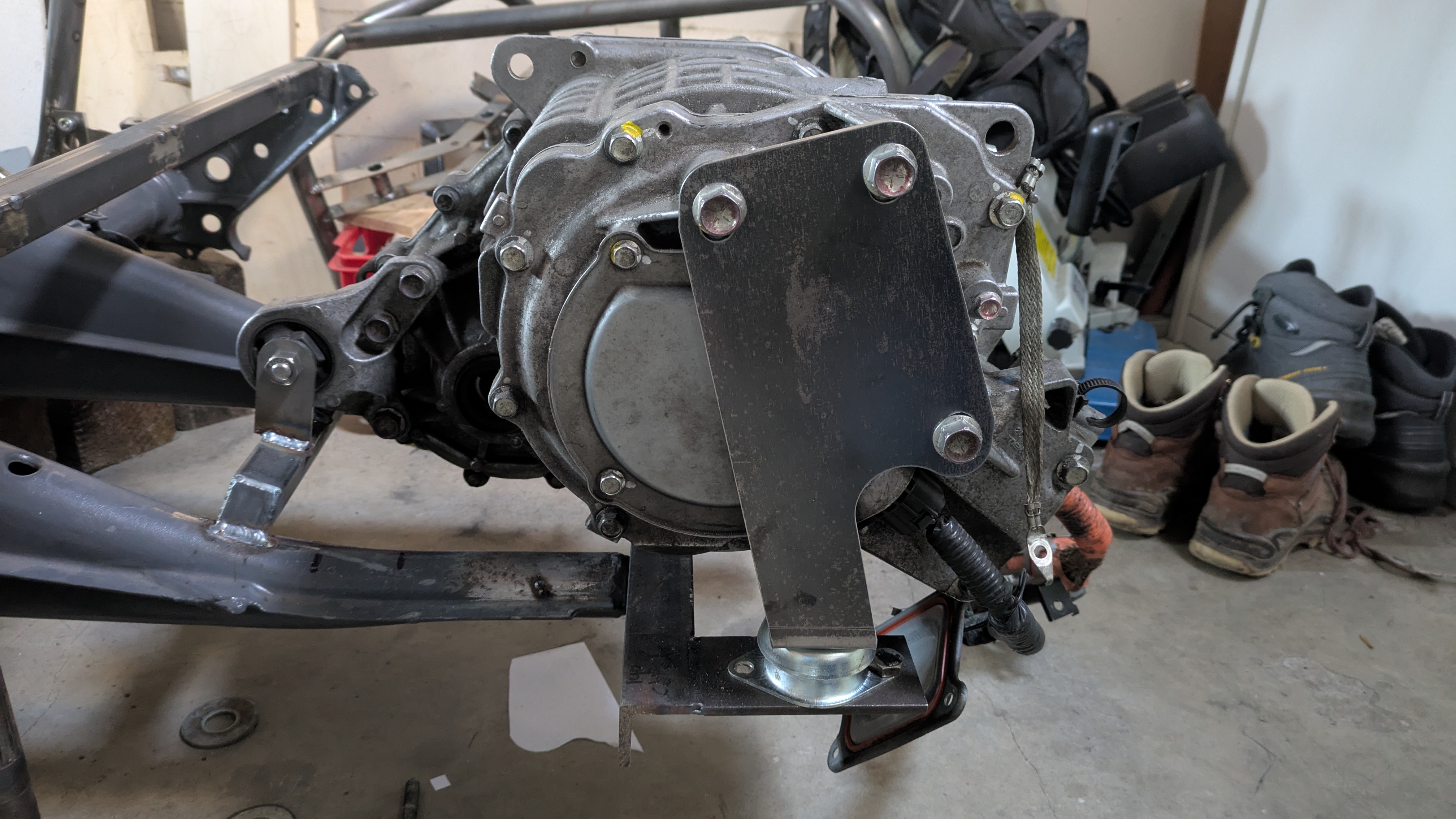

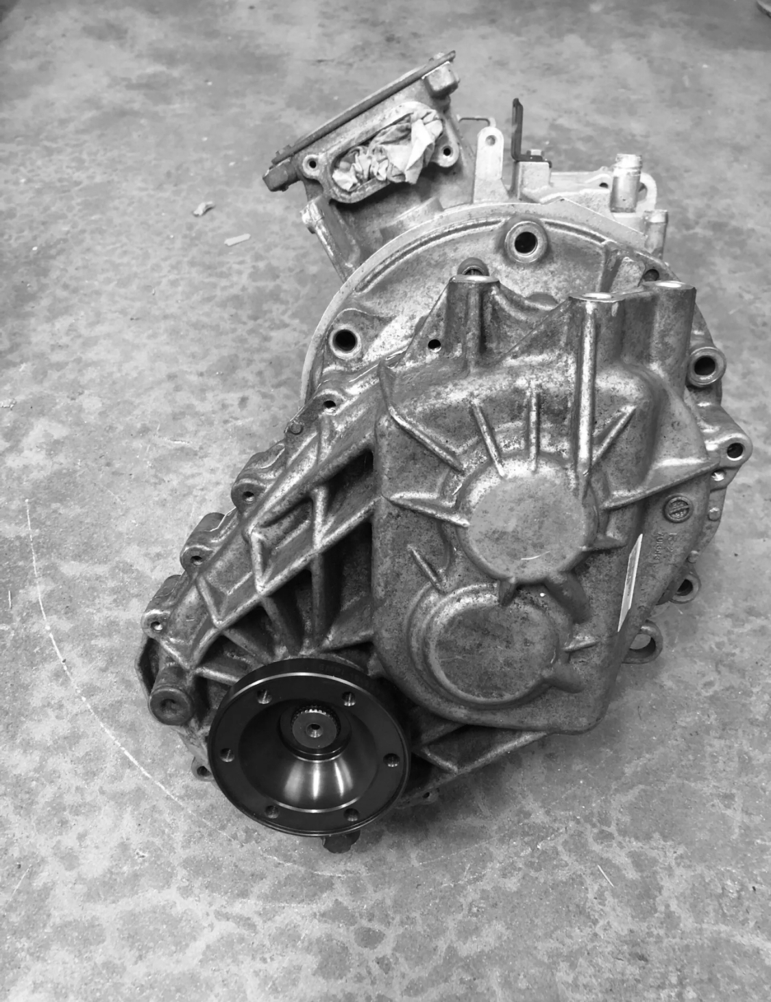

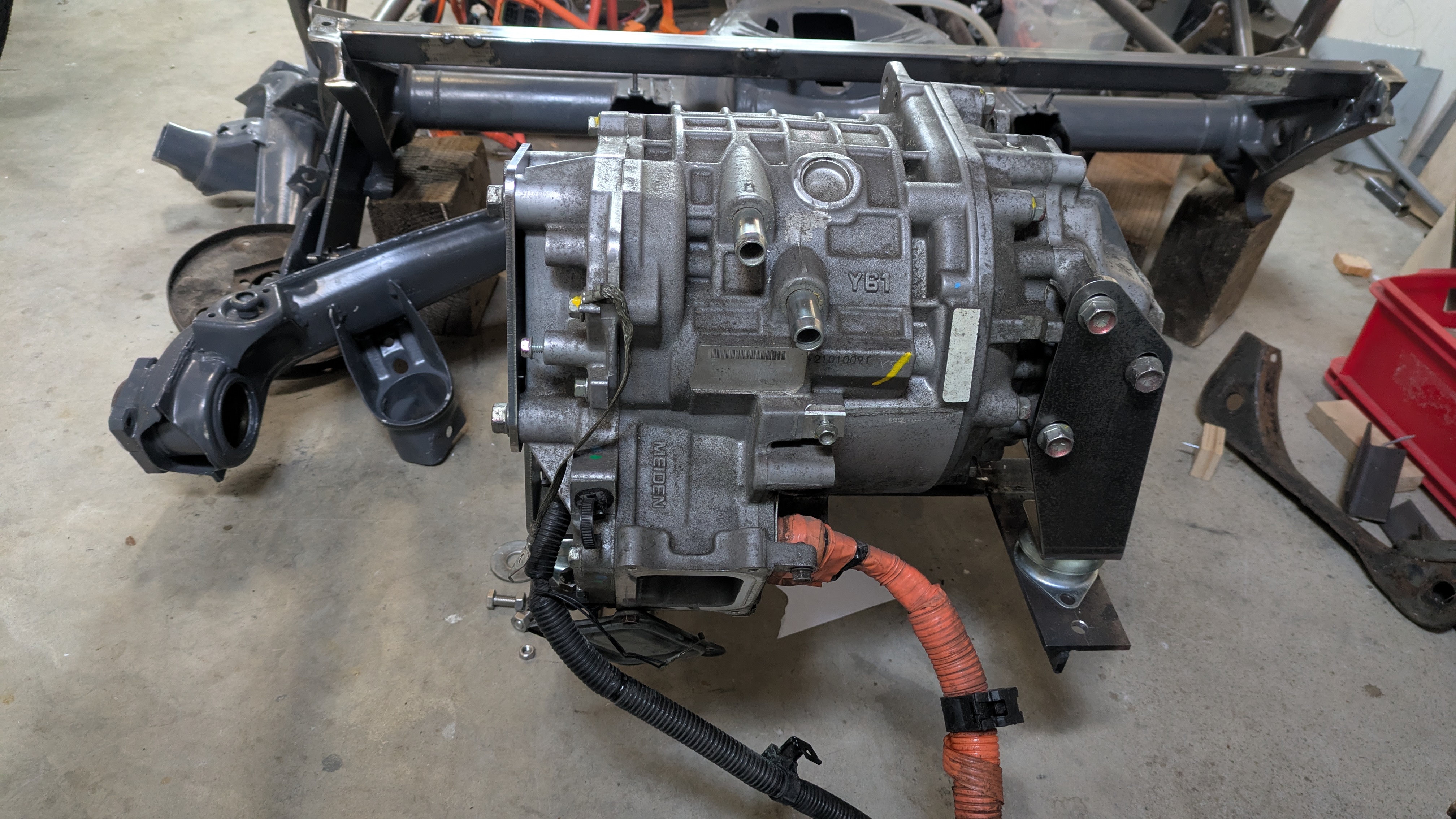

Recently I decided to choose an Outlander rear drive as the motor for my dune buggy conversion, having made that decision I also bought a drive unit.
Besides figuring out how to control everything, which batteries are best to use, how to transfer the power to the wheels etc etc, I will start with designing a mechanical solution how to mount the drive unit to the VW chassis. Ideally I would like to use the original VW buggy ( = beetle) gearbox mounting points to mount the drive unit.
So I need two drive unit mounting brackets:
  • Front bracket: I think I will keep the original drive unit bracket and design an additional bracket to connect the drive unit bracket to the front gearbox mounting point
  • Rear bracket: I will remove the original rear brackets from the drive unit and replace them with a bracket that can be mounted to the rear gearbox mounting points
Regarding the bracket (mainly the rear one) design, the easiest way is designing a bracket without vibration dampeners. Of course this will generate some vibration in the car. Has anyone experience driving with this drive unit without using the dampeners? Besides the vibrations, are there other factors why keep the dampeners? If it is a better Idea to use the dampeners, what type of dampeners could i use?
Below some pics:
Figuring out how to position the drive unit.
The buggy with the body removed.
Keep u posted!

for the outlander gear box, your In luck, as I have drive shaft adapters available, you’ll be able to use stock vw axles. No custom haft shafts needed.
Nice, those adapters! I already had the idea of such a solution but never actually checked if it was already available. First things first, getting the electrical system up and running. I gave the BMW packs some more thoughts, based on what I saw in Grekski's build and other information I found a 12 kWh pack will fit my project nicely, maybe a bit less milage than originally planned but for now good enough.
The price for such a pack is substantial in the Netherlands, 3500 - 4000 Euro's, so I'll keep an eye out to see if I can find a bargain. In the mean time I can focus on some other stuff.

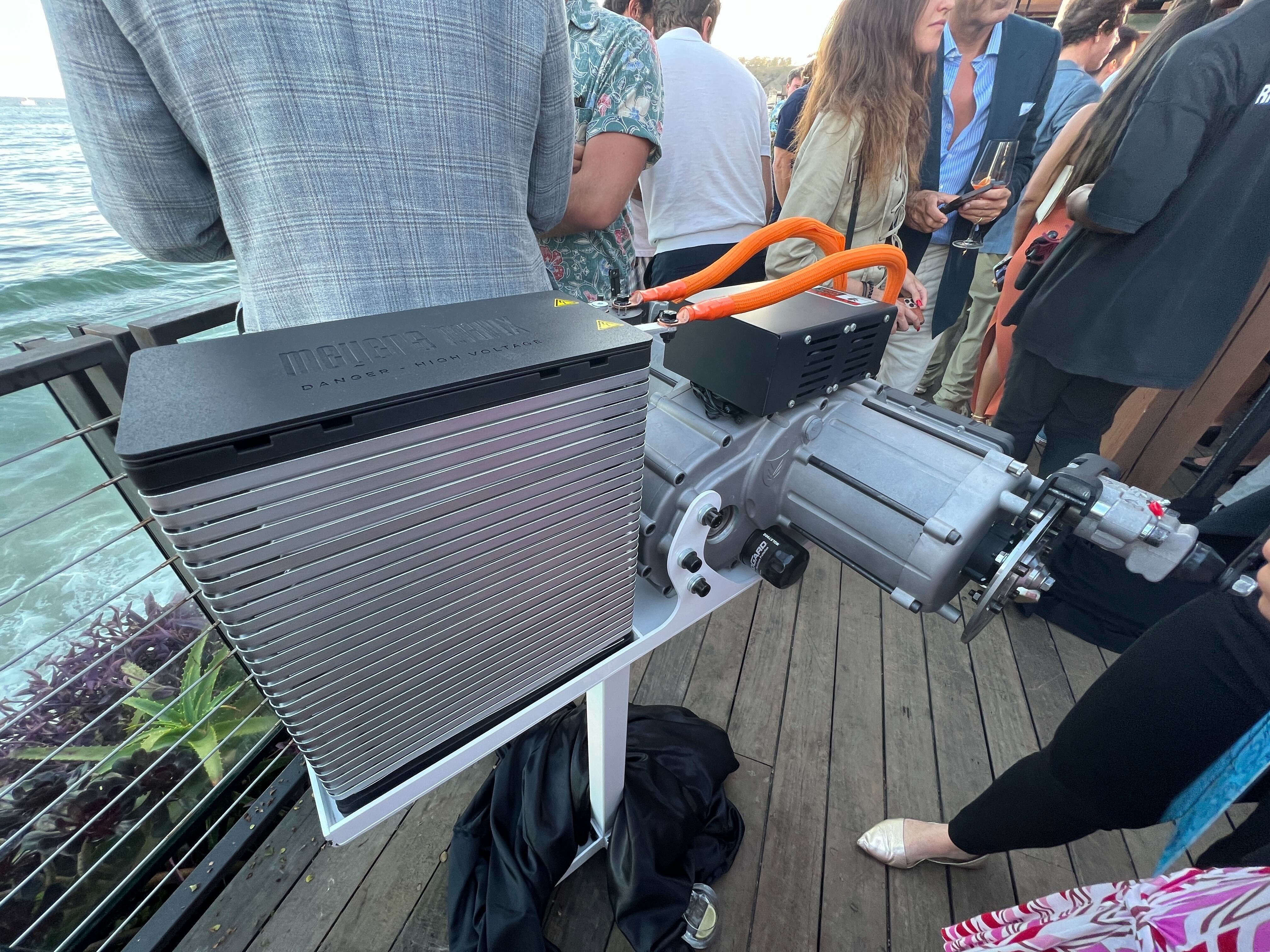

These estimates for mileage seem high, https://www.motortrend.com/news/2024-me ... -buggy-ev/
Sjanders
Posts: 37
Joined: Thu Jan 28, 2021 10:12 pm
Location: Netherlands
Has thanked: 9 times
Been thanked: 11 times
Re: [WIP] VW Manx conversion
Post by Sjanders »

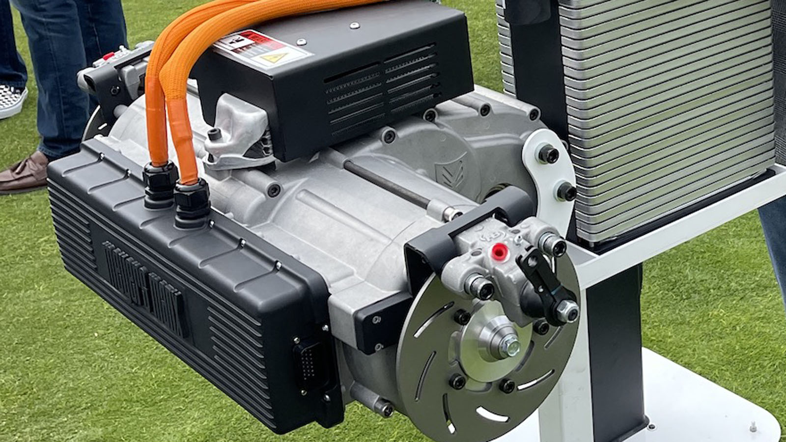

jrbe wrote: Sun Jul 14, 2024 9:58 am These estimates for mileage seem high, https://www.motortrend.com/news/2024-me ... -buggy-ev/
I've seen that version before, I like the way they managed to stay close to the original design! Apart from the VW beetle front axle the car seems to be totally modified, it has an aluminum monocoque. That saves weight compared to the original steel structure.
The milage also seems high to me, but who knows! The picture below shows the motor and batteries used in the car. Does any one has an idea where the motor comes from (I guess they didn't develop a new engine for this car) and what cells are used?
jrbe
Posts: 766
Has thanked: 363 times
Been thanked: 249 times
Post by jrbe »
I like it too. The multi-link rear suspension with the original front suspension is a funny choice, everything else they shared seems decent.
I tried to search the logo on the side of the motor but couldn't find it. Do you have any more images of that you could reverse image search?
I'd guess there are a lot more cells in the battery and it's just displaying a short stack. No idea what cells they are.
Sjanders
Posts: 37
Post by Sjanders »
jrbe wrote: Sun Jul 14, 2024 12:08 pm I like it too. The multi-link rear suspension with the original front suspension is a funny choice, everything else they shared seems decent.
Agree, seems a decent build. Totally newly developed car with an old school VW front axle as a tribute to the beetle.
I have done some additional searching, unfortunately I haven't found reliable information on the motor and batteries. ChatGPT suggests Nidec or AEM as the supplier of the motor, but I can't reproduce that information. I cant find the logo either.
Regarding the batteries, from some video's I understand that there are indeed more than 1 stack of cells, all nicely positioned under the back seat. Further searches on the batteries did not give any information on the possible brand/source/producer.
The picture below might be helpful in logo searching. Looking at the plug on the inverter, it very much looks like the plug they use on Curtis and Sevcon motor controllers. I guess there are 2 inverters, one for each motor. All in all, it is a nice compact package!

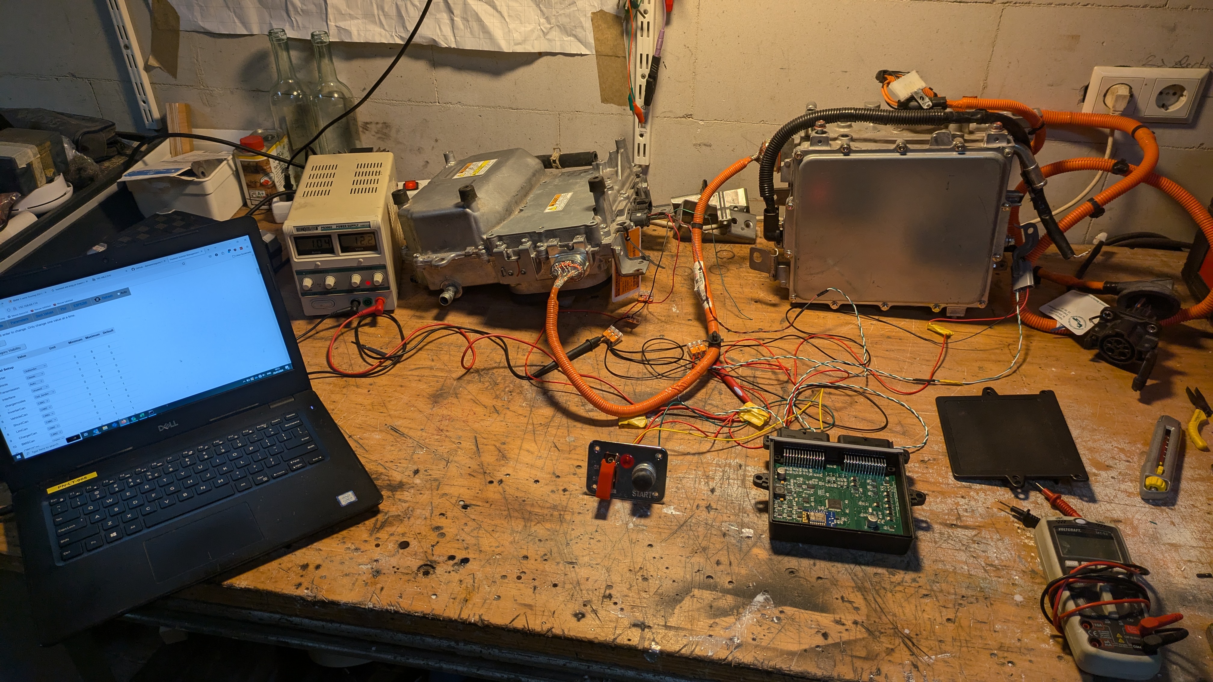

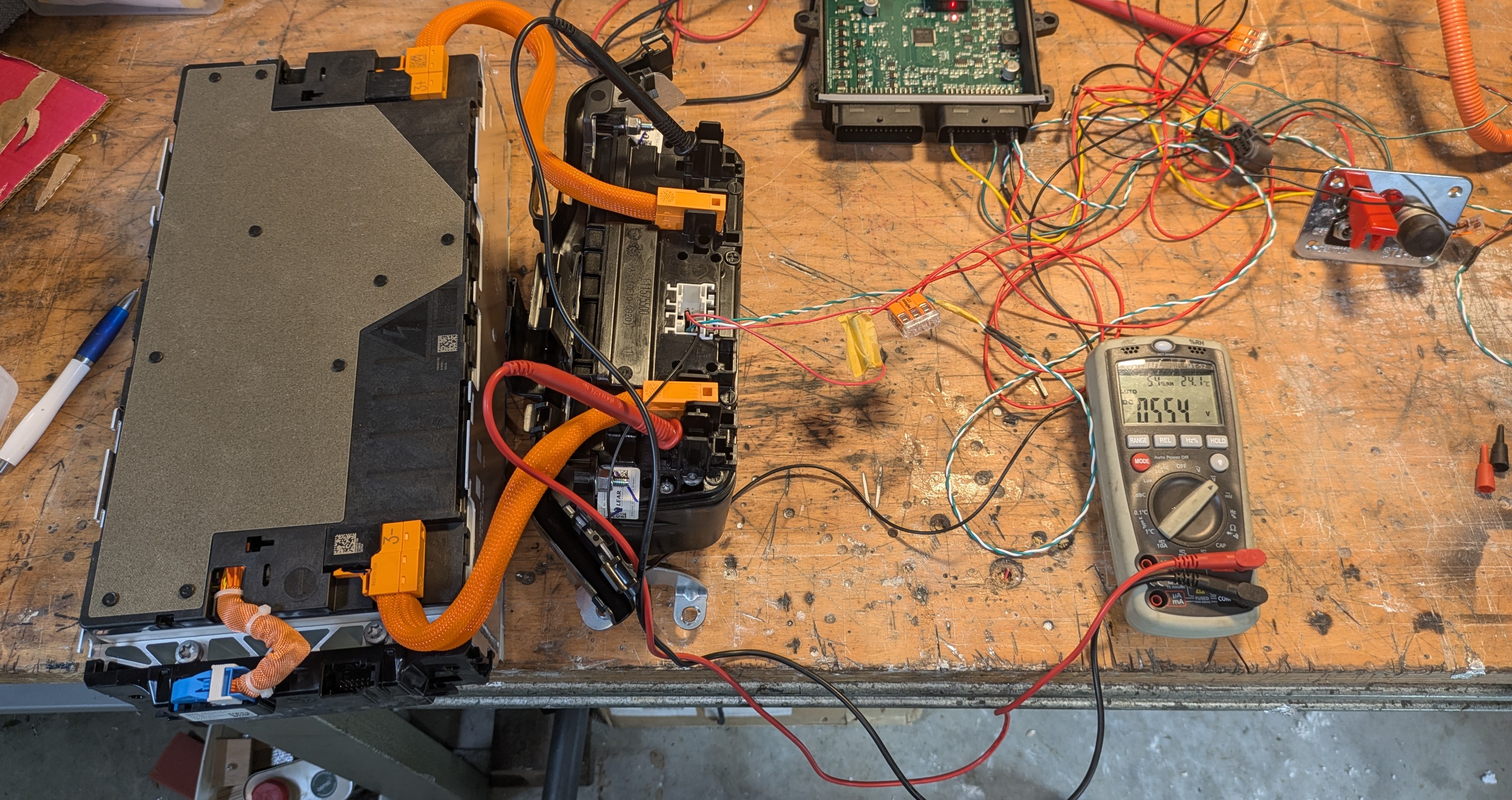

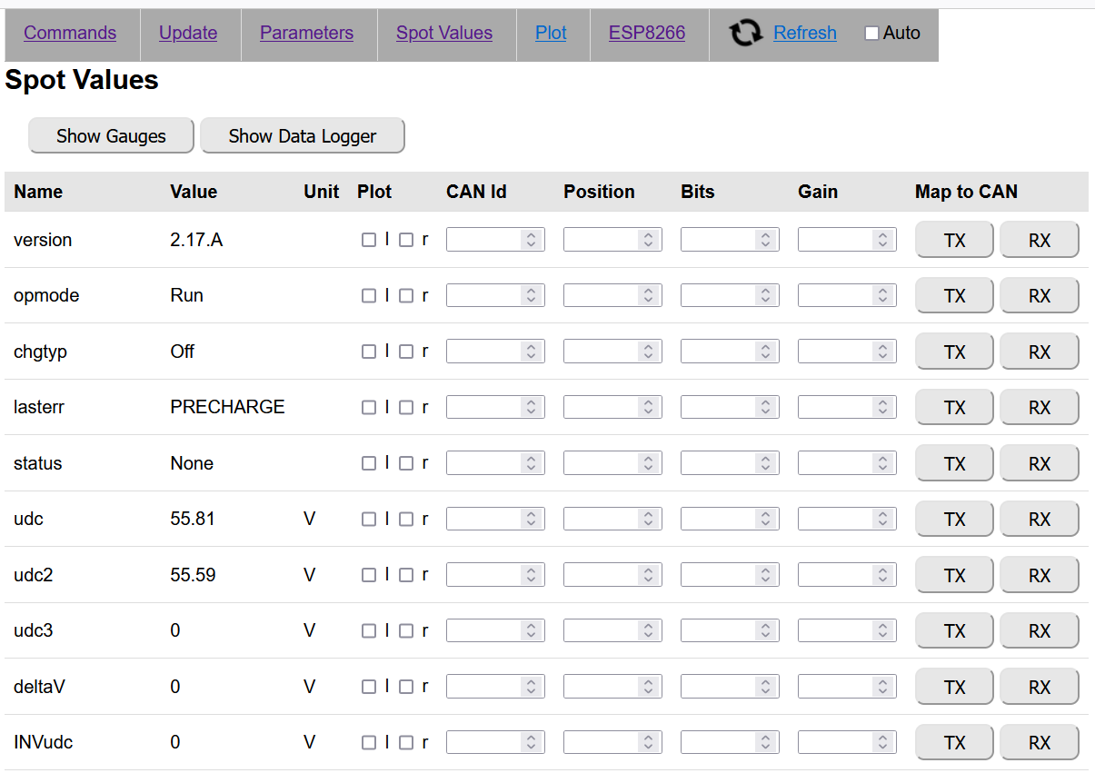

Hi all,

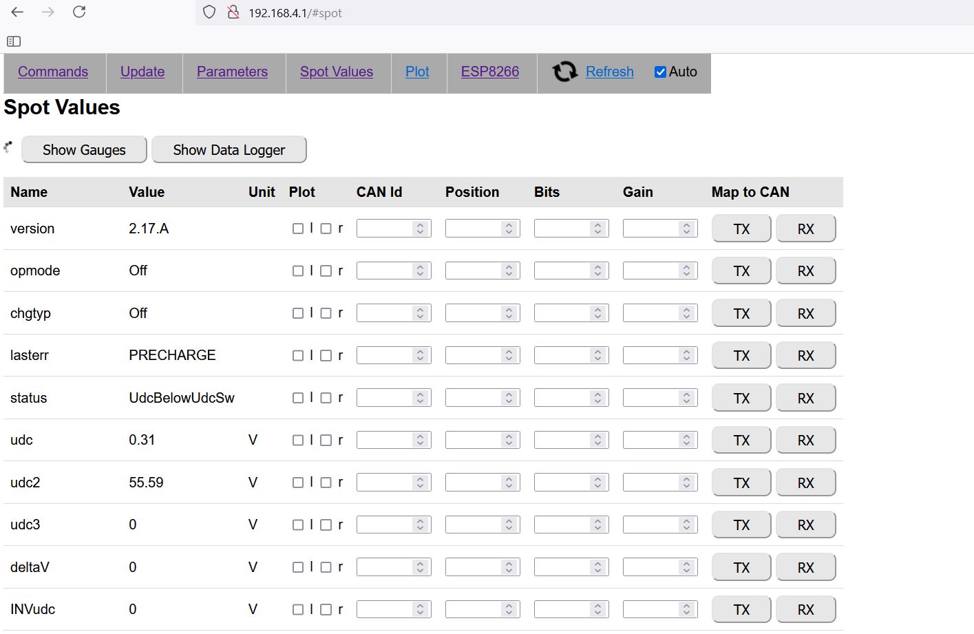

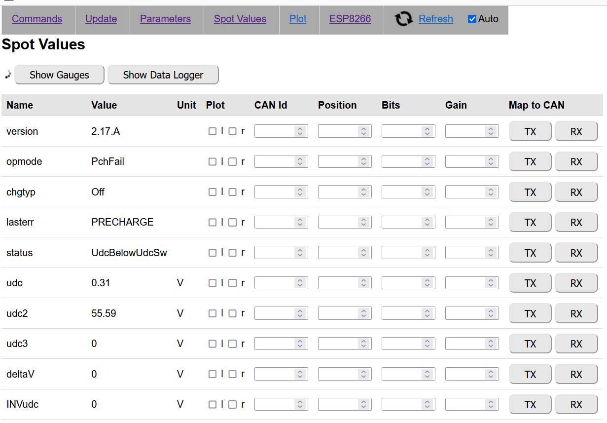

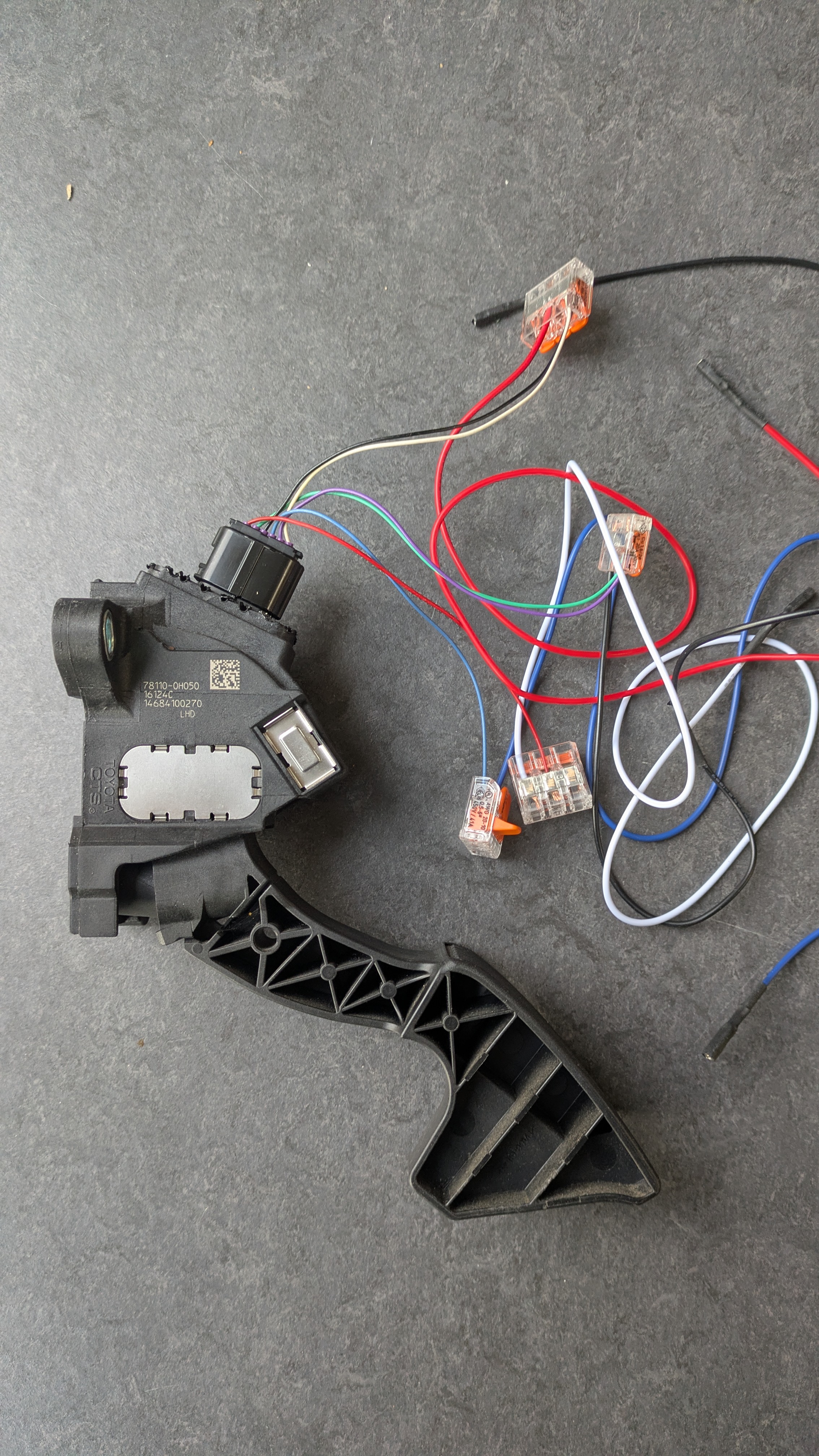

So, I'm taking little baby steps here! Got the Zombie soldered and it's working. I have setup communication with the Outlander rear inverter and the Outlander charger/converter. Communication with the Outlander rear motor (already in the car) was also succesful when connected to the inverter.
With succesful communication in mean i was able to read temperatures and applied voltages (where applicable).
As a next step, I would to test the motor and see if it spins when pushing the pedal. At this point I have no pre charger and contactors in my setup, so I was wondering if it is possible to safely test the motor using a lower voltage (for example 50-60 volts DC) without the need of contactors and a pre charger.
My idea now is to buy a BMW battery pack including the s-box, but I'm still looking for a decent deal. So if testing with a low voltage can be done with destroying the inverter, that would be nice. Of course I could always build a pre charge setup myself using a large resistor.
Suggestions are most welcome, thanks!
Posts: 2962
Has thanked: 330 times
Been thanked: 848 times
Outlander inverter does not work below 220v. No real need to test it if things show up well, you can spin the motor by hand to see if the speed updates on the spot values, best to graph it.
Sjanders
Posts: 37
Post by Sjanders »
tom91 wrote: Thu Jul 25, 2024 5:56 pm Outlander inverter does not work below 220v. No real need to test it if things show up well, you can spin the motor by hand to see if the speed updates on the spot values, best to graph it.
Thanks for your fast response! All clear. The hand spinning test was already on my to-do list, good to hear that it's a good validation test :)
Then I'll keep an eye out for a decently priced battery pack to get to the next steps in the testing process.
BR Sander

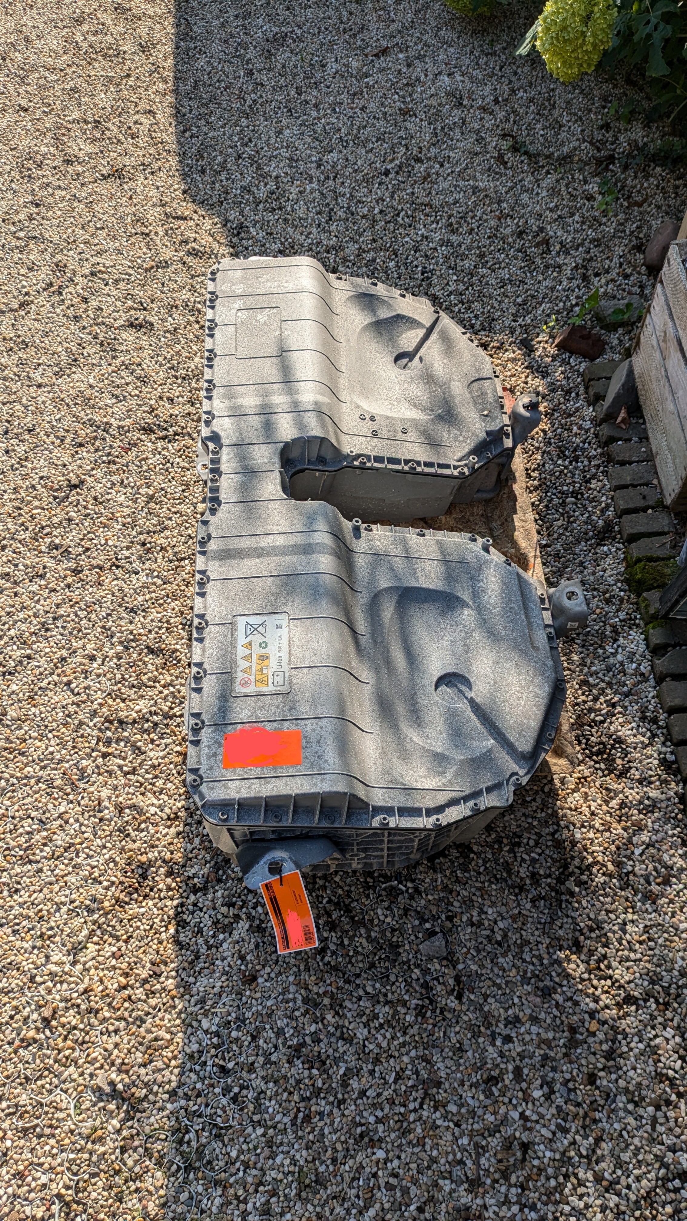

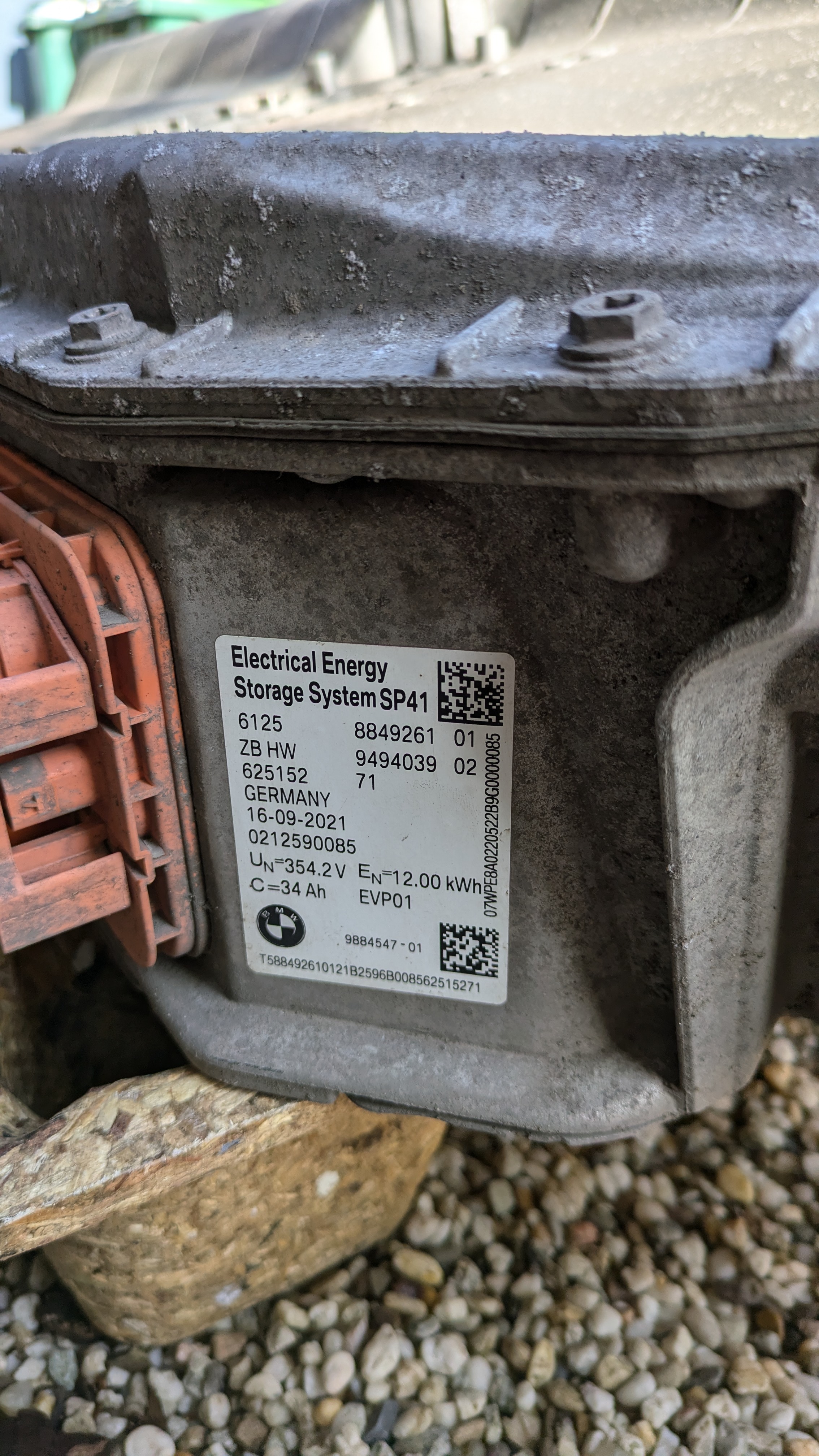

Hey all,
I've searching for a BMW 530e battery pack. I have found various suppliers with a rather large price range. The found range was from 495 to 4200 euro for a 12 kW pack. Comparing the build year an car milage there was not a huge variation between them (45000-58000 km), except for one supplier that offered a pack from a 2024 BMW with barely 1000 km on the clock, this pack was in the middle of the price range.
I think I will buy one of the cheaper packs, the supplier gives a 3 month warranty on it. Before ripping apart the whole pack, is there a way to test the capacity of the pack? Of should I test on module of even cell level? I expect that the SOH will be somewhat degraded, but I'd like to know if there are modules/cells that worse than others.
Could anyone point me in the right direction how to test a pack, preferably on a budget ofcourse.
Edit: I think I might have found something to test the battery on module level: https://nl.aliexpress.com/item/4001153199791.html? has anyone got experience with these testers?
Thanks a lot!
BR Sander
Post by Sjanders »
Look what arrived on my doorstep today!
Time for some next steps in my journey, I'm super excited!

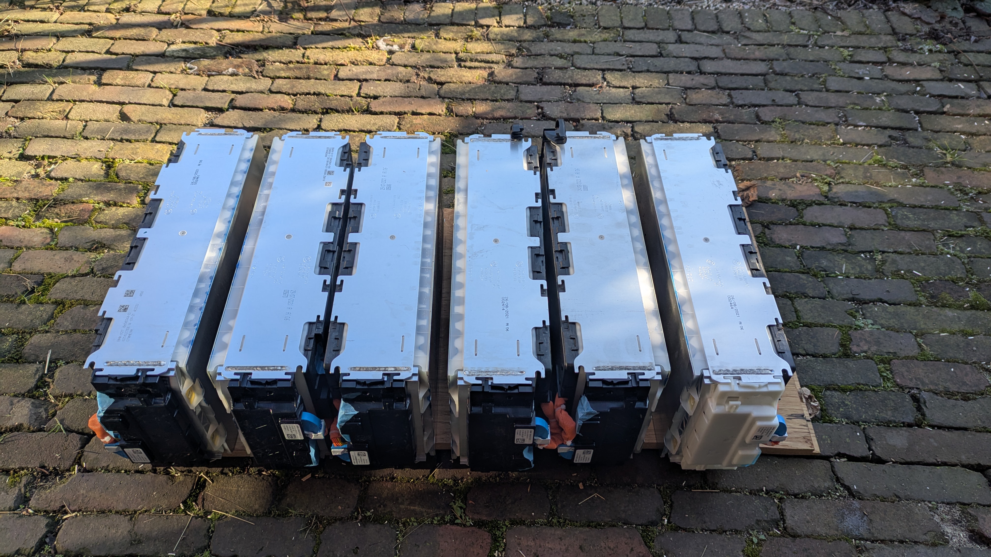

  • PSA battery (50kWh)
  • Zombie VCU

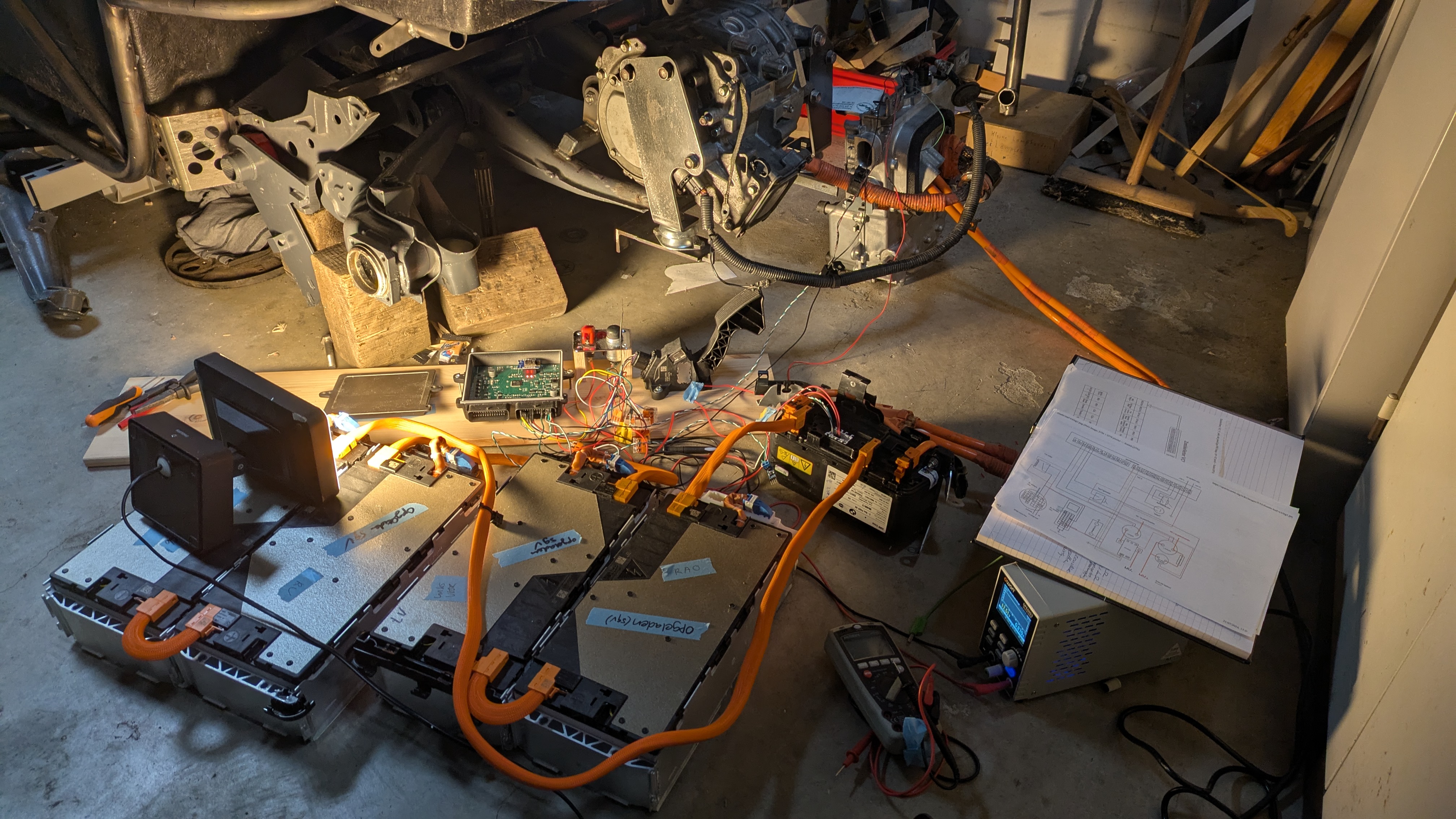

Yesterday I safely opened up the BMW SP41 pack, seeing the inside of the pack in real life is such a joy! I've never opened up a HV pack before, but i can really enjoy how well such a pack is designed!
After disconnecting the HV cables I measured the voltage of all modules, they were all reading between 55.3 and 55.4V, I did not measure the total pack voltage however. This morning I removed the S-BOX for testing with the Zombieverter. Initially I tested it without a battery module, when all seemed fine I tested with a single module.
I made the following observations without a battery module connected:
Pin 14 powers the contactors, in precharge mode the precharge contactor is pulling ~0.5A, when the contactors are closed it is pulling 0.86A.
Pin 13 powers the PCB (maybe something else?), when active it pulls 0.23A.
Measuring resistance over the S-BOX connections I found the following:
Open contacts -> 4.21 M ohm over the positive contacts, the negative contactors had no conductance
Precharge mode -> positive contacts resistance went up to 15.2 ohm followed by precharge fail (UDCSW set to 330 V in the Zombie)
Closed contacts -> 0 ohm for both contacts (UDCSW set to 0 V in the Zombie)
Allthough I couldn't find the resistance specification of the precharge resistor, my observations seems to show me all functions as it should be. Next step was testing this a module attached:
I started with UDCSW at 330 V, this gave a precharge fail as expected. After changing UDCSW to 50 V precharge was succesful and the Zombie entered RUN mode.
So, this was a really successful next step, I'm really happy with the progress. But....to be honest I could have done it without the expertise available here! Especially the super boring( ;) ), no cat containing, YouTube vids from Damien and Gregski were of a lot of help to me :)
Cheers!

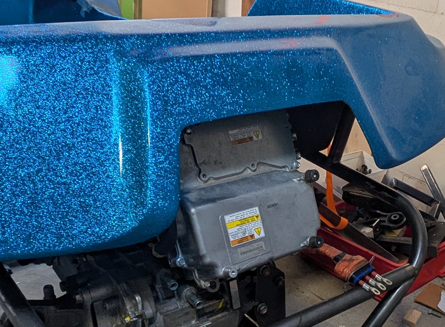

Initially I mounted the Outlander rear motor to the tube frame of the buggy. But on second thought I came to another idea to fabricate a subframe and some brackets and mount the motor on that using a some of industrial vibration dampeners.
In addition I picked up a throttle pedal from the local salvage yard, It came from a Peugeot 108, on the pedal is says Toyota CTS with ID# 78110-0H050. After connecting it to the Zombie, throttle pedal calibration was done in no time.
At this point in the project I have almost all parts I need to start testing, but there is one thing that confuses me and that is the BMS.... I have a BMW 530e battery pack, it comes with a build in BMS but it is not (yet) possible to control the BMS master module with the Zombieverter. As far a I understand it correctly it is possible to control the slave modules with an alternative BMS system.
Am I right? If so, could someone please point me in the right direction which BMS system is suitable for me. Considering I'm more a construction kinda guy than a software/programming expert..
If i'm not even close to understanding whats going on, which obviously is possible, I'd very much like to hear how it should work.
Many thanks!
