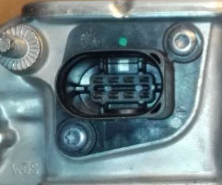

I purchased the WEBASTO heater and have the connectors and am ready to do my own testing.
Silly question to some, but on the LV connector on the heater side (picture below), which is PIN 1, so I can build from there for testing?
Top RIGHT
Top LEFT
Bottom RIGHT
Bottom LEFT
Thanks everyone and an early Merry Christmas to all of you!
jsimon
Top RIGHT
Top LEFT
Bottom RIGHT
Bottom LEFT
jsimon

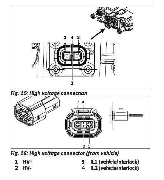

Re: Webasto HVH50
Excellent. I was looking in the wrong PDF. Thanks for the quick response!
Now that I am reviewing page 11, I want to make sure I am not mixing up the HV+ and HV-. The wiki page says: "The right pin (with tab facing upwards) is HV+, the left one HV-"
BUT page 11 of the PDF seems to indicate that HV+ is on the LEFT side of the connector (ATTACHED TO THE VEHICLE).
I get that this might be one of those times where one person is talking about the connector coming from the power source (FIG 16) and one person is talking about the connector attached to the actual heater (FIG 15), SO . . . just to be safe, can someone confirm if the LEFT SIDE of the connector attached to the heater (FIG 15) is HV+ or HV-? That is what it appears to say in the manual.
THANKS AGAIN!

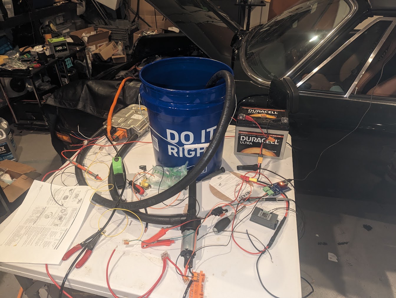

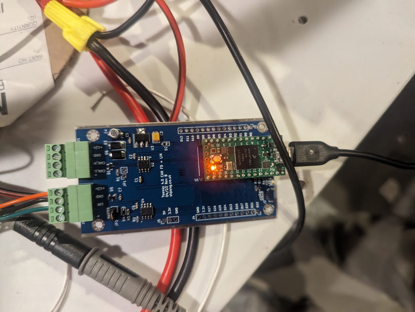

I wanted to keep everyone up to date on my progress. Thanks to royhen99, who has taken the time to convert the code created by Johan into a form acceptable to Arduino. MUCH APPRECIATED!!!! We have been tweaking it, but I am not getting hot water. I am trying both the 9600 and 19200 baud rate.
Below is the code as it stands in case anyone sees anything that stands out to them.
Here is the included lin_bus.h file that is relied upon for the program:
This schematic helped us confirm the lin_cs pin:
Here is the Teensy 4.0
My messy work space!!!!
Thanks!

When I initially wrote the code I did not know what hardware you were using. The skpang board uses serial 3 for lin so initialisation should be
LIN l(&Serial3, 19200);

Re: Webasto HVH50
Thanks guys. I updated the code to LIN l(&Serial3, 19200) and LIN l(&Serial3, 9600) and neither seemed to engage the heating of the water.
Johan, I am not sure what changes need to be made to the communication parameters as you mention above. Maybe royhen99 can help with that.
I assume my settings on heat and power are correct with the offsets. I do get the following warnings when compiling the code which I am told is caused by conversion of power which is 16 bit number to lin data which is 8 bit:
warning: narrowing conversion of '(int)(((short unsigned int)((int)Power)) / 40)' from 'int' to 'uint8_t' {aka 'unsigned char'} [-Wnarrowing]

I also have another heater I can swap in at any point to rule out a faulty heater.
The hardest part is I am not able to see any feedback to know if anything is happening. Operating on faith that the 12V to the heater is actually turning it on and the LIN signal is being received . . . I am happy to keep troubleshooting with any assistance.
Thanks!

Part of what I like about EV-Olution's design is that there are status LEDs (and a start - stop button!) simply using MPU I/O pins
I am confused by the nomenclature on the schematic, I see LIN_TXD and LIN_RXD on the MPC2004, which I think would be connected to TX1 and RX1 of the MPU, but those pins are labeled CRX2 and CTX2?
Also, what is the CAN doing?
Thanks!
Thanks!
