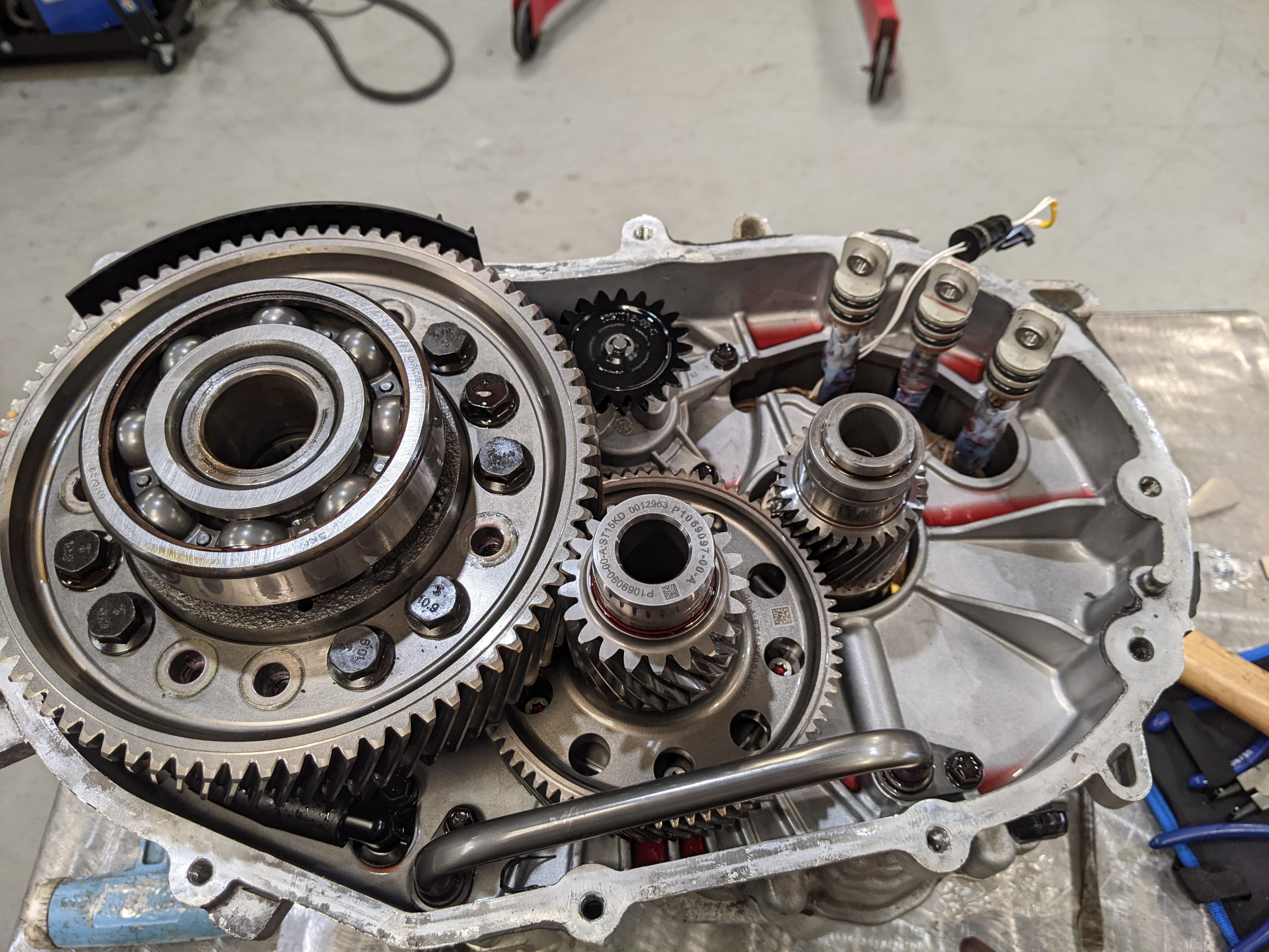

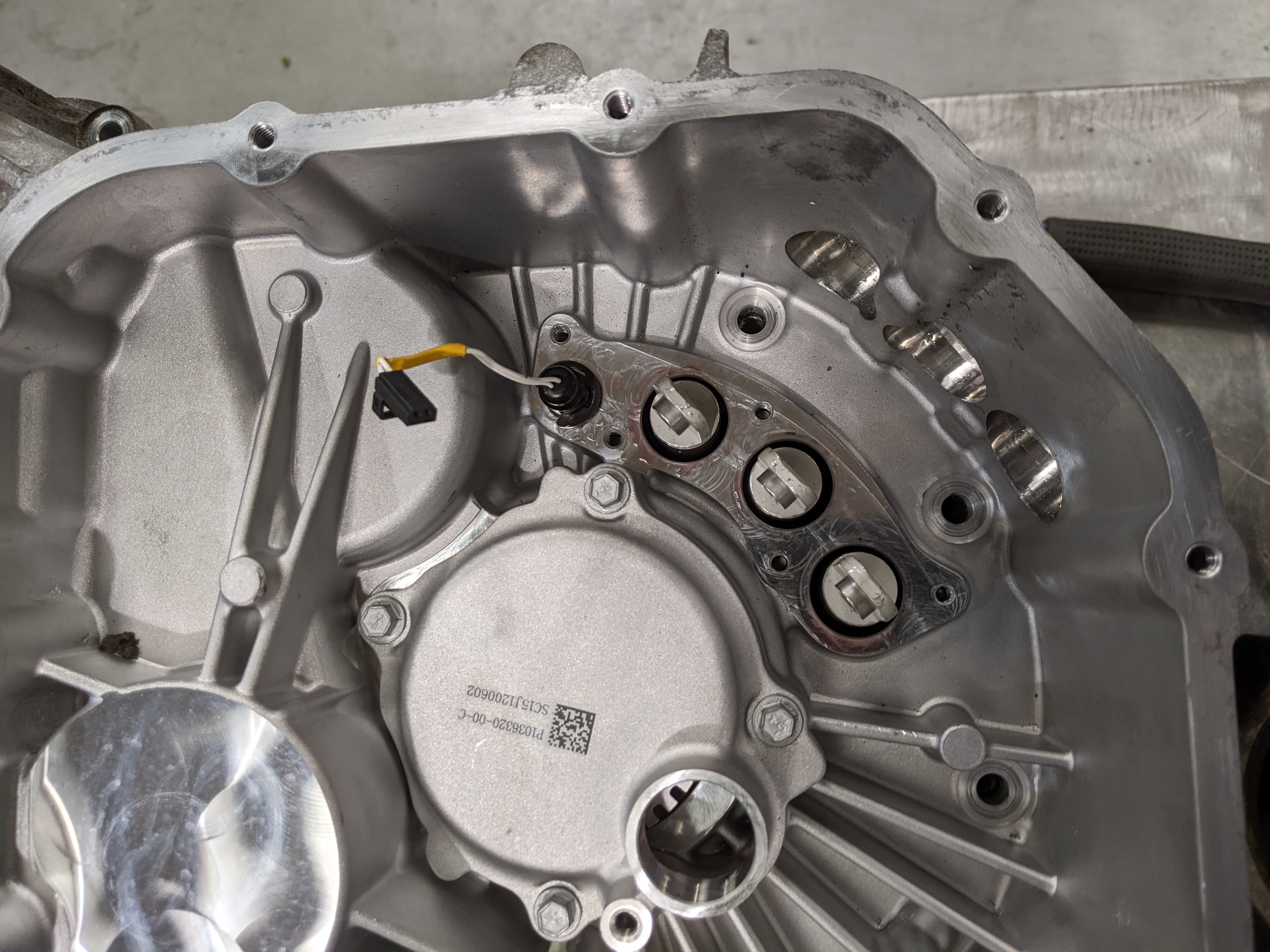

Do we have a picture of how that wheel is fitted?

It's literally just pushed onto the end of the motor shaft. Here's a teardown of mine.
