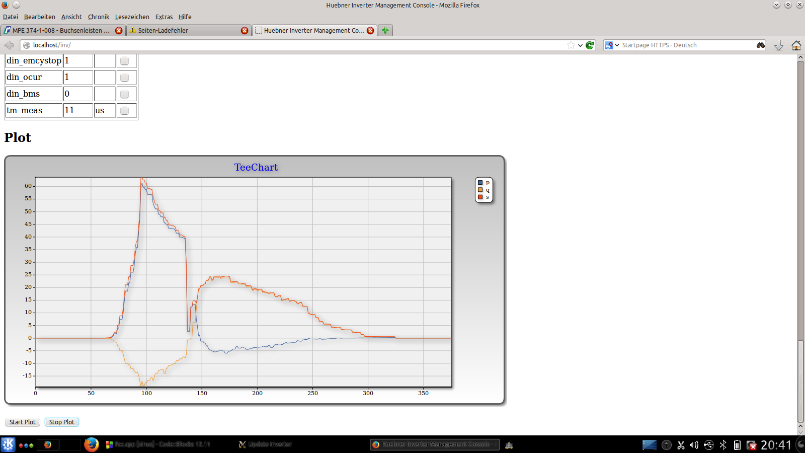

Good results there, looks a lot like some of my plots of transient states.
The code is basically the same as mine (though your library has improved and made it easier for me): https://github.com/catphish/stm32-sine/ ... L188..L192
Also worth noting - you knew how to calculate Is (ilmax) all along, although I guess doing it this way is a bit expensive compared to my hypot3 method.

Indeed. I think the need to feed il1 and il3 to the transforms must be down to the current sensors not actually being on L1 and L2. The FOC code uses "pinswap" to correct for this.
EDIT: oh yes, Prius Gen2 indeed has sensors on L1 and L3 if I remember correctly. Implication: what works on your bench will not work on your Tesla SDU.
