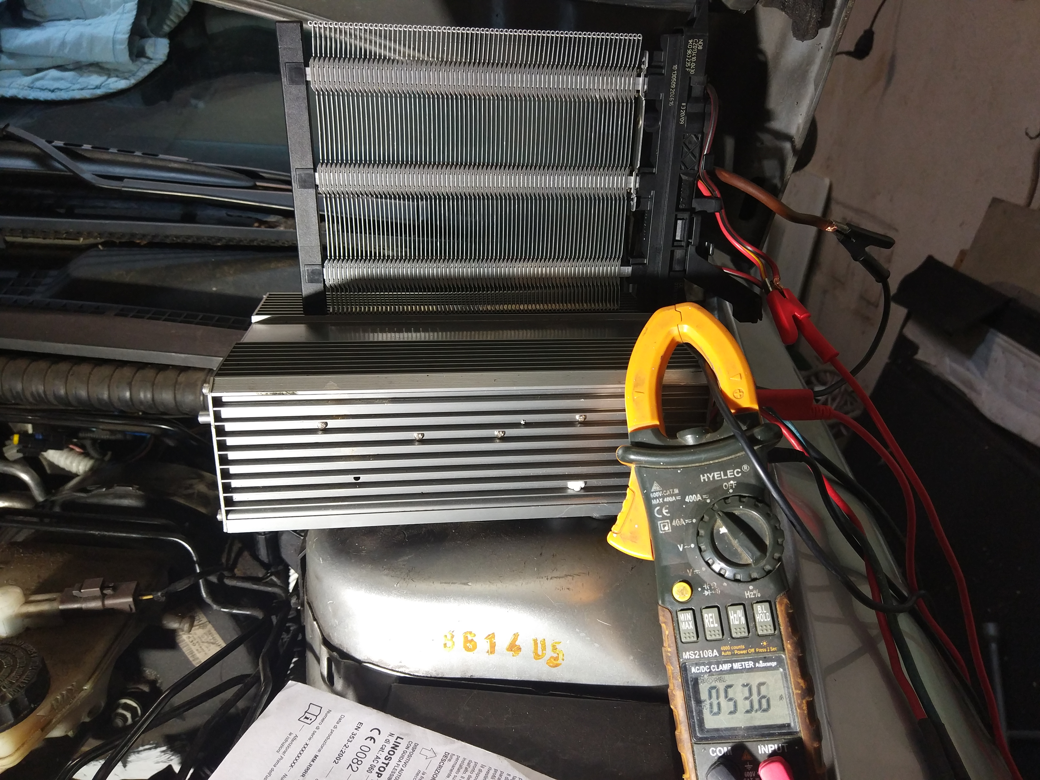

PTC preheater

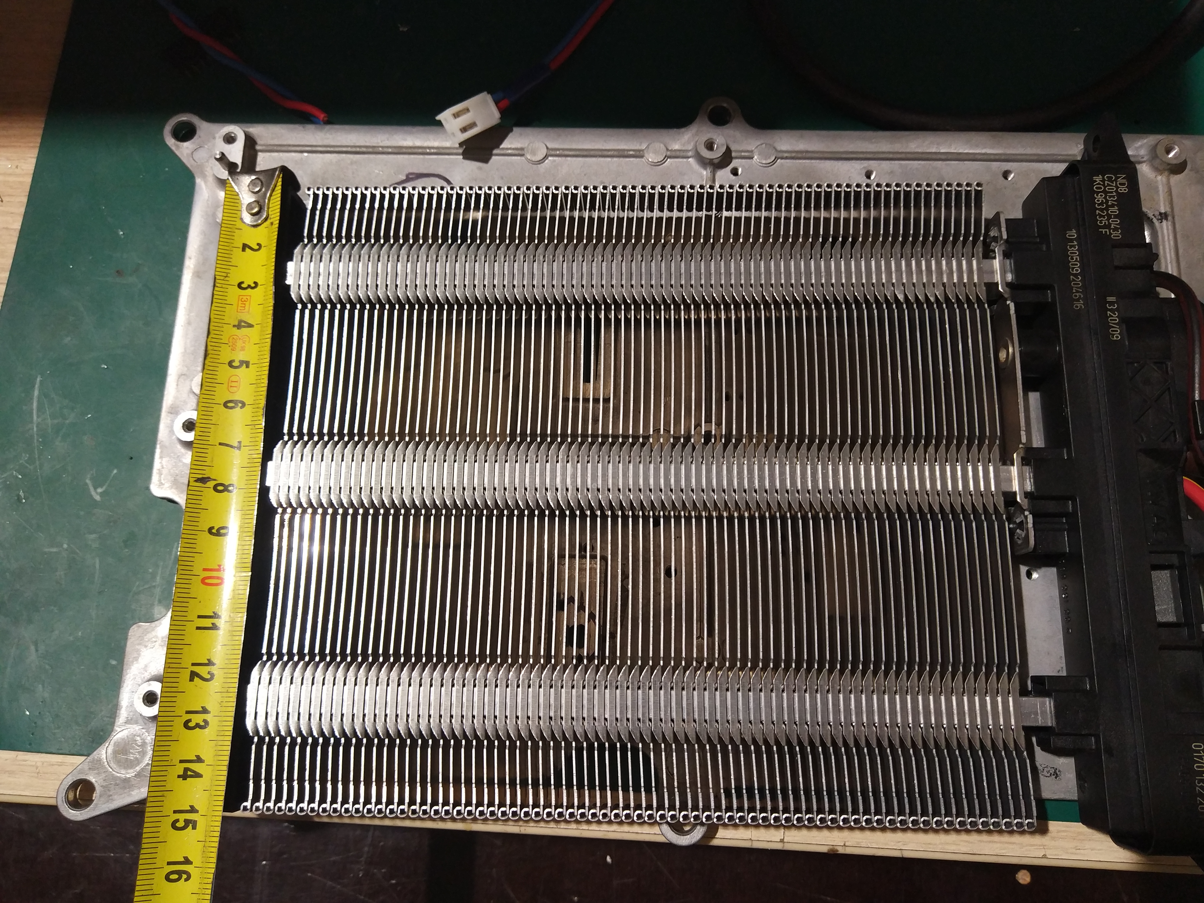

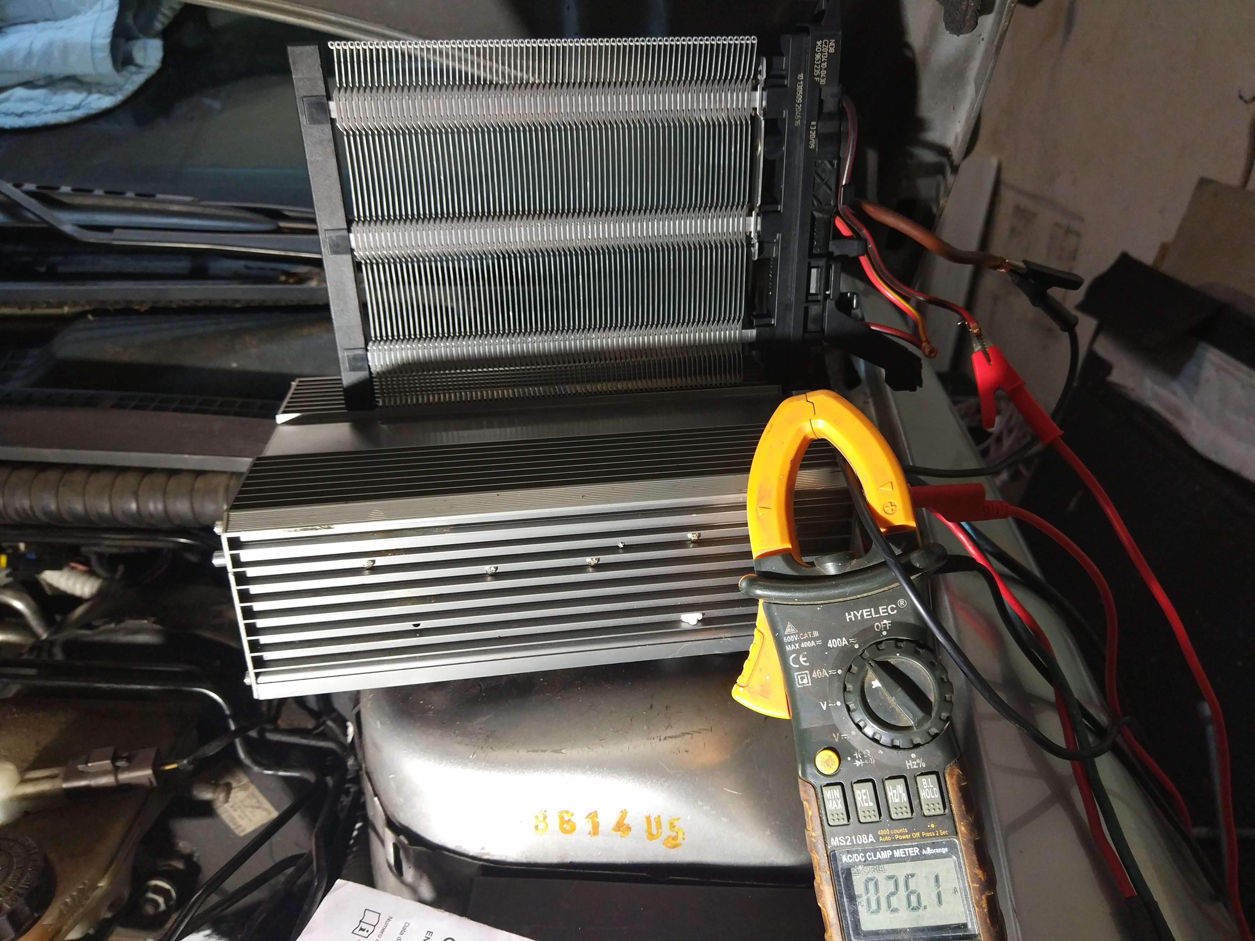

I got this preheater in scrapyard for 20€!
It is like new. It supposedly belongs to VW Golf mk V.
I tested it and it provides about 800W from 14V source.

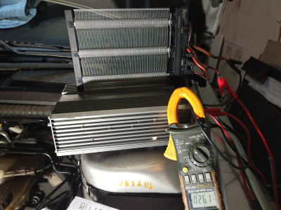

It has PTC characteristic so it is self regulated. If you lack the air flow its temperature will raise and with it the resistance.
This means less amp flow and less power untill you provide enough air flow.

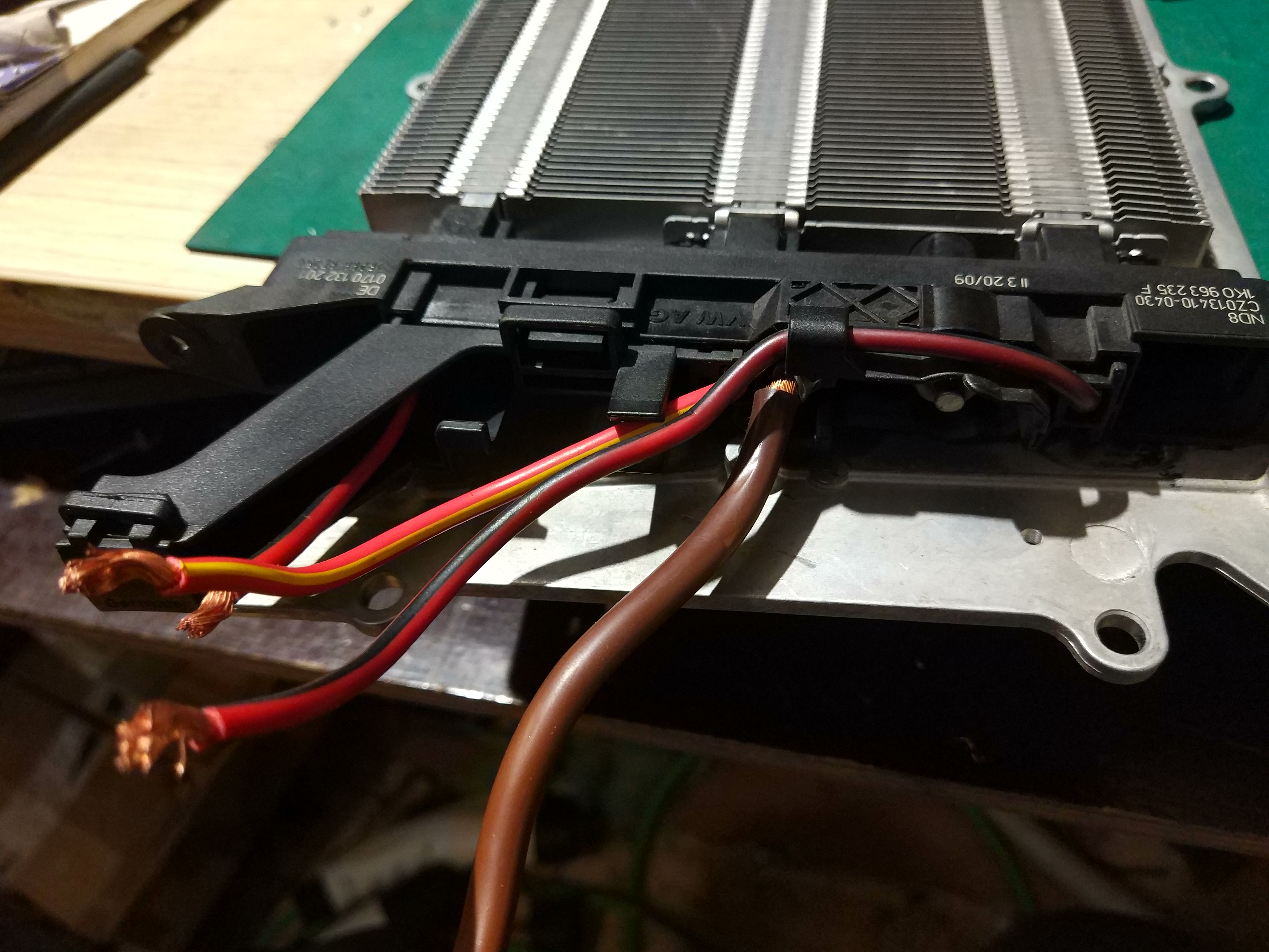

It has three power lines each worth about 25A. I tested it on my battery with power supply that controlled voltage drop to 13.6Vdc.
1st line is 25A = 350W
2nd line 42A = 600W
3rd line 56A = 800W
Strangely each element by itself consumes 25A, but if i connect two of them i only get 42A max and if i use three i get 56A.

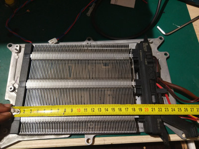

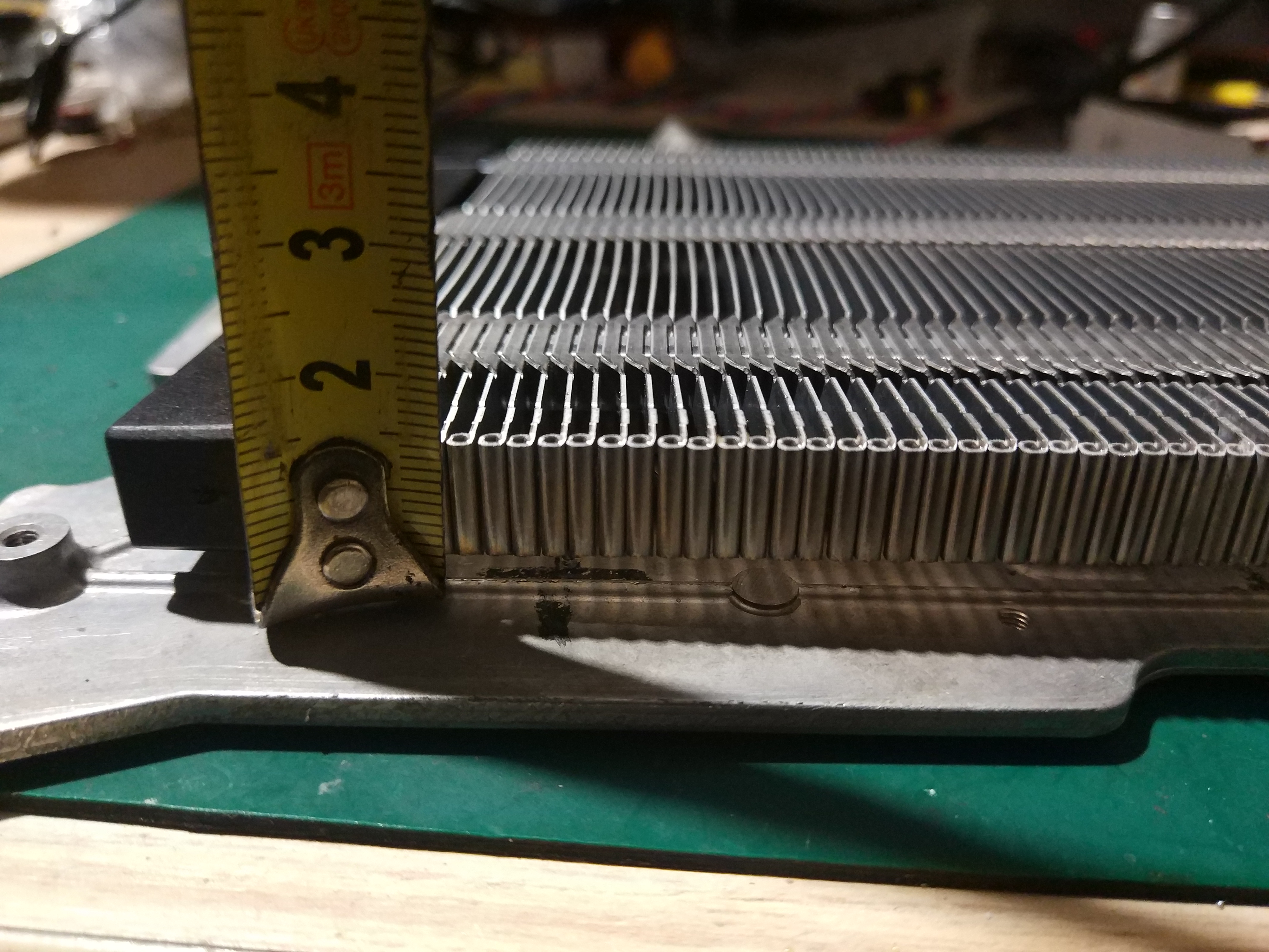

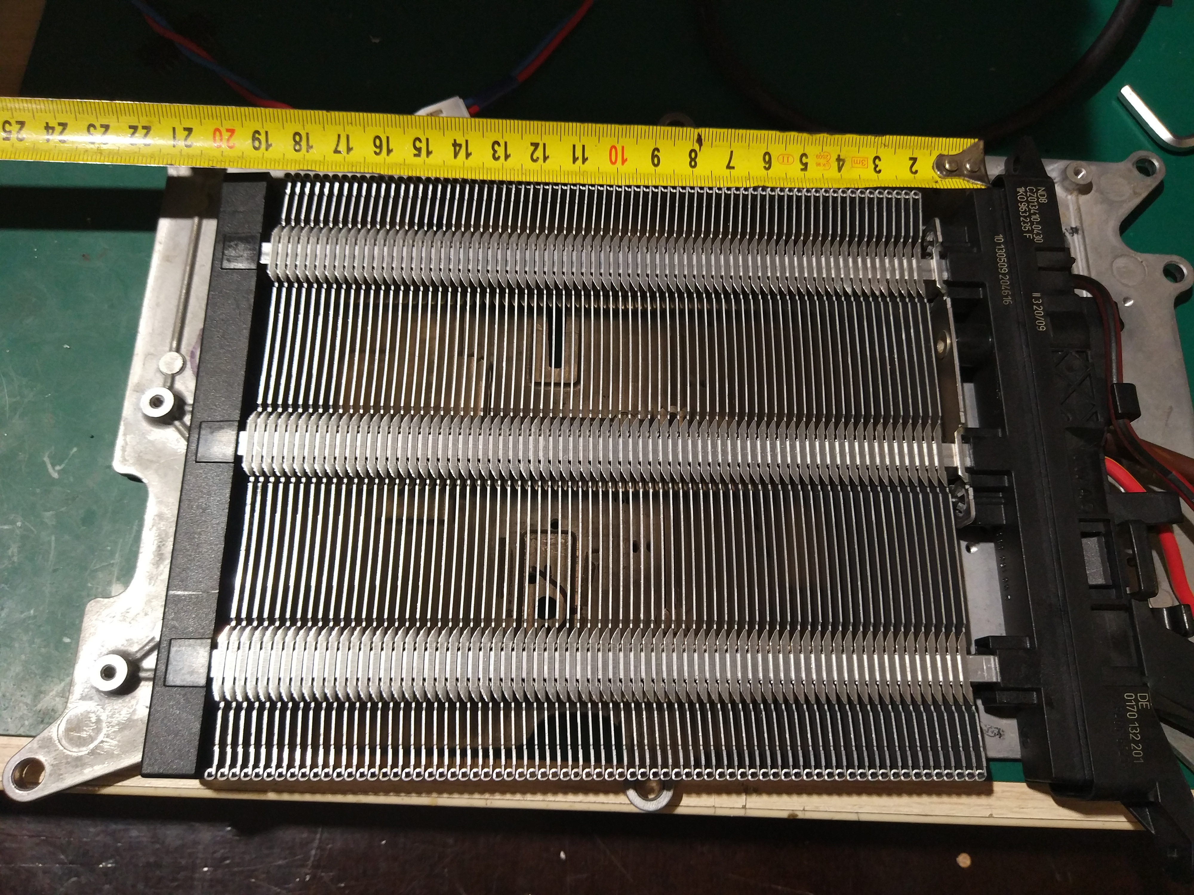

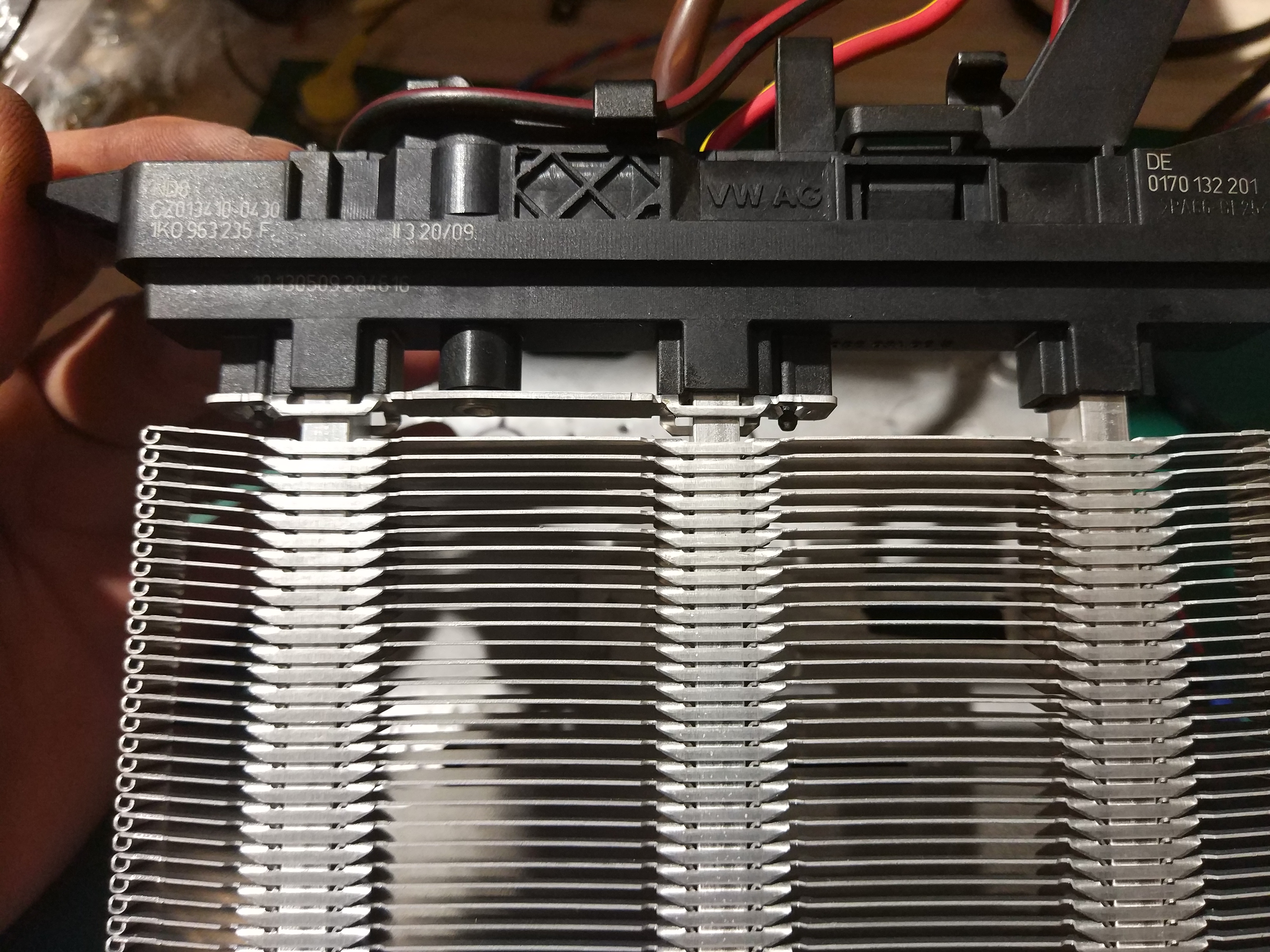

Effective dimensions are about 150mm x 200mm x 15mm. That is the "meat" that is fixed into slot, but there is some 30mm overhang and cables that are outside slot.
My intention is to make a slot in front of the liquid heater to fit this so it will be in the airflow.
Then i will use 3x 30A relays and some switches to run it from inside cabin. Only when car will be running however!

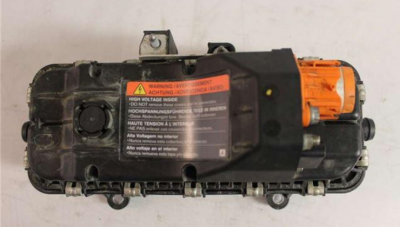

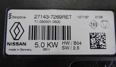

Can I ask if the 5Kw heater from the Gen 1 Leaf (27143-7269RET) is of any use for cabin heating into an existing heater matrix?
Posts: 3796
Been thanked: 413 times
Cookie6000 wrote: Sat Jan 04, 2020 5:04 pm Great thread this. Thanks for all the info!

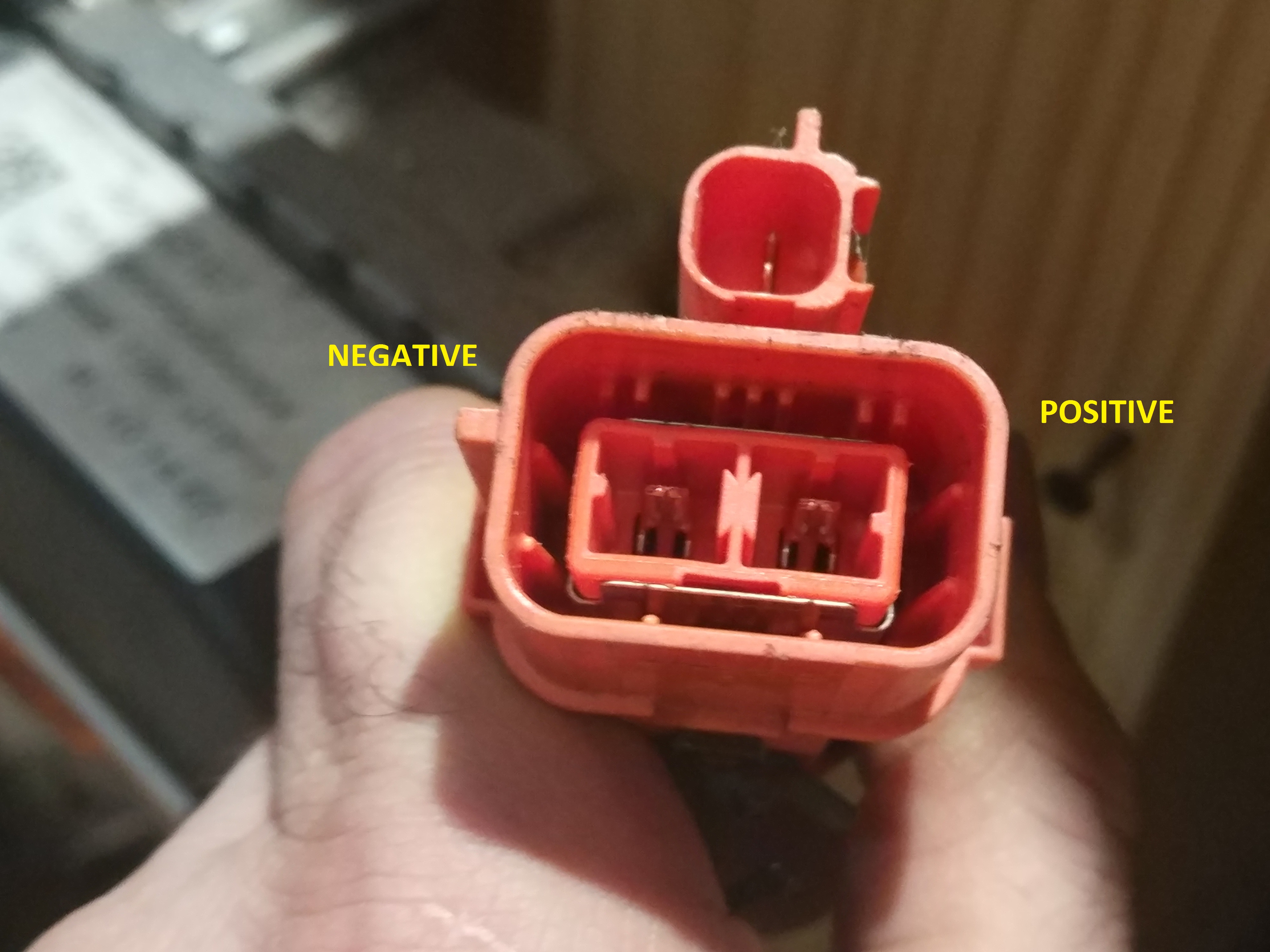

I am not sure. What kind of control is needed to run this at partial power? Is it 1kHz PWM or SW CAN?
damian.lo
Posts: 123
Location: Poland
Post by damian.lo »

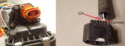

I have the same question with heater, because I already have it. What I know from manual in 2012 Leaf communication inside is PWM, but externally is going via LIN - what I think it's some serial communication, so I don't have idea what to do. Maybe someone else will help us.
It's Ebersprecher heater and I saw almost the same model but only with PWM inputs, so maybe is possible to go inside and connect directly to PWM?

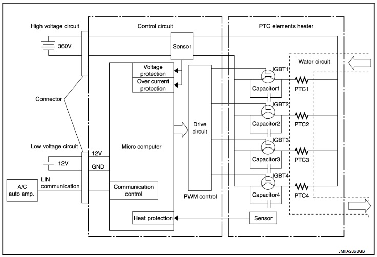

Found a bit of info at http://www.nissantechnicianinfo.mobi/ht ... ntrol.html
There is LIN bus comms from the A/C auto amplifier but it's PWM. It's not my area of expertise but, does this make any sense as to the control element and if this is a usable PTC?
The PTC heater provides an internal control circuit and performs LIN communication with A/C auto amplifier. Based on the signals from A/C auto amplifier, the microcomputer inside PTC heater controls the heater output by PWM. When current is applied, it heats up. Upon reaching a certain temperature (Curie temperature) the resistance suddenly increases, limiting the current, and maintaining a constant amount of heating.

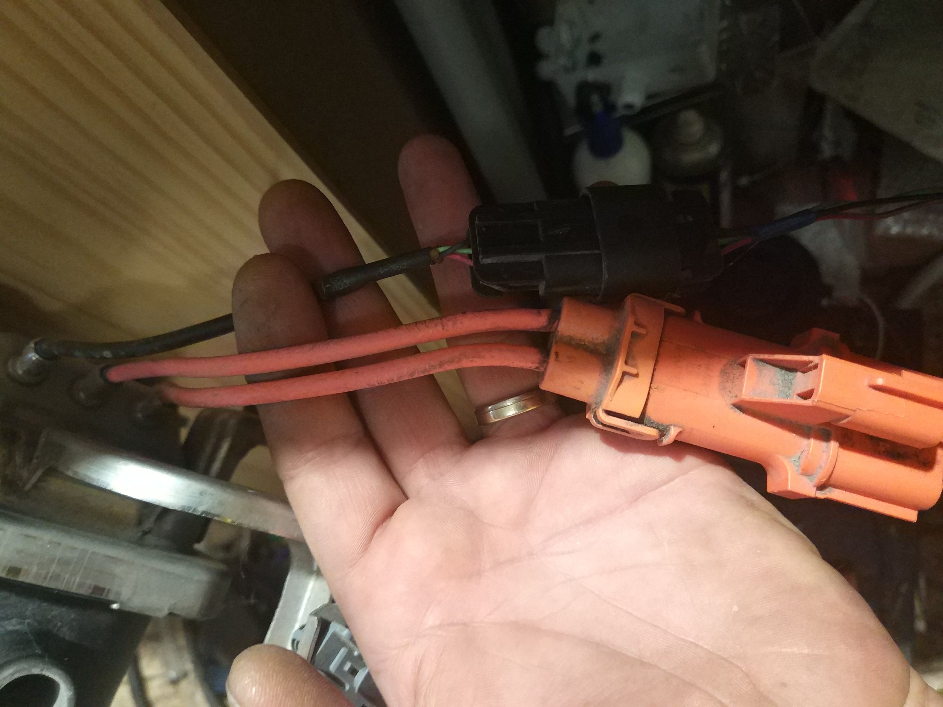

Pics of the 3 wire connector

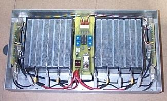

Heater solution in my Scirocco about 20 years ago...
Posts: 2963
Has thanked: 330 times
Been thanked: 848 times
SciroccoEV wrote: Mon Jan 06, 2020 10:14 pm Heater solution in my Scirocco about 20 years ago...
http://www.compton.vispa.com/scirocco/heater.htm
How did this last in the car? I would be slightly worried about vibrations ruining the ceramics, or have you found this not to be an issue?

tom91 wrote: Mon Jan 06, 2020 10:54 pm
Portable heaters often get dropped, kicked, damp, etc. Compared to that, this was the easy life, it's still working.
PTC cores are quite robust. Probably better than NiChrome.

@cookie6000 Please make it a standalone thread of figuring out how it works. But report here when you have a solution for running it.
I think you should provide 12v and GND to it and 12v pwm. Try 1khz 50% duty first. It's how I got all of Ampera pumps and fans working.

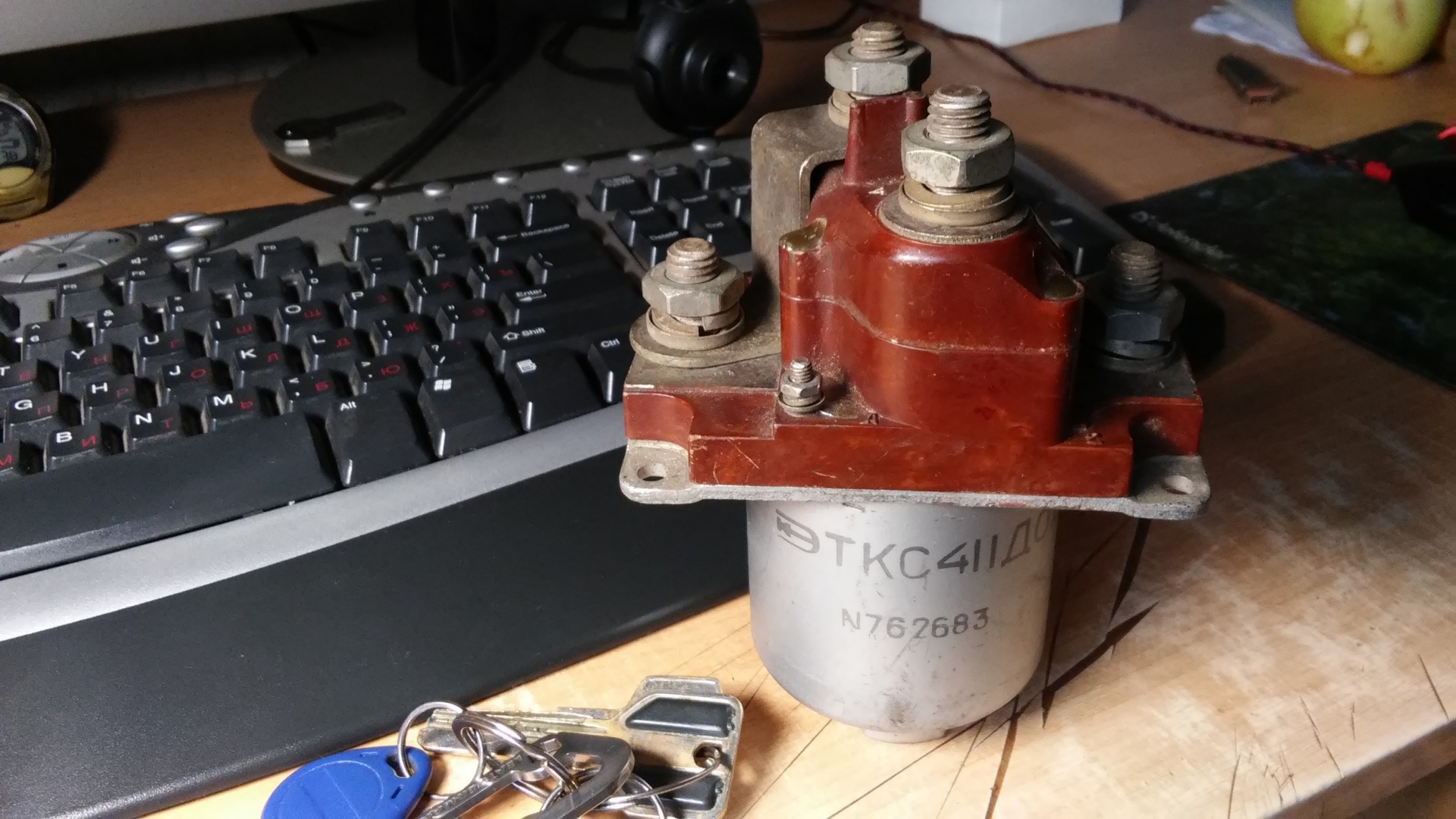

arber333 wrote: Thu Oct 31, 2019 12:41 pm I consider this each DIY preference.
Mine is Tyco Kilovac contactor EV200HAANA.
It is capable of braking 900Vdc at 500A! Inside it is nitrogen (inert gas) filled so arc doesnt form and contacts are silver coated.
https://www.ebay.co.uk/itm/Kilovac-Szon ... SwTghbyFH0
Prices vary wildly for the EV200HAANA on eBay from between the $40 ones from Isreal in the link above to the Mouser/Farnell items for €160 to a couple more on eBay for €300!. Is it just worth the peace of mind buying new from the suppliers or are they that robust, used ones are good for 380v from a Leaf pack?

Cookie6000 wrote: Thu Jan 30, 2020 4:26 pm
Well i have bought 3 EV200 from israel. They are used for military equipmment power supply etc...
Until now i hadnt had problems with them. No contacts sticking no misfires.
Well here is a strange thing. They dont like to be triggered by transistors. Probably because of economiser circuit. It just starts to chatter. I use ULN2003 transistors to trigger small relay first and then pass 12V through to EV200.

  hcan_cmd2.data.byte[4] = 0x00;
  hcan_cmd2.data.byte[5] = 0x51;
  hcan_cmd2.data.byte[6] = 0x46;
  hcan_cmd2.data.byte[7] = 0x60;
  // 0x10242040, True, 1, 00,00,00,00,00,00,00,00 - cmd3
  hcan_cmd3.length = 1;
  hcan_cmd3.id = HCAN_CMD3;
  hcan_cmd3.extended = 1;
  hcan_cmd3.rtr = 0;
  // 0x102740CB, True, 3, 2D,00,00,00,00,00,00,00 - cmd4
  hcan_cmd4.length = 3;
  hcan_cmd4.id = HCAN_CMD4;
  hcan_cmd4.extended = 1;
  hcan_cmd4.rtr = 0;
  hcan_cmd4.data.value = 0;
  hcan_cmd4.data.byte[0] = 0x2d;
  // 0x102740CB, True, 3, 19,00,00,00,00,00,00,00 - cmd5
  hcan_cmd5.length = 3;
  hcan_cmd5.id = HCAN_CMD5;
  hcan_cmd5.extended = 1;
  hcan_cmd5.rtr = 0;
  hcan_cmd5.data.value = 0;
  hcan_cmd5.data.byte[0] = 0x19;
  // 0x10720099, True, 5, 02,3E,00,00,00,00,00,00 - control
  hcan_control.length = 5;
  hcan_control.id = HCAN_CONTROL;
  hcan_control.extended = 1;
  hcan_control.rtr = 0;
void heater_cansend()
  // map requested power (percentage) to valid range of heater (0 - 0x85)
  hcan_control.data.byte[1] = map(constrain(heater_power_request, 0, MAX_POWER_WATT), 0, MAX_POWER_WATT, 0, 0x85);
  Can1.sendFrame(hcan_keepalive);
  Can1.sendFrame(hcan_cmd1);
  Can1.sendFrame(hcan_control);
  Can1.sendFrame(hcan_cmd2);
  Can1.sendFrame(hcan_cmd3);
  Can1.sendFrame(hcan_cmd4);
  Can1.sendFrame(hcan_cmd5);
void run_heater() //do this every 60ms
  heater_power_request = 0;
  if (heater_request)
    if (!heater_running)
      //Wake up all SW-CAN devices by switching the transceiver to HV mode and sending the command 0x100 and switching the HV mode off again.
      Serial.print("sending wake-up signal to heater");
      digitalWrite(pin_swcan_mode, 0); // set HV mode
      // 0x100, False, 0, 00,00,00,00,00,00,00,00
      hcan_wakeup.length = 0;
      hcan_wakeup.id = HCAN_WAKEUP;
      hcan_wakeup.extended = 0;
      hcan_wakeup.rtr = 0;
      Can1.sendFrame(hcan_wakeup);
      delay(5);
      digitalWrite(pin_swcan_mode, 1); // set normal mode
      heater_running = 1;
    else
      //Calculate the desired output power based on measured temperature.
      if (heater_request && heater_running && (temp_heater <= heater_setpoint) && 0 /*pump q is running*/) //0 to force me to make sure pump q is programmed
        // if below derating temperature, apply maximum power
        if (temp_heater < heater_derating_point)heater_power_request = heater_maxpower;
        // if between derating temp and target temp calculate derating of maximum power
        else heater_power_request = map(temp_heater, heater_setpoint, heater_derating_point, 0, heater_maxpower);
      heater_cansend();
  else
    heater_cansend();
    heater_running = 0;
The temp_heater variable is the heater temperature in C, using the thermistor inside the heater unit. I don't know the conversion for this thermistor.
The circuit used is below:
All untested.
The heater 3-pin connector is as below:
TAB
1 2 3
1 = GND
2 = SWCAN
3 = 12V
Again, untested.
I don't know which orange wire is + and which is -, this is a problem for me as I don't have a connector on the end of my wires, so can't look it up!
If someone is able to tell me which wire is which, that would be great. Mine do not have red/black bands on them.

Posts: 3796
Re: Nissan Leaf Powered E46 Touring
xp677 wrote: Sat Feb 01, 2020 12:14 pm I don't know which orange wire is + and which is -, this is a problem for me as I don't have a connector on the end of my wires, so can't look it up!
If the power section is anything like the Leaf heater linked above, then polarity will matter.
I can help you with that. I managed to heat up the heater more by accident and i suspect i damaged it because it didnt had any coolant inside.
But i did managed to get the polarity by using wires and connectors from chrashed Ampera car. I checked against Ampera inverter and confirmed:
1. The contact on the connector side with the extrusion is NEGATIVE battery.
2. The contact on the flat side of the connector is the POSITIVE battery.
It is the same orientation on Ampera AC compressor and of course the same connector.
I hope it helped you, thank you for the code. What do you use for controller?
EDIT: Crap! I just saw you do not have a connector on the heater. That sucks.
Well i took off the orange wrapping from the cable and the orange cable closest to the black control cable is POSITIVE!
xp677
Posts: 442
Location: UK
Been thanked: 15 times
Post by xp677 »
That's great, thank you for doing that, especially because you had to cut the orange sleeving. :)
My heater did come with a connector, but it was broken quite badly, only the back part was left, so I cut it off. I didn't think to check the polarity first!
For the controller I am using an Arduino Due, with the schematic in my post above. The schematic just needs CAN Rx and Tx (if you don't have a board with CAN, the MCP2515 should work fine), and a single digital input to set the transmission mode (I'm not exactly sure what this does, looking at the code, it seems to be related to waking up the SWCAN devices.

konstantin8818
Posts: 290
Location: Minsk, Belarus
Been thanked: 10 times
Post by konstantin8818 »
Might be usefull for those who live in ex-Soviet Union or ex-Warsaw Treaty countries. Contactor from Mi-8 helicopter: ТКС411ДОД. They are being sold used or new. I believe they sold new ones to any country nowadays.
This one is rated for continuos 400A current. Operated by 12-27 Volts. Massive, yet pretty inexpensive and reliable piece. All-weather type. This particular model also is switching "on-off/off-on". So my BMS unit on start up checks if battery is ready to use and switches contactor to "drive" connecting battery to inverter. Othervise it is already on "charge" and battery is connected to charger.
SciroccoEV
Posts: 370
Location: Luton UK
Been thanked: 16 times
Post by SciroccoEV »
Those contactors are only rated for 27v on the switching contacts. Most likely they'd be OK up to 48v nominal, but I wouldn't use them in a high voltage system.
konstantin8818
Posts: 290
SciroccoEV wrote: Thu Feb 06, 2020 6:19 pm Those contactors are only rated for 27v on the switching contacts. Most likely they'd be OK up to 48v nominal, but I wouldn't use them in a high voltage system.
Well, the only bad side is they won't prevent electric arc at higher voltage when disconnect, but it need some malfunction to happen in invertor while under load.
I'm using it under 96 volts. And I must say Curtis controller is really clever made to operate high voltage circuit proprly.
Three years ago in my coutry any high voltage high current contactor would cost around 100-200 dollars, and this one was 30 or something like that. As time passes EV components become more spreaded and cheap so this is not a problem anymore.
