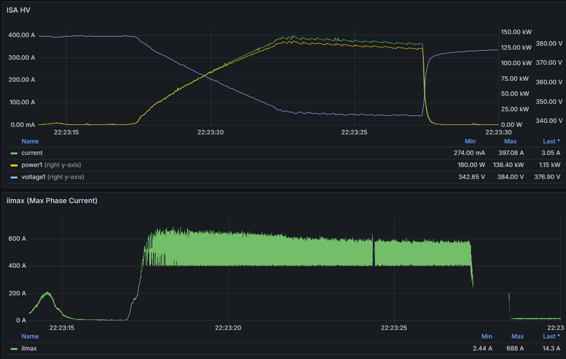

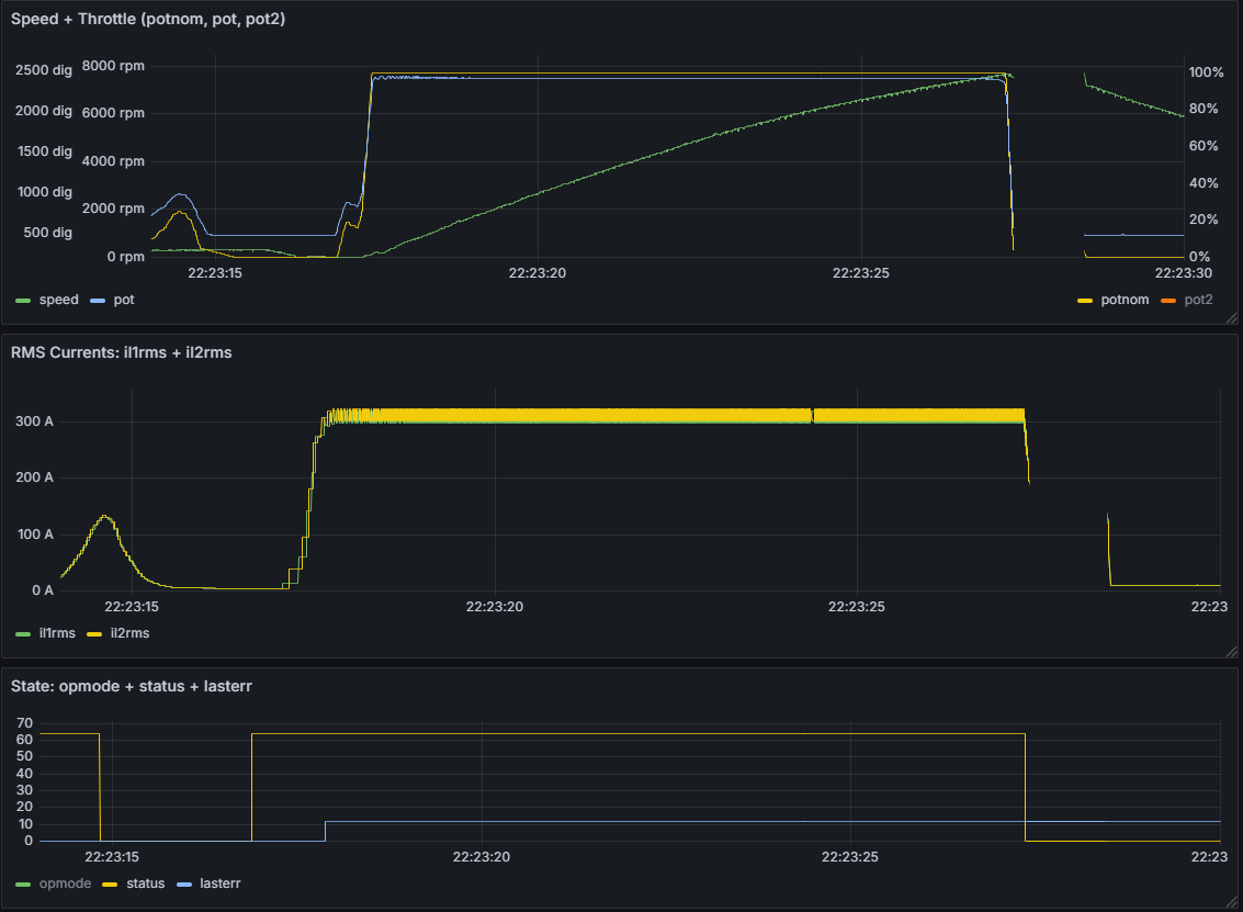

Have been driving car for some time now and made almost 5k km so far. Monthly average is around numbers planned initialy for this conversion - 500-700 km monthly.
Mechanics is still great and I did wheel aligment also.
For more than a week I'm driving with parameters set that pulls 130kW+ from battery. Siemens and Prius inverter are doing great job, gearbox and coupler also.
Around city I mostly drive in 2nd gear (rarely over 90 km/h) and on open road it's 3rd gear up to 150 km/h.
Full throttle in 1st gear just spins rear wheels, 2nd gear is aggresive enough to keep DSC busy, and 3rd gear provides enough power not to be sluggish in junctions and pull up quickly.
If road is good enough, WOT from standstill doesn't spin wheels in 2nd gear and goes over 100 km/h until rpm limit.
So, I measured times to 100 km/h while tuning parameters.
Best time - from charts - is <9 sec at pack 385 V. I consider this very good number since original car was around 9s.
Here is a parameters json that has half a second lower time
params_20260422.json
(2.91 KiB) Downloaded 4 times
For best time I've setup fslipmax to 2.9 and fslipconstmax to 5.8. However, that combination trips inverter in some cases on low rpm. Will share that in other topic.
