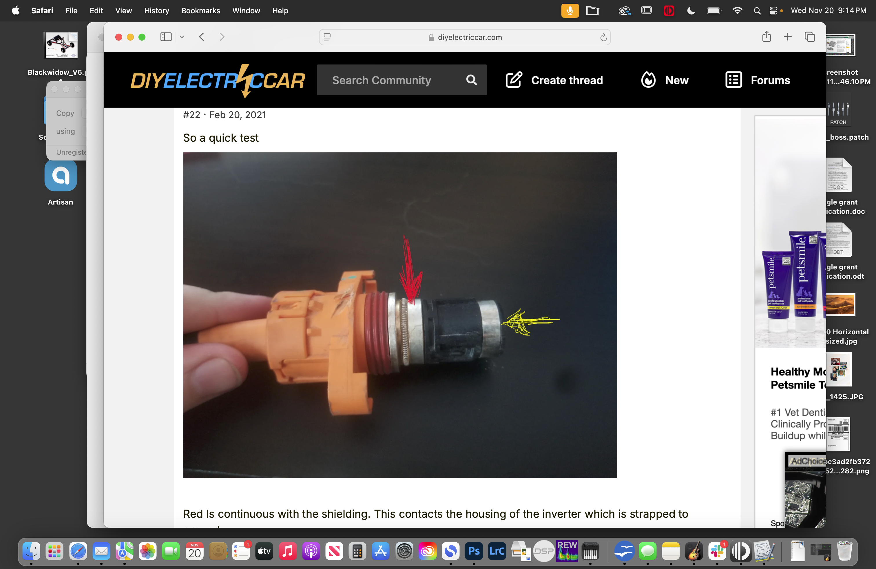

I got up a little bit of nerve and went out to do some testing. The negative plug seems to be fused into the inverter, but the positive I can remove. When testing for continuity, I get it when testing the negative plug against the motor housing, but I don't get it when testing the negative inverter cable with the very center prong inside positive (positive unplugged). I do however get continuity at the end of the positive cable with negative cable both plugged in. Not sure if this makes any difference but not sure whey I wouldn't get it with that very center prong on the inverter.
Edit: Now that I understand the below, it makes more sense. Maybe there isn't continuity at the inverter cables after all. More testing tomorrow to confirm.

catphish wrote: Fri Nov 15, 2024 8:29 pm
Another possibility is that you accidentally crimped the shield of the high voltage cables. The shield of both cables in the SDU is connected to the chassis ground, so if you crimp them into the HV, things will explode, but I guess you'd have noticed this during the low voltage test.
johu wrote: Mon Nov 18, 2024 7:42 am It's not a setting, it's how you hook it up or crimp it
Ok, pretty sure this was a problem. I didn't realize this was the case at the inverter connections as part of the OEM wiring harness. I guess I just thought the shielding was a physical barrier to protect the cable at whatever polarity the cable was. I'm pretty sure I crimped the shielding :0 Learning new things along the line at every step. I didn't notice in the low voltage test because I was using the factory connections and hadn't done any crimping myself to that harness.

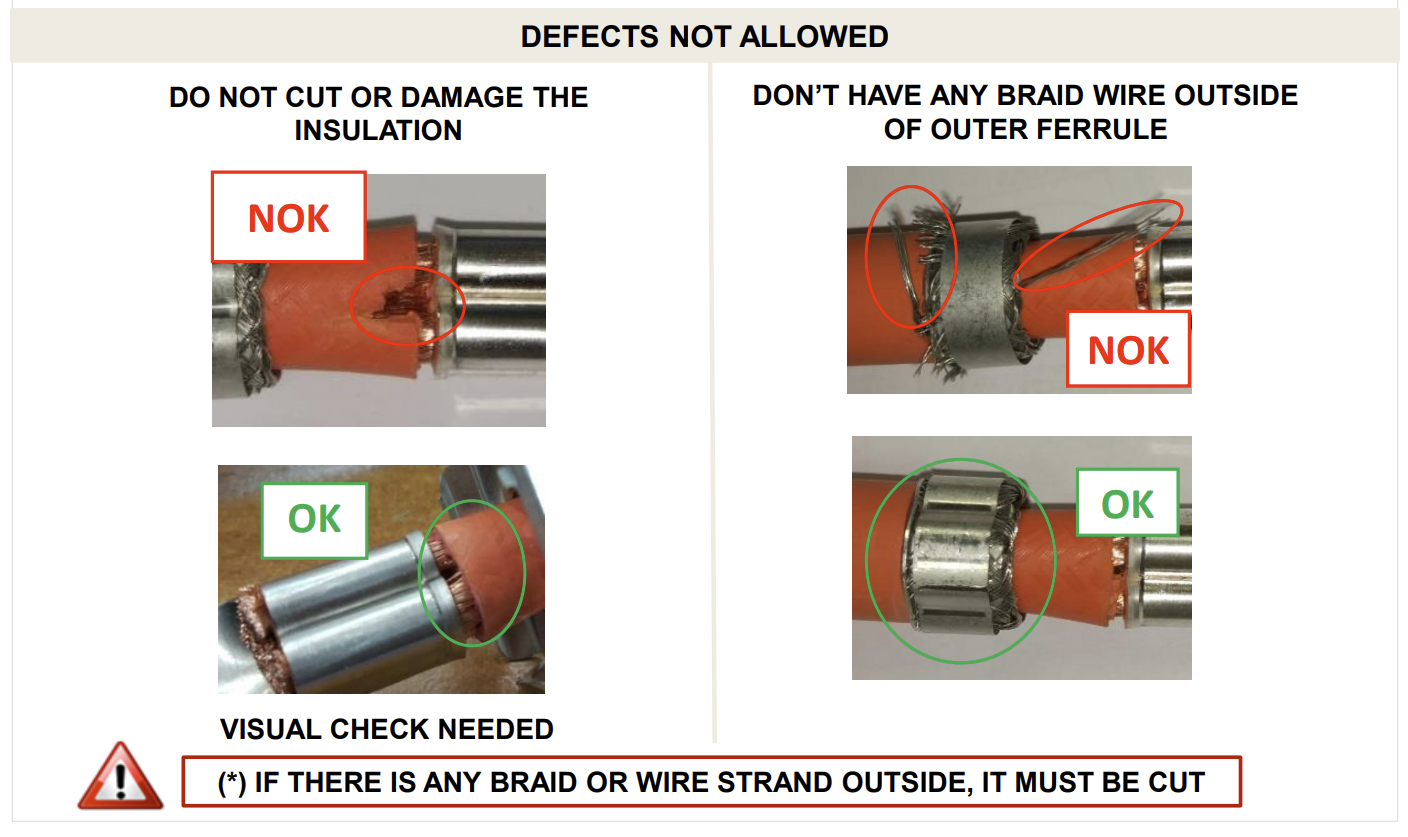

Just to get an idea on how detailed process crimping a shielded HV cable is, you can check this Aptiv RCS800 assembly instriction just as a reference.
This snip is from the document, you need to be also careful that you don't cut the insulation in a wrong place.
Yes it may seem fine, but with HV you can't really go with gut feeling. A slit in insulation means that the angry pixies can get out there and then it's no fun trying to find out where's a problem after a while (because it may not cause an issue right away and the problems can occur intermittent)
Also check that you have enough creepage distance between the shield and the end of the middle insulator. Usually these are specified in such assembly instructions which not all manufacturers have openly available.
Pages 25-33 have good pictures of steps and pics of defects not allowed on page 32 are something that can be used more generally as rules on what's good and whats not.
