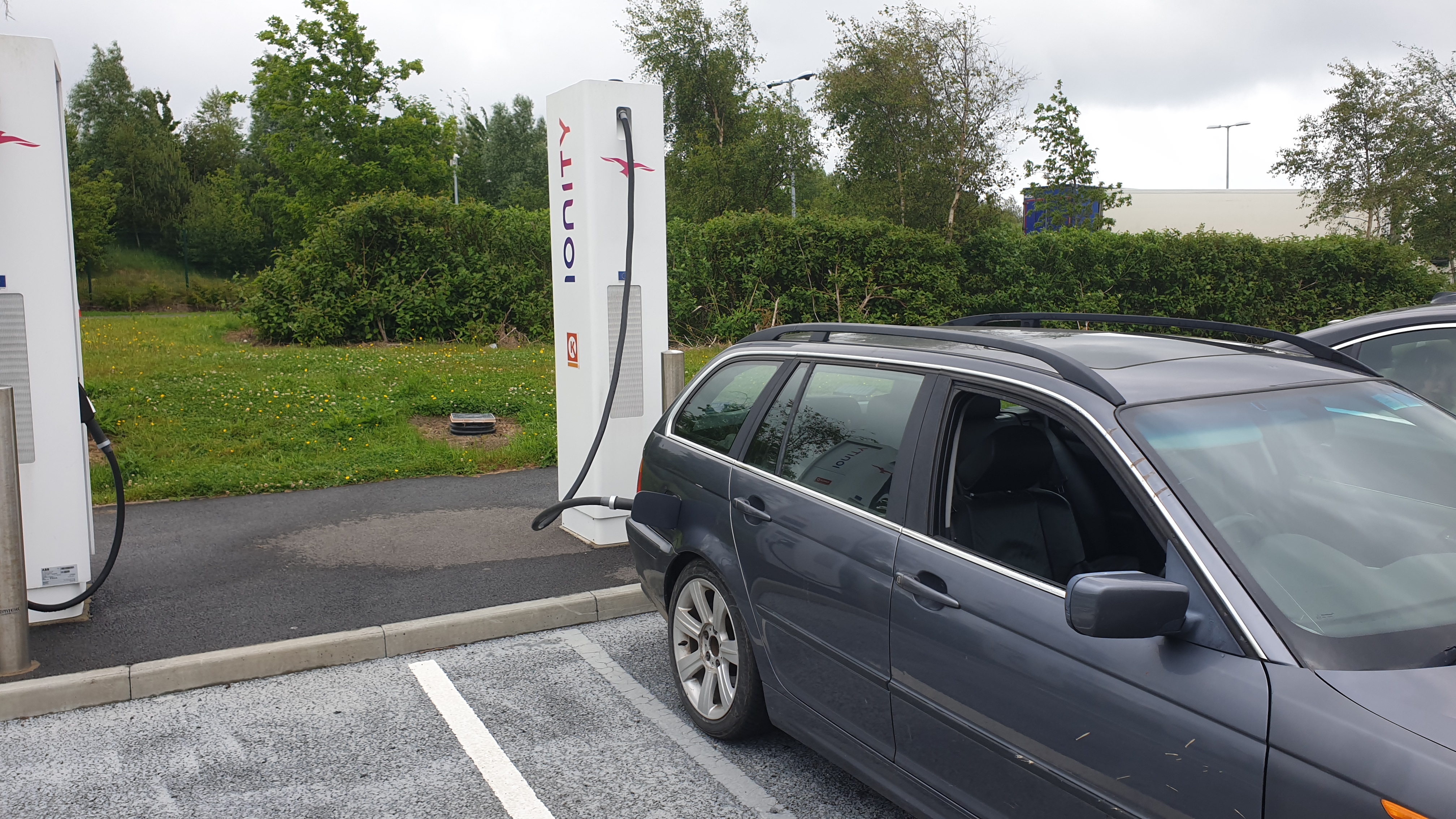

Few pics from yesterday

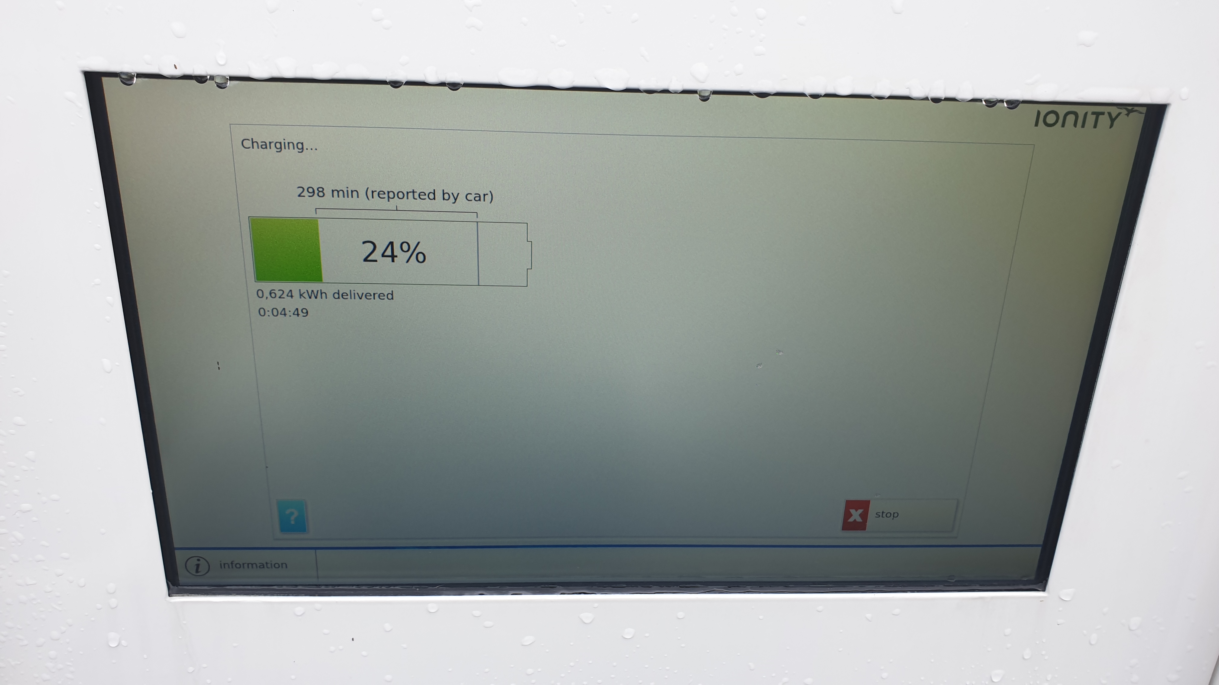

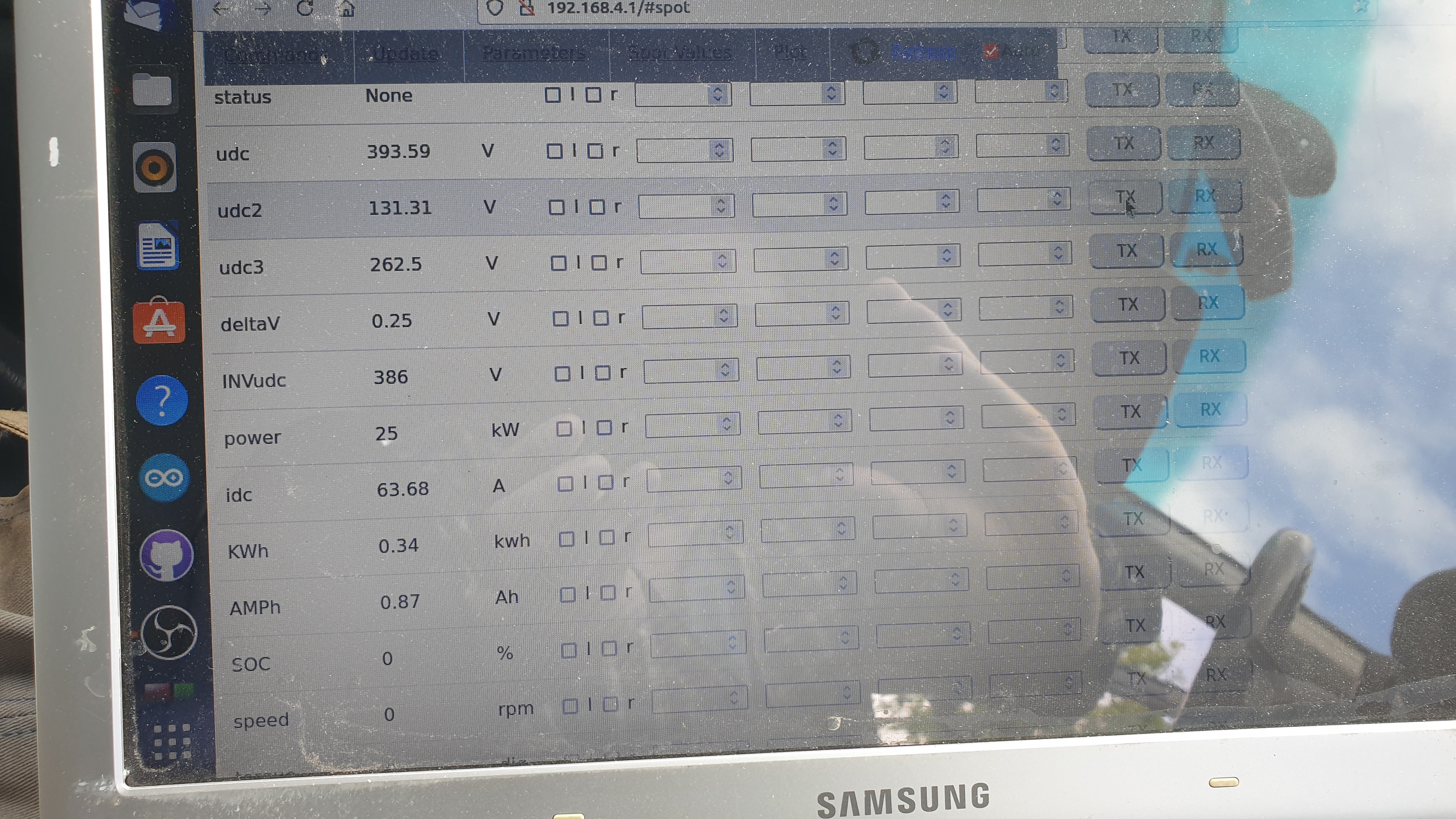

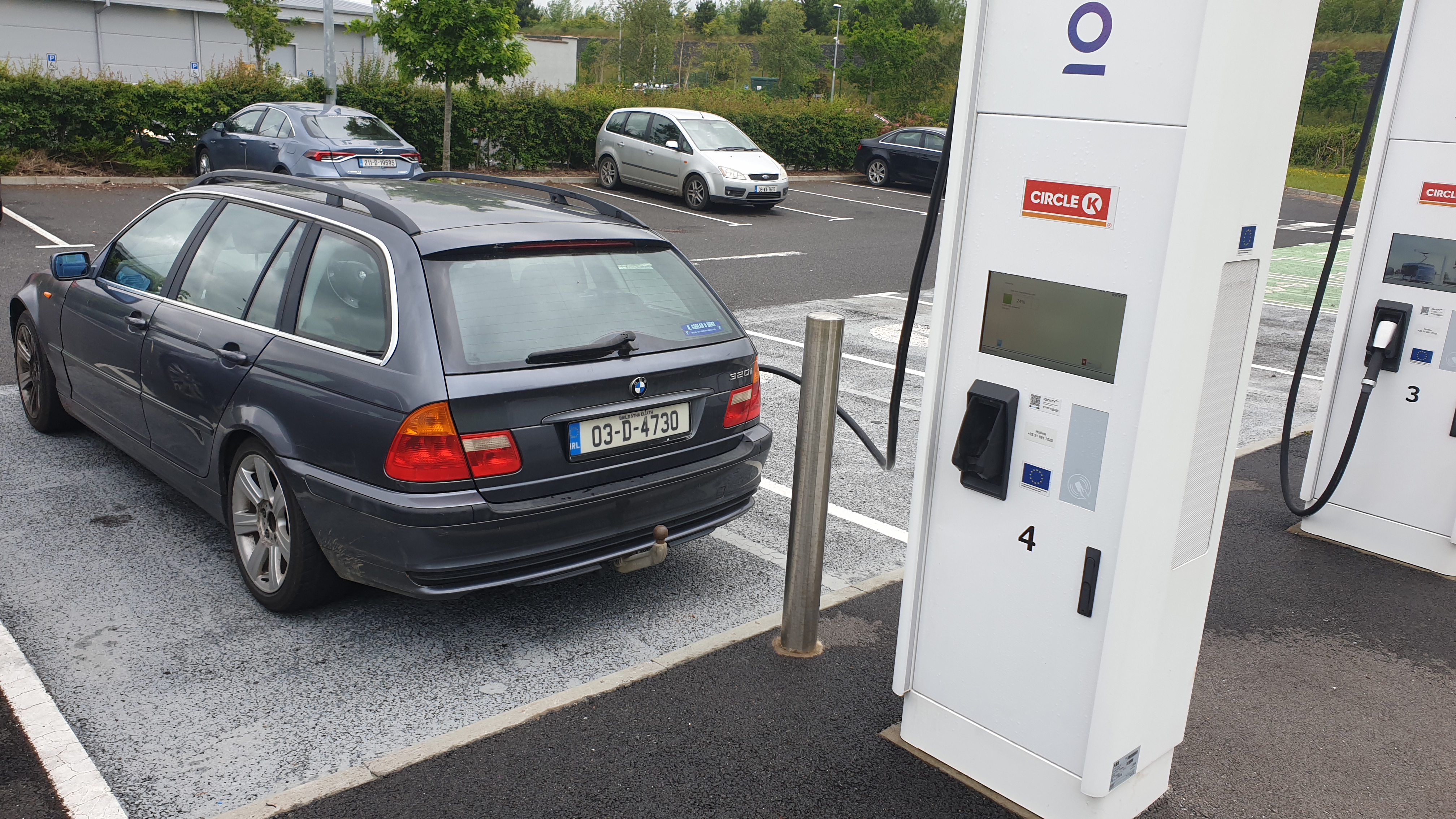

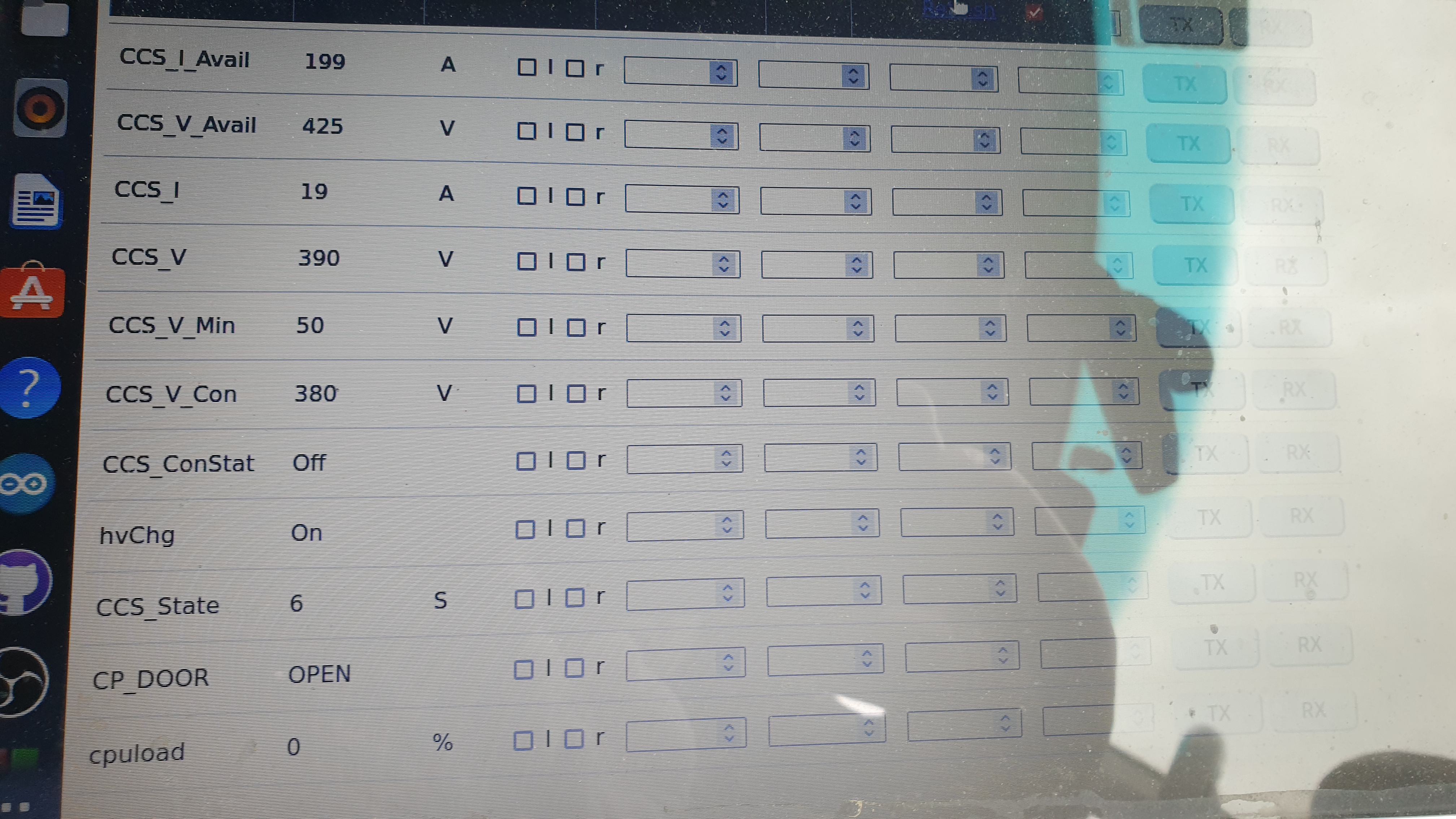

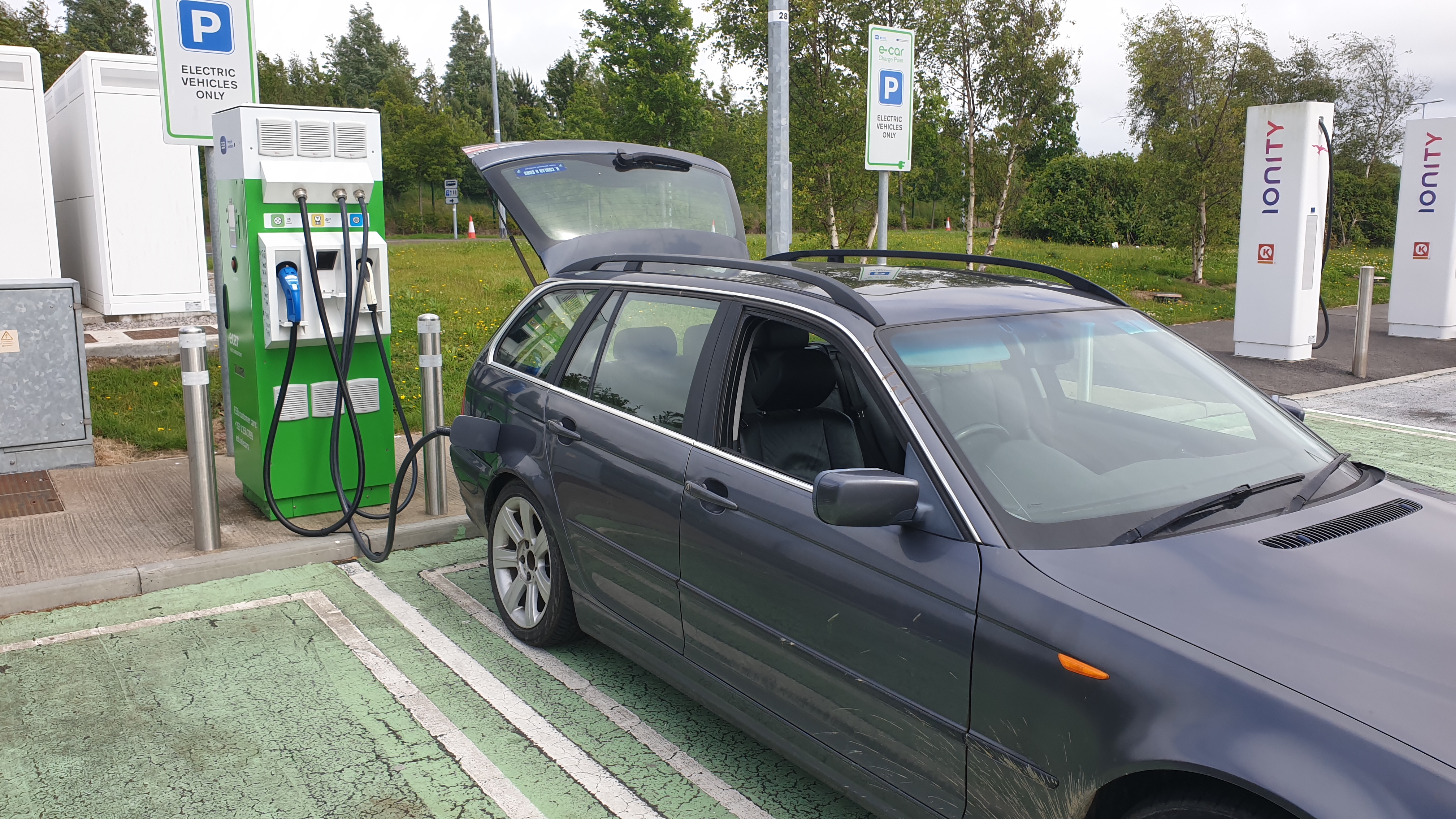

Today went for a bit more power. 25kw. Had to use the less powerful power company charge point today as my stupid bank insist on this text verification nonsense when ionity do a pre authorisation of 1 euro for every session start. This drives the app loopy and the charge point won't authorise.
Did a few tests :
1)Shutdown session, drive car, new session. No problems
2)Shutdown session, start new session. no problems.
3)LIM weld detects when cp door closed and ign on but happy to restart a session if not done.
4)My stupid cc/cv software actually sort of works.
Did a few tests :
