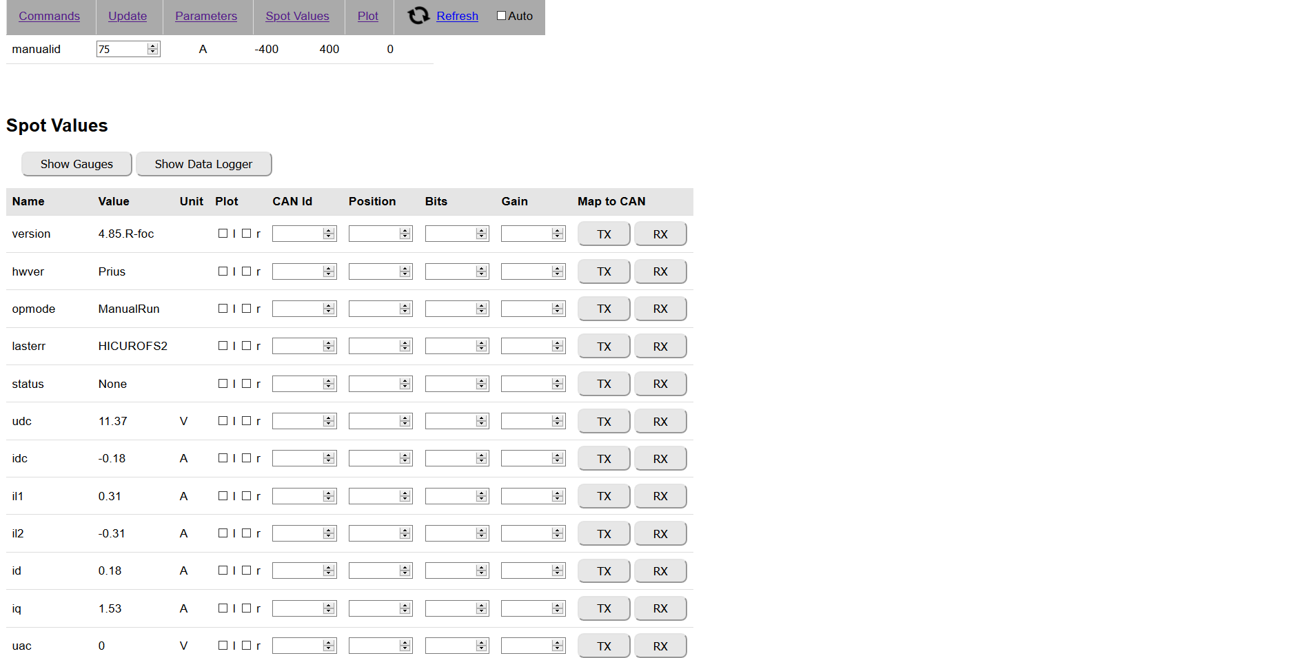

I reverted to FOC 4.85.R for testing, no uac and no change, am not getting any output and no errors. If there were some errors, I would be inclined to tear the inverter apart, being there are none, I will try and simplify the wiring and re-try.

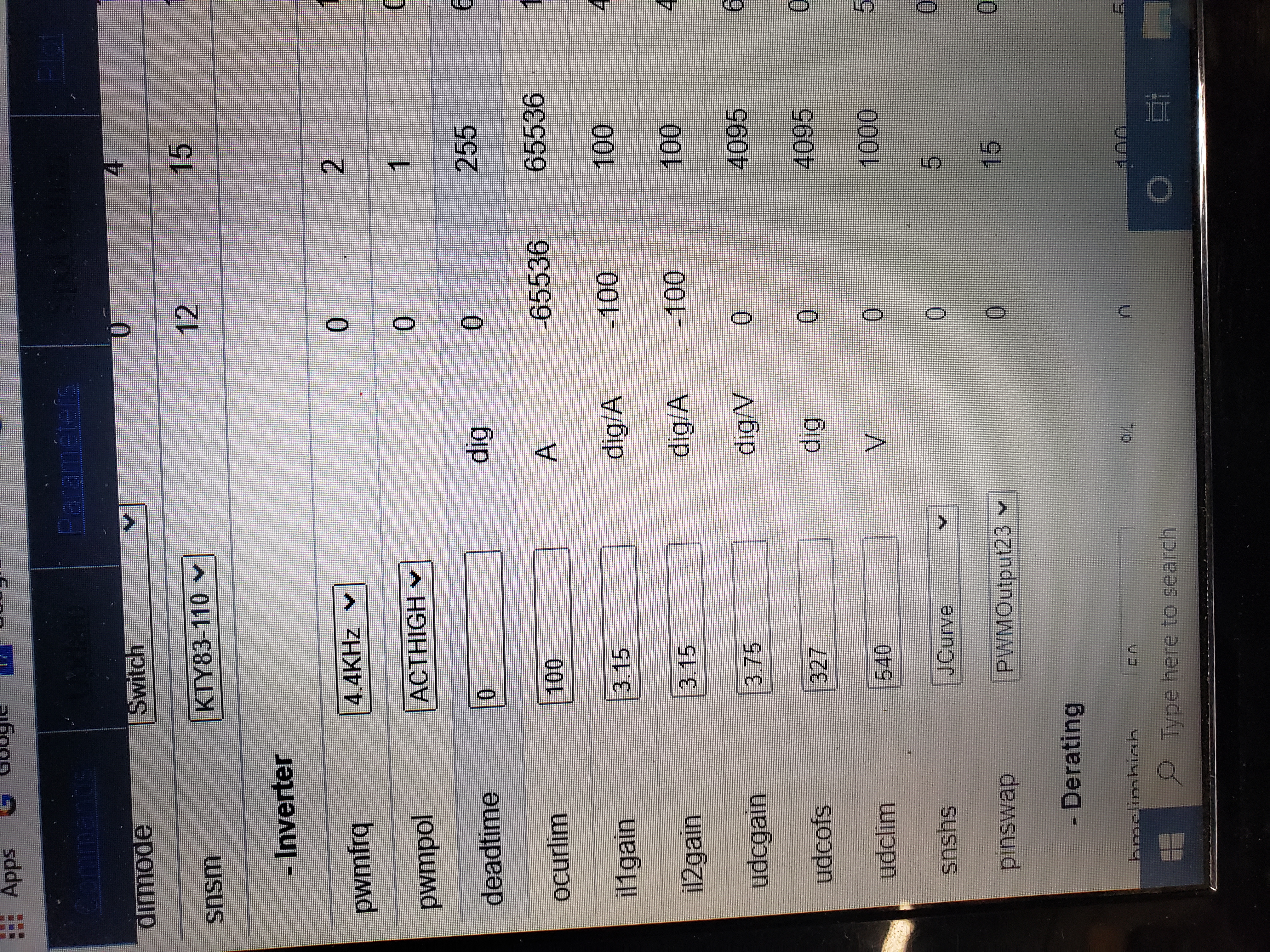

so... we seem to have 3 choices for pwmfrg on the webinterface drop down menu. does this mean that selection 2 is the one?Toyota Prius Gen2 Inverter
Only inverter parameters
"pwmfrq": 2,
"pwmpol": 0,
"deadtime": 0,
"ocurlim": 100,
"minpulse": 1000,
"il1gain": 3.18,
"il2gain": 3.18,
"udcgain": 3.78,
"udcofs": 327,
"udclim": 540,
"snshs": 0

Yes, 4.4kHz.
You can see the translation from numbers to string here or by typing the "list" command in custom command

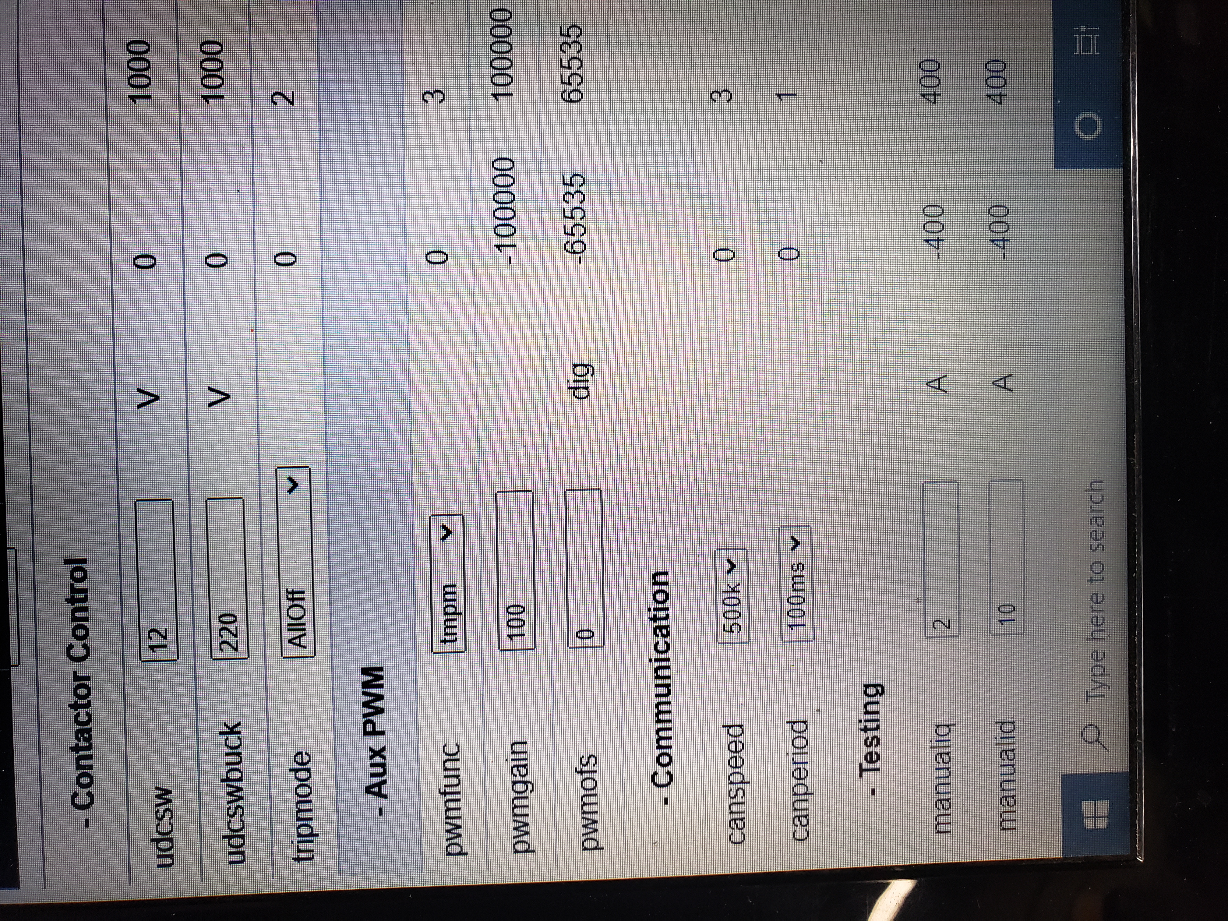

is there a link for the revised motor parameters with the version 4.85foc or is there anyone who has it working with a gen 2 prius transmission ( either mg1 or mg2)?
my resolver seems to show the best waveform when plotting angle on the web interface when I select 2 pole pars.
but my motor just jumps and hangs.
it seemed to get worse with the inverter parameters listed a few posts earlier but I left them as they are published by johu
I have tried different current and swapping phases in software.
am using 220 vdc

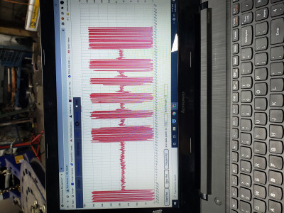

You need to be systematic about pole pairs, otherwise you are left with too many variables. Set both polepairs and respolepairs=1 and try to do a full motor revolution while plotting angle. How many times does angle go from 0 to 360?

okay set pole pairs to 1 and it appears to me that there are 6 zero crossings.see the photo
does that mean.....what?

That would mean 6 pole pairs for both polepairs and respolepairs
And that would mean 4. Now what

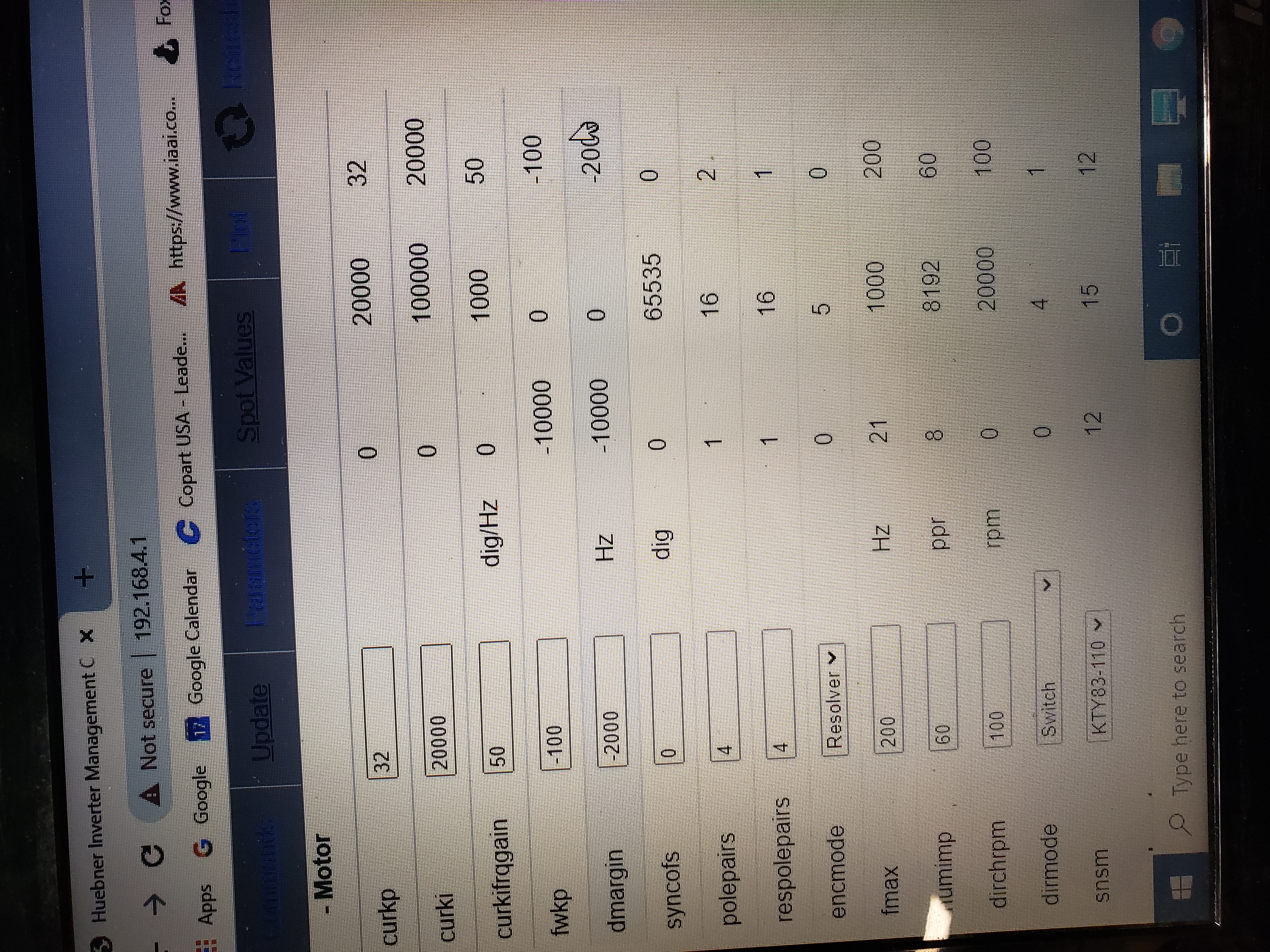

I tried 4 and 6 , motor does try to spin, does hum, and does not jump off the table.
im using under 10 and usually under 3 for the manualID.
guess i can try 8...

I notice that my angle plot is a modulated sine with 6 zero crossings in one revolution, but in Damiens youtube video at time 17:23 his is a nice sawtooth.
most information including the oak ridge report linked above and the youtube comments seem to agree there are 4 pole pairs for the prius mg2.
but I believe I saw damiens pole pairs was set to 2 and resolver set to 1 at time 21:37

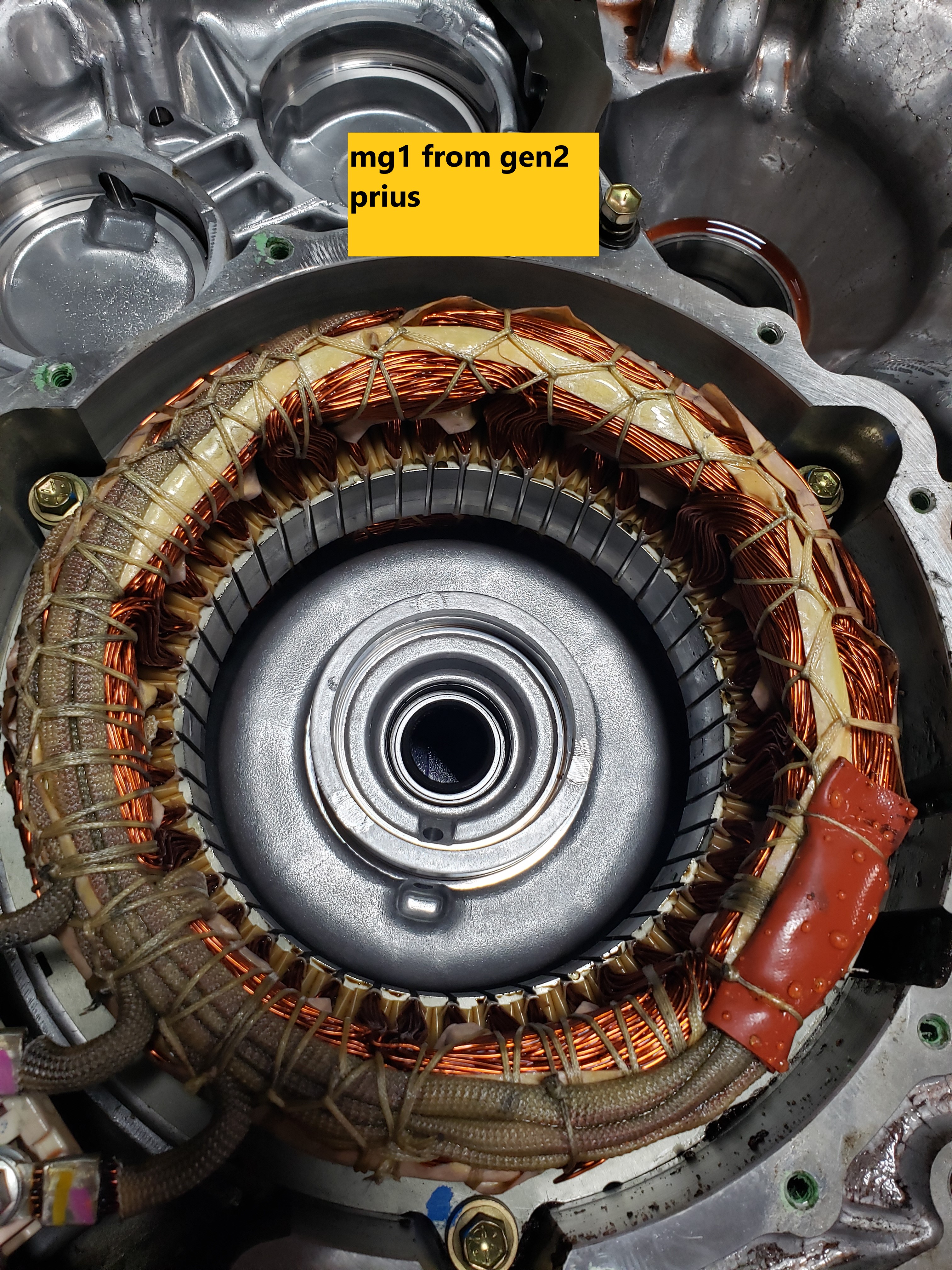

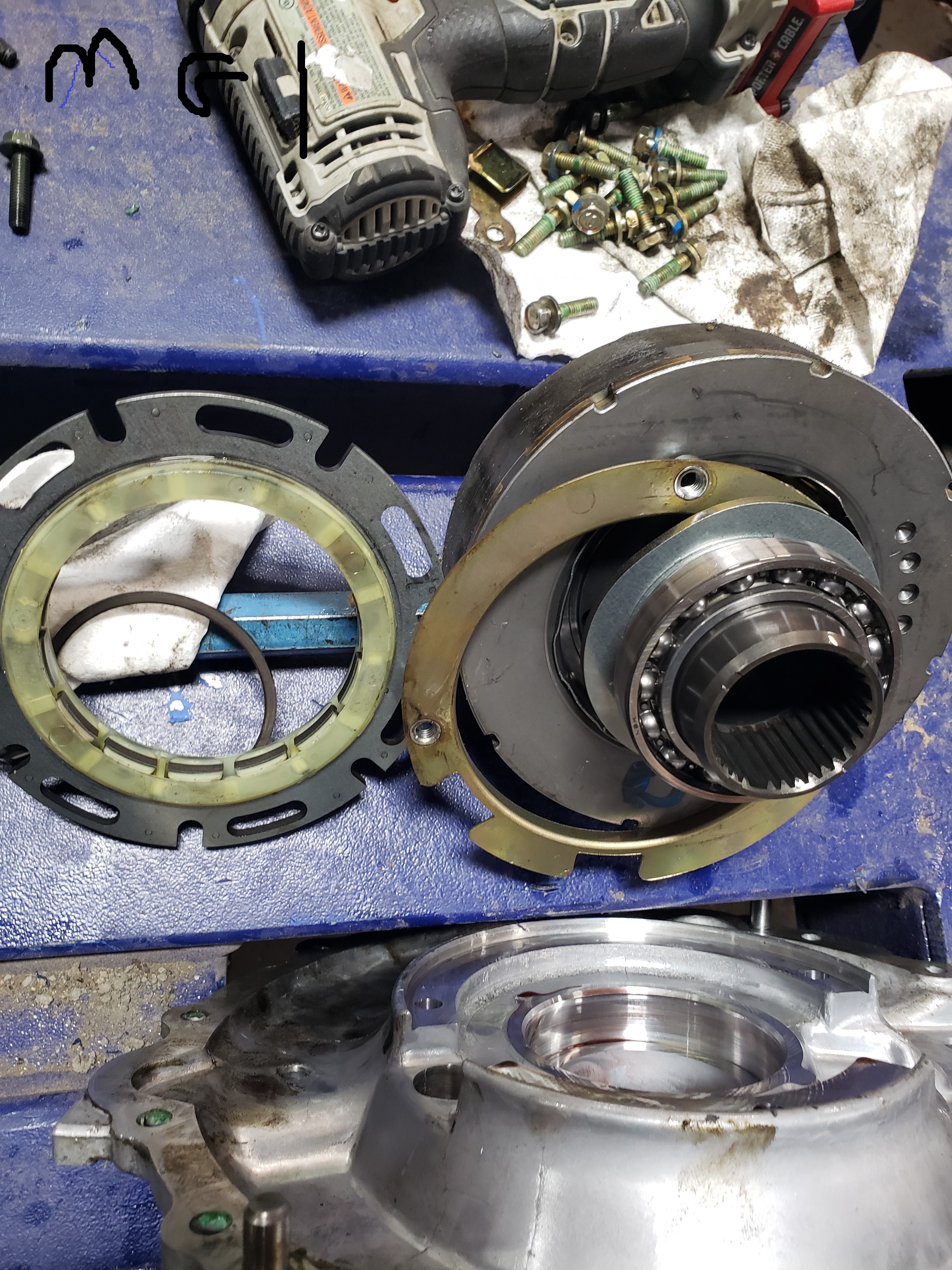

these photos show that mg1 and mg2 resolvers are the same. I have just taken apart a gen2 transmission.
and you can also see there are 48 sections to the motor and 14 sections ( slots) to the resolver.
im wondering how 6 goes into 14....but both are divisible by 2 ( his pole pair setting.)

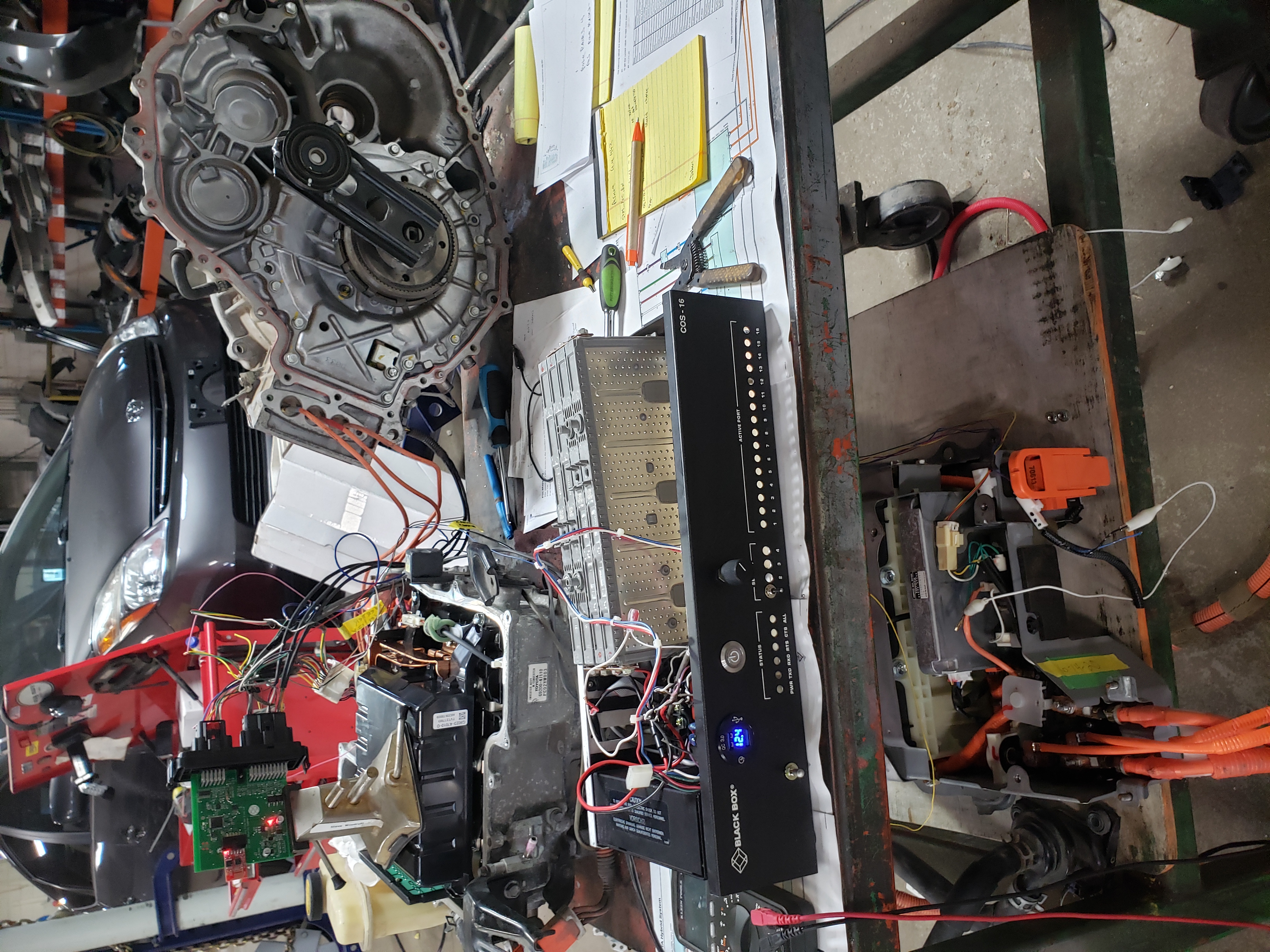

Is there any way to validate PWM output from the VCU using typical tools like resistors, LED, lamps, multi-meters, etc? After my melting insulation event, my motor has not turned or even tried. While I see and smell no evidence of damage to any component of the inverter or VCU, there is no measurable output on the 3ph wires as I had before.
Need to figure out which side is not working, or both. With the inverter and VCU connected as designed; a LED connected between 12v and MVU thru a resistor results in it being on, but dimly with no change in brightness regardless of VCU settings.

If anyone has nothing better to do than play with their new boards, I'm trying to narrow down what I fried. Since Johannes is on holiday, I am hoping to localise the problem and repair it myself....
I have PWR led on permanently and was hoping to test 'though hole points' in the first instance. Maybe it would narrow down my fault....
The 2 through holes next to 'stm' led have 0volts when powered up.
I have 0,3v on led point closest to R32 and zero the other side.
I really hope I haven't damaged STM
