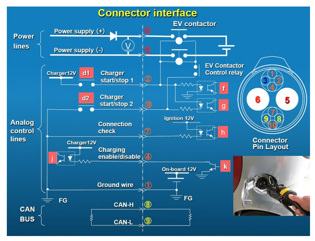

Tnx yes it seems i misread the schematic as ot is from the back of the connector. I will reset cables AGAIN.
Well i still have to try what it is that vcu wont start can bus.

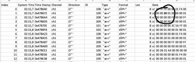

You should see 108 and 109 show up about 2 seconds or less after start1/D1 is set. It varies a bit between manufacturers but in general if you don’t see 108/109 after a few seconds, you have your CAN wires swapped or otherwise messed up.

Pretty sure can lines are the right way round. Been chatting to damien on his discord, looks like I need 12v on proximity. Will try tomorrow and report back

Still no EVSE side can messages received. I've double checked my can H and L orientation, as I'm looking at the socket on the car, I have CAN H as the left most pin in the lower group for 4 and CAN L as the right most pin in the lower group of 4. If I connect a can device directly to the socket on these pins, my controller receives the messages.

Why you need 12V on proximity? It is designed to activate off GND signal. Do you mean a pullup resistor? You can draw 12V off a supply pin inside VCU.
EDIT: i consider Pin 7 proximity detect. I use it to power up my VCU and ISA as well. 10K pullup shouldnt hurt there i think.

The charger side grounds the proximity, damien uses it via a relay to power up the controller, so wondered if I needed 12v on there. My can logging gets my messages but not the chargers can messages. If I replay the charger messages feom someone's recording into my socket, with the 12v on pin 2, then ground 10, my controller thinks its charging and closes contactor. I'd think I've got can high and low mixed up, bit checked multiple times with multiple sources.

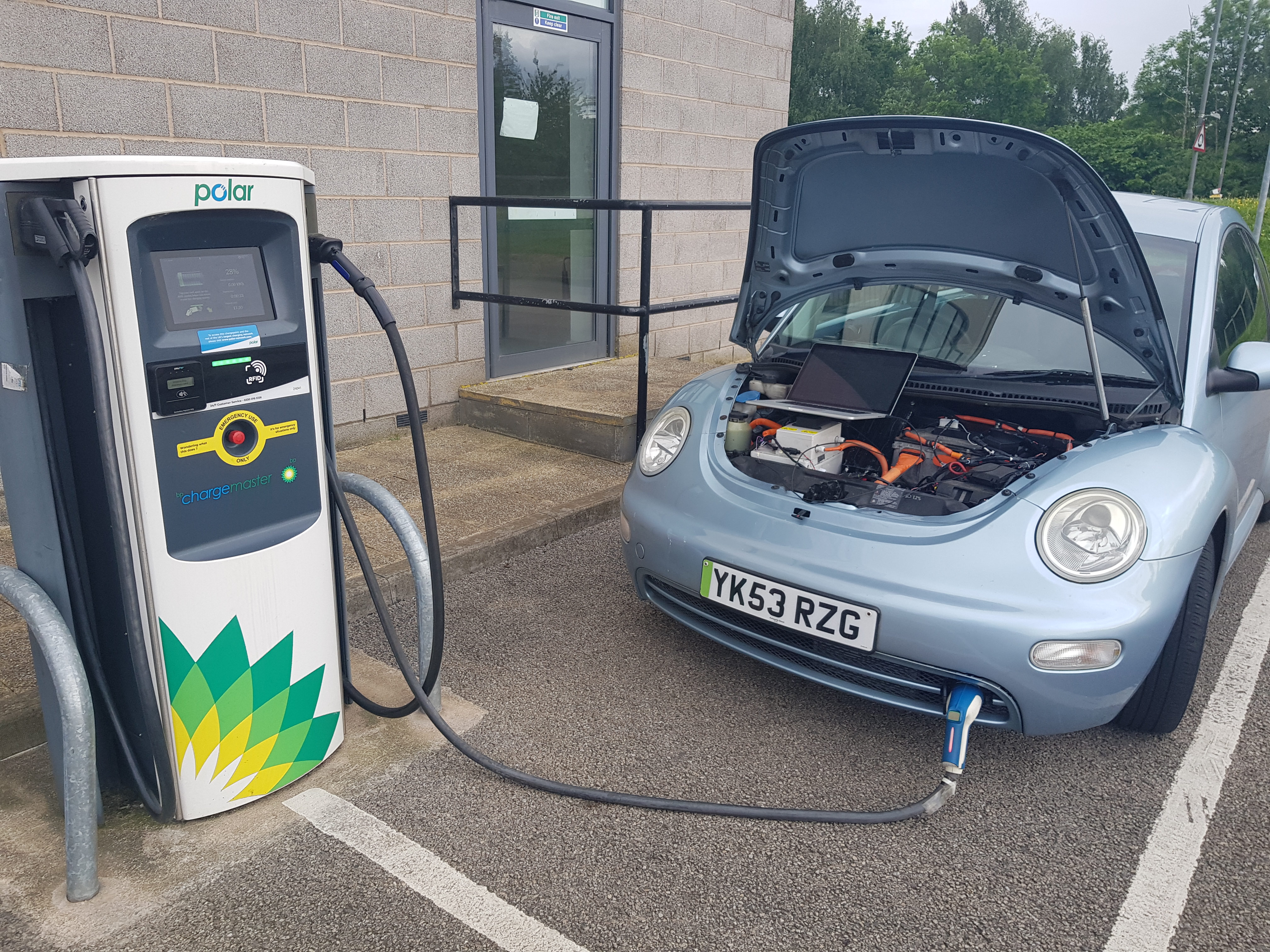

Success. Changed the code to set the extended flag to false and away it went. The most expensive half a kwh I've ever purchased.

like it BigPie. you got chademo working just in time for the massive price hikes. Still nice to have less charger anxiety out in the wild. Personally id blot out your reg since there are some nobs cloning ev plates in london of late if you watch johnathan porterfield's channel.

I just added outFrame.extended = false; I originally forked your repo, I'd have done a PR but my editor changed a load of line endings so it's not showing just this one change.

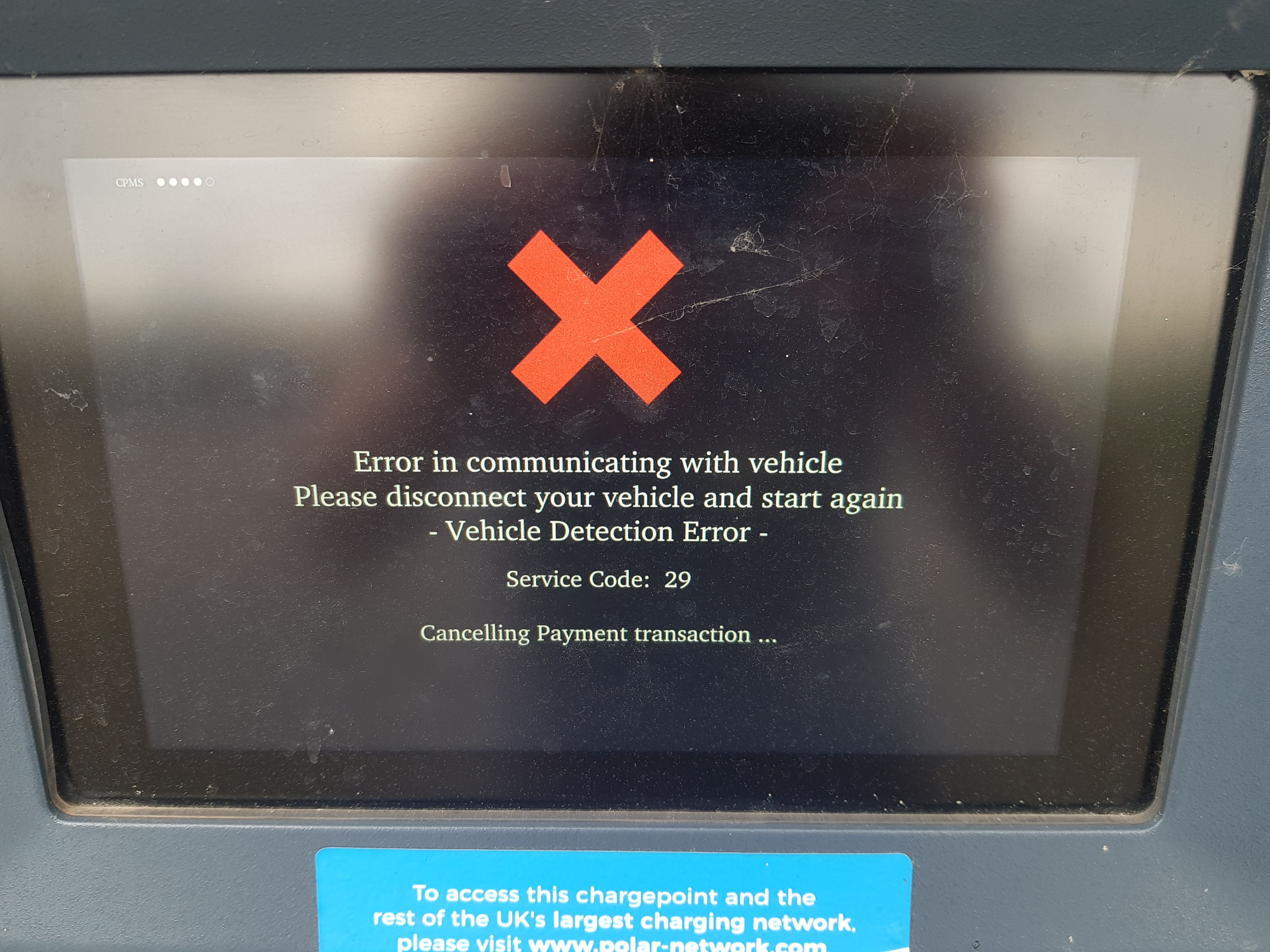

Again i got error in communication.
And also now i couldnt hear contactors click in, though i did hear the small contact relay.
I will need to test this with EVSE simulation.

OK my CAN log is attached...

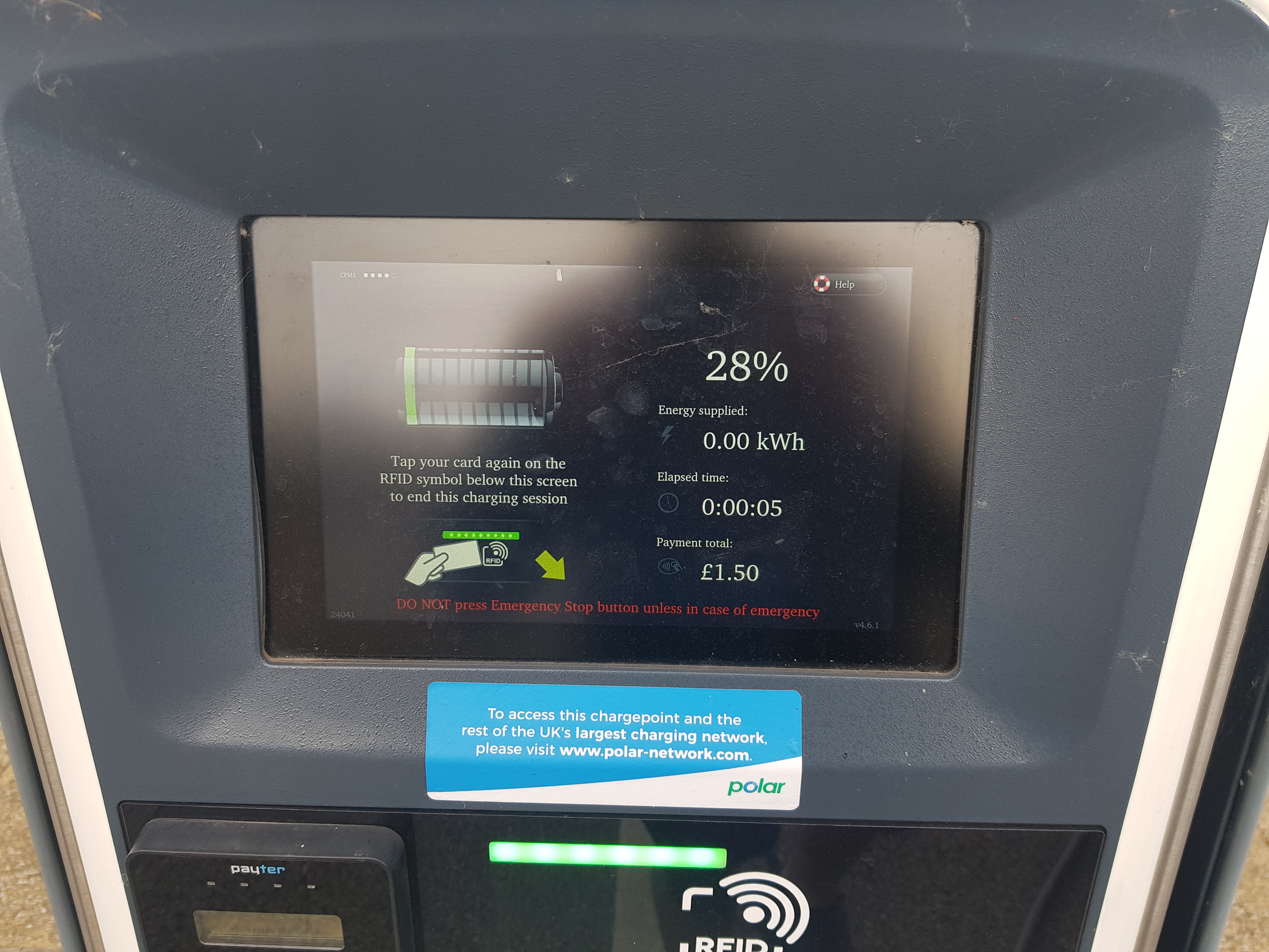

I finally managed to get the EVSE charging.
1. Of course i needed to add simple ID flag
2. I managed to solder 1K 12V pullup to wrong VCU pin
Of course now that i corrected both mistakes EVSE pulls contactors in and starts to charge, YAY!

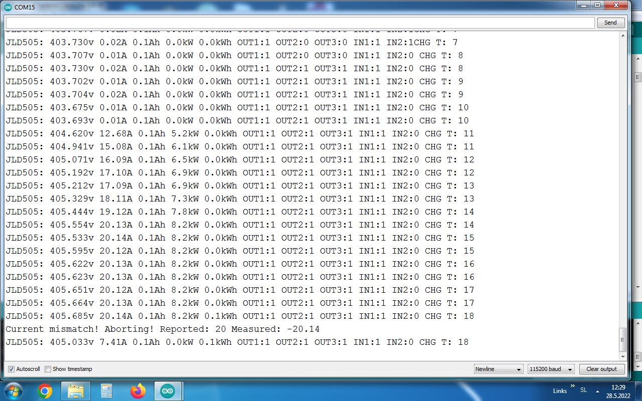

NO... after 24A ramp EVSE throws a flag. It says current request mismatch. When i connected to USB i got 20A provided for -20A VCU request.
I tried to charge several times and later i tried to set reverse current inside the code, but i dont know how...

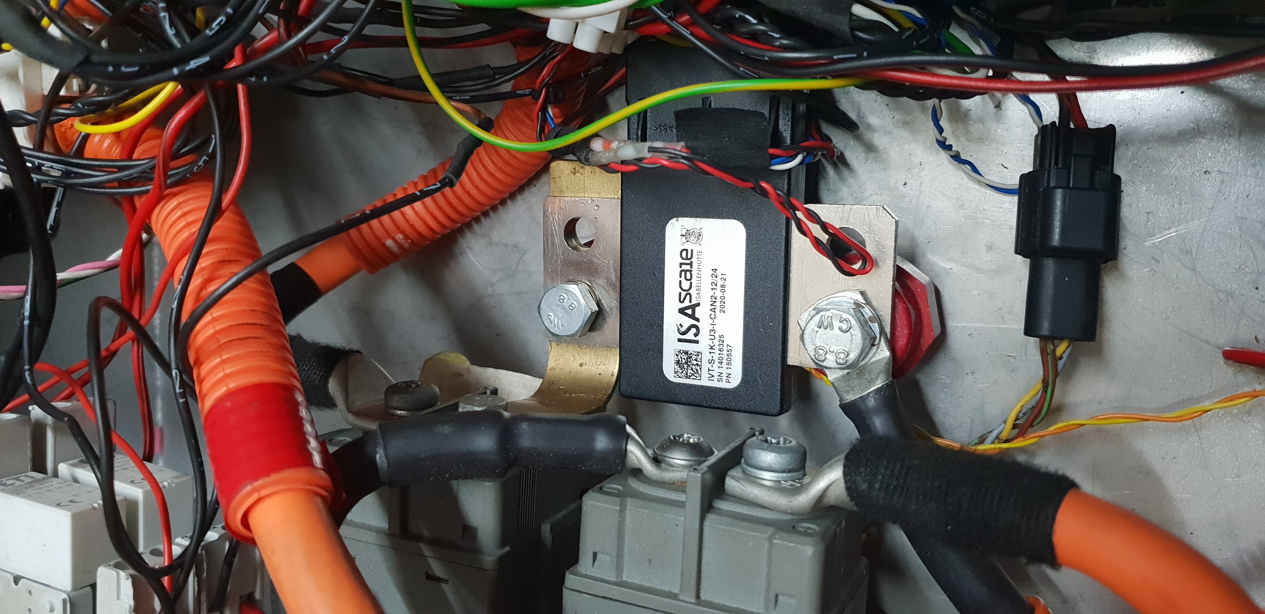

@Bigpie how is your ISA shunt connected in reference to battery voltage?
@Isaac96 can you help me with the code? How would i reverse the ISA (or VCU) CAN reporting so EVSE would see positive current request?
tnx
chademo test_0000.xls- (57.76 KiB) Downloaded 472 times

Do you have a dedicated current sensor for the CHAdeMO lines? Or an overall sensor for measuring the current going into your pack?
In case of the second option: are there any loads consuming power during charging?
If for example a DC/DC uses power that is charge current, but not measured as such going into the battery.
- Posts: 3795
- Has thanked: 166 times
- Been thanked: 411 times
Like you can see from photo i connect at the battery with ISA sensor after this connection. So no current should be flowing on that side.larsrengersen wrote: ↑Sat May 28, 2022 11:57 am Do you have a dedicated current sensor for the CHAdeMO lines? Or an overall sensor for measuring the current going into your pack?
ISA is on the CAN1 and chademo is on CAN0.
No matter what i set in current request (20A, 30A, 12A) it will allways result in termination at the same time after charg innitialization.
What i am thinking of is multiplying "Sensor.Amperes" by *-1. Would that change anything in the overall chademo report? Obviously my VCU is requesting -20A... But if i enter request for AMAX=-20 i would actually get 240A

Sorry, did not look closely enough.
You are indeed reporting -.
With a LEM sensor this would be a sensor orientation issue, but with IVT not likely. But yes, then I'd say multiply measured current with -1

I've got my ISA on the negative side, DCDC not running. My shunt reports positive for consumption and negative for charging.
My log shows the current as -50 amps and the EVSE reporting 50 amps. It charged for 5 minutes without issue. Now I'm not sure why.

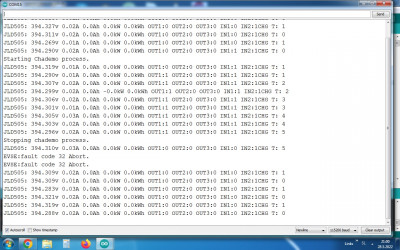

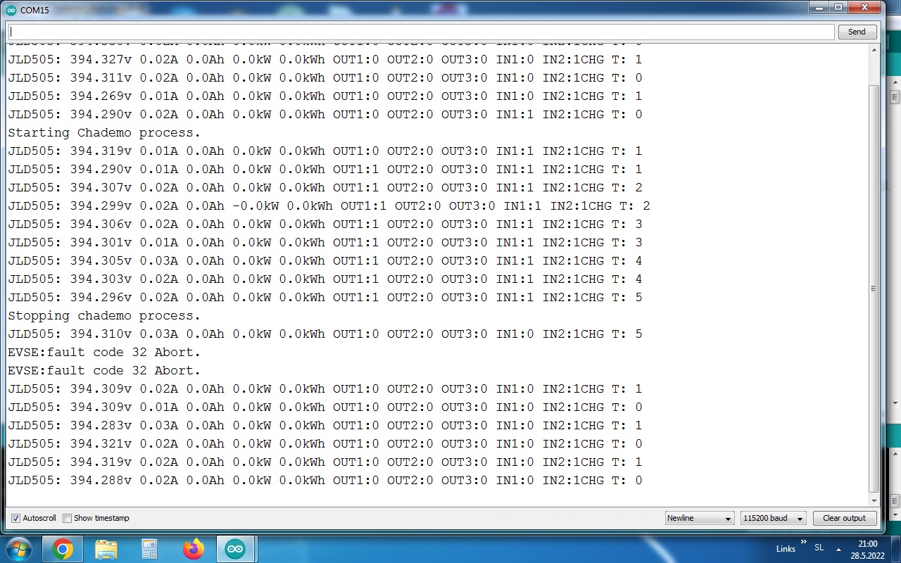

I tried on another EVSE and this time i wouldnt even get contactors pulled. Just error 32! See csv file and serial report.Bigpie wrote: ↑Sat May 28, 2022 12:49 pm I've got my ISA on the negative side, DCDC not running. My shunt reports positive for consumption and negative for charging.
SuccessLog.txt
Strange... I will now turm ISA around so it will sense current the other way. No problem doing that...
chademo test_0001_0000.xls- (27.26 KiB) Downloaded 477 times

Is the timing of the messages you are sending correct? Data update rate needs to be 100 ms for each message.
And do you know what the 0x208 and 0x209 messages are?
- Posts: 3795
Yes i feed data at 100ms.larsrengersen wrote: ↑Sat May 28, 2022 7:39 pm Is the timing of the messages you are sending correct? Data update rate needs to be 100 ms for each message.
Still cant pull contactors in. Just error 32.
I have no idea about 0x208 and 0x209. They originate from EVSE which behaves really different than the first one.

If you do DBG=3 your logs will have more info
- larsrengersen
- Posts: 171
- Has thanked: 16 times
- Been thanked: 36 times
Looks like from the beginning, the EVSE says 'Stop'. The question is, why?
