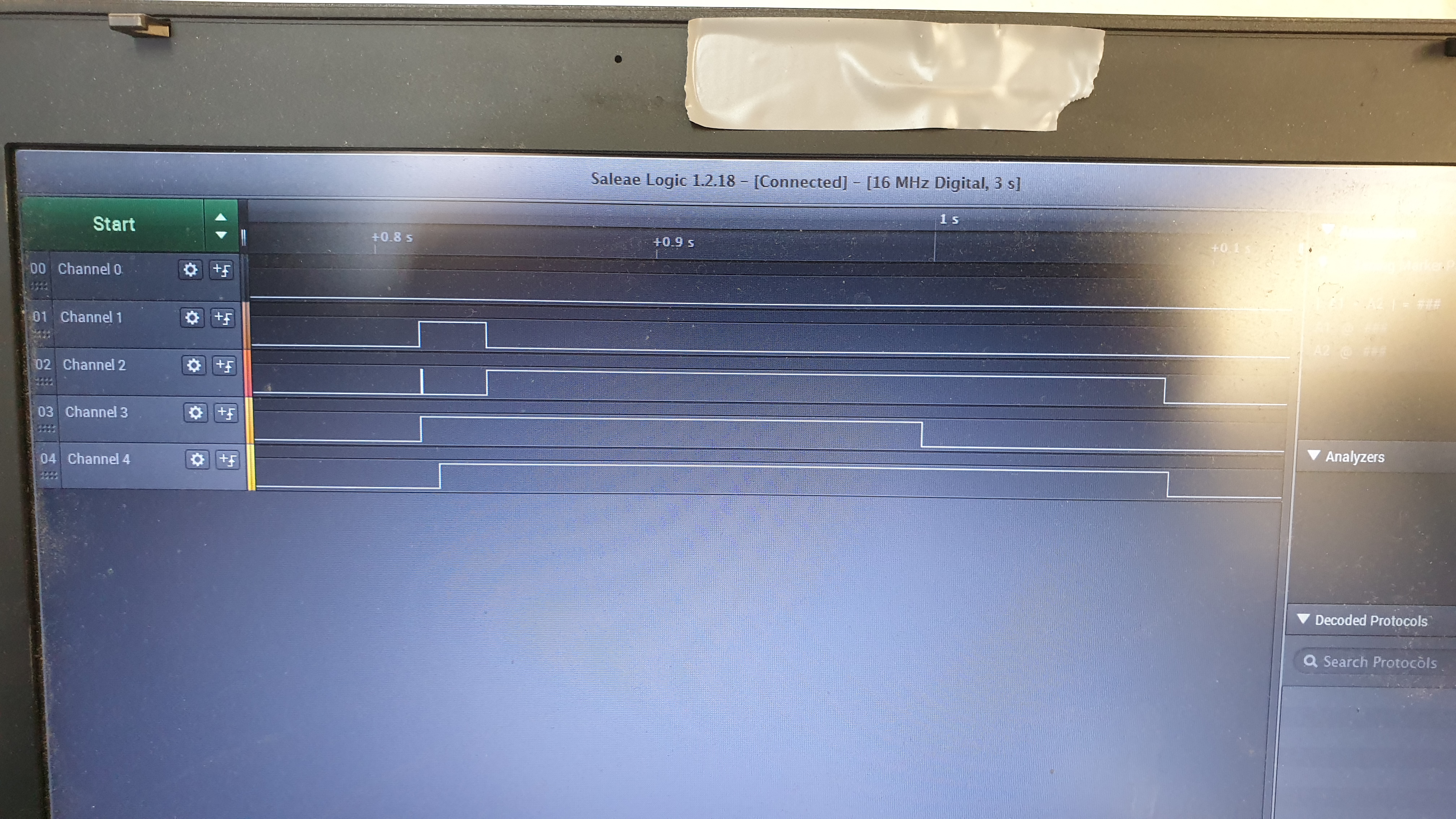

That's odd. Even if they were using UART mode it uses the same pins so you'd expect to see something if you manage to get your state machine far enough.
Looking at your PCB picture it looks awfully like an SPI EEPROM footprint. You've not got the SPI Master (config) bus rather than the SPI Slave (host) connection?
- Posts: 4006
- Been thanked: 1136 times
oookay. I'm on pins 3 , 65,66 and 67 with are ....wait for it ..... SPI master! Now I just gotta find the RIGHT spi .... gaahhh
mikeselectricstuff
- Posts: 120
reading the datasheet, looks like it can be configred to get its firmware from the SPI slave bus.
SPI slave functions are on page 22, boot modes on page 18
- Posts: 4006
Yep based on pin 22 am now on Serial IO 0 to 4. Few state changes at powerup. Nothing constant and nothing on 5% pilot
mikeselectricstuff
- Posts: 120
Seems odd - looks like it needs a firmware load, and unlikely it could detect GP carrier without. the QCA7000 has sleep modes so doesn't seem like there is a reason to delay intialising it. The Kona module's flash has about 400K of code, so a firmware load over SPI should be pretty obvious.
I assume you were looking for SPI both at powerup and after you'd thrown some initial CAN at it?
Have you looked at what the reset pin is doing - I'd expect the MCU to do a reset first, then load the firmware
- Posts: 4006
No data of any sort at any time on that bus other that the few pulses pictured above. Guess I better try it at a ccs station.

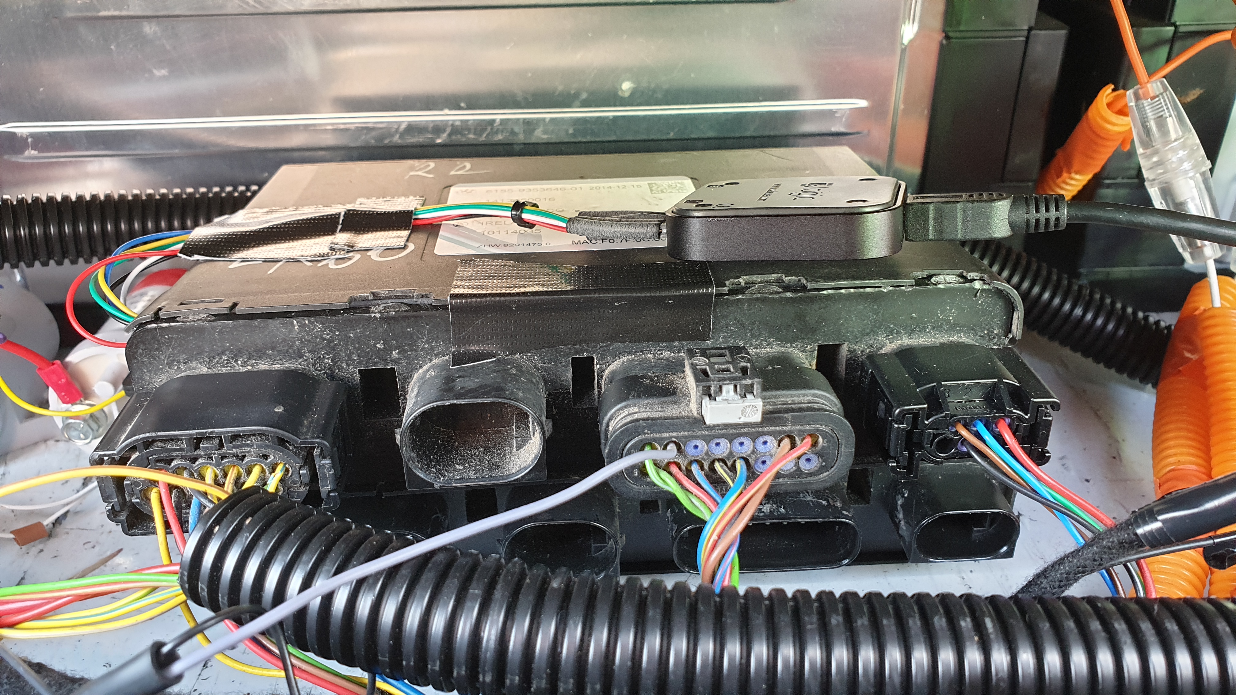

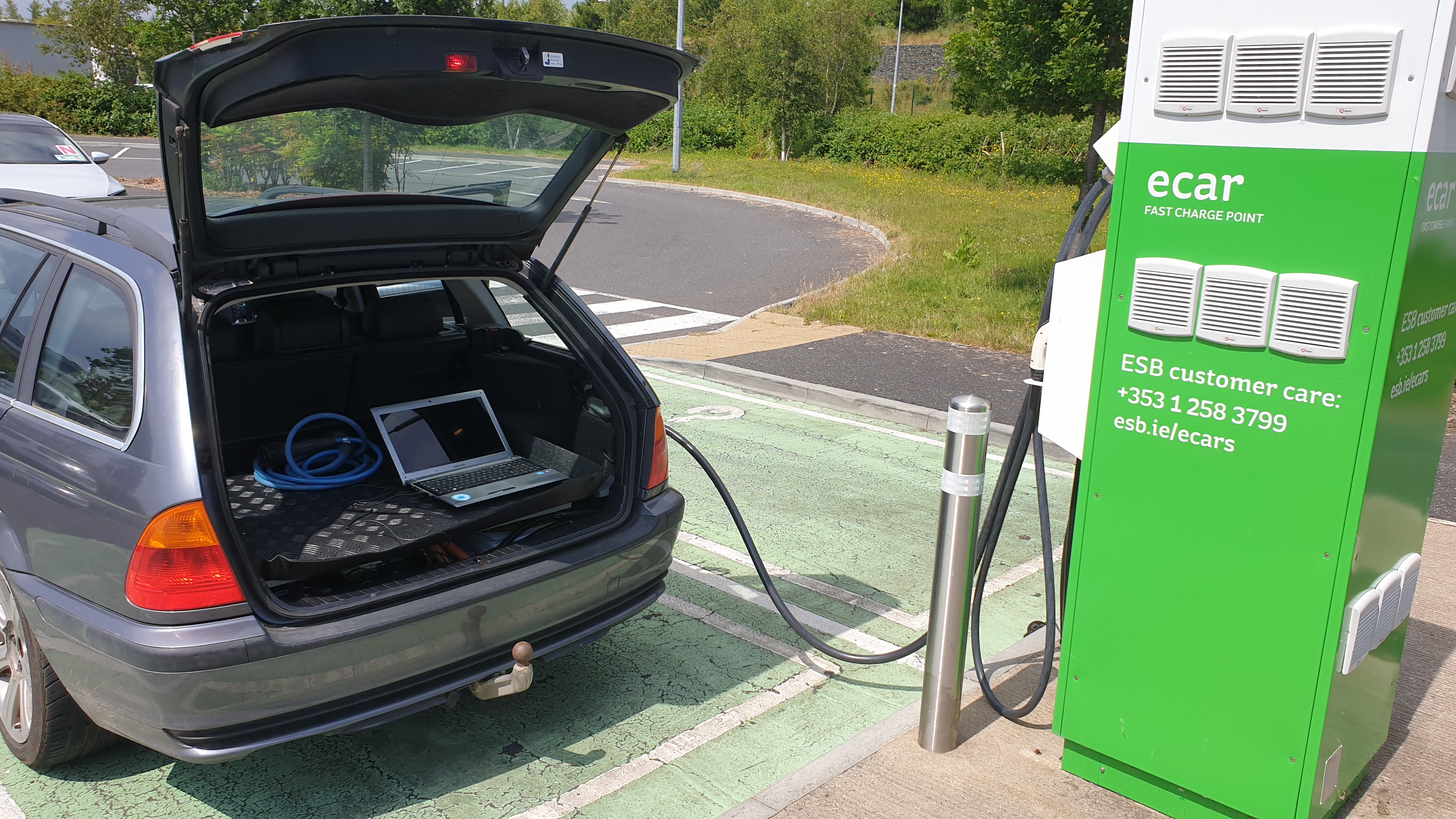

Just back from my local services where they have Ionity/ABB and Efcaec QC45 stations.
All tests done with same VCU firmware as had been used previously (works on Efcaec, not Ionity or Circontrol).
2014 LIM with Saleae logic on the spi bus.
Ionity first : https://github.com/damienmaguire/BMW-i3 ... .logicdata
Exact same behaviour as before. Connects, starts talking, station reports it needs to wait for power to be available then times out.
20 second capture done as follows, Open cp door, authenticate station with app, start logic analyser, plug in.
Efcaec: Lots of logs. Start, full power then at tail end (approx 45A current).
All on the repo : https://github.com/damienmaguire/BMW-i3 ... n/SPI_Caps
Few quick observations : Looks like a 2MHz clock. Only difference between 2014 and 2017 Lims in terms of bahariour was when I command 0 amps the 2017 sits there until I terminate charge but the 2014 terminates.

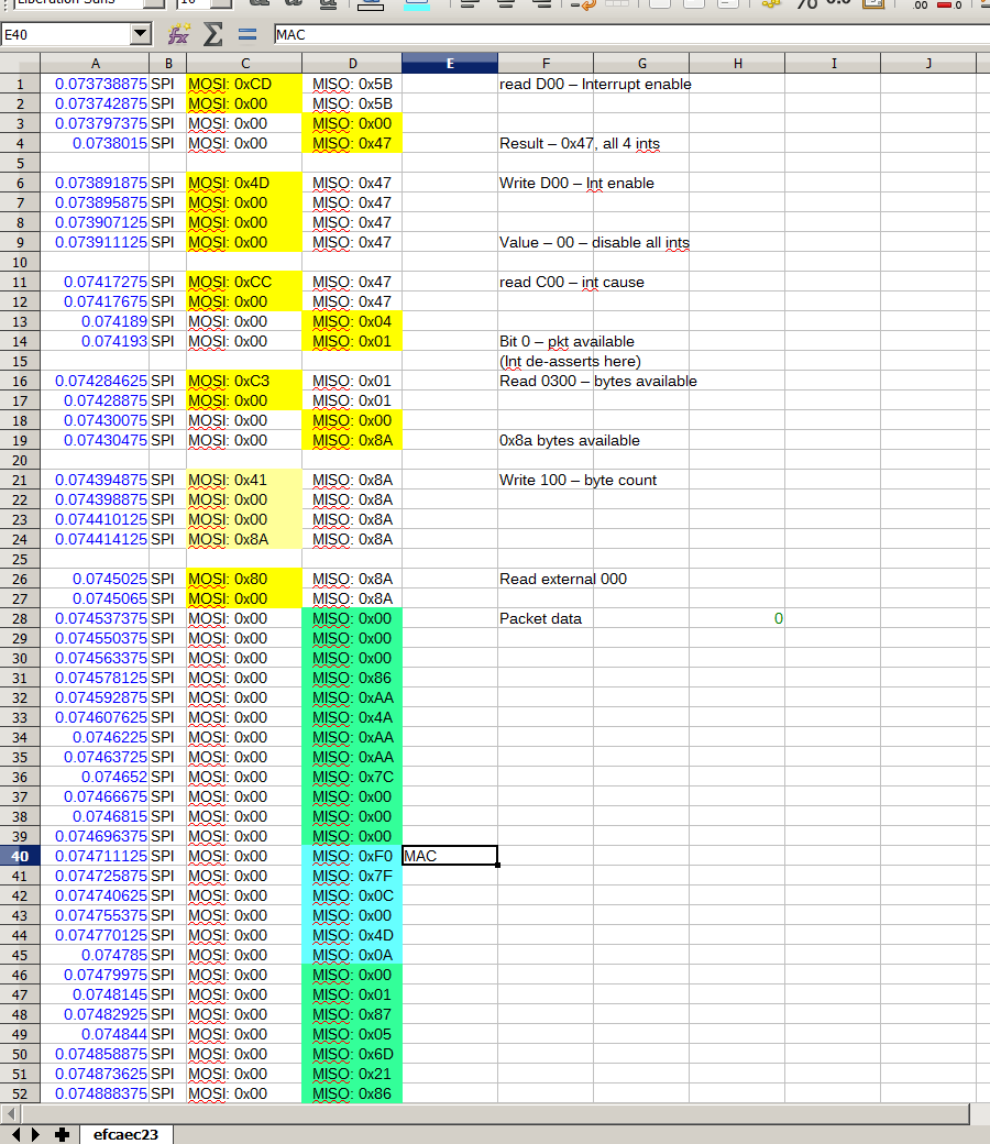

Once you've set up SPI decode in Seleae Logic, You can export a CSV of the decoded SPI bytes.
Not ideal as it doesn't packetise them but could be a useful step in analysis. It does include timestamps so that could be used to group packets to some extent
davefiddes
- Posts: 416
- Has thanked: 206 times
- Been thanked: 257 times

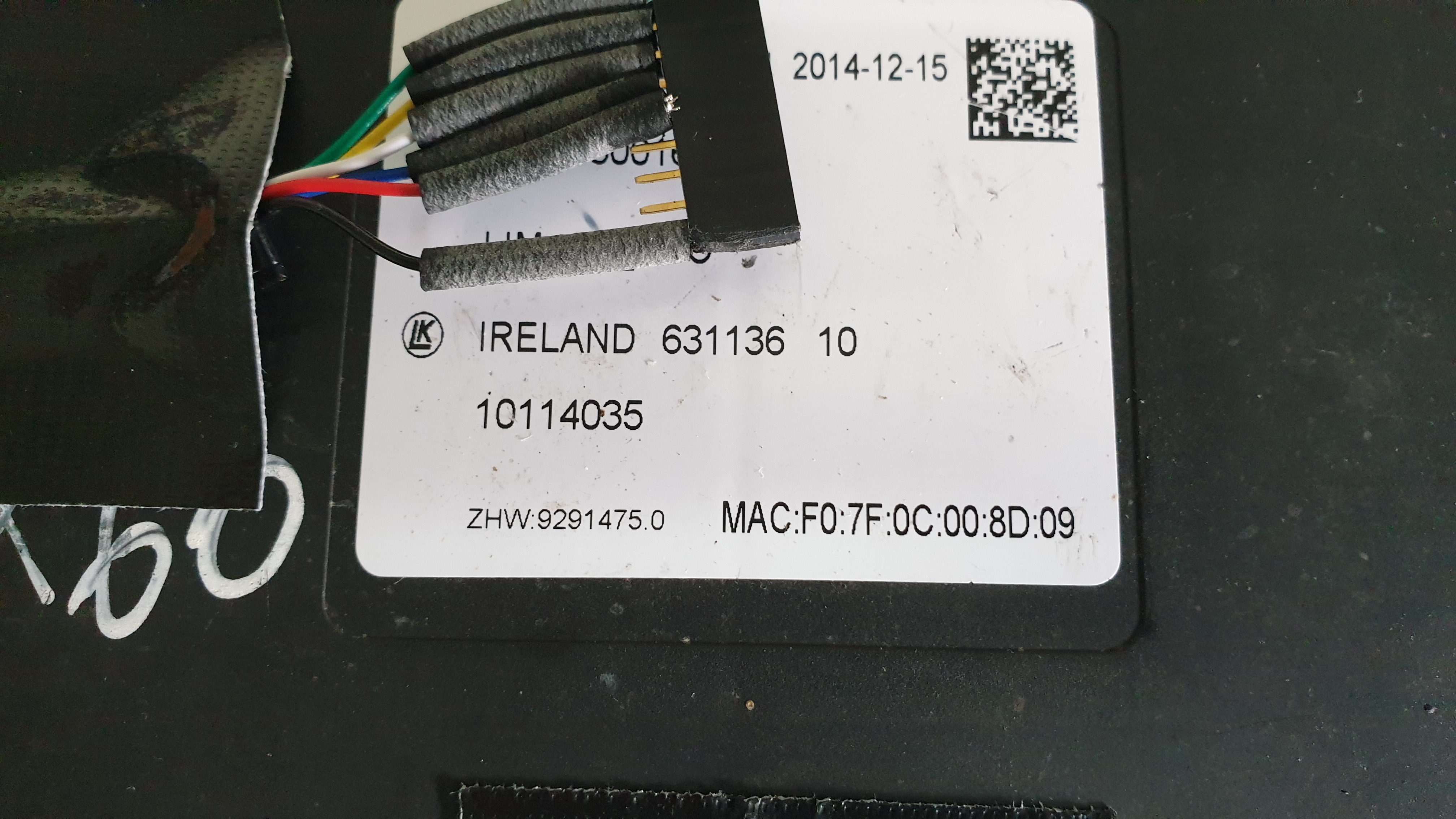

Yipee! Got the SPI decoded and I've found the MAC address of the unit F0:7F:0C:00:8D:09 in the data stream from the LIM so I think we've got Ethernet packets. I have an ugly hacky idea for how to decode this just need to put together some python to try it.
mikeselectricstuff
- Posts: 120
The data looks very plausible - here's a snippet.
This document is helpful for making sense of the SPI data https://in-tech-smartcharging.com/asset ... 4_rev5.pdf
MAC prefix F0:7F:0C looks plausible https://www.kostal.com/en-gb/
and 00:01:87 is I2SE GmbH , who we've encountered before with CCS stuff
I'll leave the full decoding to others....

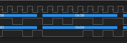

Quick warning - don't trust the Seleae Logic SPI decodes. Seems it can't handle sampling on different edges for MOSI and MISO.
Looking at the MAC addresses, when the host is sending to the QCA, the MAC is showing as F0 7F 0C 00 8D 0A, but when receiving, it's F0 7F 0C 00 8D 09
Can't immediately see a way to make it decode both correctly

Correction - looks like the decode is correct, but why is the MAC LSbit changing from Tx to Rx ?
Signal integrity issue from capture?
mikeselectricstuff
- Posts: 120
OK I think the issue is just the edge selection in the SPI capture - needs to be set as "valid on trailing edge", otherwise the receive data from the QCA is sometimes wrong.
I think the actual MACs are
Efcaec : 00:01:87:05:6D:21
Ionity : 54:10:EC:A5:0B:D1 (UUID 5410EC is Microchip!)
LIM : F0:7F:0C:00:8D:0A
