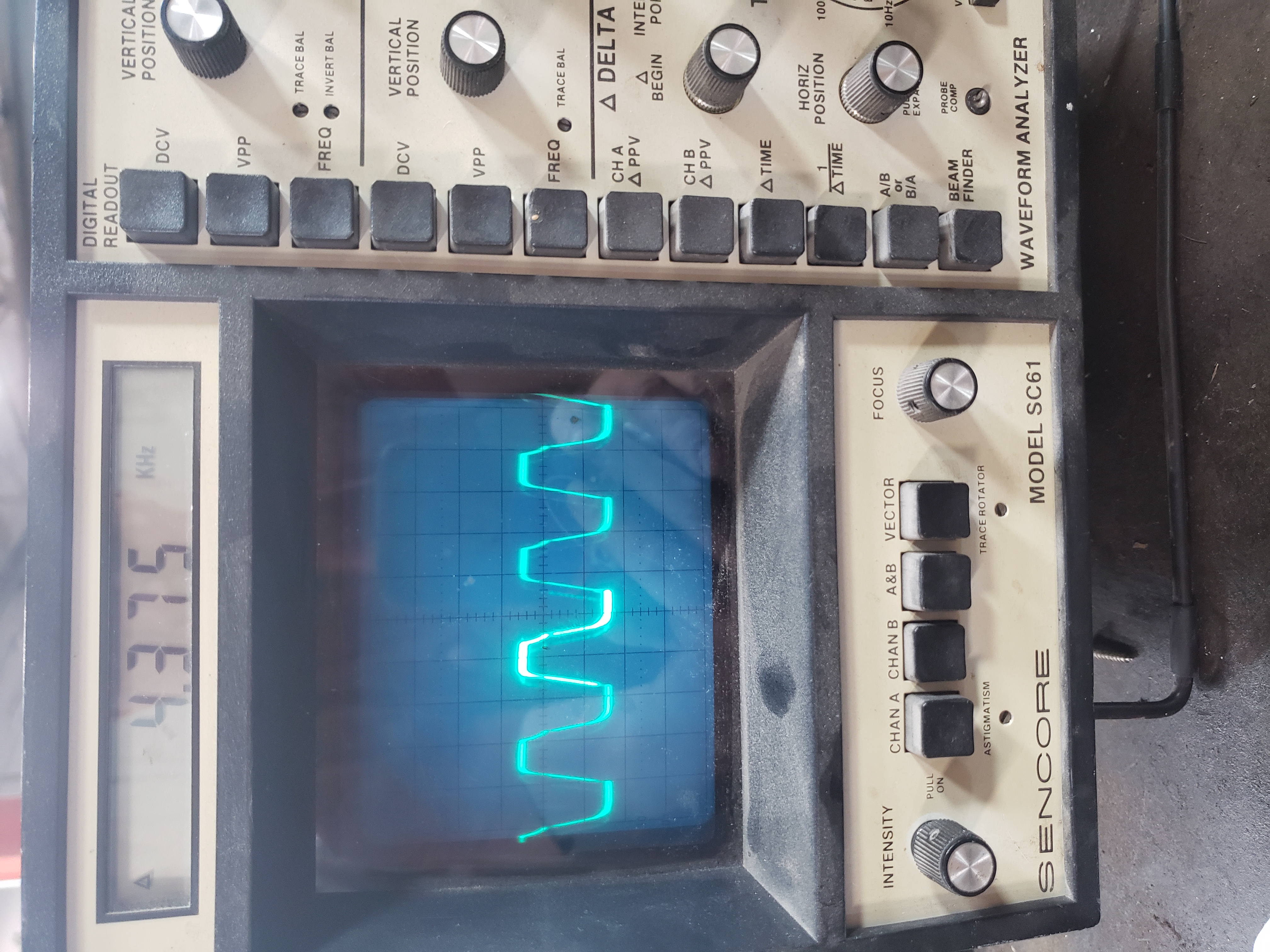

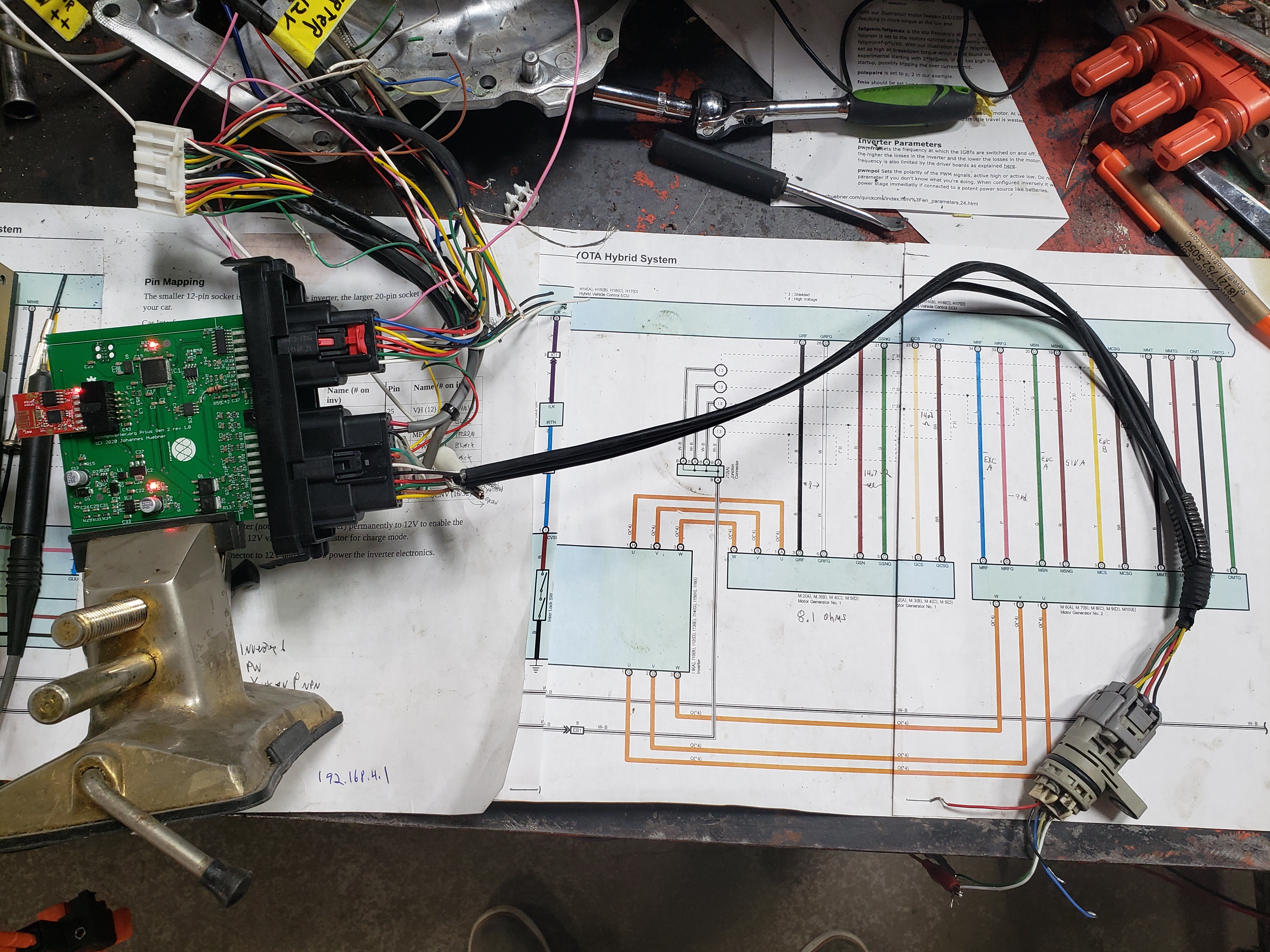

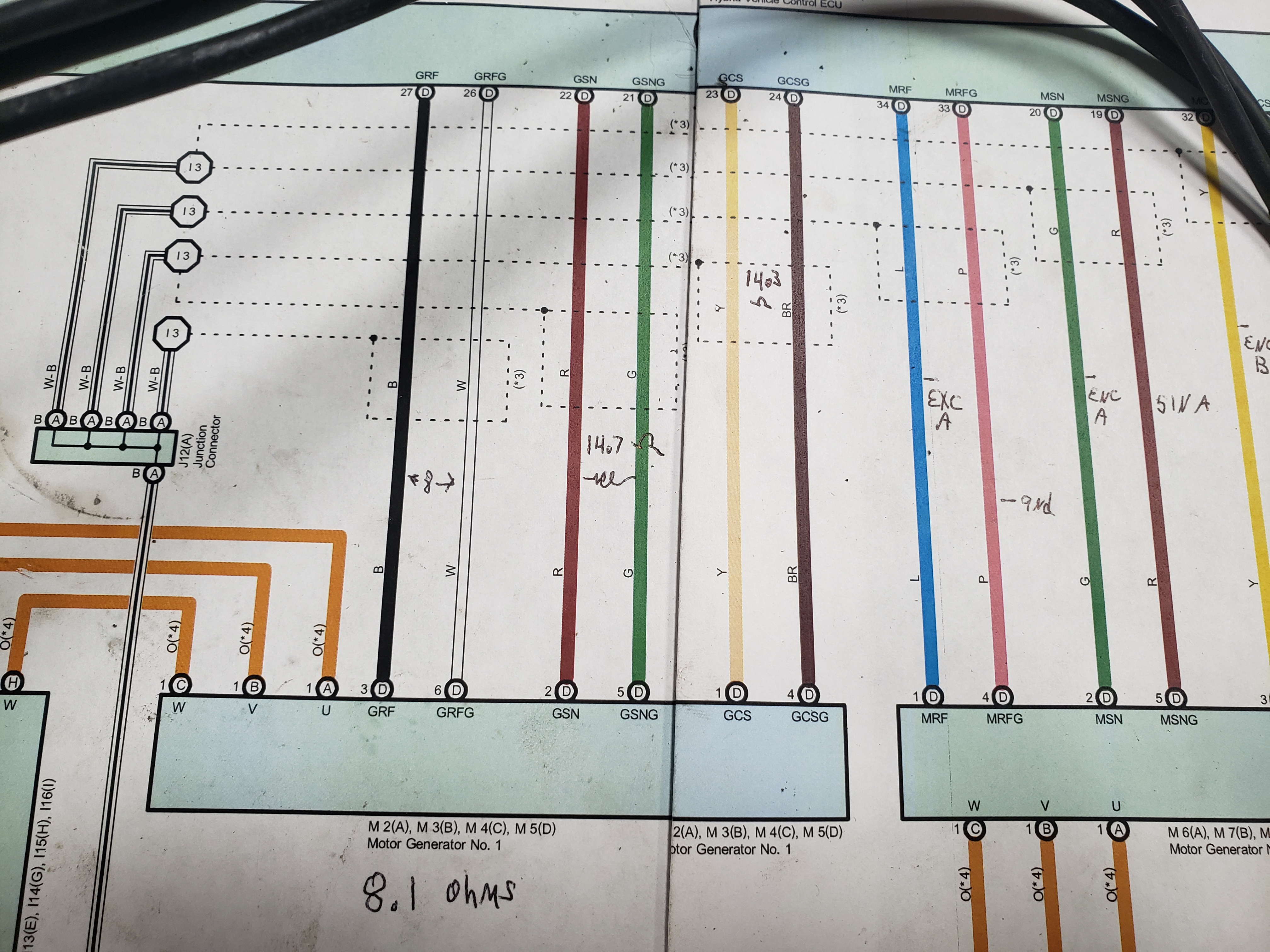

thank you for answering kiwifiat,
you are right the three coils in the resolver are 14 ohms, 14 ohms and 8 ohms.
I have photographed the toyota schematic with my oem harness laying on top.
yes the colors match, with black and white being the excitation.
the openinverter board is producing this almost sinusoidal signal unloaded. the distortion shows up when connected to the 8 ohm resolver
I am baffled why the vector signal entering the openinverter board will not show a valid angle when plotted with the webinterface
and I would argue this is a problem that could be fixed in firmware.

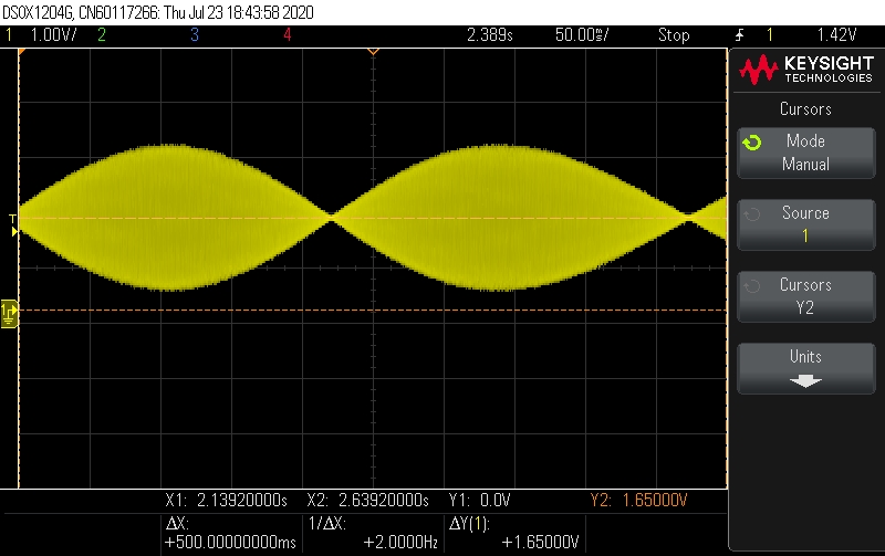

Ok, lesson time considering I have just been doing this with the Model 3 drive unit. In order to work the FOC software needs the exact angular position of the rotor. It does this by feeding one end of the sine and cosine from the resolver to two adc inputs. The other ends are held and about 1.65v. Why 1.65v? well its 3.3v/2
Now, in order to get the most accuracy we want the sine and cos amplitudes to be close to 0v at minimum and close to 3.3v at maximum. We can tolerate less but more is very bad as we loose angle information. ok so far?
Now we end up with two numbers. Feed those into an arctan function and presto an angle in degrees. That's how it works.
So lets scope the sin and cos pins on the stm32 and what should we see?
If it clips, thats bad.
If it is very low amplitude, thats bad.
And those pretty waves we see only with a spinning rotor, right? With rotor/resolver standing you have only 2 steady values for sin/cos.
- ZooKeeper
- Posts: 526
- Location: USA
- Has thanked: 8 times
- Been thanked: 5 times
Unless I am mistaken, you will not see pretty waves in the VCU GUI, but something more like a sawtooth. The pretty ones are on only on scopes.

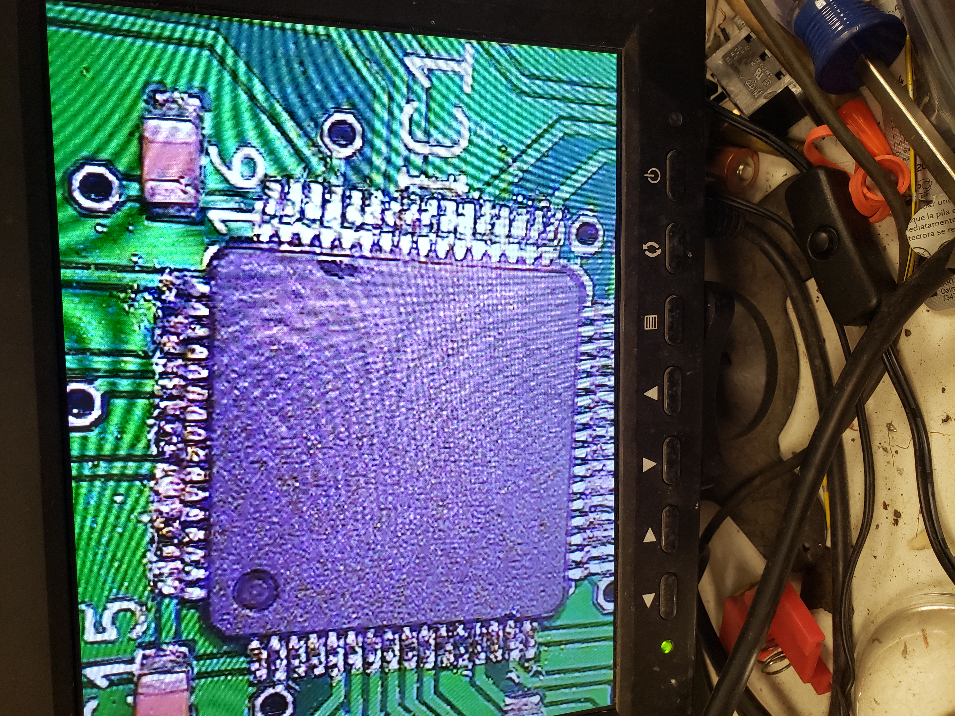

thanks " elon" while trying to figure out what pins are the sin and cos in to the STM32, I remembered this was one of the boards Johu had to rotate the chip.
so I reflowed it with hot air. and my symptoms are different... and maybe a little better. some circular jerky motor movement.
so, now I will go back and retest the polarity of the sin and cosine connections. you dont happen to know what pins I should scope do you?
I can likely go find a point to probe nearby.

update!
I can now plot a sawtooth, just like damiens in his youtube. the only change was reflowing the STM.
now when I attempt motor spin , I get a few moments before the contacters cut out and they wont restart until I power cycle.
no errors but Ive been up for 10 hours and maybe I should take damiens advice and ponder a bit.
is there a way to restart without power cycling?
Im assuming I need to play with W.C.U phases or perhaps sin cos polarity
does anyone want to see a tube video of the reflow under a microscope?
