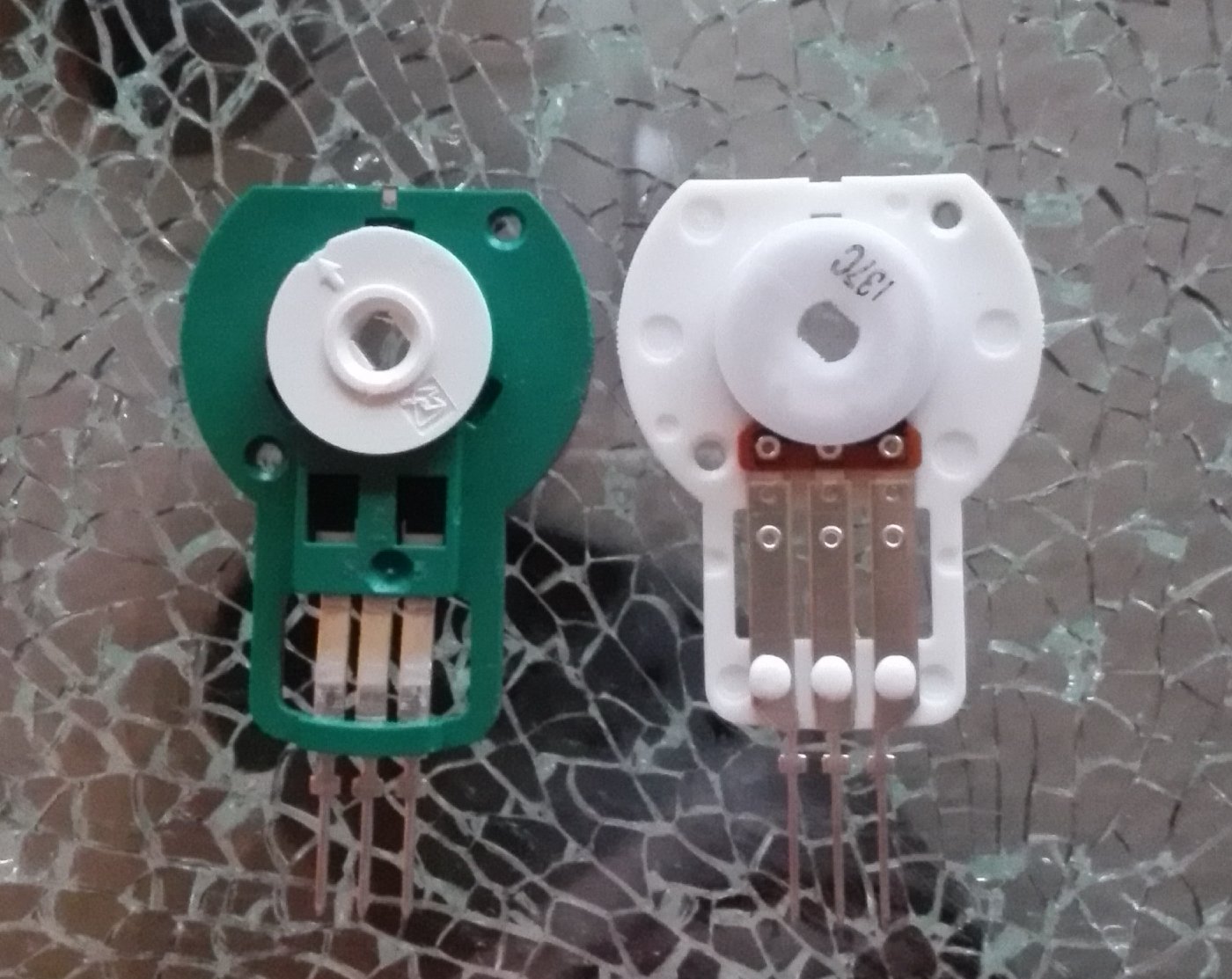

I found that the PTC heater wouldn't stay on consistently and therefor didn't produce much heat either. So I checked. Now, I have fitted a microswitch to the heater flap servo, to enable the heater when the flap is in "full heating" position. But it turned out the servo drove back and forth so much that it disabled the micro switch for prolonged periods.
The servo has a simple pot inside for position feedback. These pots tend to wear out and the dust that gathers around the wiper will produce inconsistent resistance. Simple mans fix: WD40 :D The servo is now also much quieter as it doesn't move around anymore and the heater stays on, yay :)
Been thanked: 1918 times
As always, the WD40 "fix" didn't last long. So after a long search I found sortof compatible feedback pots (the white one is new, green original).
https://de.aliexpress.com/item/4001252117889.html
When measuring the old pot with multimeter you could see it never really settle on a value. So now swapped out 3 of the servo pots and it is again quiet and hopefully the passenger side servo stops getting stuck in cold position.

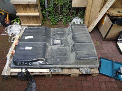

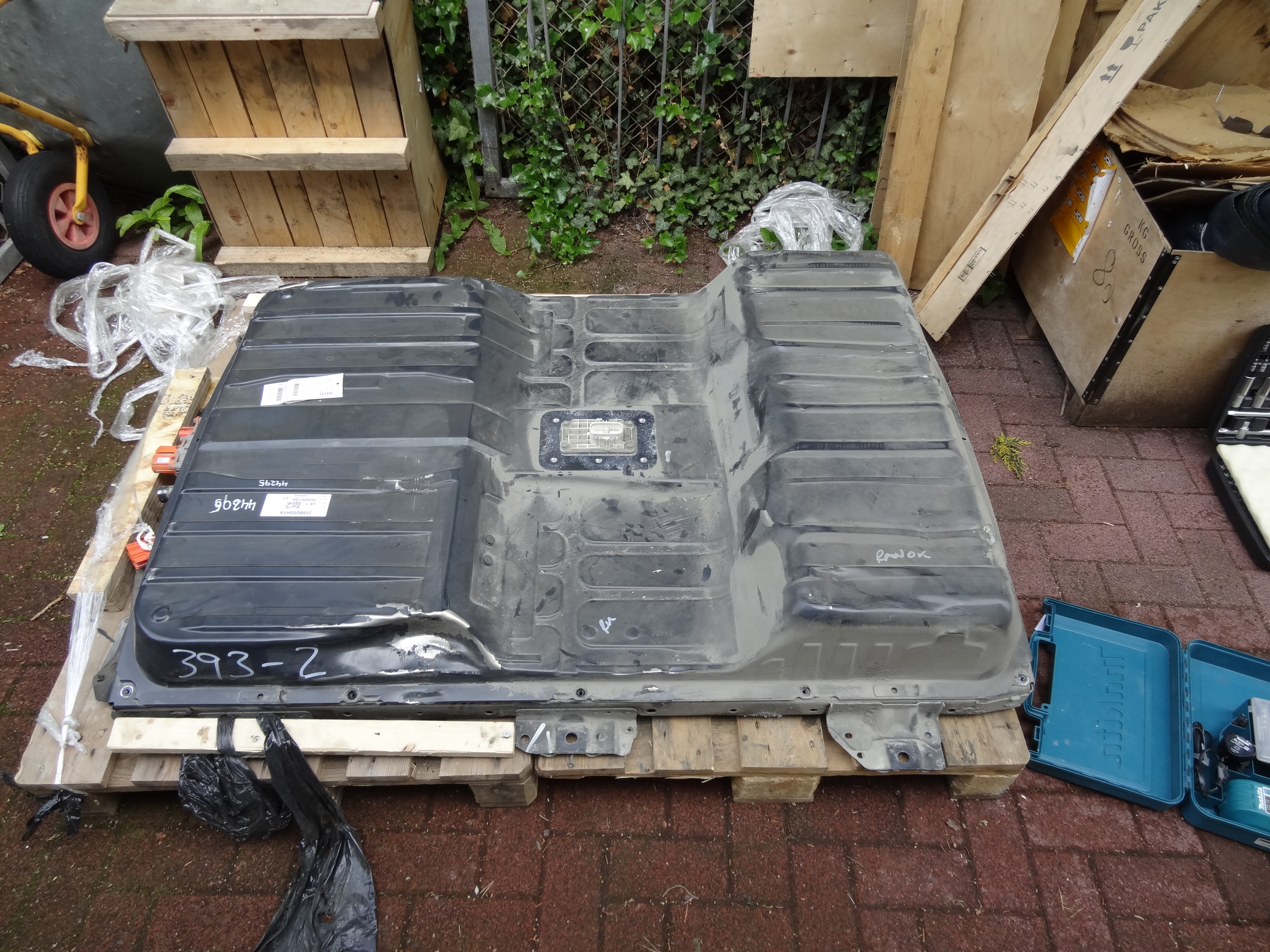

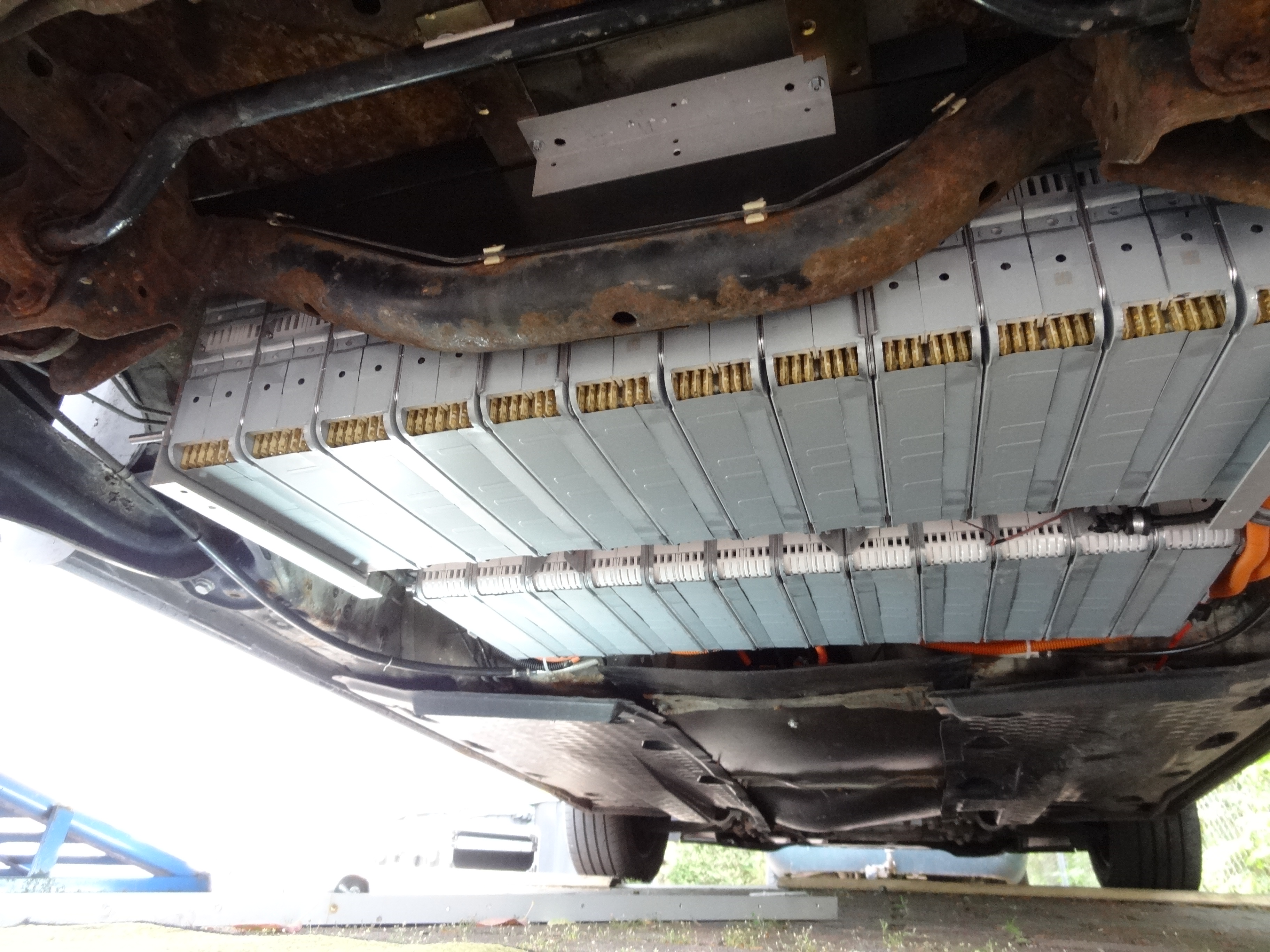

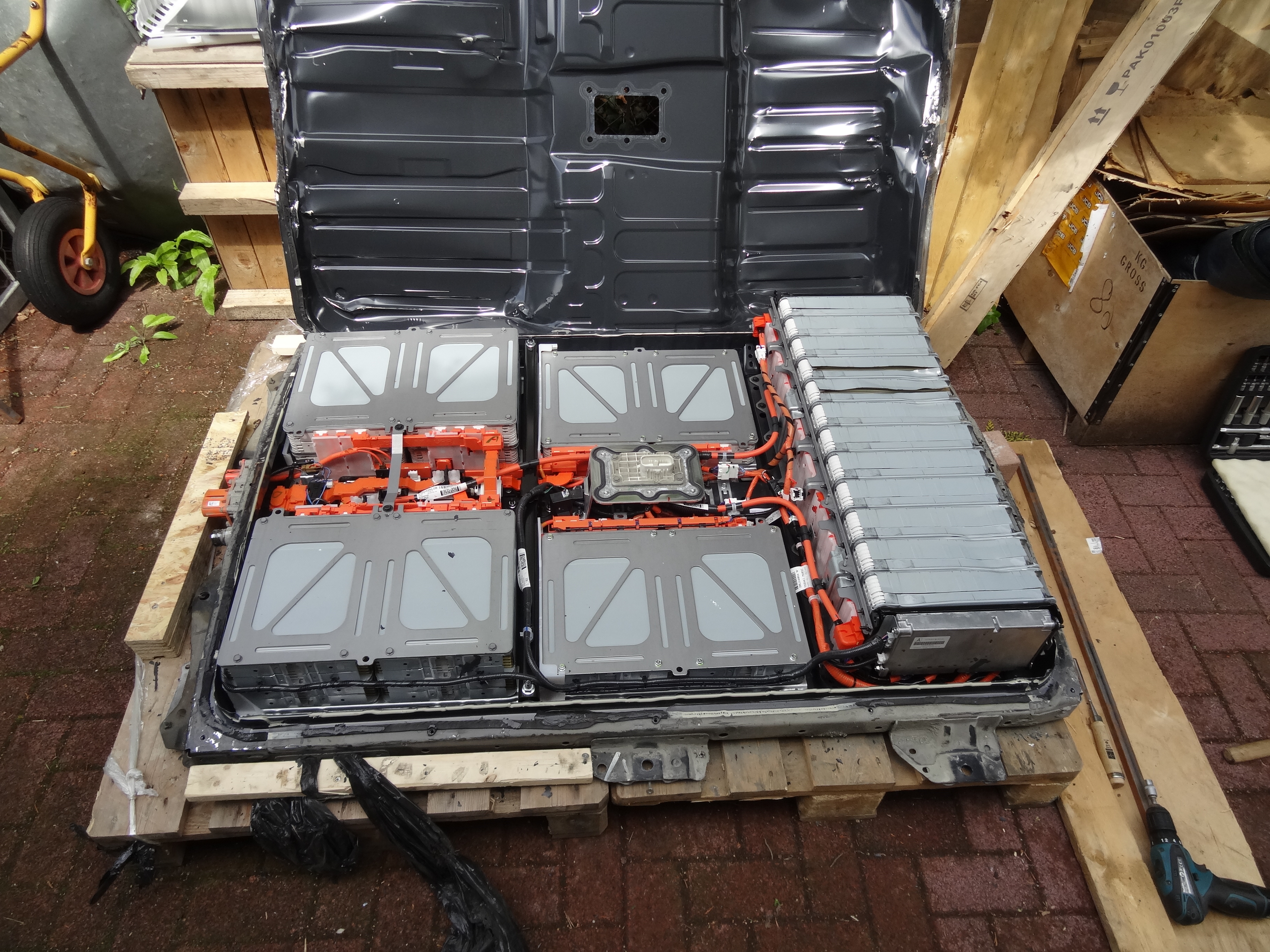

A large truck pulled up today and brought my Norwegian 40 kWh battery :)
I was a bit shocked when I saw the large dent in the front but it turns out there is a lot of leeway between the enclosure and the cells.
Not such much in the rear, where rather small dents pressed down on the cells. I did bend the metal cover open a bit to see what is below and it seems to just have pushed the pouch seams sideways a bit. Should be ok.
Total pack voltage is 347V, one cell voltage I got ahold of was 3.613V and 347V/96=3.615V. Looks good.
I found they moved the main pack fuse away from the safety disconnect to a separate unit next to the relay box. Also it is 350A in place of 225A. Temp sensors are now mounted to the cell terminals in place of being stuck in the rear. All else seems unchanged.
Had to take a small break because the pack lives outside and a thunderstorm is approaching. Will report more later.

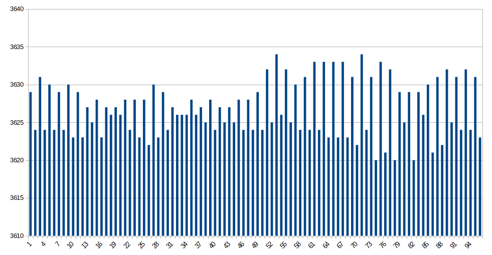

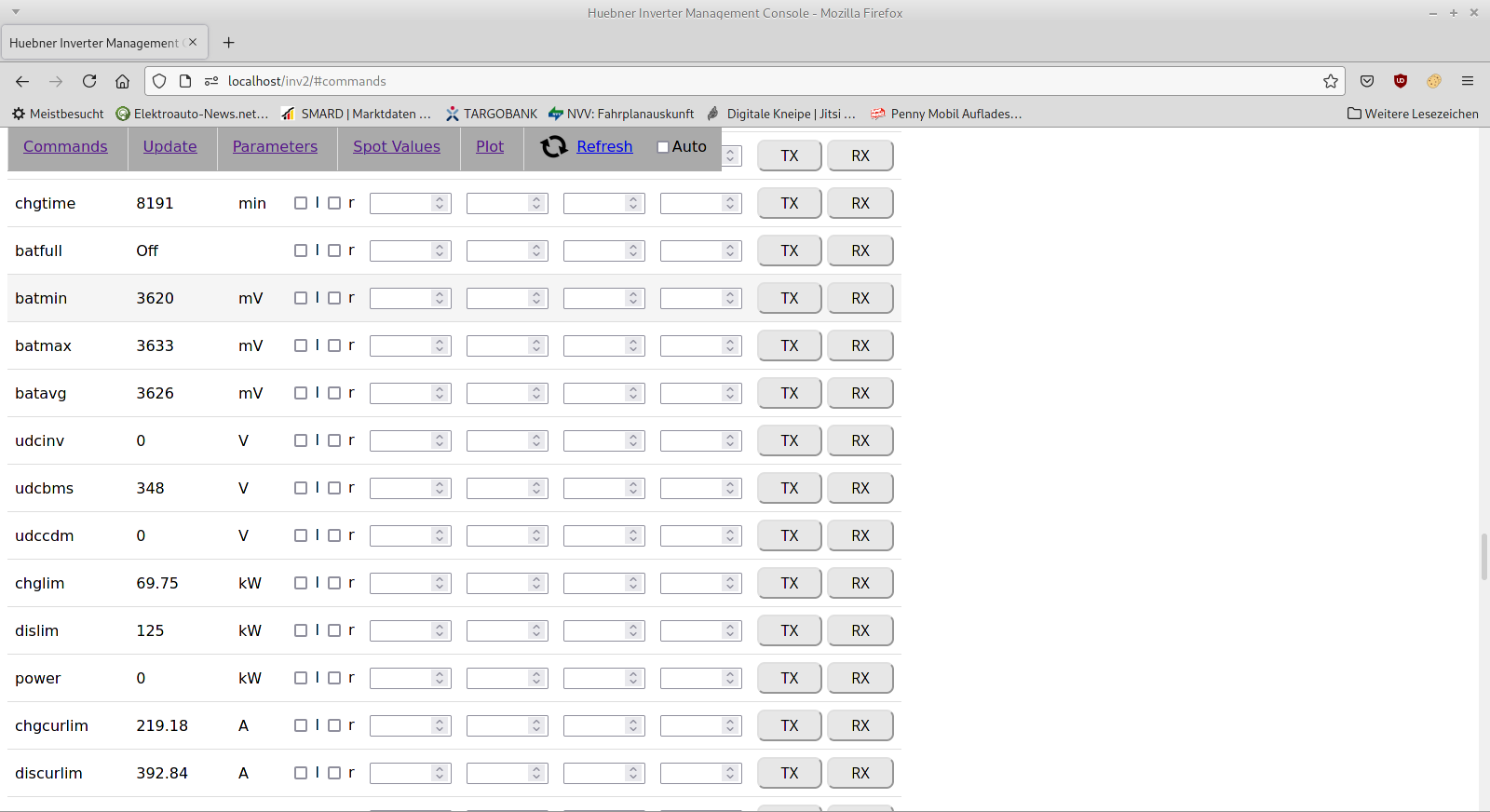

So, got half of the cells out (the smaller bricks).
I connected stm32-car to the LBC and it just works as is, contrary to what "the internet" says.
Cell voltages a quite even within 13mV, better then my current pack. SoH=93% which I'm quite happy with.

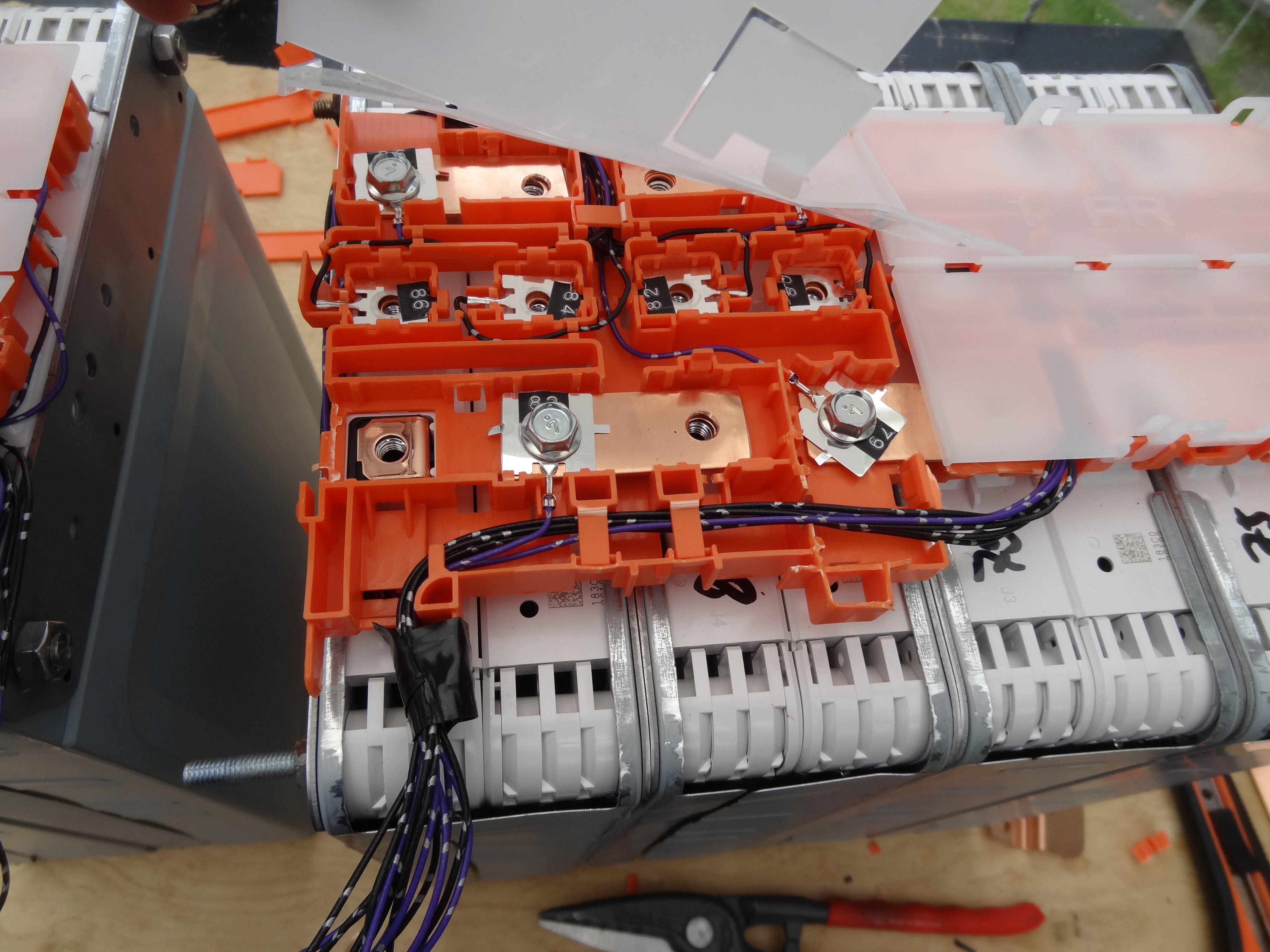

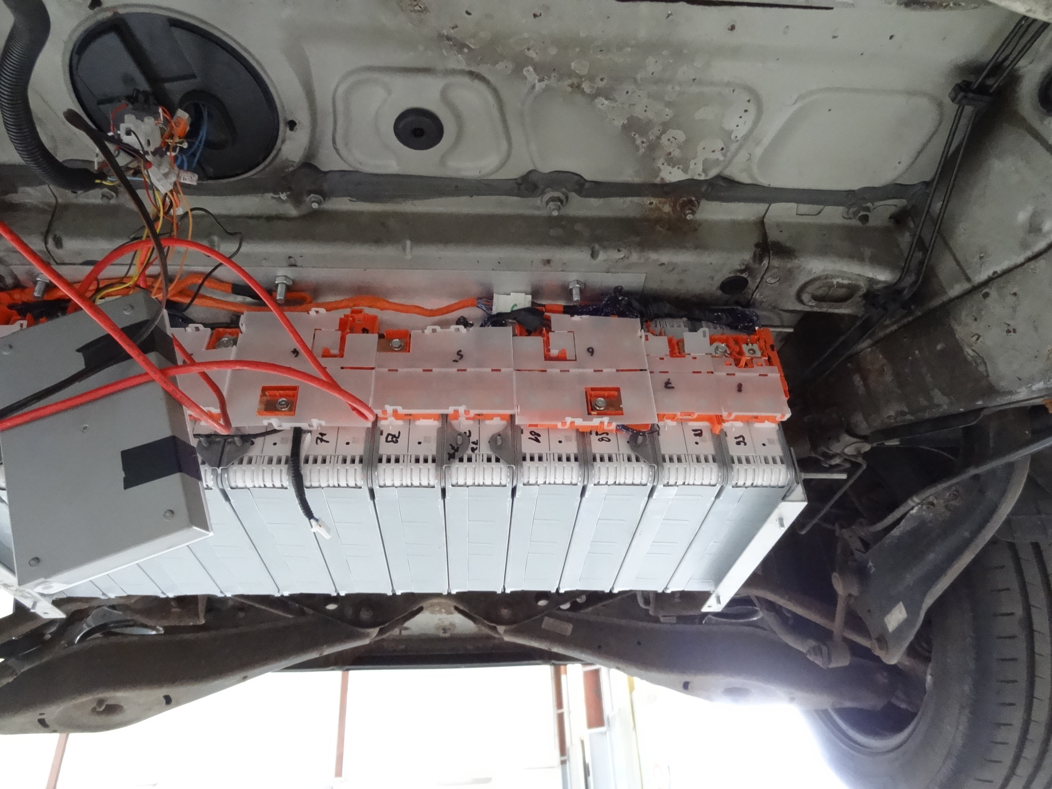

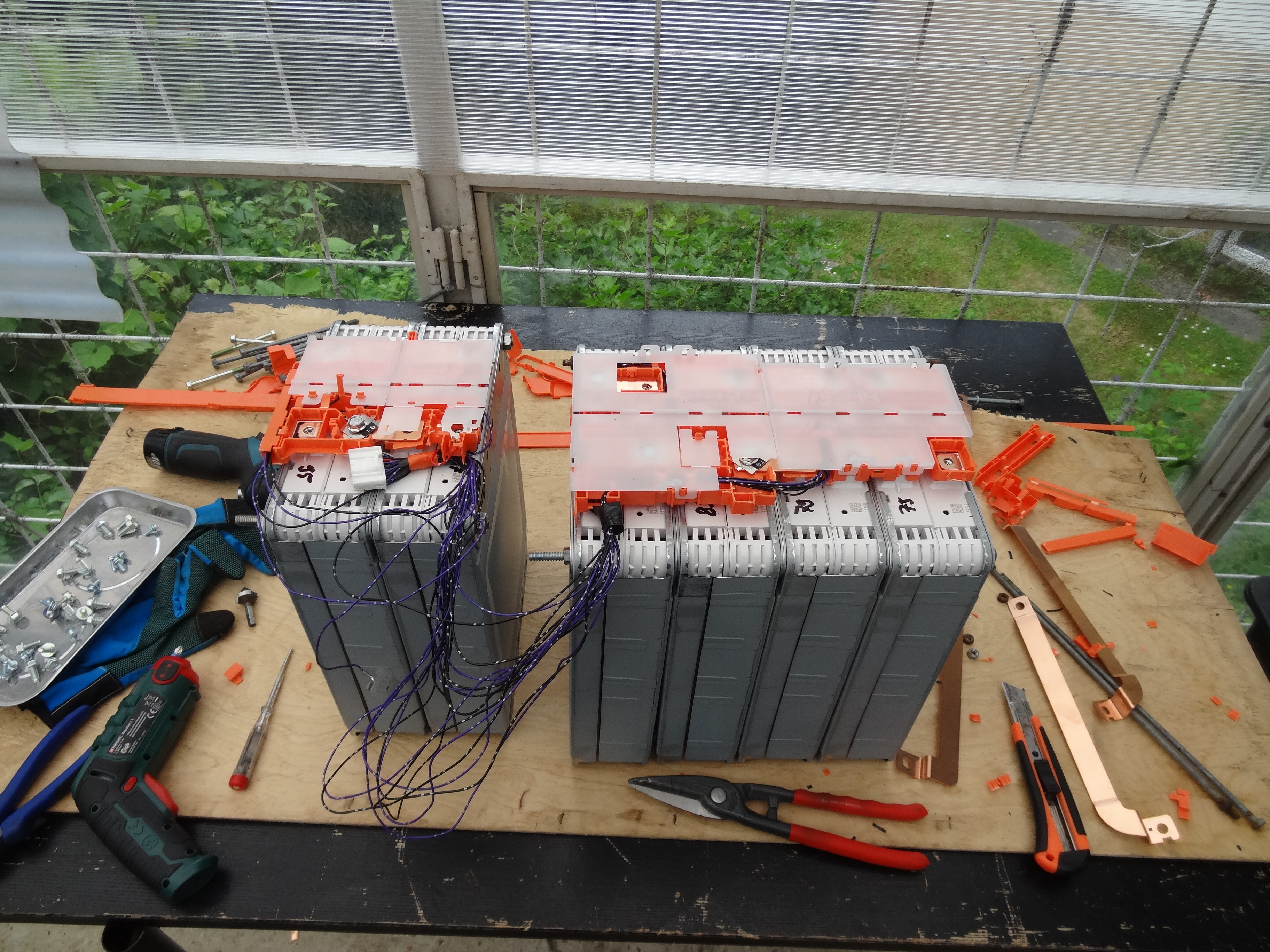

I have disassembled one of the lying down quarter packs and reassembled it as a straight brick. This time I did put labels on the tap wires to reconnect them in their original order.

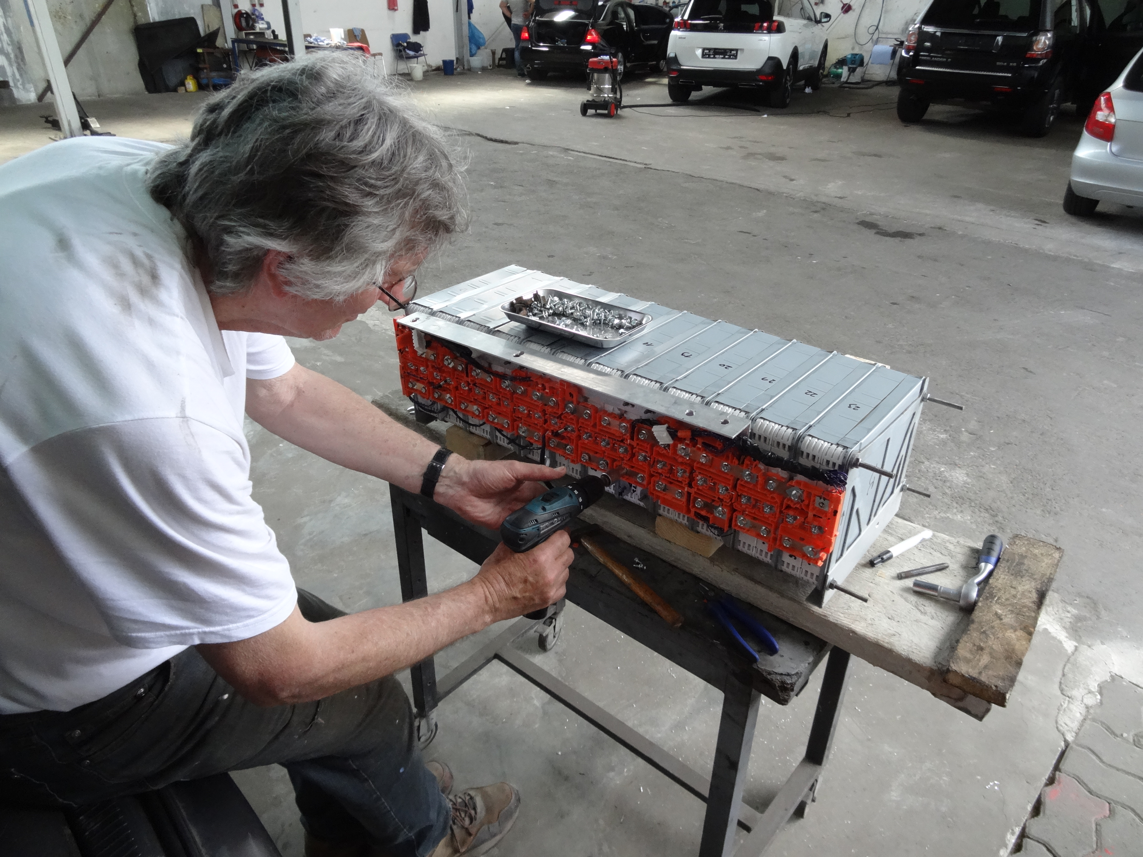

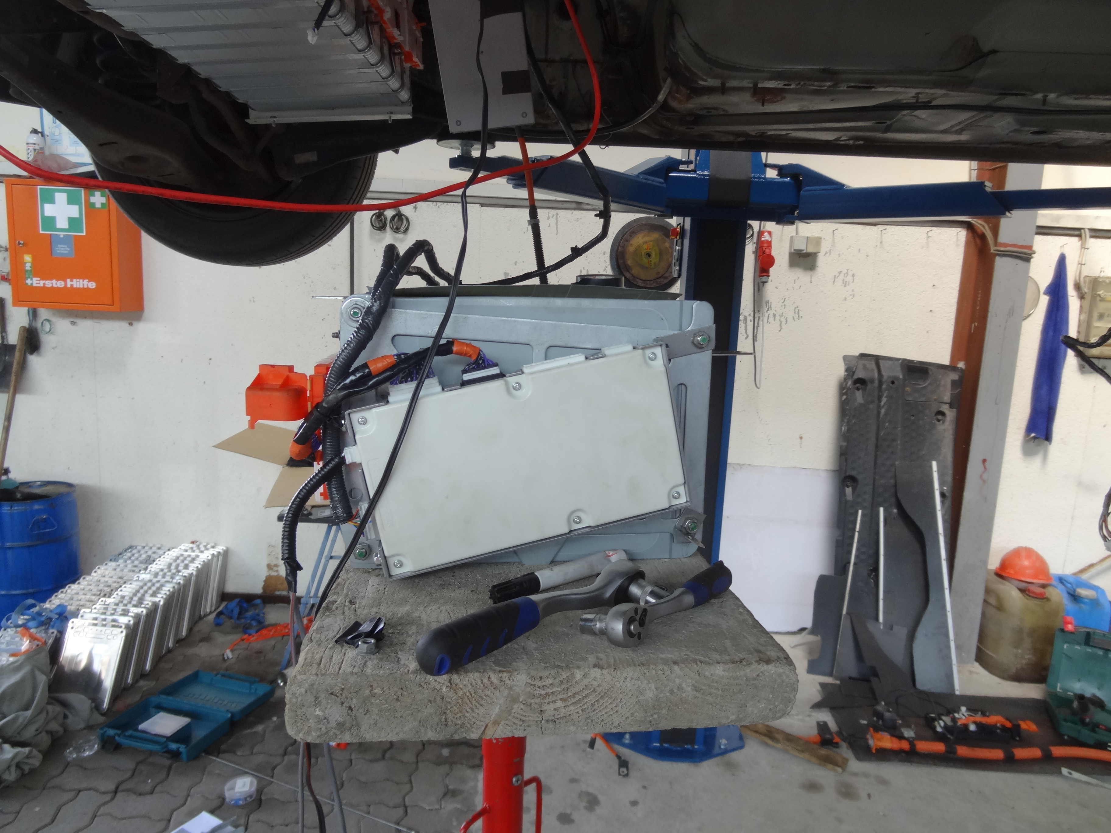

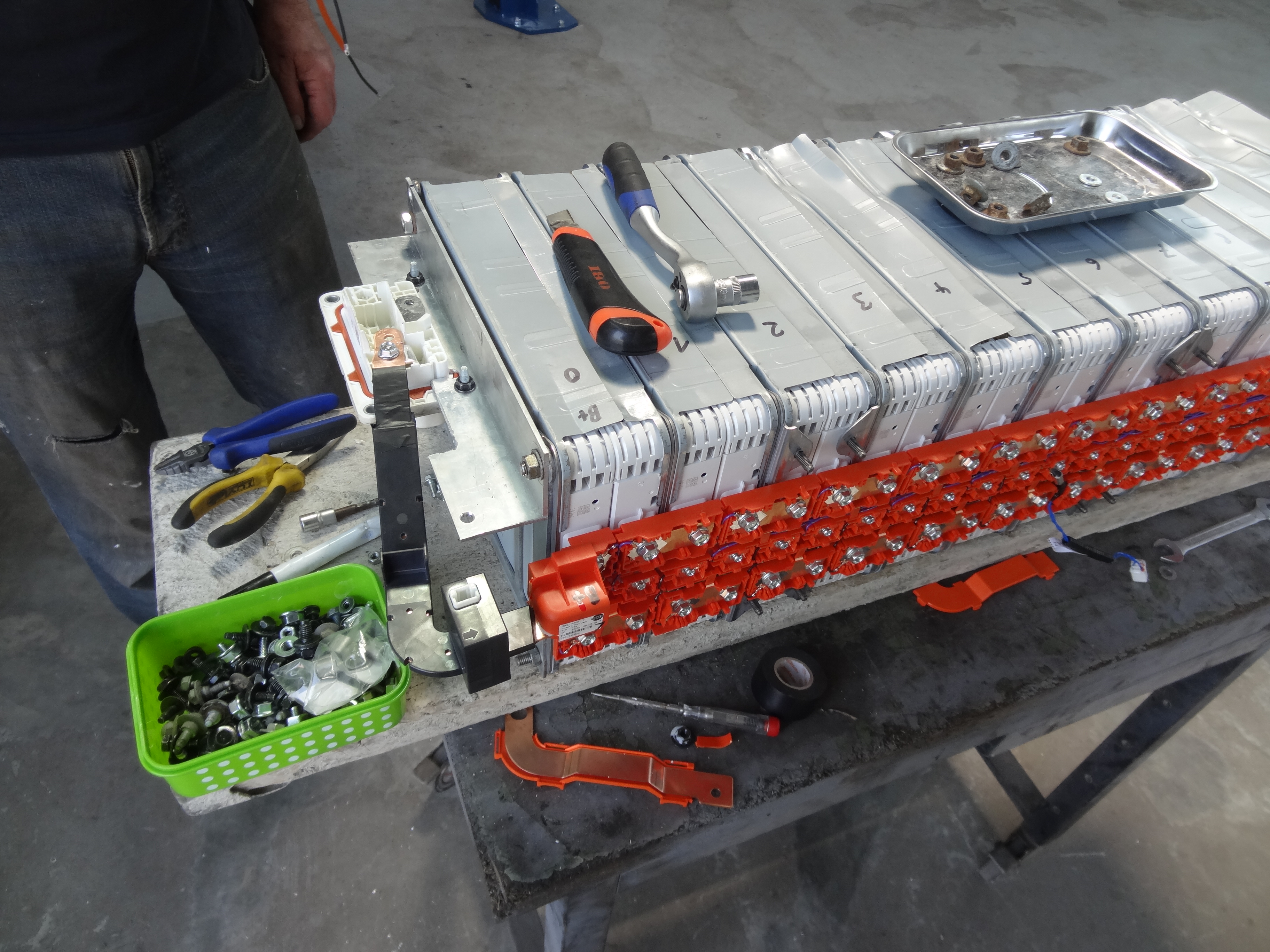

First day in the workshop today. We removed the 24 kWh battery and disassembled it. Unfortunately one pole broke but I think the electric connection is still ok.
First brick is in, we'll do the second brick tomorrow.

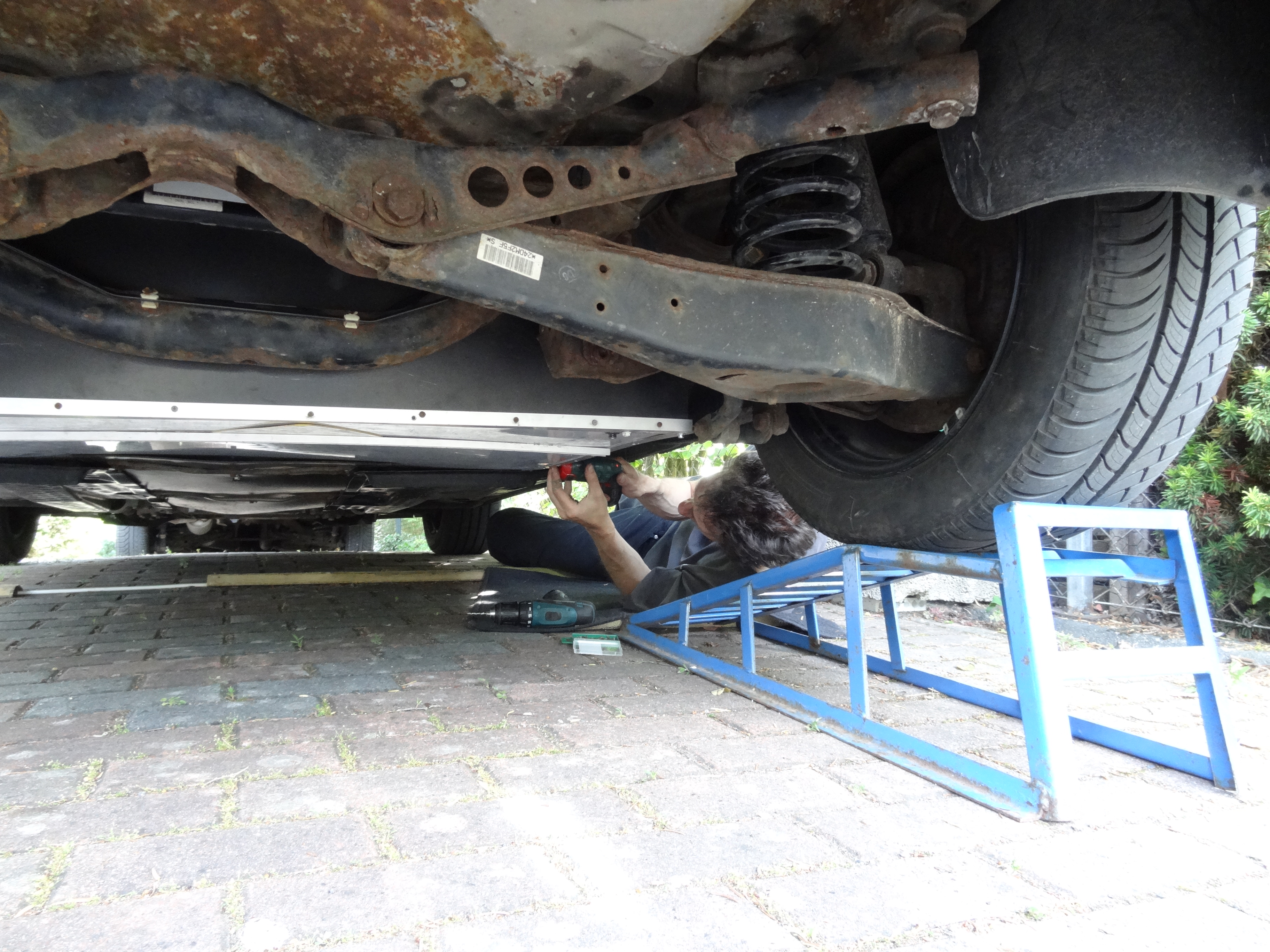

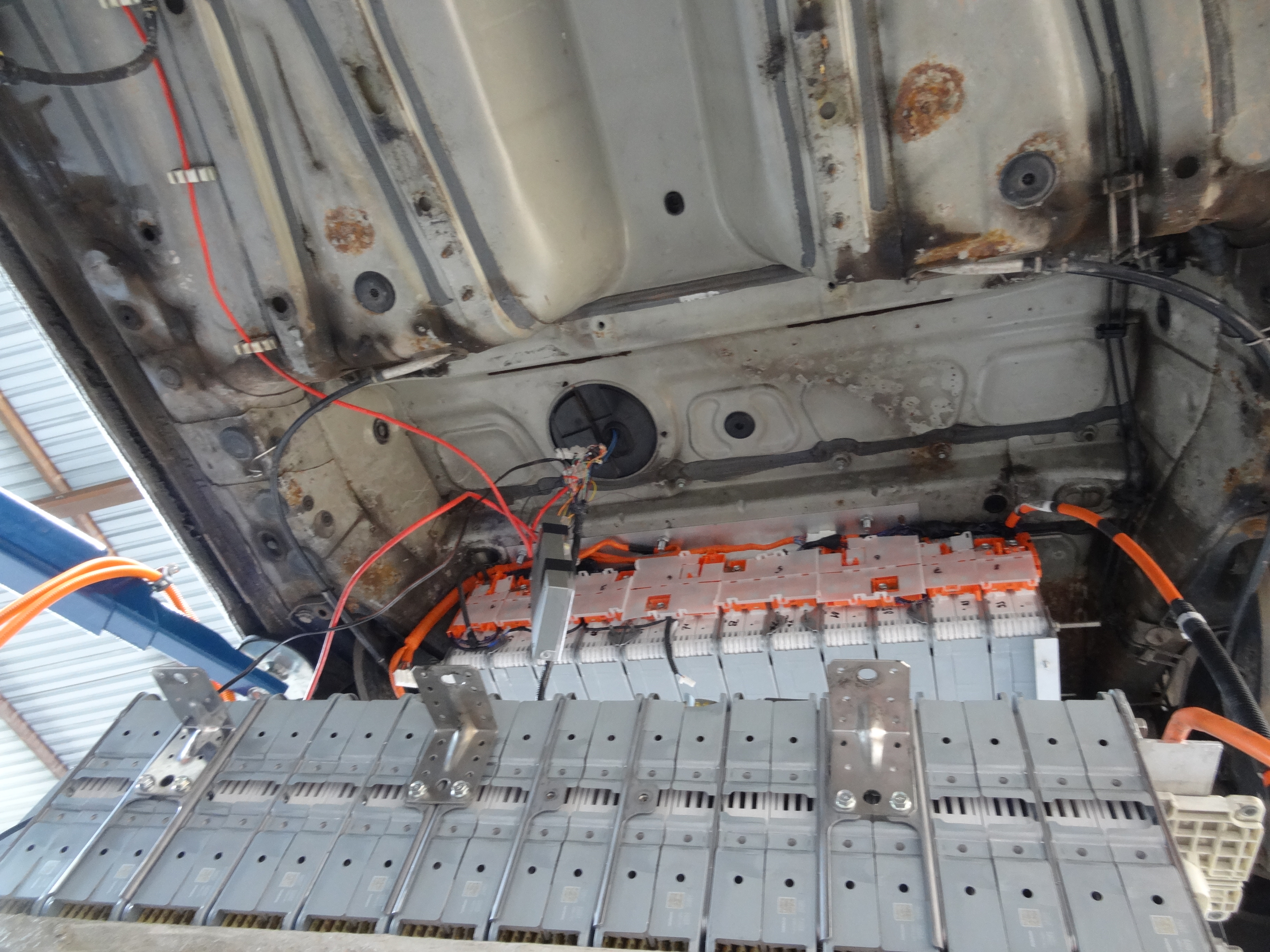

So, finally the battery is in :)
Once again it was super ugly because the bricks are so close together. There was already quite little space last time without pole covers, guess how little space there was with them. The final challenge was to limbo the nut with the narrowest possible extension between the bricks, tighten it, and hardest part, get the tool out again.
The BMS and current sensor are mounted much neater than last time but the BMS will need extra weather protection. Last time it sat on top of the front brick shielded of with some foam, now it sits on the side of the brick. Also I didn't need to deploy any hand crimped extensions.
The connection between the two bricks is a bit less neat, I attached two 10 cm long cables to the poles which need to be joined up after installing. Thats because the two UPPER poles are now connected and they are impossible to reach when mounted.

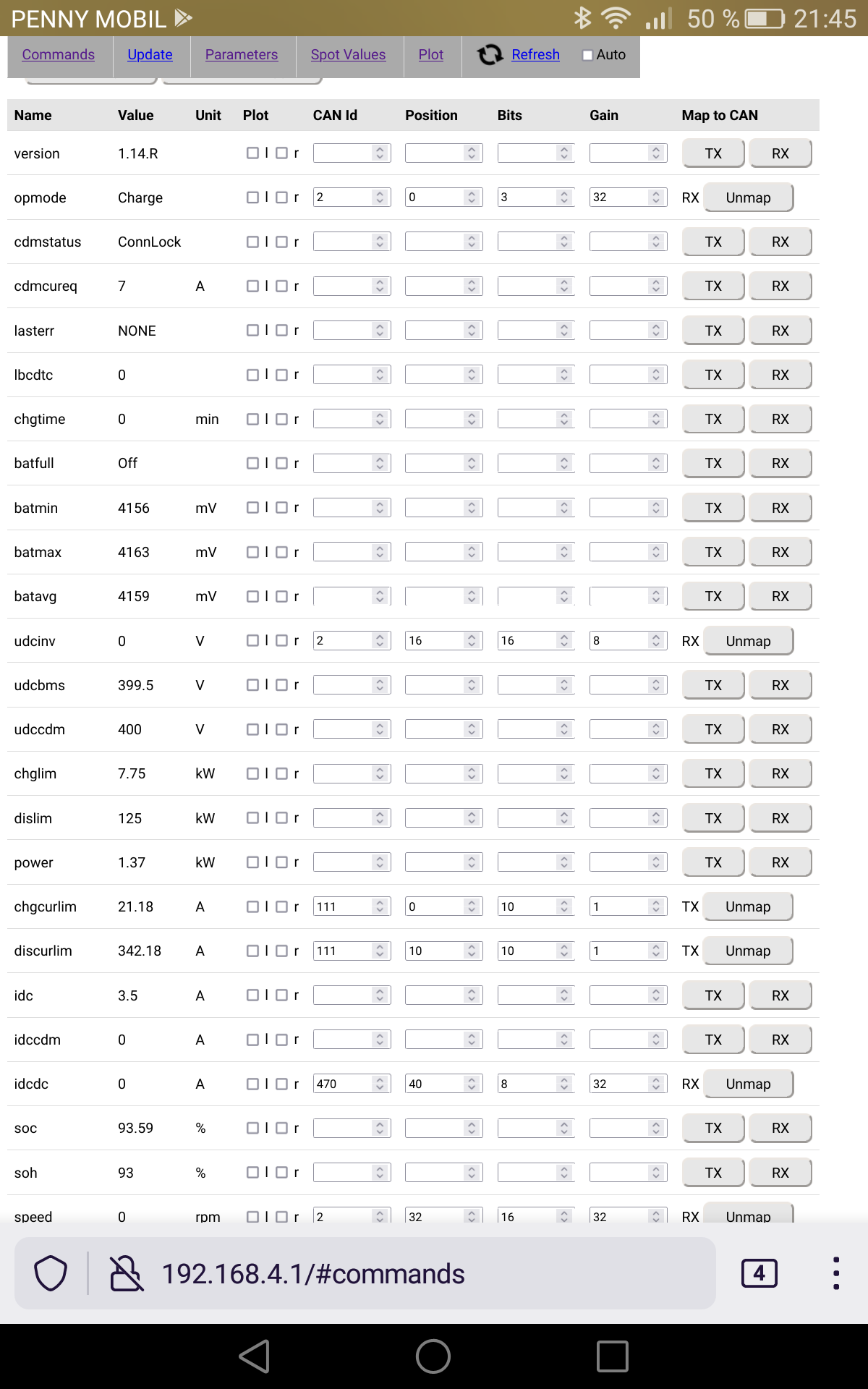

Alrighty, cover is back on. It was a bit harder to fit the passenger side cover because the LBC is now also mounted next to the brick and almost touches the chassis. Replaced the connection between charge relay and drive relay with one of the left over bus bars.
Now charged to 93% and it seems the voltage curve has changed quite a bit. The pack was delivered at 35% and 3.515V. So I wonder what they will be at at 0%. At 50% I saw about 3.75V and now at 93% it is 4.16V. So it seems Nissan allow the full 4.2V on the 40 pack as opposed to about 4.1V on the 24 pack. So I think I will limit the SoC to 80% unless I plan a longer distance trip.
Also quite amazing is the allowed charge power. At 50% it was still 70 kW and at 93% it is still 7.5 kW.

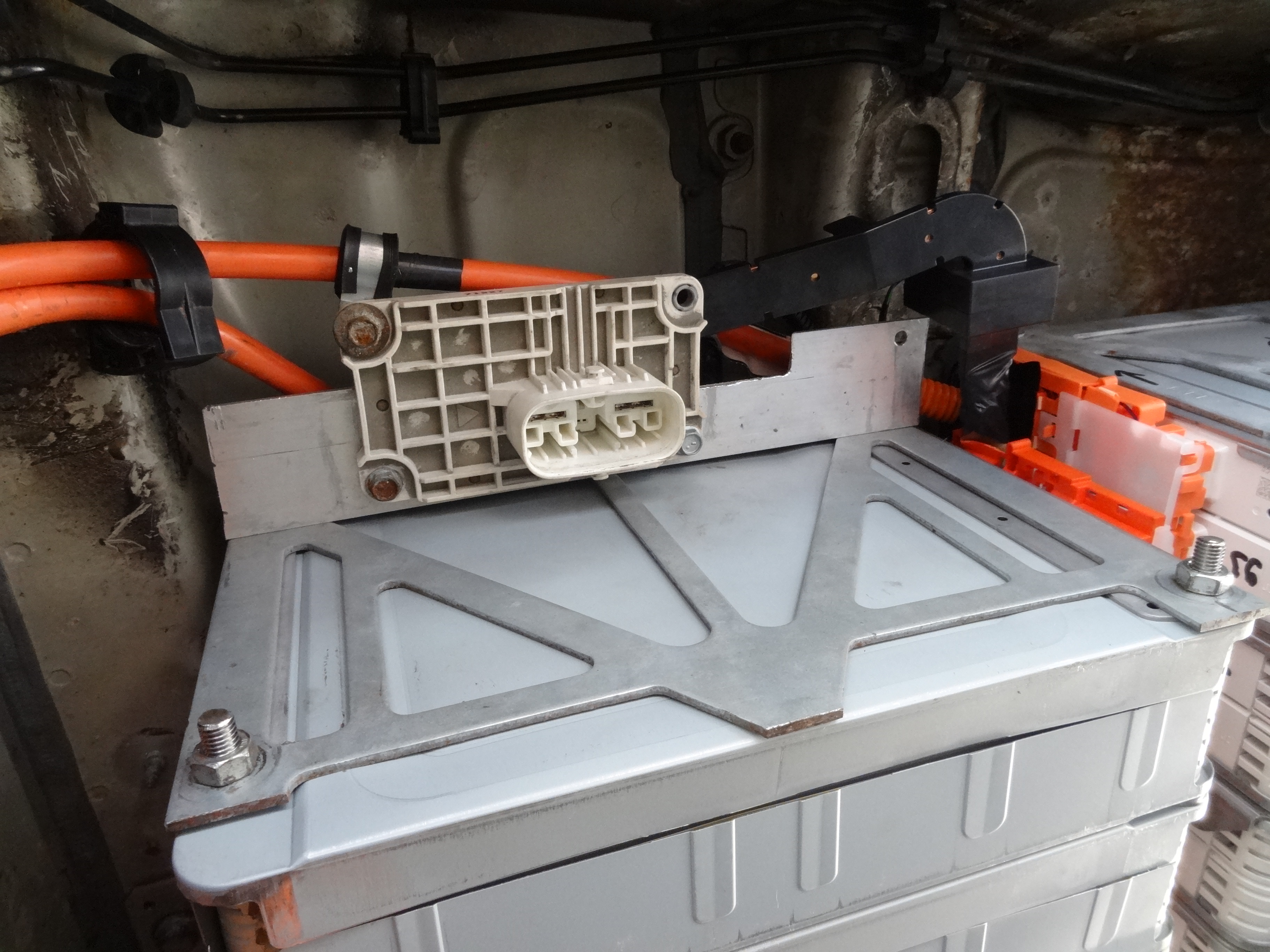

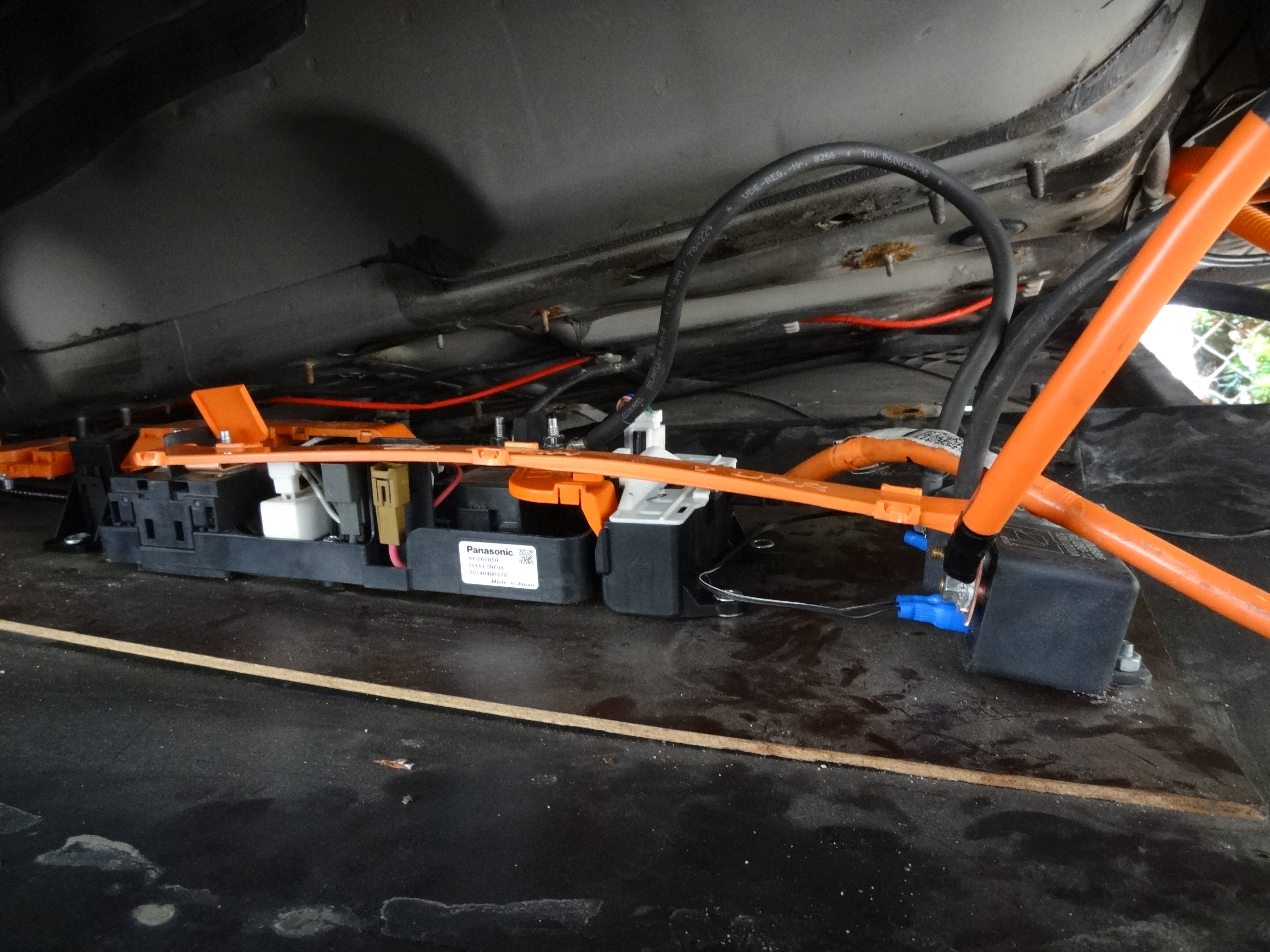

johu wrote: Sat Jun 12, 2021 7:55 pm Image
Would you happen to have the Nissan part number off the Disconnect Switch? You have the same later design as I, my pack came w/o the switch, the local breakers do not have one and the parts folks are less than helpful w/o a VIN :(
Thanks!
Time for ICE Melt
I only have the part number of the 24/30 kWh disconnect: 297C1-3NA0B . It is much the same, only the 24/30 one has the fuse integrated. The 40 model still has the mounting bracket for the fuse but no fuse ;)
I have my old disconnect left over, send me a message if you want it. I'll probably keep the fuse though.
