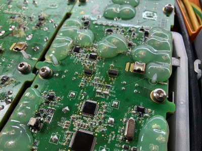

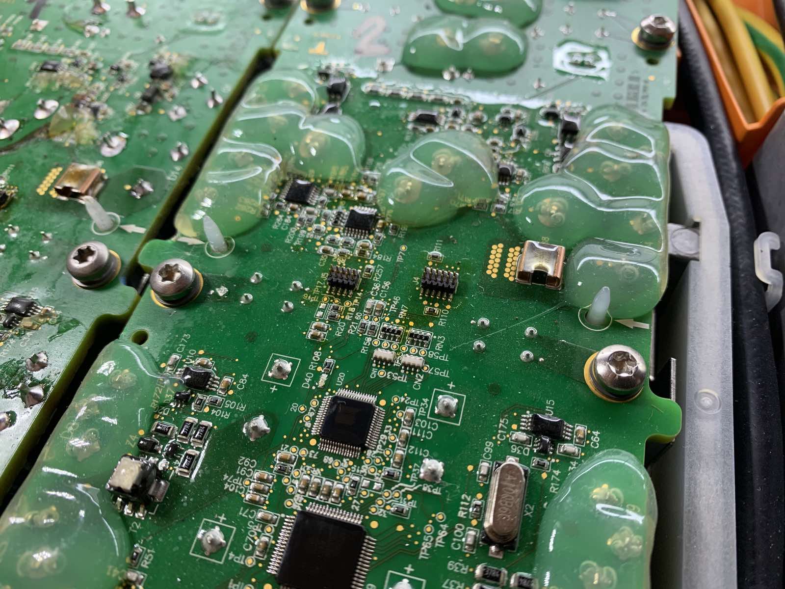

I'll check firmware between two power modules. There are two processors on the board - TMS320 F28935 from TI and Programmable Logic ALTERA 5M160Z E64A5N - I think all CAN addresses present in TI microcontroller. Can you recommend any hardware for download firmware from it ? There are connectors on the board, JTAG I think

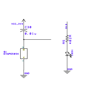

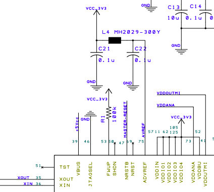

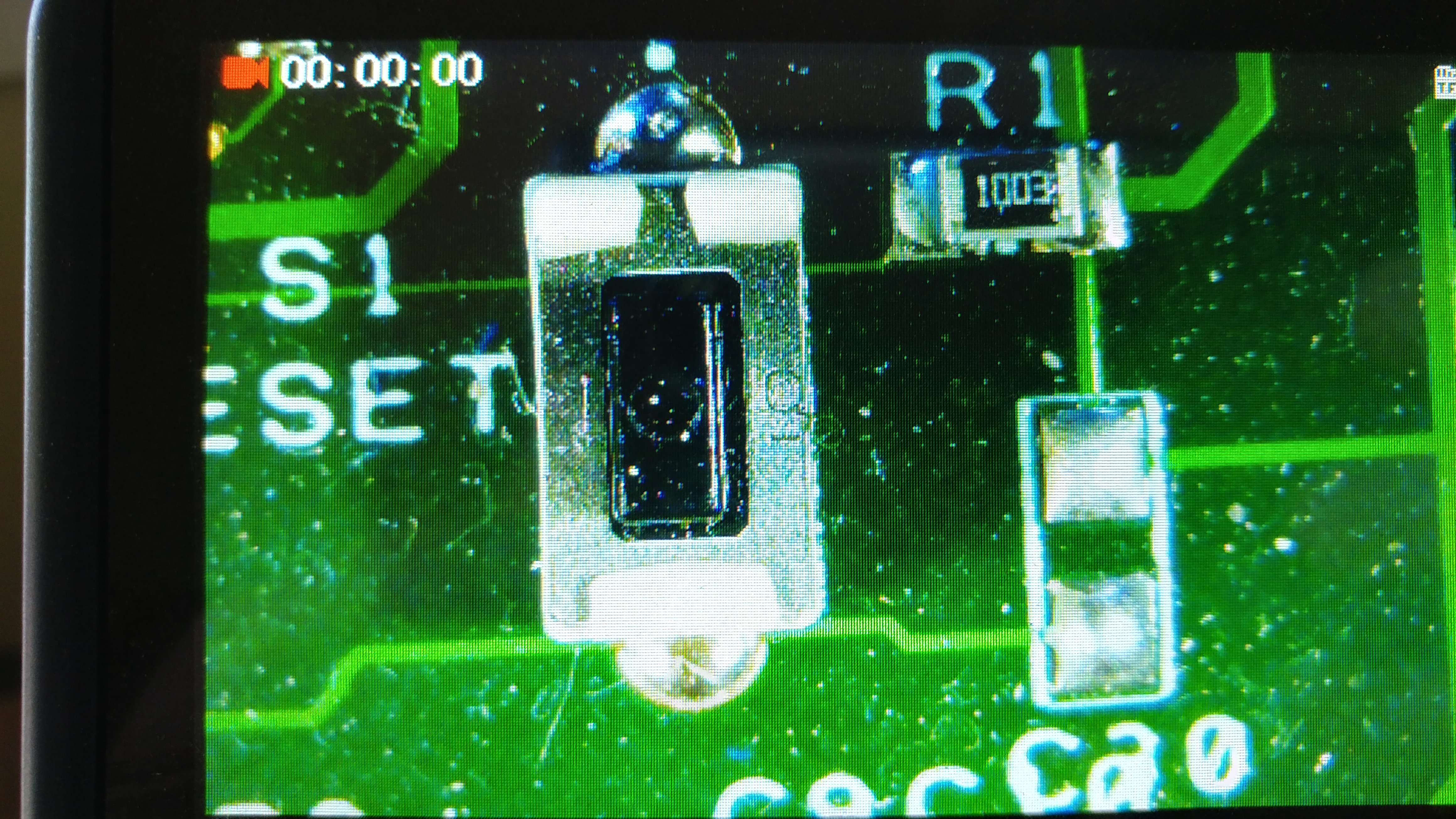

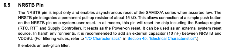

bulletbug wrote: Sun May 24, 2020 2:53 pm At this moment I still do not have a capacitor on the board in the C30 location.
Assuming the V4 schematic on GitHub (here) is the latest then C30 and S1 are not connected to the reset pin because net name MASTER_RESET is missing :?
The SAM3X8E datasheet says the reset pin has an internal pullup and that external capacitor is only required in noisy environments.

Kevin Sharpe wrote: Sun May 24, 2020 3:33 pm
Assuming the V4 schematic on GitHub (here) is the latest then C30 and S1 are not connected to the reset pin :?

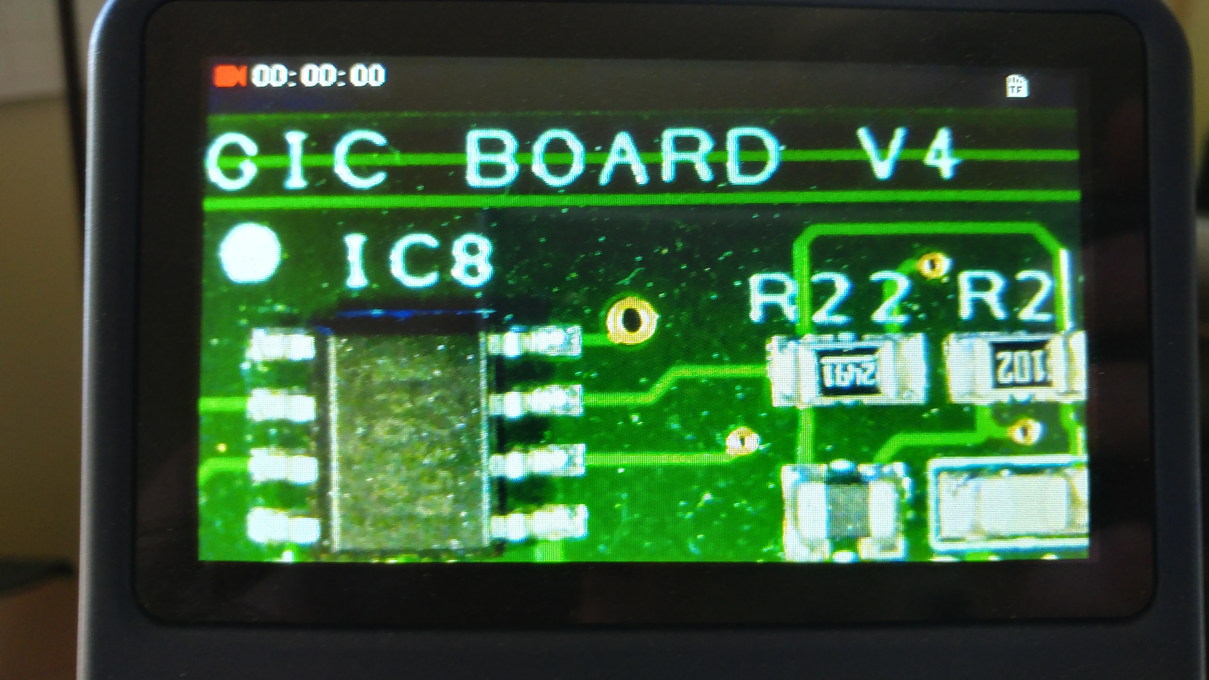

Here's what I'm seeing on the board. Although the silkscreen is obscured...the empty spot is c30.Image

bulletbug wrote: Sun May 24, 2020 3:44 pm Here's what I'm seeing on the board.
Are you sure that's a V4 board?
bulletbug
Posts: 94
Joined: Thu Sep 26, 2019 5:12 pm
Location: West Jordan, Utah USA
Post by bulletbug »
Kevin Sharpe wrote: Sun May 24, 2020 3:47 pm
yes.

Post by Kevin Sharpe »
bulletbug wrote: Sun May 24, 2020 3:51 pm
yes.
Ok, so I can think of two possibilities, the GitHub schematic is out of date or the reset pin net name is not visible :?
Can you run a simple test? What happens if you press the reset button?
If the board resets then you could fit C30 but given it's only recommended in noisy environments it's unlikely to be the source of your problems unfortunately :(

Ok. I power up the board through the molex 12v line. A single red LED comes on. I press the reset button. LED remains constant on.
Alternatively, I press and hold for 2 seconds...LED continues to remain on.
Is an LED blink what you're suggesting I should see?

bulletbug wrote: Sun May 24, 2020 4:03 pm Is an LED blink what you're suggesting I should see?
I have no idea what the LED should do during reset. Try pressing the reset button when you're communicating with the charger via the terminal programme.

You are correct. Initiating the serial communication and pressing the s1 button, resets the serial communication streams timestamp. I'm assuming this confirms that the board is then reset.

bulletbug wrote: Sun May 24, 2020 4:14 pm
Kevin Sharpe wrote: Sun May 24, 2020 4:05 pm
Ok, you've proven the reset switch is working and the issue is with the schematic (i'll add a comment to GitHub for future reference).
I suggest you fit capacitor C30 if the BOM says that's normally fitted (this ensures your board is the same as those used by other people). Unfortunately, I doubt this will make any difference to the issues you are investigating.

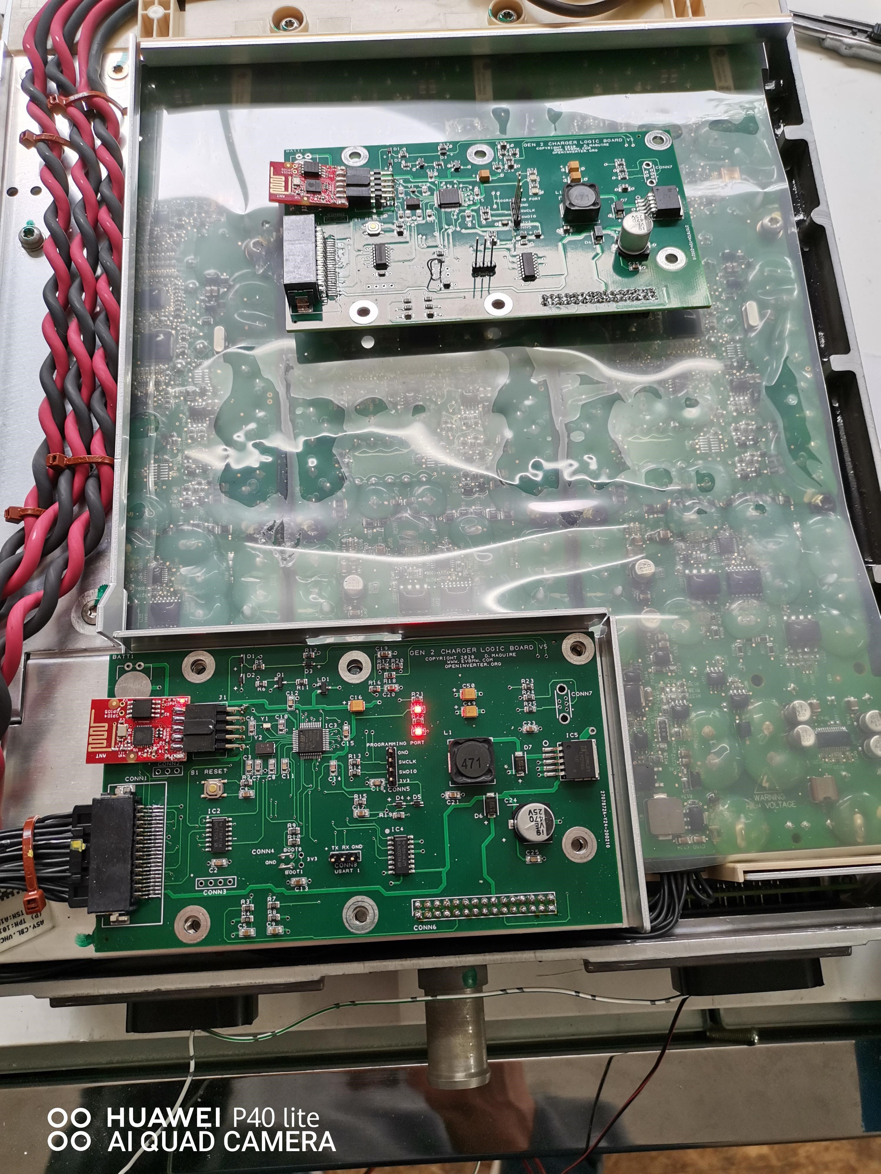

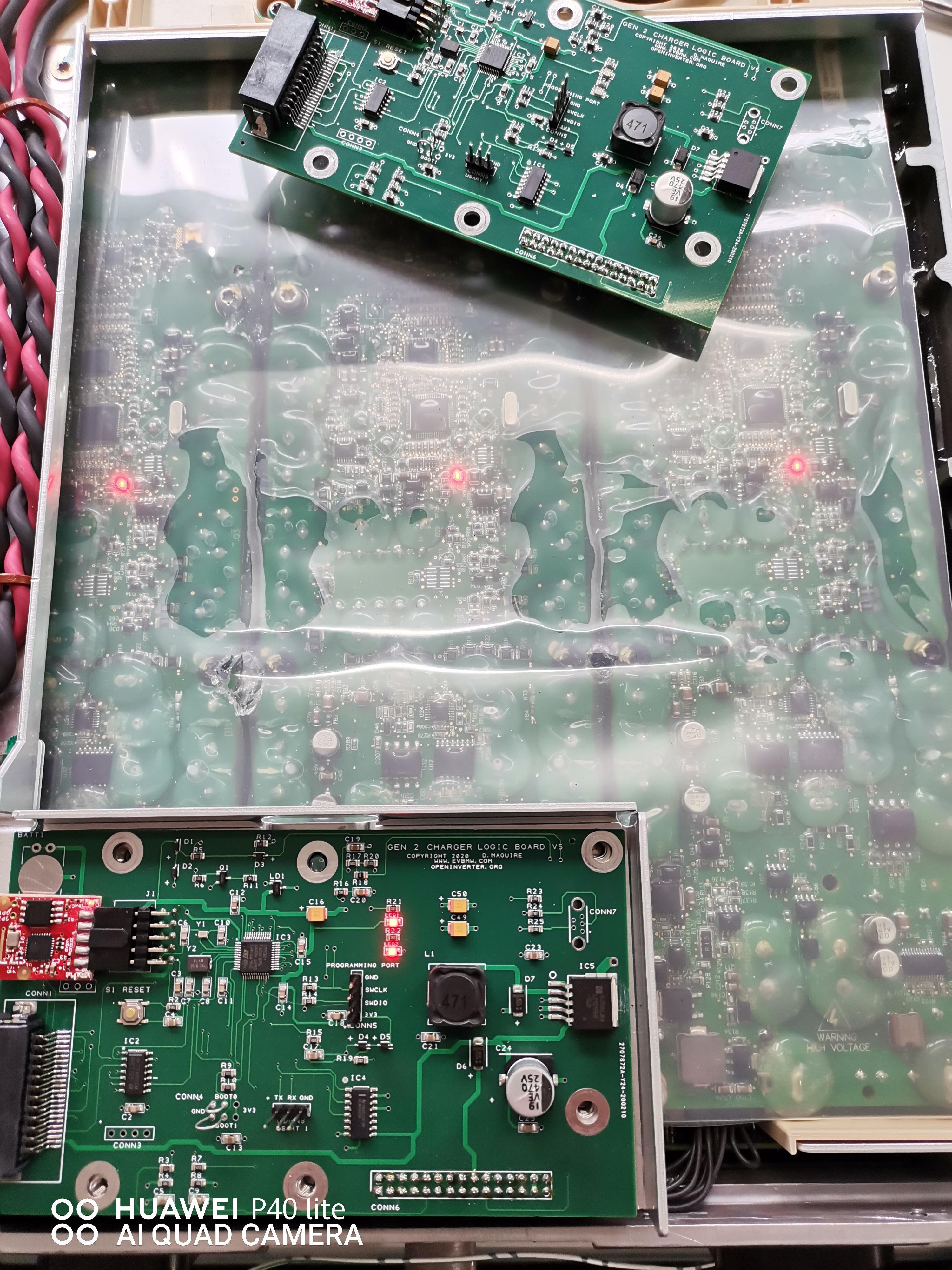

Hi
I have two V5(build+tested) controllers for gen2charges here.
One eneble the modules the other not.what does it mean?
Of course i will start with the working one.I checked the wifi.ok i found the gauges fullon!
I think i need to make a cable for the prog.port!?Is there any pinout ?
Then making configuration with serial monitor and it should work?Is it in that way ...?
Kevin Sharpe
Posts: 1339
Location: Ireland and US
Been thanked: 10 times
nesto1972 wrote: Mon May 25, 2020 7:45 am I have two V5(build+tested) controllers for gen2charges here.
I think it means you need to get an electronics engineer to help you :?
