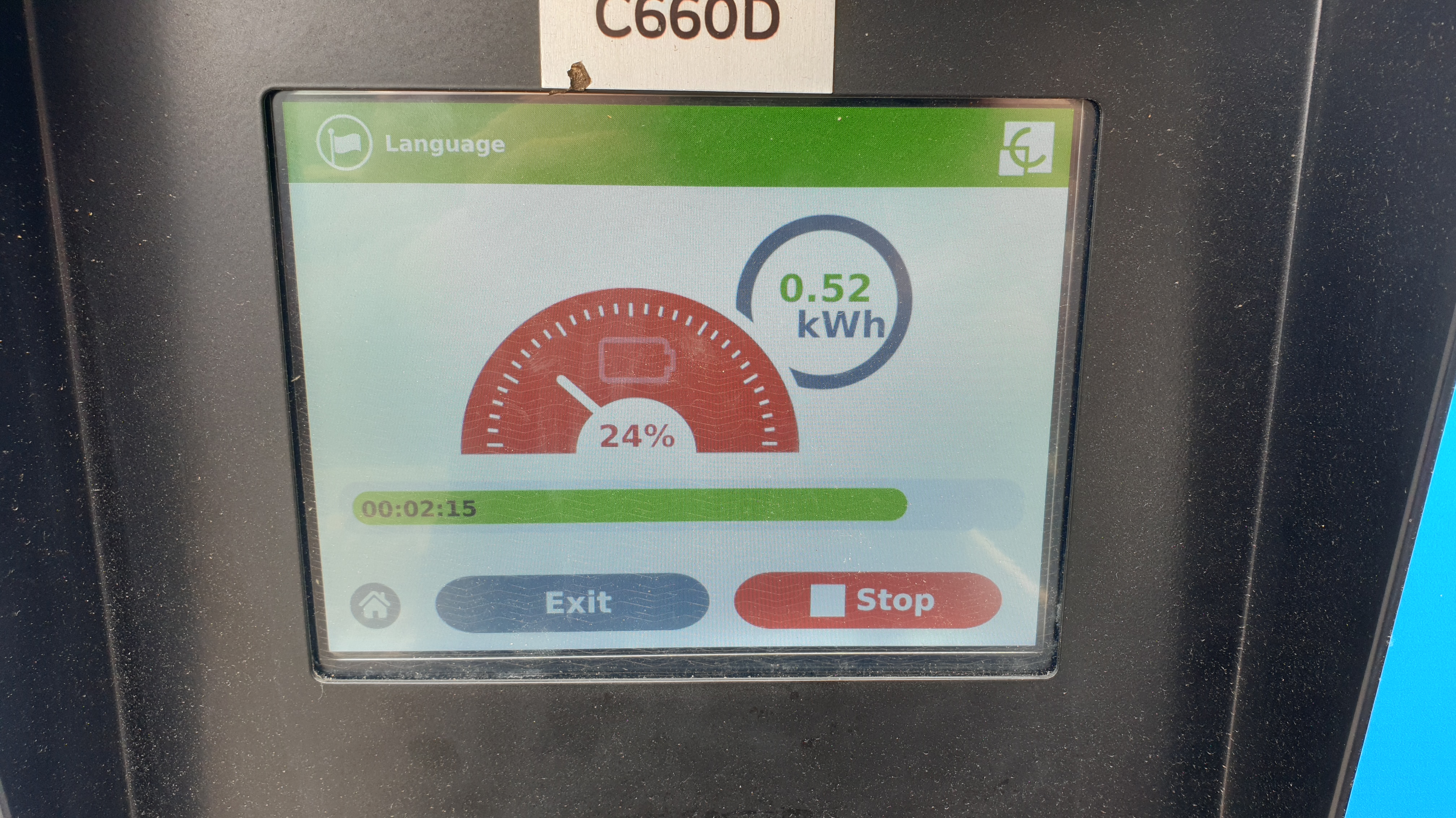

And to verify that you are sending what you intended (and to prove I’m not bsing):
Efacec23.pcap- you’re requesting 51 A, voltage limit 400v target 400v, EV maximum current limit 125A, remaining time to bulk soc 1800s, remaining time to full soc 3000s. You’re also in EV ready, no error, soc is 24%, bulk charging complete is “no”. Total capture time is 1.455 seconds. I lose the station packets 141 ms in, for the rest I just see your requests.
Efacec24.pcap- 20A request. Everything else is the same. Total capture is 1.459 seconds.
Efacec25.pcap- only 5 frames of homeplug. Appears to capture slac parameters at the very start of charge. (CM_SLAC_PRAM.CNF and CM_START_ATTEN_CHAR.IND)
Efacec_startup2.pcap- identical to ‘23pcap. You’re in the current loop requesting 51A. Capture lasts 1.38 seconds. I lose the station packets 141 ms in, for the rest I just see your requests.
Ionity2.pcap- almost identical to efacec25, 5 frames of homeplug.
Looking at the time stamps, I think we are off by an order of magnitude, so 15 seconds instead of 1.5, add a 0 to all the times I mention above.
Not sure why I’m losing the station to EV packets. Will need to look into further.

Post by CCSknowitall »
Fantastic! I can see now. :)
You’re setting a voltage limit of 386V during charger parameter discovery, but then requesting 386V during precharge. Unfortunately efacec25 cuts off before the current loop, so I can’t see if this switches during your power delivery request and current loop. I think it does because startup2 showed max voltage limit of 400v.
You should set a maximum a few volts above your target voltage (target being your desired pack voltage during voltage mode if you use that). I think on the can side the lim is reusing inputs during various states, and during charger parameter discovery the EV target voltage input is used as the EV maximum voltage value sent over plc .
On the PLC side, the car should not change its maximum voltage limit between discovery and current demand, and some stations may store and use the limit sent during the discovery phase. Sending EV maximum voltage is required during discovery, but not in current demand. Some stations may ignore the limit sent in current demand. So an inconsistent behavior between different stations could be caused by this.
You may have other issues too, I will check some more in a few hours.

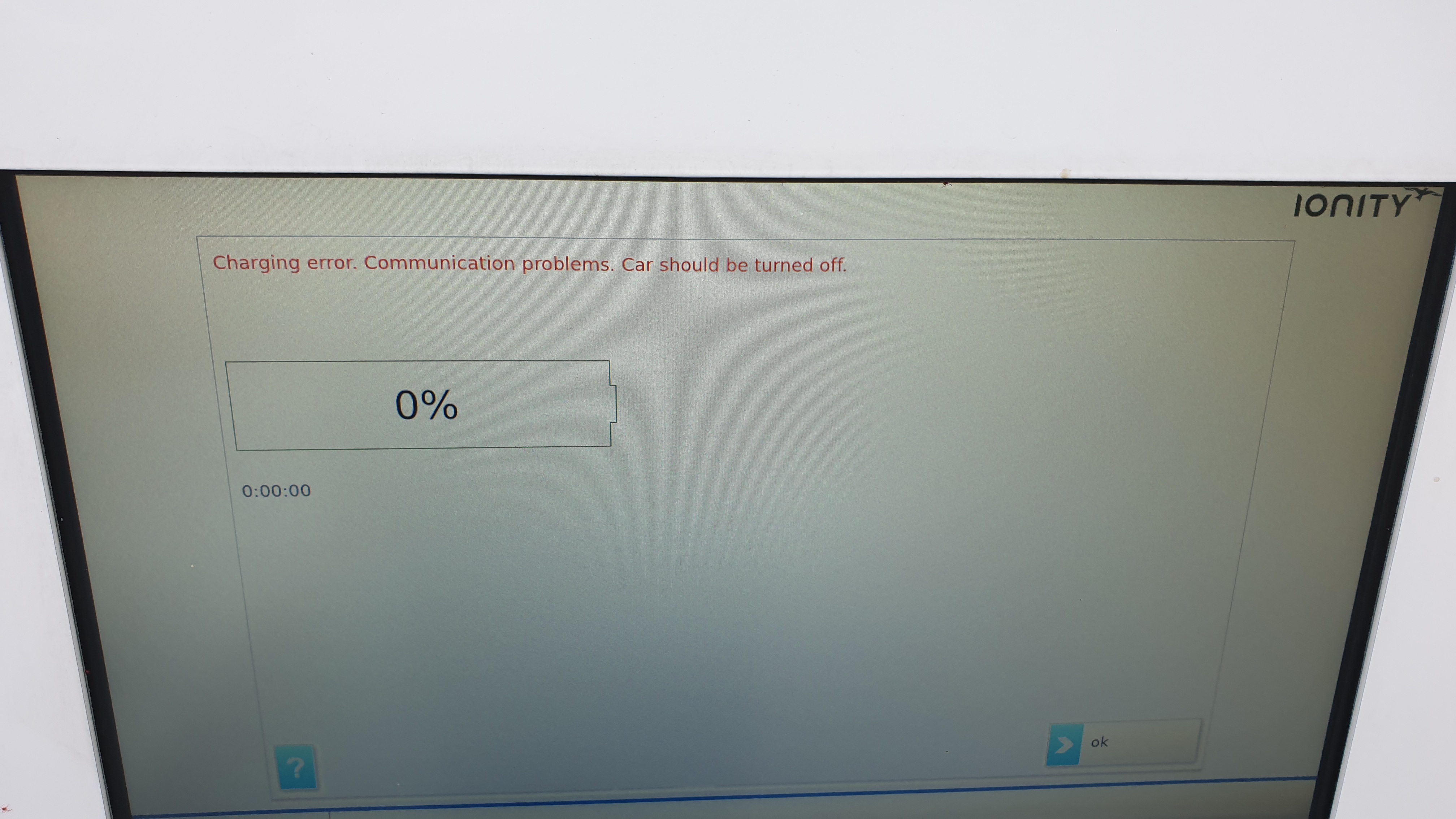

Mr.Ionity still doens't like me and complains about power availability even with plenty of money on my account. I did a capture and let it fully time out and got the attached on the screen before unplugging.
Now I caught something interesting. After pulling the plug I caught a burst of spi data. In afterplug.sal

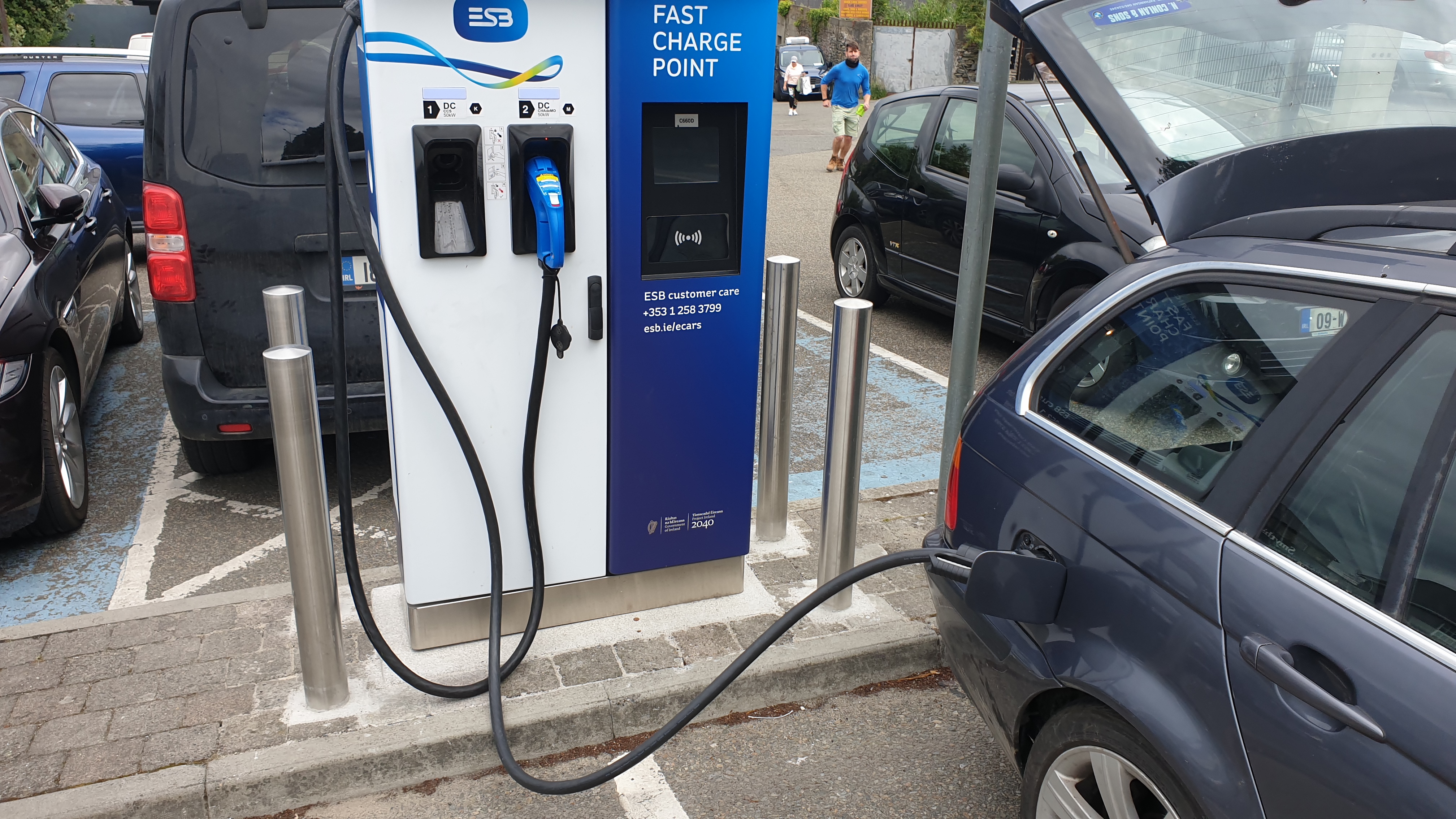

Gassing up the car now and fortifing myself for a trip to the worst located charge point in the entire country to get a Circontrol capture.

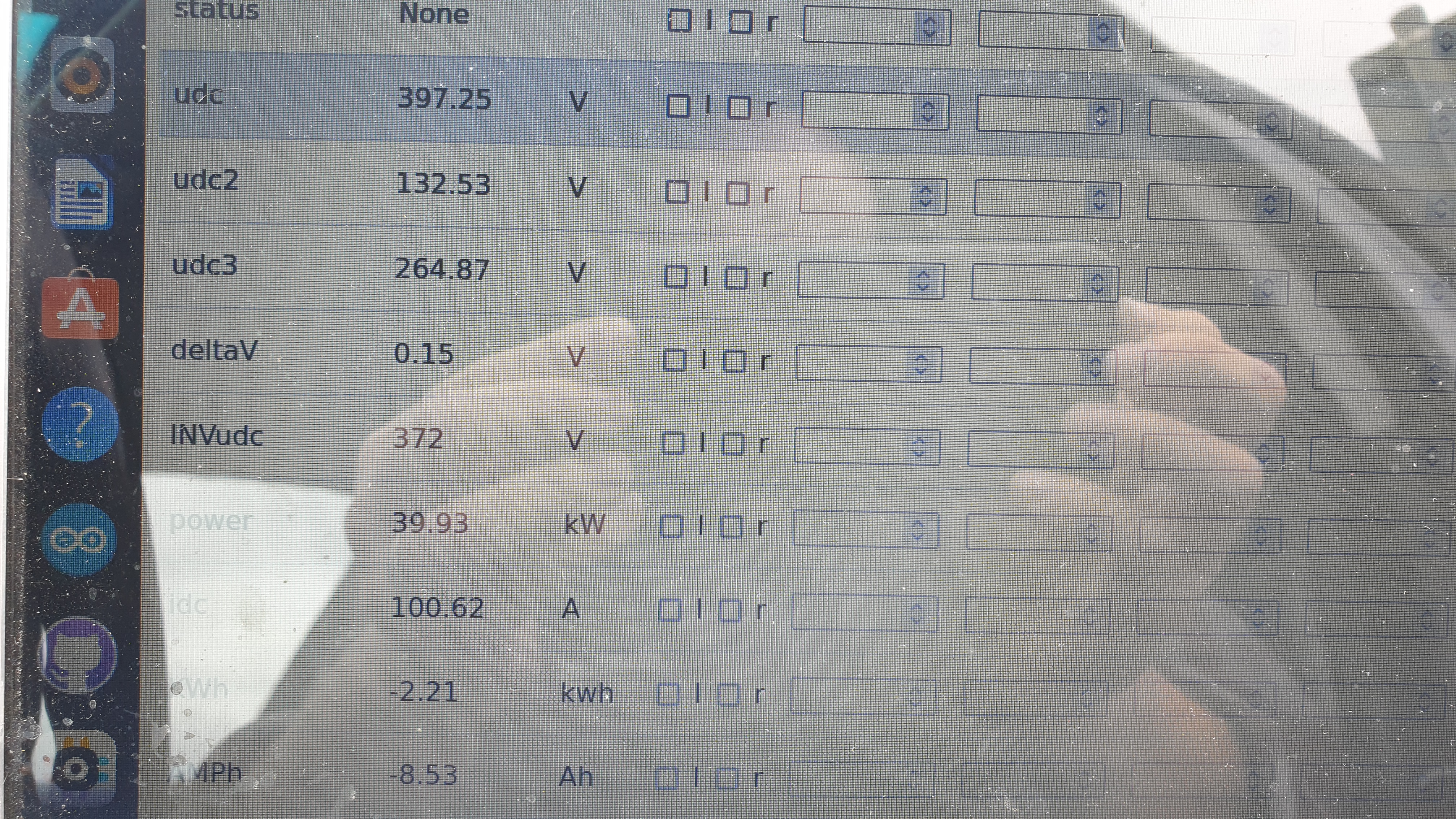

Sooo....I guess they don't call you the CCSknowitall for no reason:) First successful charge on a Circontrol Rapition 50 today with the modified Vlimit behaviour.
Captures on the repo :
https://github.com/damienmaguire/BMW-i3 ... Caps/Part3
cirstart3 is probably the best. All the way from plug in to ramping to 100amps.
the others have various fails. Seem ol mr.cir don't really like you asking for 125Amps.
charged in bulk phase for about fifteen minutes before it tripped out with charge error on screen. Sorry I didn't catch that. Guessing its not liking all the timers ans soc staying static.

The ionity thing has me driven a little mad. I even called their support line. Rebooted the charger etc. No joy. Support can't see any feedback info from the charger either.
Edit: huh. We never even see the SLAC commands in the ionity file ...

Ionity_fail1.pcap - No idea what's going on here. There's no high level packets in the pcap. And the MAC Ids here are not yours. I wonder if you (er, the chip) is picking up another station's PLC. Since you aren't going into SLAC, I wonder if you are not getting a good connection to the cable. Try holding up/supporting the cable until the lock engages. This is an issue in CCS1 markets with liquid cooled cables. You have a different port and a different cable than what normally causes this, but it's worth a shot. I would put a cheap scope on the pilot wire and make sure you have a solid connection. You should see the low level 1kHz square wave easily.

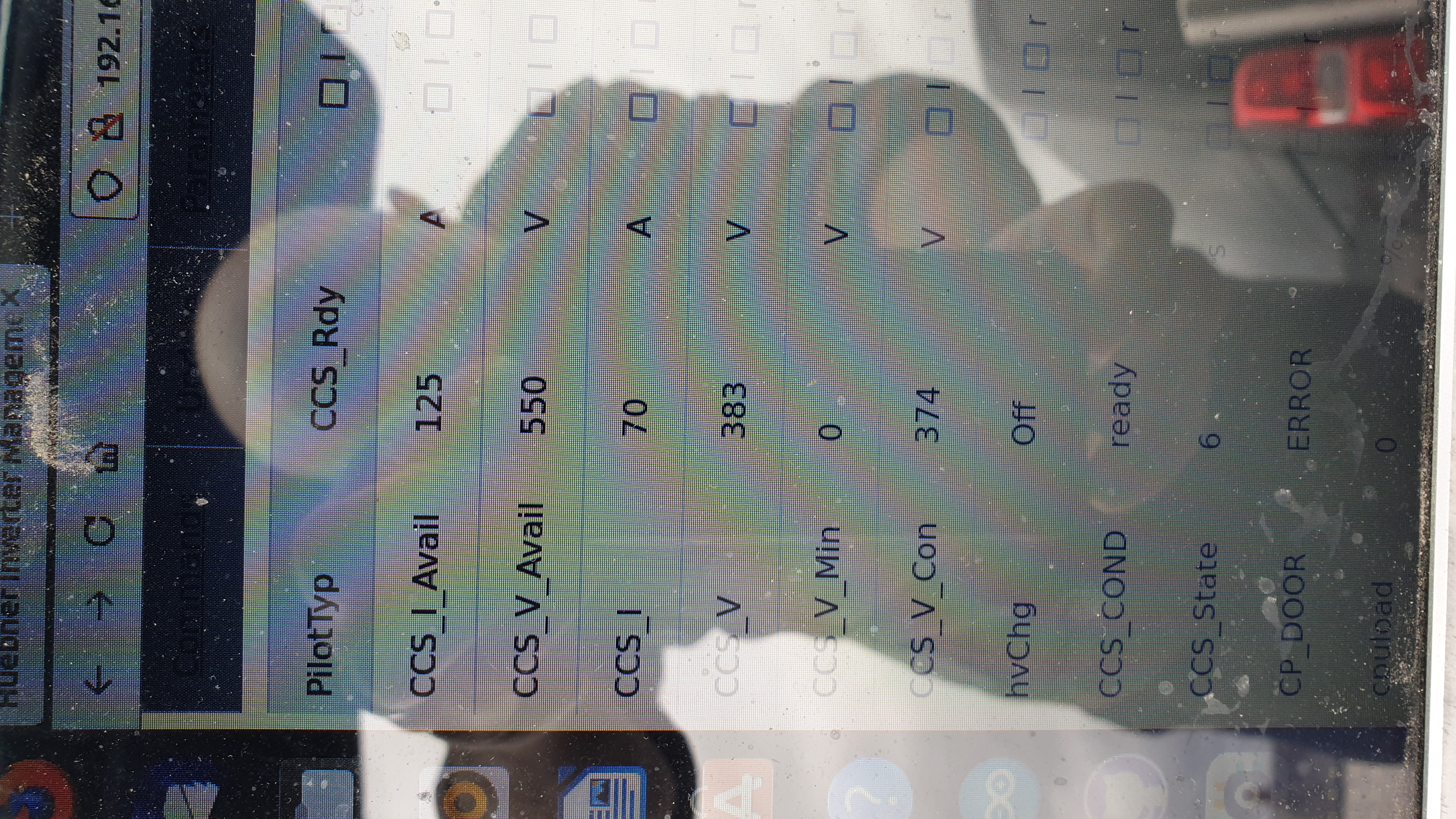

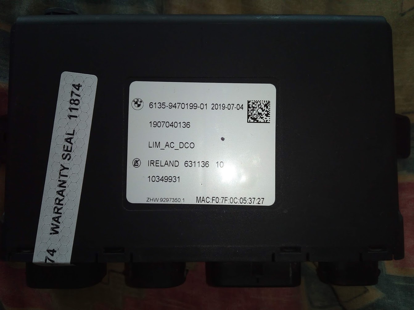

Ok I need to find where the battery and cabin conditioning is set over can and shut them off.
So regards contactor control. That is handled by the LIM. I can request a contactor close but if I do something silly like ask it to close during cable test for example it will ignore me and shutdown. All of those captures were run on the same day with the EXACT same firmware in the vcu. Efacec closes at the correct voltage yet Circontrol closes wayyyy too soon. Hmmmm.
Can the software folks take a look here and tell me if I'm being stupid....again...

The idea is we wait for the voltage measured by the LIM at the EVSE side of the contactors to get less than 20 volts under the actual measured battery voltage and start counting cycles through the state machine. Each cycle takes 200ms so 10 cycles , 2 seconds the voltages must match before we request a close. I wonder is this delay too long for the Circontrol and its actually ramping DOWN when we close but just right for Efacaec....
I think you are dead right about the ionity plug issue. I actually called their support line and the agent was adament about having the plug inserted fully and asked me to hold it in place at one point. That and my crappy cheap Aliexpress ccs socket.... Yeah. Need to do some investigations.
Edit : I am sending a CV target of 398V and a Max of 402V over can to the lim. I suspect the 2014 LIM doesnt use the seperate target value.
Edit 2 : From what I can tell on the CAN side (0x03c) I am not asking for air con or battery conditioning. Searching for any more...
