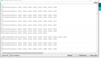

Hi tom,
Unfortunately the current garbage values still exist.
I added the couple of lines to my code and the problem still presisted,
then i decided to flash the hex file you uploaded yesterday to make sure it isnt my code and issue still there.
check the pictures i took from the debug.
that's the current sensor reporting on canbus, the current is really zero no flow going through it.
and this is the current debug and shows way big or garbage data.
i think RawCur and getcurrent functions are the trouble here,
will look at the code and hopefully i can catch the issue.

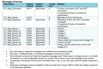

7yatna wrote: Thu Oct 27, 2022 6:17 am check the pictures i took from the debug.
The standard broadcasting is defined the user manual for the shunt. so you need to see 0x521 for current.
I bench tested it, so the problem is on your end.
So if you do not see 0x521 on the canbus it wont work.

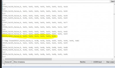

tom91 wrote: Thu Oct 27, 2022 9:03 am The standard broadcasting is defined the user manual for the shunt. so you need to see 0x521 for current.
Hi tom,
Yes i agree and that's the very first thing i verified since last July when the problem started, and of course this week when the problem persist.
so if you see my attached picture sorry i didn't highlight the 0x521 but it is in the middle to lower end line but here it is highlighted in this one
the current sensor is reporting 0x521 all the way to 0x528 and is working fine. as well if i disconnect the current sensor from the network the garbage values stops.
meaning the 0x521 id is contributing to the issue.
i agree the problem might be on my end, but the current sensor and can network and 0x521 is out of the picture.
sorry to pick your brain on that. i will debug code and see where the problem might be.

Garbage probably due to you having set the byte value in reverse so its little endian as byte 2 contains something.
The standard message is Big Endian.

tom91 wrote: Thu Oct 27, 2022 4:43 pm Garbage probably due to you having set the byte value in reverse so its little endian as byte 2 contains something.
that what i actually was thinking. little vs big, i didn't intentionally do so but i will figure a way to reverse it :D
so after all it is my current sensor being a square ??
haha sorry tom. will spend sometime reversing that then report back. need now to figure it out.

tom91 wrote: Thu Oct 27, 2022 6:11 pm Please insert the (long)(.....) back as it keeps it formatted right and you do not get errors with the signed value.
I must say I never initialised it I just ran it as it came. Have done so on all ones I used so far.
Hi Tom,
wanted to report back that indeed it was a little endian vs Big endian issue. i confirmed it by looking at the script code i used to initialize the IVT-S Sensor it was reading back in little endian.
so after adjusting the SimpBMS to little endian, All is good and i have fully working system.
over the weekend i did the first full charge cycle on the pack. current is reporting Ok both ways, Balancing is active and with my little modified code it can report on the screen if it is balancing or not.
if you remember my pack is
3 Parallels BMW 530e Packs each has its own current sensor, SimpBMS, Contactor boxes and fuses.
the main SImpBMS is configured to read the main current sensor so it is reporting capacity and discharge as total
the other two packs are only reporting their own data.
it is working OK except one of my packs that uses analog sensor is not calibrating the offset correctly. so SOC current info based isnt accurate.
do you think it is good idea to make SOC as strictly voltage based ?
well thanks again for supporting my crazy idea for the longest time i will report back with some pictures.
Hammer, Duct tape, WD-40 that`s it :D

7yatna wrote: Mon Oct 31, 2022 5:48 pm do you think it is good idea to make SOC as strictly voltage based ?
Yes voltaged based SOC is the "cleanest" way of doing it, with analogue sensors. I have purposely not supported analogue sensors in my new products.
Best to do is tune it a bit when the vehicle drives, but does the "main" SimpBMS not use the IVT shunt and just do all the current tracking in and out for the full setup? Or have you wired it as 3 seperate packs?
How are they wired? 3 parallel strings or is it 3 packs that are put in series?
