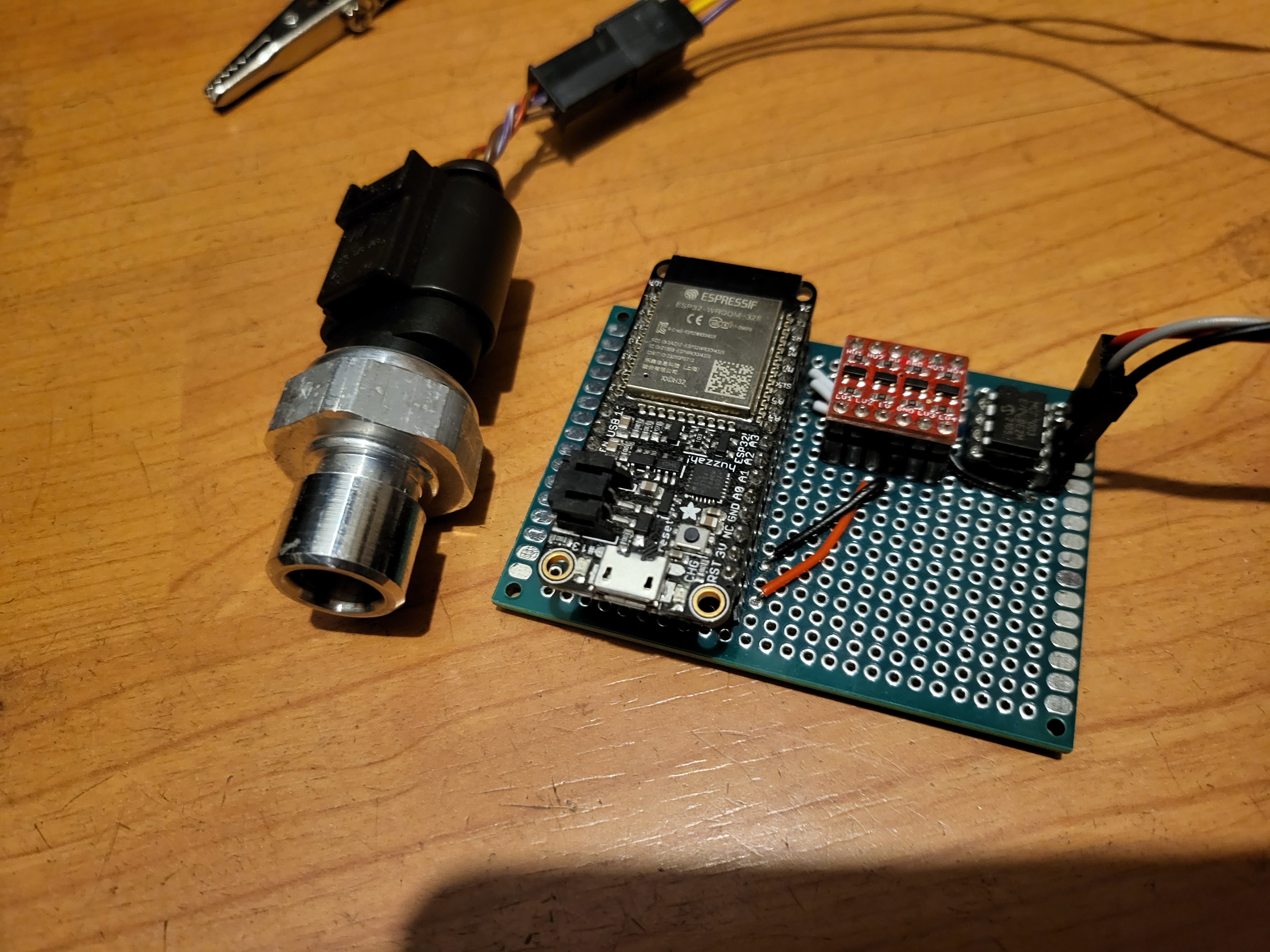

Great plot @pete9008
the data should be very accurate as i emulated the pressure sensor and read the values of a factory climate control module via diagnostic.
its a shame i don't know what byte 3 and 4 do as i couldn't see any values on diagnostic change.
I was trying to do the same with sending the compressor data but the climate control wasnt happy with that one.
i will get round to the humidity and temp sensor next.

its possible that the the other 2 bytes are fine value. Like 0-4bar representation. and that the other 2 bytes are course.
So to get the total pressure you calculate the 0-4bar values and the course value and sum them up.

i will give it a try tomorrow but when i applied pressure the the sensor (in a previous attemp to get some readings) i didnt see those values change

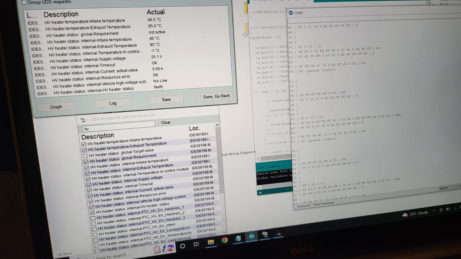

I just simulated the AC pump to the climate control and got some values. They seem very different from muehlpower results but these are from VCDS so i trust them. i didnt not go thru all the error and status options but i will in the future.

i just done the HV heater this was my results.
