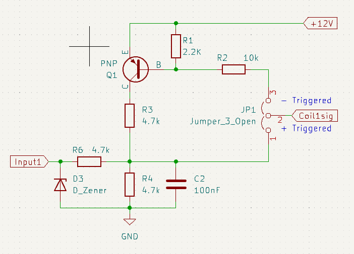

I added a solder jumper to select + or - triggered, otherwise the circuit is very similar to the last run. Anyone see any issues with this? C2 is to debounce the input.
R6 shouldn't do much unless the signal is over 5v. Then the Zener will clamp around 5v to keep the DRV103 Input turn on voltage from going too high and R6 will limit current when shorting. Ti may have said it was ok to go higher but its a simple thing to prevent issues.
BC857B-7-F is an extended part ($5 charge for each batch of extended parts) I might swap it to a basic component. I think the DRV103 is the only extended component this will need.

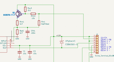

This was the previous version,

I simulated the + / - trigger part of the circuit, I believe it works as expected. The left 2 position switch flips between + & - triggered, this will be a 3 pad solder jumper.
The right 2 position switch flips the enable to + or - to simulate a ground or +12v turn on.
https://everycircuit.com/circuit/4812355044900864
Any input / feedback?
I have an unrelated circuit using a TI high side switch, I've had 2 short out on the enable line. It's a similar protection circuit as seen in this design. The other chip doesn't say anything about the enable line voltage needing to be equal or lower than the input voltage like this drv chip specs.
I haven't thought through how to do a simple & effective protection for that. Just a diode to feed power from the enable line over to the input will have the diodes voltage drop and the drv chip will still very likely blow...
