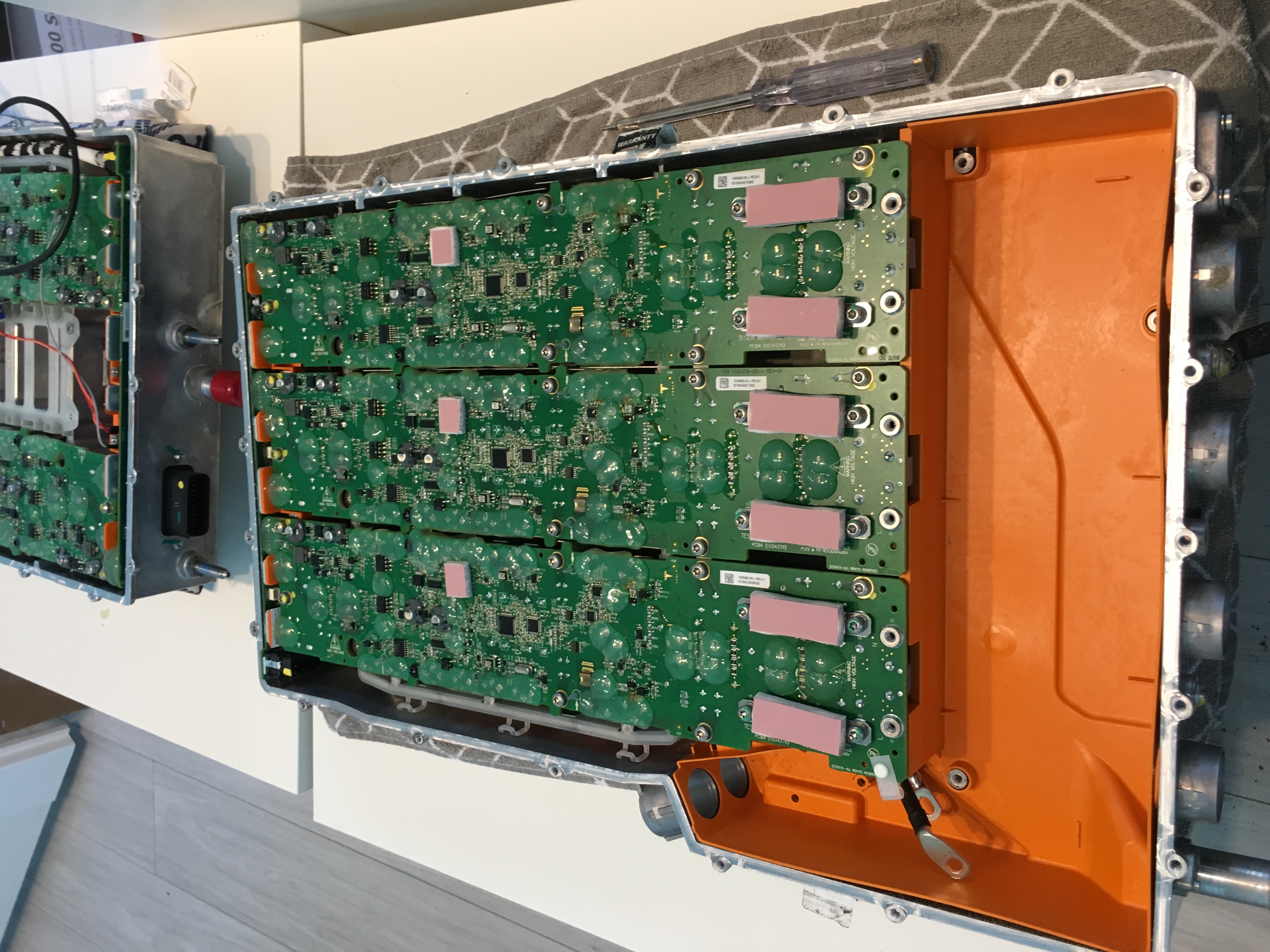

Does anyone know the coolant flow direction for the gen.2 charger.
50% chance I mounted it the correct way
It looks like this inside the coldplate:
- Posts: 4007
- Been thanked: 1139 times
I have ran coolant in both directions without problem.

Phase 1 Feebback // AC present: 1 AC volt: 240 AC cur: 8.00 DC volt: 37 DC cur: 0.00 Inlet Targ: 60 Temp Lim Cur: 15 25 47 EN:1 Flt:0 Stat:111001
Phase 2 Feebback // AC present: 1 AC volt: 240 AC cur: 8.00 DC volt: 37 DC cur: 0.00 Inlet Targ: 60 Temp Lim Cur: 15 25 50 EN:1 Flt:0 Stat:111001
Phase 3 Feebback // AC present: 1 AC volt: 242 AC cur: 16.53 DC volt: 38 DC cur: 0.00 Inlet Targ: 60 Temp Lim Cur: 15 25 51 EN:1 Flt:0 Stat:111001

I have a charger here that does just that. Seems to be a difference in the can transmission. I've not had a chance as yet to investigate due to workload.
- Kevin Sharpe
- Posts: 1339
- Location: Ireland and US
- Been thanked: 10 times
Can you post the full part numbers for each charger? Maybe its a difference between master/slave firmware or hardware build revision
- dougyip
- Posts: 82
- Joined: Thu May 09, 2019 2:02 pm
- Location: Vancouver, BC
- Has thanked: 9 times
- Been thanked: 16 times
Ryan is away, so I am replying for him. Unfortunately, the part numbers of all chargers are the same: 1014963-00-E
One thing that has confused us is that all 3 modules on the defective charger behave the same. Other than shared inputs and outputs, aren't all three modules independent and isolated?
- Posts: 4007
Yes they are independent but my guess is the firmware is either older or newer than the others. As I say I do have one here on the shelf with the same behavour so will get to it.
