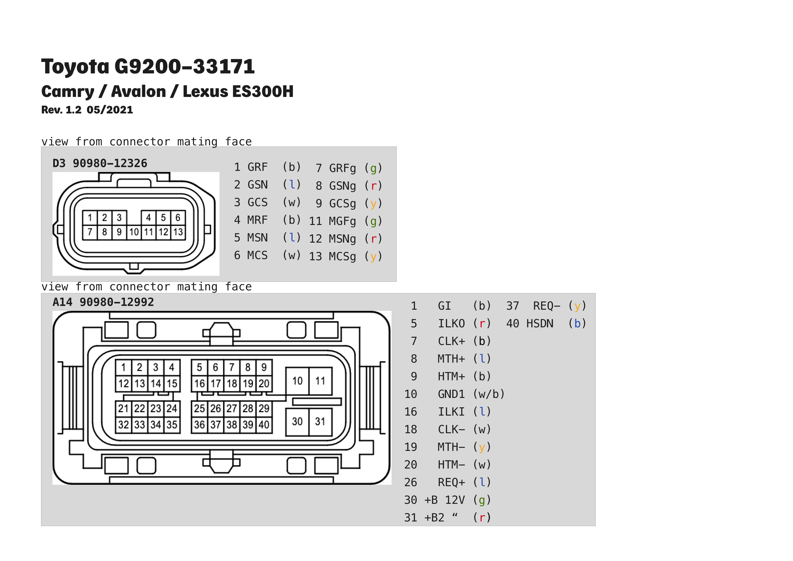

So it seems there is a lot of confusion about using CAMRY inverters for this platform. My assumption is that users who have failed to get good results with the inverter are using the G9200-33020, from a 2007-2011 Camry NAFTA vehicle. This is the inverter that is recommended at the time of this writing in the Wiki. This should probably removed form the wiki, so other don't end up wasting time and money on an inverter that won't work.
In 2012 they changed the NAFTA Camry inverter to G9200-33171
We have the G9200-33171 paired to a GS450H Drive unit. Have not had any issue, However, still just preliminary low-speed testing in the parking lot. Have not done on road / highway travel thus far, because we need a proper traction pack to power the platform.
It seems the information is lacking for this more proper inverter. So here we worked up an info graphic that should help users to connect the -33171 unit and get spinning to do some proper tests.

My Camry inverter is a G9201-33010, comms looks good, will give it a test once I've got the high voltage cables! Thanks my man
nkiernan
- Posts: 589
- Has thanked: 518 times
- Been thanked: 95 times
I have a G9200-33030 Camry inverter. Runs the GS450H box in forward direction but stutters in reverse and stops. Just tested with bench test.

I wonder if this could be an issue with misplaced conductors on the resolver? It would be possible to look up the diagrams and schematics on the conductors of that particular inverter application via the Toyota tech info portal, but you would need to know the details about the chassis that the inverter was removed from in order to get useful data.

Myself and Arturk got the exact same results. Tried some variations on wiring but didn't fix it. I got sections of the harness and the plugs with the inverter which tied in wire colors etc with Arturks info on the Wiki, so we were confident wiring etc was correct. Also worked to make sure it wasn't interference on the wiring. swapping in a GS450H inverter into the same setup fixed the problem then, so does seem to be something around that Camry inverter

I've edited the GS450H WIKI to remove the misleading information about the Camry inverter, and make it more clear, that this is still an unknown.
There are numerous models of inverters in use in the Camry line. Since the Camry is a much wider application than the GS450H, there are a lot more variations. We need to make sure that when we are referring to these inverters, we use specifics, such as the G9xxx model numbers. For example @Arturk didn't specify what inverter he used on his most excellent info graphic. This is important information that should not be overlooked in order for us to be able to extrapolate what Camry units do and do not work.
