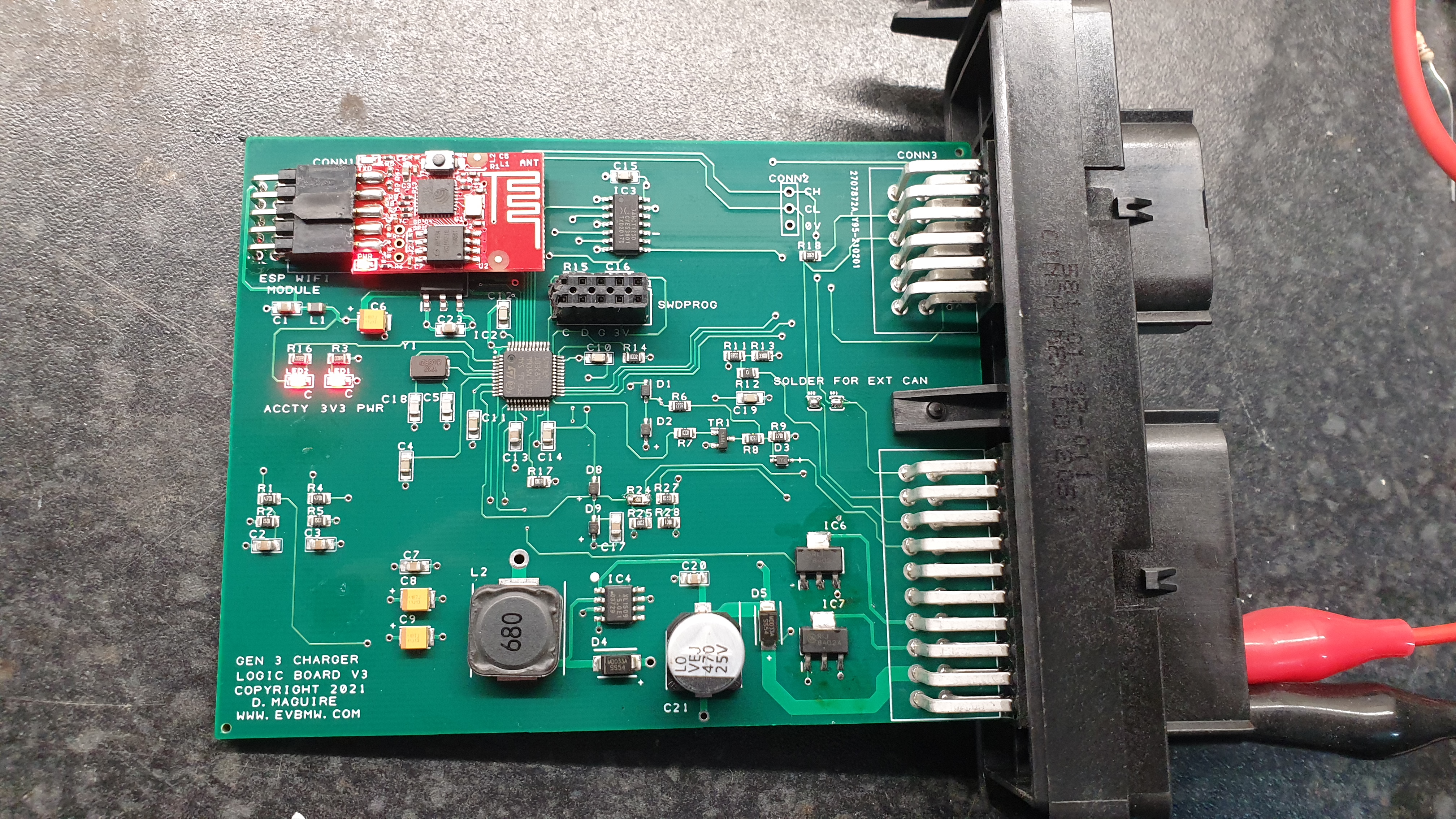

I'm able to load Damien's FW and use the serial interface (menu, debug messages) via a USB UART bridge on CONN8, but I still don't have USB serial. I thought there might be a clock issue (saw that happen with a USB audio device at work recently) and the load caps on Y2 looked too large, but changing those to 10pF didn't help. I haven't looked at the clock with the nice scope, but it looked like it was right on 8Mhz with my scope meter. The 32KHz crystal doesn't look like it's being used because It's not in a low-power mode.
Really scratching my head on this.
- Been thanked: 1914 times
The STM32 doesn't handle any USB, it's the FTDI chip. Maybe some dodgy connection in that proximity.
You can try my alternative firmware because that doesn't use USB anyway
https://openinverter.org/wiki/GEN2
Oh sorry, I thought all V5 boards were that architecture.
I've got your firmware on now and the wifi interface is working, so I think that will do what I need. I hate to leave it with features not working though. Makes me think I could have other problems.

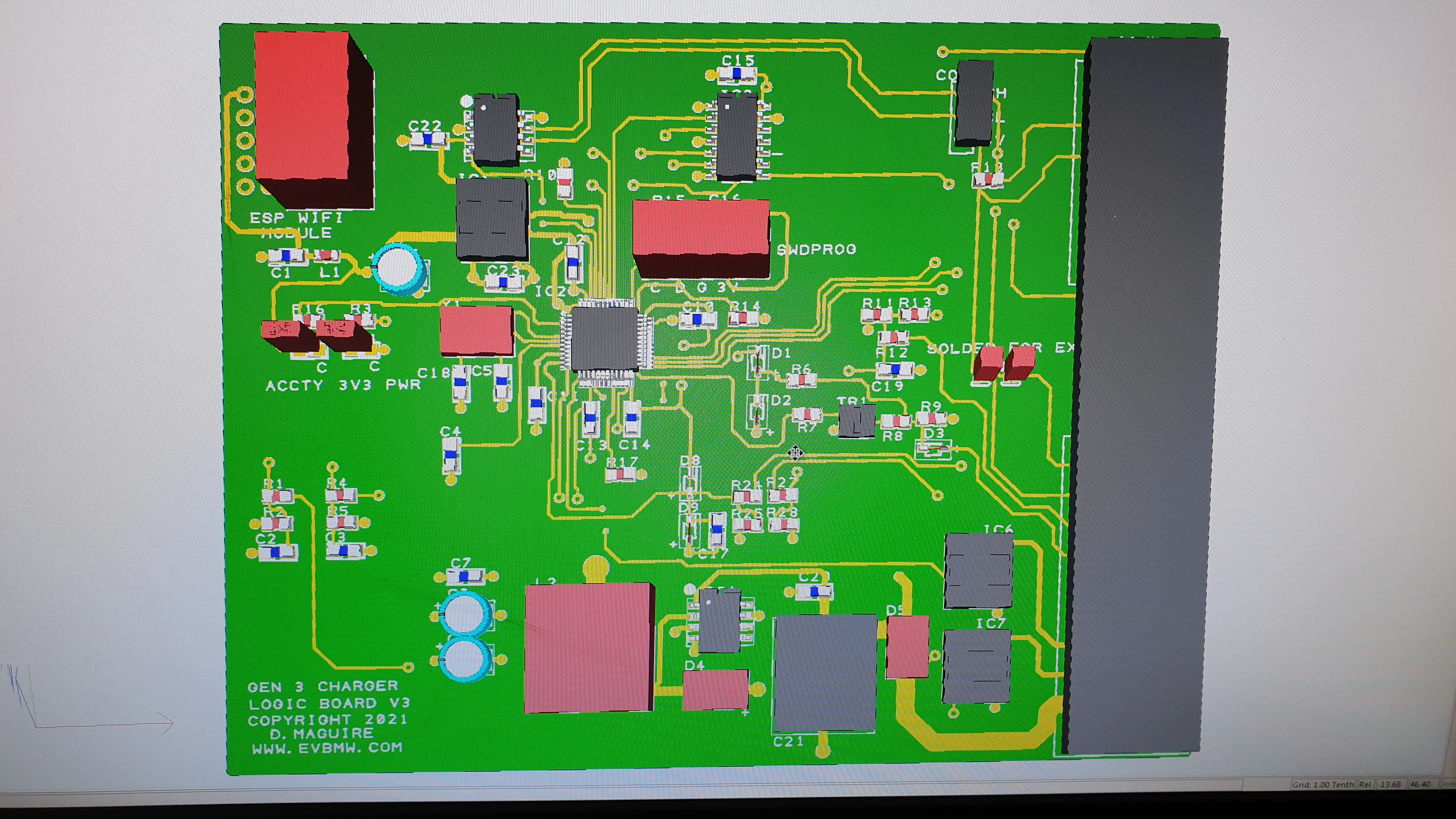

New V3 STM32 based design for Gen 3 charger released which support the new Openinverter firmware with wifi interface :
viewtopic.php?f=10&t=1323
Sources on Github :https://github.com/damienmaguire/Tesla-Gen3-Charger

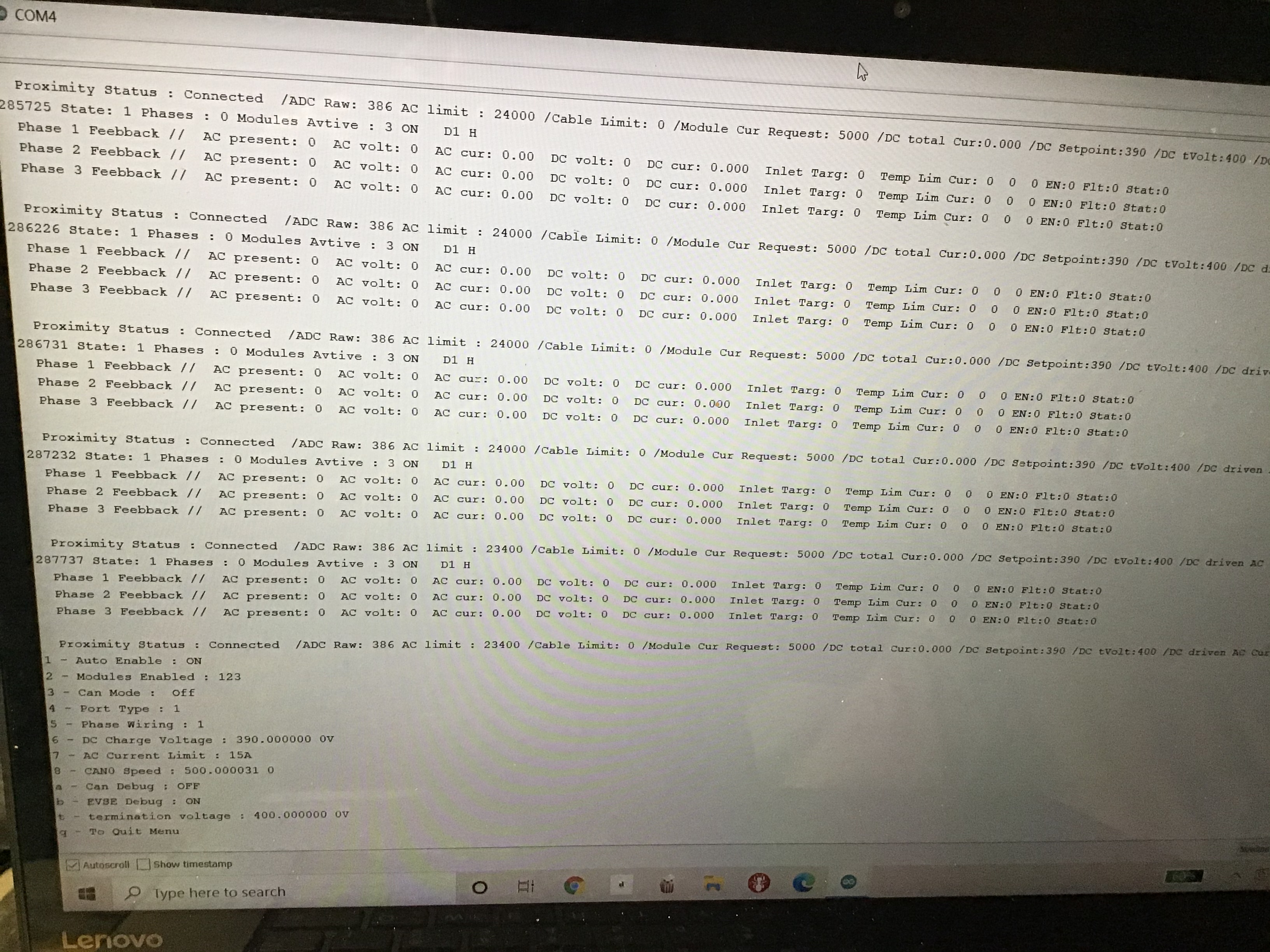

USA single phase 240 volt supply.
V5 board , I did try two Tesla charger 1014963-00-C and 1014963-00-K.
On both cases EVSE kick in but dc voltage showing 0, Not charging,attached screenshot.

Just to reiterate can folks with V5 (or later) boards please update to the new firmware :

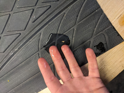

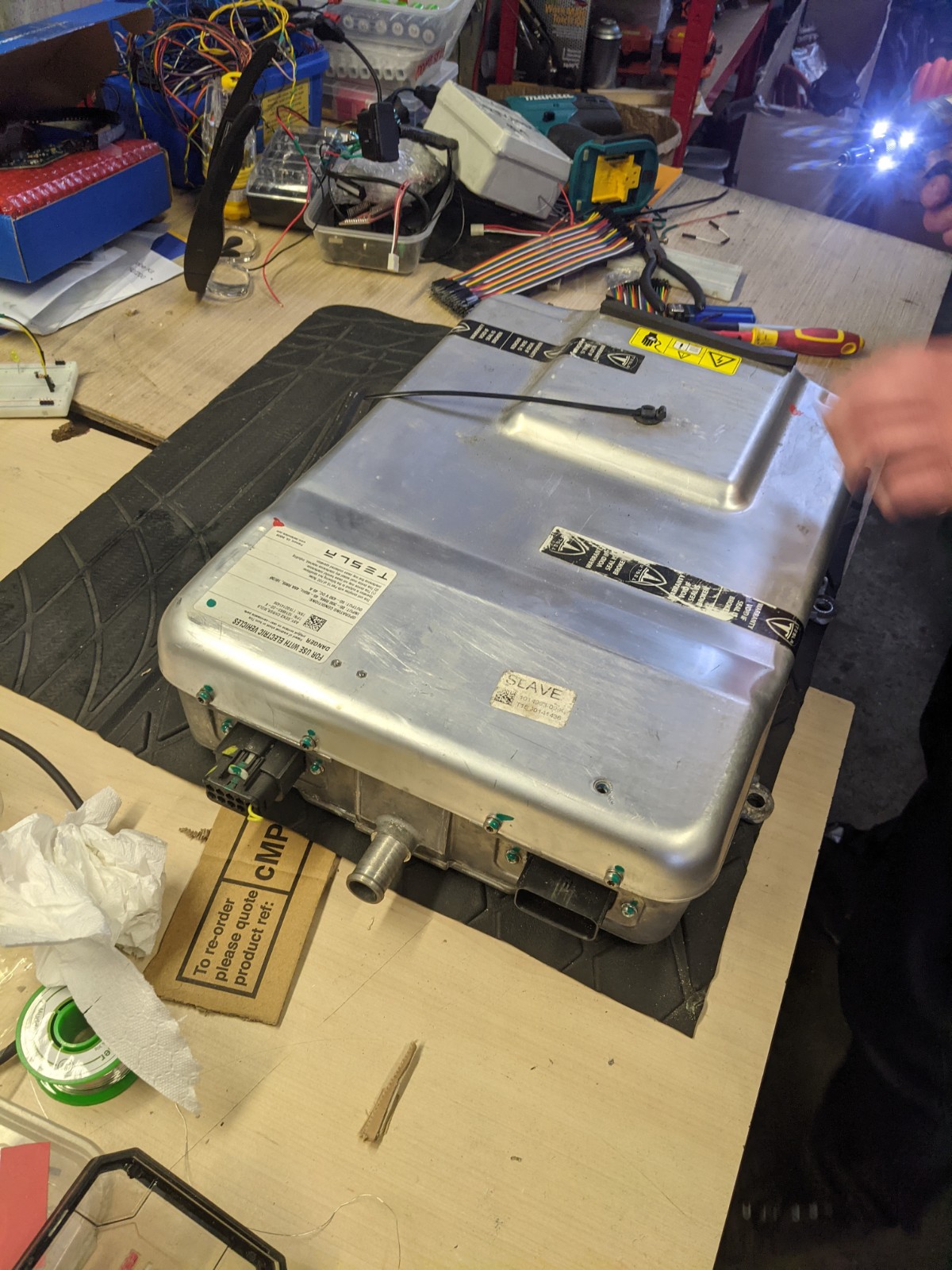

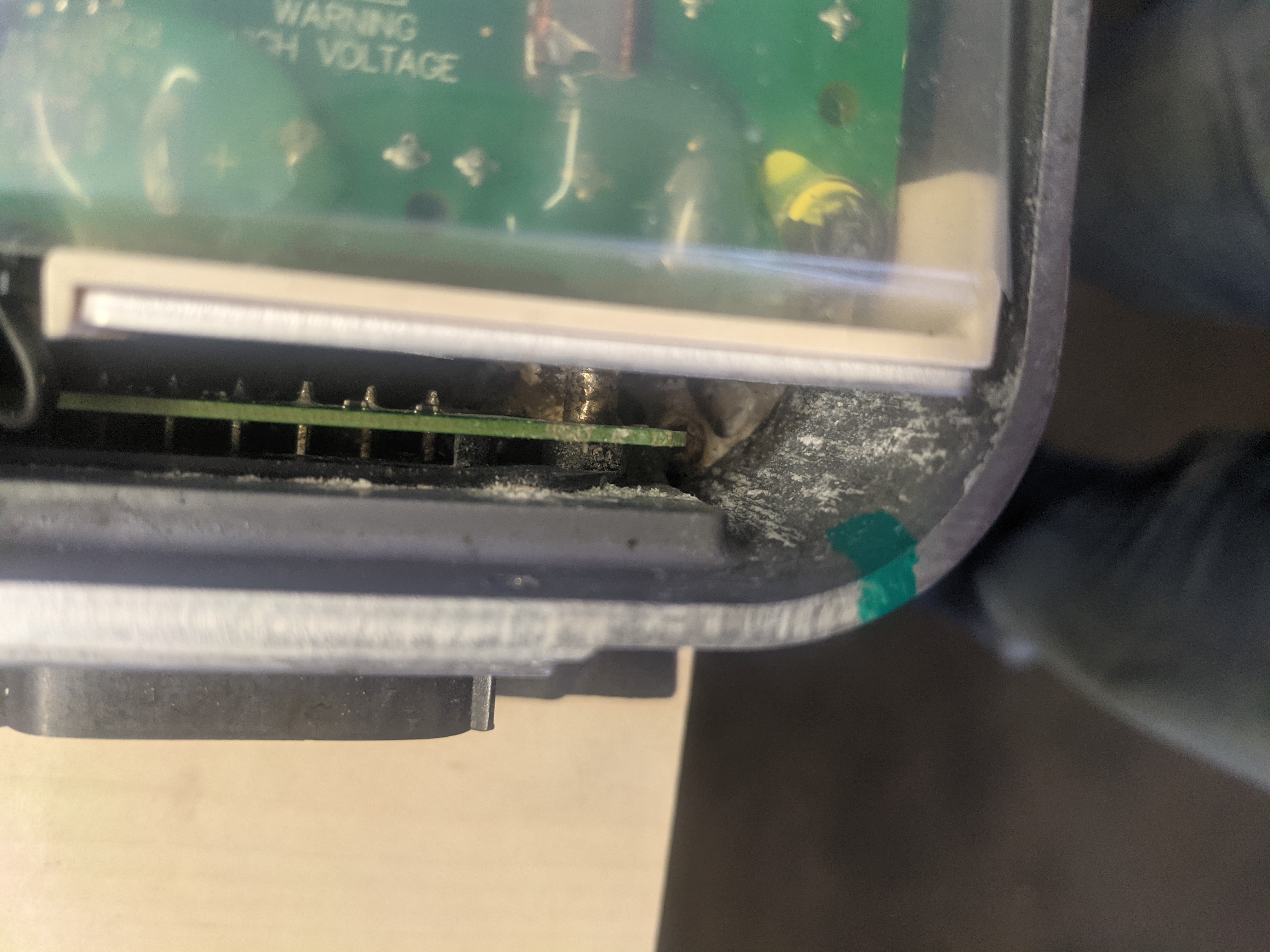

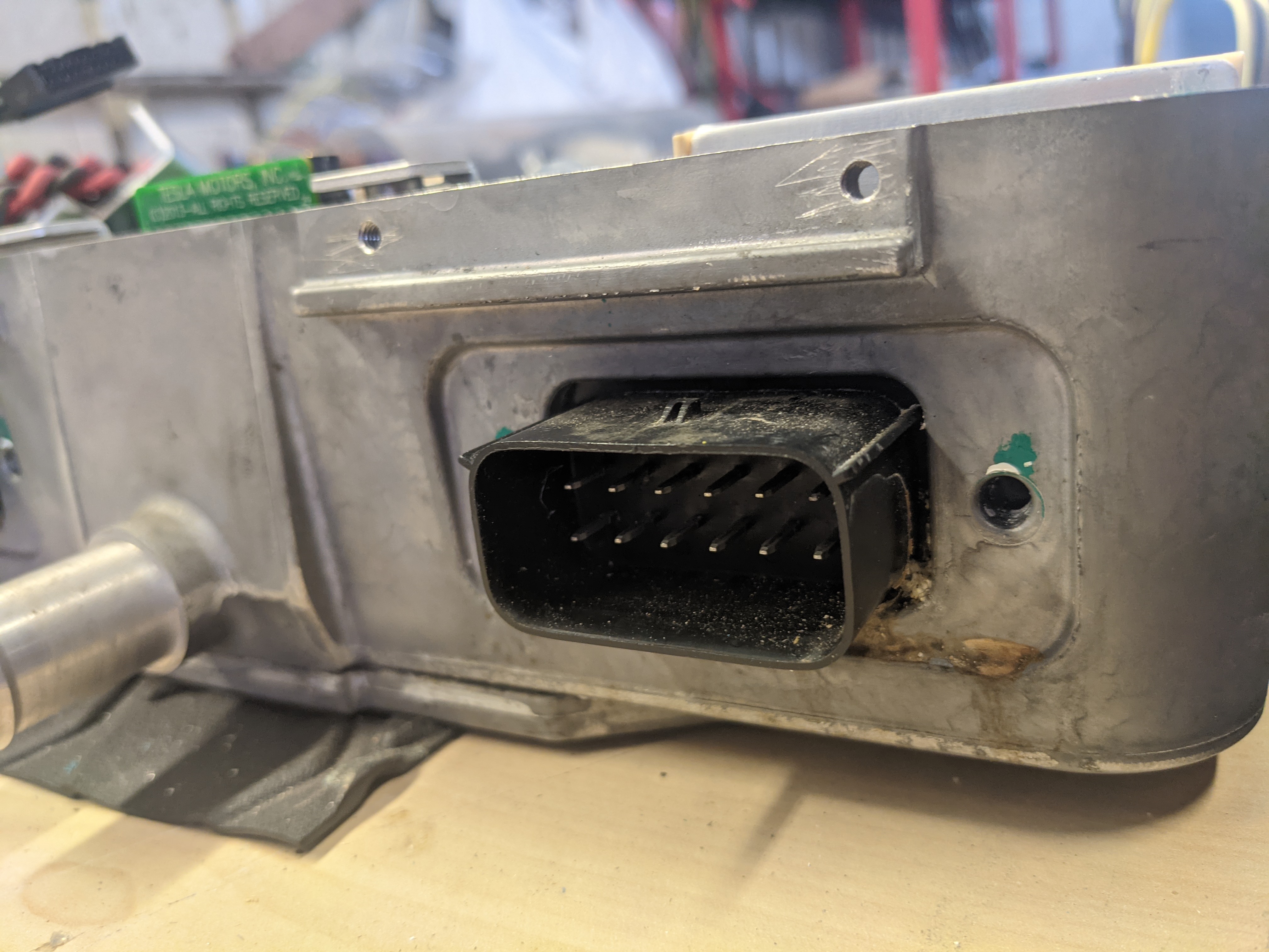

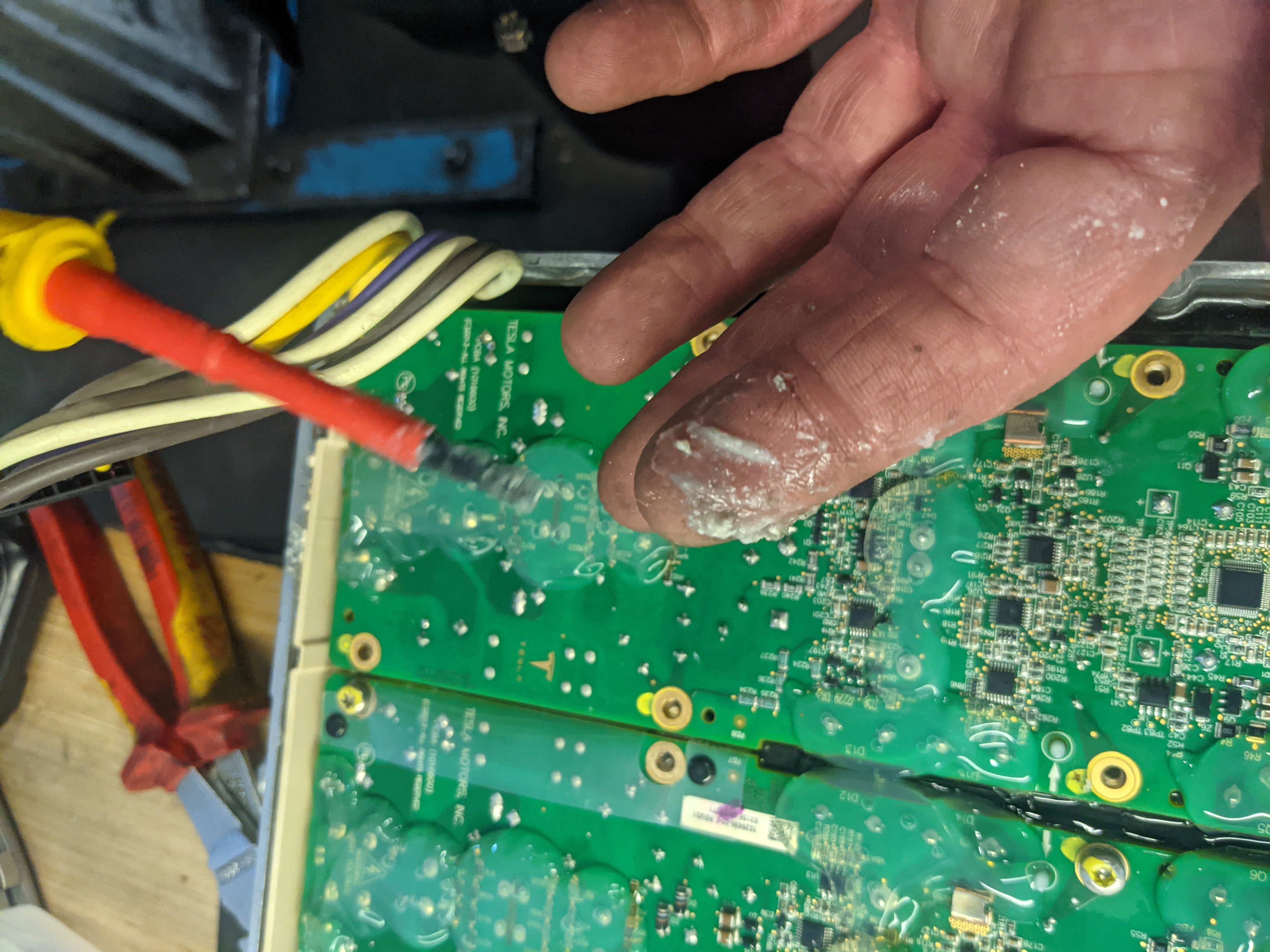

We got two gen 2 chargers and opened them today.
Turns out one of them was WET on the inside. Not water from the cooling outlets, definitely from within the unit.
We could now either
1) try drying it as good as we can and then check if it works
2) disassemble it further, to see where & how the water got in.
Has someone taken the actual charger boards out before? They seem glued in.
I will press on with the other charger for now, that seems dry at least.

Worth doing a pressure test to double check it’s coming from the inside. Haven’t come across that previously
Edit: If water has been in there it’s going to be knackered anyway.
If it came from a wrecked car, it could very well be rainwater, or removed and then get wet. It's not very whether proof even when lying flat. I do not think it could leak coolant on the inside, then it must be a crack/fault in the aluminium casting.
- EV_Builder
- Posts: 1205
- Location: The Netherlands
- Been thanked: 37 times
If it came from a wrecked car, it could have been sprinkled or soaked completely in the fire extinguish bath tub.
I have heard that over here they have big baths and they drop the car in completely to extinguish the battery fire.
