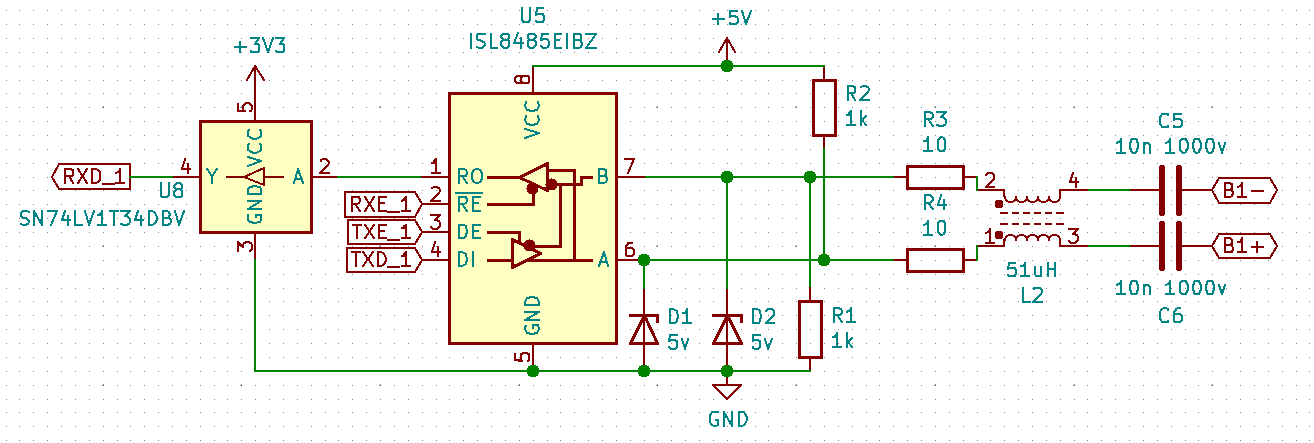

Just had a quick look and can't find stock of anything suitable now.
It's a fairly nasty solution at these frequencies but a resistive divider should work for Rx, just keep the resistor values low so that RC (where C is the circuit parasitics) is much lower than the signal pulse width and ideally lower than the max rise time, if specified, for the receiving chip (can't find it for the RP2040 but given the input has metastability latches and schmitt inputs it should be fine).
Say 20pf (probably lower in reality) and RC < 50ns gives a max R of 2k5 so say a 1k and a 2k. Should be possible to bodge them onto an existing board to try it without a respin too if you can find a 5V transceiver.

Re: New BMS for bq76PL455A based batteries
Unfortunately I think this might be too much bodge. I'd need to swap in resistive dividers on the two data pins, and a 5v supply, not totally impossible for testing, but probably worth just ordering a new board.
Edit: only one data line, and the driver VCC line, and the pull up resistor, not totally inconceivable.
It's not too bad to do, I wouldn't do it on a production board but for testing it's ok. I've recently done the same mod on a 5V CAN transceiver to allow it to work with a 3v3 Arduino board (just tried to take a picture but can't get the camera to focus clearly enough to show it). I normally cut a track, scrape back the solder resist and lay the series resistor across the gap and then find somewhere from the 3v3 side of the track to the ground plane for the parallel resistor. If done neatly it's hard to tell it is there.
For the 5V I'd expect to lift the IC pin and run a mod wire unless there is a convenient place to cut a track (later has the advantage that it keeps the decoupling cap on the IC).
The main problem with the resistive divider is the power consumption, to get the high frequency performance it needs to have low R values which means mA currents going through it which ruins your standby power consumption - but it's good enough for validating a design. There is a really nasty hack which just uses the series resistance to limit current and then relies on the receiving IC protection diode to clamp the voltage - in theory it works but I've never used it.
There are a number of other level translator circuits using FETs or diodes but they often don't perform well at higher frequencies. The best way is to use a translator which gives low power and clean/fast rising and falling edges. You can either use a dedicated one, like the one mentioned, or a logic gate from a family that has 5v tolerance, seem to remember using LVC and VHC families in the past.
Looks good.
I forgot you have three channels to do, could also use something like a vhc125, cheaper and available but older generation family so slightly higher supply current (afraid I'm not up to date with newer equivalent logic families). Might not work quite as well with the existing board layout/routing though?
Thanks, I think I'll use the three small shifters though, definitely fits better with the "modular" layout.Pete9008 wrote: ↑Sun May 15, 2022 9:27 am Looks good.

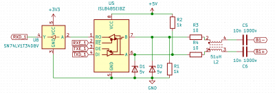

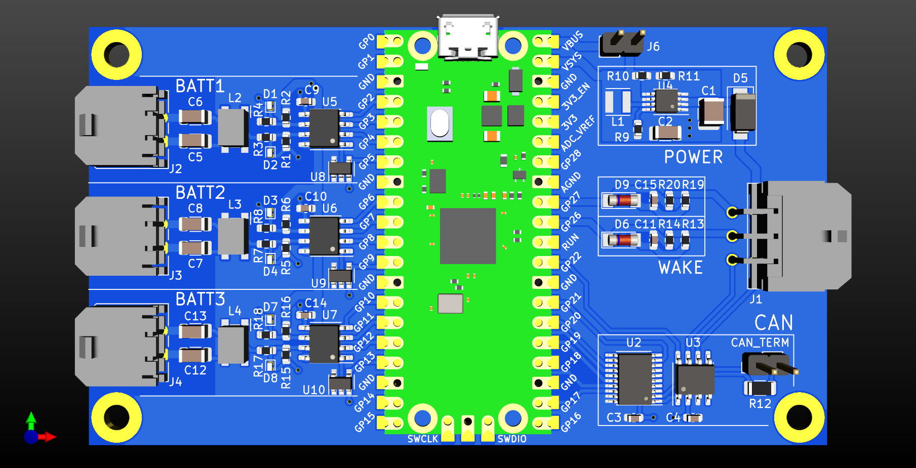

I've ordered a new board with the 5V drivers. Fingers crossed!
Latest schematic here: https://raw.githubusercontent.com/catph ... ti-bms.pdf
It occurs to me that there is another improvement that could be made. I'm not inclined to do so on my board at this late stage but for a redesign, I would consider tying RE and DE together, and putting a pull-up on RO. This does 2 things:
1) Frees up a GPIO per transceiver!
2) Disables RX when transmitting, no PIO JMP needed!
Edit: Remembered why I didn't do this originally, the board has a low power sleep mode that shuts down both the TX and RX.

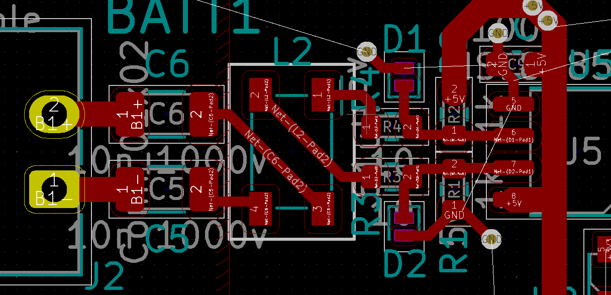

That had me worried for a minute, from the render it looked like the chokes were in the wrong way round
Just checked the PCB and it's fine though
Yes, for some reason I mounted the chokes sideways. I think at some point I must have been extremely tight on space, and it stuck.
It's all JLCPCB. They have stock, but prices are through the roof. £160 GBP for 5 boards. I really hope they work!

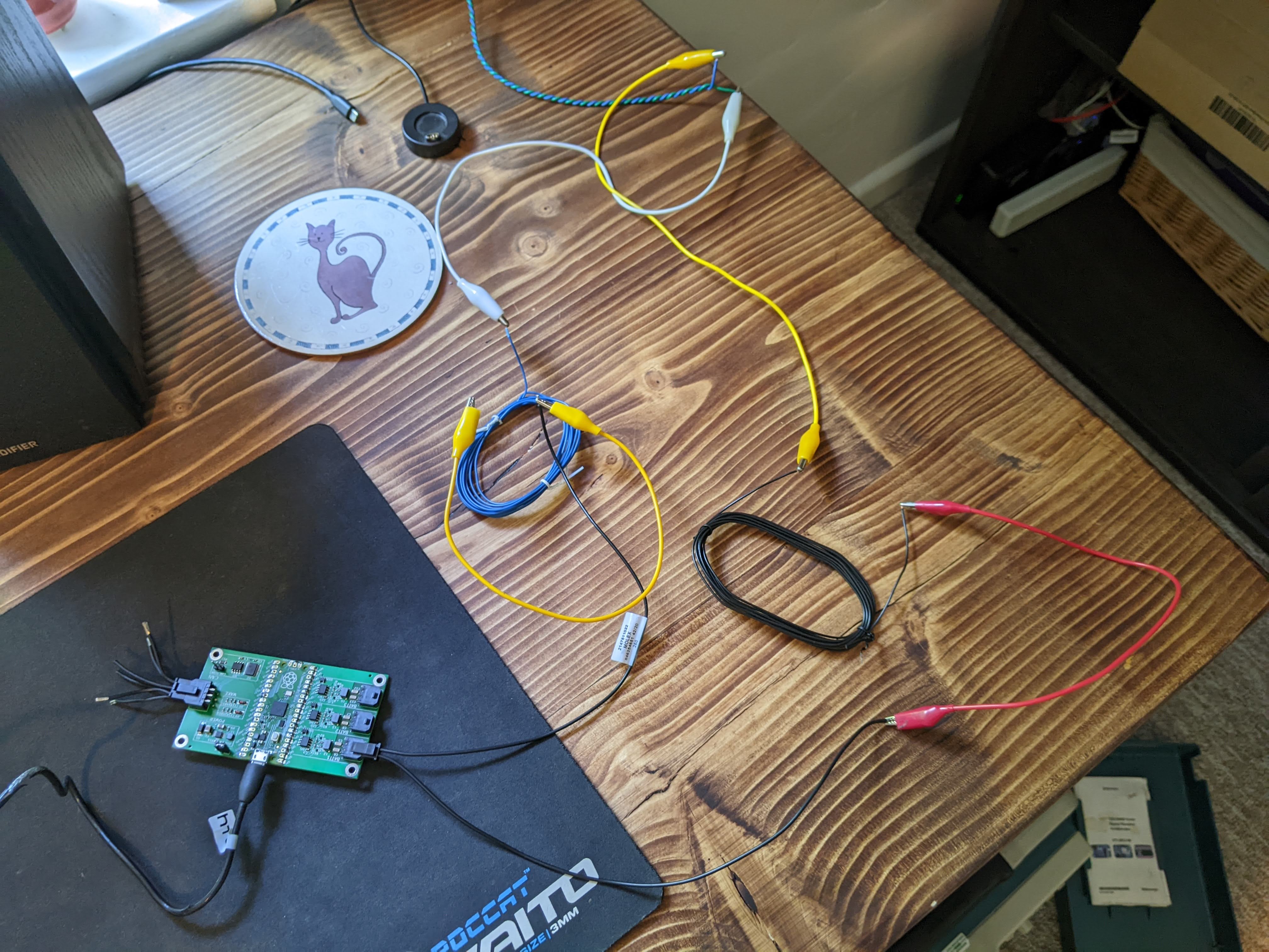

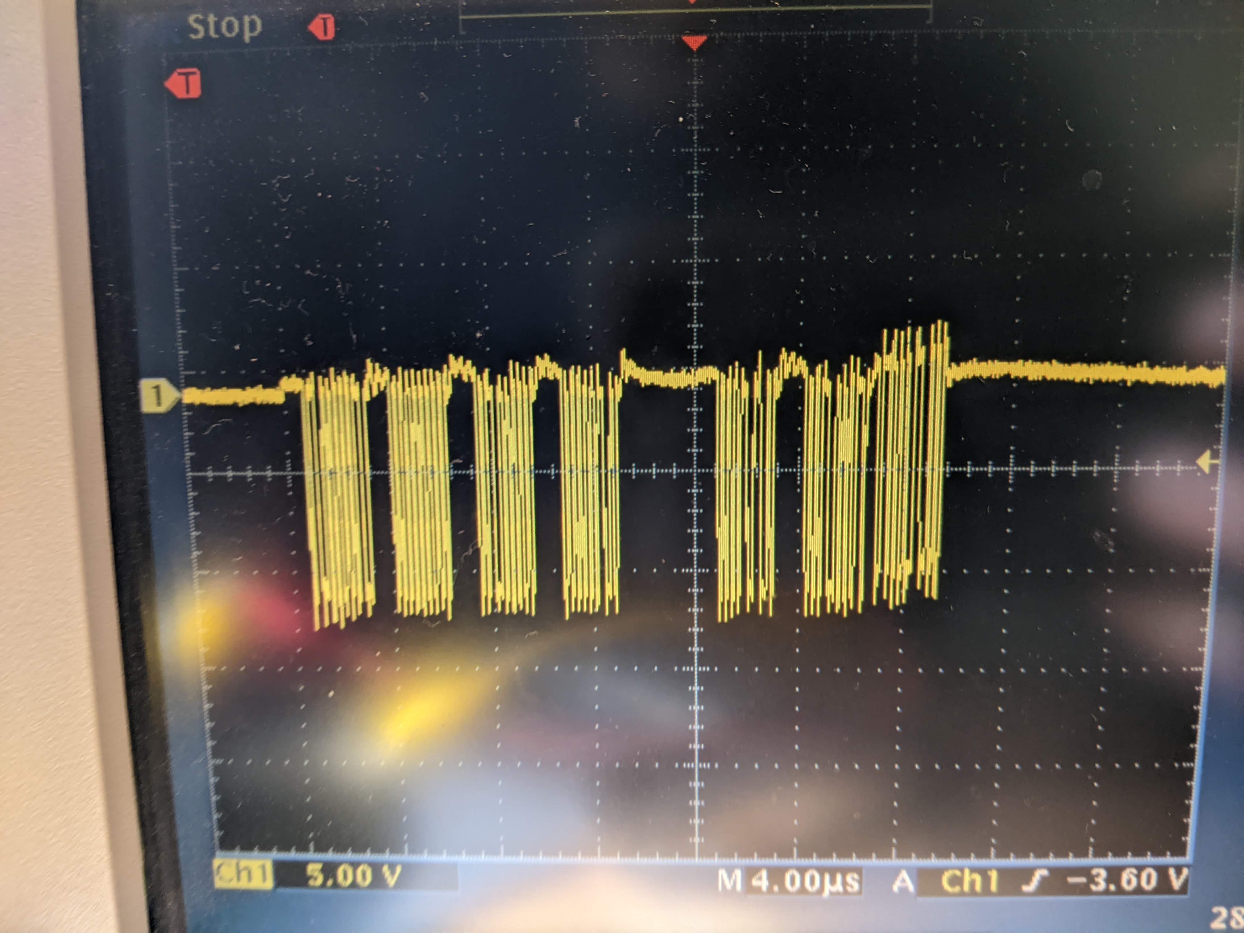

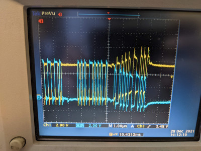

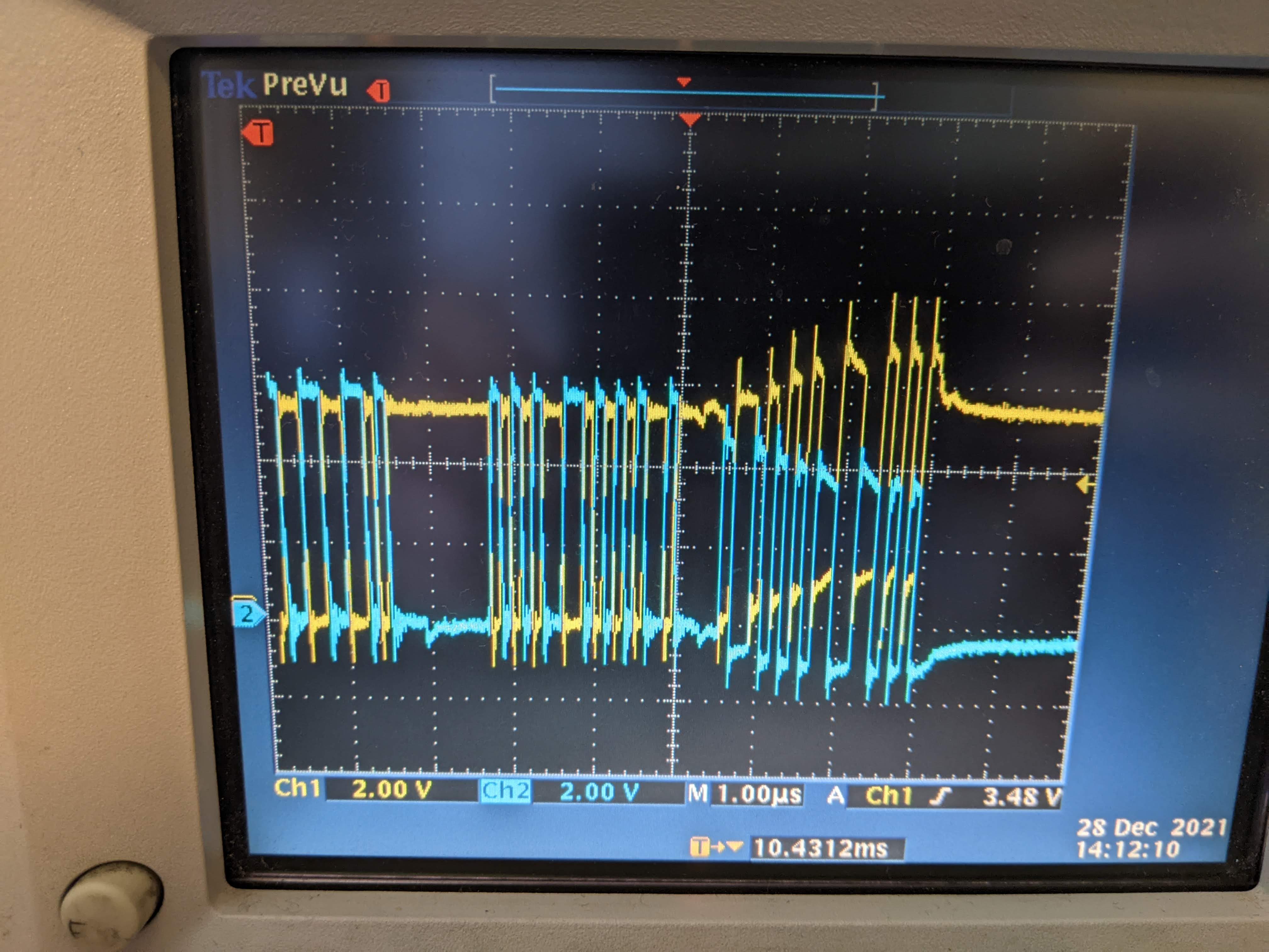

New boards arrived yesterday, had a chance to test this morning and the difference with the 5V drivers is substantial. I am now getting around 50% failures with *this* wiring setup (and obviously none with a sensible 2m cable).
Looking on the scope, I now see strong 10V transitions.
There is clearly a drift towards 0V when the battery transmits (the last of the 7 bursts), because the battery doesn't have nearly as much drive strength as my board does (because it has 1nF capacitors). I'm not worried about this though as it stays well within a detectable range, and the zener diodes limit the effect substantially. This is the data as seen at the RS422 chip. The differential voltage gets as low as 2v.
I think the only way this could be improved further would be to use a higher impedance RS422 chip and increase the value of the pull resistors.

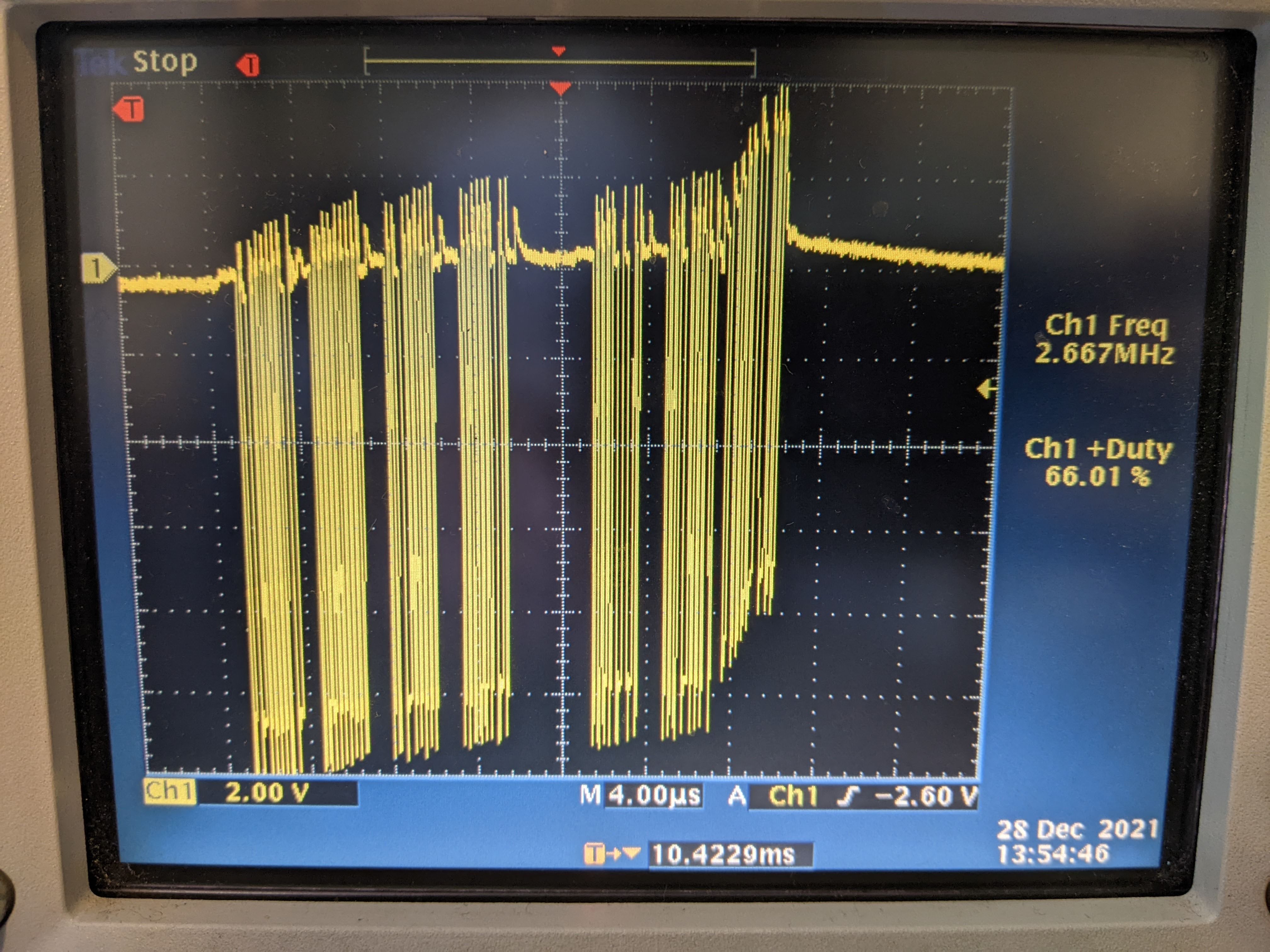

I decided to try one more change... I replaced the 1k pull resistors on the new board with 4k7. This makes a marginal improvement to performance but a *dramatic* improvement to how things look on the scope. I think we can call this a success.
Reworking 30 resistors across my new batch of boards will be boring, but worthwhile I think. Communication on the long coils of wires is still marginal.
Great news!
Signals look MUCH better, especially the last ones
Are the scope plots with the coils or twisted pair? I'm guessing the later as they look too good to still be getting errors (what kind of errors were you seeing, missed messages or corruption?).
Be careful using the coils, the L could easily be resonating with the series C giving wildly varying results for relatively minor setup changes.
If that message length is typical I wouldn't have any concerns about those signals at all now. Looking much more promising for comms to work with the inverter running too.
Those scope traces are all taken with a 1m twisted pair. I believe you're right about the coils. When testing with them, things certainly seemed unpredictable. I'll see if I can find a longer length of twisted pair to do a more controlled test.Pete9008 wrote: ↑Tue May 24, 2022 4:20 pm Signals look MUCH better, especially the last ones![]()
Bytes are always 8-9 bits long, multi-byte messages can have a significant gap between bytes. The bq76PL455A leaves long gaps between bytes (much longer than I do, and easily long enough for the line to return fully to idle) so perhaps I will do the same. Note: in my screenshots, you always see a couple of bytes of my request then one byte of reply. In fact there will always be more bytes of reply, they just come significantly later.
With the final setup (driving at 5v with 4.7k resistors), the errors I was seeing were a mix of RX CRC errors, and not getting a reply at all (which I would attribute to the bq76PL455A detecting a CRC error in my request. This is exacty what I'd hope for in the case of a bad cable, suggesting that neither end in particular is doing anything wrong.

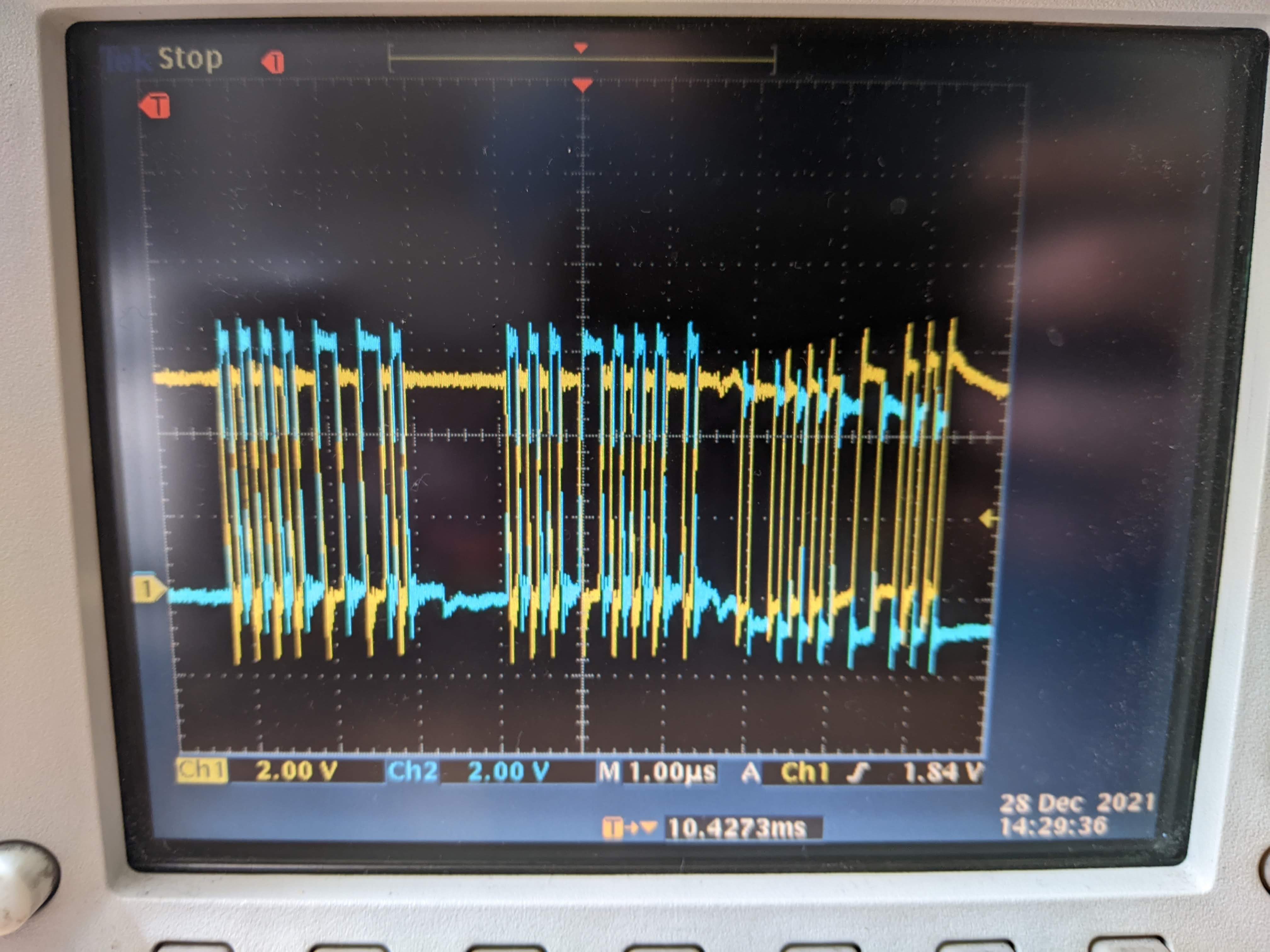

Just tested with 20m (!) roll of Ethernet cable. Results are extremely interesting. Now 100% of requests receive a complete response with CRC errors. If I ignore the CRC checks, the data is all there but clearly corrupted.
Thinking about this, I actually prefer this result to the previous one. My isolation capacitors are 10x larger than those at the other end, so I'd expect cable capacitance to affect data I send much less than data the other end sends. The coils I was using previously must have been causing their own problems.
I don't really want to start cutting up this cable to work out the maximum length, but I'd say things are definitely working well now.

That's a great result!
Agree, the load impedance difference at the two ends will be causing an imbalance too. Also bear in mind that with 20m of cable it will be starting to look more like a transmission line than a lumped component equivalent, and with being unterminated it will have all sorts of interesting resonances of its own too!
