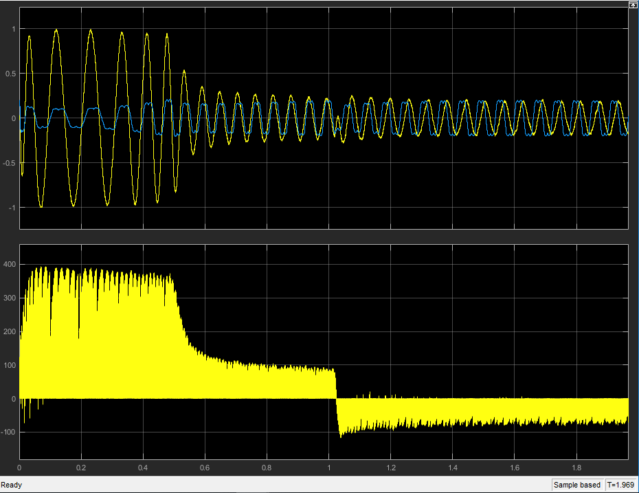

johu wrote: Sun May 19, 2019 11:40 am The issue is that stator current is not in phase with stator voltage, as far as I know. There is also mention of injecting a low DC current to determine
No they aren't in phase as you mentioned because of the inductances, but is this an issue at all? I meant we could scope the time difference between phase voltage and resolver, not the currents. A low-pass filter is all we need, something like 10k Ohm + 22 nF (~723 Hz cut-off) would be enough to eliminate the PWM while running the motor through the inverter. Also toggling a pin at the resolver zero-point sounds very practical.
I actually made a crude simulation for this method on Matlab and it looks promising. But to test it in practice I need a whole new inverter power stage hooked up to my Leaf motor, which has been laying around for years. Someone who already has all the setup might give it a try :P

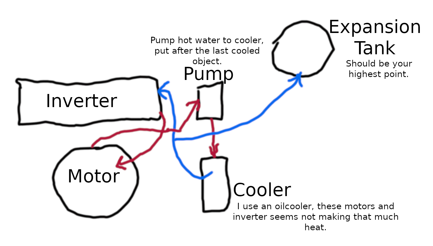

The cooling system is very simple to deair(eiluft you guys say in Germany) if you dont have some elaborate valves and heating elements included.
1. You have your reservoir with one supply line and one output line in case liquid would boil.
2. supply line leads to 3way port on water hose from motor to radiator
3. cooler fluid from radiator to suction pump and back to motor
I use another 3way port element in section between radiator and pump. 2 points just pasthrough liquid, but i connect third one to a toilet hose with a screw plug in the end. When i have to deair my system i just supply liquid to reservoir and run the pump. When it starts to suck air i open the end valve and wait for the air to evacuate and liquid to flow from there. That is it. You can use even larger hoses. What is important is that your plug is higher than the system so air can evacuate to the highest point - the plug.
Been thanked: 1918 times

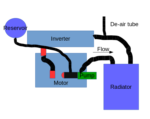

Like that basically?
What do you guys think about the radiator?
Posts: 3796
Been thanked: 413 times
It is a bit small and without active cooling. Starts will heat up inverter a lot. Is that a car heater core? This would do for the motor, but for both inverter and motor i dont think it will be enough.
I think i will use original radiator for the motor and i will first let the water from radiator to inverter and charger and then to the motor. From here dT would have to be dropped fast. I will write more about it when i have motor in a car.

Might be a good idea to put the pump after the cooler if you are expecting higher temperatures, less risk for cavitation.
(and pump runs cooler, lasts longer)

johu wrote: Sun May 19, 2019 10:14 pm Like that basically?
Hi Johannes!
I think that you have to change the flow of the coolant a bit.
You should try to pump push cold fluid from the bottom of the radiator through first the inverter, then the motor and out into the top of the radiator.
Having the radiator the way you have it now with both inlet and outlet on the top gives the least of cooling.
If you look at the ICE radiator you normally have the hot inlet in the top on one side and the the cold outlet on the other side on the bottom.
That is to force the fluid to move through the whole radiator, if you have both inlet and outlet on the top there is a big risk of creating a layer of cold fluid in the bottom and then the hot fluid in the upper parts of the radiator. Atleast if you have low flow.
A fan for pushing air through the radiator will also help when stationary.
Regards
/Per
Ok thanks guys, will re-arrange that :)

Ok, re-tubed the cooling system. It started to rain, so photo next week.
Basically hot water exits the motor, into a splitter from reservoir and to pump. From pump another splitter into the front radiator or into the passenger heater core. From either radiator back to the inverter. The exit from the heater core has a de-airing spliter. I'm looping it back into a reservoir but quickly realized that this leads to hat water cycling back into the reservoir and directly to the pump. So once de-aired it has to be closed off.

johu wrote: Fri May 24, 2019 6:35 pm Not sure if I'm ready to try FOC yet. Does the whole syncofs stuff become irrelevant when using FOC? Is it just Park/Clarke - (PID for iq, PID for iq) 1/(Park/Clarke)?
How is the V/Hz ratio maintained while you're releasing the throttle? If the current goes up too much, would increasing ampmin (say 80%) help to fix this?
I don't think the syncofs becomes irrelevant when using FOC. You still have to provide the correct rotor position in order to transform to the correct d-q axis. Otherwise, the values you'll control won't be the true id and iq.

So, 50% ampnom is supposed to be the freewheeling voltage, but it's true as long as the fweak (and udcnom) is set correctly for the Leaf motor. Isn't it? We should know the exact V/Hz ratio of the back-emf of Leaf motor. Or do we already know it? I personally don't :)
For the current regulation idea, sounds nice and easily implementable without too much work. So I wondered and simulated it with a FOC model. The simulated motor is an ACIM, but a PMSM would behave the same. The result is that we can easily tell if we're motoring or regenerating by comparing the current vs. PWM generated sine voltage. Attached has two graphs, the upper one is (phase U) current (per-unit, scaled down to between 1 and -1) vs. (phase U) PWM voltage, lower one is battery (DC) voltage. Motor is in motor mode until around second 1.1, then it starts regenerating.
Edit: Edited graph due to a wrong plot
Very nice. So when motoring current is almost in phase with U_L1. U_L1L2 would be -30° offset.
When generating current is about 90° offset from U_L1.
In other words if L1 PWM voltage is positive at - to + zero-crossing of L1 current we are generating, otherwise motoring. So this calculation could happen where currently RMS calculation happens.

johu wrote: Mon May 27, 2019 9:08 pm In other words if L1 PWM voltage is positive at - to + zero-crossing of L1 current we are generating, otherwise motoring. So this calculation could happen where currently RMS calculation happens.
Exactly!
