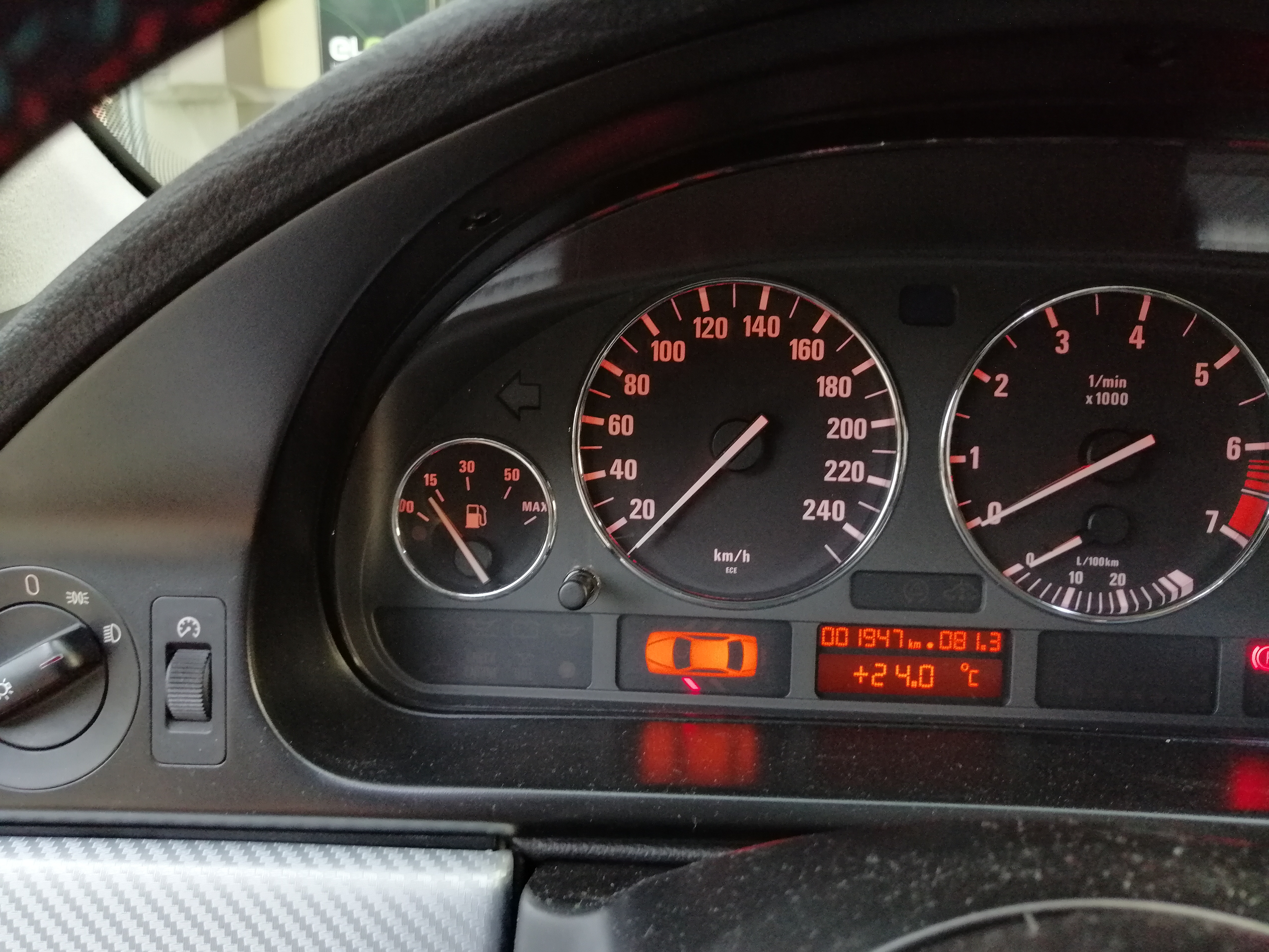

I like the display in the air vent :) What is the rev counter displaying?

It shows total battery voltage, current + when driving, - when charging, power in KW
Aux 12V voltage, temperature of controller, % of galvanic isolation betven chasis and battery minus,
and SOC - it can be with % or Ah, I like more in Ah

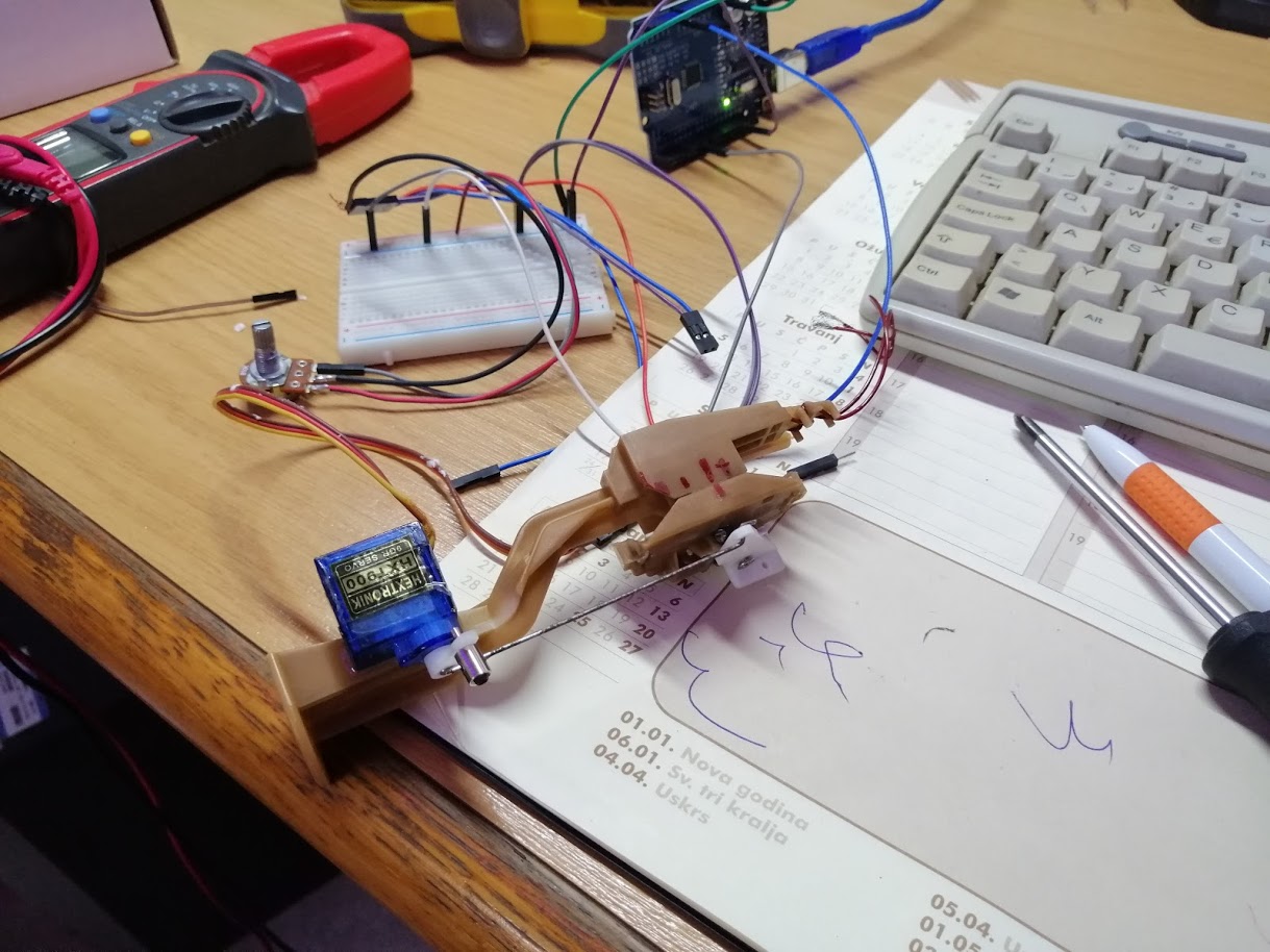

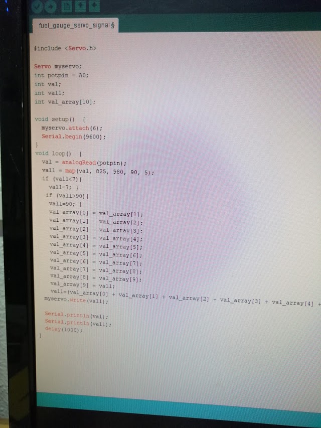

Car got new odometer kilometer . I finished fuel gauge function. Arduino is reading voltage every ( with voltage devider) 1 second and calculate average of 10 last readings to reduce significant current voltage drops and it is working :)
