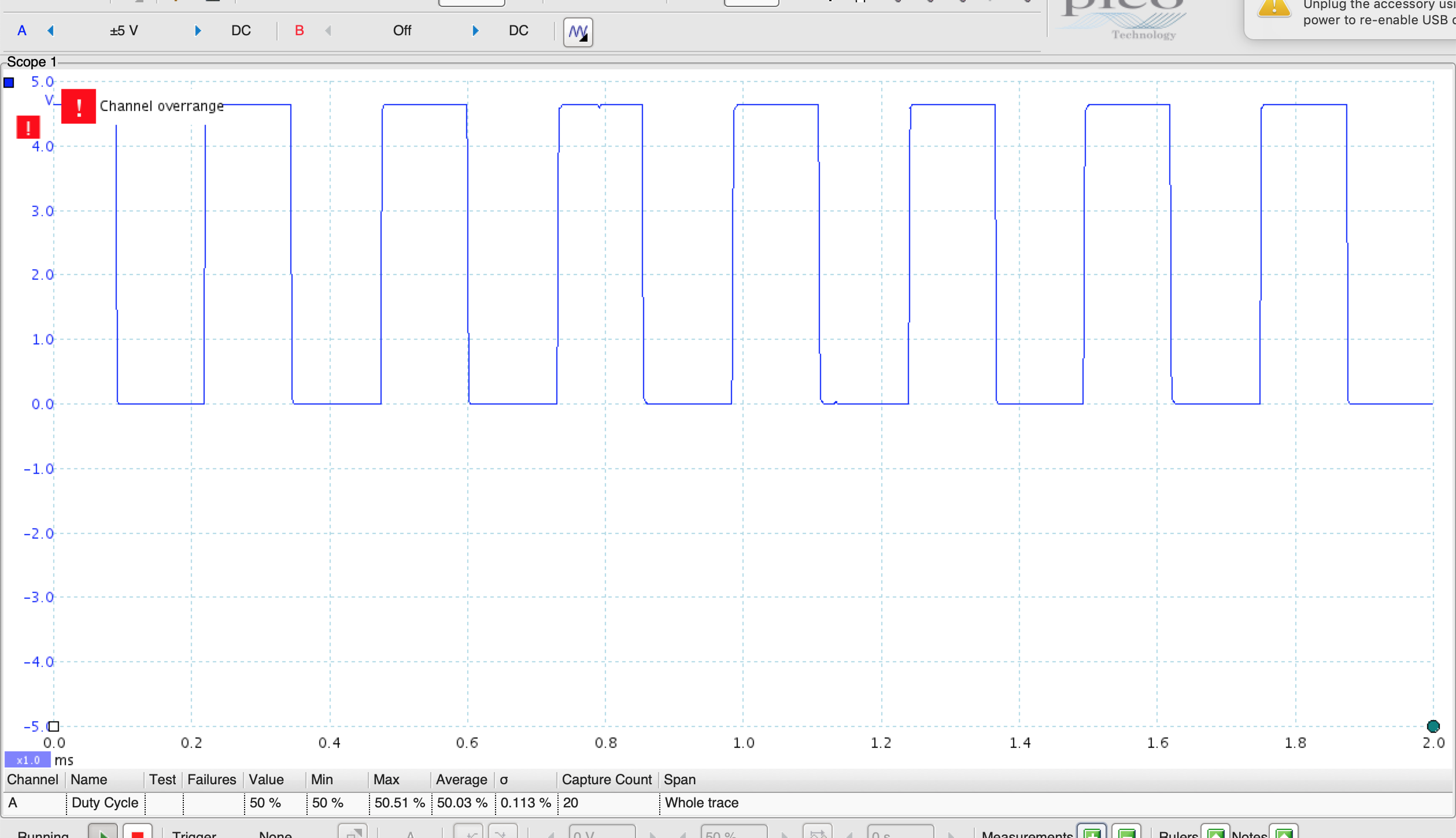

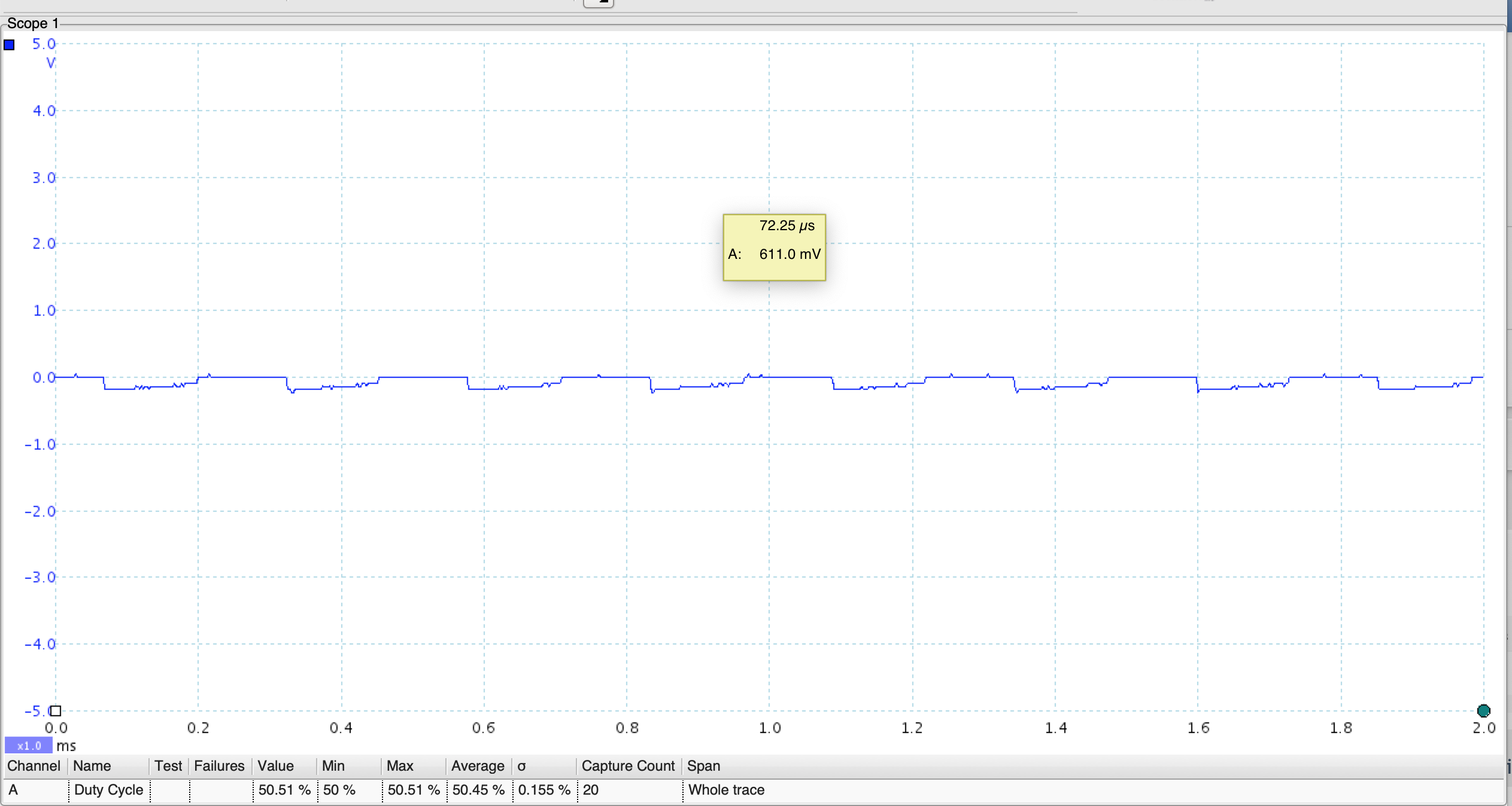

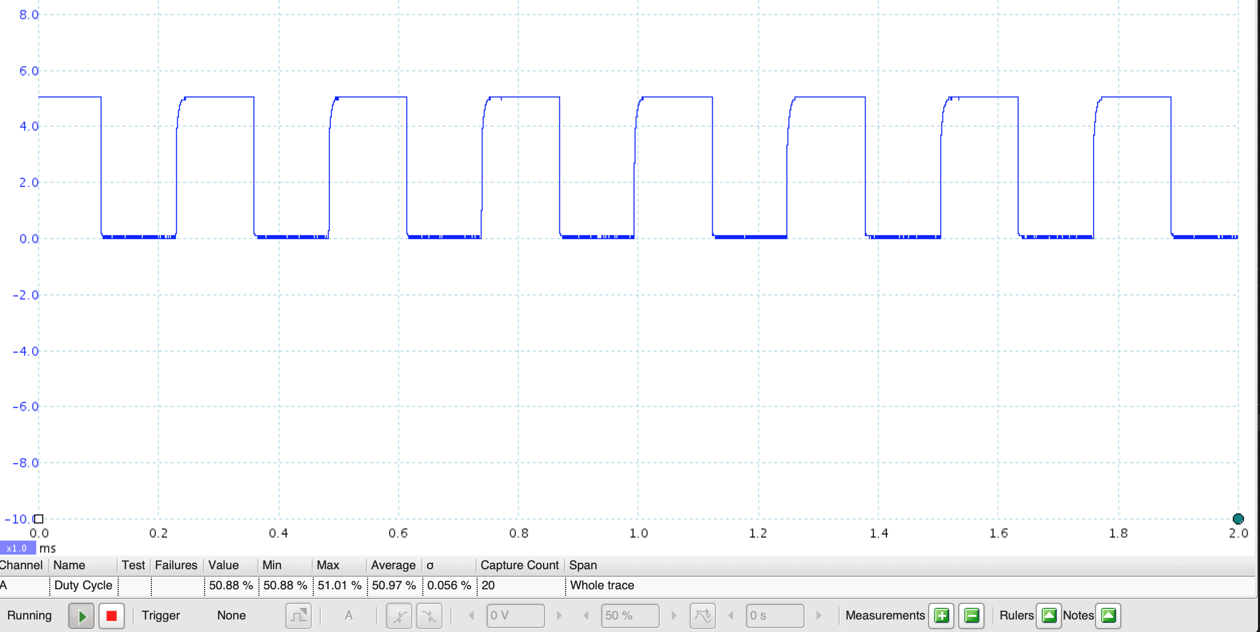

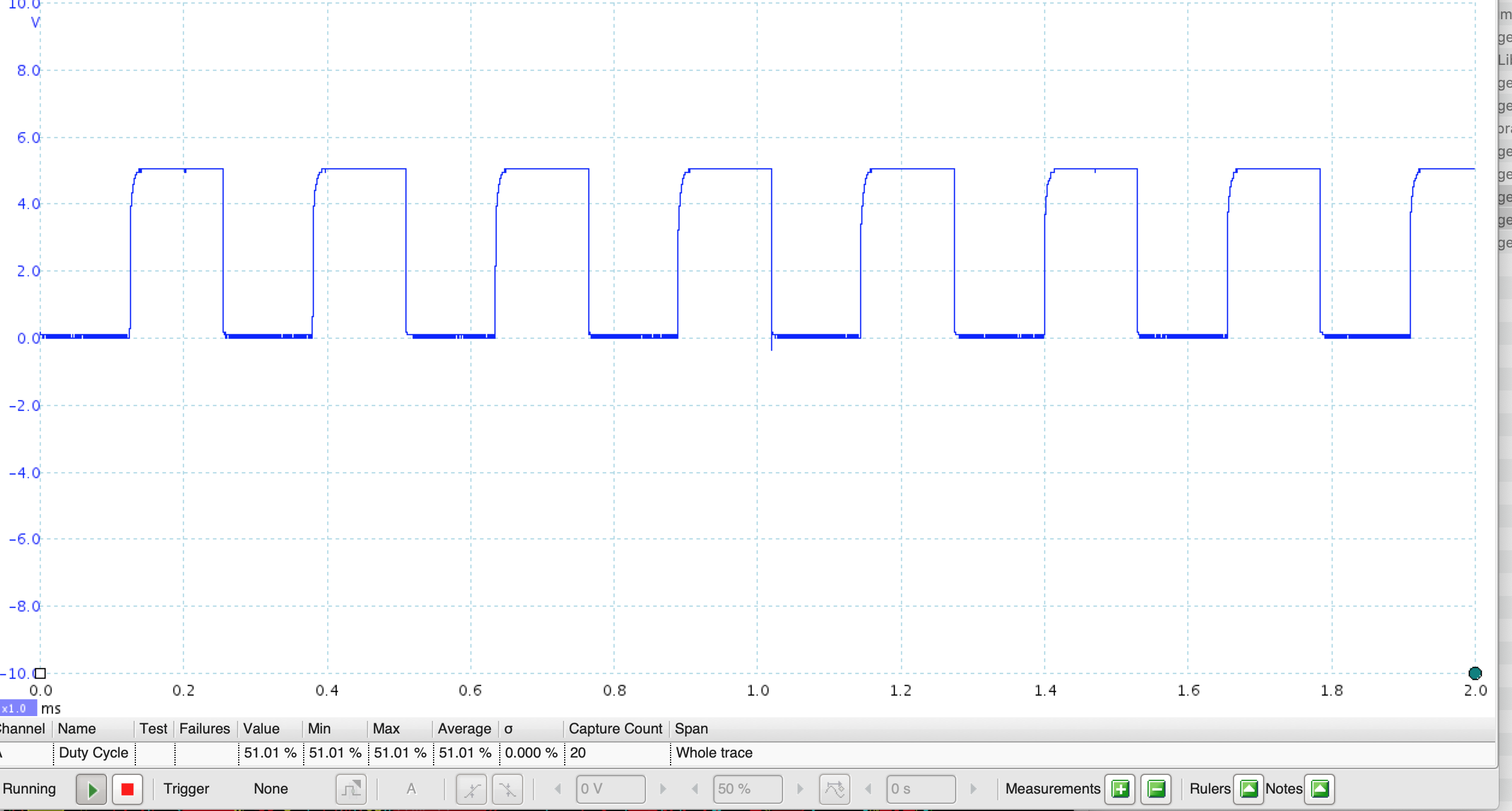

So as a test I've pulled the board out, set 9 and 10 at 50% duty.
Output from the pins looks good. I've followed this to TR8 and TR9 then the R88 and R87 to the 50way connector, both the same
- celeron55
- Posts: 804
- Has thanked: 38 times
- Been thanked: 136 times
Re: Gen 3 inverter converter control software
That looks ok assuming the IGBT driver board is disconnected. Once connected it will supply the 5V pull-up to the lines. If it doesn't supply 5V, that means it's detecting a fault in the IGBT.
Both look good when hooked up. I'll put the inverter back together tomorrow and stuck a voltage on the DC bus and see if I get any boosting with just setting the PWM and 50%.

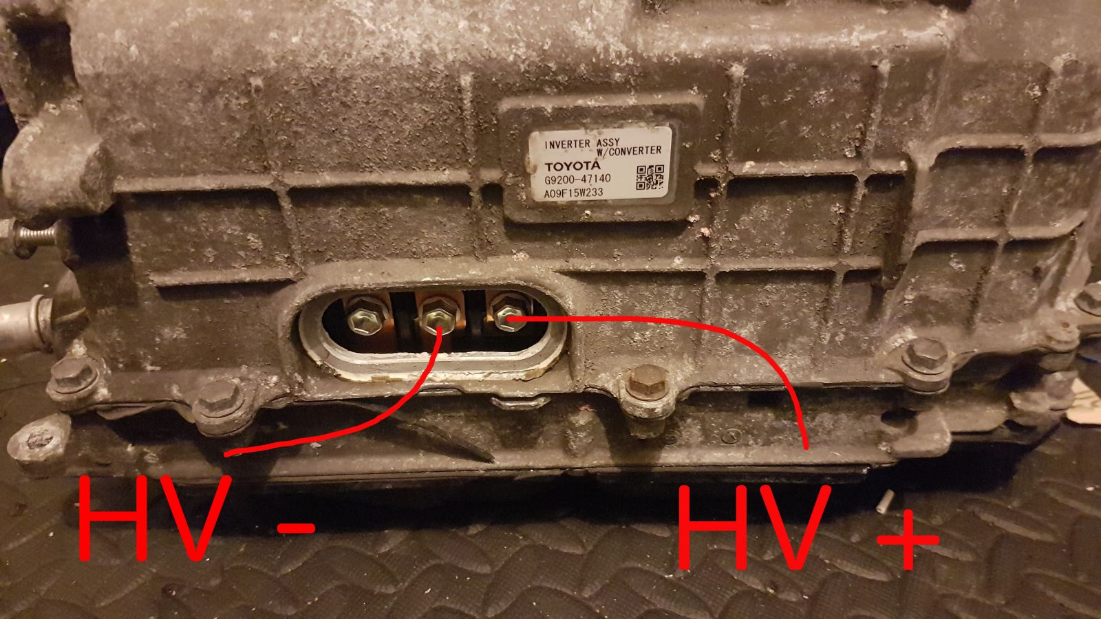

I must be doing something wrong.
I've got 83v on the RHS side as in the photo. I've got a multimeter on LHS (1 & 2) an no load
I've checked BOOST_FAULT and it remains at 5v.

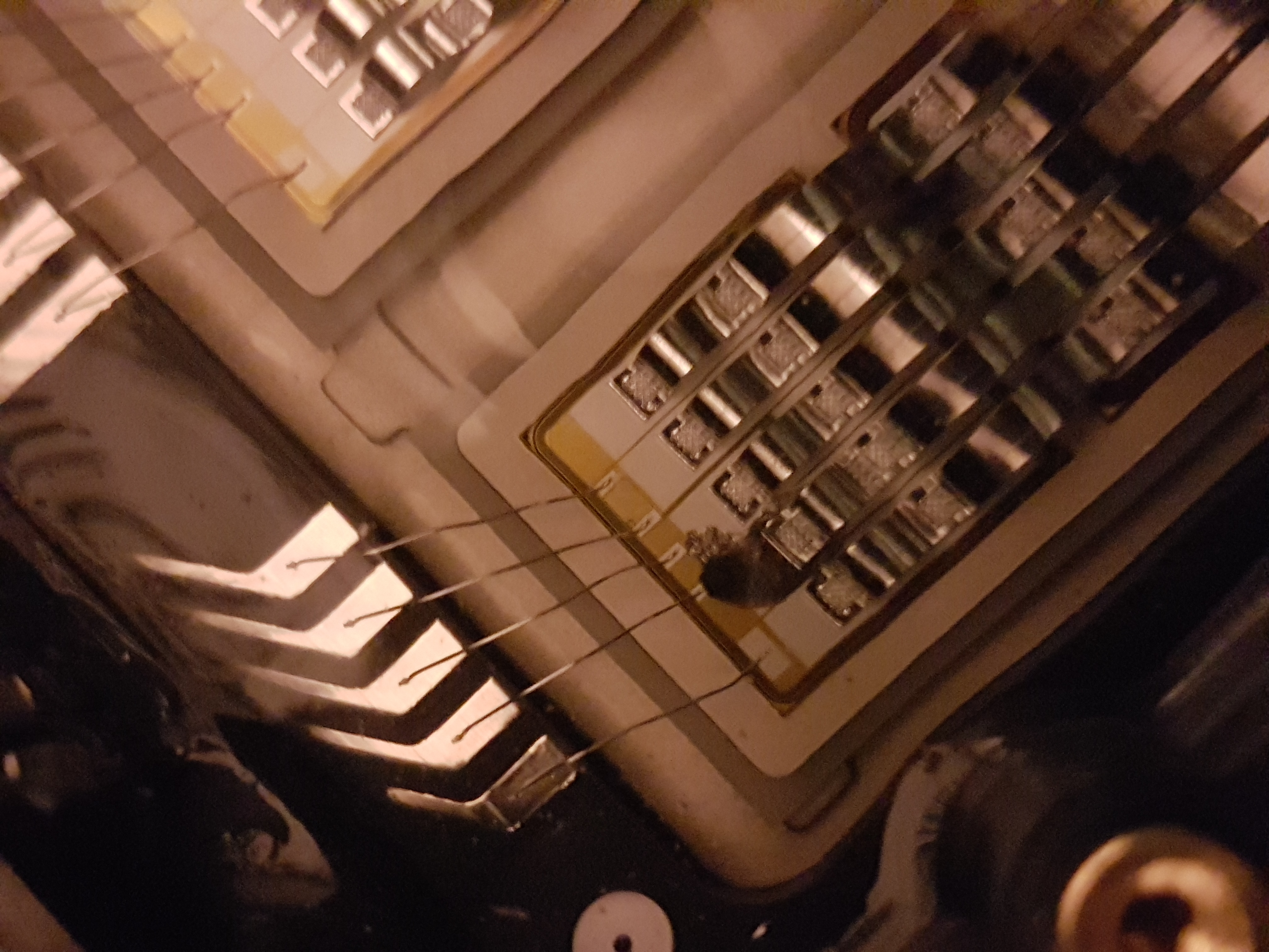

So I was running the prius3charger_buck (latest version), and all was well. I had single phase connected through a lightbulb, to MG1 (1&3) it light briefly and went out. Using TEST_BUCK = true.
I turned the mains power off and when I turned it off I heard a click sound from the inverter. Now when I turn mains back on the bulb stays on. Any clues what I've done and what I've killed?

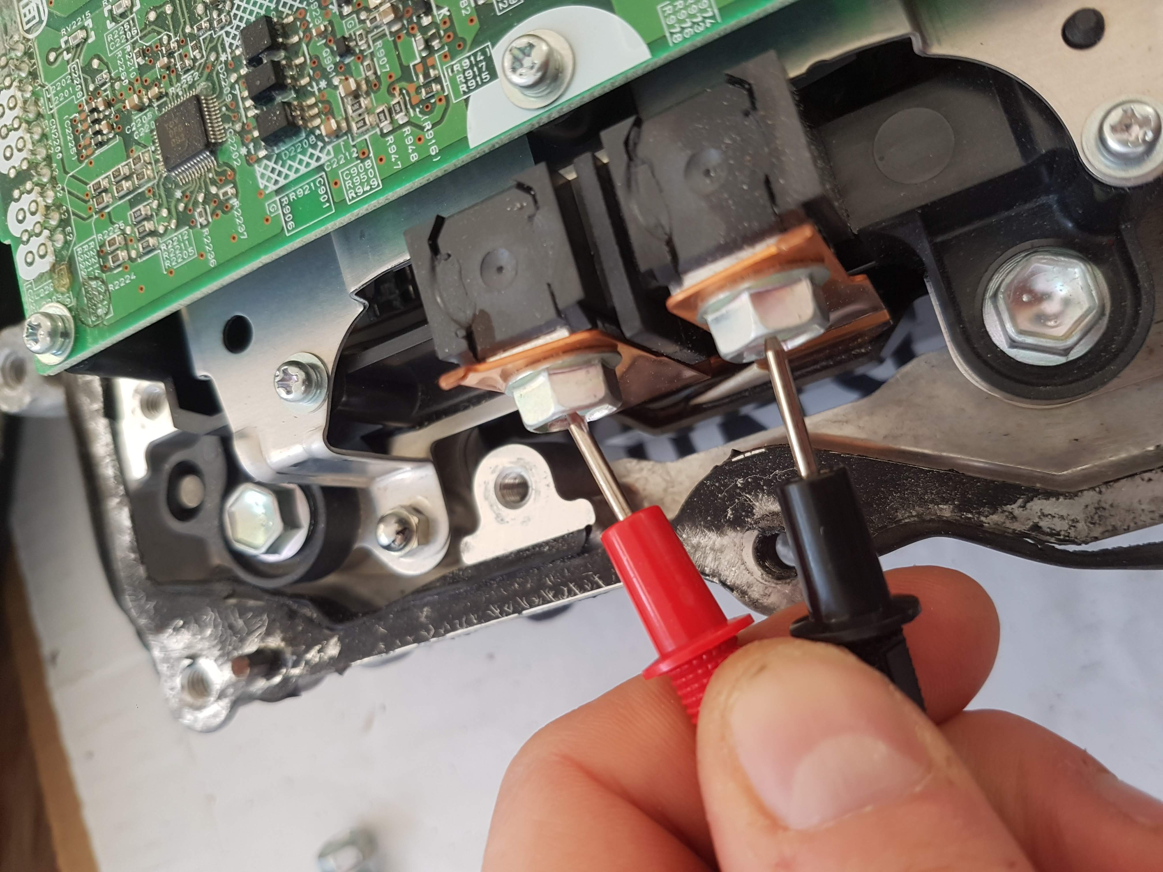

Do some continuity measurements and you'll probably find out. Definitely sounds like the converter high or low side died.
- Posts: 1774
- Has thanked: 82 times
- Been thanked: 424 times
Would be be kind enough to point me to where I'd be probing? I'm not sure which legs are for the buck boost mosfets
EDIT found this:
I have a short between + and -, It's dead, Jim. 1/ If I cut the legs of the boost IGBTs I'm guessing that would allow me to still drive a motor with MG1/MG2?
2/ I'm assuming I've had both the high and low on at the same time? I was only running test_buck, does some dead time need bringing in to stop the happening when I get another inverter?
EDIT found this:
In these cases it's difficult to tell what the root cause is.
I think some of the used inverters on sale do have problems with the boost IGBTs, so there's a chance it's bad luck.
My code might just suck, altough I've personally ran it more than enough to give it a chance to destroy my IGBTs.
It could also be that some versions of the inverter have worse protection than others, and only the better ones survive the code. Who knows.

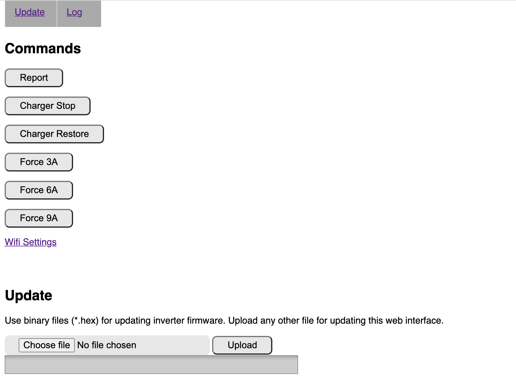

I've started working on a basic web interface for this so I don't have to plug in.
https://github.com/jamiejones85/PriusCh ... bInterface
So far it uses Web Sockets to display the serial output from the charger.
Plans are to allow uploading of new firmware and set configuration options at least, someones written code https://github.com/rene-win/esp_avr_programmer that I'm going to be ripping off for that.
I'm using a Wemos D1 mini, even though it's supposed to be 3.3v hooking the RX and TX pins up directly seems to work.
Contributions will be greatly appreciated.
EDIT
It's a bit rough round the edges, but you can now upload a hex file to flash the attached atmega.
So you directly connect (taking care of different pinout) the Wemos D1 mini to GND, 5V, RX, TX and RST in the "FTDI 5V" connector and it just works?
- Posts: 1774

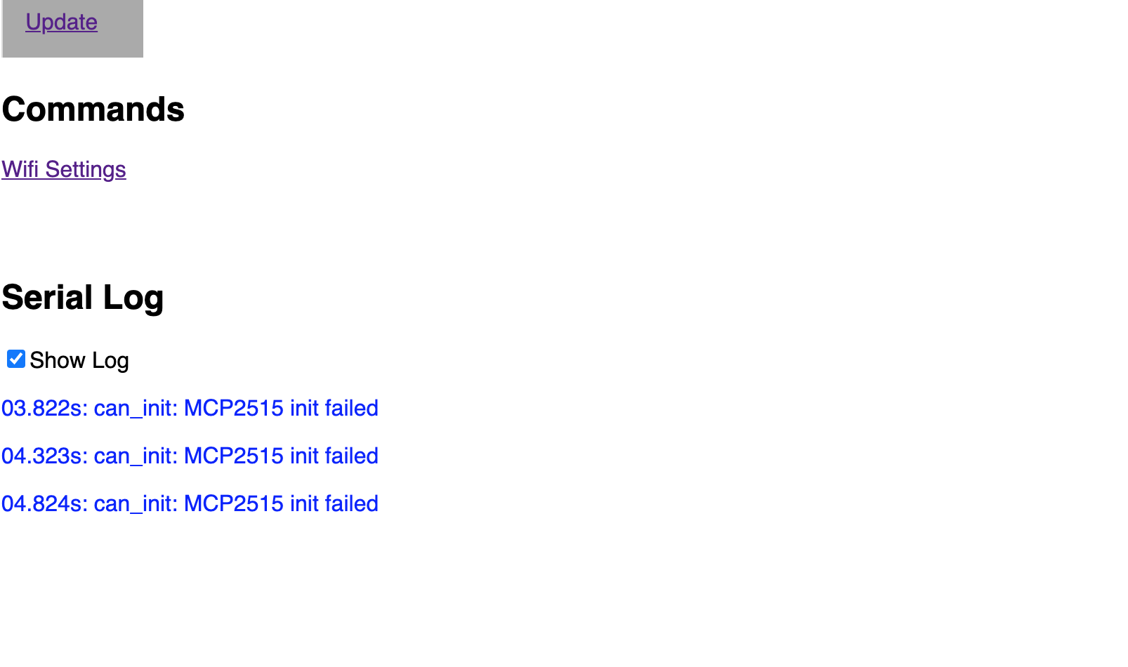

pretty much, yea. I'd read https://hackaday.com/2016/07/28/ask-hac ... -tolerant/ and though what the hell, I'll give it a go.
I've flashed a hex with the web interface that prints a serial message and this started appearing in the output. So on to cleaning up the code.

-Updating the Atmega Firmware
-Sending Commands
-Viewing Output Log
I'll have to look at some changes to the charger code next, moving the configuration parameters in to EEPROM and allowing this to be set from the Web Interface.
