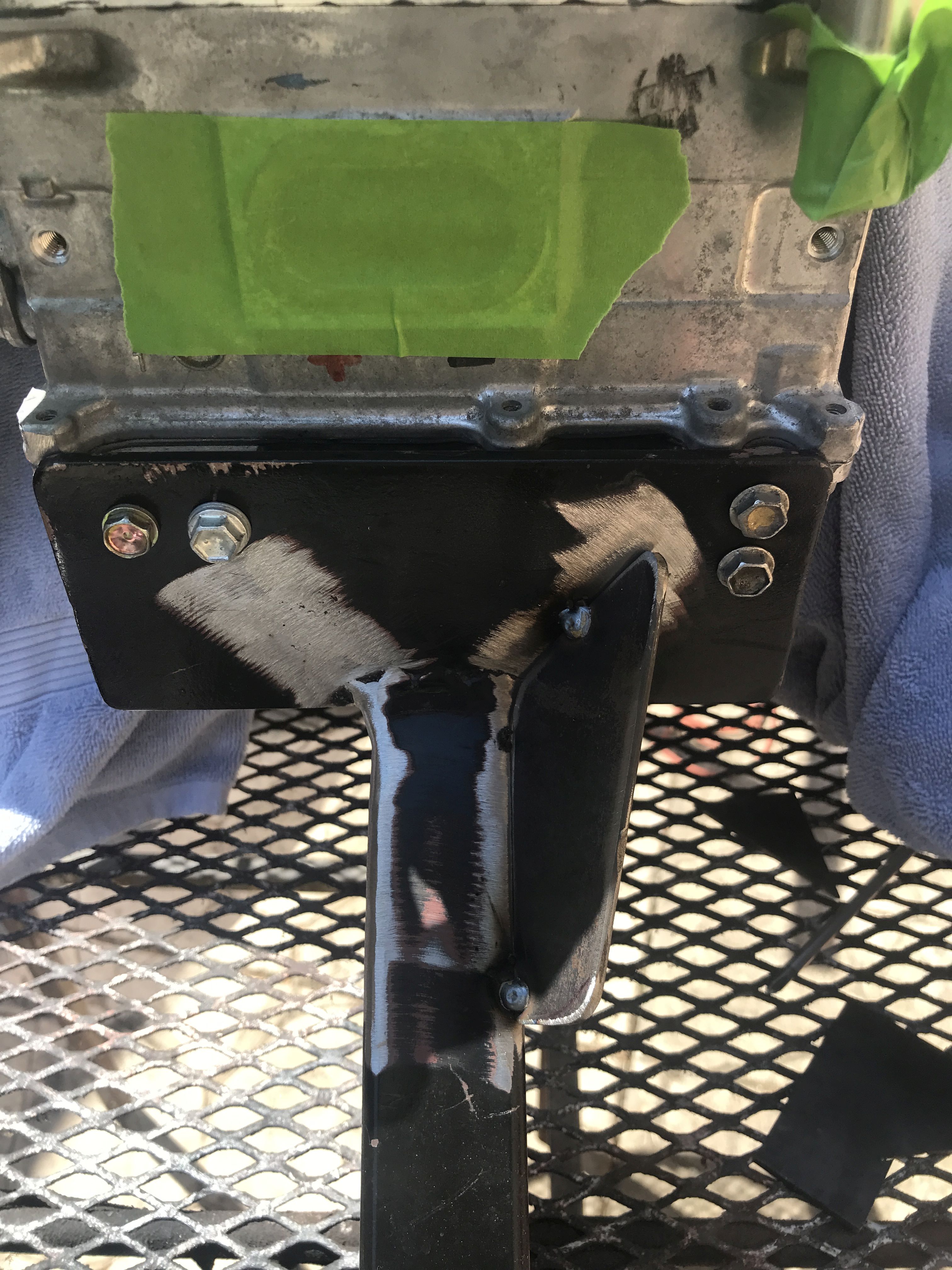

this is just a trial fit, she will get a coat of paint and maybe even some sort of a rubberized gasket

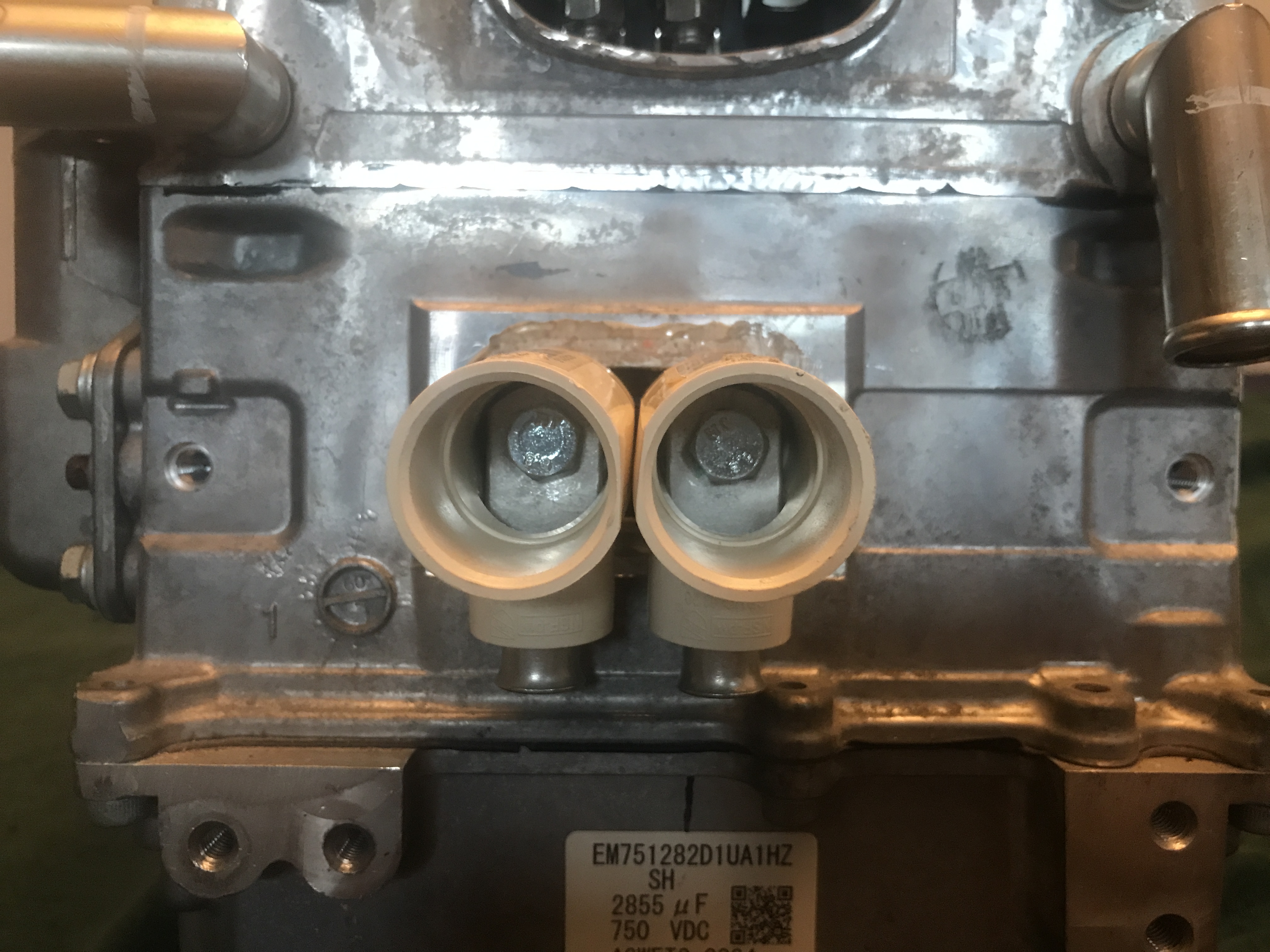

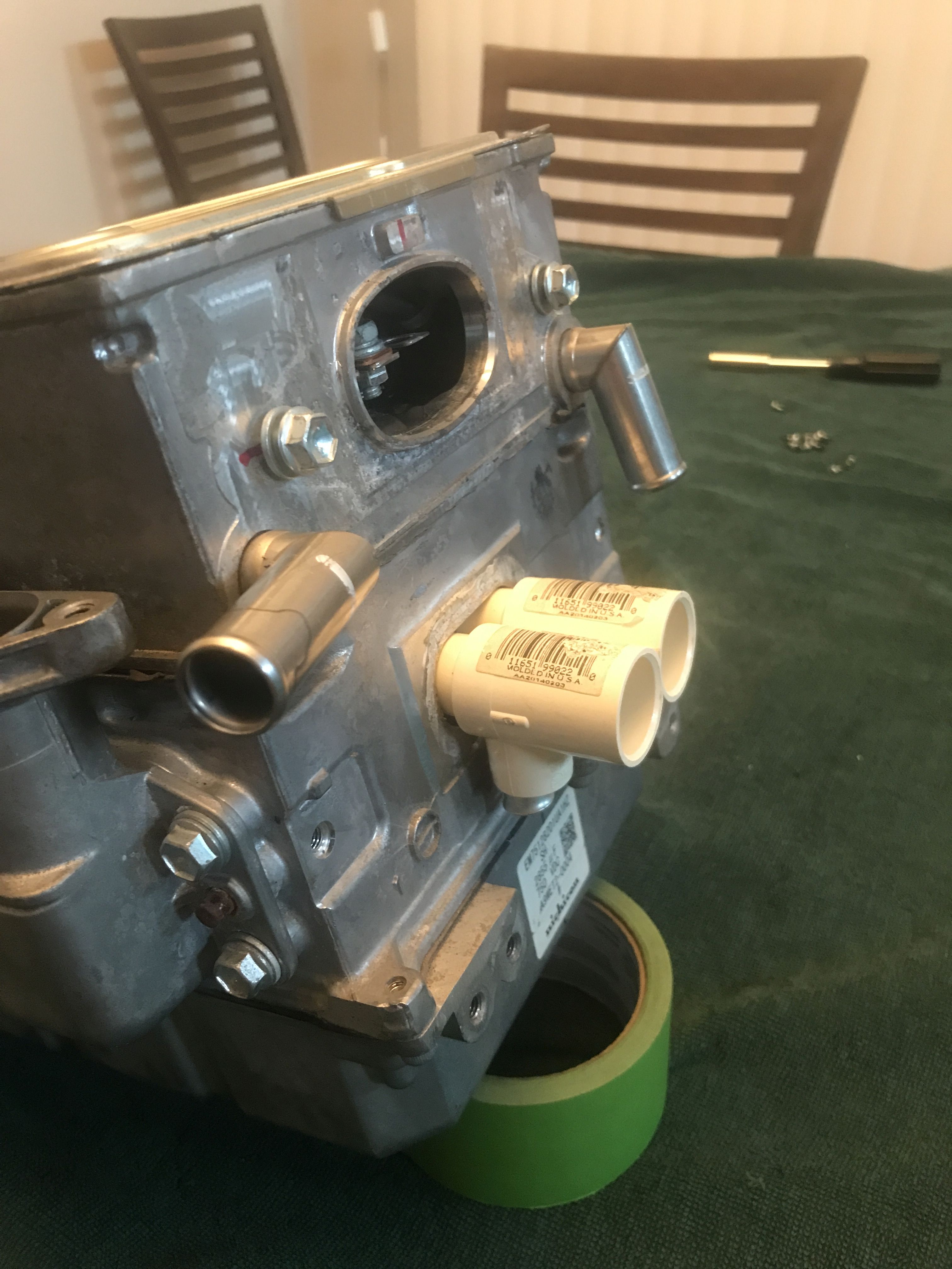

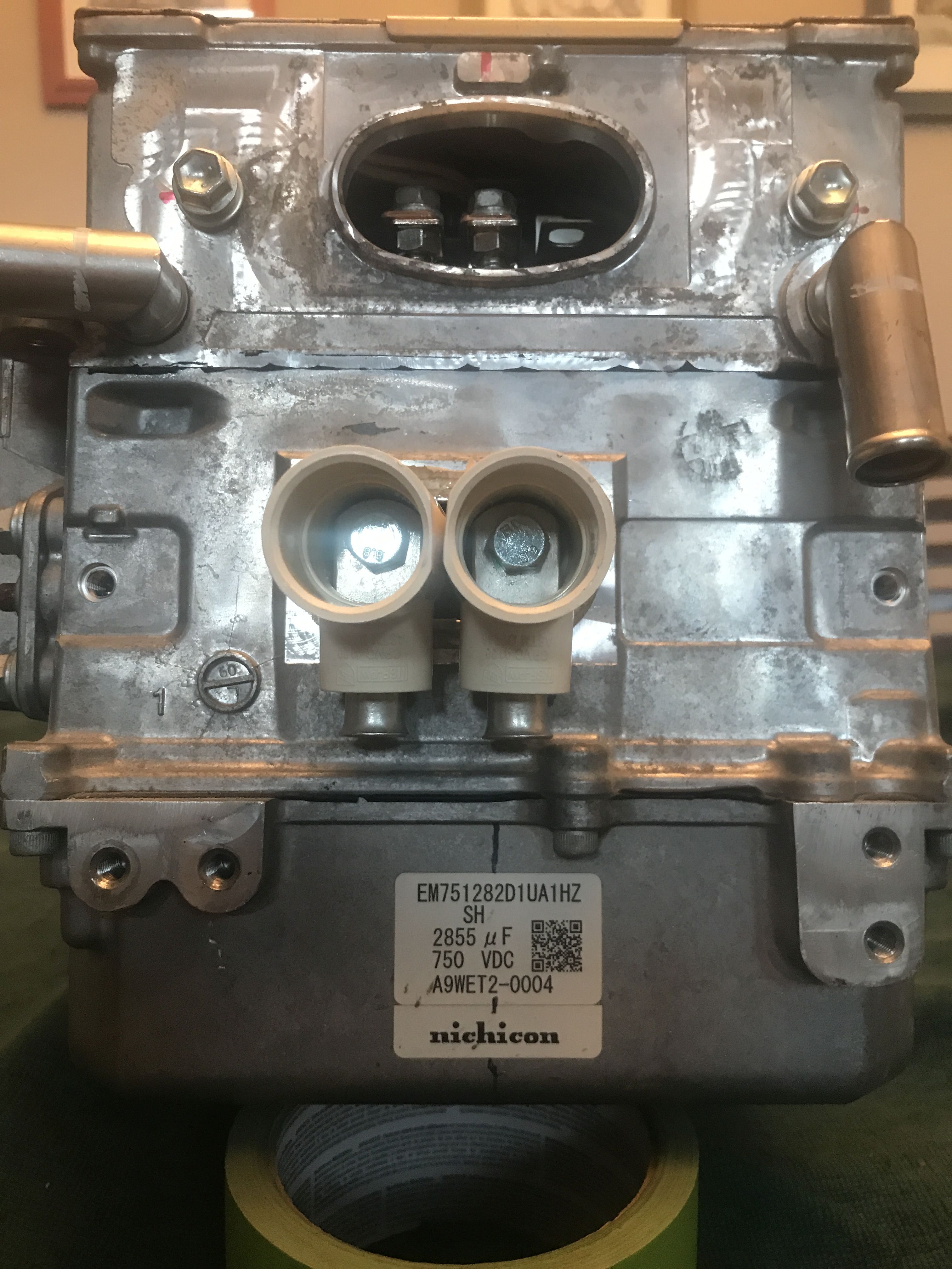

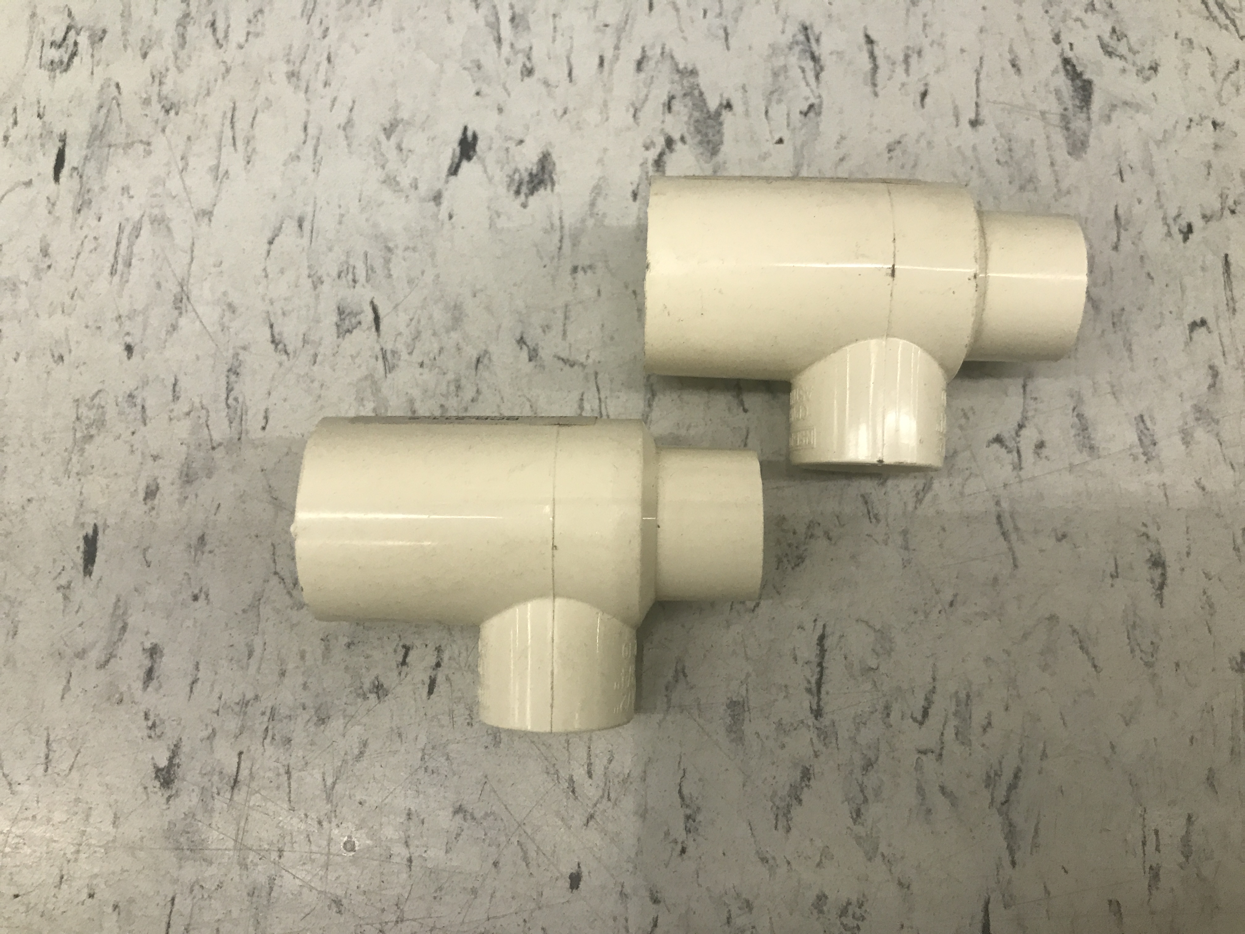

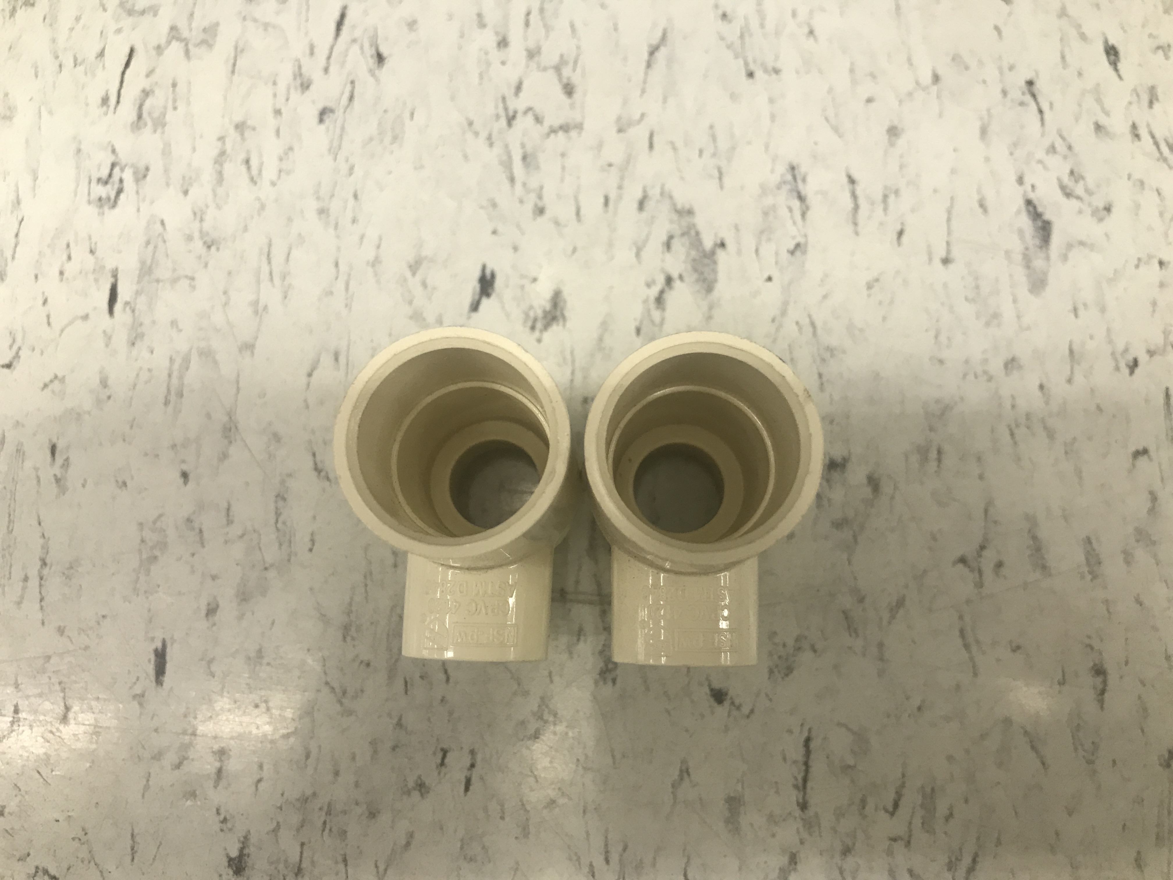

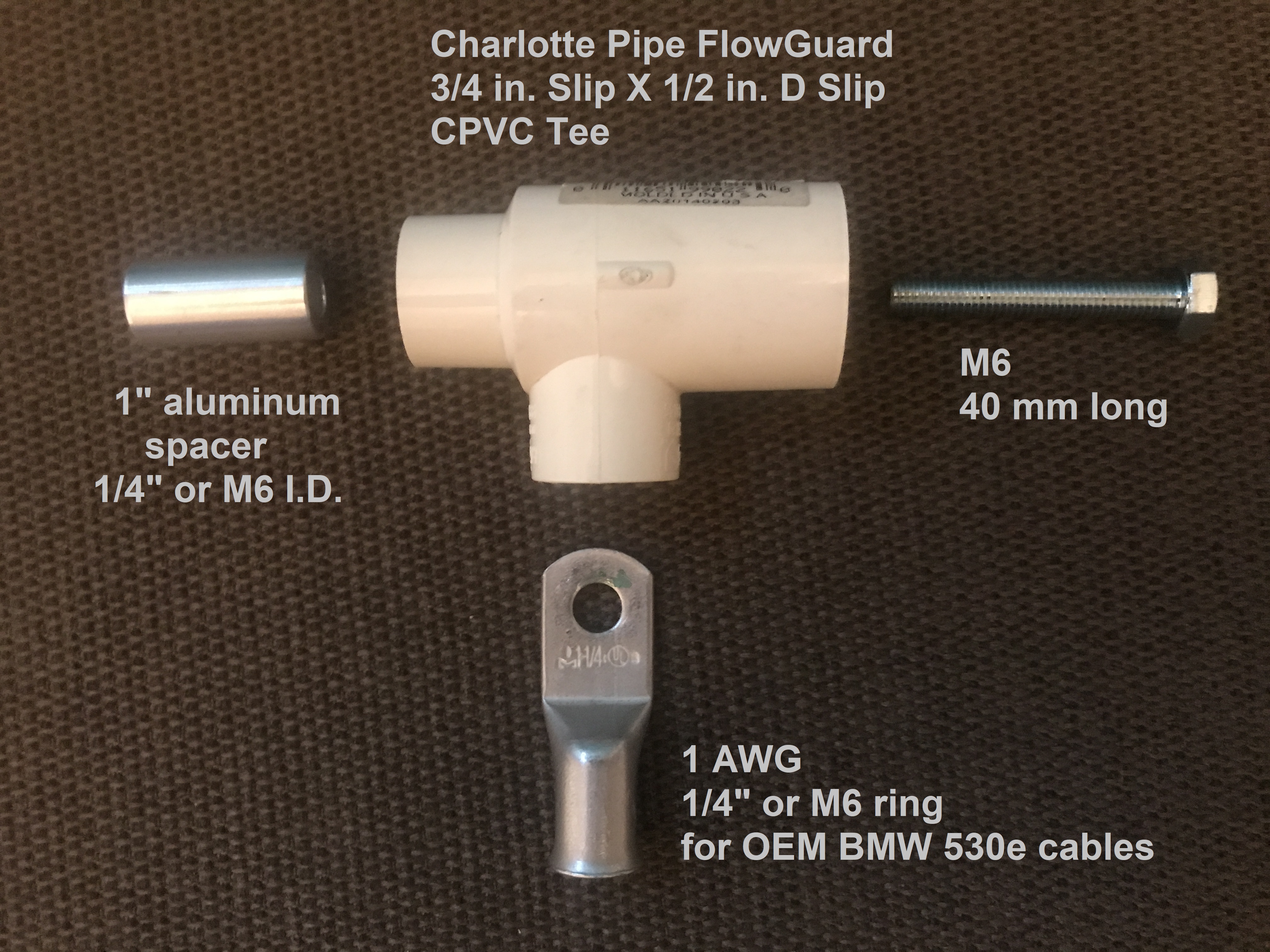

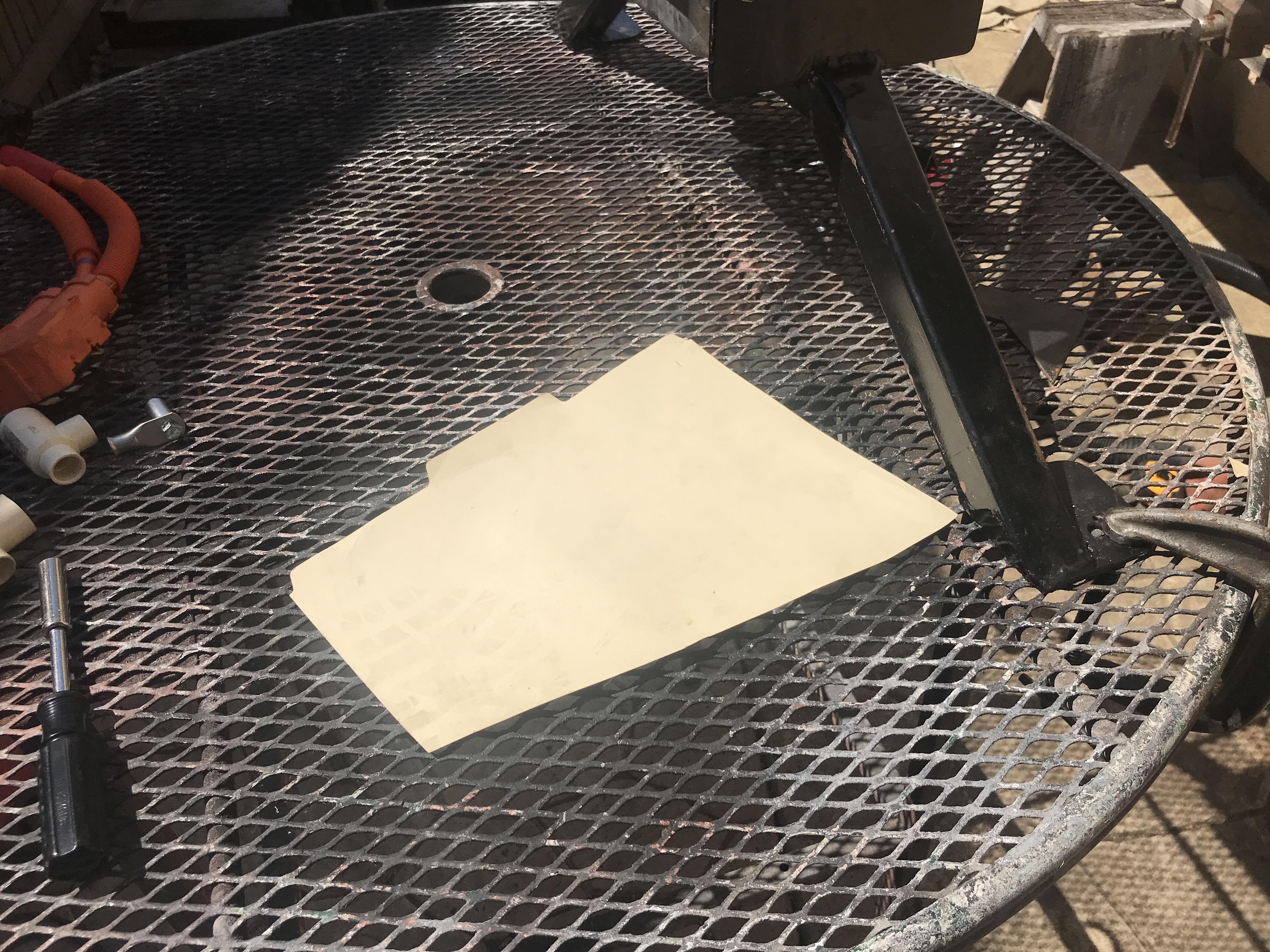

let's spit ball here
Charlotte Pipe FlowGuard 3/4 in. Slip X 1/2 in. D Slip CPVC Tee
Item #41952
Mfr #CTS024002000
What, are we plumbers now?
Item #41952
Mfr #CTS024002000
- Gregski
- Posts: 3163
- Has thanked: 631 times
- Been thanked: 1609 times

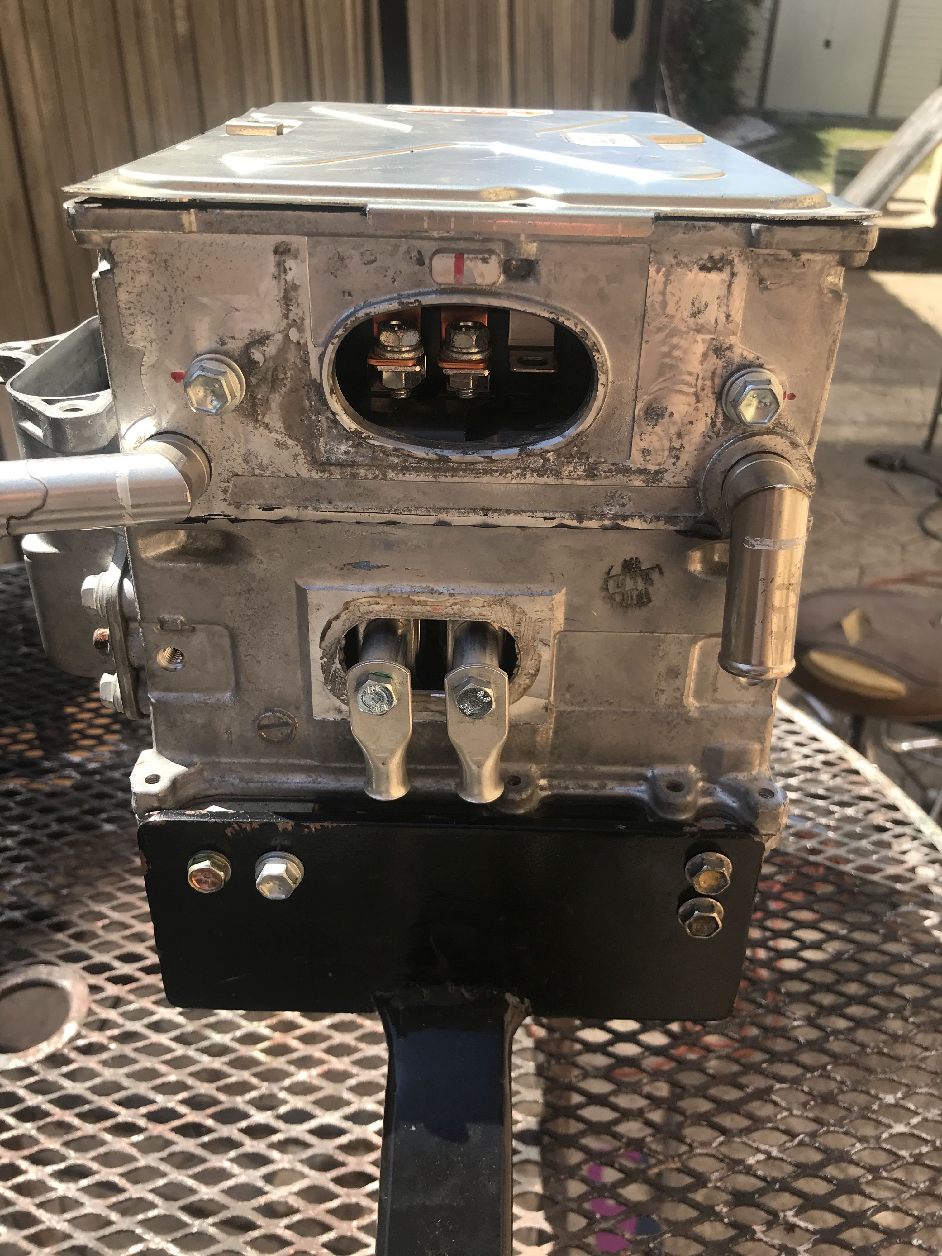

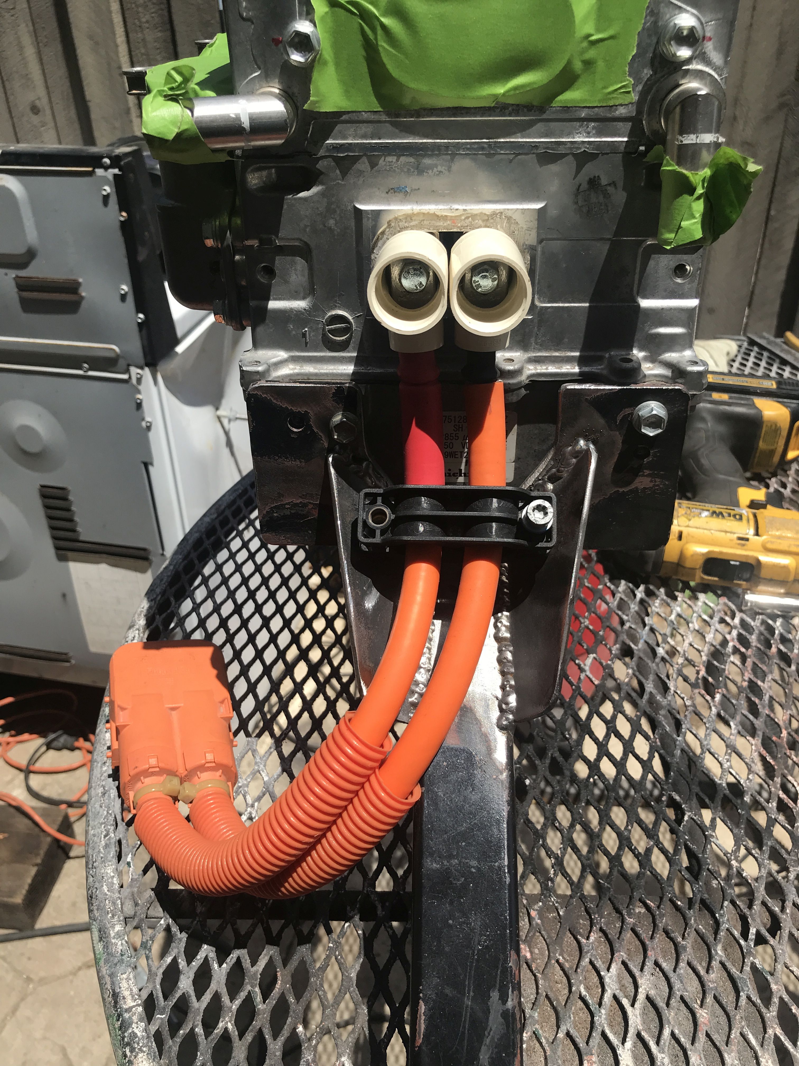

Where are we going with this? OK, 1" spacer
- Gregski
- Posts: 3163
the Double Barrel Shotgun design TM
Note: some filing and grinding required to make that cable lug fit in the 1/2" hole

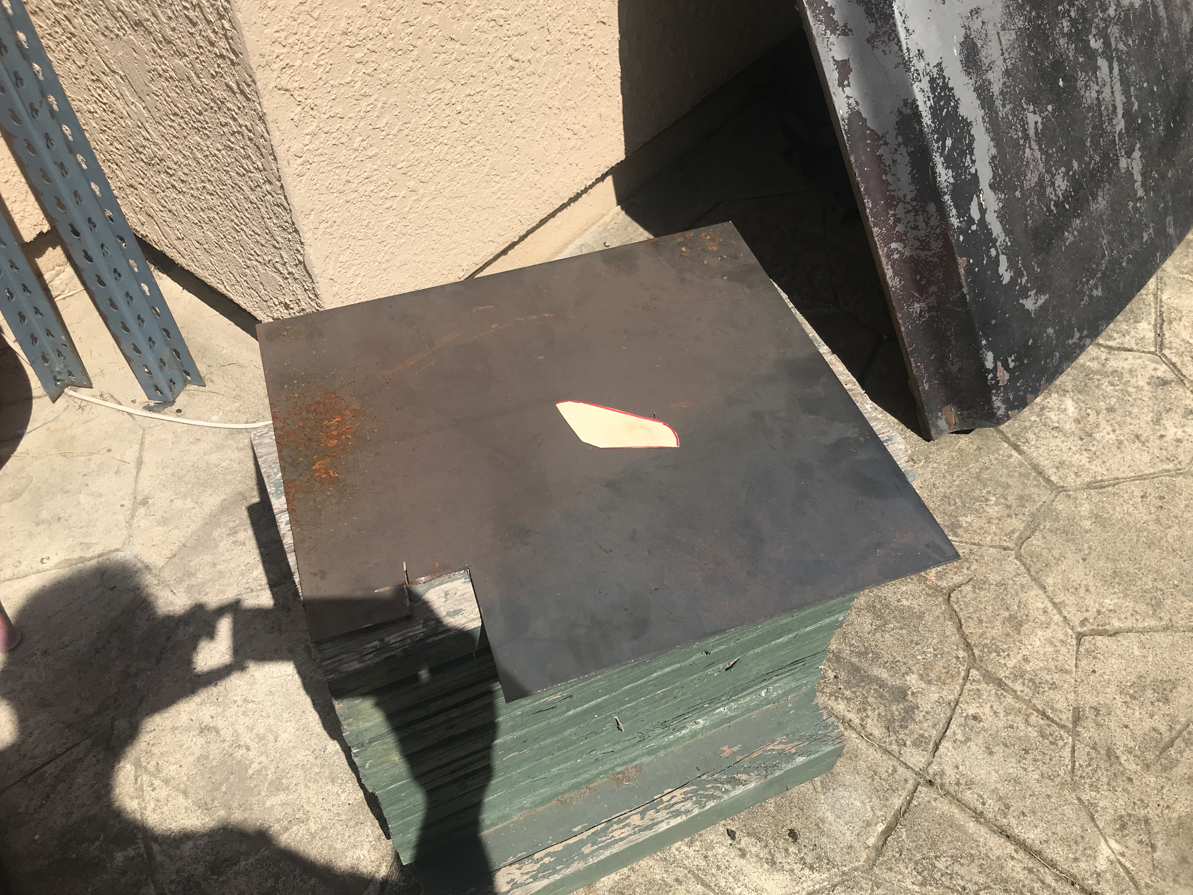

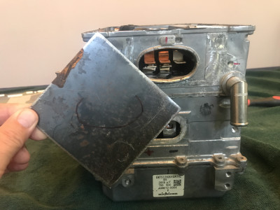

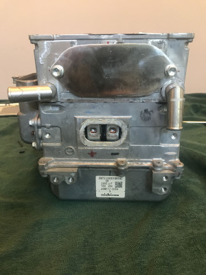

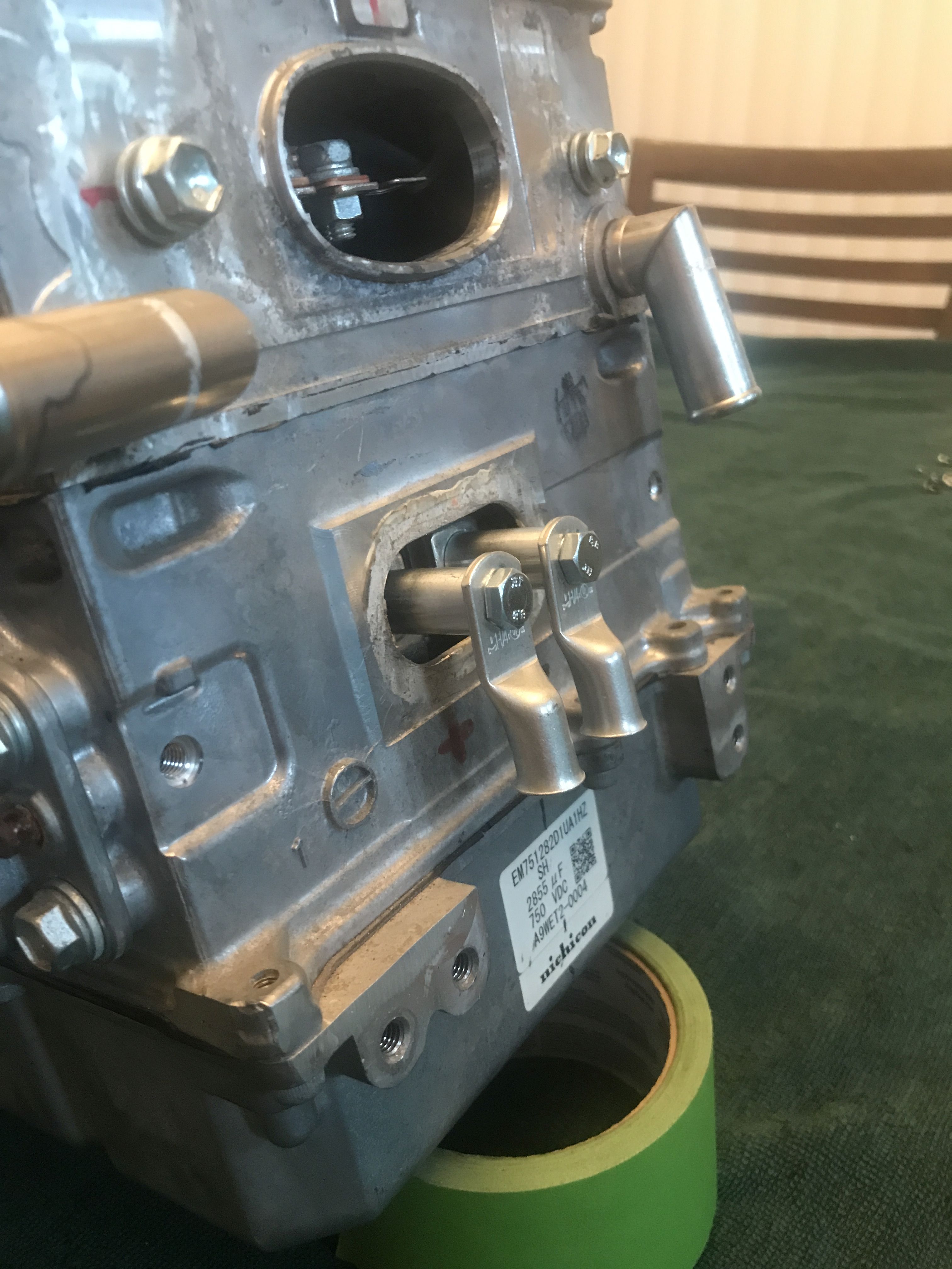

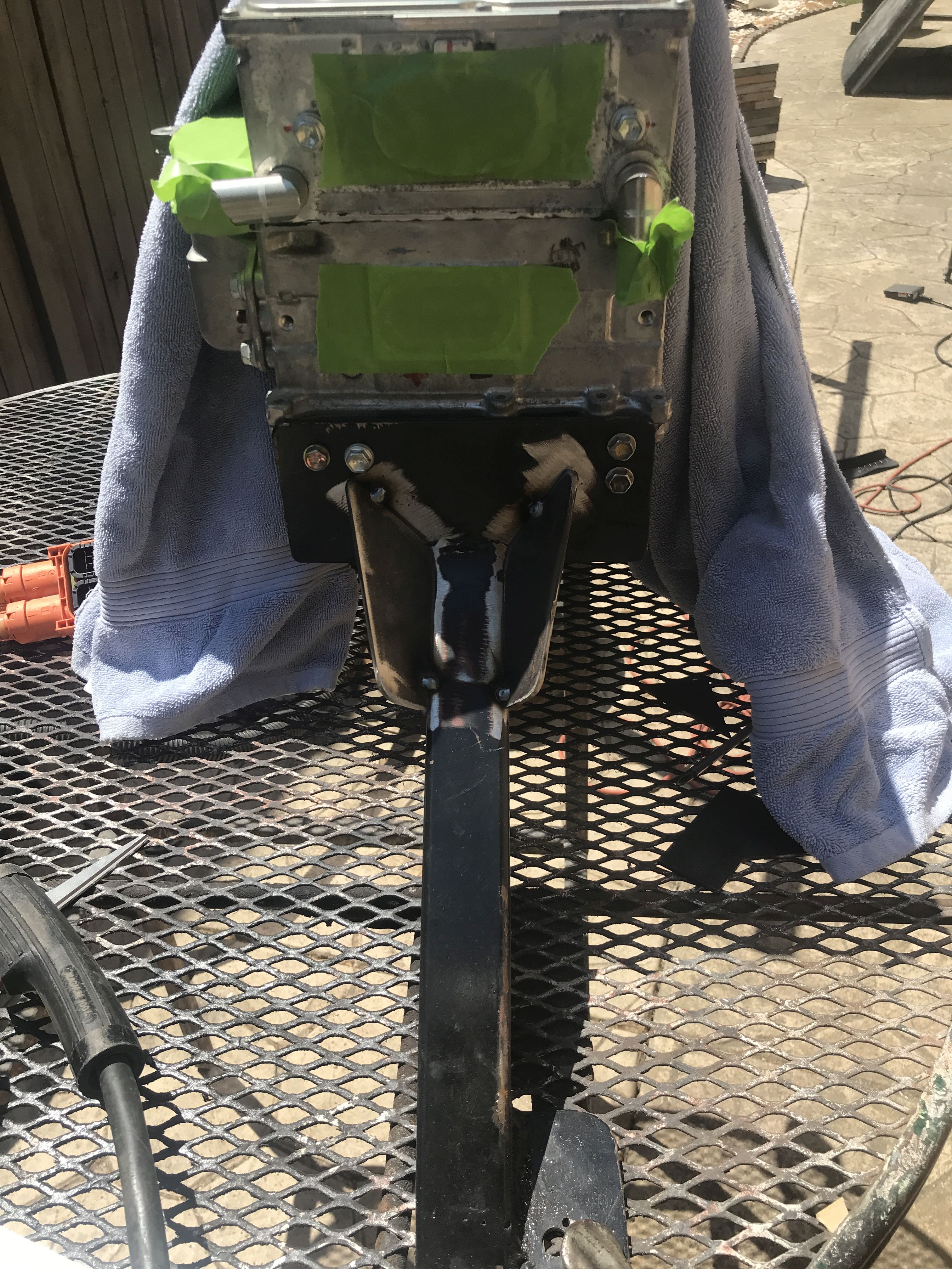

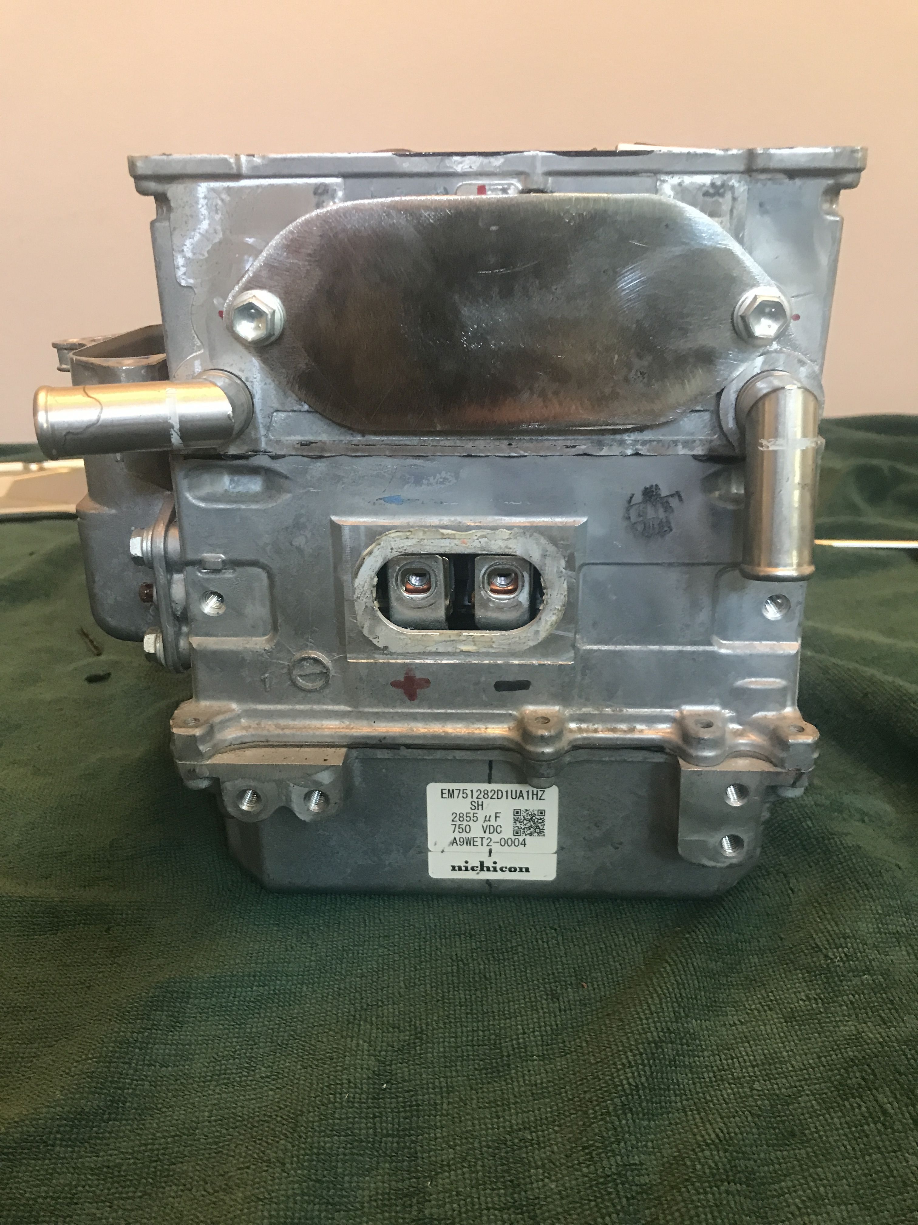

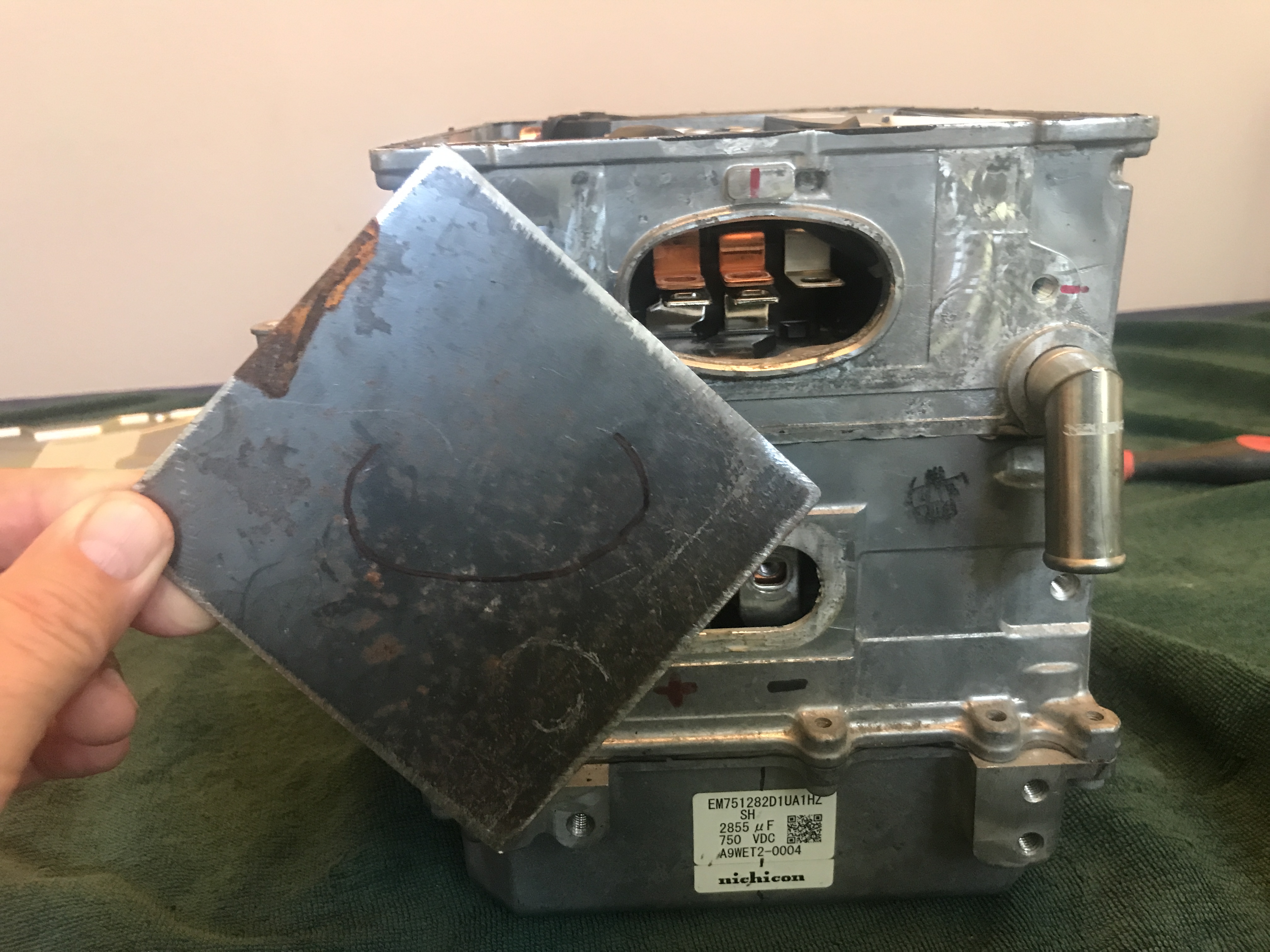

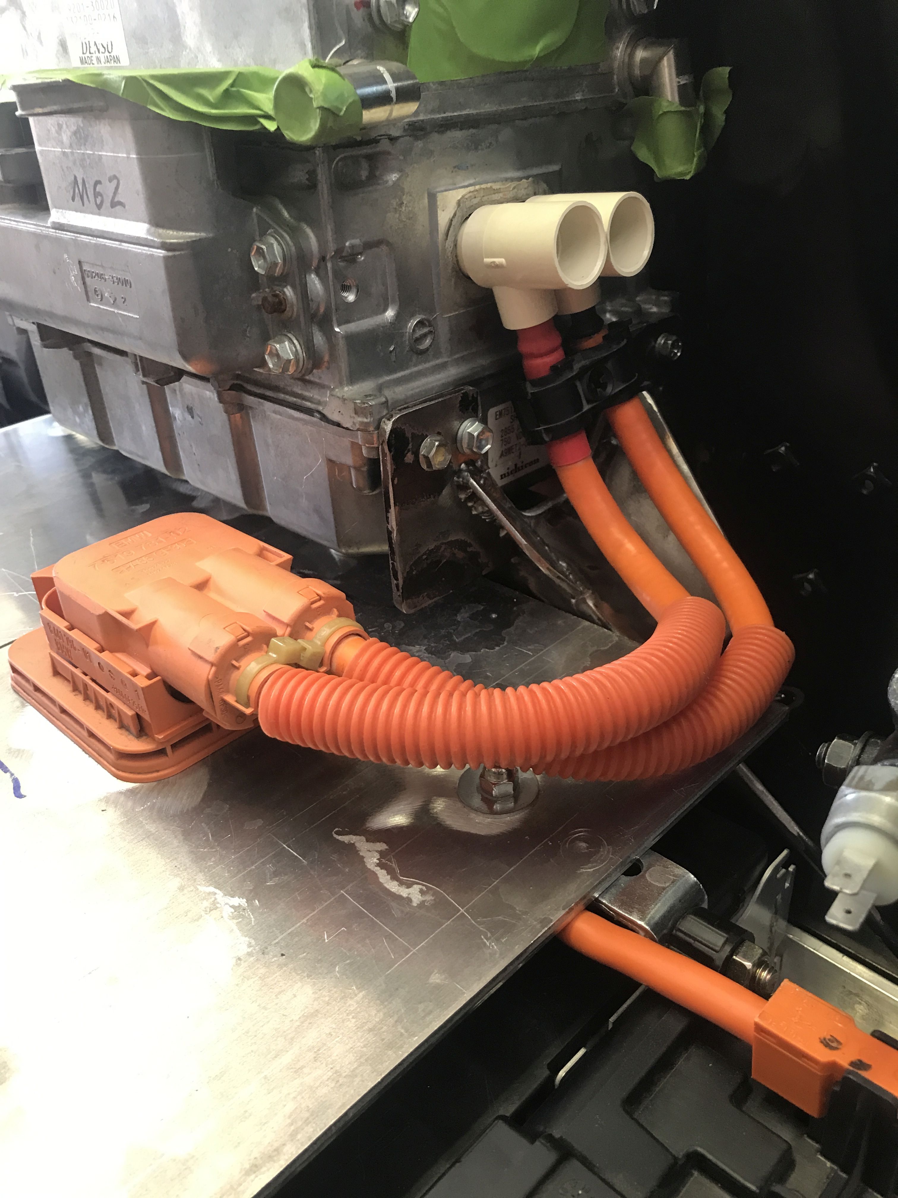

in order to get the 360 high voltage wires as close to the inverter as possible we have to modify the inverter bracket
- Gregski
- Posts: 3163
but first we must reinforce what's already there and what will remain after the debauchery that is about to ensue
- Gregski
- Posts: 3163

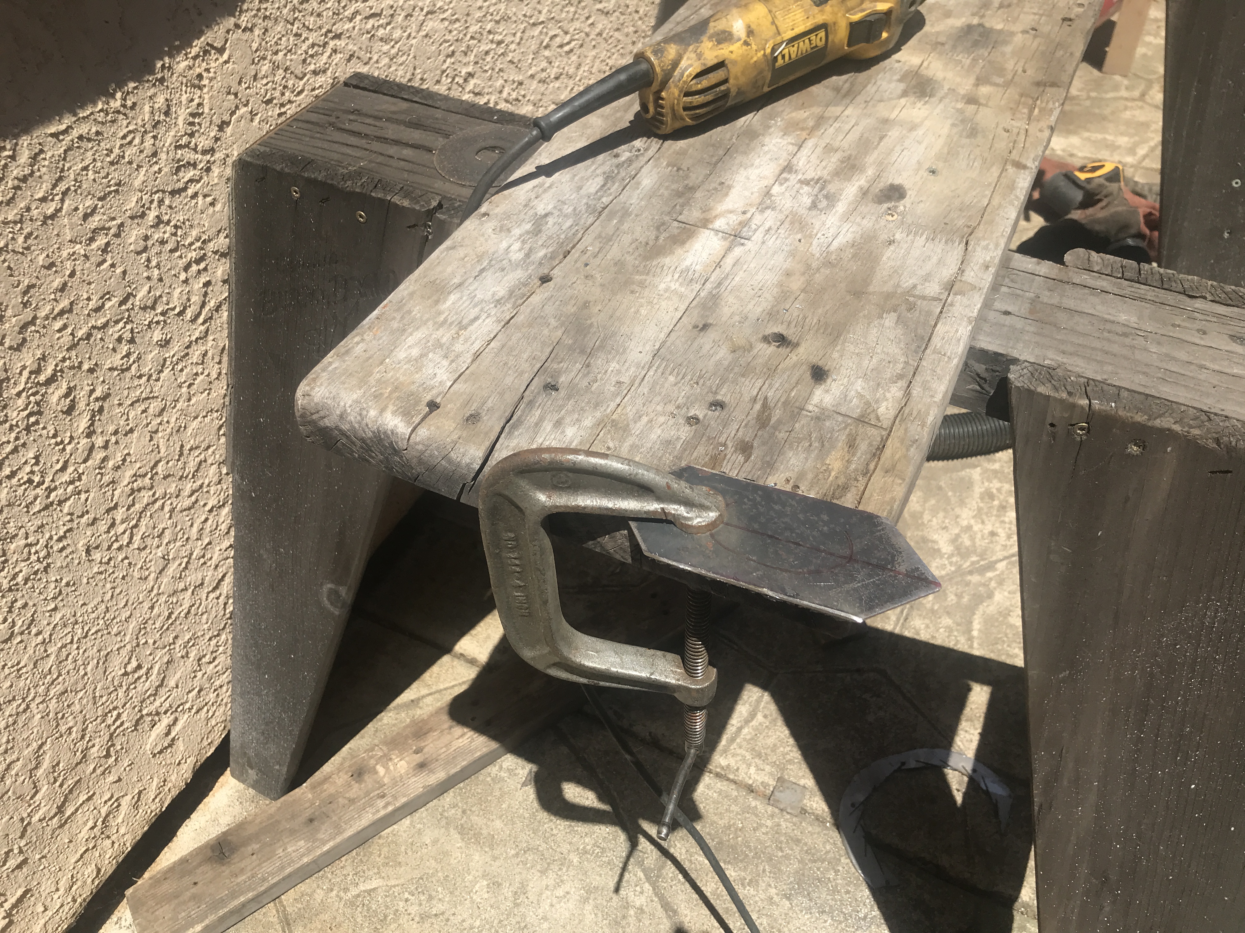

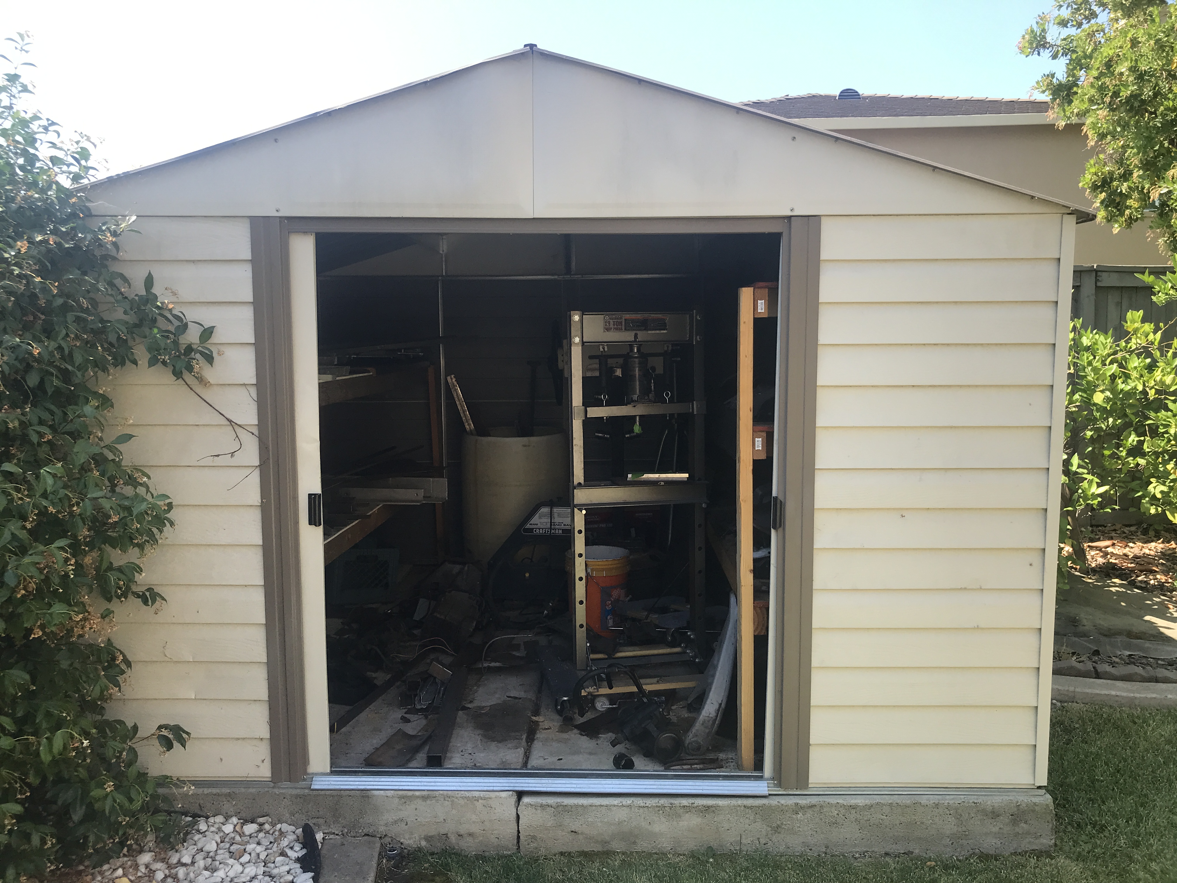

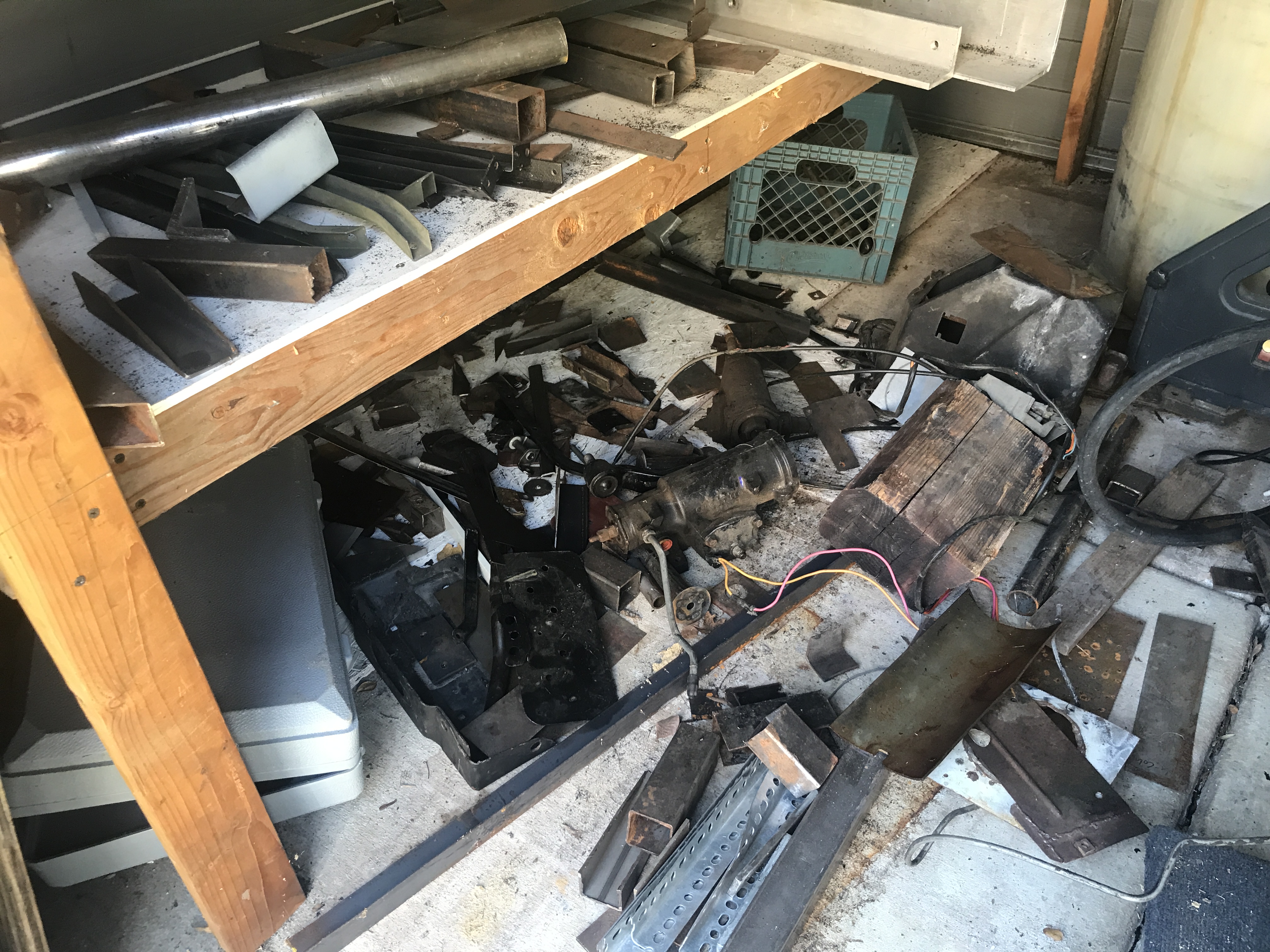

for this we will need some metal, so off to the Shed of Stuff where it appears we are running a little bit low on stock

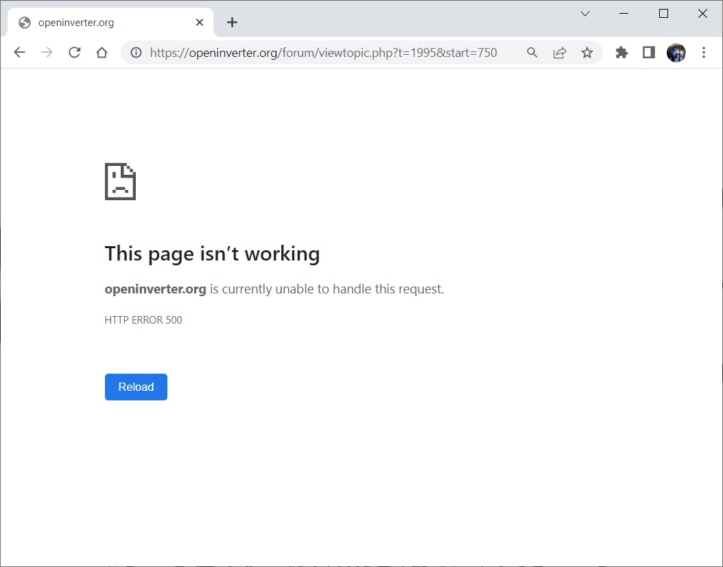

snap crackle pop, did I just break OpenInverter ?

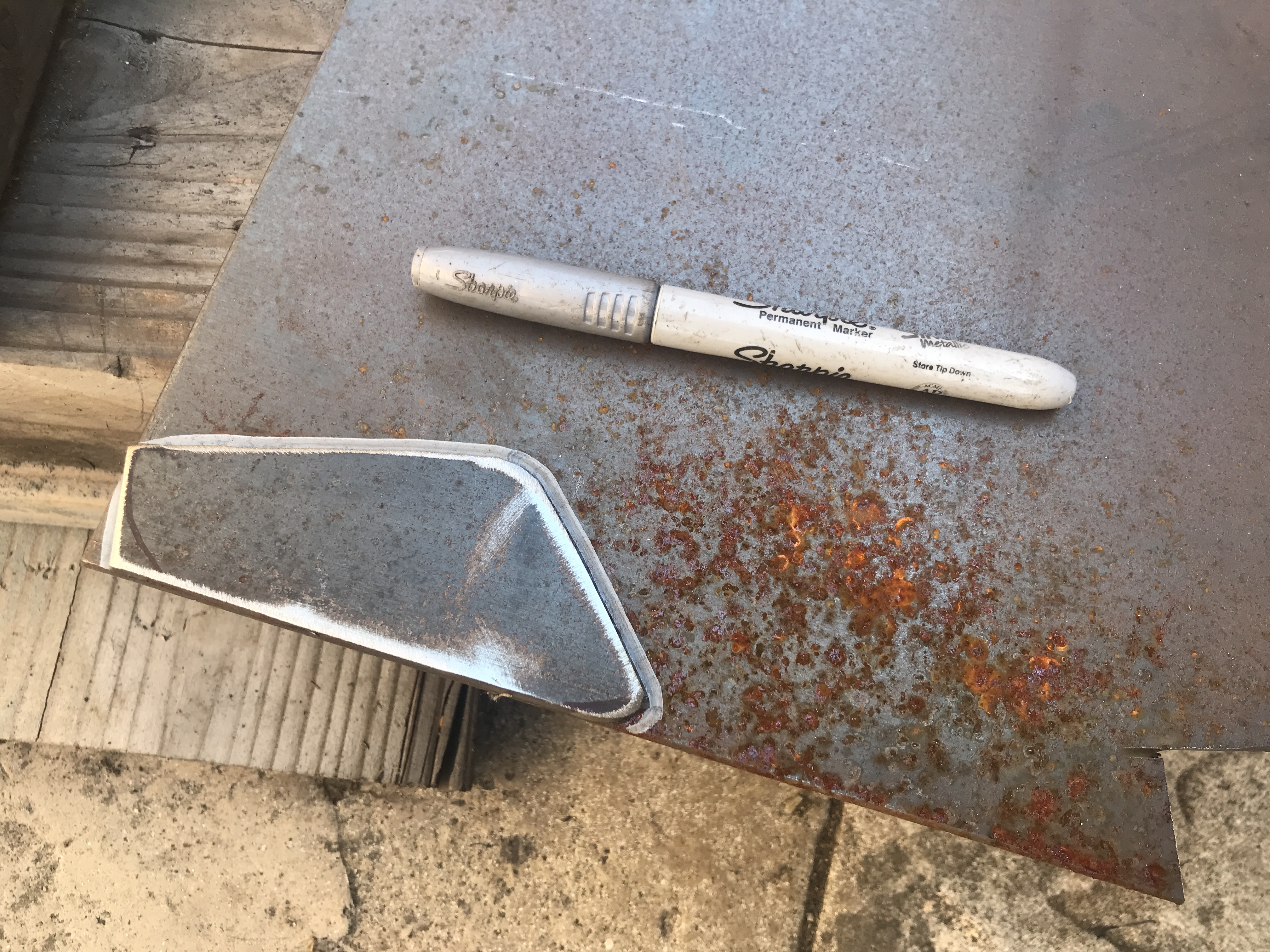

this piece seems large enuff

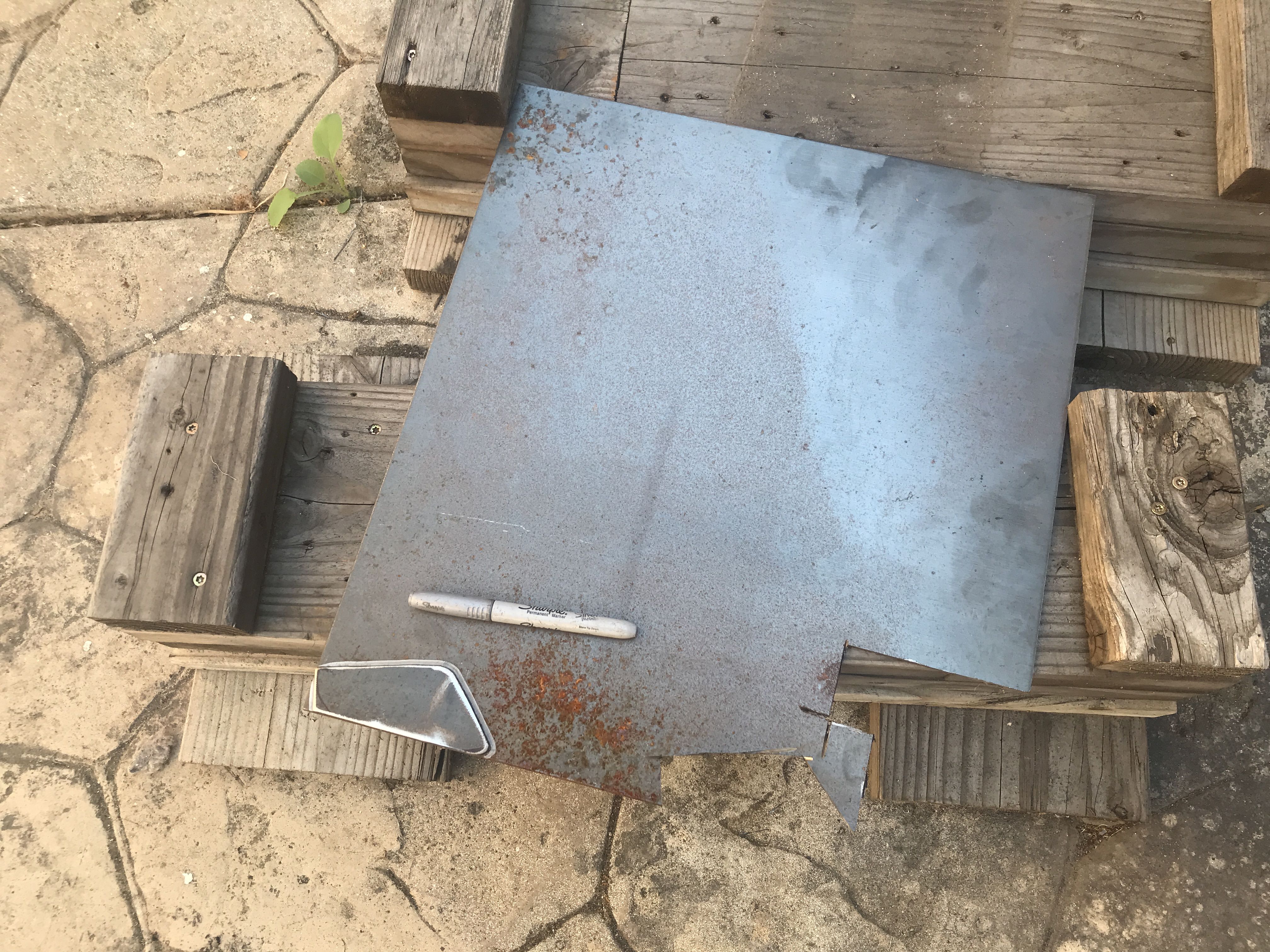

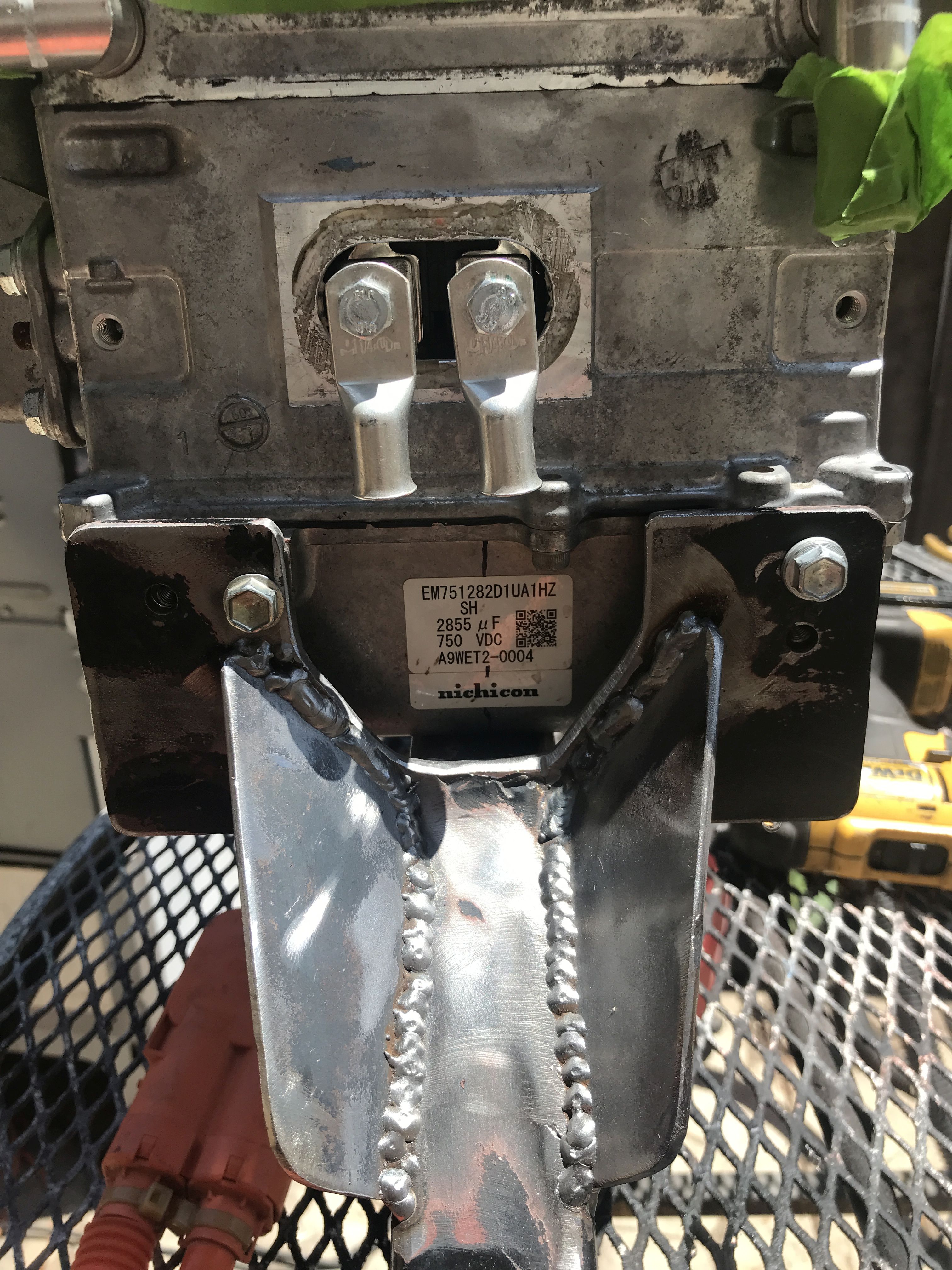

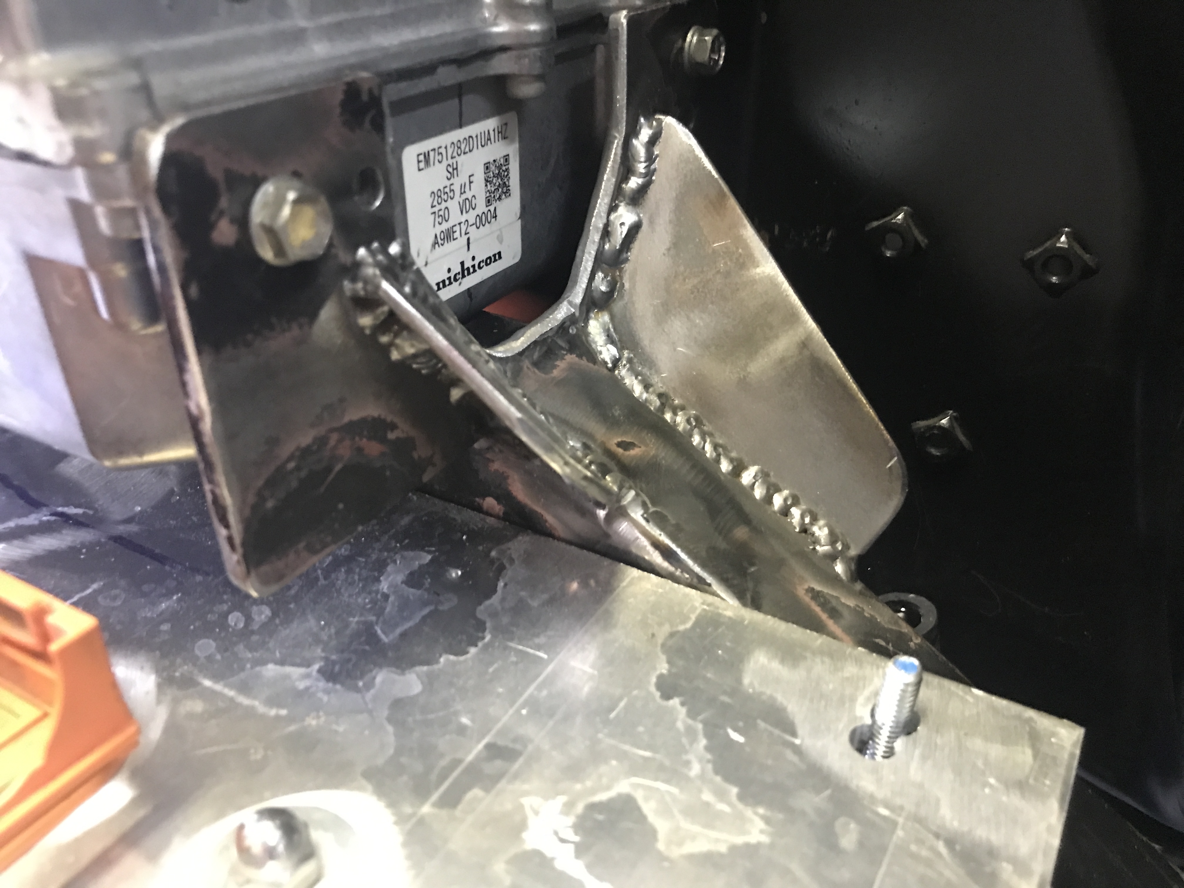

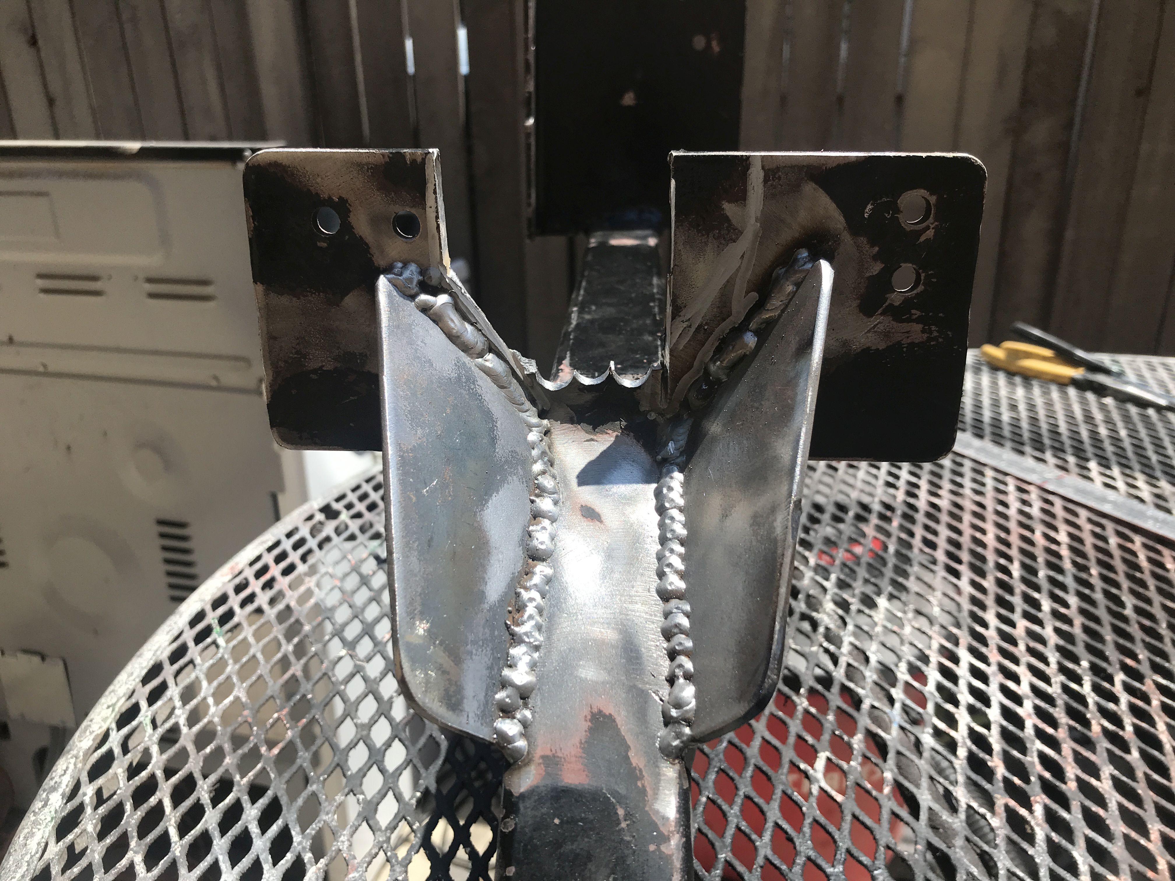

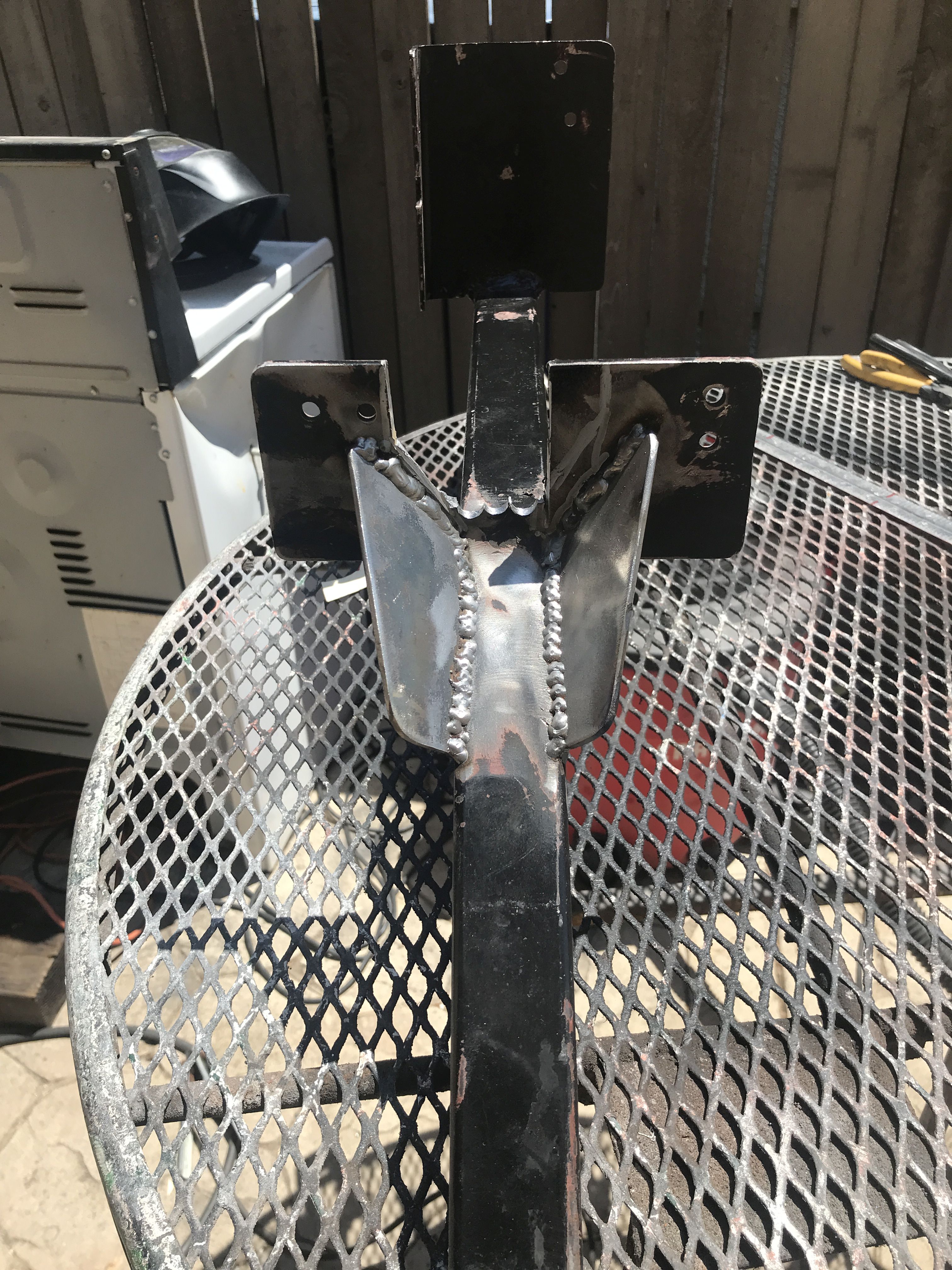

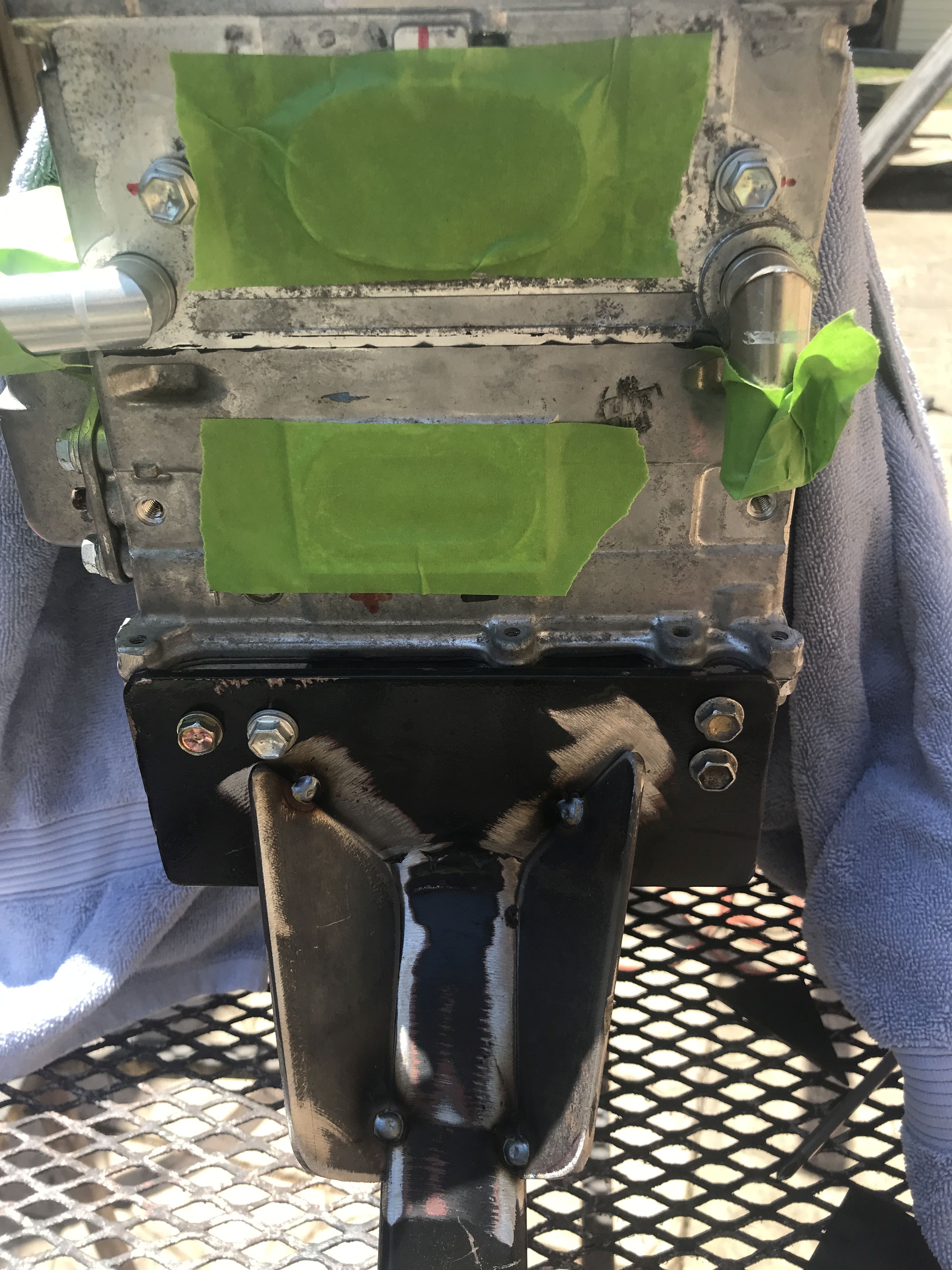

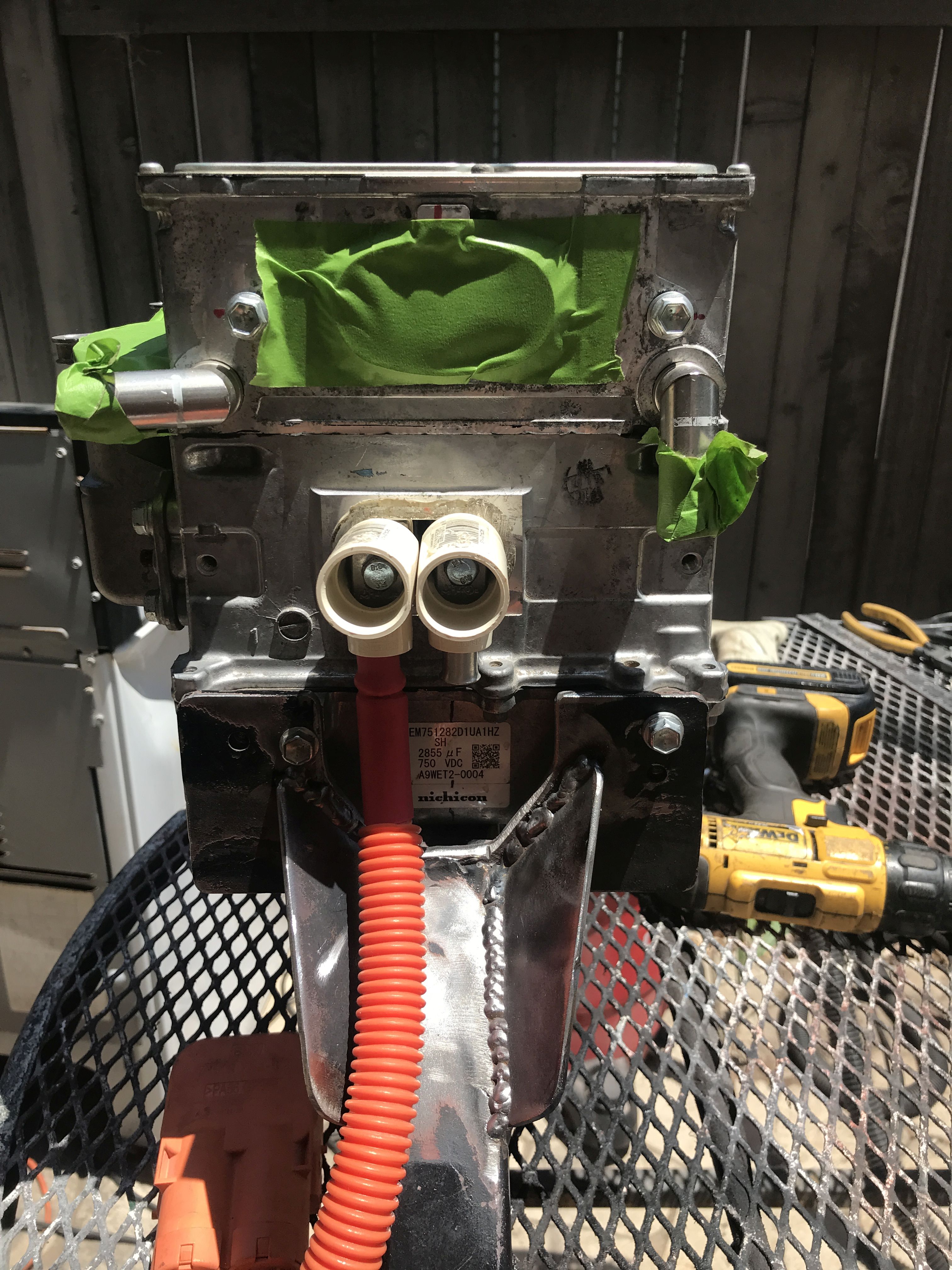

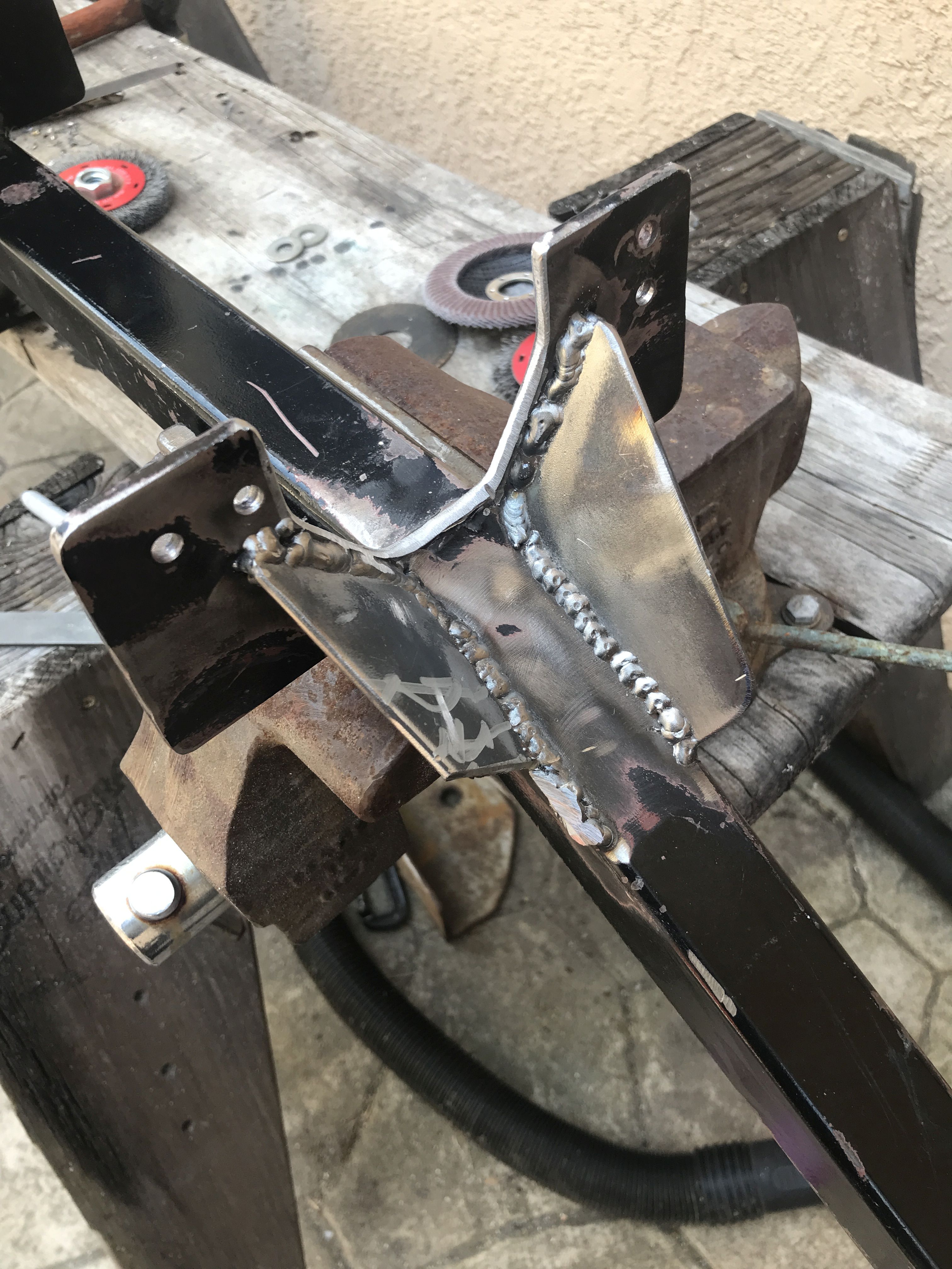

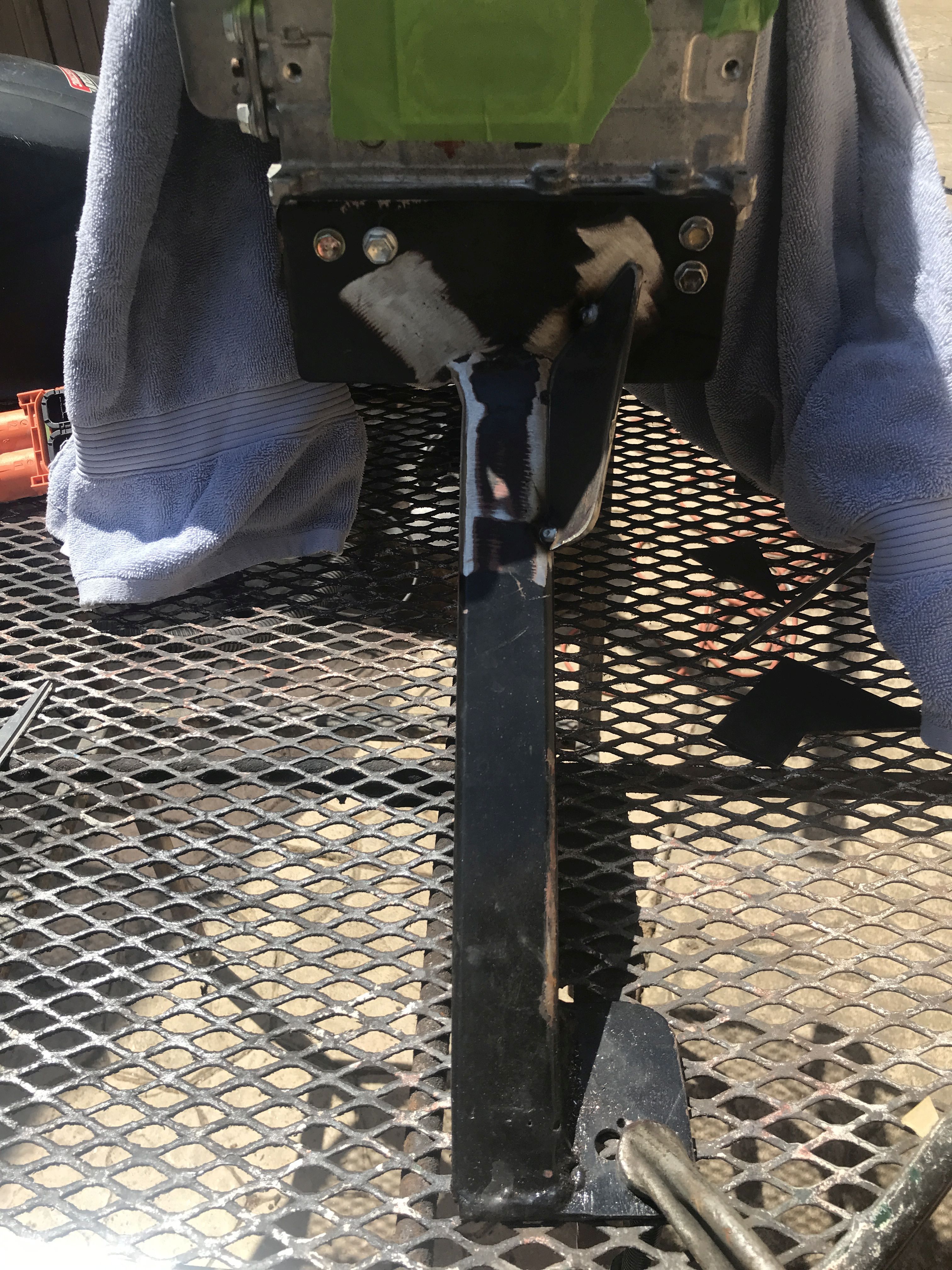

so this is what I'm going for I call it the Winged Hussars design
- Gregski
- Posts: 3163

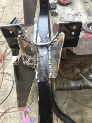

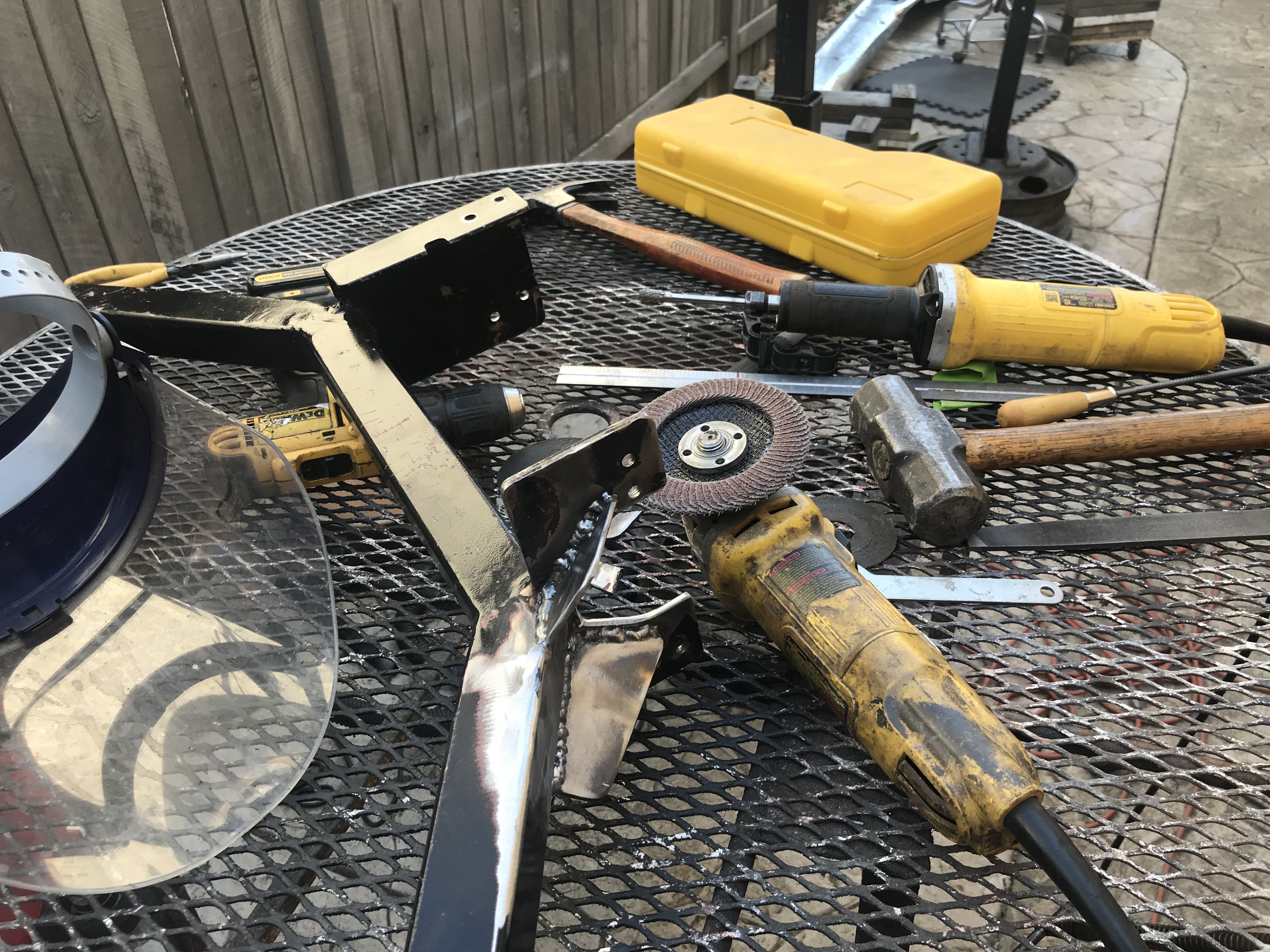

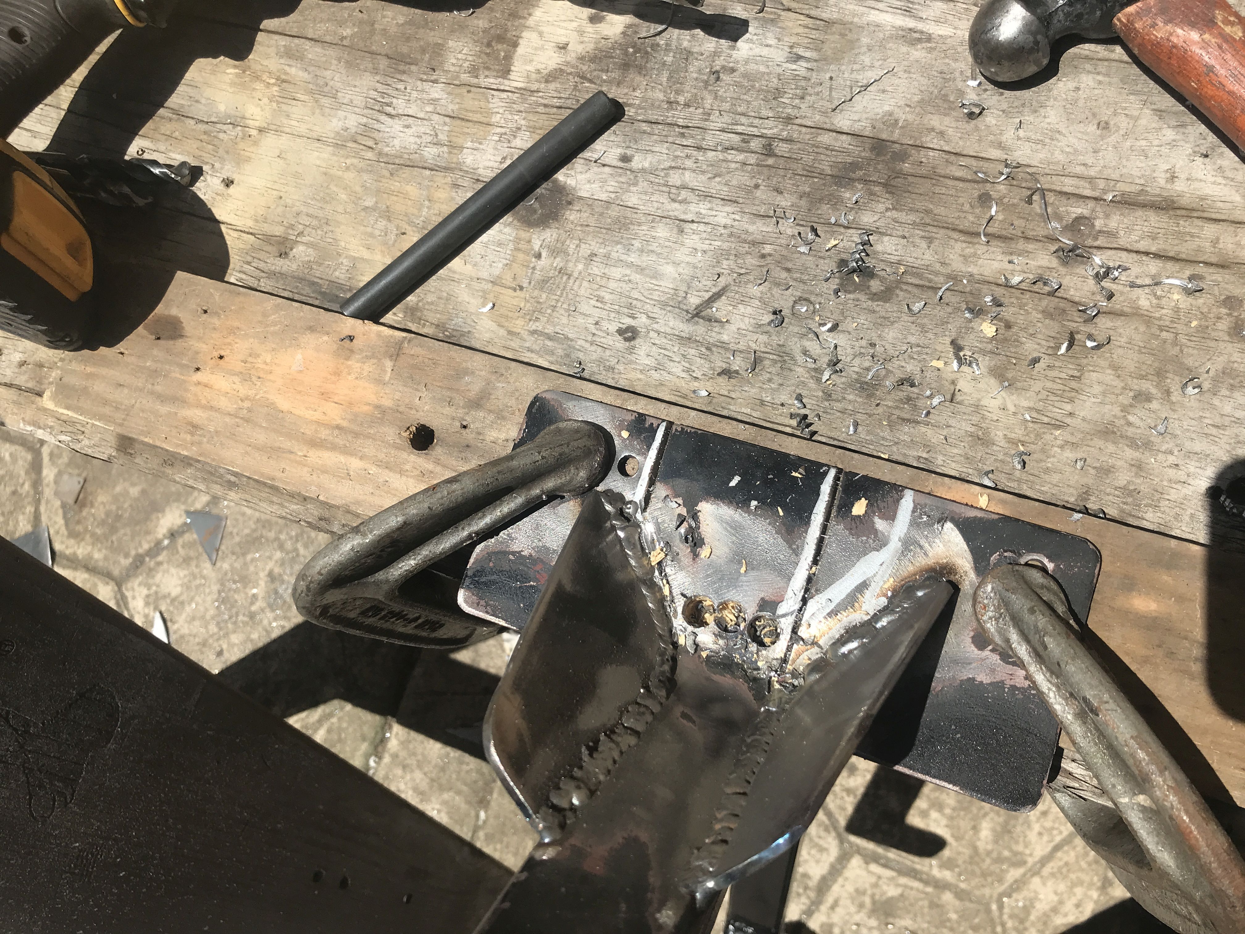

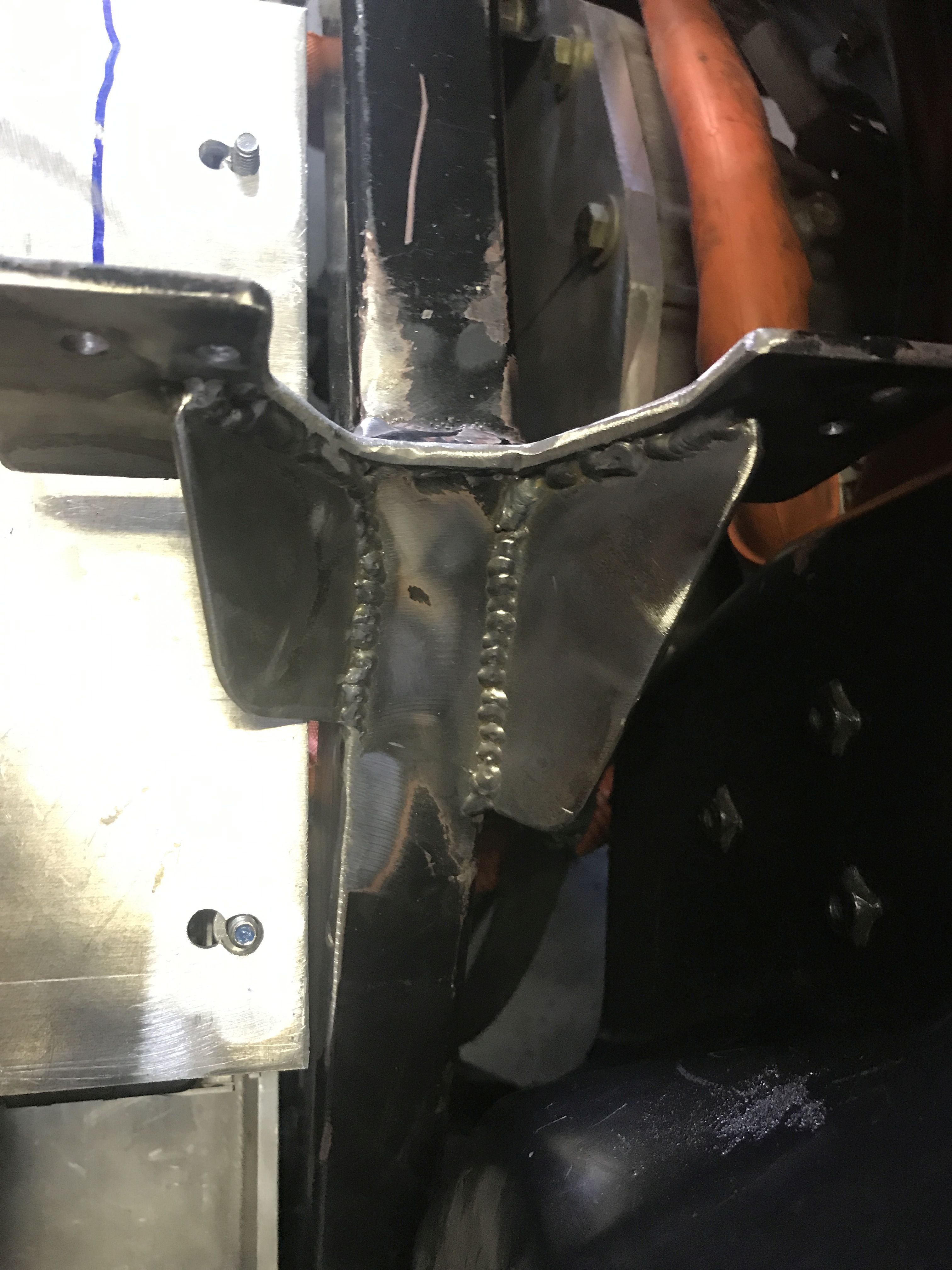

I like to prime, paint, and clear coat all my custom made brackets first before cutting them up... (can any of you relate?)
I'm still working on my Welding Game and here I tried the tac tac tac method (dumb I know)
first attempt at the proper cut out

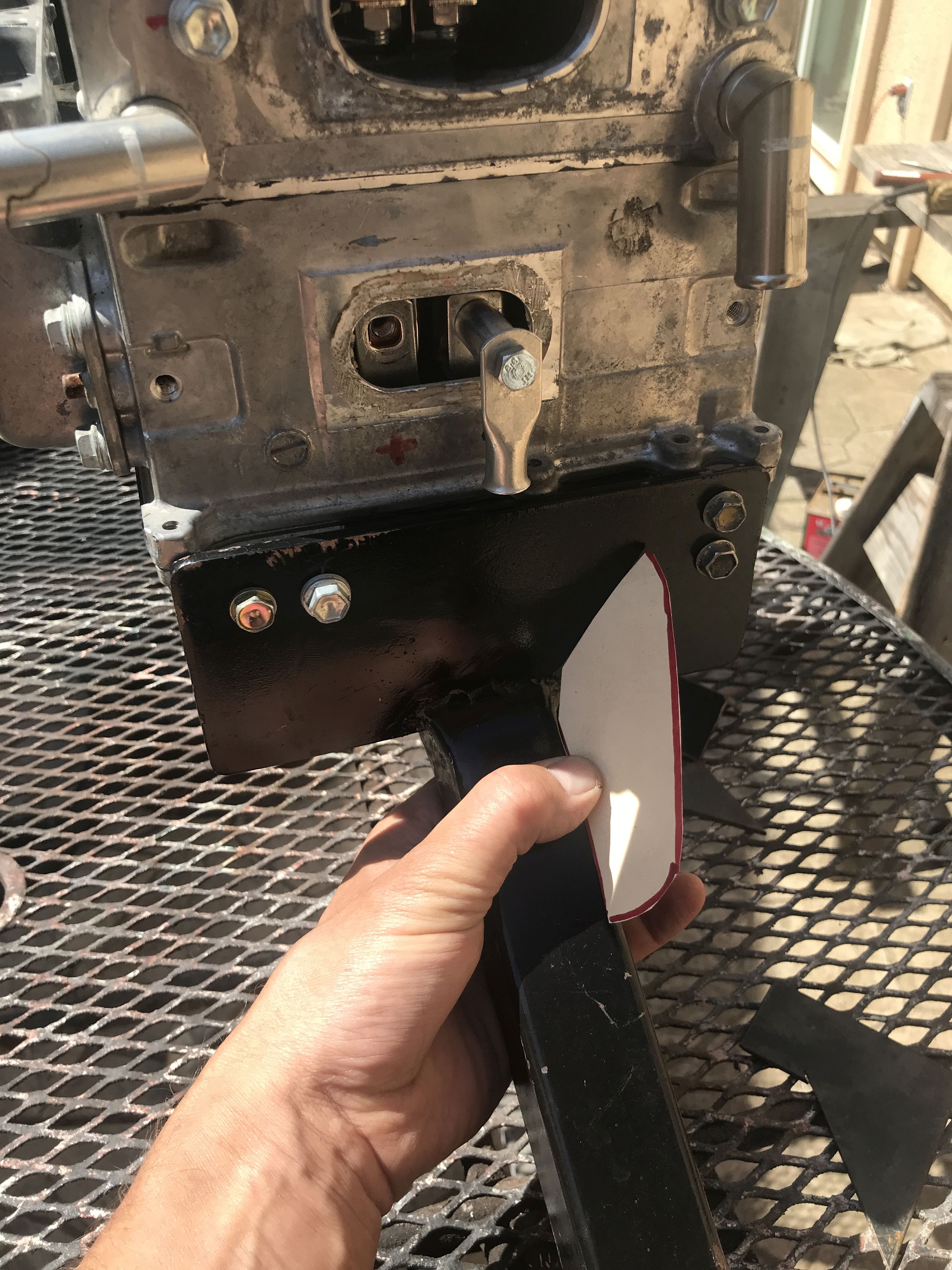

- Gregski
- Posts: 3163

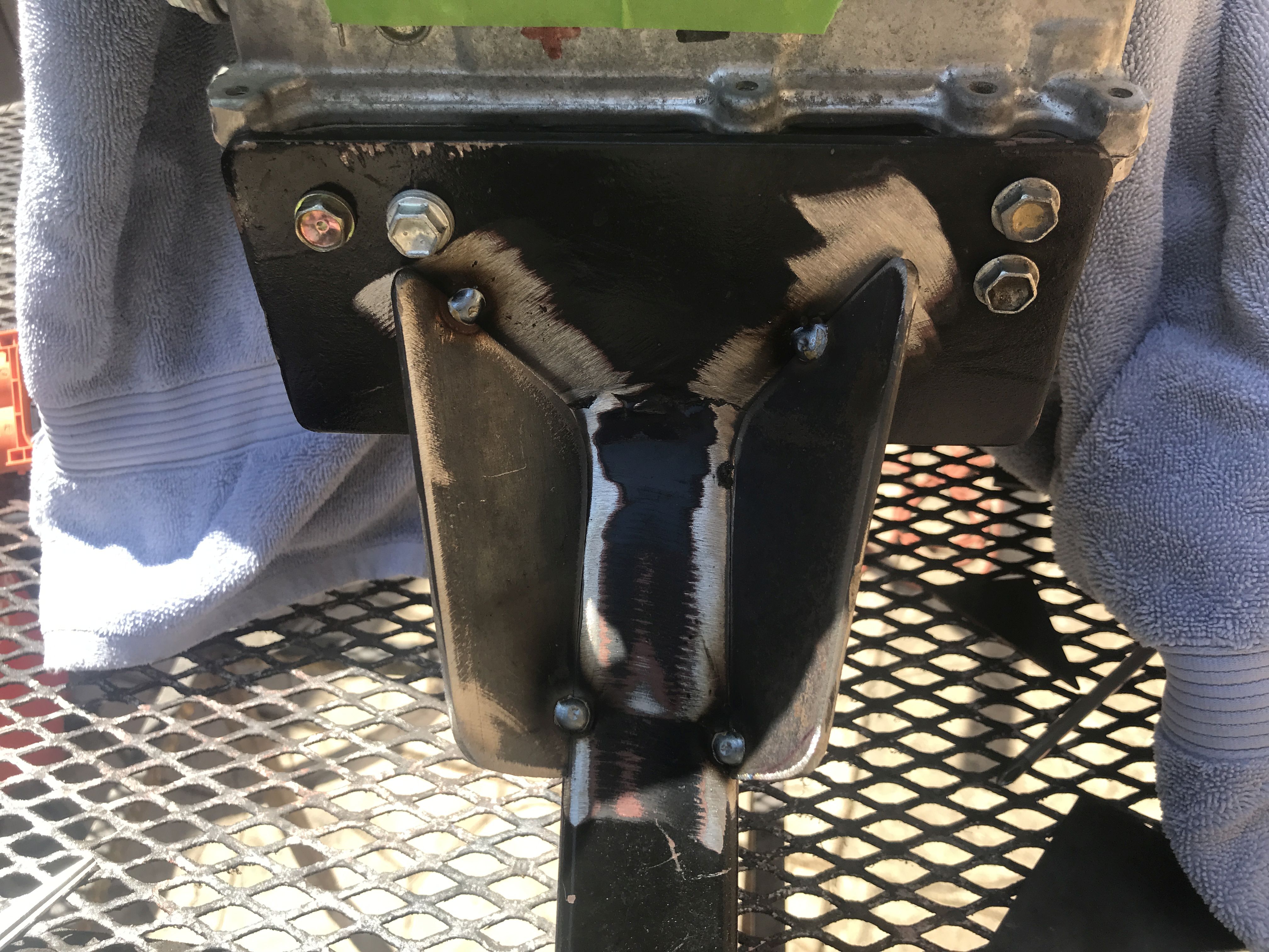

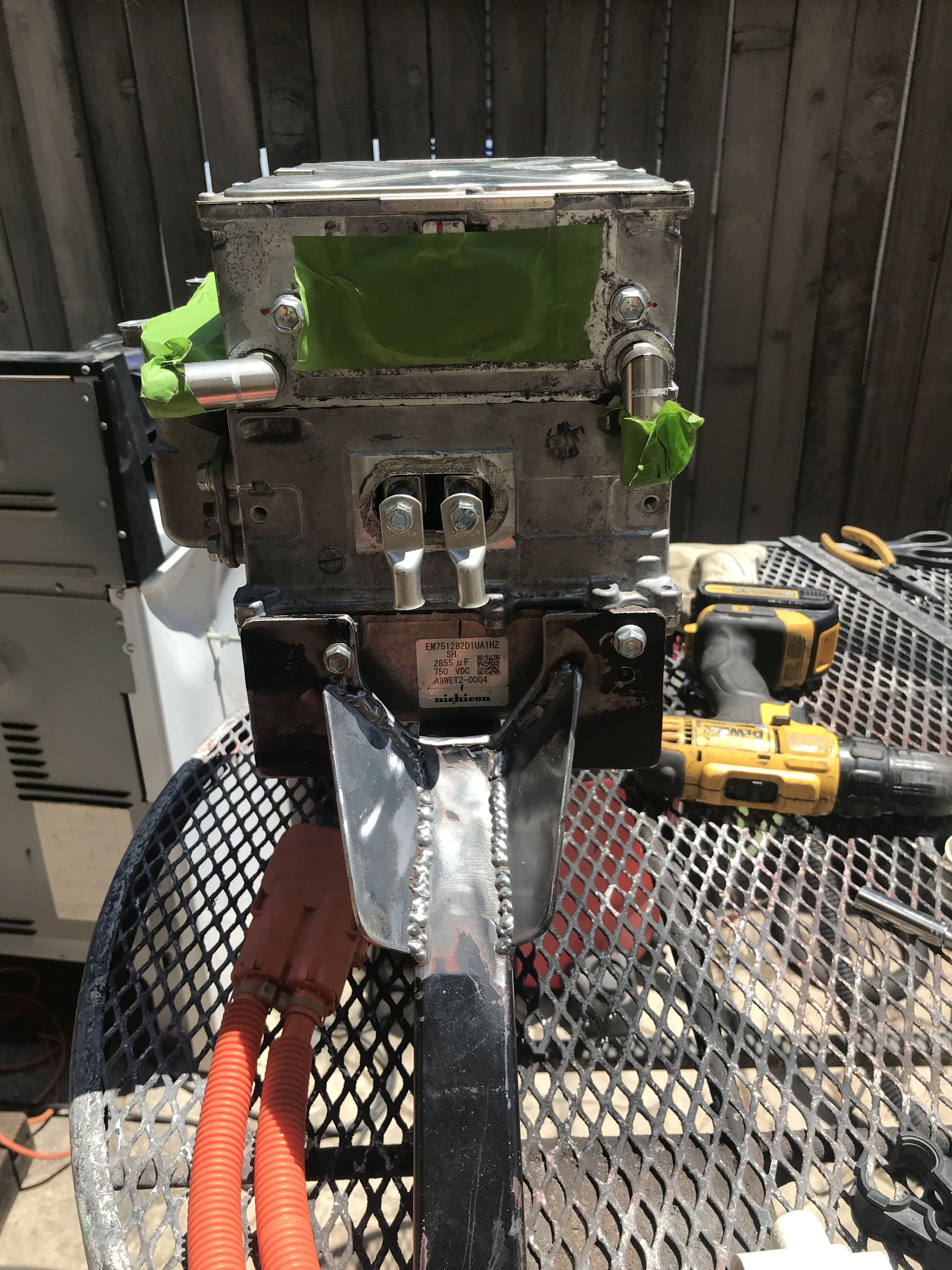

so that first cut out wasn't wide enuff to clear a plastic cable bracket I wanted to mount right below the lug connection, so I had to make a bigger cut out
and here I am trying a totally different plastic cable bracket, just spit ballin' ideas on the fly
- Gregski
- Posts: 3163

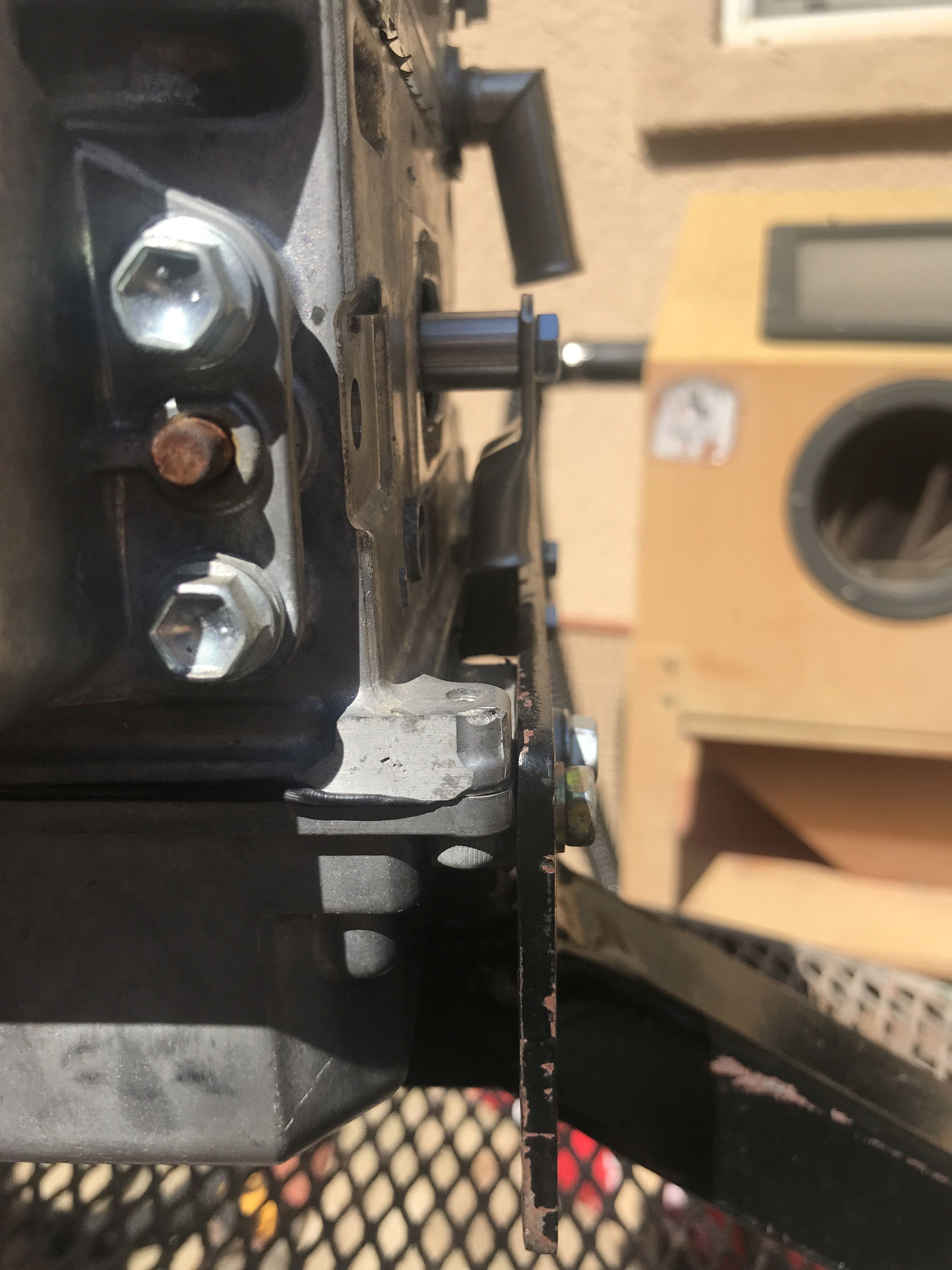

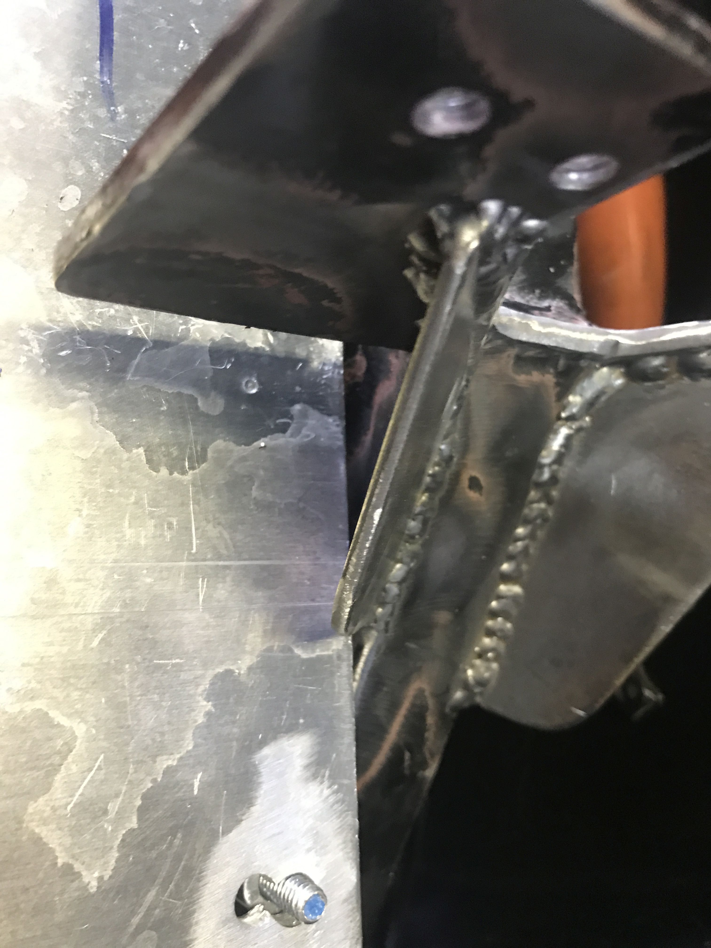

you've heard of death by a thousand cuts, well this ended up being design by a thousand cuts
after attempting to trial fit this newly augmented inverter bracket I of course realized it would now not clear the battery lid tray thingy, so I lopped a section of the left wing off (that hurt, cause I am all about symmetry)
- Gregski
- Posts: 3163

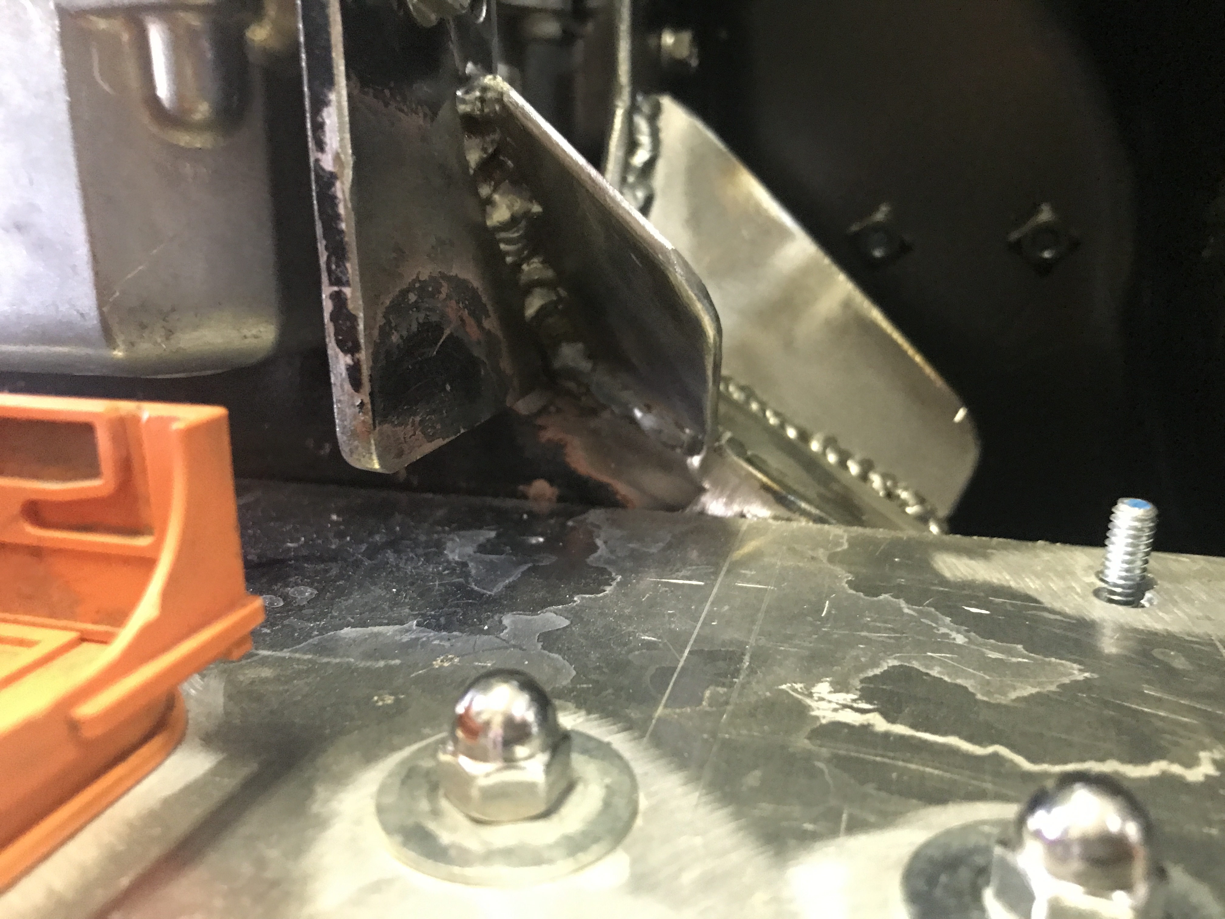

second attempt, FAILED again but only by this much
I need to recalibrate my eyecrometer
um... you may wanna rethink that dude!

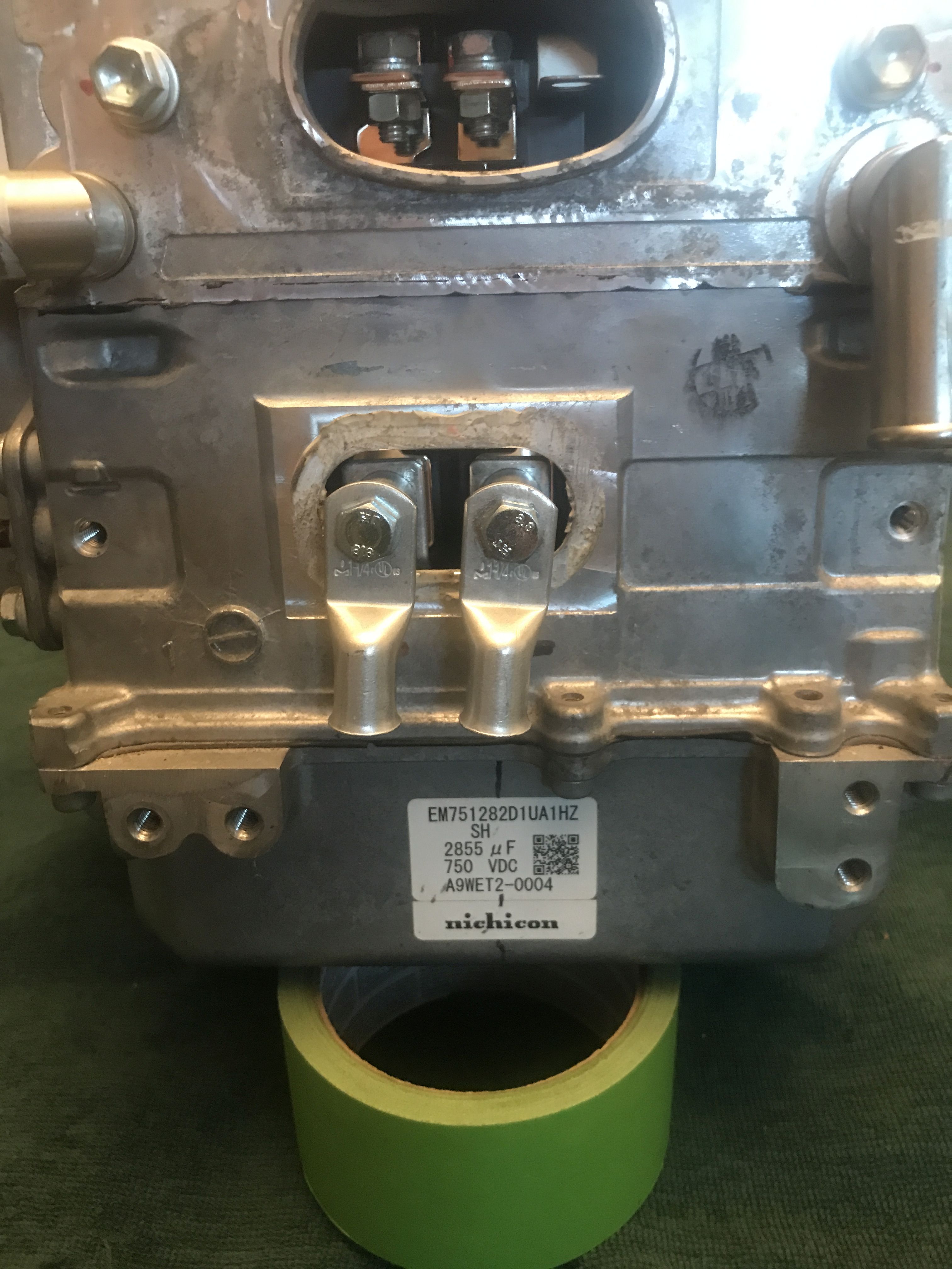

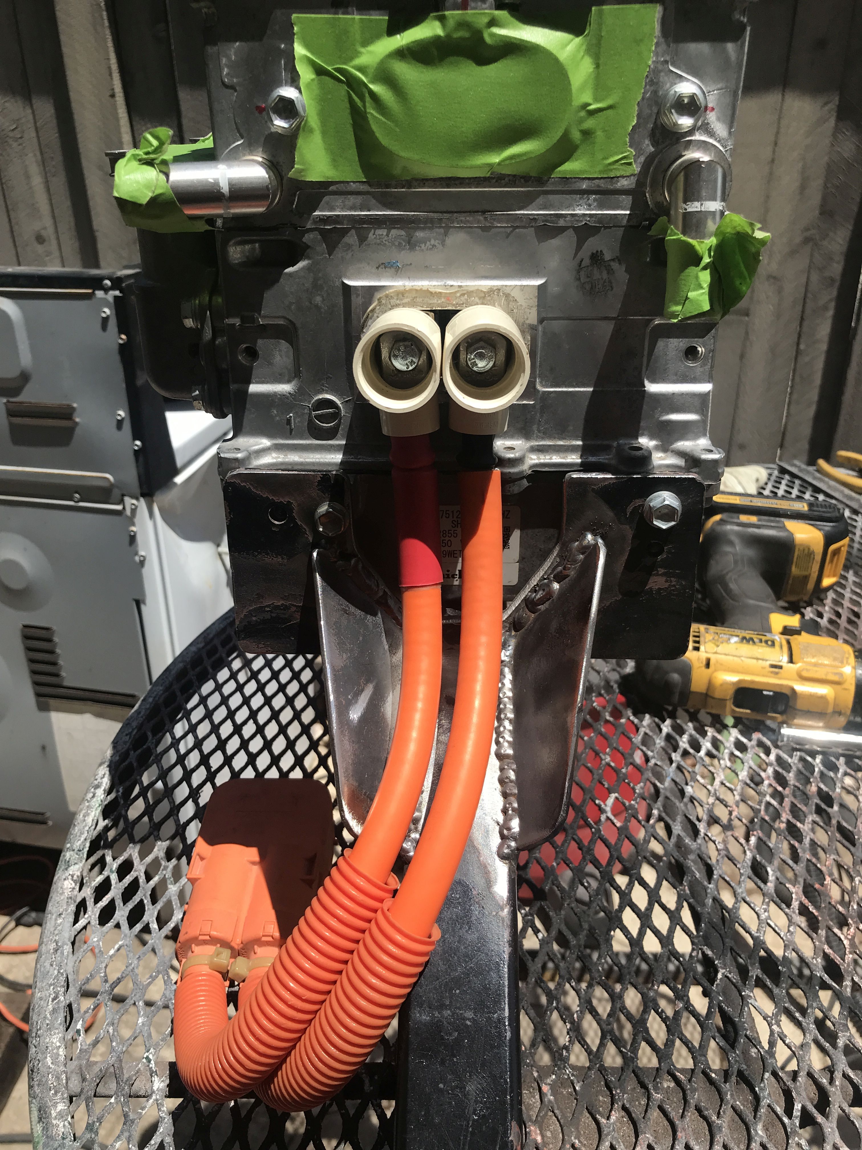

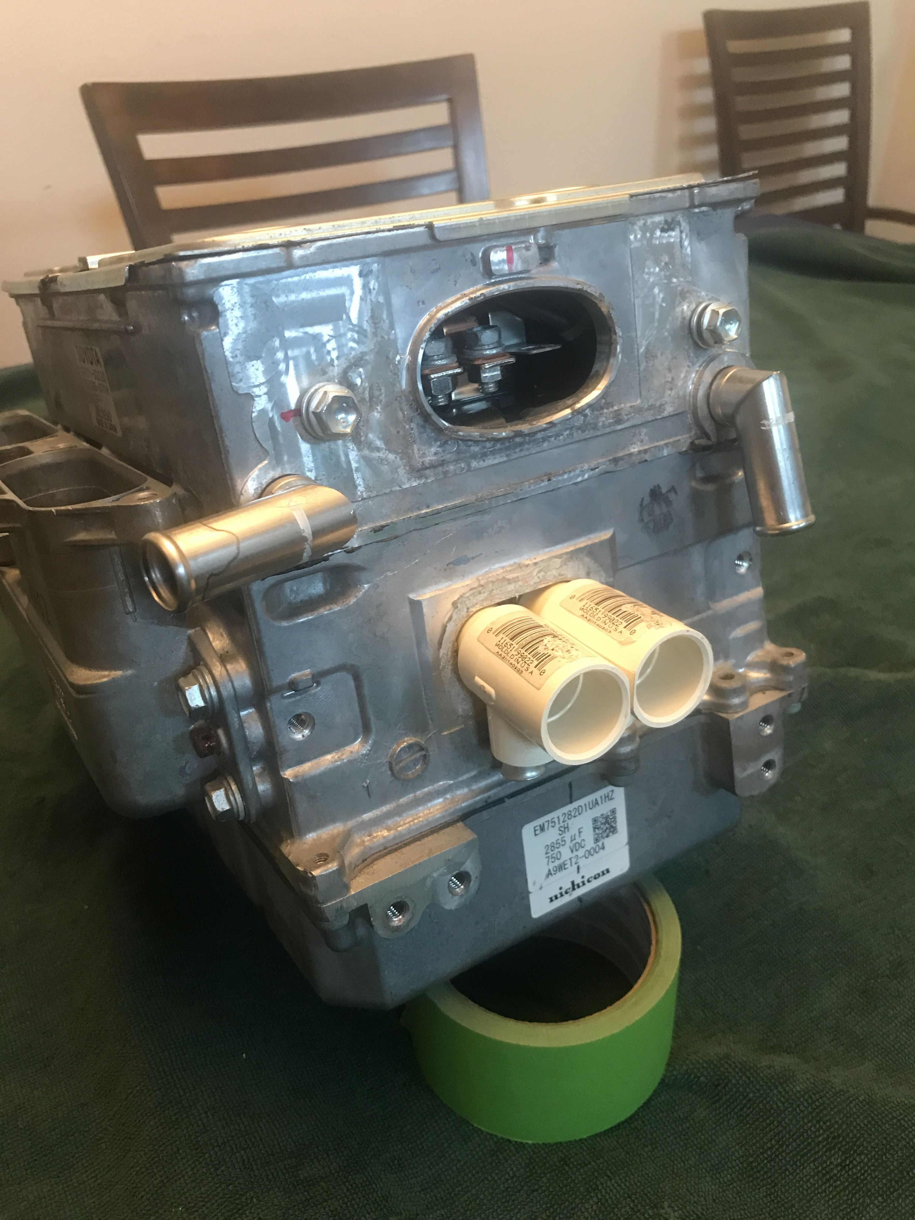

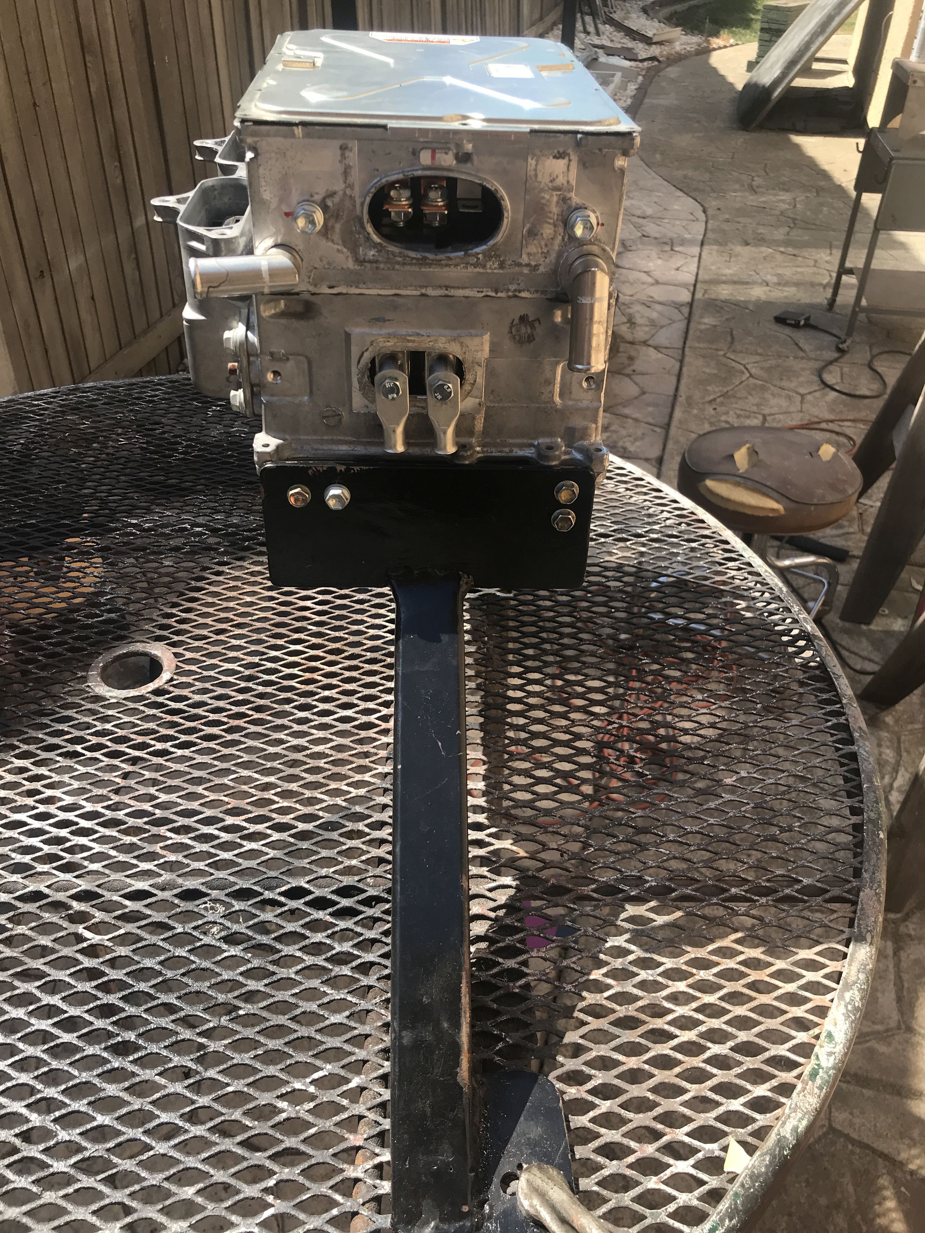

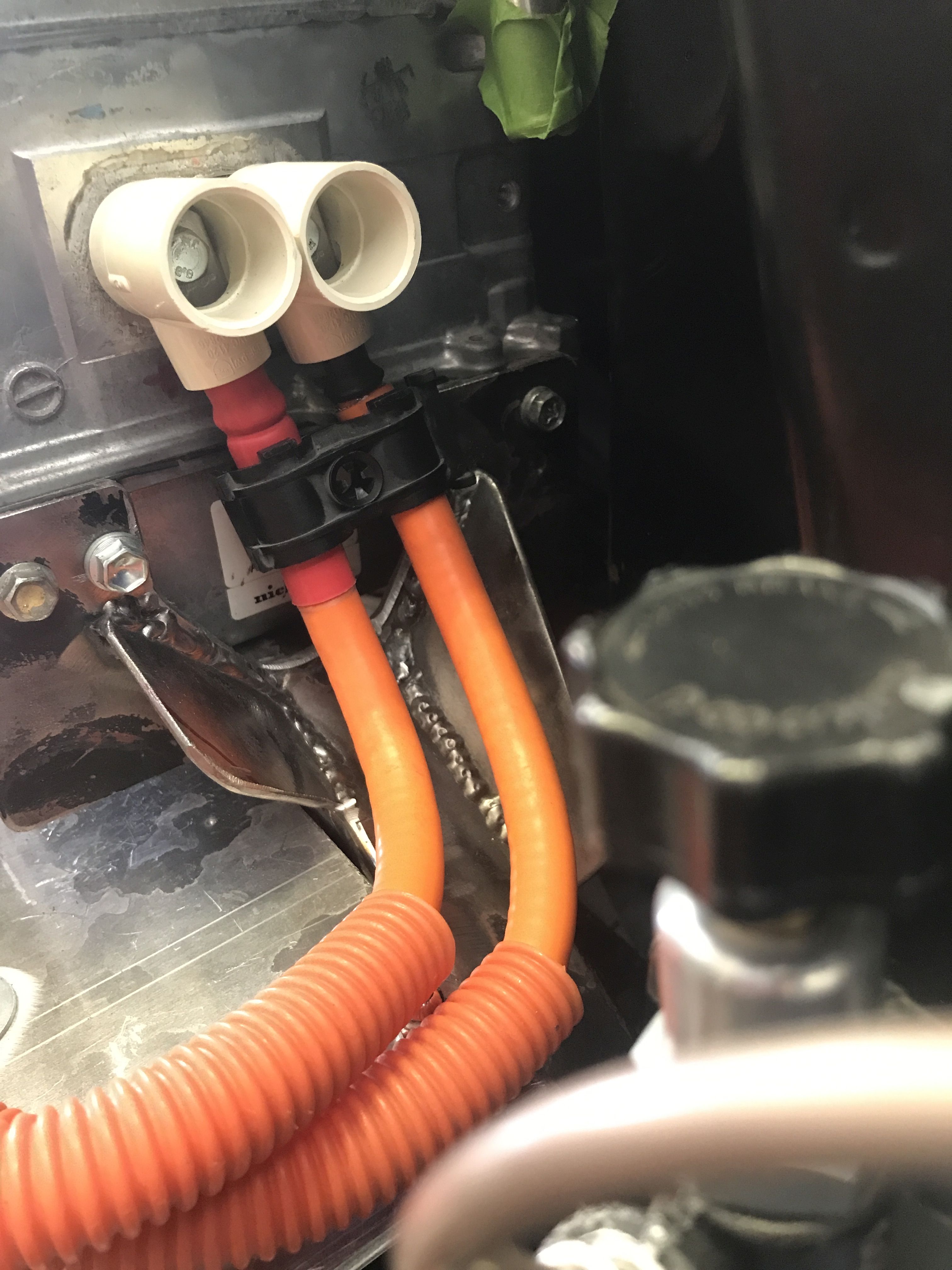

alright, these cables better reach
this is just a trial fit, the black plastic cable bracket is just loosely dangling on there (I didn't have the energy to deal with it that day)

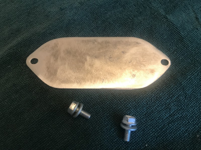

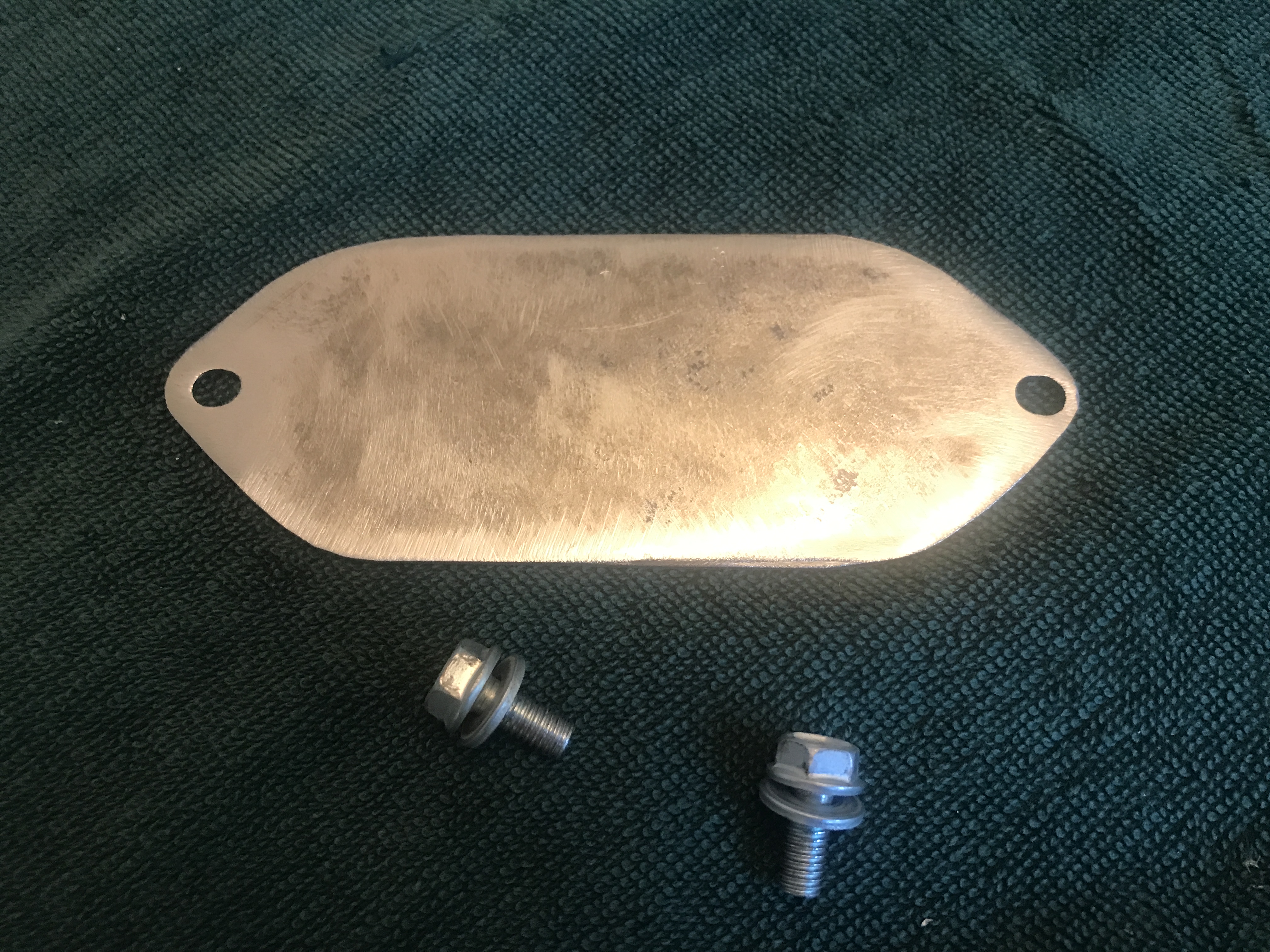

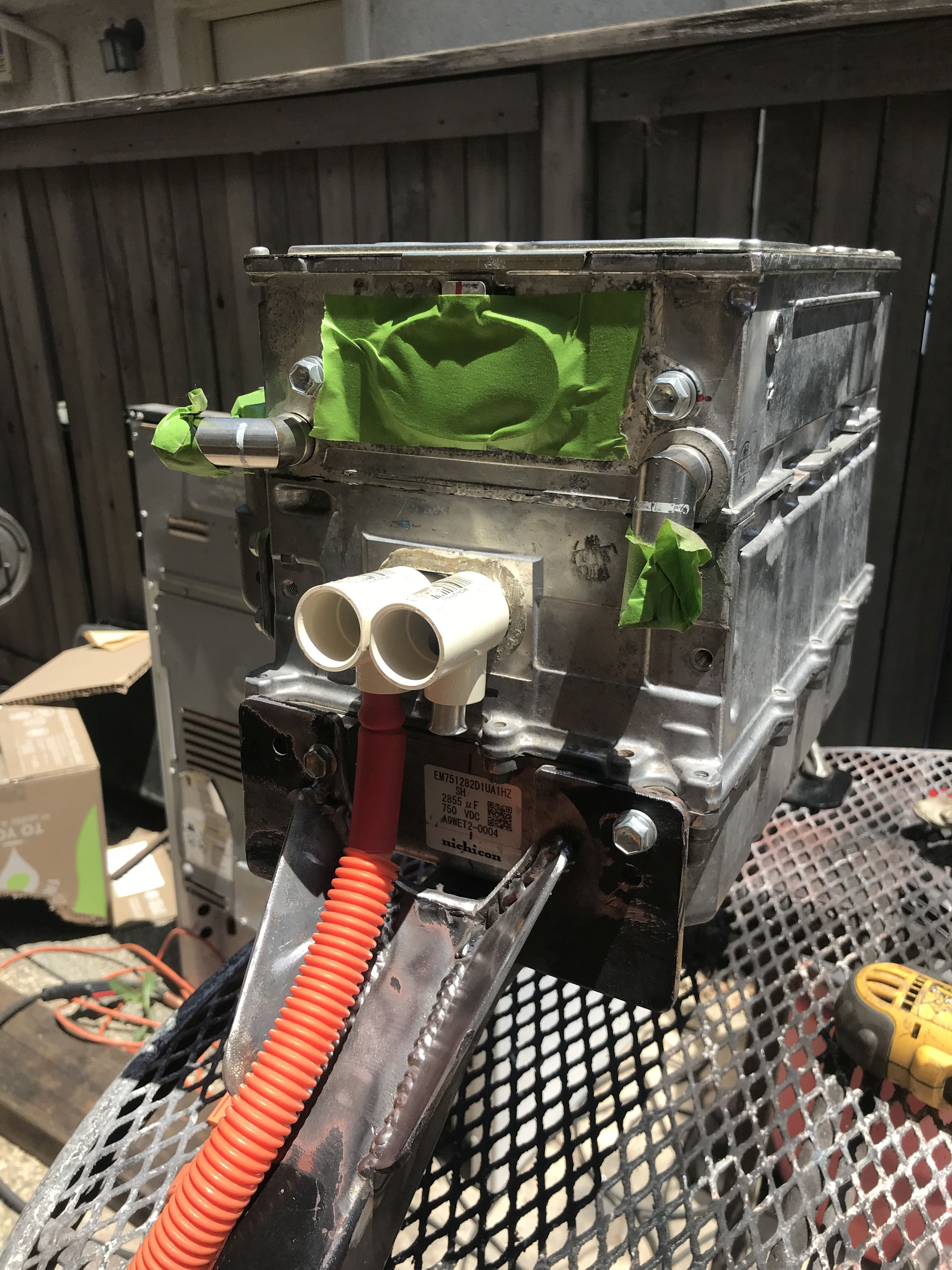

I appreciate your comment but this is now turning into a three ring circus, I originally wanted to go with copper but could not find any so I wanted to do aluminum, but someone said that they may snap off, so I ordered steel stand offs and I got this message on DIY Electric Car, please check it out for funsies, this should take you directly therecrasbe wrote: ↑Sat Jun 24, 2023 9:54 am Compared to aluminium and copper, stainless steel is a terrible conductor: https://de.wikipedia.org/wiki/Spezifischer_Widerstand (the English wikipedia uses different units..)
We have a specific resistivity of ~0.017 (Ohm * mm²) / m for copper, 0.1-0.2 (Ohm * mm²) / m for steel and 0.72 (Ohm * mm²) / m for V2A stainless steel.
Keep in mind: less is better, which means copper conducts 40x better than stainless steel.
1971 GMCe Lexus GS450H BMW 530e Tesla Model S powered Electruck
- crasbe
- Posts: 330
- Location: Germany
- Has thanked: 58 times
- Been thanked: 180 times
Well now, that's something we can calculate, can't we?
With a thermal expansion coefficent of 23.0e-6 1/K for Aluminium and 13.0e-6 1/K for Steel, and an assumed length of 1 banana (25.4mm) for your spacer and a whooping 100K temperature difference, we arrive at an elongation of 58nm for the Aluminium spacer or 33nm for the Steel spacer.
(For copper it would be 42nm and for brass it would be 44nm).
For completeness we would have to calculate the stresses introduced by the elongation of the spacer, but for that we would have to know the precise torque of the bolt etc etc. There is just no sense to calculate that.
I would say that the difference will not cause your bolts becoming lose. Especially if you use loctite
Conclusion: Just use brass like everyone else. Or use copper, the internal busbars of the inverter are bare copper as well and it doesn't cause any problems.
Or you could use tinning paste (like solder paste) to coat the copper spacer in tin.
=> Use whatever except steel or stainless steel

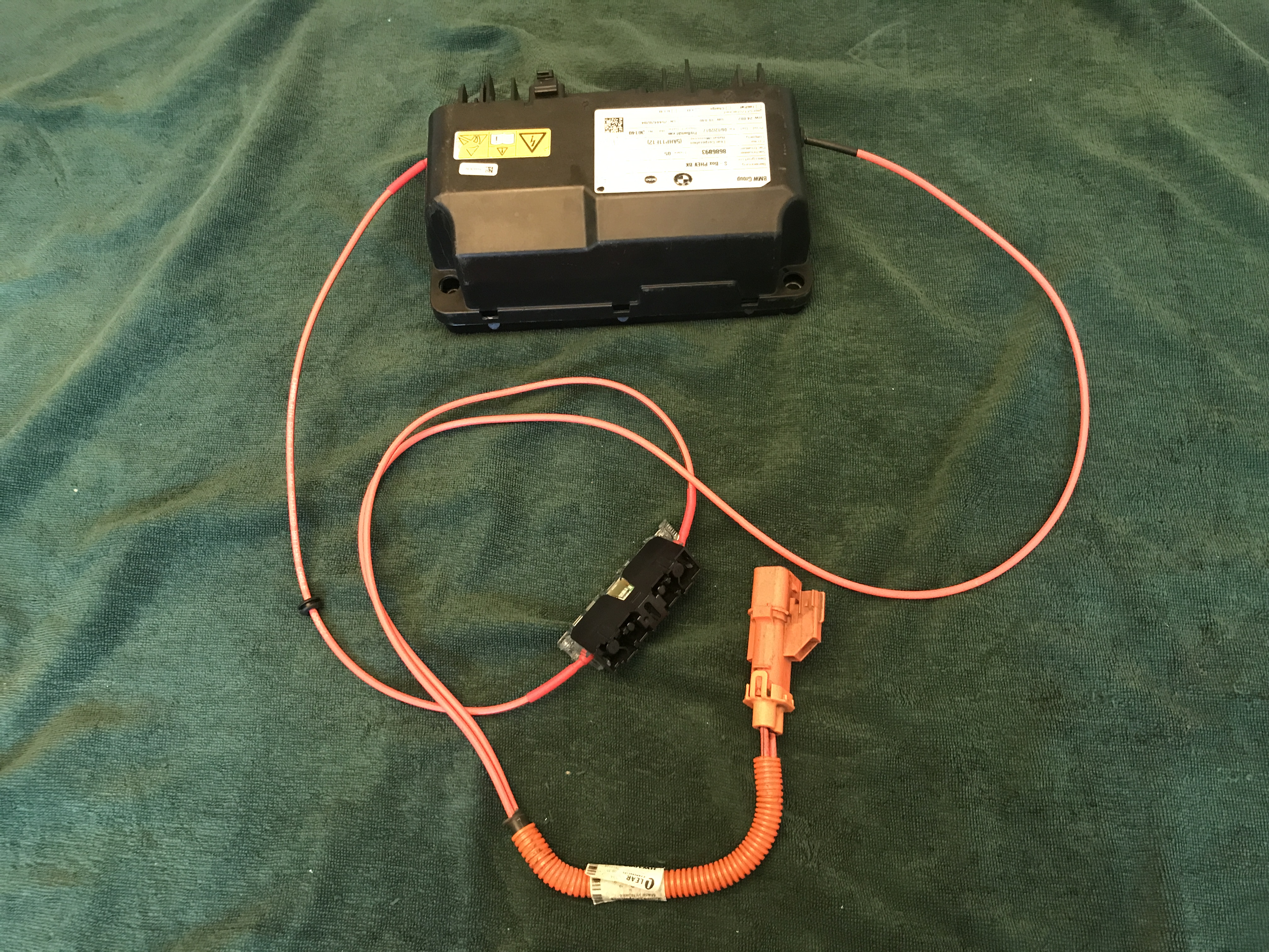

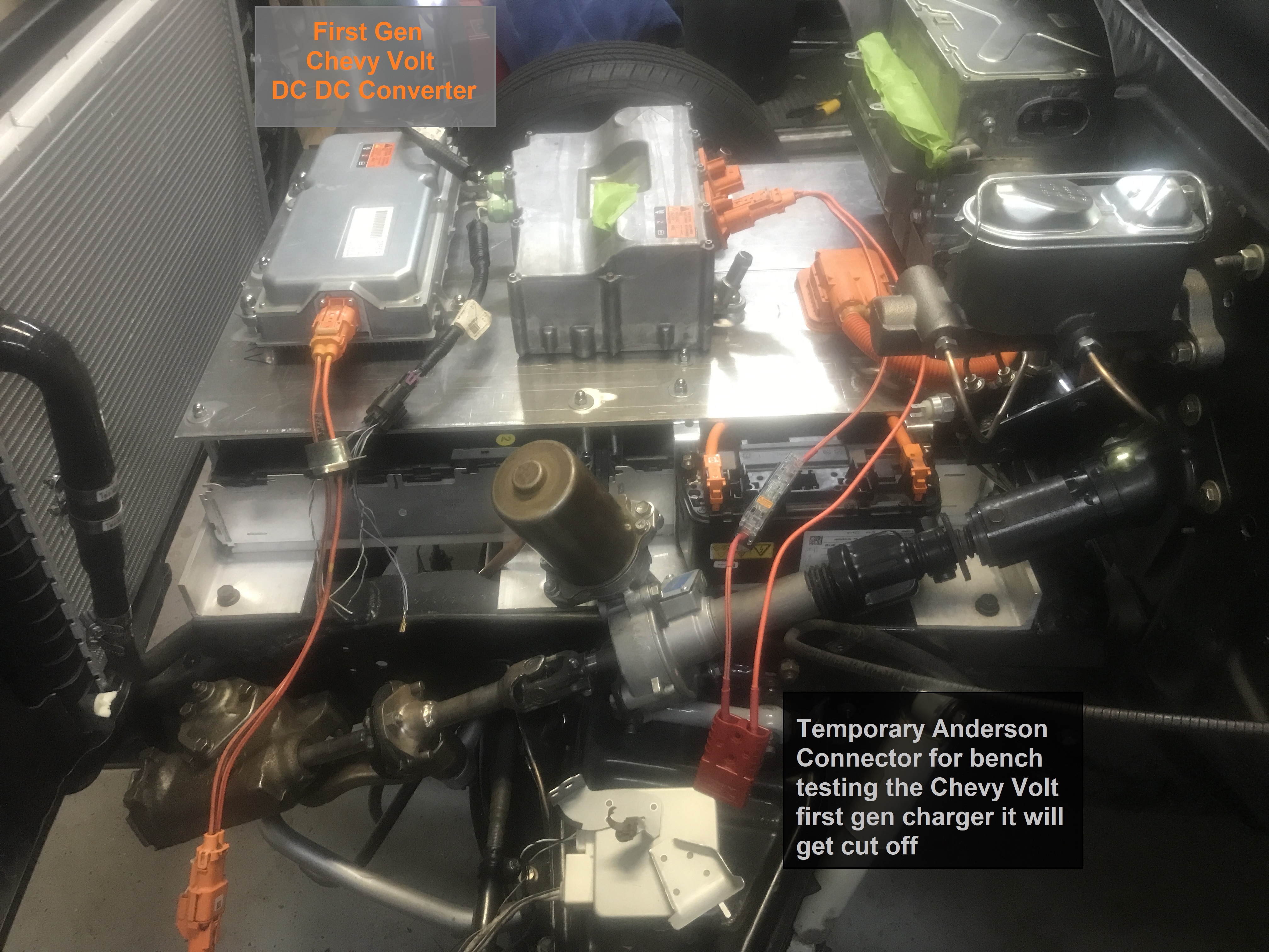

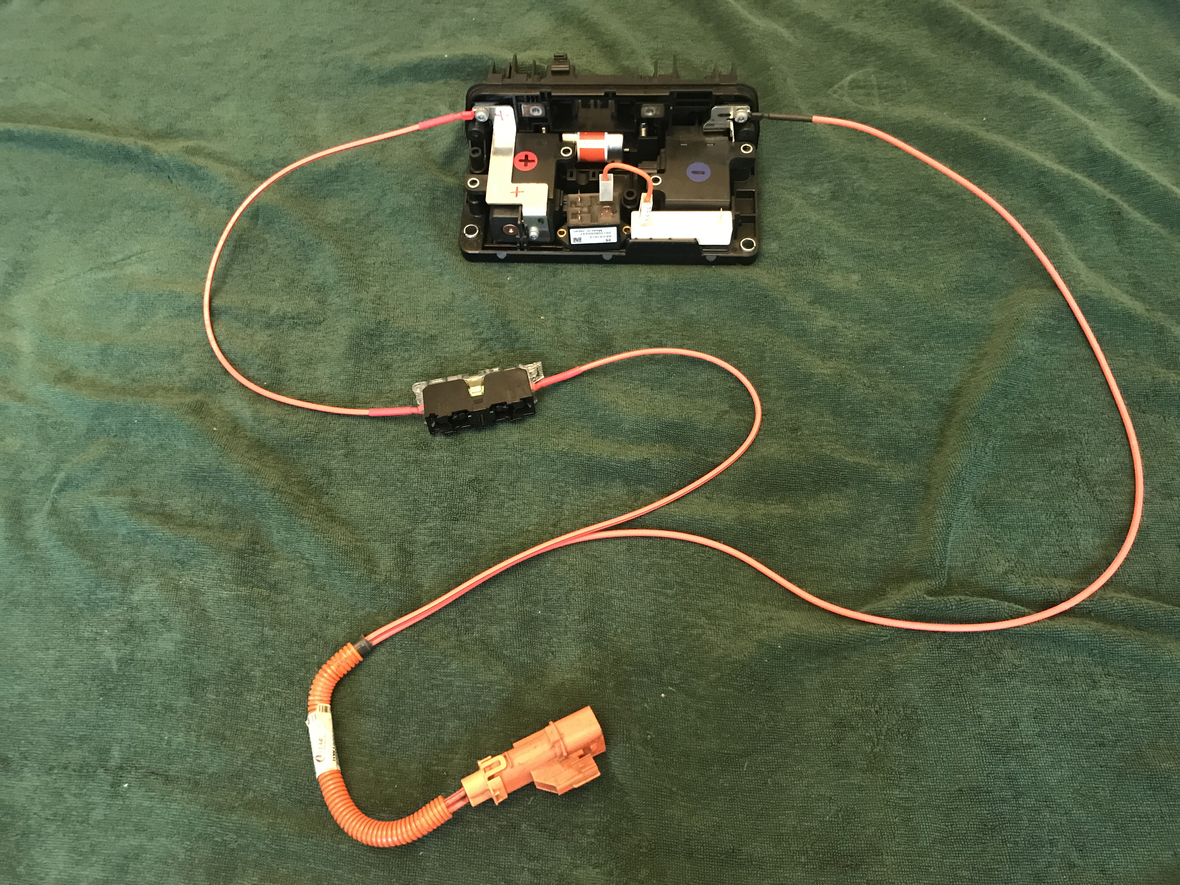

today the stare down began between me and the first gen Chevy Volt DC DC converter, I hoped I could will it to connect itself to the BMW 530e Battery Safety Box
so this thing is like a alternator in the car, and I don't want it to have a permanent connection to the high voltage battery, so I am thinking if I tap it into the Safety Box aka the Contactor Box on the output side then it will only make a connection to the battery pack when the contactors are closed
For any of you who are A. reading this, and B. having trouble sleeping, I highly recommend my I bought a Chevy Volt Gen1 DC-DC Converter - Now What? thread, where I seek help taming that beast
- Gregski
- Posts: 3163
maybe this will work, I would love to ignore I mean hear your thoughts
that may be a 20 amp fuse I may shove something lesser in there or morer I don't know, whatever you recommend
I am also entertaining the idea of just shoving this entire black BMW Safety Box into one of them electrical plastic boxes and not even putting it's flimzy OEM lid back on just using the lid from the bigger electrical box, bonus if I can find an orange one

Think you might have your decimal point in the wrong place, I make it 58um (or around 2.36thou) for the above materials and sizes.crasbe wrote: ↑Thu Jun 29, 2023 10:28 am Well now, that's something we can calculate, can't we?
=> Use whatever except steel or stainless steel![]()
Couldn't understand how it could be nm as then thermal shrink fits of shafts and bearings wouldn't work!
Agree completely though - make it out of copper or brass and it will be fine.
