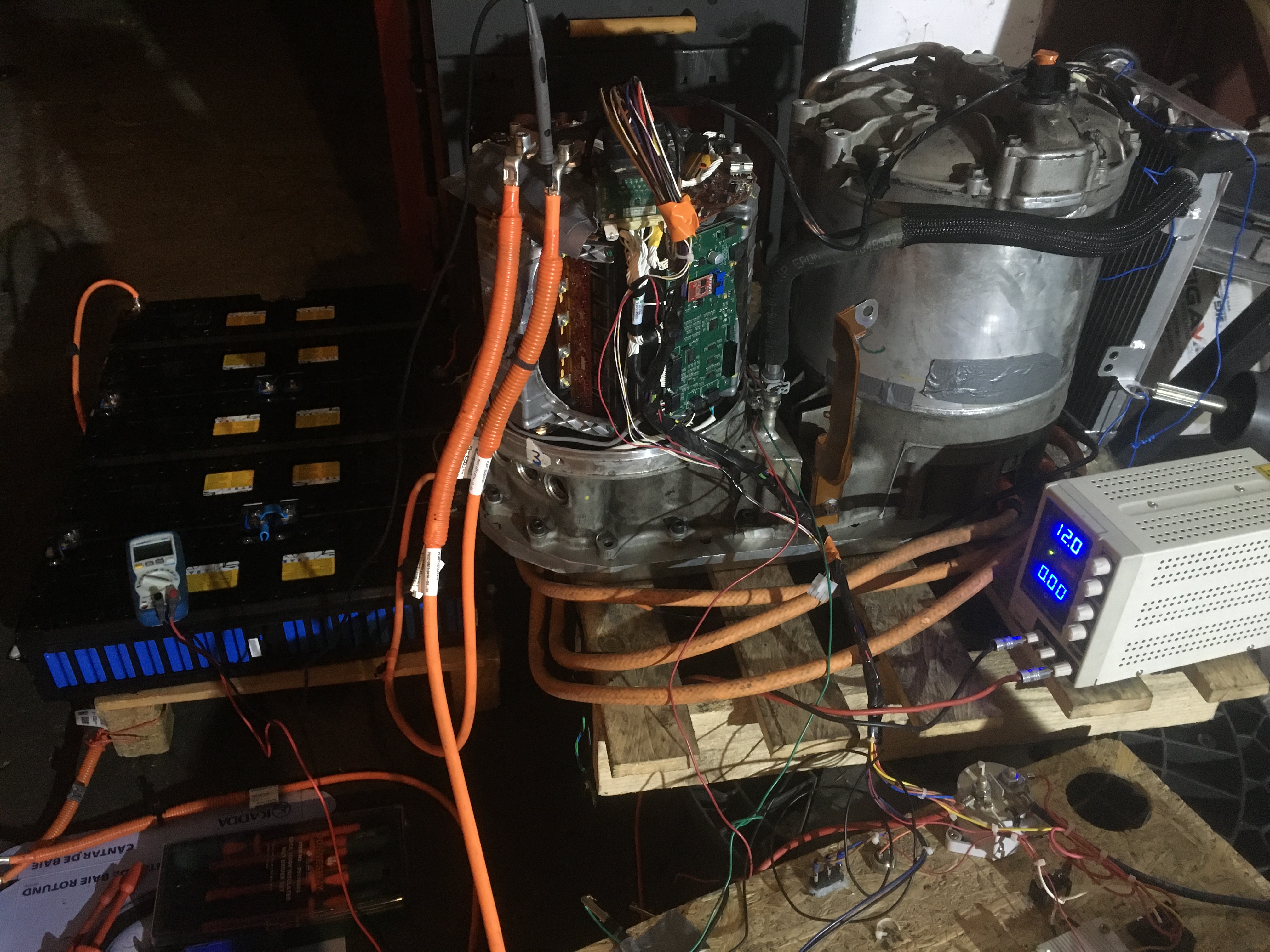

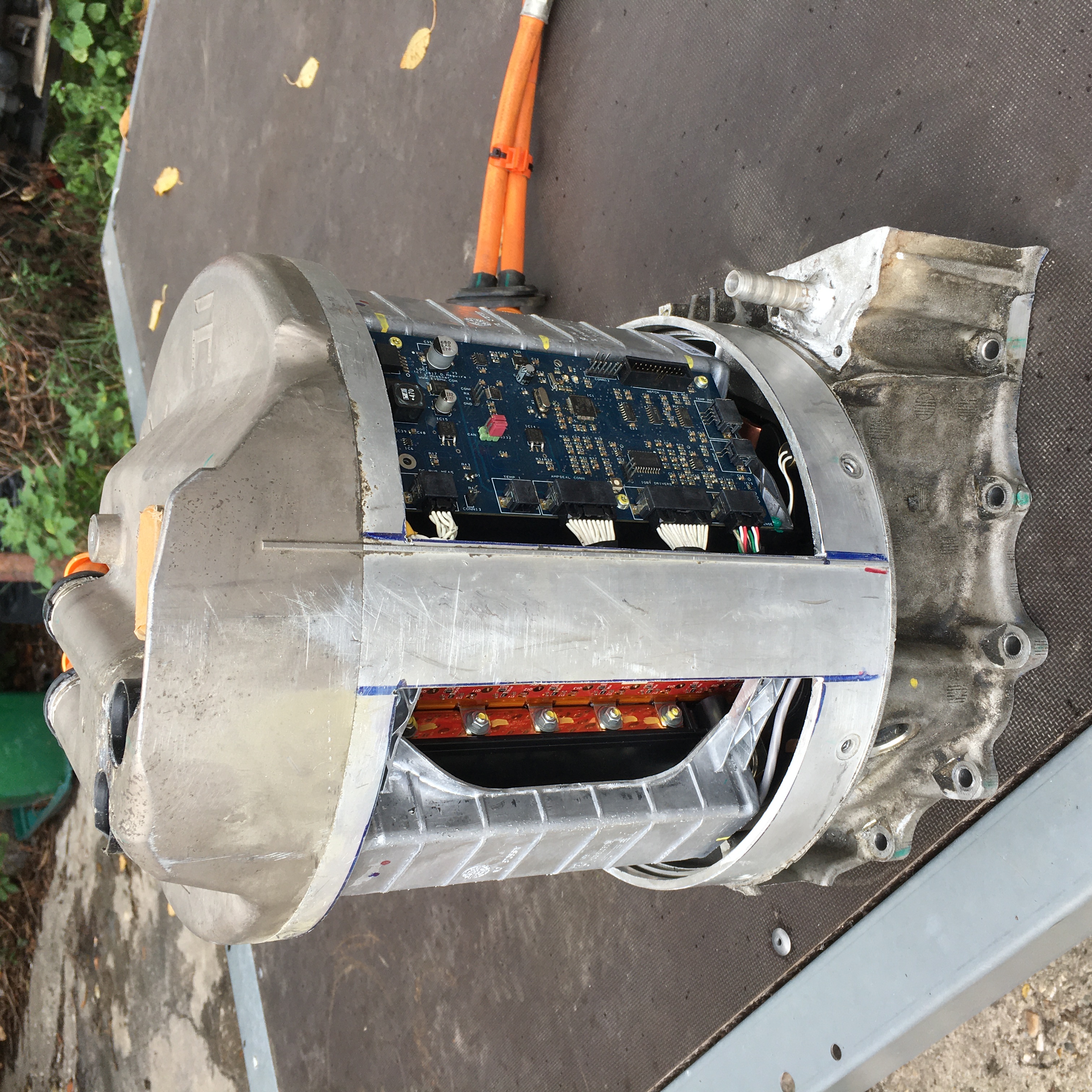

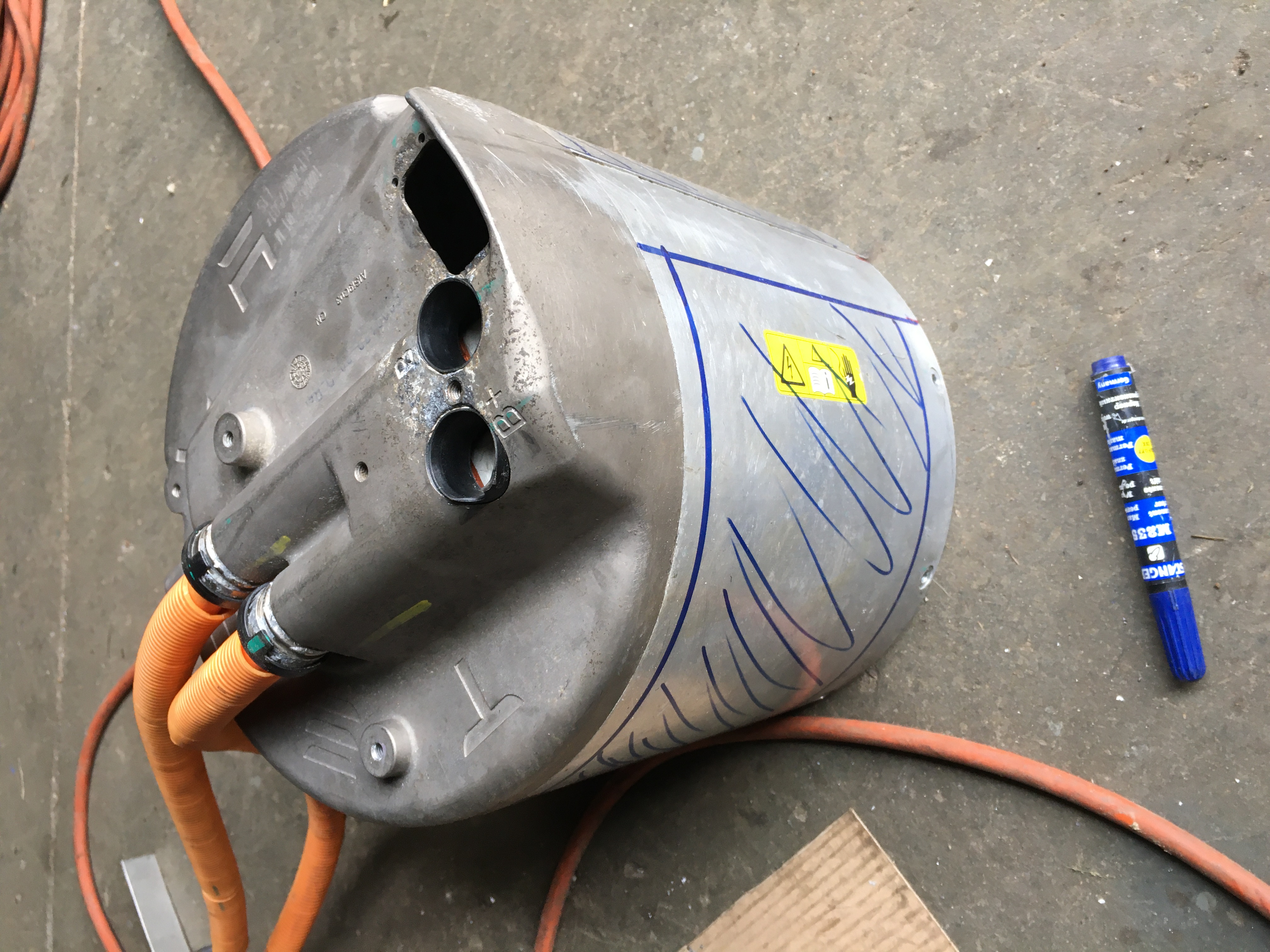

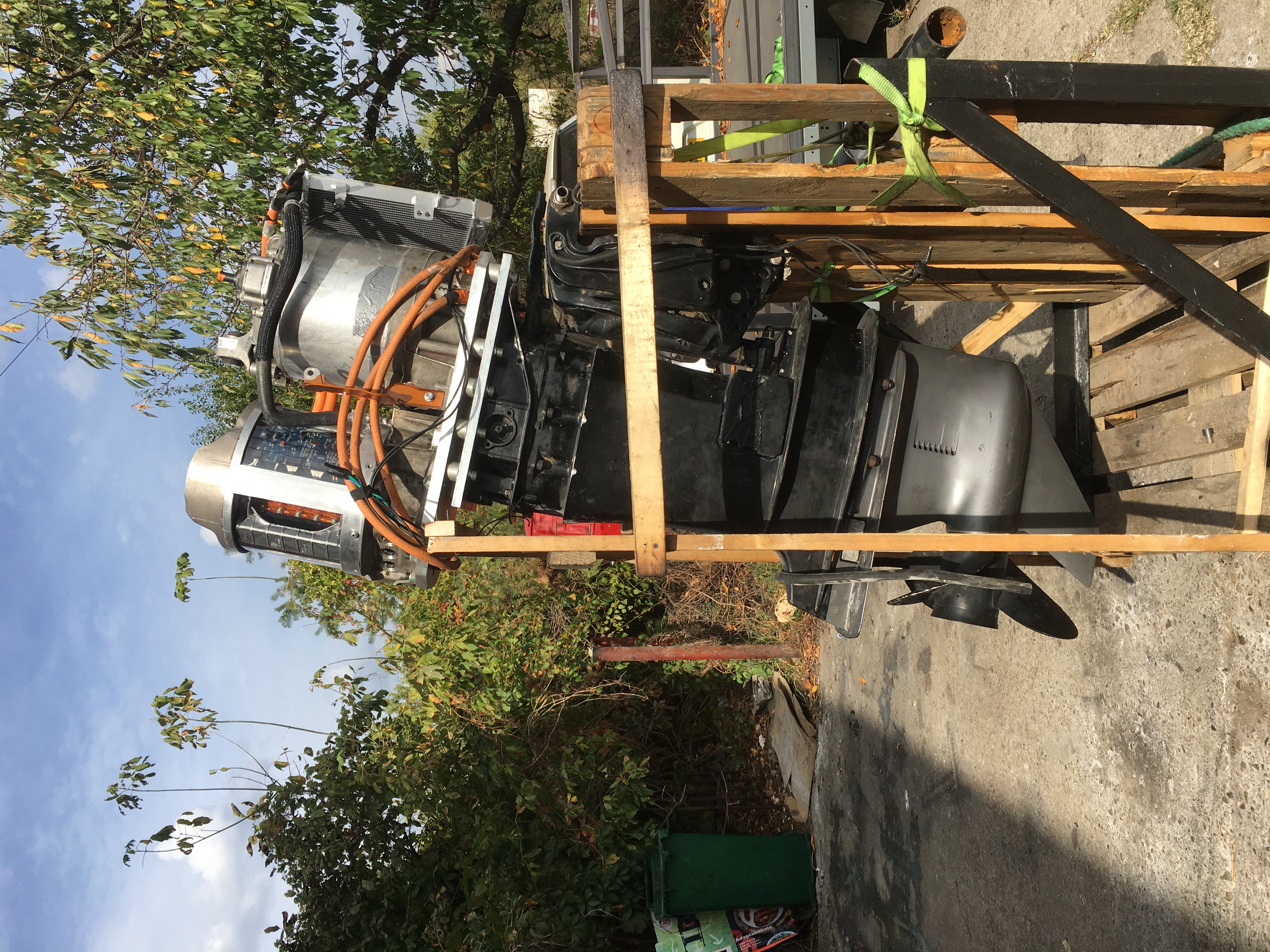

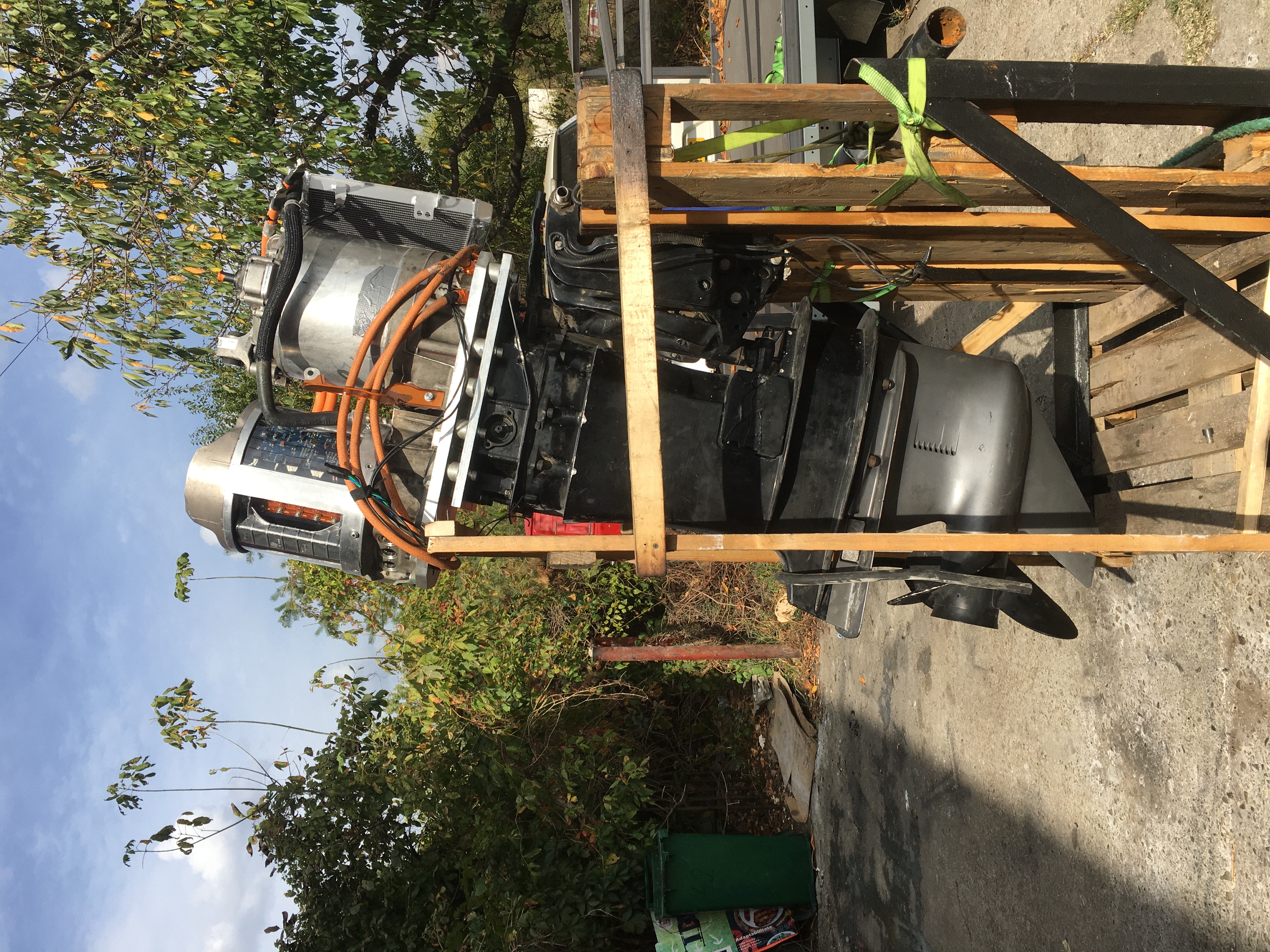

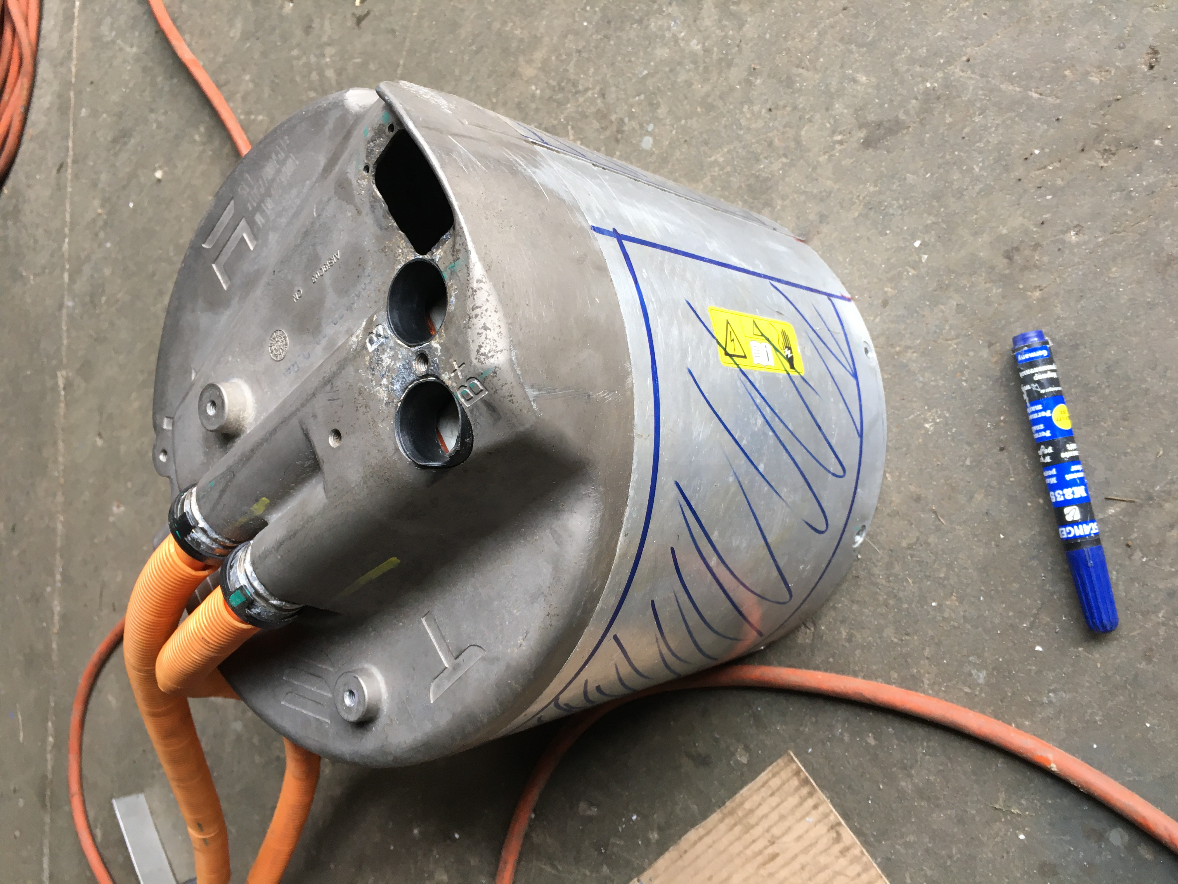

I have build two electric boats with Tesla modules but now i am close to powering up the Tesla LDU that i cut and modify in order to install it on a proper boat donor motor.
So what do you think about this LDU on a boat? :) 350 Volts. I have a lot of photos with the modified drive unit but the project has to be public only after an event, in about 2 weeks.

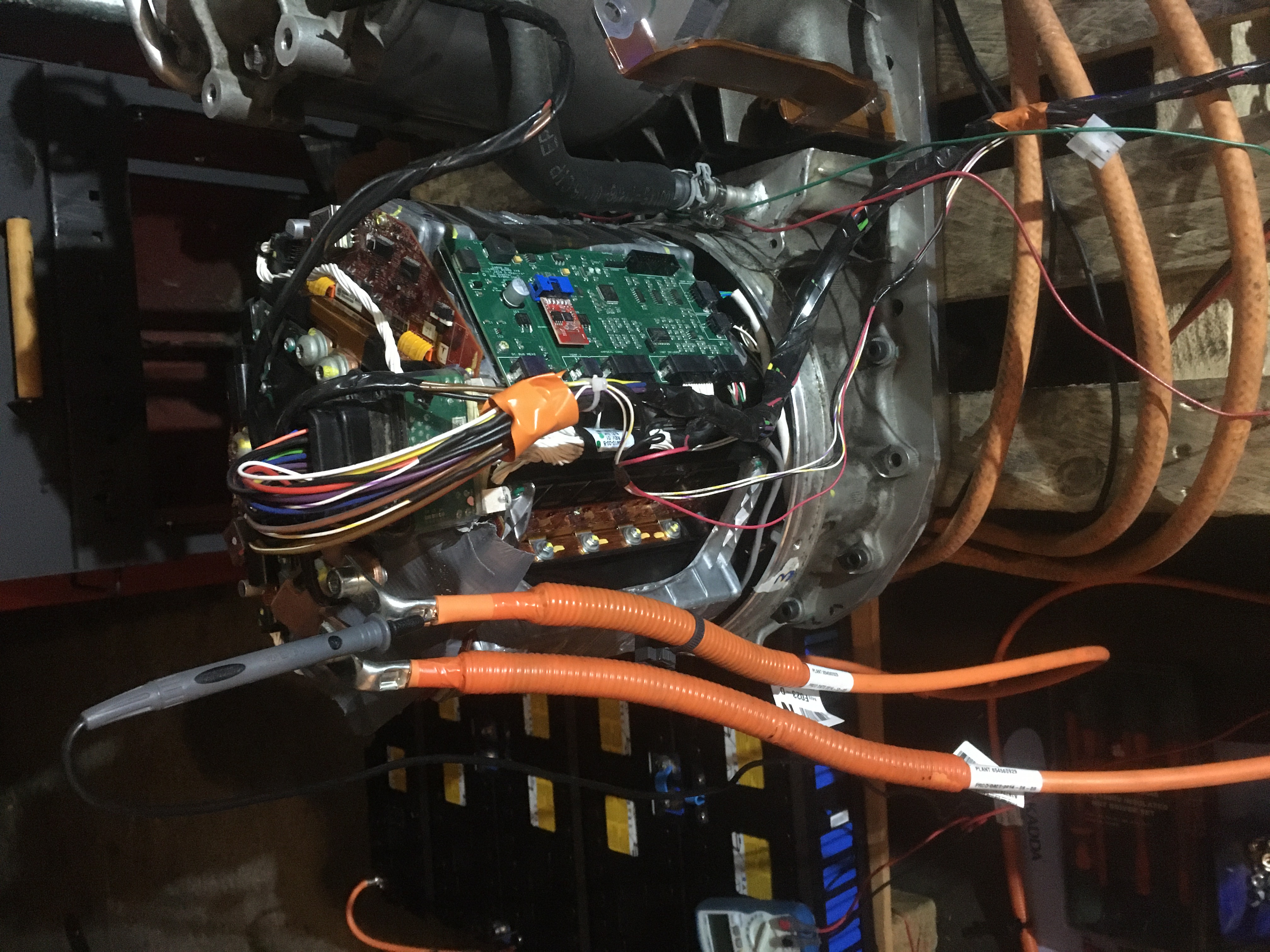

it had a simple test at 306 V, does not allow power even with full throttle, plot ok for temp, direction, throttle (nissan leaf), it just slowly turns fwd/reverse ok, one error of overcurrent, but that was just precaution (50 amp), so i guess i have an encoder problem? thanks! i just love how it turned out, curious to see if interference because i cut the inverter bell, but i guess not :) It has plexiglass. I have to test again tommorow
Been thanked: 1918 times
Re: Tesla LDU on a 300hp boat donor motor
What on earth :D never seen the LDU look that small
Yes encoder problem. A/B swapped or not connected at all

Not afraid from overheating the motor?
Boatapplication is by far not a car!!!how much S1 power the LDU have????60kw?
EV_Builder
Posts: 1205
Location: The Netherlands
Has thanked: 18 times
Been thanked: 37 times
Post by EV_Builder »
Well he does has allot of cooling medium in his design...
