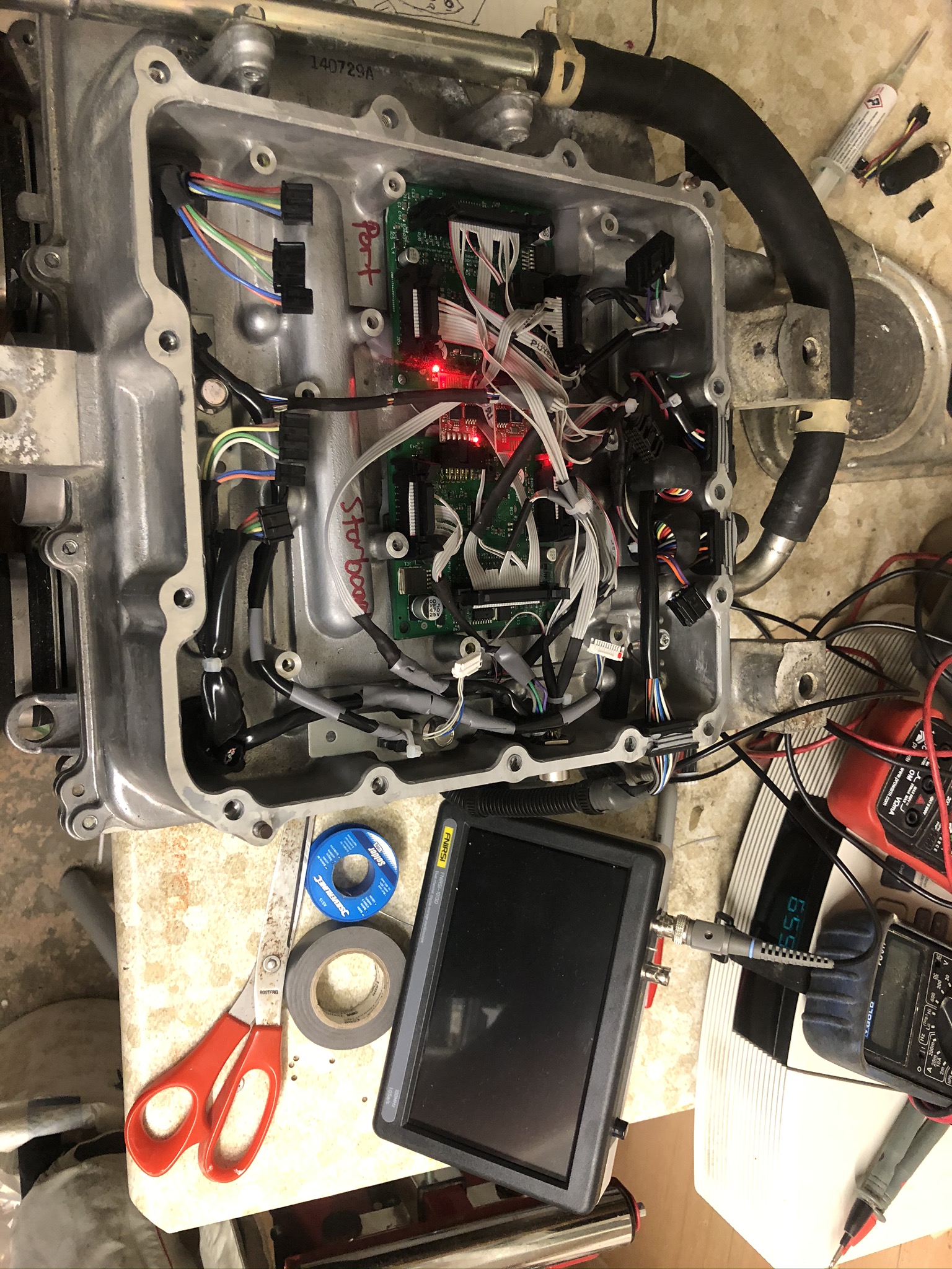

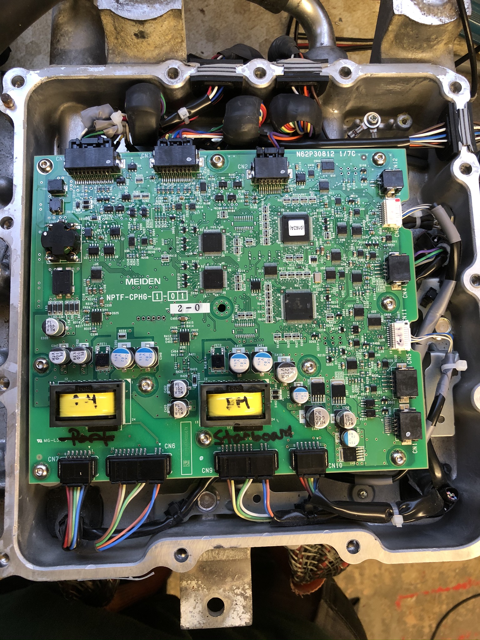

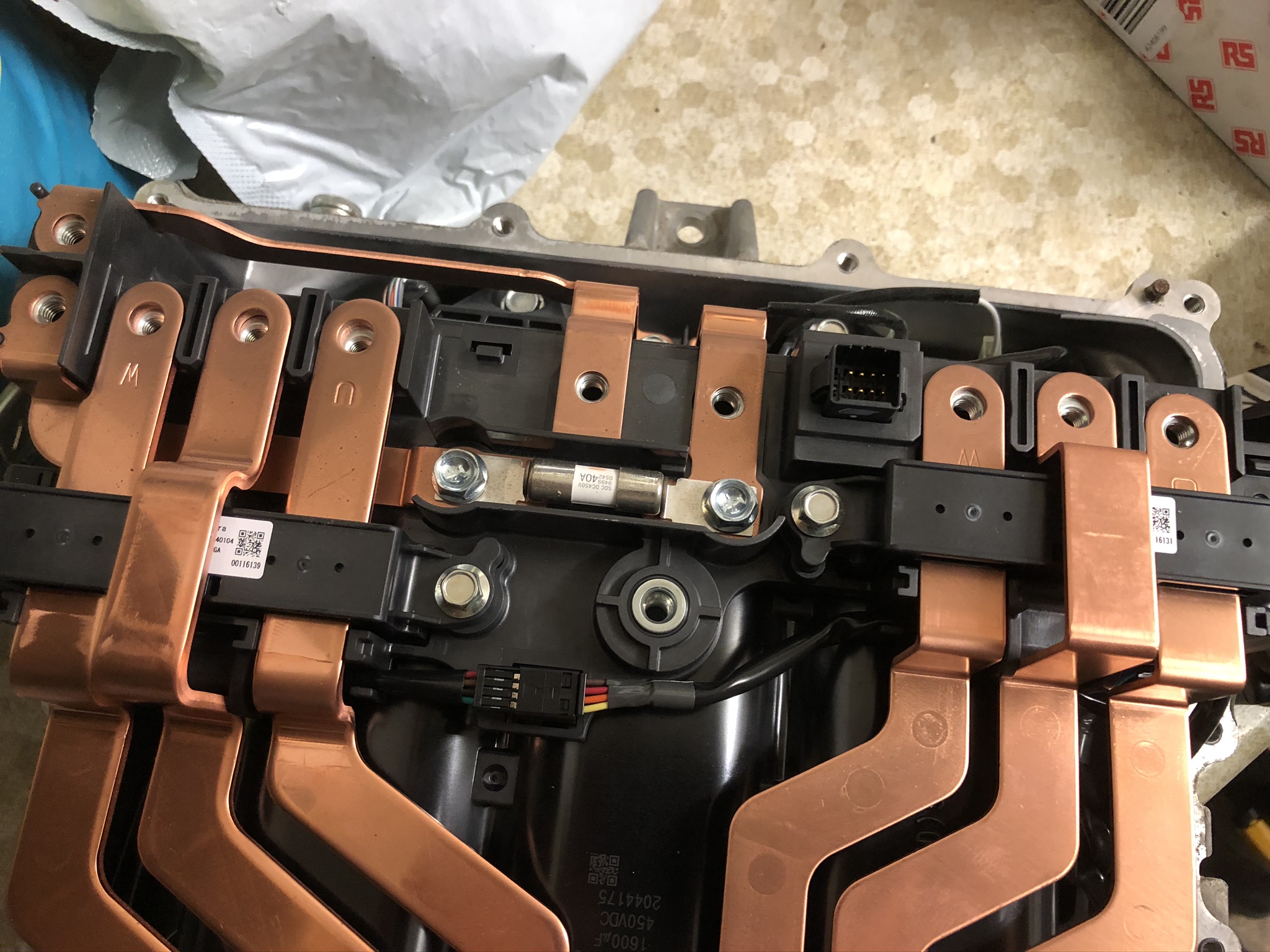

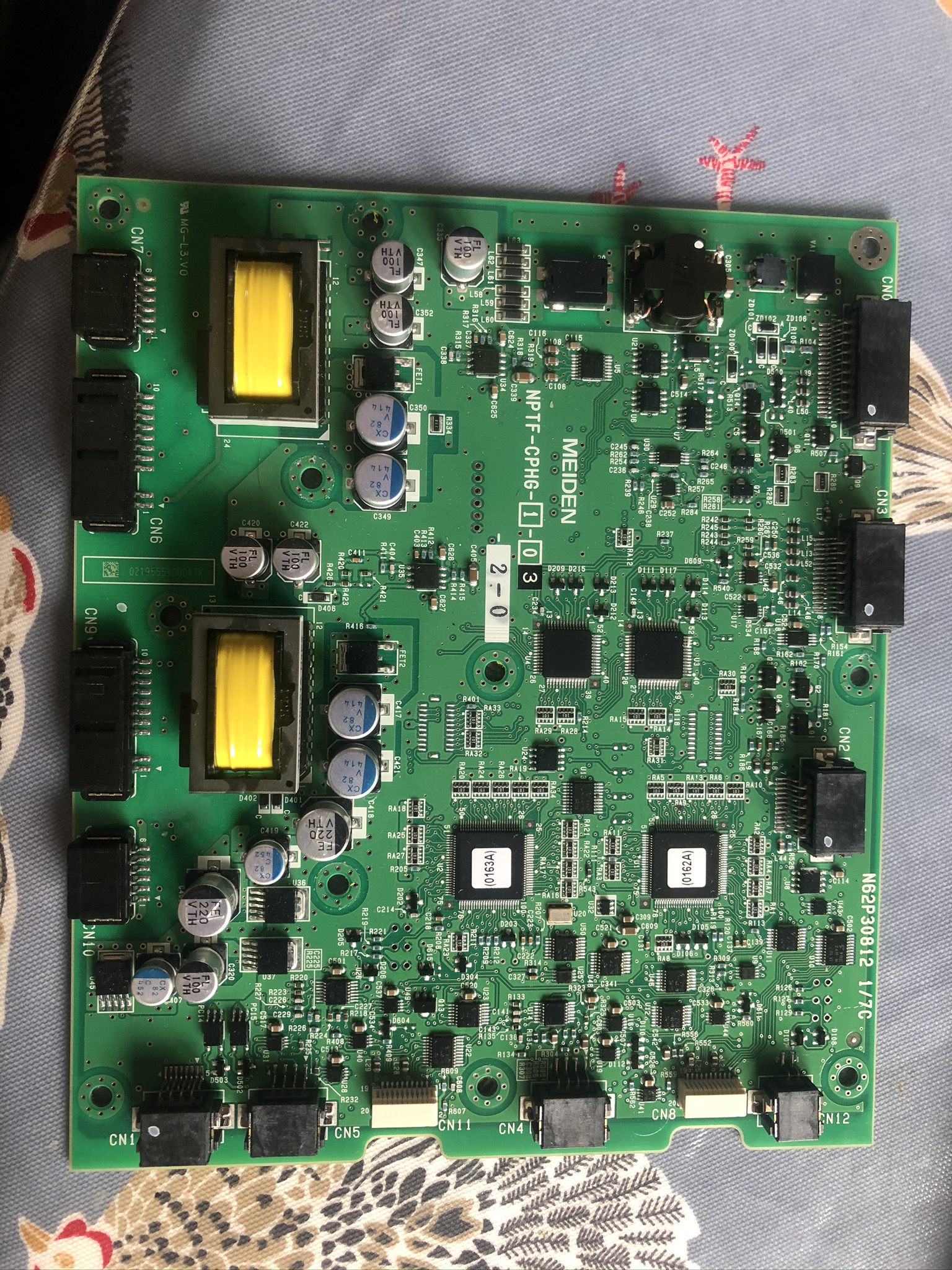

In case anyone else is looking to do the same as I am doing here is what I have found out stripping down the front inverter to replace the logic board:
I have done a spreadsheet with all the pinouts for the logic boards and driver boards and how they might map to a V3 main board but I will post that in the morning...

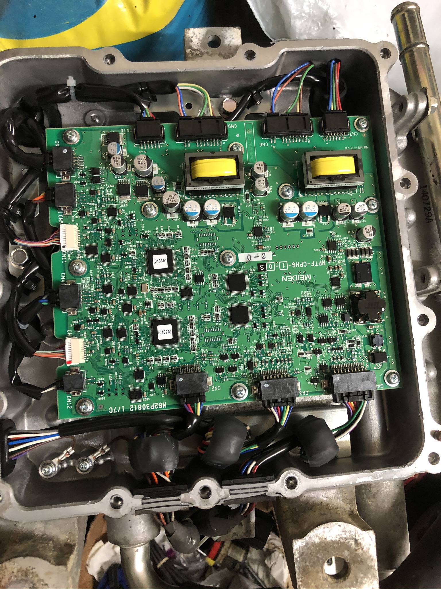

Here is the logic board, easy to see how the board is split into distinct sections for the motor and generator.

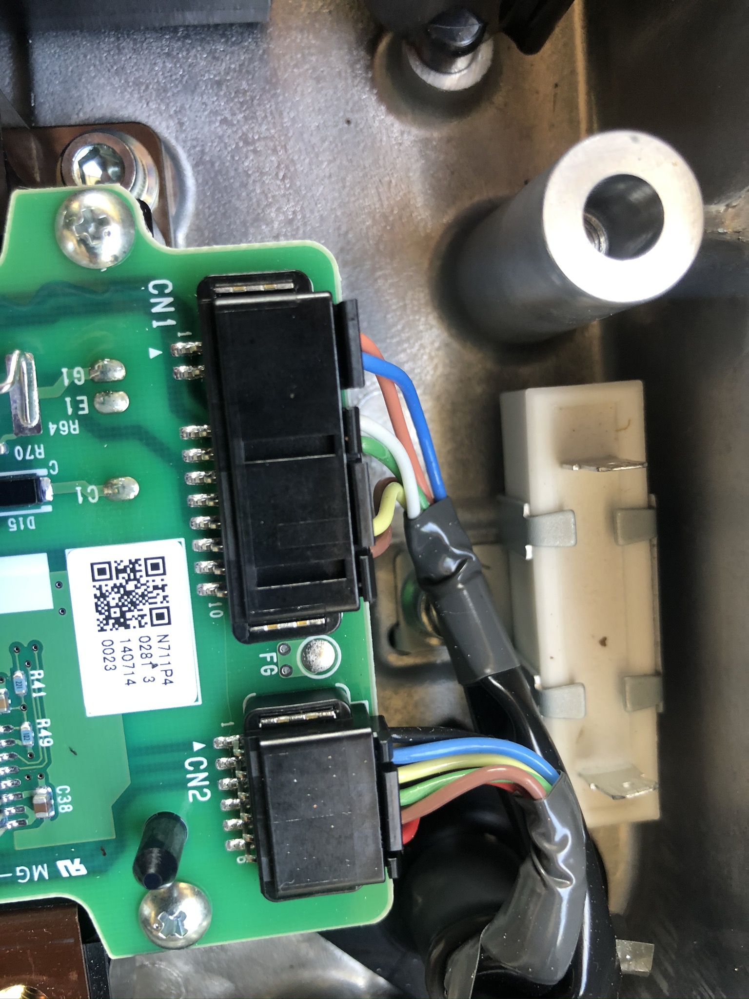

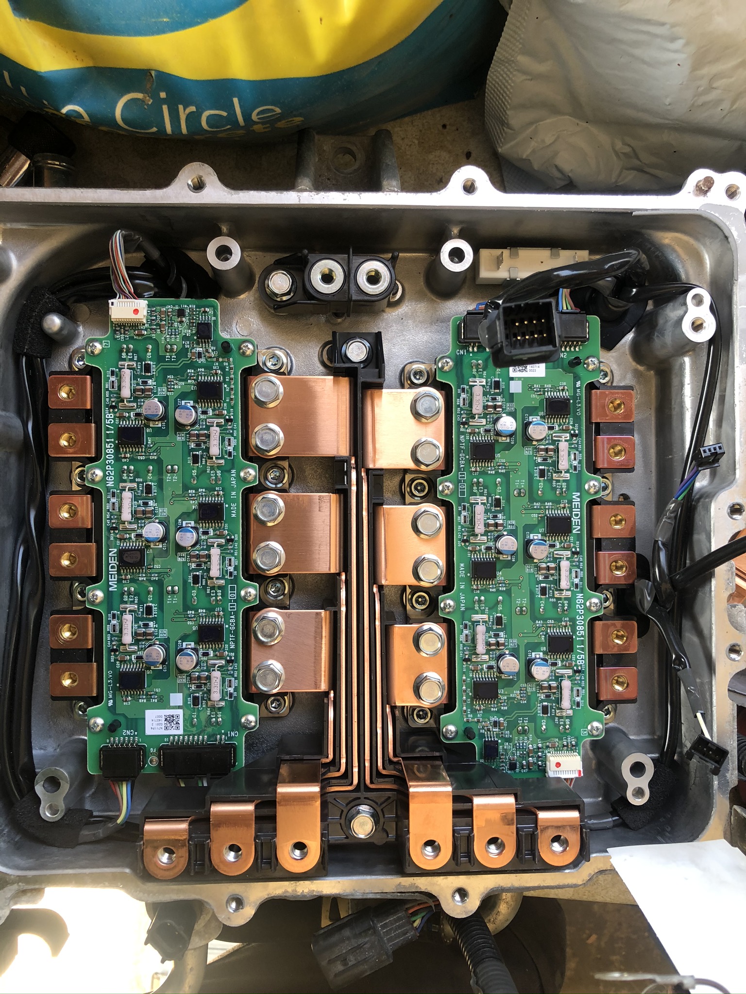

Here are the IGBT driver boards, as far as I can tell these boards are identical to each other and also to the board in the rear inverter. It is worth noting that they are reliant on power from the SMPS transformers mounted to the logic board to power the IGBT side of the A34JT opto couplers. Each board has three heatsink thermistors and a C87AT opto voltage sense.
This pair of conectors provides the 22v floating power from the transformers for firing the IGBT gates, 12 wires: a pair for each IGBT.

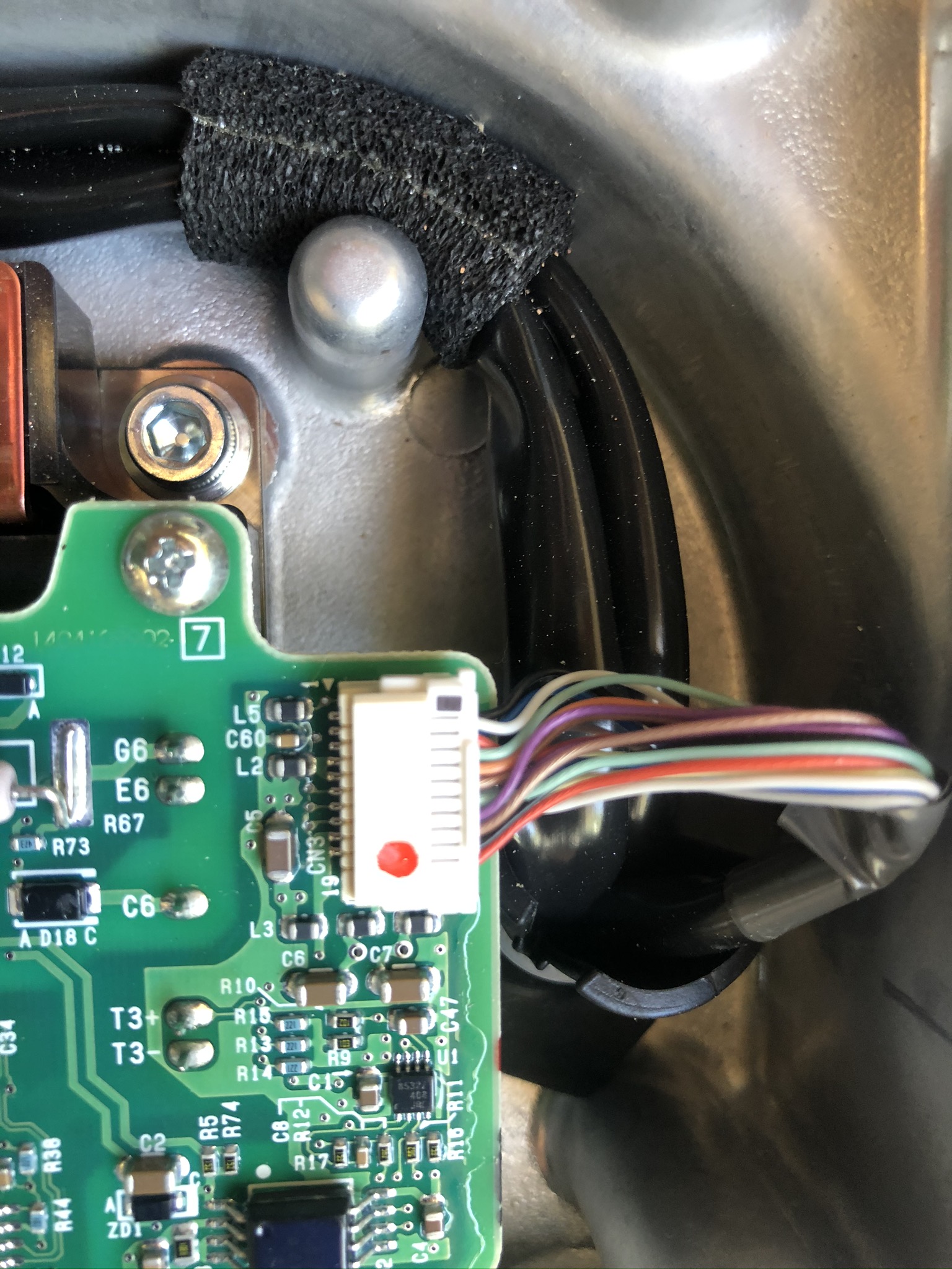

This is the 20 pin connector for the optically isolated side containing the PWMs, temp sense, voltage sense, UVLO, FAULT (desat), 5v+, 15v+ and ground.
Here you can just about see the Nipon/Nicera current sensors, 2 phases monitored per motor. From what I can tell so far they are four wire: 5v+, 0v, sensor 1, sensor 2 with 2.5v on the output lines denoting 0 amps.I have done a spreadsheet with all the pinouts for the logic boards and driver boards and how they might map to a V3 main board but I will post that in the morning...

Really nice! I have rear inverter with me and i can crosscheck your findings with my setup.
It seems this power section will go nicely with either Huebner or Lebowski brain.

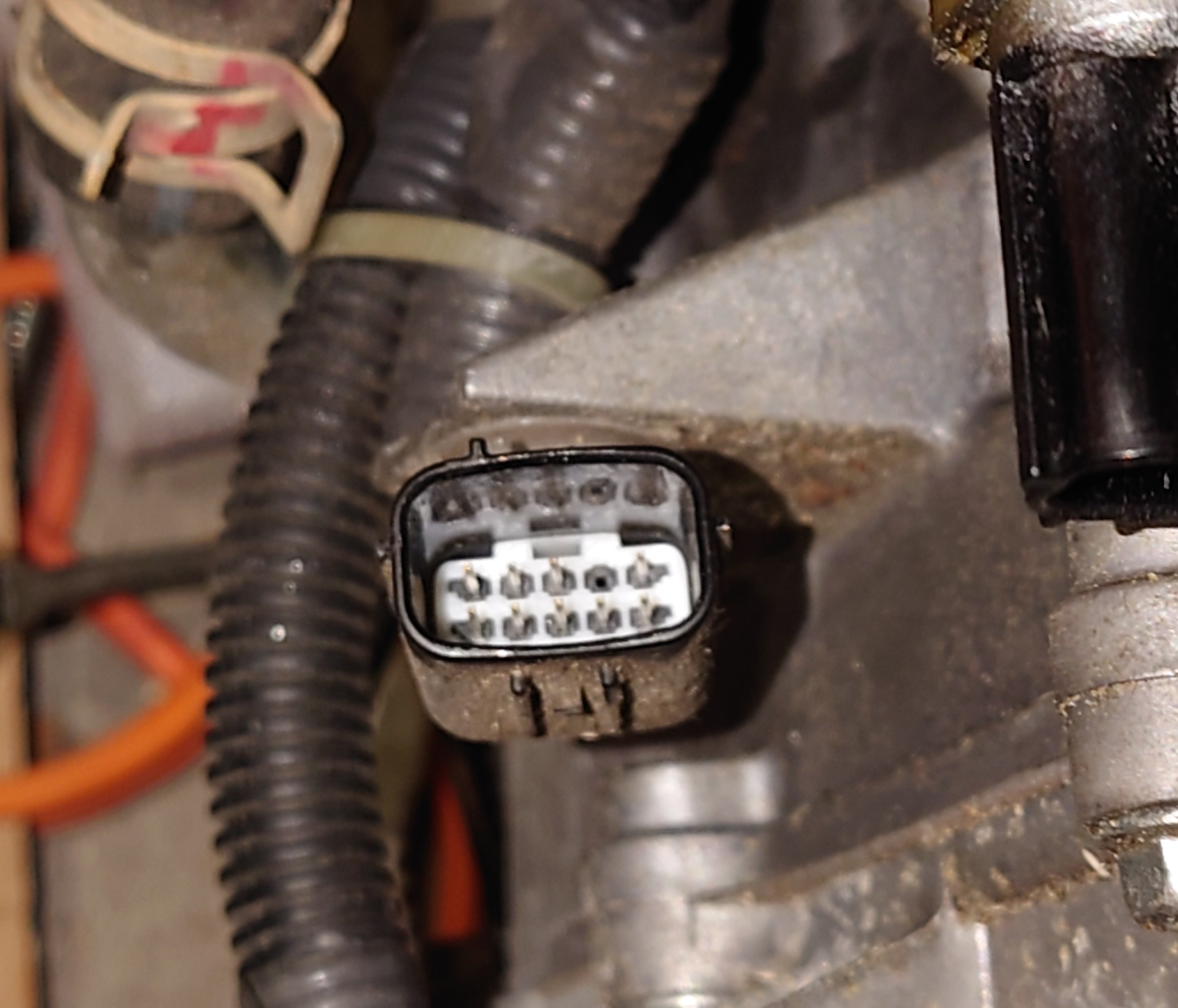

I have sourced a set of external connectors for the front inverter from a company called Autoclick.
Main loom 10 pin connector: B-143 in MMC diagrams is Sumitomo 6189-1134.
Motor sensor looms 13 pin connectors: B-141 and B-142 in MMC diagrams is Sumitomo 6189-1092.
I havent confirmed the motor plugs themselves yet as they are on my boat and I am in the workshop but so far they look like-
Motor/Generator temp sensor 6 pin connector: B-137 and B-139 in MMC diagrams is 6189-1083.
Motor/Generator resolver 8 pin connector: B-136 and B-140 in MMC diagrams is 6189-1240.

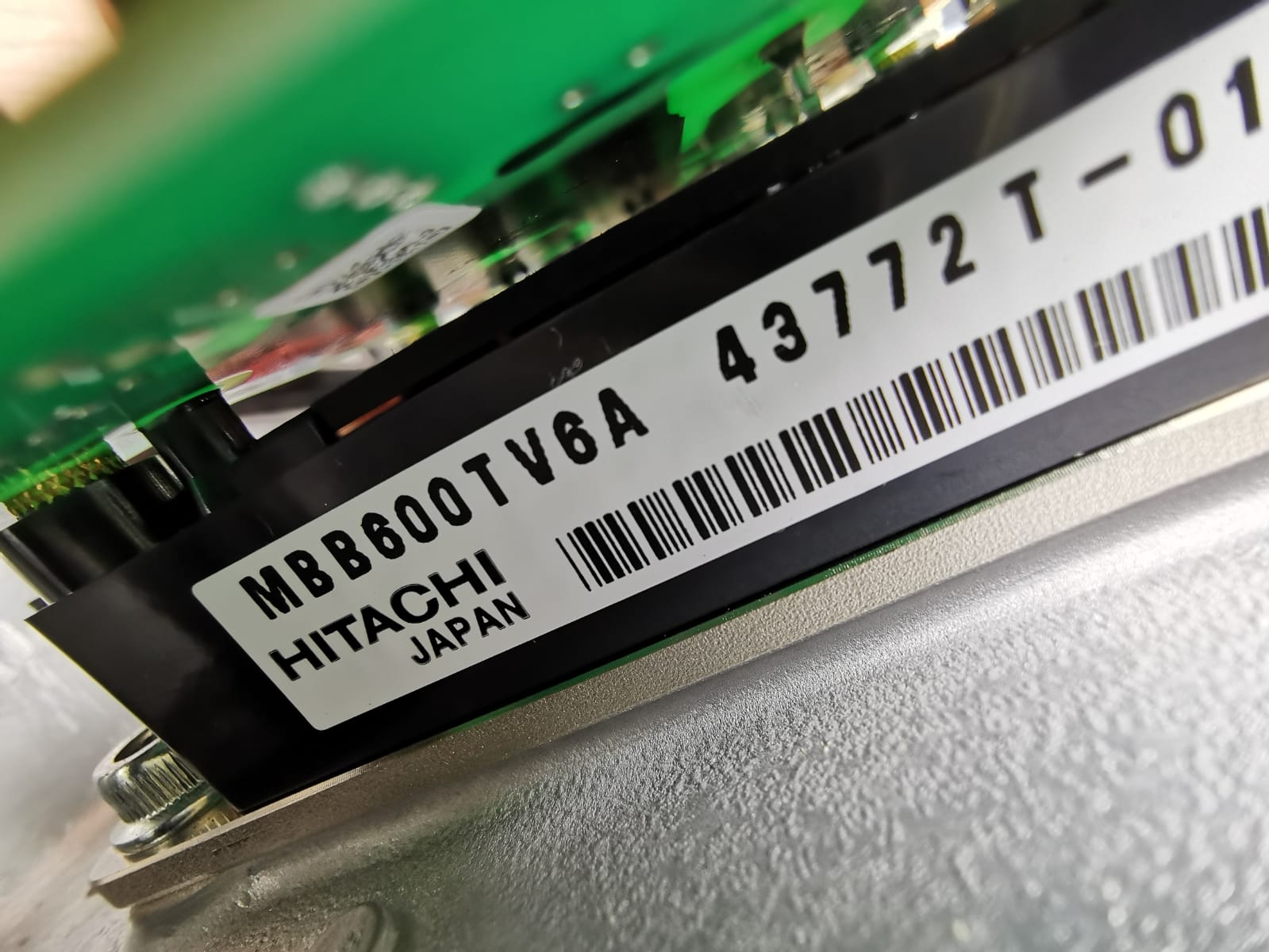

Can you get the P/N for IGBT module? That can show us what front drive is capable of. I will see the same for the rear drive...

Very similar to Volt inverter power stage. I bet the real limit to Outlander is not motor but batteries.

I would definitely agree with you. When you consider that when the batteries are flat the generator on the engine can charge the batteries and drive the front and rear motors all at the same time that is a lot of continuous power passing through just one IGBT stage. The solid copper 3 phase bus bars from the generator IGBTs would suggest that too as they are about three times thicker than the drive motor bus bars or DC in bus bars. The internals of the motors all seem to be the same, the generator receives priority oil cooling and has a dedicated oil temperature sensor is the only difference as far as I can tell. With the right battery And cooling I would say they are capable of some serious power output!

So correct me if I'm wrong but with IGBT's with ratings of 650V and 600A that makes a total maximum DC power of 360kw per IGBT stage?
Currently with the 300V battery and 60kw limit the IGBT's only see 300V and 200A. What do you feel as tough would be the maximum "Safe" voltage and Amps on each IGBT stage? Then the next question does anyone know if there is a way to actually modify the BMU and EV ECU to allow for the greater AmpHours (currently 40AH) of an upgraded pack and a higher EV only power of say 80 or 100kw. Thanks

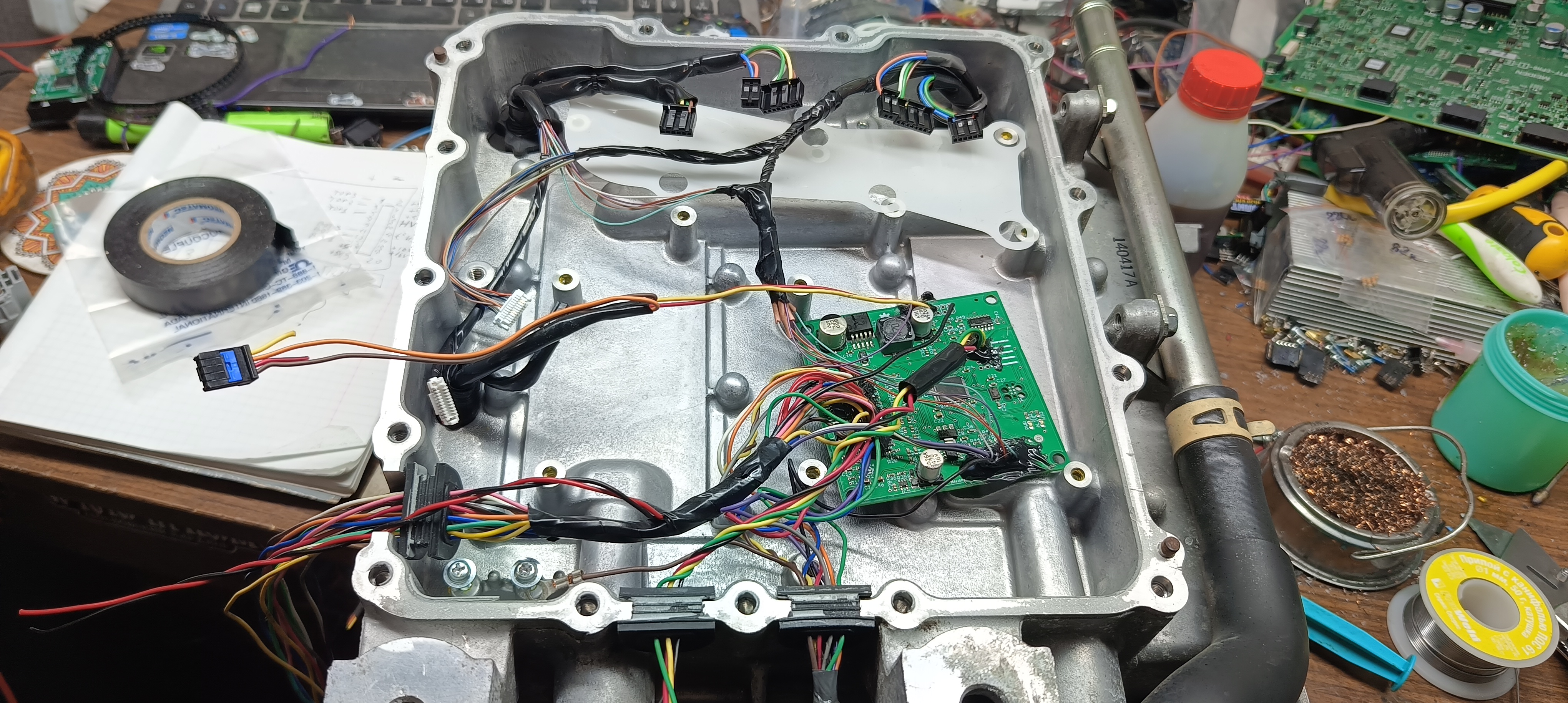

My current plan is to leave the original board in place, pick off the signals I want from the connectors and plumb them into the Hubner boards mounted over the top with a spacer plate to move the bottom cover far enough away to stop contact with the boards. The Meiden board continues to provide power no mattter what you do to it so even missing most of its inputs it will just become a power stage. I did investigate making up my own power stage with a whole set of isolated dc-dc converters making enough space in the casing for mounting the new brains but that would mean using 14 individual DC-DCs!!! Or unsoldering the original SMPS transformers and placing them on a new board putting in some new SMPS driver chips but that all takes time and I want to get my boat moving so I will try the simple route first.arber333 wrote: ↑Thu Oct 08, 2020 10:04 am Damn! I went through your pinout and calculated a bit on what it would require to control the IGBTs with Lebowski.

I agree that CAN bus would be far easier but the software wont allow reverse direction of the generator motor (as far as I am aware) and for the boat I want full independant control of both props.

Generally we push no more than 450 volts through a 600V IGBT, due to the voltage spikes which come from driving an inductive load like a motor. With careful work and lots of EE experience you can probably push 500. But increasing voltage like that will certainly cause issues with other components, so increasing voltage is not really a feasible change for an OEM vehicle.
Increasing power is better. You'd need to first upgrade the battery system and then tell the motor that it's allowed to use more power -- there is likely a CAN message somewhere which you could intercept and modify. Unless, that is, the power limit is inside the inverter, in which case you'd need to replace the inverter board -- a difficult undertaking, hard to integrate with all those Mitsubishi systems.
600A IGBTs can easily handle peak currents of 500A, which is 350A RMS (average).

As i can see the actual 1ms rating is 1200A so i think they will hold actual 600A with good collant flow. With 650V rating i would go with 2/3 rule. Not over 420Vdc since most of the components have problems higher than that as well. Also EMI power is rising to the square of voltage.

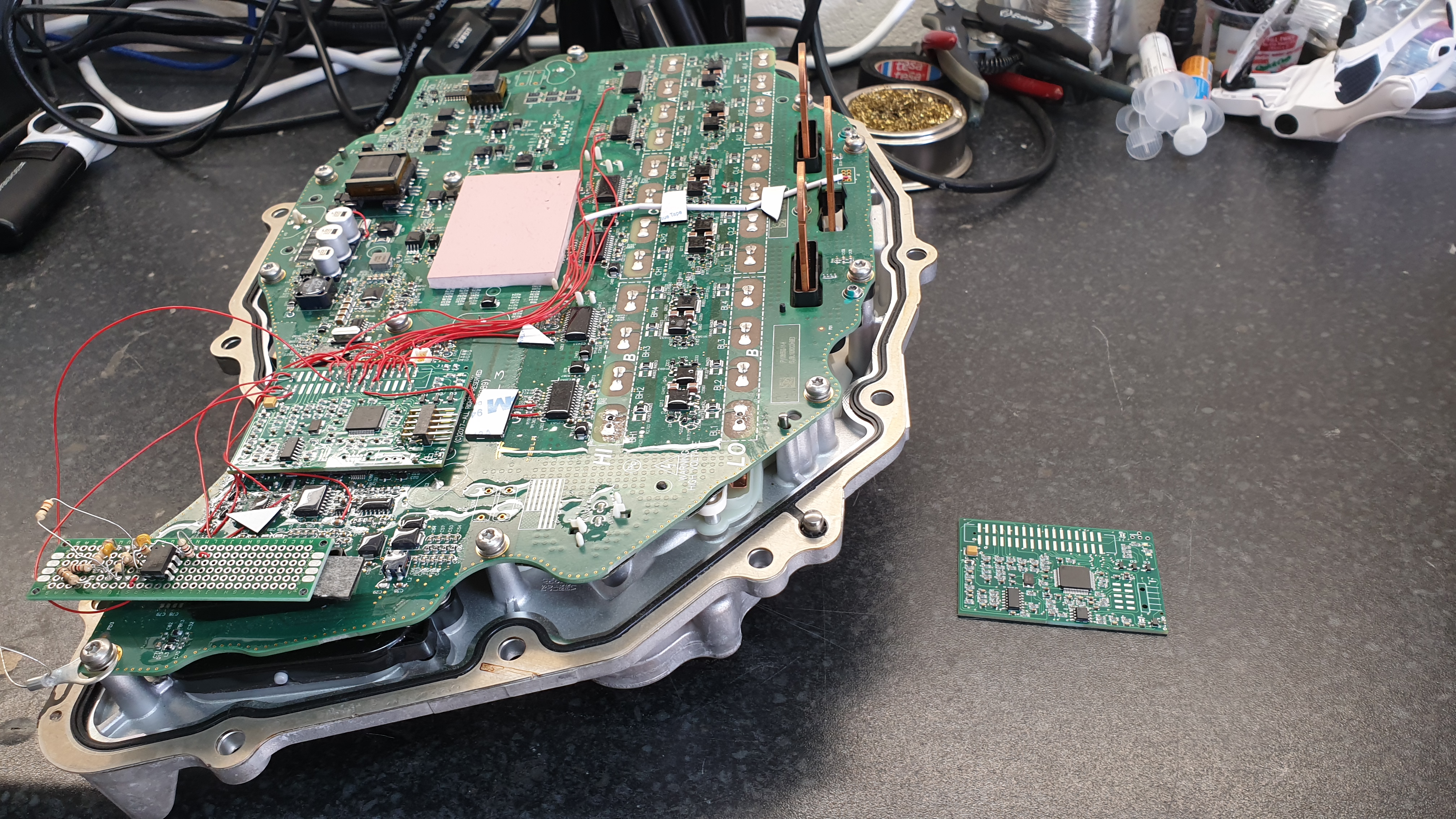

I am hopeful the stock inverter and stock board will purely run on canbus commands well above the stock torque and power ratings on the outander.
The i-miev evolution 2&3 used stock imiev inverter and a seperate board sending canbus commands and they both ran 300nm torque and between
100-112.5kw power on each motor.
Fairly sure the phev outlander rally car used some custom controls too.
Once i have my battery finished i can begin testing, but im fairly sure the inverter is dumb and just works off given canbus commands like the earlier i-miev model.
I do have a v3.0 board if this is not the case, i will use it piggybacked off the stock board , so the igbt get the correct voltages and v3.0 board just gets current sense/voltage sense, resolver, motor temp and igbt control.
Everything else will be done through canbus.

Really excellent, I would be very interested to know where it would max out on the stock board. It seems several people have the stock system working with a CAN VCU but have problems with throttle mapping. The only draw back with the front inverter is that you can’t spin the generator motor backwards via CAN command (or so I’ve been told) to protect the engine from reverse rotation.
I am in the process of mounting the 2x v3 boards as you say piggybacked. Looks like I will have to create a spacer for the bottom cover plate to create extra room for the v3 boards to sit with enough clearance inside the case.

So, a bit of an update and some more information.
The V3 boards are in and working as much as they can be without being connected to a motor. The next few days will hopefully see them spinning a propellor. Damien sent me two of the model 3 modboards which I thought would be perfect but in the end getting the resolver exciter to work with the resolver to digital chip was proving tricky and leading towards needing another external signal converter board so I ended up modifying the inverter case to allow the Hubner boards to fit.
Original logic board fitted back on top on spacers. Only mild clearancing of the cover plate to clear the transformers....

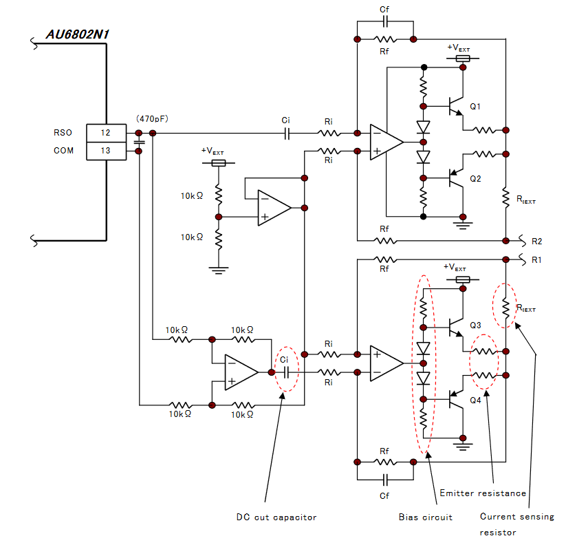

Now, things I have found out about the Meiden logic board:
It uses a resolver to digital converter, Tamagawa AU6802N1, this drives a resolver excitor ciruict using 4 transistors driven by a set of op-amps. The sine-cosine is then fed back into the chip, converted into a digital position and sent to the main MCU via seriel. The main MCU is a Renesas R5F7147FPV.
In a previous post I mentioned that there is a connector on the board, CN1, which I couldnt find a function for. I have now found that it it a RS232 programming conector for both of the Renesas chips.
1. Boot mode, feed 5v to pull MD1 (pin 76) to ground - Drive motor MCU
2. RS232 Tx - Drive motor MCU TXD1 (pin 65)
3. GND
4. RS232 Rx - Generator motor MCU RXD1 (pin 66)
5. Boot mode, feed 5v to pull MD1 (pin 76) to ground - Generator motor MCU
6. GND
7. RS232 Rx - Drive motor MCU RXD1 (pin 66)
8. RS232 Tx - Generator motor MCU TXD1 (pin 65)
The loom from this plug on the logic board leads up to a connector accesible from the cover plate over the phase cables so gives access to full programing of the original logic board without disasembling the whole inverter. There is a flash programing tool on Renesas' website that seems like it could be used for this. When I have more time I will have a play with this.
