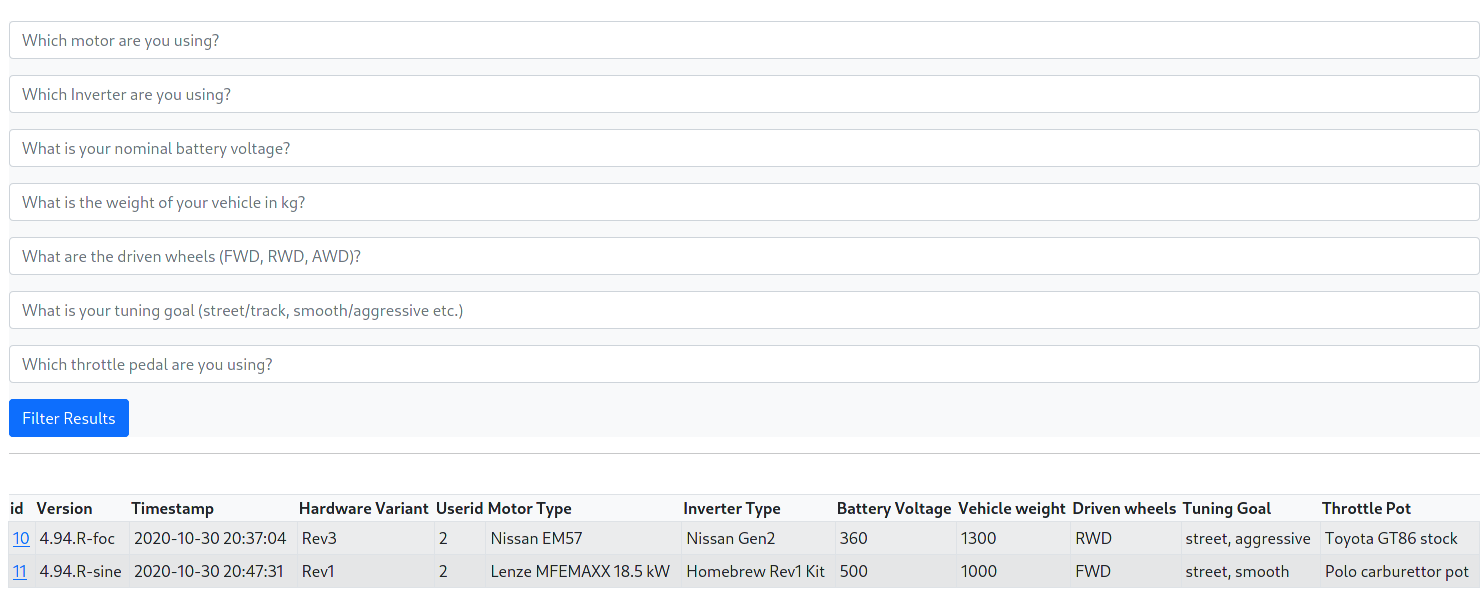

Just want to let everyone know we (Dima, me) are making good progress with the database.

Thank you both. You guys rule, can’t wait to see how you get on
