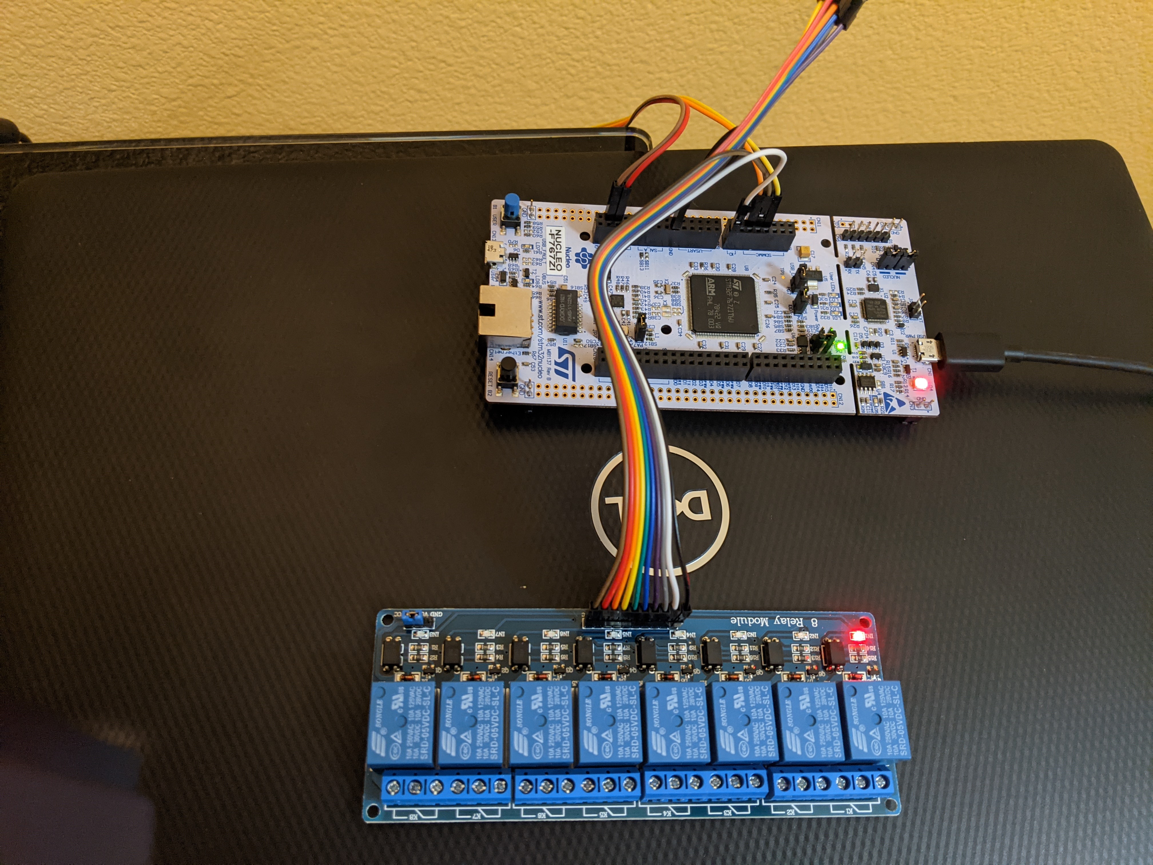

I have a 8 relay module board fitted and working:
Now I just need to throw some logic around what I've got.
I'll put together a DBC for the CAN data as well when I'm done.
Hopefully I'll be able to get closer to where it wants voltage... I hope to have something to show by tomorrow night. But I'm done for now. :)
