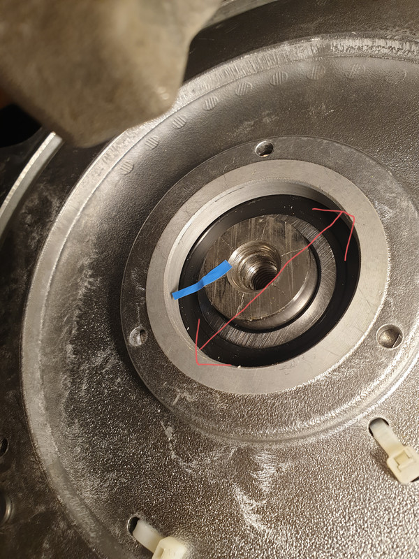

Well you need to make 44mm recess in your mount center. Make it like 2mm deep with central hole so that when you mount your bolt in center of shaft it will almost touch the underside of RLS metal pad.
You need to get pad in center with 0.1mm accuracy, but magnet distance is good up to 1mm from the pad underside.
I suggest a 4 wire LiYCY cable which is shielded cable. You solder the wires directly onto the RLS encoder circuit and put a blob of nail polish or paint on it. You find a place to connect shield inside motor case and use a zip tie to fix the cable in place inside. Then you find a gland through which you will fit the cable out.
You will have to calibrate the sensor with the motor. After mounting the sensor you will supply 5V to the sensor and give 12Vdc to 2 of the motor phases to align first magnet to stator. Then you short two pads on the encoder PCB for a second. Encoder will remember position and that will be your 0° angle,
RLS encoder you need to select according to the pole count! This is really important so let them know your motor parameters in a comment or message.
I think your encoder will be P/N RMF44AC01SA10 and magnet you will select RMM44A3A00. See their online store.

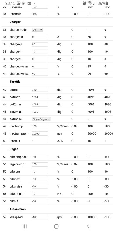

I've got a throttle pedal that one of the channels gives 0.389 v at rest and 2.064 v fully pressed. The other channel I did not manage to get any reading out when pressing the pedal so far. I'm not sure how to enter the values into firmware. I entered as above and it gives me strange readings when I try to plot the pot value. What have I done wrong?
