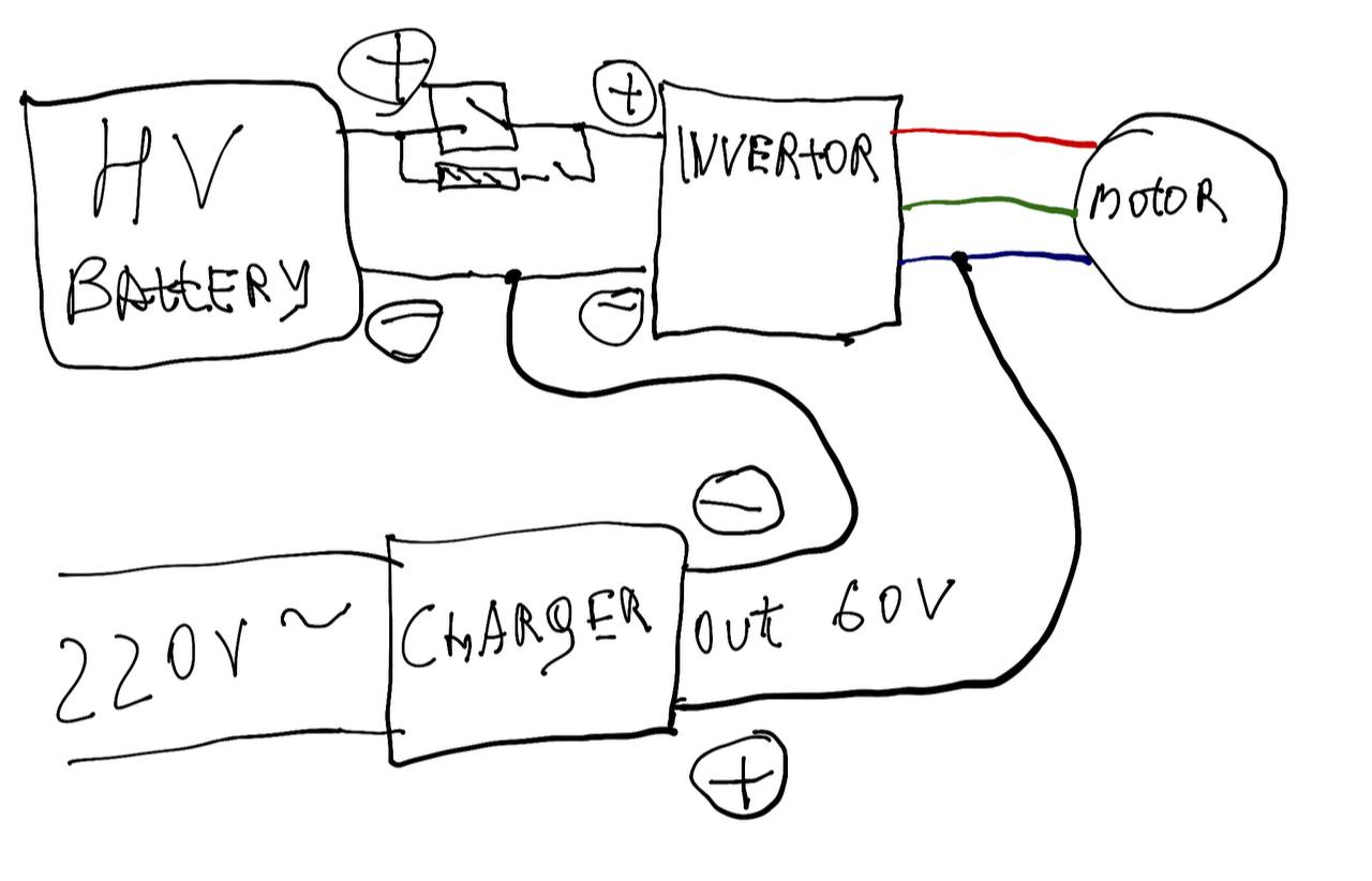

is there any special order for starting the boost charging mode?
I used a 60 volt power supply.
I connected his + to the middle phase of the motor, and his - to the negative terminal of the battery. I closed +12 to the outputs forward and backward, turned on the 60 volt power supply, turned on the inverter power. controller status: boost. however, no charging current has occurred. I can't figure out where I'm wrong. I had high hopes for this system and such a crash (((
evil neodymium :twisted:

Romale wrote: Thu Jun 02, 2022 11:02 am I connected his + to the middle phase of the motor
I think there's your problem. L2 is the module being clocked for boosting, so to have an inductor your input voltage can be on any phase BUT L2. Right now you're just shorting out your power supply

it's very strange. I can't figure out exactly where the error is and why should I have a short circuit for the power supply?
this did not happen, there was simply no load in the form of a charging current.
in fact, I did everything exactly as indicated in the wiki for using an inverter with a motor to charge the battery, just simplified the number of contactors and used a power supply instead of a diode bridge.
maybe there is an error in the wiki and it is necessary to supply + to the battery, and - to one of the phases?

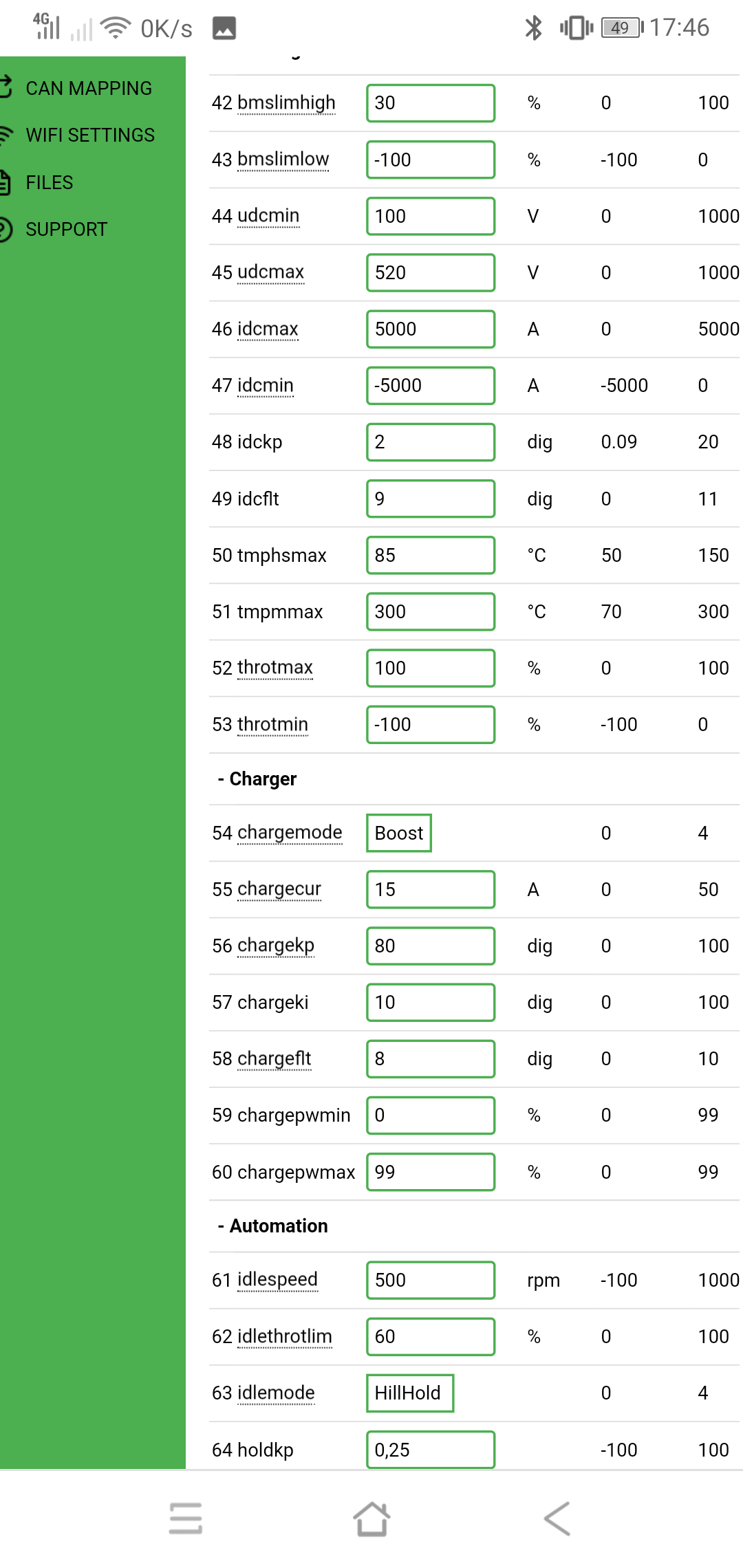

below is a picture of how I connected and a screenshot of how to connect, I don't see the difference.

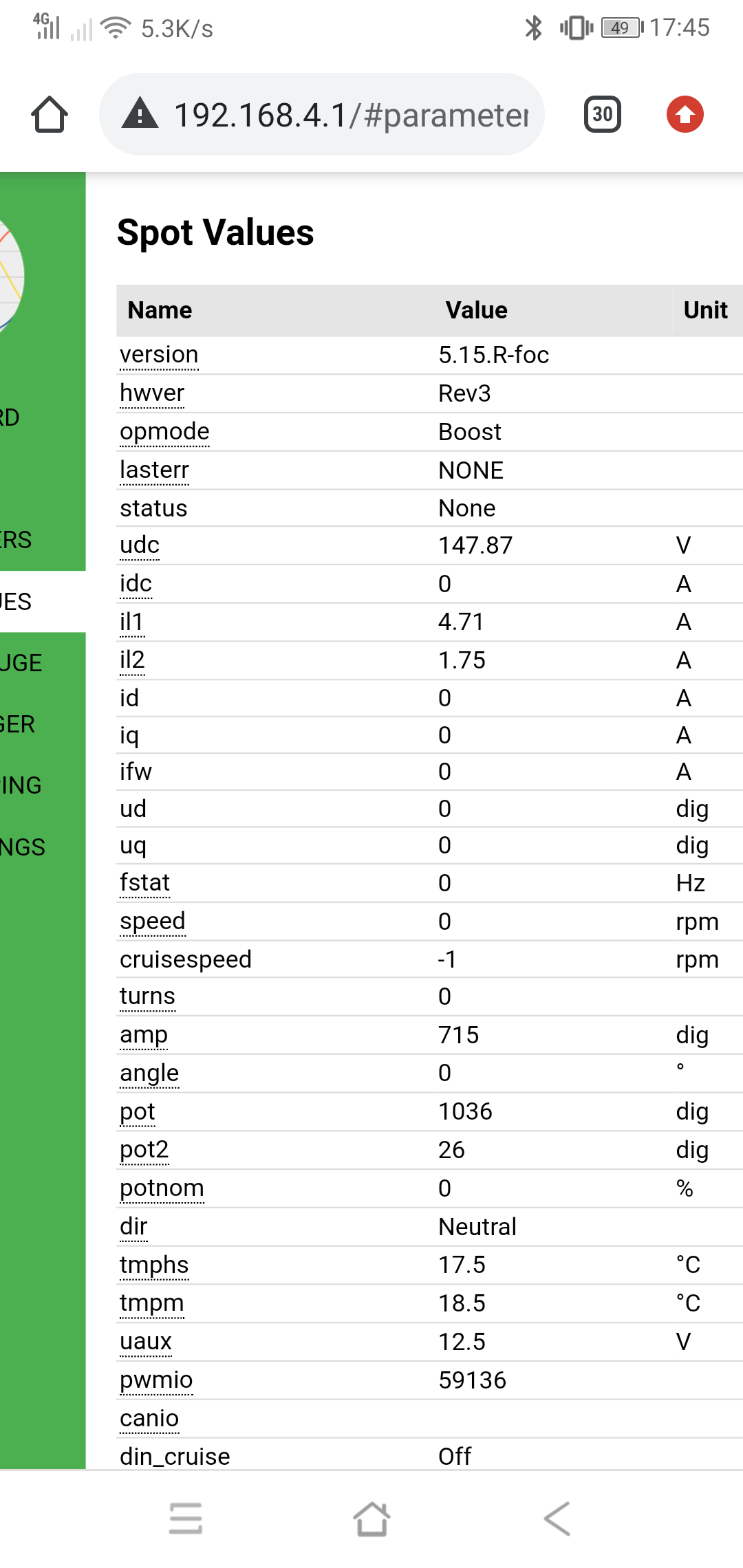

Your connection is correct and in spot values you can see the IGBT is clocked with 715 digits, I think that is just around 20% duty cycle. Much too low...
I haven't tested charge mode in a while, maybe try older software like 4.97.R?
Might be a silly question, but you do have the inverter positive connected to the HV Battery positive through a closed contactor, correct?
If that answer is yes: What happens when you move the "charger out" positive wire from the blue to the green or red motor phase?
