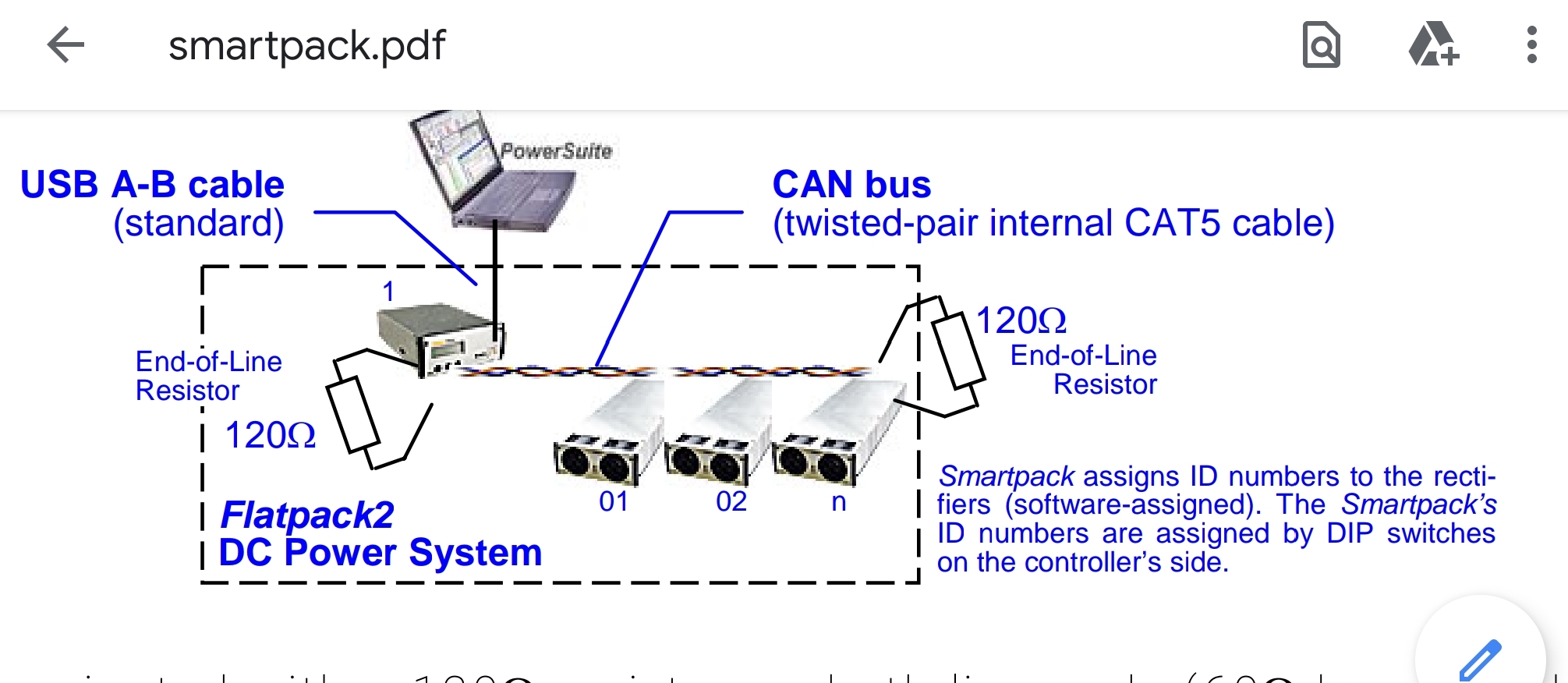

I was asked if I can share any details of how you can control Eltek Flatpack 2 HE over CAN so here goes.
My knowledge of this is based on the forum thread below and my own experimenting and use of these power supplys as EV charger.
https://endless-sphere.com/forums/viewt ... ce854514ff

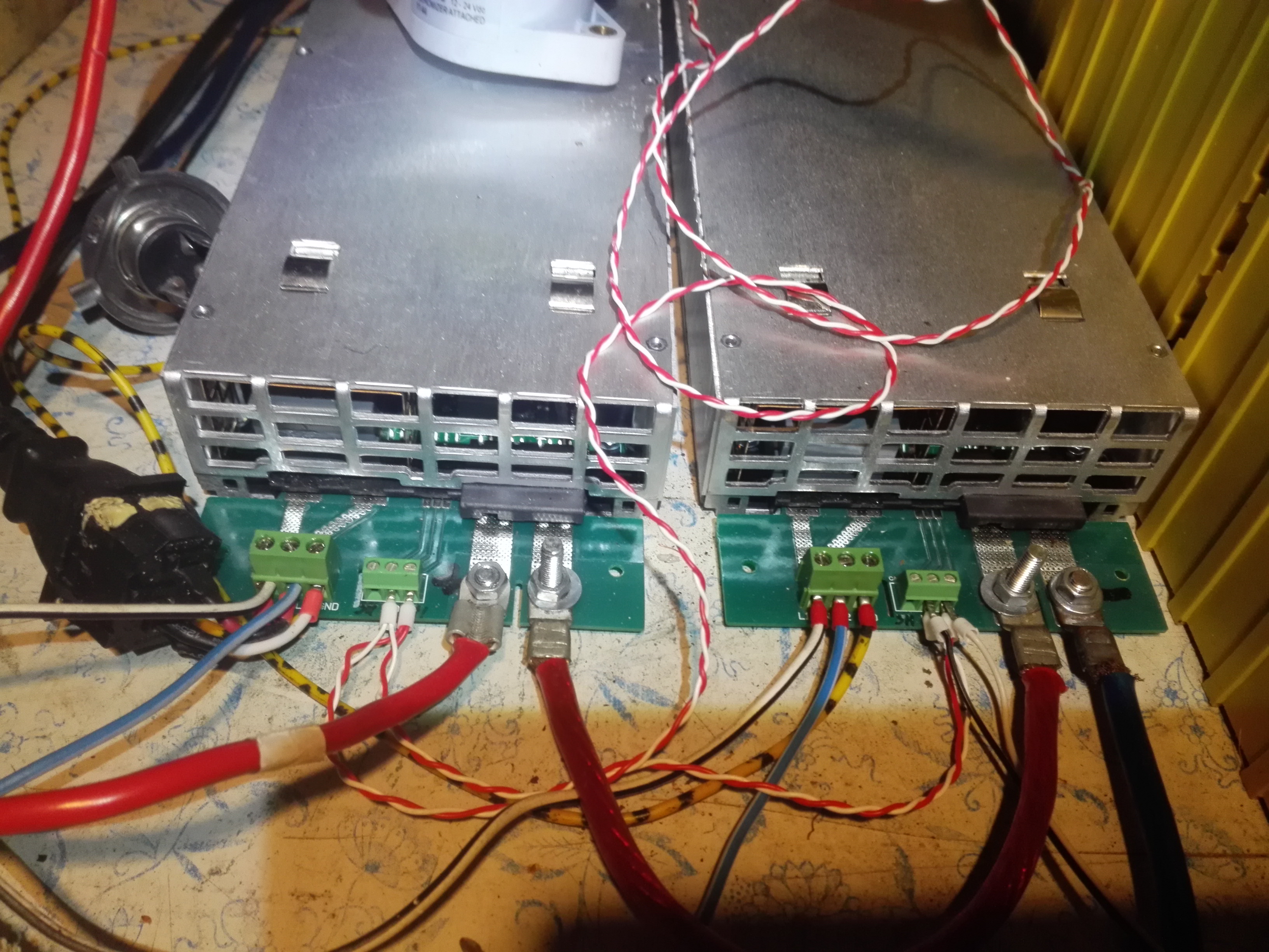

I have used 3pcs of 48V Flatpack 2 HE connected in series on the DC-side and y-connected (1 supply on each phase to neutral) on the AC-side to run 9kW of charging into my 42S LiFePO4 batterypack.
NOTE: The CAN-bus on the 48V Flatpacks is related to DC-side minus connector i.e. not isolated so when connected in series the CAN-bus needs to be isolated from the controlling microprocessor. I did this by using ISO1050 CAN-trancievers.
EDIT: johu proves not needed, my misstake
EDIT2: In order to get reliable communication the CAN-bus on the 48V Flatpacks needs to be related to the DC-side negative connector, resulting in that the CAN-bus need to be isolated from the controlling microprocessor.
CAN speed is 125kbit/s.

bexander wrote: Fri Jan 15, 2021 4:28 pm NOTE: The CAN-bus on the 48V Flatpacks is related to DC-side minus connector i.e. not isolated so when connected in series the CAN-bus needs to be isolated from the controlling microprocessor. I did this by using ISO1050 CAN-trancievers.
Are you really sure? I also use them in series but just connected the CAN buses straight through.
Also I never send the login. Maybe a different message, will check. I set the default voltage once (I think with login) and so low that it doesn't charge. It seems it has stored that setting to eeprom.

To get the CAN communitaction to work I have to connect the GND of the tranceiver to the negative output of the FP. When connecting two FP:s in series there will be a voltage difference of one FP output between the two negative outputs and hence a SC if not using isolated CAN.
This is the way I got it to work. There might be other ways that I'm not aware of. Please share more details of your connections.
There might also be differences between different FP:s. I use 48V Flatpack 2 HE.

Re: Communicate and control Eltek Flatpack 2 HE
Of course I had to go and check :)
I measured infinite resistance between CANL and negative rail.
They are FLATPACK2 48/3000 HE G2

johu wrote: Fri Jan 15, 2021 5:21 pm Of course I had to go and check :)
If I remember correctly I also have infinite resistance between CANL and negative rail. I don't have the FP:s available at the moment so can't check.
But when I didn't connect the negative rail to GND of the tranceiver (TJA1050) I couldn't get the communication to work. I might have made a mistake and falsely concluded that this is neaccesary. I will test this again when possible. Would be great to not need the isolated tranceivers.
What CAN-tranceiver are you using?

I finally got a chance today to test this.
Indeed I can connect three FP i series and put them on the same CAN-bus without causing any shorts or similar, but I can't get the communication to work reliably. At startup all three responds and sets commanded voltage but after 10s (time it takes for FP to fall back to default) two of the three FP falls back to default. If I make a GND connection between a FP and my CAN tranciever, that FP responds to commands.
Also when using three FP it is always the one in the middle that take commands and the other two that loses them after startup.
My conclusion is that there are some kind of capacitive coupling that makes the FP-CAN lose there ground reference somehow. I have no idea of how to work around this other than to use a separate CAN-tranciever for every FP in series.

bexander wrote: Wed Mar 03, 2021 4:01 pm I finally got a chance today to test this.
Maybe each of them have their own terminator resistor and final parallel resistance is too much (low) for CAN transcievers. Can you see if they use some jumper or DIP setting to add 120R resistor in circuit?

arber333 wrote: Wed Mar 03, 2021 7:07 pm
Good idea, but there are no dip switch or jumper as there are no internal termination resistors.
I have measured the resistance between CAN H and CAN L. With my termination resistors, in each end, I have a total resistance of 60ohm.

bexander wrote: Thu Mar 04, 2021 6:42 am
There are other possibilities for CAN not working. I speak out of experience.
1. You may have wire pairs twisted in the reverse way of the other :). It happens i should know...
2. Length of wire from the junction to the device could be too long and inductance still appears. I suggest you use not more than 10cm cables from CAN junction to the device.

Maybe it will be useful. In Eltek power systems/cabinets, gnd are connected to Positive leads (positive is grounded). Negative, fused, goes to load.
Also flatpacks have no option on resistors. Main can bus network is terminated by two resistors.
