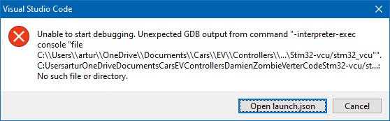

Johannes, there is not to many file at all. Let us work out some kinks and once we have solid solution you will be able to incorporate it in your projects.
Dave, I an glad you were able to get it to work on Linux, I found your VS Code configuration in "ACDC_LIM" branch, I wish I knew about it earlier
I tried it on Windows and run into few small issues, let's try to address them so we can come up with cross-platform solution. Unfortunately I do not have have Linux machine and I am not able to test my updates on Linux.
In "c_cpp_properties.json" currently hardcoded "compilerPath" will not work on all systems specially Windows, I propose to use Environment Variable for the Toolchain bin folder (in my case "C:/Program Files (x86)/gcc-arm-none-eabi-10-2020-q4-major/bin"). Hopefully it can be replicated on Linux. Please see my comments in modified file below.
Param "intelliSenseMode": "linux-gcc-arm" did not work for me, will "gcc-arm" work on Linux?

Am I missing some component? Do I need to do something before hitting F5?
I am using "Cortex-Debug" plugin for VS Code and OpenOCD.
Here is my config file:

I can test it further on Windows if you have any suggestions. I can create guide but it is probably better to wait until we have solid solution worked out.

My launch config expects an openocd process to be running. I found it easier to keep an eye on openocd. Using Cortex Debug is probably a much better way to go. Apologies for the hard coded paths, I'll need to do a bit more digging and see if we can't come up with a neater cross-platform config. I have Linux and Windows PCs to test with.

I have tried to start OpenOCD before initiating Debug session:
and I still got the same popup error. I am lost on this one.
As far as environment variables I run another test removing compiler path and leaving just the name of executable. Since I have Toolchain bin directory in PATH Variable it worked just fine. If we can do it the same way on Linux it would simplify configuration process.
Not much progress but just wanted to share.
It would be great if you could try to test Cortex Debug plugin configuration in Linux. Perhaps this method will work on both platforms.
