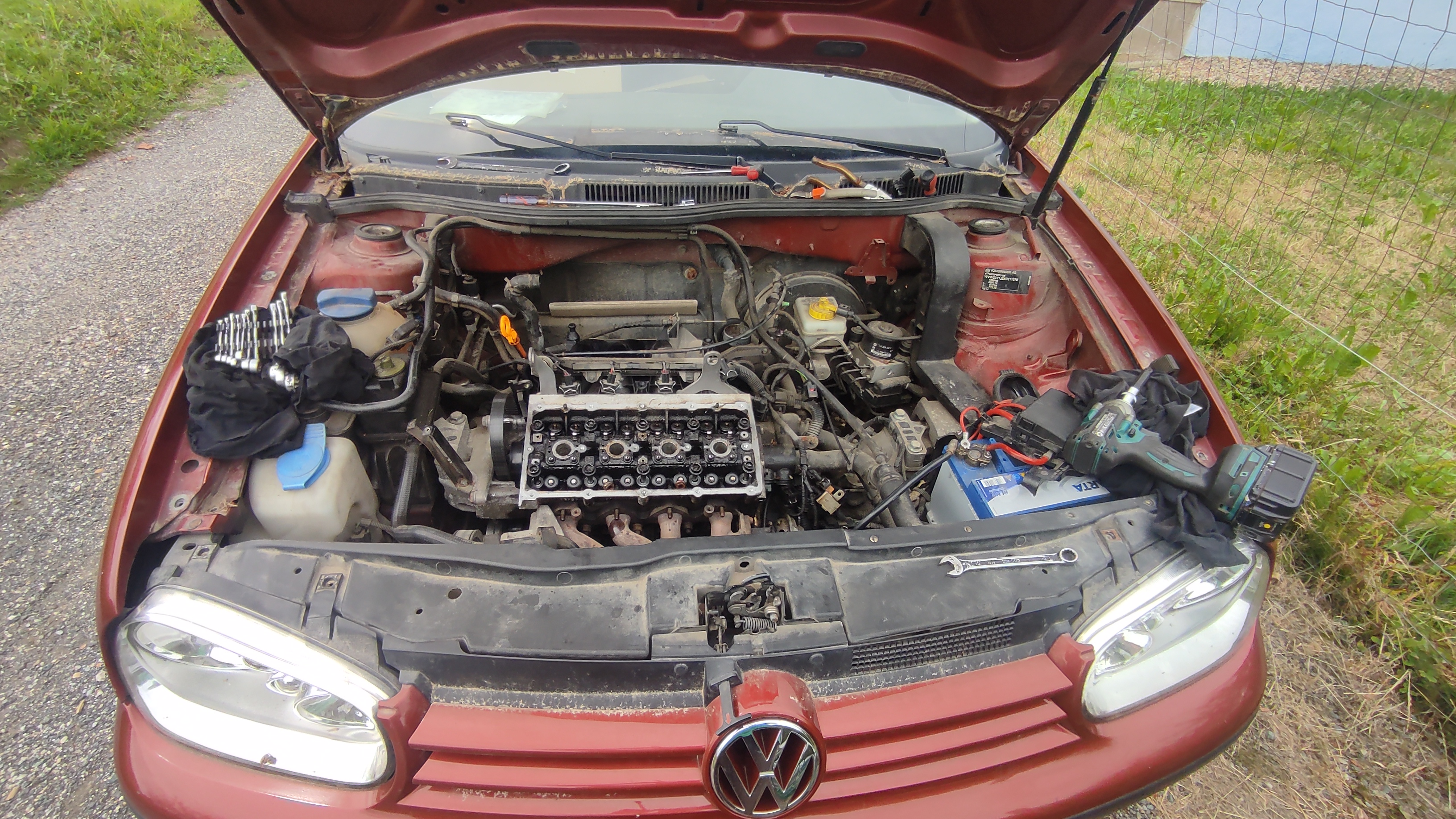

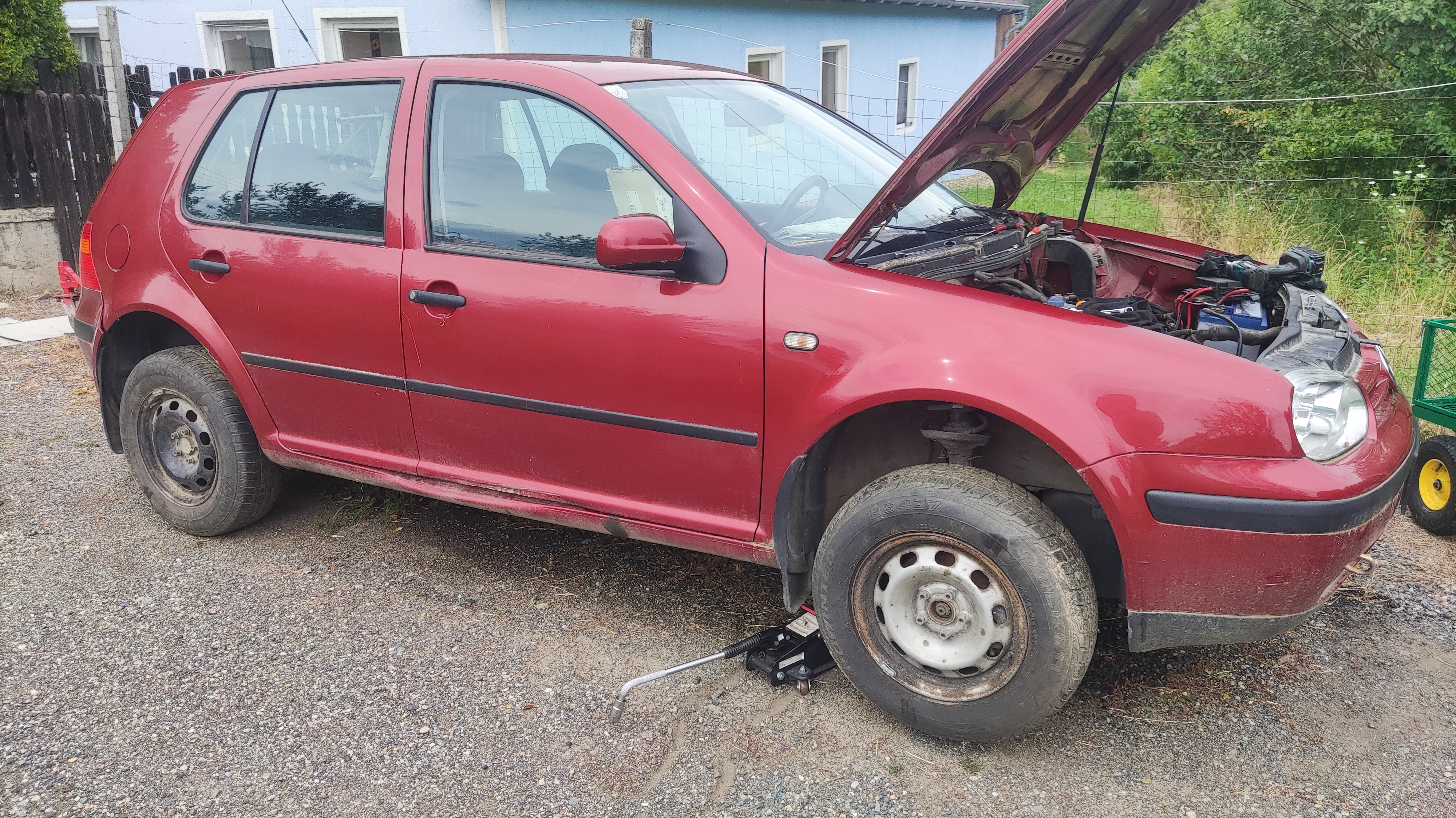

I've decided to finally start building my own electric car.
I was going to convert my Passat in 2019 but just as I was about to start buying parts COVID happened and I was laid off amongst other things. :cry:
The Passat is my only mode of transportation for now, so I got this Golf instead for just 200€ with a broken Conrod.
I've got brakes figured out, don't know if I should go with electric power steering or hydraulic. Hydraulic seems way easier.
Inverter is a Gen2 Prius with the brain board from Johannes.
Motor is a 33kg asynchronous forklift motor rated at 5kw cont. It has plenty of cooling holes so I'm hoping it'll handle 20kw peaks, maybe more with higher voltage.
I think I got the battery figured out.
This will be a tight budget conversion since I don't have a stable income.
