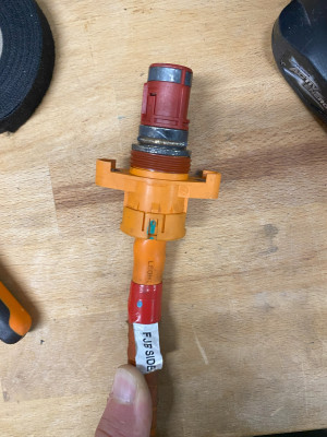

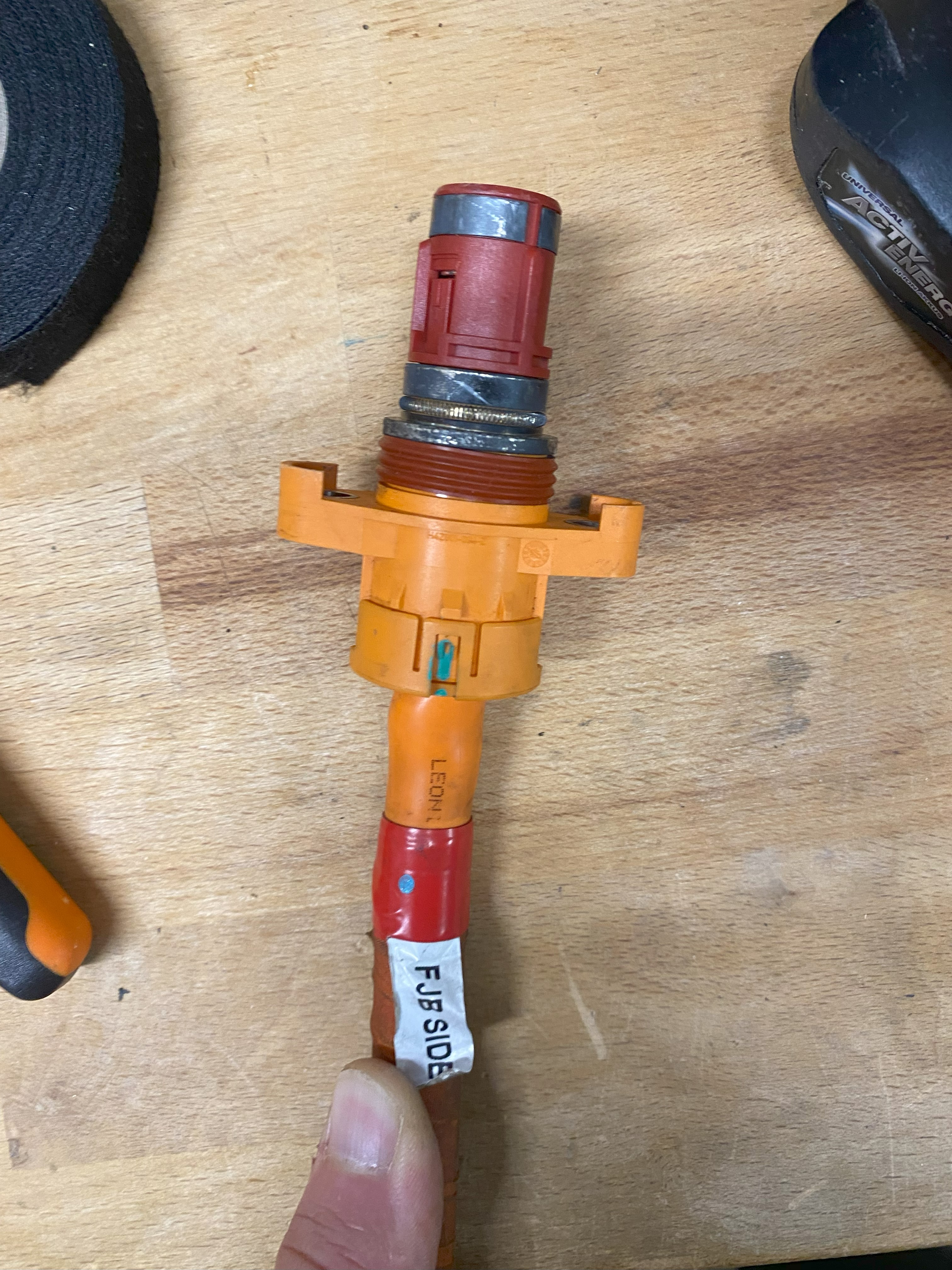

Which wiring diameter does the Tesla SDU Rear Unit have? I got some 50mm² cables with fitting connectors, but they they FJB Side on them.
I will add the information to the wiki, if somebody can confirm.

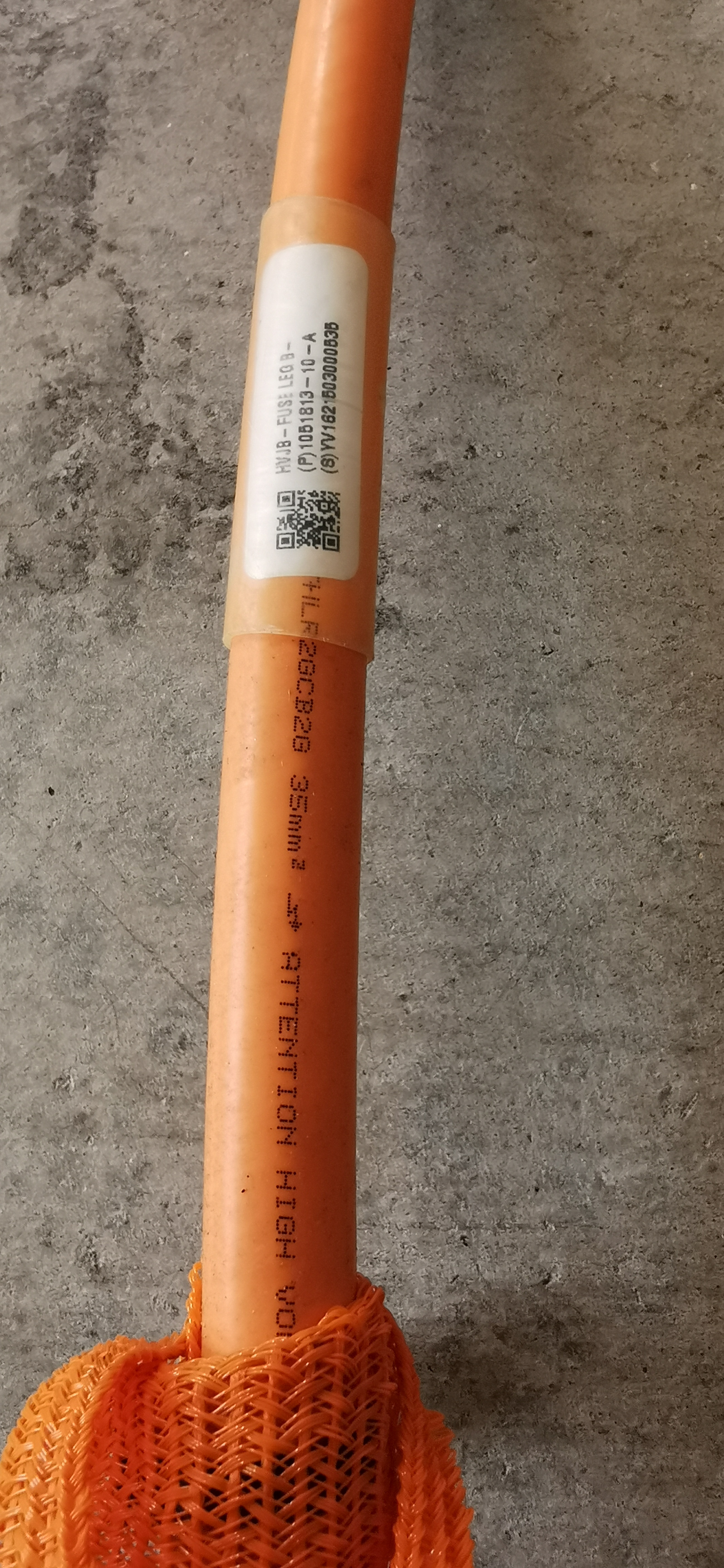

My cable came from the 70d model s. It uses 35mm2 cable. See attached.
