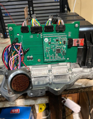

photo of my board

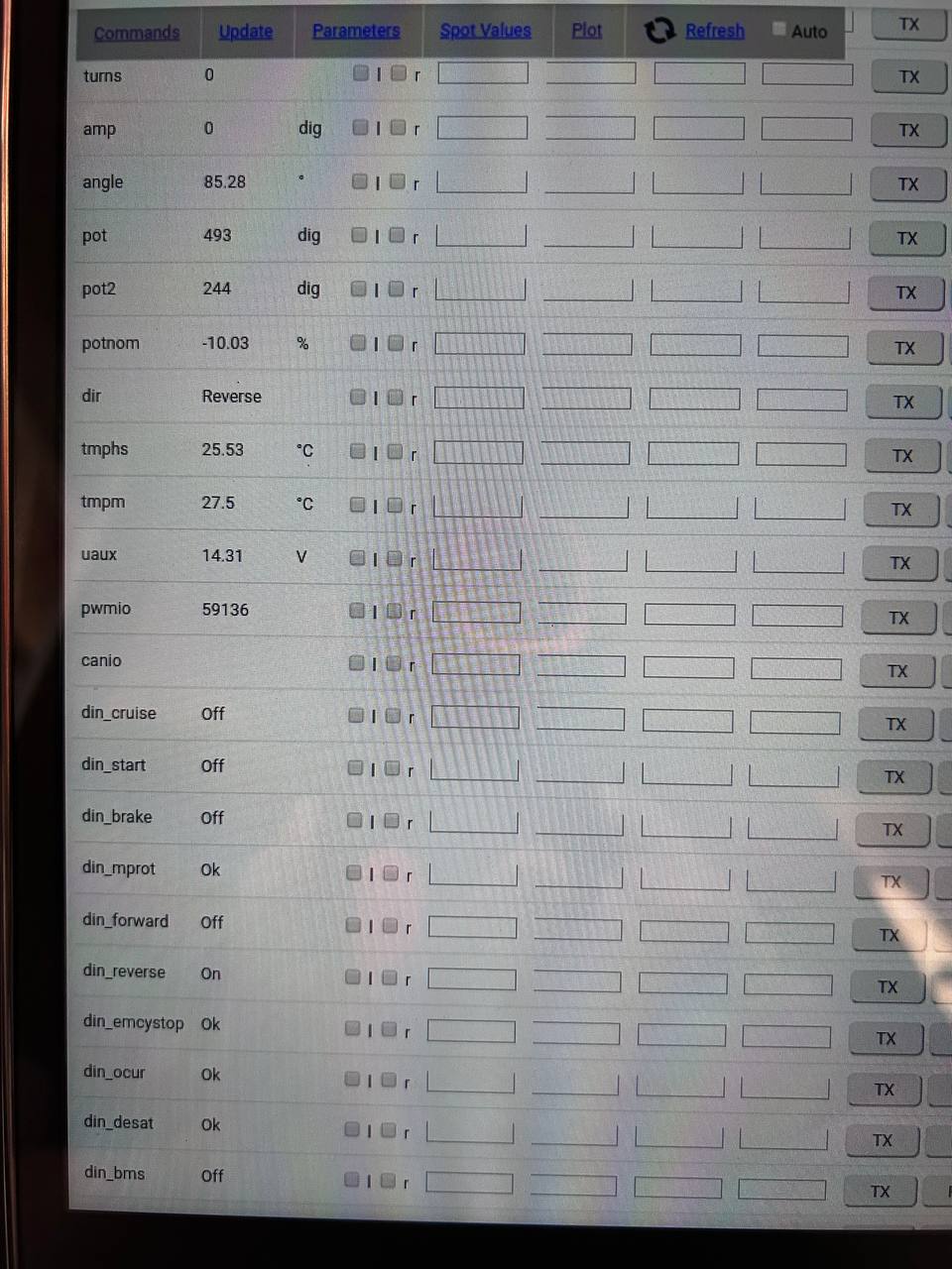

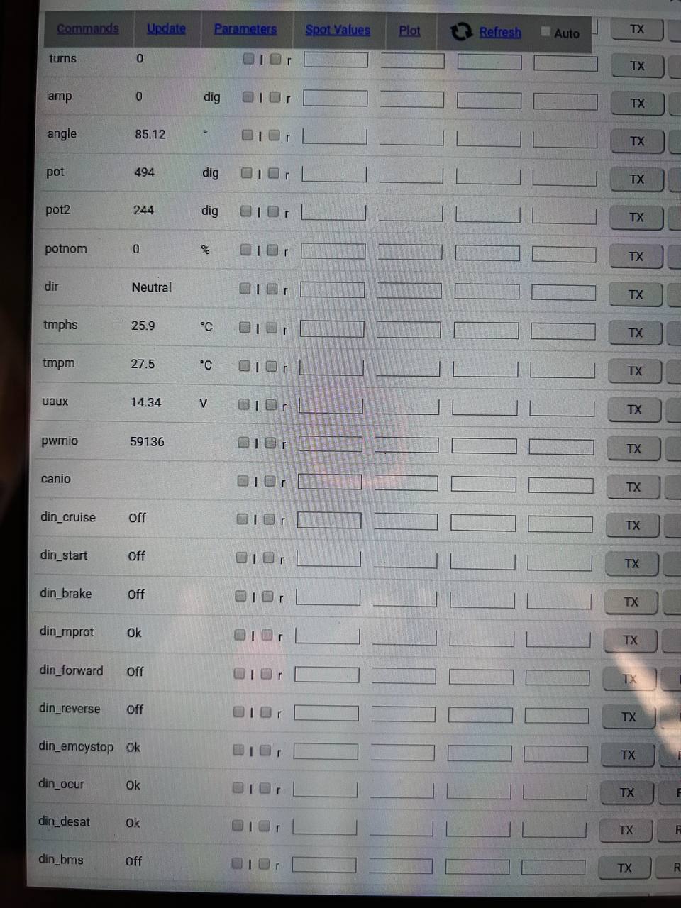

Re: The motor turns in the opposite direction
In the description of the parameters and spot values https://openinverter.org/wiki/Parameters
we find "dir", with the explanation Rotation direction. -1=REV, 0=Neutral, 1=FWD
This could help, to split the search range into two two smaller search ranges. There are two possibilies:
(C): The dir follows your direction switch. This means, the switch is correctly configured, but the software does not consider dir for the motor actuation.
(D) The dir always shows the same direction. This means, your direction switch is not correctly evaluated.
Which case do you see?

When you switch the 3-position toggle switch, the parameters change.

With one rotation of the motor shaft, the angle changes 4 times from 0-360 degrees.
0-360 0-360 0-360 0-360
What if you try to move the resolver from another motor?
The behaviour is expected, both motor and resolver have 4 polepairs so one physical turn is 4 electrical turns.
I'm also puzzled that pinswap=6 stops the motor because the pins are swapped on the mini mainboard (viewtopic.php?t=2760)
Can you post the output of http://192.168.4.1/cmd?cmd=json%20hidden
That includes the hidden parameters. Maybe one is off

I updated the firmware to the latest version. The motor has stopped turning completely and is just making noise. I think I need to configure something.
"iqkp": {"unit":"","id":107,"value":32.00,"isparam":true,"minimum":0.00,"maximum":20000.00,"default":32.00,"category":"Motor","i":0},
"idkp": {"unit":"","id":149,"value":32.00,"isparam":true,"minimum":0.00,"maximum":20000.00,"default":32.00,"category":"Motor","i":1},
"curki": {"unit":"","id":108,"value":10000.00,"isparam":true,"minimum":0.00,"maximum":100000.00,"default":20000.00,"category":"Motor","i":2},
"vlimflt": {"unit":"","id":145,"value":10.00,"isparam":true,"minimum":0.00,"maximum":16.00,"default":10.00,"category":"Motor","i":3},
"vlimmargin": {"unit":"dig","id":141,"value":2500.00,"isparam":true,"minimum":0.00,"maximum":10000.00,"default":2500.00,"category":"Motor","i":4},
"fwcurmax": {"unit":"A","id":144,"value":-100.00,"isparam":true,"minimum":-1000.00,"maximum":0.00,"default":-100.00,"category":"Motor","i":5},
"syncofs": {"unit":"dig","id":70,"value":0.00,"isparam":true,"minimum":0.00,"maximum":65535.00,"default":0.00,"category":"Motor","i":6},
"lqminusld": {"unit":"mH","id":139,"value":0.00,"isparam":true,"minimum":0.00,"maximum":1000.00,"default":0.00,"category":"Motor","i":7},
"fluxlinkage": {"unit":"mWeber","id":140,"value":90.00,"isparam":true,"minimum":0.00,"maximum":1000.00,"default":90.00,"category":"Motor","i":8},
"syncadv": {"unit":"dig/Hz","id":133,"value":10.00,"isparam":true,"minimum":0.00,"maximum":65535.00,"default":10.00,"category":"Motor","i":9},
"polepairs": {"unit":"","id":32,"value":4.00,"isparam":true,"minimum":1.00,"maximum":16.00,"default":2.00,"category":"Motor","i":10},
"respolepairs": {"unit":"","id":93,"value":4.00,"isparam":true,"minimum":1.00,"maximum":16.00,"default":1.00,"category":"Motor","i":11},
"sincosofs": {"unit":"dig","id":131,"value":2048.00,"isparam":true,"minimum":1.00,"maximum":4096.00,"default":2048.00,"category":"Motor","i":12},
"encmode": {"unit":"0=Single, 1=AB, 2=ABZ, 3=SPI, 4=Resolver, 5=SinCos","id":75,"value":4.00,"isparam":true,"minimum":0.00,"maximum":5.00,"default":0.00,"category":"Motor","i":13},
"fmax": {"unit":"Hz","id":9,"value":500.00,"isparam":true,"minimum":21.00,"maximum":1000.00,"default":200.00,"category":"Motor","i":14},
"numimp": {"unit":"ppr","id":15,"value":60.00,"isparam":true,"minimum":8.00,"maximum":8192.00,"default":60.00,"category":"Motor","i":15},
"dirchrpm": {"unit":"rpm","id":87,"value":100.00,"isparam":true,"minimum":0.00,"maximum":20000.00,"default":100.00,"category":"Motor","i":16},
"dirmode": {"unit":"0=Button, 1=Switch, 2=ButtonReversed, 3=SwitchReversed, 4=DefaultForward","id":95,"value":1.00,"isparam":true,"minimum":0.00,"maximum":4.00,"default":1.00,"category":"Motor","i":17},
"snsm": {"unit":"12=KTY83-110, 13=KTY84-130, 14=Leaf, 15=KTY81-110, 16=Toyota, 21=OutlanderFront, 22=EpcosB57861-S, 23=ToyotaGen2","id":46,"value":14.00,"isparam":true,"minimum":12.00,"maximum":23.00,"default":12.00,"category":"Motor","i":18},
"pwmfrq": {"unit":"0=17.6kHz, 1=8.8kHz, 2=4.4KHz","id":13,"value":1.00,"isparam":true,"minimum":0.00,"maximum":2.00,"default":1.00,"category":"Inverter","i":19},
"pwmpol": {"unit":"0=ActHigh, 1=ActLow","id":52,"value":1.00,"isparam":true,"minimum":0.00,"maximum":1.00,"default":0.00,"category":"Inverter","i":20},
"deadtime": {"unit":"dig","id":14,"value":78.00,"isparam":true,"minimum":0.00,"maximum":255.00,"default":63.00,"category":"Inverter","i":21},
"ocurlim": {"unit":"A","id":22,"value":700.00,"isparam":true,"minimum":-65536.00,"maximum":65536.00,"default":100.00,"category":"Inverter","i":22},
"il1gain": {"unit":"dig/A","id":27,"value":1.65,"isparam":true,"minimum":-100.00,"maximum":100.00,"default":4.68,"category":"Inverter","i":23},
"il2gain": {"unit":"dig/A","id":28,"value":1.65,"isparam":true,"minimum":-100.00,"maximum":100.00,"default":4.68,"category":"Inverter","i":24},
"udcgain": {"unit":"dig/V","id":29,"value":6.25,"isparam":true,"minimum":0.00,"maximum":4095.00,"default":6.15,"category":"Inverter","i":25},
"udcofs": {"unit":"dig","id":77,"value":271.00,"isparam":true,"minimum":0.00,"maximum":4095.00,"default":0.00,"category":"Inverter","i":26},
"udclim": {"unit":"V","id":48,"value":540.00,"isparam":true,"minimum":0.00,"maximum":1000.00,"default":540.00,"category":"Inverter","i":27},
"snshs": {"unit":"0=JCurve, 1=Semikron, 2=MBB600, 3=KTY81, 4=PT1000, 5=NTCK45_2k2, 6=Leaf, 7=BMW-i3","id":45,"value":6.00,"isparam":true,"minimum":0.00,"maximum":7.00,"default":0.00,"category":"Inverter","i":28},
"pinswap": {"unit":"0=None, 1=Currents12, 2=SinCos, 4=PWMOutput13, 8=PWMOutput23","id":109,"value":4.00,"isparam":true,"minimum":0.00,"maximum":15.00,"default":0.00,"category":"Inverter","i":29},
"modmax": {"unit":"dig","id":148,"value":37836.00,"isparam":true,"minimum":37000.00,"maximum":45000.00,"default":37836.00,"category":"Inverter","i":30},
"potmin": {"unit":"dig","id":17,"value":550.00,"isparam":true,"minimum":0.00,"maximum":4095.00,"default":0.00,"category":"Throttle","i":31},
"potmax": {"unit":"dig","id":18,"value":3000.00,"isparam":true,"minimum":0.00,"maximum":4095.00,"default":4095.00,"category":"Throttle","i":32},
"pot2min": {"unit":"dig","id":63,"value":300.00,"isparam":true,"minimum":0.00,"maximum":4095.00,"default":4095.00,"category":"Throttle","i":33},
"pot2max": {"unit":"dig","id":64,"value":1500.00,"isparam":true,"minimum":0.00,"maximum":4095.00,"default":4095.00,"category":"Throttle","i":34},
"potmode": {"unit":"0=SingleRegen, 1=DualChannel, 2=CAN, 3=CANDual, 4=BiDir, 6=CANBiDir","id":82,"value":1.00,"isparam":true,"minimum":0.00,"maximum":6.00,"default":0.00,"category":"Throttle","i":35},
"throtramp": {"unit":"%/10ms","id":81,"value":4.00,"isparam":true,"minimum":0.09,"maximum":100.00,"default":100.00,"category":"Throttle","i":36},
"throtramprpm": {"unit":"rpm","id":85,"value":20000.00,"isparam":true,"minimum":0.00,"maximum":20000.00,"default":20000.00,"category":"Throttle","i":37},
"throtcur": {"unit":"A/%","id":105,"value":4.50,"isparam":true,"minimum":0.00,"maximum":10.00,"default":1.00,"category":"Throttle","i":38},
"brakeregen": {"unit":"%","id":38,"value":-35.00,"isparam":true,"minimum":-100.00,"maximum":0.00,"default":-50.00,"category":"Regen","i":39},
"regenramp": {"unit":"%/10ms","id":68,"value":0.25,"isparam":true,"minimum":0.09,"maximum":100.00,"default":100.00,"category":"Regen","i":40},
"regentravel": {"unit":"%","id":19,"value":20.00,"isparam":true,"minimum":0.00,"maximum":100.00,"default":30.00,"category":"Regen","i":41},
"offthrotregen": {"unit":"%","id":49,"value":-25.00,"isparam":true,"minimum":-100.00,"maximum":0.00,"default":-30.00,"category":"Regen","i":42},
"cruiseregen": {"unit":"%","id":124,"value":-20.00,"isparam":true,"minimum":-100.00,"maximum":0.00,"default":-30.00,"category":"Regen","i":43},
"regenrampstr": {"unit":"Hz","id":39,"value":10.00,"isparam":true,"minimum":0.00,"maximum":400.00,"default":10.00,"category":"Regen","i":44},
"brklightout": {"unit":"%","id":67,"value":-50.00,"isparam":true,"minimum":-100.00,"maximum":-1.00,"default":-50.00,"category":"Regen","i":45},
"bmslimhigh": {"unit":"%","id":55,"value":50.00,"isparam":true,"minimum":0.00,"maximum":100.00,"default":50.00,"category":"Derating","i":46},
"bmslimlow": {"unit":"%","id":56,"value":-1.00,"isparam":true,"minimum":-100.00,"maximum":0.00,"default":-1.00,"category":"Derating","i":47},
"udcmin": {"unit":"V","id":42,"value":250.00,"isparam":true,"minimum":0.00,"maximum":1000.00,"default":450.00,"category":"Derating","i":48},
"udcmax": {"unit":"V","id":43,"value":520.00,"isparam":true,"minimum":0.00,"maximum":1000.00,"default":520.00,"category":"Derating","i":49},
"idcmax": {"unit":"A","id":96,"value":5000.00,"isparam":true,"minimum":0.00,"maximum":5000.00,"default":5000.00,"category":"Derating","i":50},
"idcmin": {"unit":"A","id":98,"value":-5000.00,"isparam":true,"minimum":-5000.00,"maximum":0.00,"default":-5000.00,"category":"Derating","i":51},
"idckp": {"unit":"dig","id":130,"value":2.00,"isparam":true,"minimum":0.09,"maximum":20.00,"default":2.00,"category":"Derating","i":52},
"idcflt": {"unit":"dig","id":132,"value":9.00,"isparam":true,"minimum":0.00,"maximum":11.00,"default":9.00,"category":"Derating","i":53},
"tmphsmax": {"unit":"°C","id":125,"value":150.00,"isparam":true,"minimum":50.00,"maximum":150.00,"default":85.00,"category":"Derating","i":54},
"tmpmmax": {"unit":"°C","id":127,"value":300.00,"isparam":true,"minimum":70.00,"maximum":300.00,"default":300.00,"category":"Derating","i":55},
"throtmax": {"unit":"%","id":97,"value":100.00,"isparam":true,"minimum":0.00,"maximum":100.00,"default":100.00,"category":"Derating","i":56},
"throtmin": {"unit":"%","id":119,"value":-100.00,"isparam":true,"minimum":-100.00,"maximum":0.00,"default":-100.00,"category":"Derating","i":57},
"accelmax": {"unit":"rpm/10ms","id":153,"value":1000.00,"isparam":true,"minimum":1.00,"maximum":1000.00,"default":1000.00,"category":"Derating","i":58},
"accelflt": {"unit":"dig","id":154,"value":3.00,"isparam":true,"minimum":1.00,"maximum":5.00,"default":3.00,"category":"Derating","i":59},
"chargemode": {"unit":"0=Off, 3=Boost, 4=Buck","id":74,"value":0.00,"isparam":true,"minimum":0.00,"maximum":4.00,"default":0.00,"category":"Charger","i":60},
"chargecur": {"unit":"A","id":71,"value":0.00,"isparam":true,"minimum":0.00,"maximum":50.00,"default":0.00,"category":"Charger","i":61},
"chargekp": {"unit":"dig","id":72,"value":80.00,"isparam":true,"minimum":-100.00,"maximum":100.00,"default":80.00,"category":"Charger","i":62},
"chargeki": {"unit":"dig","id":126,"value":10.00,"isparam":true,"minimum":-100.00,"maximum":100.00,"default":10.00,"category":"Charger","i":63},
"chargeflt": {"unit":"dig","id":73,"value":8.00,"isparam":true,"minimum":0.00,"maximum":10.00,"default":8.00,"category":"Charger","i":64},
"chargepwmin": {"unit":"%","id":128,"value":0.00,"isparam":true,"minimum":0.00,"maximum":99.00,"default":0.00,"category":"Charger","i":65},
"chargepwmax": {"unit":"%","id":79,"value":83.50,"isparam":true,"minimum":0.00,"maximum":99.00,"default":90.00,"category":"Charger","i":66},
"idlespeed": {"unit":"rpm","id":54,"value":-100.00,"isparam":true,"minimum":-100.00,"maximum":10000.00,"default":-100.00,"category":"Automation","i":67},
"idlethrotlim": {"unit":"%","id":65,"value":50.00,"isparam":true,"minimum":0.00,"maximum":100.00,"default":50.00,"category":"Automation","i":68},
"idlemode": {"unit":"0=Always, 1=NoBrake, 2=Cruise, 3=Off, 4=HillHold","id":66,"value":3.00,"isparam":true,"minimum":0.00,"maximum":4.00,"default":3.00,"category":"Automation","i":69},
"holdkp": {"unit":"","id":138,"value":-0.25,"isparam":true,"minimum":-100.00,"maximum":0.00,"default":-0.25,"category":"Automation","i":70},
"speedkp": {"unit":"","id":53,"value":0.25,"isparam":true,"minimum":0.00,"maximum":100.00,"default":0.25,"category":"Automation","i":71},
"speedflt": {"unit":"","id":57,"value":5.00,"isparam":true,"minimum":0.00,"maximum":16.00,"default":5.00,"category":"Automation","i":72},
"cruisemode": {"unit":"0=Off, 1=Switch, 2=CAN, 3=ThrottlePot","id":62,"value":0.00,"isparam":true,"minimum":0.00,"maximum":3.00,"default":0.00,"category":"Automation","i":73},
"cruisethrotlim": {"unit":"%","id":155,"value":50.00,"isparam":true,"minimum":0.00,"maximum":100.00,"default":50.00,"category":"Automation","i":74},
"udcsw": {"unit":"V","id":20,"value":280.00,"isparam":true,"minimum":0.00,"maximum":1000.00,"default":330.00,"category":"Contactor Control","i":75},
"udcswbuck": {"unit":"V","id":80,"value":220.00,"isparam":true,"minimum":0.00,"maximum":1000.00,"default":540.00,"category":"Contactor Control","i":76},
"tripmode": {"unit":"0=AllOff, 1=DcSwOn, 2=PrechargeOn, 3=AutoResume","id":86,"value":1.00,"isparam":true,"minimum":0.00,"maximum":3.00,"default":0.00,"category":"Contactor Control","i":77},
"bootprec": {"unit":"0=Off, 1=On, 2=na","id":135,"value":0.00,"isparam":true,"minimum":0.00,"maximum":1.00,"default":0.00,"category":"Contactor Control","i":78},
"pwmfunc": {"unit":"0=tmpm, 1=tmphs, 2=speed, 3=speedfrq","id":58,"value":0.00,"isparam":true,"minimum":0.00,"maximum":3.00,"default":0.00,"category":"Aux PWM","i":79},
"pwmgain": {"unit":"","id":40,"value":100.00,"isparam":true,"minimum":-100000.00,"maximum":100000.00,"default":100.00,"category":"Aux PWM","i":80},
"pwmofs": {"unit":"dig","id":41,"value":0.00,"isparam":true,"minimum":-65535.00,"maximum":65535.00,"default":0.00,"category":"Aux PWM","i":81},
"canspeed": {"unit":"0=125k, 1=250k, 2=500k, 3=800k, 4=1M","id":83,"value":1.00,"isparam":true,"minimum":0.00,"maximum":4.00,"default":2.00,"category":"Communication","i":82},
"canperiod": {"unit":"0=100ms, 1=10ms","id":88,"value":1.00,"isparam":true,"minimum":0.00,"maximum":1.00,"default":0.00,"category":"Communication","i":83},
"nodeid": {"unit":"","id":129,"value":1.00,"isparam":true,"minimum":1.00,"maximum":63.00,"default":1.00,"category":"Communication","i":84},
"controlid": {"unit":"","id":156,"value":63.00,"isparam":true,"minimum":1.00,"maximum":2047.00,"default":63.00,"category":"Communication","i":85},
"controlcheck": {"unit":"0=CounterOnly, 1=StmCrc8","id":157,"value":1.00,"isparam":true,"minimum":0.00,"maximum":1.00,"default":1.00,"category":"Communication","i":86},
"manualstart": {"unit":"0=Off, 1=On, 2=na","id":150,"value":0.00,"isparam":true,"minimum":0.00,"maximum":1.00,"default":0.00,"category":"Testing","i":87},
"manualiq": {"unit":"A","id":151,"value":0.00,"isparam":true,"minimum":-400.00,"maximum":400.00,"default":0.00,"category":"Testing","i":88},
"manualid": {"unit":"A","id":152,"value":0.00,"isparam":true,"minimum":-400.00,"maximum":400.00,"default":0.00,"category":"Testing","i":89},
"version": {"unit":"4=5.32.R-foc","id":2039,"value":4.00,"isparam":false},
"hwver": {"unit":"0=Rev1, 1=Rev2, 2=Rev3, 3=Tesla, 4=BluePill, 5=Prius","id":2036,"value":2.00,"isparam":false},
"opmode": {"unit":"0=Off, 1=Run, 2=ManualRun, 3=Boost, 4=Buck, 5=Sine, 6=AcHeat","id":2000,"value":1.00,"isparam":false},
"lasterr": {"unit":"0=NONE, 1=OVERCURRENT, 2=THROTTLE1, 3=THROTTLE2, 4=CANTIMEOUT, 5=EMCYSTOP, 6=MPROT, 7=DESAT, 8=OVERVOLTAGE, 9=ENCODER, 10=PRECHARGE, 11=TMPHSMAX, 12=CURRENTLIMIT, 13=PWMSTUCK, 14=HICUROFS1, 15=HICUROFS2, 16=HIRESOFS, 17=LORESAMP, 18=TMPMMAX, 19=CANCRC, 20=CANCOUNTER,","id":2038,"value":0.00,"isparam":false},
"status": {"unit":"0=None, 1=UdcLow, 2=UdcHigh, 4=UdcBelowUdcSw, 8=UdcLim, 16=EmcyStop, 32=MProt, 64=PotPressed, 128=TmpHs, 256=WaitStart, 512=BrakeCheck","id":2044,"value":0.00,"isparam":false},
"udc": {"unit":"V","id":2001,"value":403.81,"isparam":false},
"idc": {"unit":"A","id":2002,"value":-0.09,"isparam":false},
"il1": {"unit":"A","id":2003,"value":1.78,"isparam":false},
"il2": {"unit":"A","id":2004,"value":0.59,"isparam":false},
"id": {"unit":"A","id":2049,"value":-0.34,"isparam":false},
"iq": {"unit":"A","id":2050,"value":-0.81,"isparam":false},
"ifw": {"unit":"A","id":2048,"value":0.00,"isparam":false},
"ud": {"unit":"dig","id":2046,"value":-2.00,"isparam":false},
"uq": {"unit":"dig","id":2047,"value":79.00,"isparam":false},
"fstat": {"unit":"Hz","id":2011,"value":0.00,"isparam":false},
"speed": {"unit":"rpm","id":2012,"value":0.00,"isparam":false},
"cruisespeed": {"unit":"rpm","id":2041,"value":-1.00,"isparam":false},
"turns": {"unit":"","id":2037,"value":0.00,"isparam":false},
"amp": {"unit":"dig","id":2013,"value":57.00,"isparam":false},
"angle": {"unit":"°","id":2014,"value":135.15,"isparam":false},
"pot": {"unit":"dig","id":2015,"value":505.00,"isparam":false},
"pot2": {"unit":"dig","id":2016,"value":251.00,"isparam":false},
"regenpreset": {"unit":"%","id":2051,"value":100.00,"isparam":false},
"potnom": {"unit":"%","id":2017,"value":-25.09,"isparam":false},
"seldir": {"unit":"-1=Reverse, 0=Neutral, 1=Forward","id":2018,"value":1.00,"isparam":false},
"rotordir": {"unit":"-1=Reverse, 0=Neutral, 1=Forward","id":2053,"value":0.00,"isparam":false},
"tmphs": {"unit":"°C","id":2019,"value":28.50,"isparam":false},
"tmpm": {"unit":"°C","id":2020,"value":28.25,"isparam":false},
"uaux": {"unit":"V","id":2021,"value":14.34,"isparam":false},
"pwmio": {"unit":"","id":2045,"value":59136.00,"isparam":false},
"canio": {"unit":"1=Cruise, 2=Start, 4=Brake, 8=Fwd, 16=Rev, 32=Bms","id":2022,"value":0.00,"isparam":false},
"din_cruise": {"unit":"0=Off, 1=On, 2=na","id":2023,"value":0.00,"isparam":false},
"din_start": {"unit":"0=Off, 1=On, 2=na","id":2024,"value":0.00,"isparam":false},
"din_brake": {"unit":"0=Off, 1=On, 2=na","id":2025,"value":0.00,"isparam":false},
"din_mprot": {"unit":"0=Error, 1=Ok, 2=na","id":2026,"value":1.00,"isparam":false},
"din_forward": {"unit":"0=Off, 1=On, 2=na","id":2027,"value":1.00,"isparam":false},
"din_reverse": {"unit":"0=Off, 1=On, 2=na","id":2028,"value":0.00,"isparam":false},
"din_emcystop": {"unit":"0=Error, 1=Ok, 2=na","id":2029,"value":1.00,"isparam":false},
"din_ocur": {"unit":"0=Error, 1=Ok, 2=na","id":2030,"value":1.00,"isparam":false},
"din_desat": {"unit":"0=Error, 1=Ok, 2=na","id":2031,"value":1.00,"isparam":false}
