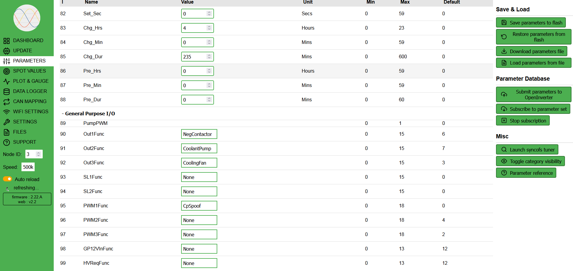

selection point 89, disappeared?

Not sure why this changed. Will review it, possibly the web interface has issues displaying it.
This has not changed so should still work for the option of TachoOut or GS450hOil

medo wrote: Sun Mar 23, 2025 4:03 pm selection point 89, disappeared?
You probably had a value for the parameter that is out of range. You are switching from a Testing and upstream branch to the release so you are going backwards.
