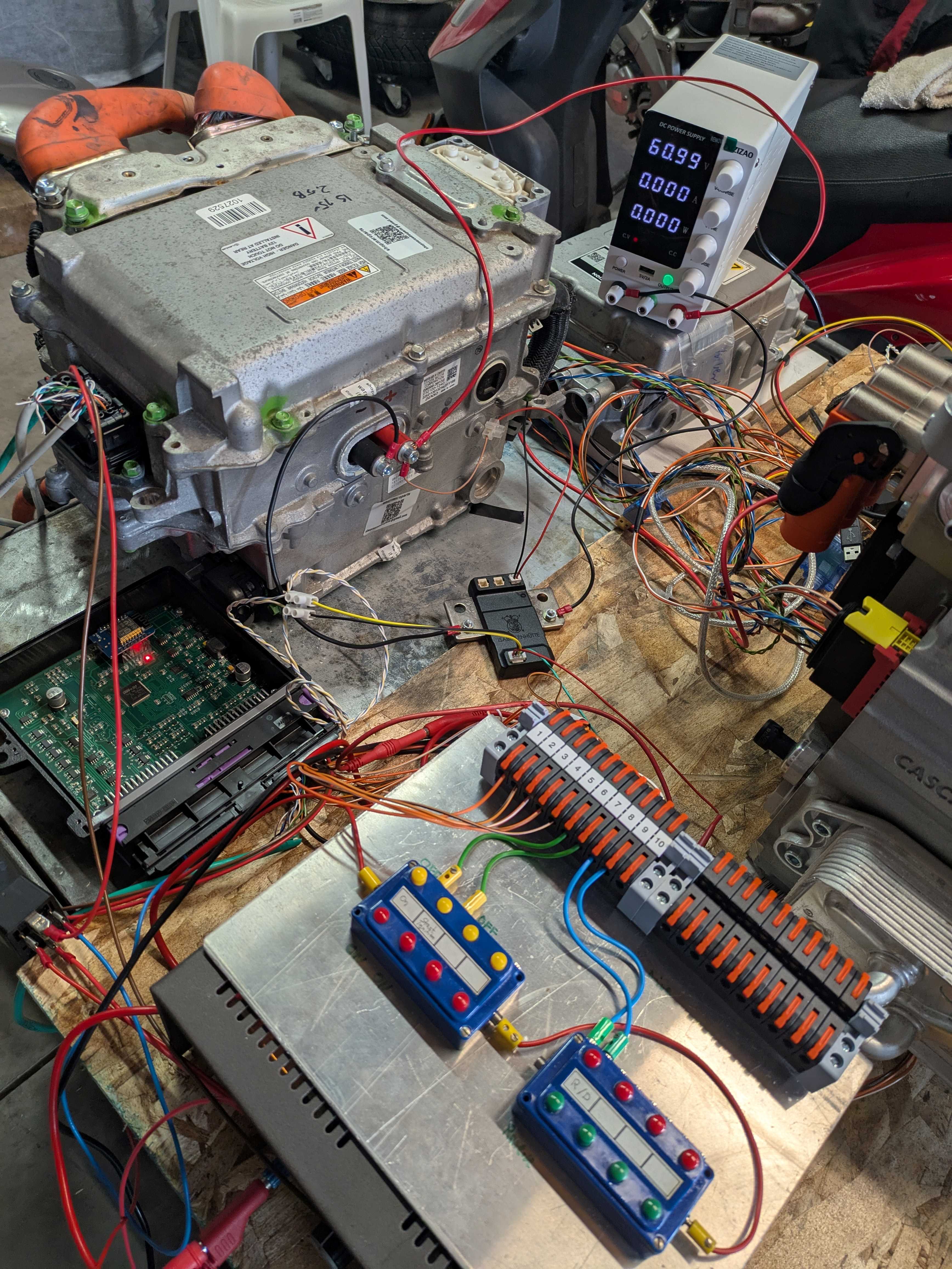

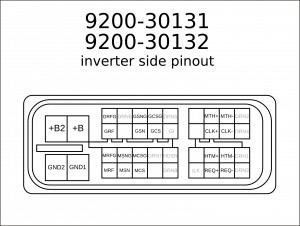

Re: Minimum configuration to get L210 running on the bench / how to initialise ISA shunt?
Post by Bintang 5 »
tom91 wrote: Fri May 09, 2025 3:43 pm Okay, show us pictures of all your wiring.
You need inverter comms to work first.
Here is a diagram of my wiring:
L210 GS300H pin diagram.pptx
(224.33 KiB) Downloaded 79 times
as well as a real-life picture:
The cables between the two resolvers and the Zombieverter and the inverter to Zombieverter were done with CAT4 communication cables. They are twisted but not shielded. As this is just a bench-application I thought this is enough... yet the cable diameter is quite small and it was a challenge to crimp them. Probably I'll check electrical continuity between the pins again.
Any other advice?

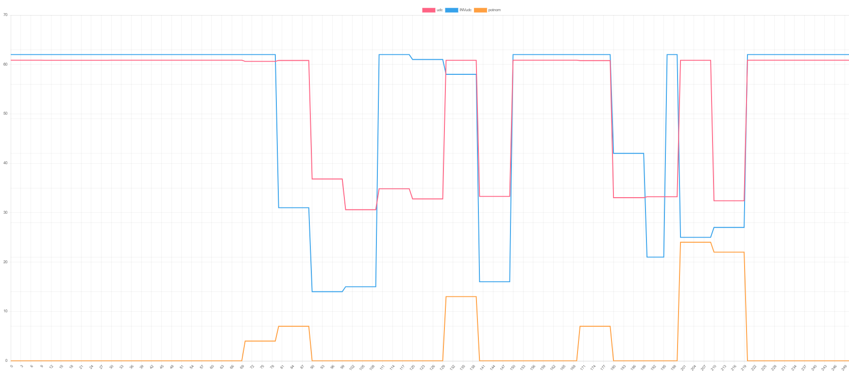

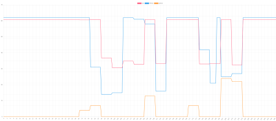

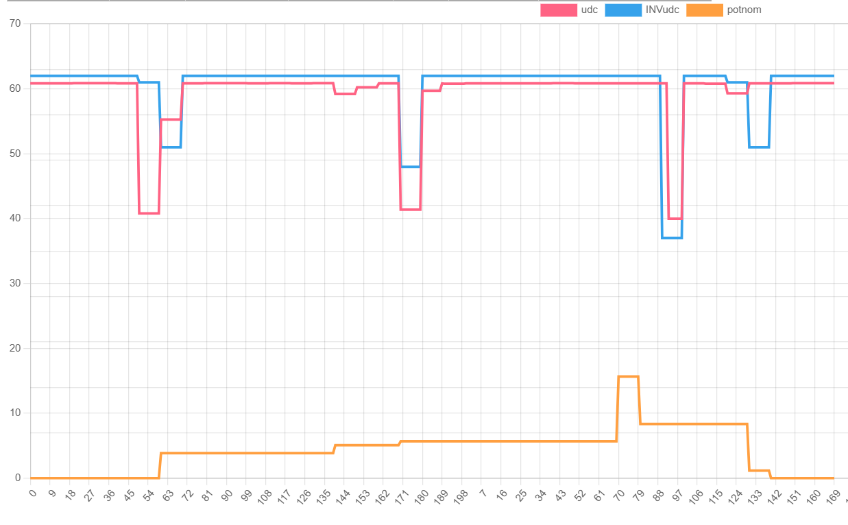

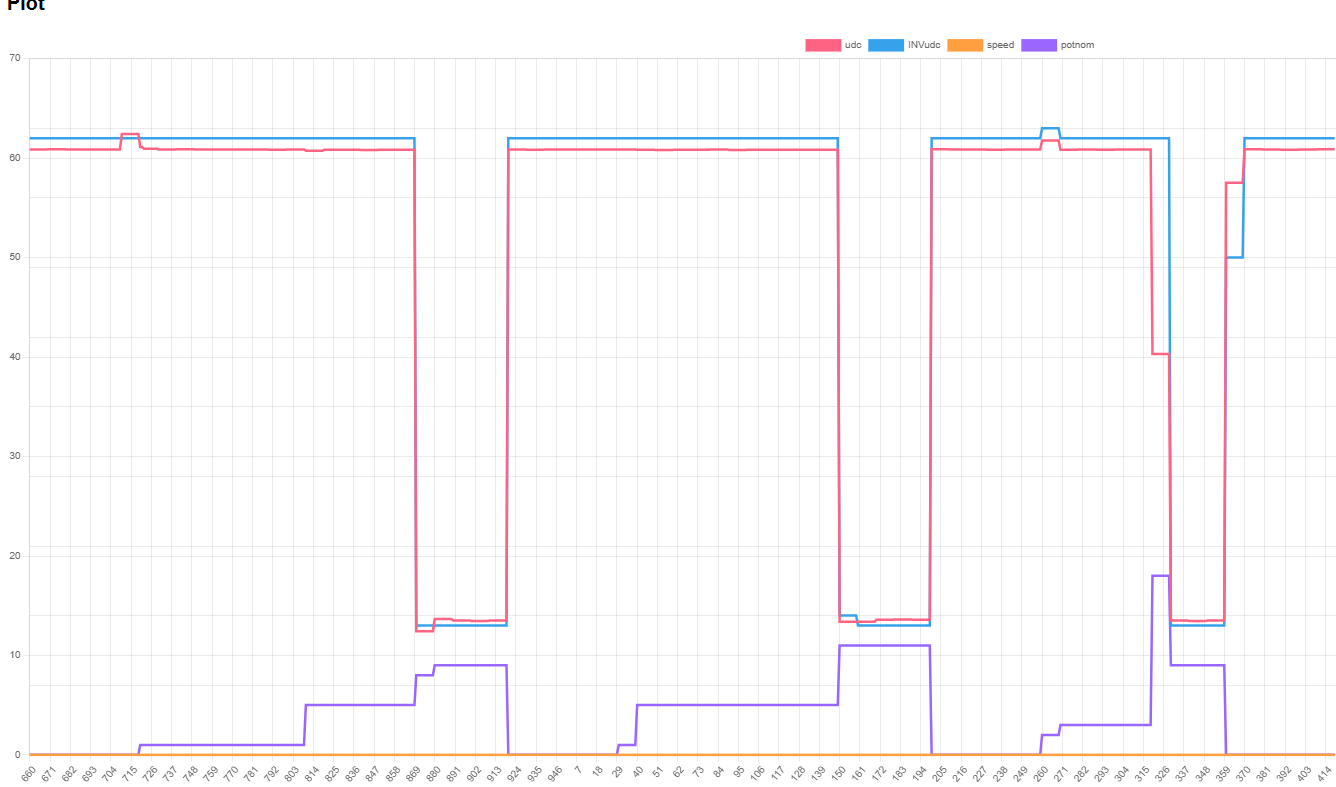

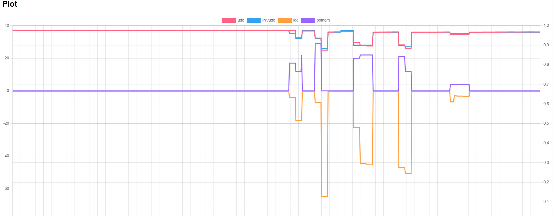

Bintang 5
Posts: 39
Joined: Sat Aug 08, 2020 1:52 pm
Location: Baden Württemberg, Germany
Has thanked: 6 times
Post by Bintang 5 »
tom91 wrote: Sun May 11, 2025 7:00 pm Plot InvUDC and potnom
here's two plots.
The Voltage from the power supply collapses drastically when I push the throttle.
Seems the power supply is too weak?
Posts: 2963
Has thanked: 330 times
Been thanked: 848 times
Bintang 5 wrote: Mon May 12, 2025 4:28 pm Seems the power supply is too weak?
Yes thats it, get some lead acid batteries in series or something. Also it seems to drop alot from the shunt to inverter, you clearly wired it very poorly with unsuitable cables.
Bintang 5

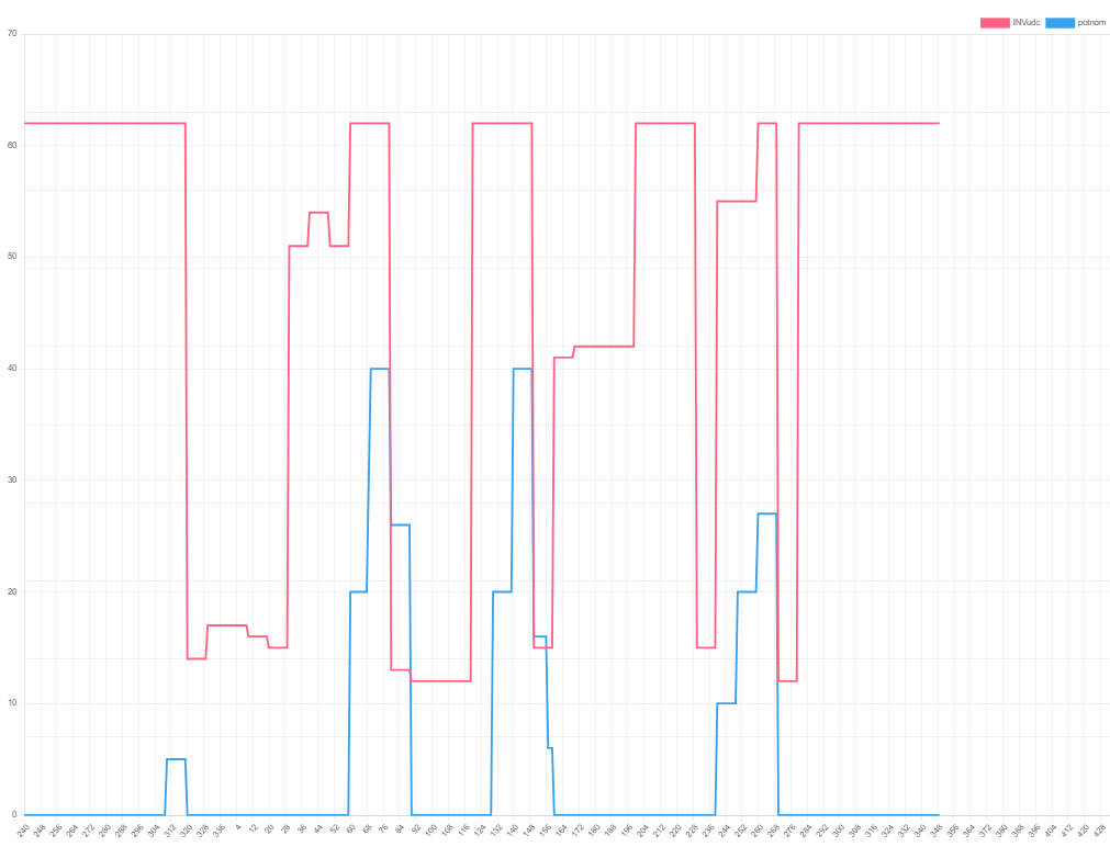

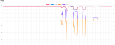

tom91 wrote: Mon May 12, 2025 6:04 pm Yes thats it, get some lead acid batteries in series or something. Also it seems to drop alot from the shunt to inverter, you clearly wired it very poorly with unsuitable cables.
Changed my wiring between power supply and inverter to 10mm². That must be more than sufficiant for 5 Amps...
@andybpowell got his l210 to spin with a similar power supply (300 W, same as mine, so I think this should be enough):
viewtopic.php?p=62388#p62388
Tried to get mine to spin after I changed the wiring, still only shuddering. What seems odd to me is that as soon as "potnom"-value changes the voltage drops, but goes up to initial voltage and stays there (if potnom does not change). The voltage drop happens only if potnom / throttle value changes.
Could this be an issue with wrong settings?
parameters2.pdf
(120 KiB) Downloaded 80 times

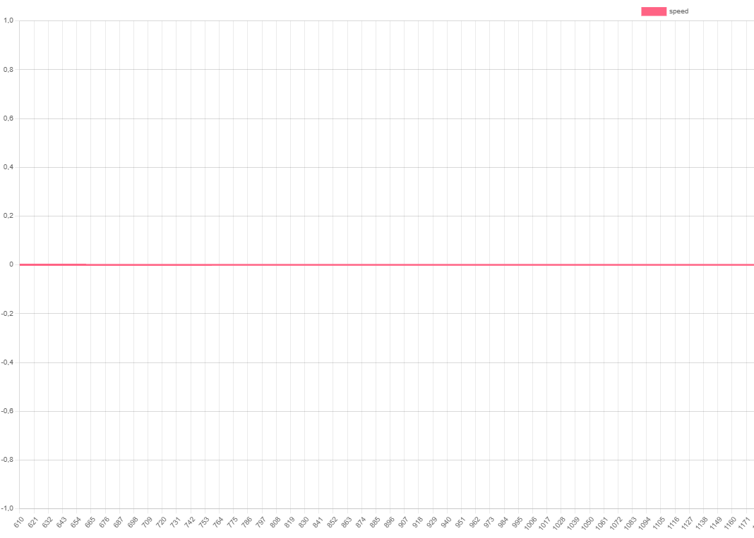

Also check the reported speed from the inverter and the resolver wiring. Is it shielded resolver wiring? What is the wiring for the motor phases, is it stock?

tom91 wrote: Tue May 13, 2025 4:15 pm Also check the reported speed from the inverter and the resolver wiring. Is it shielded resolver wiring? What is the wiring for the motor phases, is it stock?
Checked all wirings, pinning is correct.
Wiring for Motor phases is stock, resolver wiring and communication between Zombie and inverter are twisted but not shielded.
Can I check the signals from the resolver by turning the output shaft by hand? Are there any spot values for that?
How to check reported speed from the inverter?
