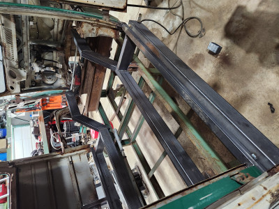

I am deep in the research phase of a pretty ambitious build. As a background, I have a background in ME, and understand the safety precautions, I have worked on 480v 3 phase equipment and retrofitted my fadal cnc mill with linux. So I'm not a rookie, but also can recognize dunning kruger and know I know nothing on this subject.
The vehicle is a derelict 1964 Vw bus that was abandoned in the woods of Minnesota and rescued by me in 2015. It was pretty toast to be a restoration candidate, so my original plan was to put a modern engine in it with a 4x4 drivetrain using a combination of jeep, toyota and jetta parts. So, I fabricated a full rectangular tube chassis and it became apparent that packaging was going to be an issue for my goal of actually using this as a camper. In the midst of this, I came to own a ford F150 hybrid for a while and fell in love with the off grid capabilities of the hybrid, especially when we were boondock camping.
I ran across https://forum.ih8mud.com/threads/1996-l ... t.1268985/, and decided that leaf power was maybe the way to go, so I've spent the last 3 months taking notes, reading, and in general realizing I know nothing.
As of now I plan to mate a leaf motor to a transfer case doubler made from a complete toyota case and a planetary from a jeep 241 case for gear reduction. Combined with 4.10 gear ratio axles and my planned tire size, it should put me at around 6200rpm at cruising speed, which seems ideal for a leaf. I plan to run an onboard 30-40kwh pack, which I hope to get 75-100 miles range from. Since I loved my hybrid so much, I plan to build an auxiliary trailer with a VW TDI engine mated possibly to a second leaf motor as a generator ( still working this part out) to act as a range extender and also to have backup power for my house. The range extender would be for longer trips and staying off grid.

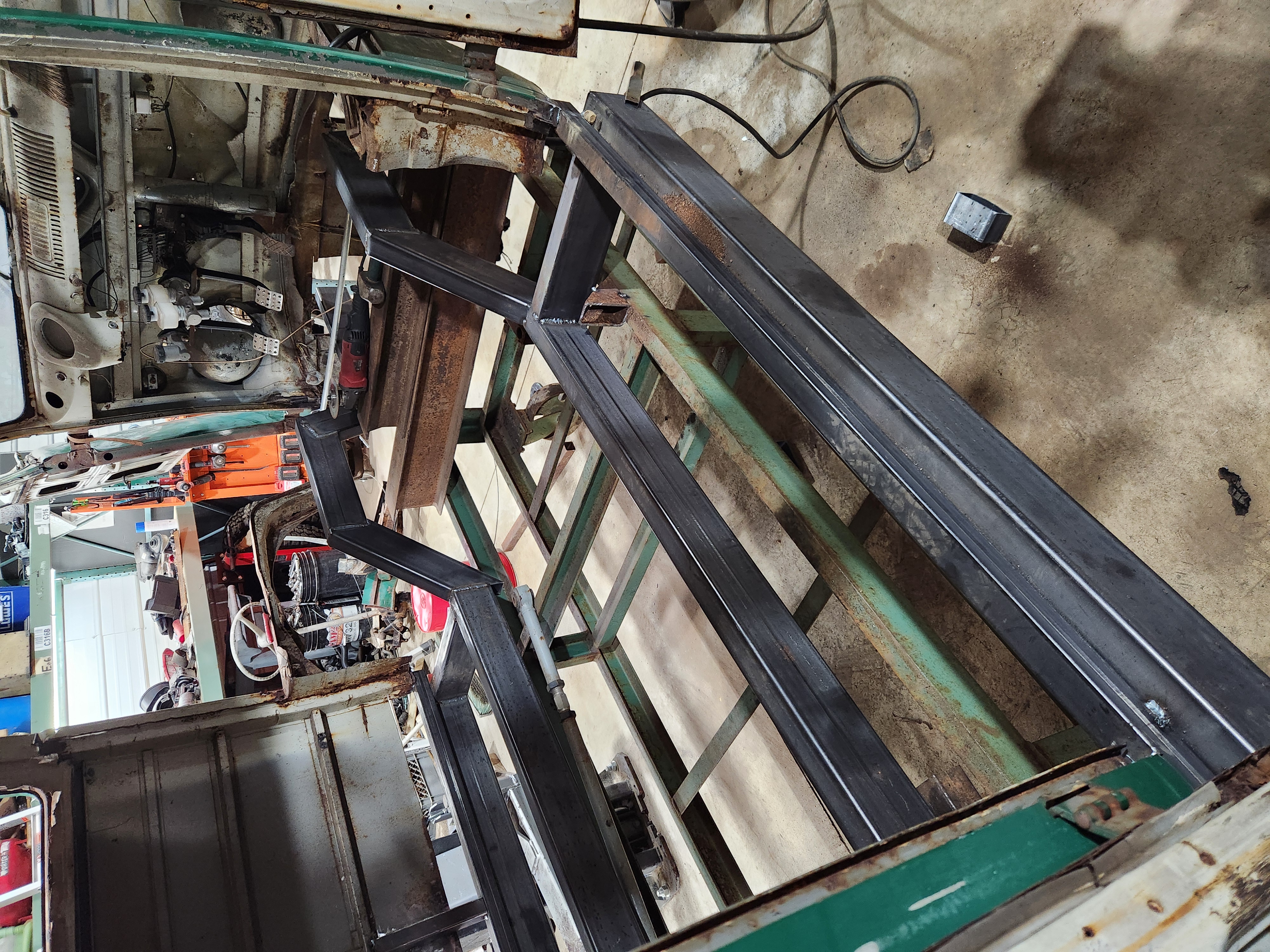

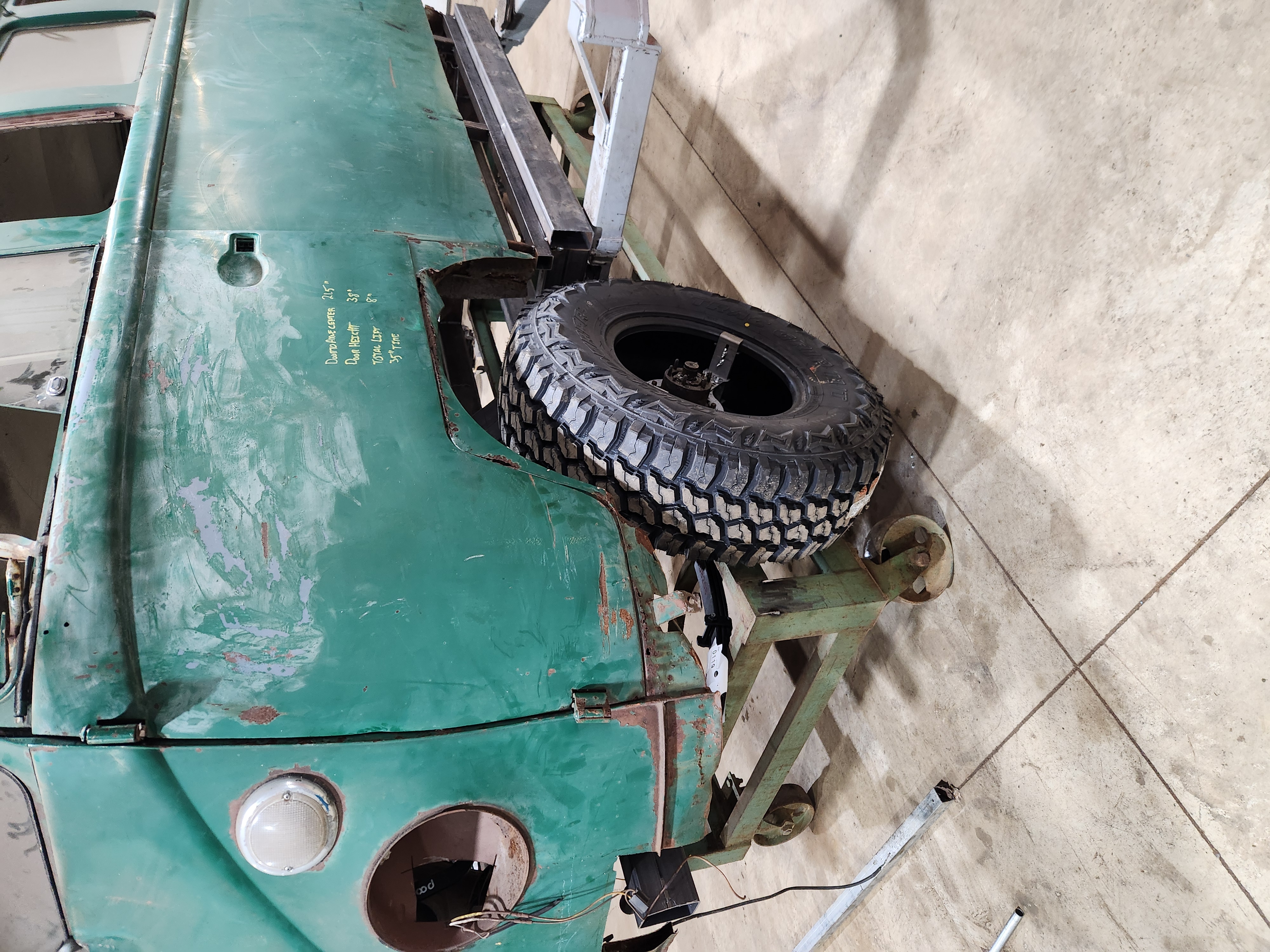

The sideways bus with the toy axle mocked up when it will still going to be diesel powered The chassis under it. And for good measure, another one of my VW's doing some yardwork yesterday.

Impressive work on the chassis! And very nice picture postcard image of a VW at work. Could have been from VW themselves 60 years ago.
