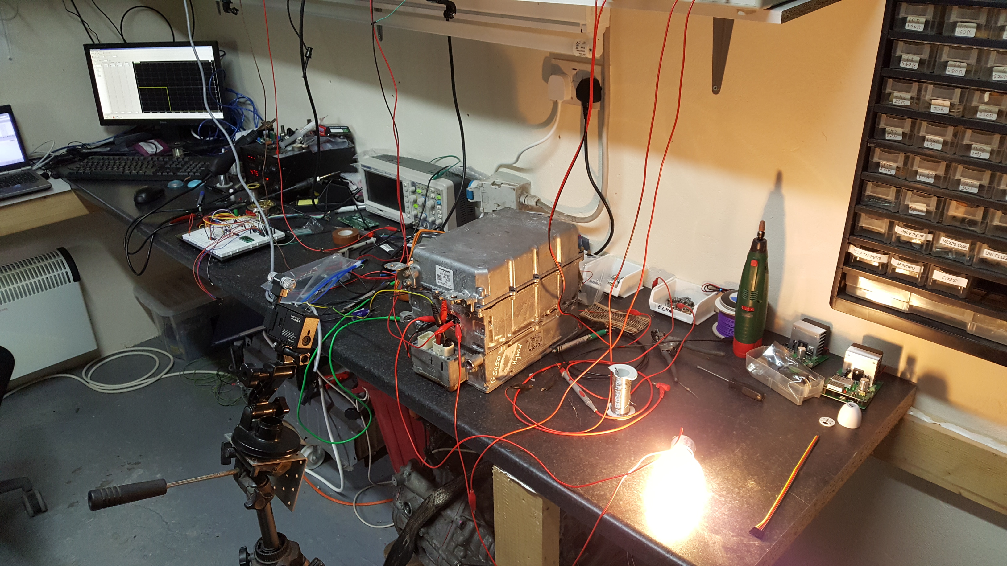

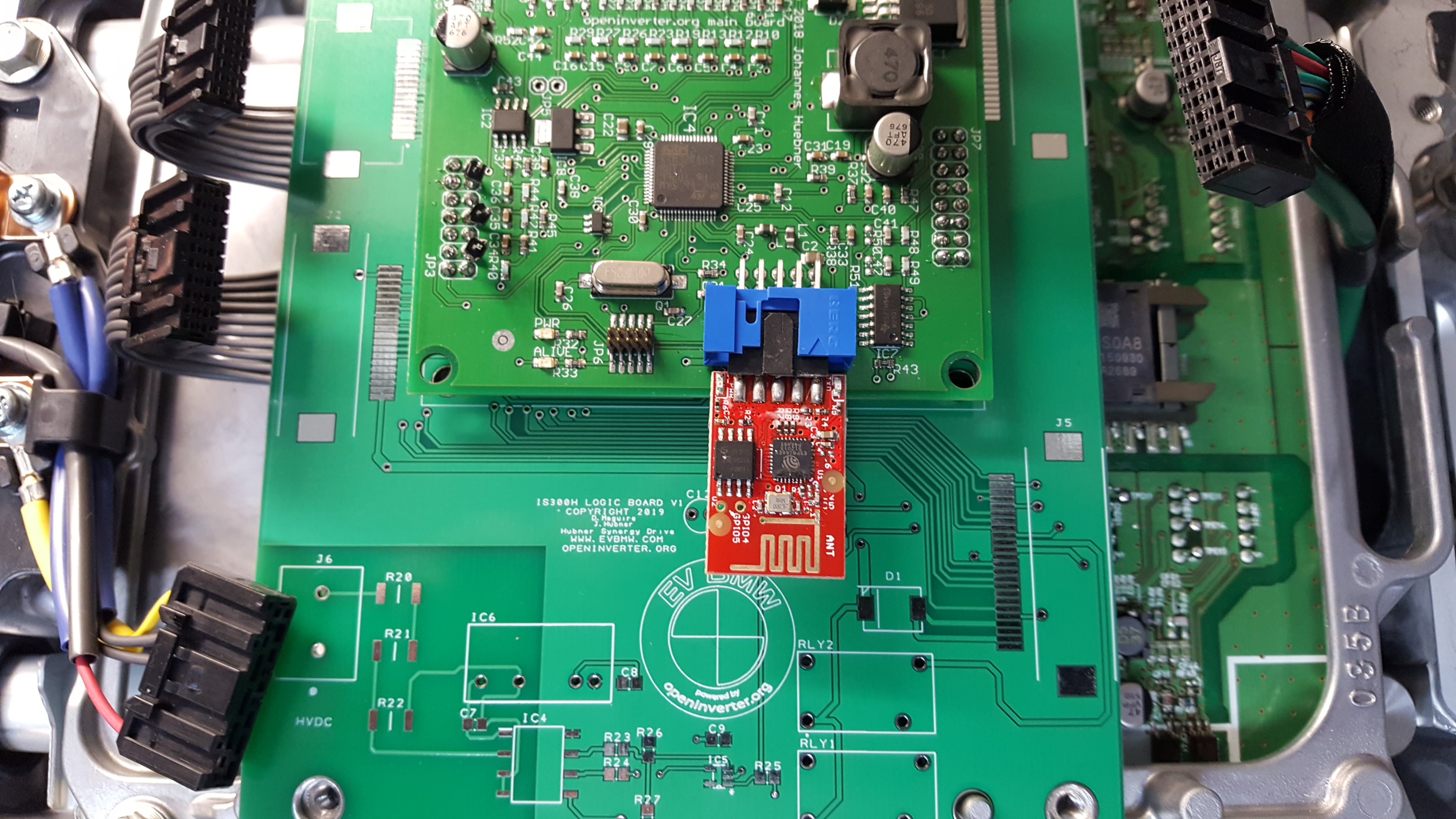

Next up on the bench for hacking is the Lexus IS300h inverter. I believe this one is also fitted to the new model GS450h and LS hybrids also. Have another few Lexus inverters on the way including a few 2009 GS450h units that are available quite cheaply. Should work out nice for people who need more power than the Prius and /or rear wheel drive solutions.
Today managed to get the IGBT driver woken up and running in the IS inverter.

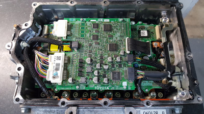

First look inside the GS450H inverter. Uses the same connector for the igbt driver board as the Gen 3 Prius.

Released a development board design for the Lexus IS300H inverter :
https://github.com/damienmaguire/Lexus-IS300H-Inverter
Uses the Hübner brain board and a jumper to select between running the MG1 or MG2 inverter.

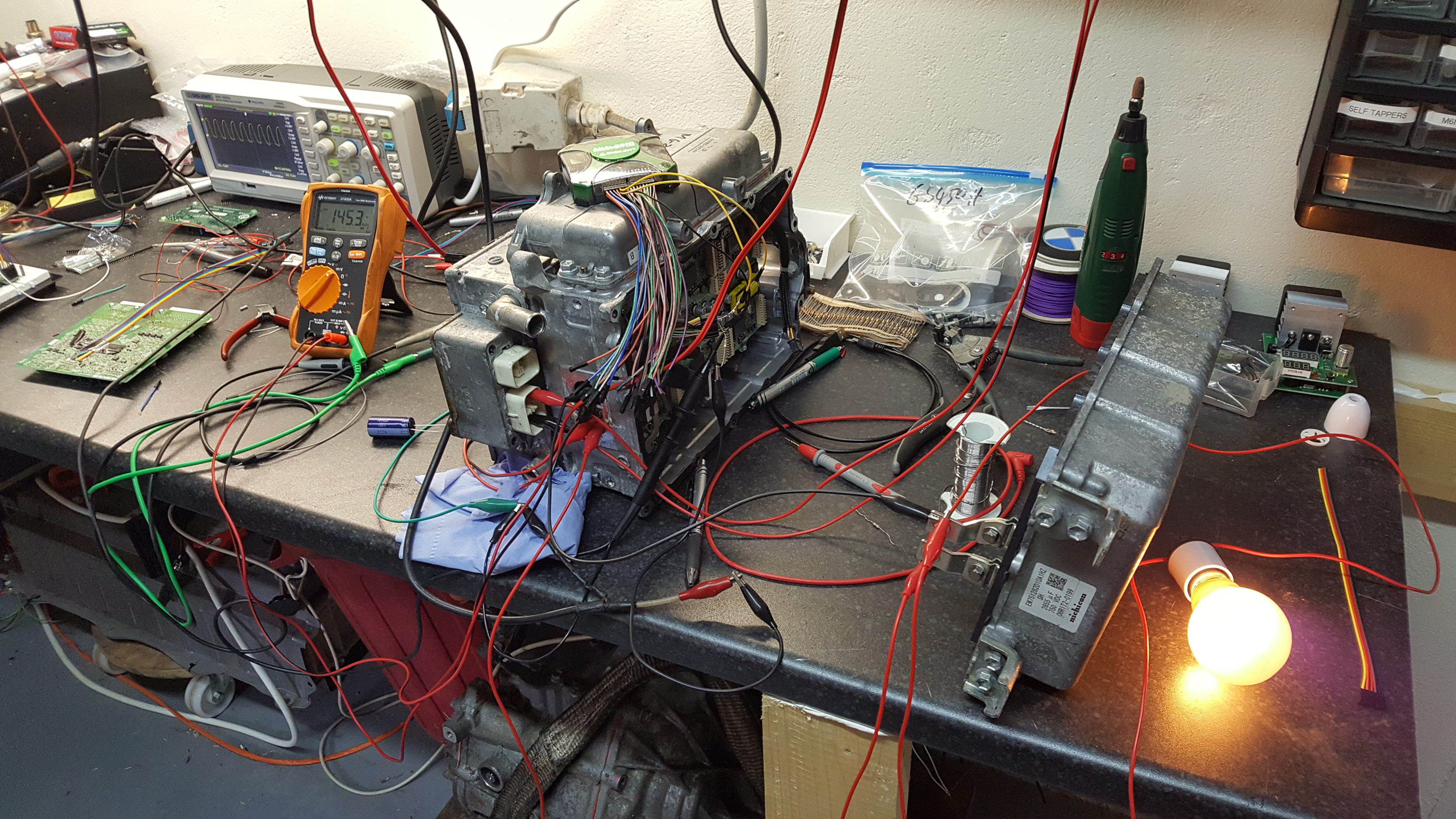

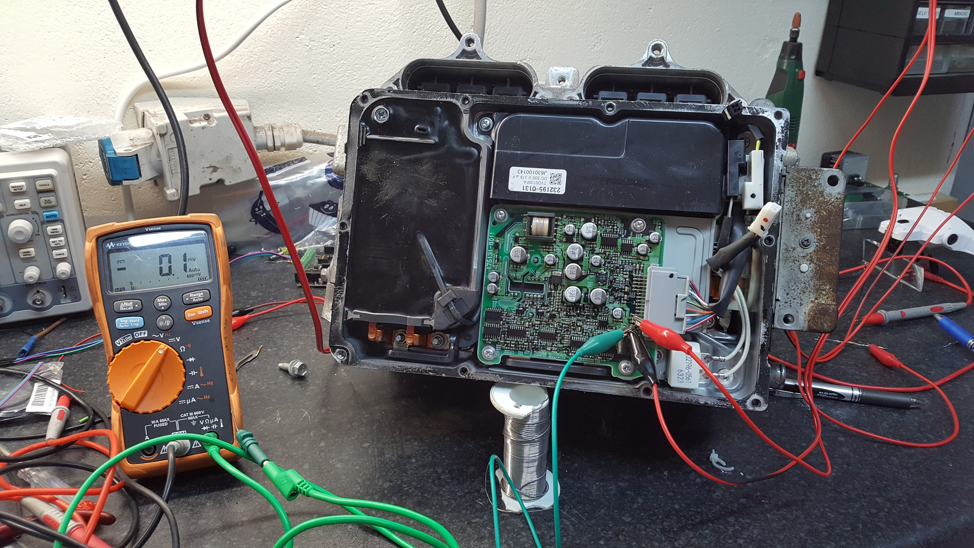

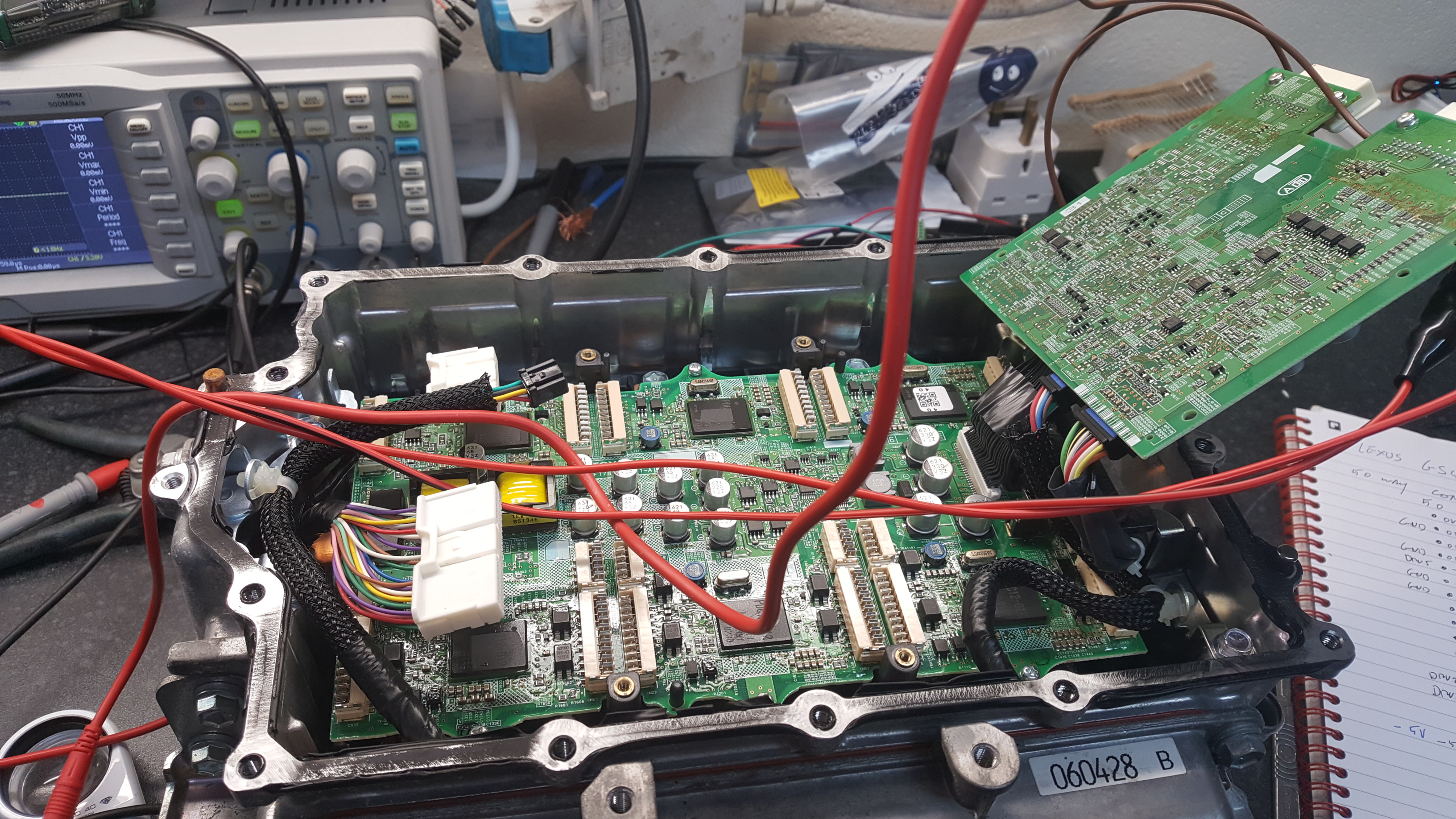

Started in on the GS450h inverter today. Our friends in Toyota are being extra sneaky with this one ...

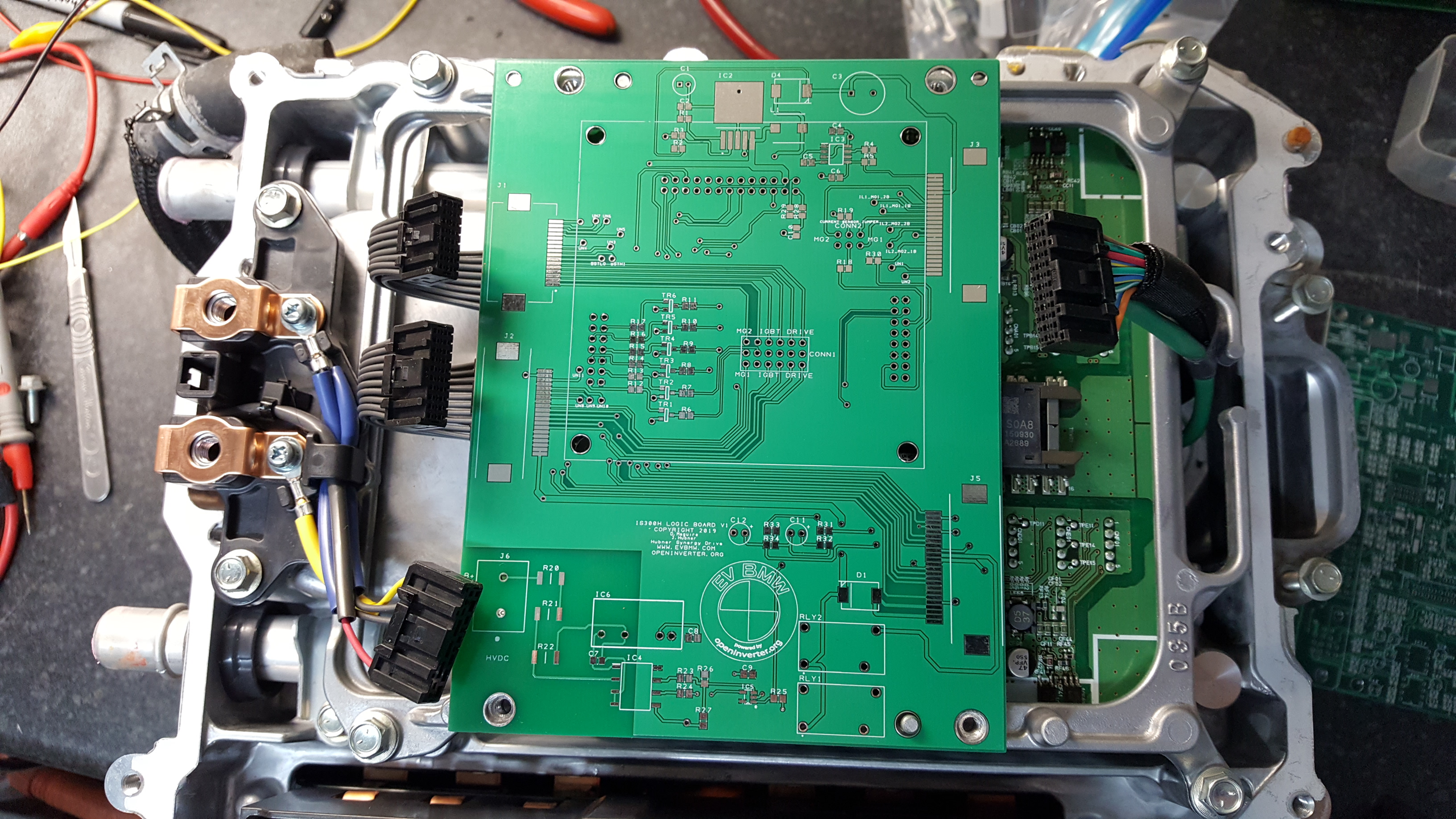

Development board for the is300h inverter arrived and it fits:)

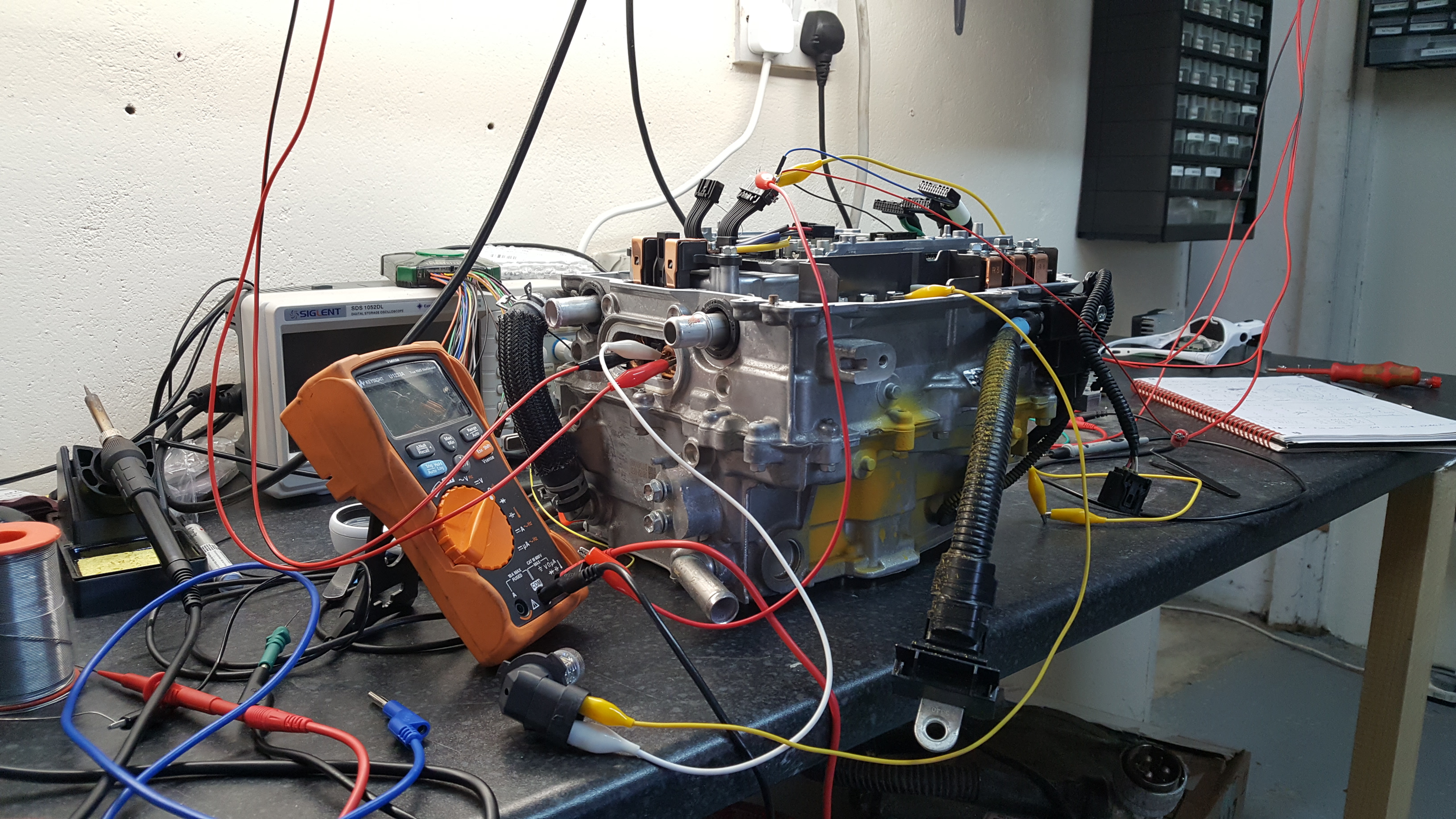

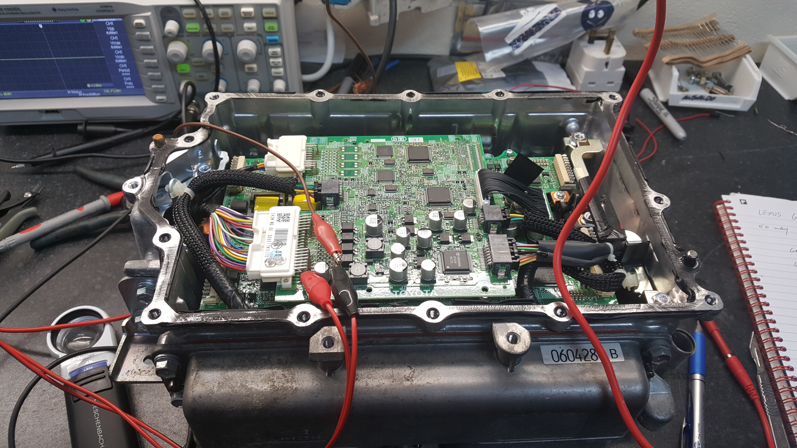

Well the boost converter in the GS450h inverter is playing hard to get. Identified quite a few signals but still not firing the igbts.
Gets rather frustrating when you realise this has been done before but not shared. That said the Toyota stuff continues amaze. It's just been designed to be totally fail safe.

Can't kill them. They seem to use asics for the igbt drive that simply will not allow anything destructive to happen. They even have their own temp sense so if you let the heatsink hit 90c they ignore the pwm. The prius gen3 inverter is very integrated although the dc dc can run standalone. These older Lexus inverters are modular.

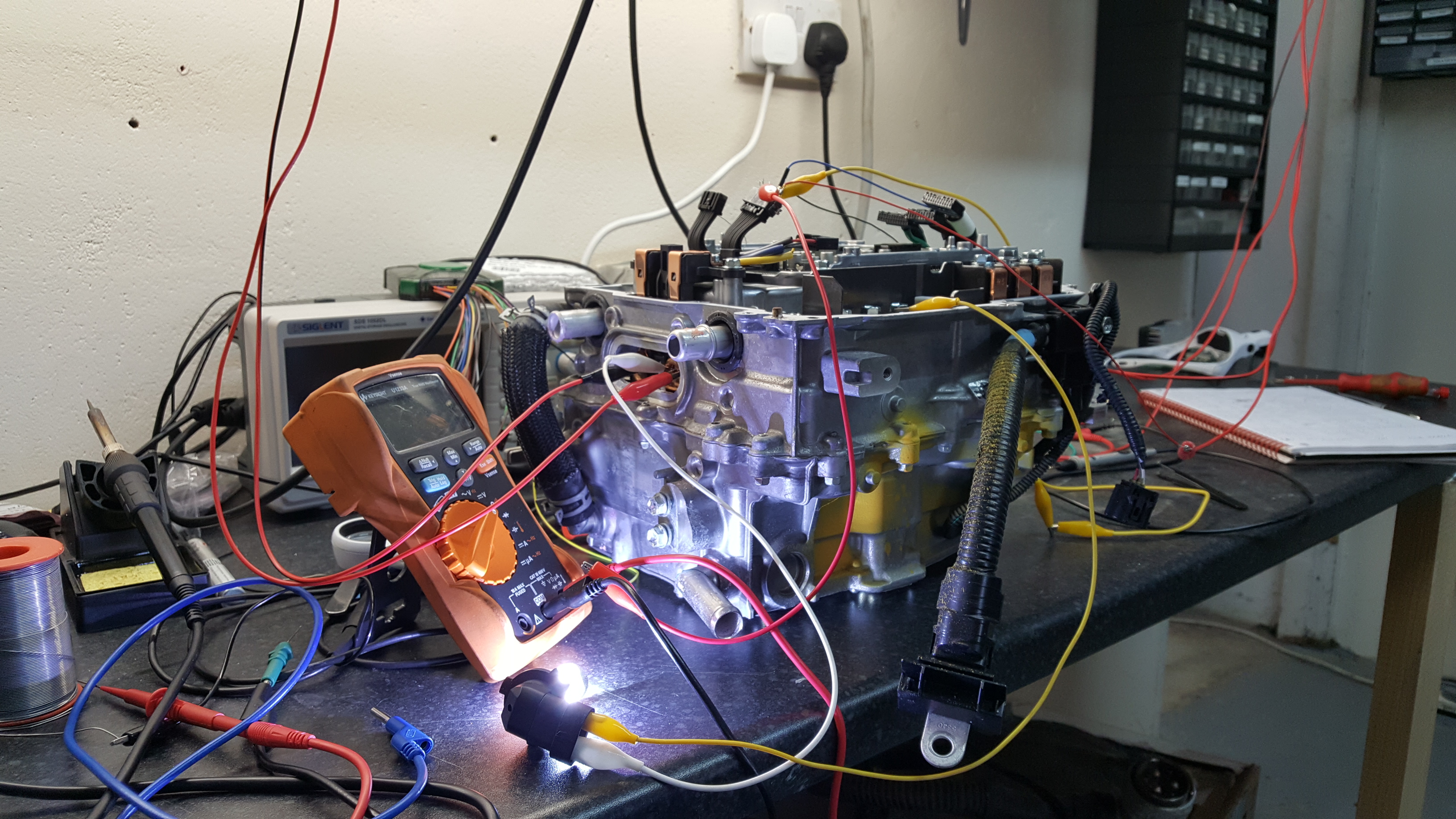

And the booster is boosting!

Boosting from 20v to 250v. The gs450h inverter does not have a dc dc built in. Its just a dual inverter and boost converter. Rated at 37kw from what I can find online.
