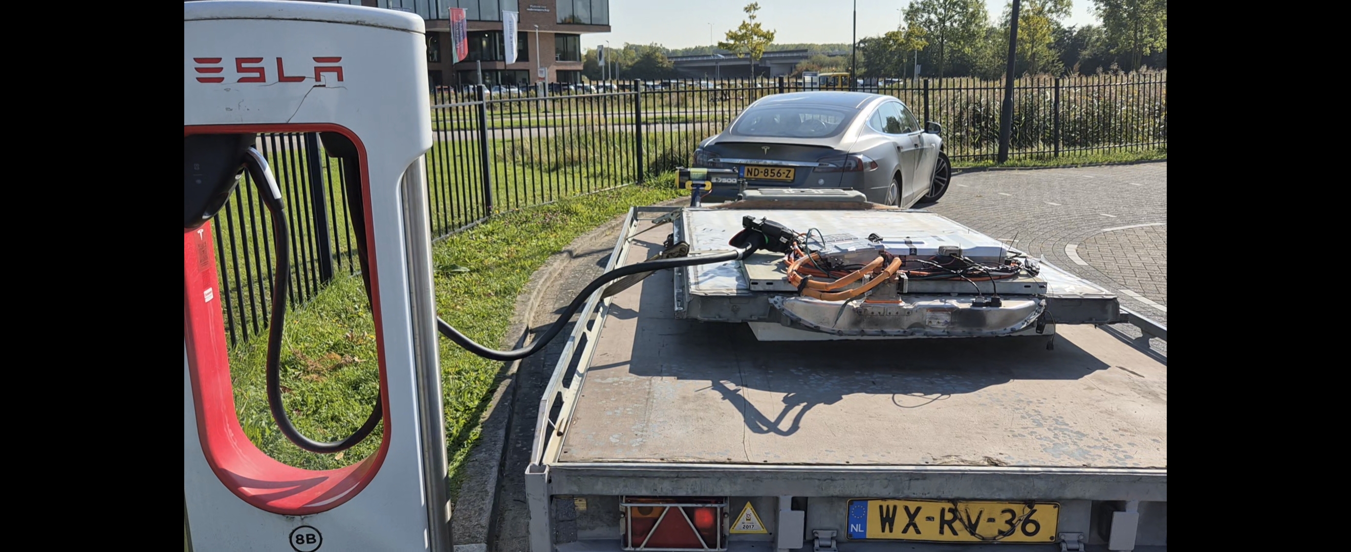

Re: Supercharging a Tesla standalone battery pack
Post by hanskraayeveld »
It can also work with gen3 obc's.
No need for can-redeploy. Can also work with v2 v3 superchargers with ccs adapter.

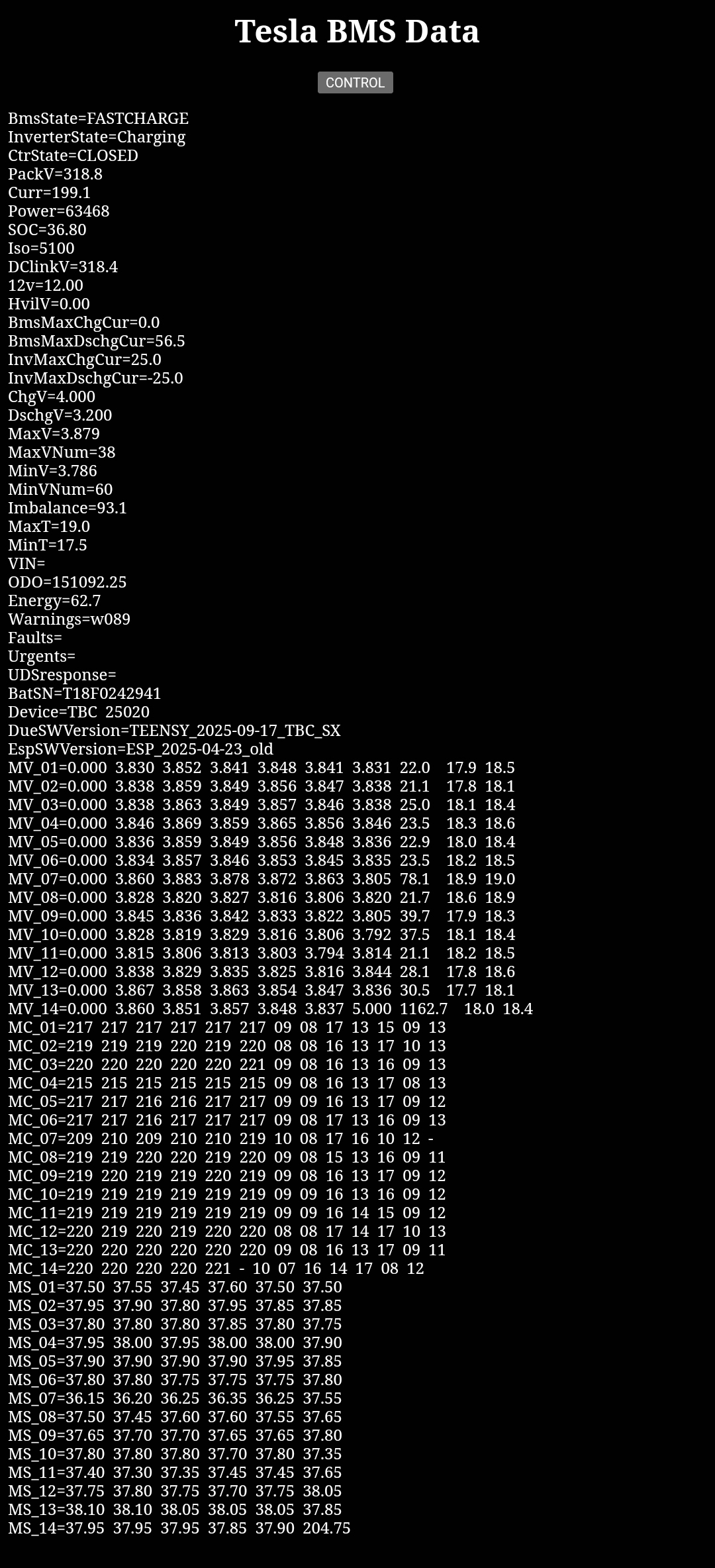

Info during fastcharging
Its a 14 modules 75 kWh battery with 83 bricks.
1 module, module 7 has 5 bricks.

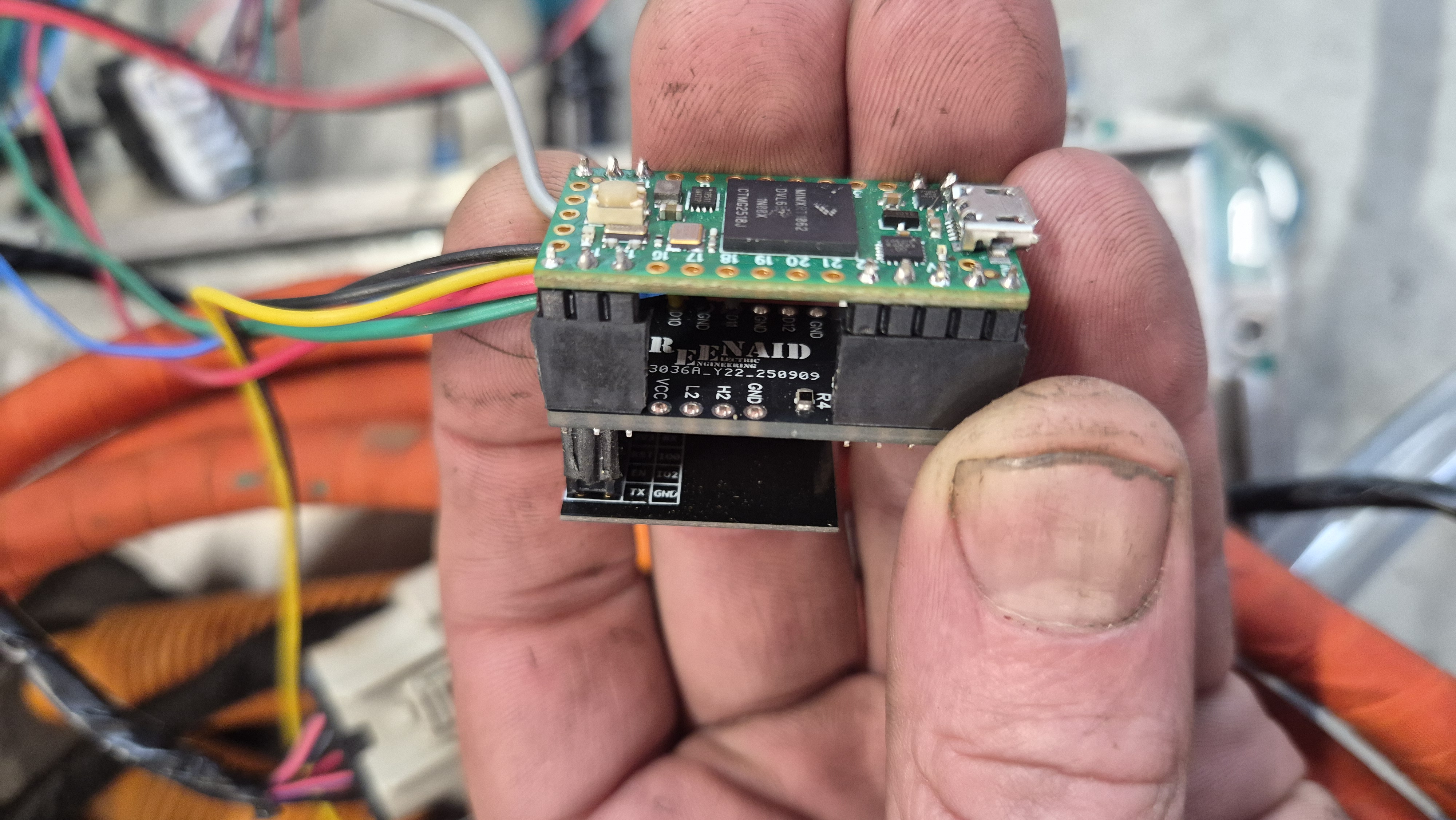

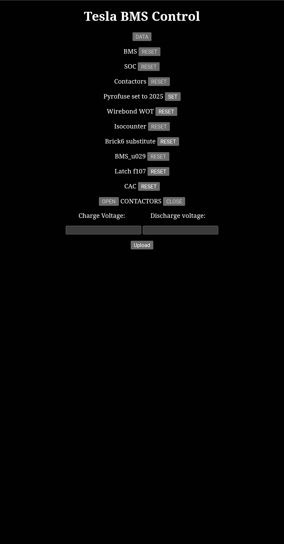

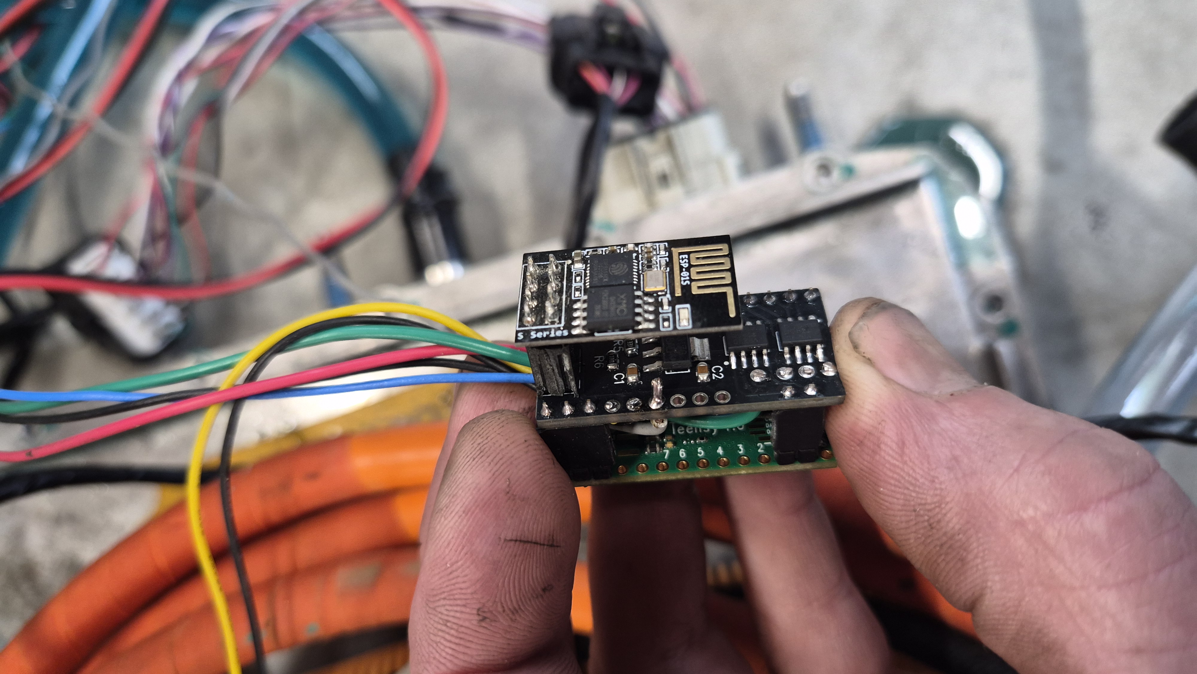

This is the controller.
manny
Posts: 195
Location: Netherlands
Has thanked: 58 times
Been thanked: 159 times
Post by manny »
Cool.
So parts needed battery, charger, hv junction box and charge port?
What does the controller do exactly?
The controller sends the missing can data from some (HV) components.
And the VIN number for the payment.
