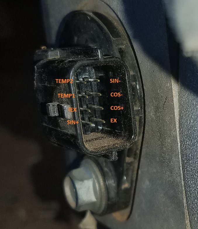

Was sent another picture today.
Please check with a simple multimeter in AC mode: exciter voltage about 5V AC, return voltages between 0 and 1V depending on rotor position.

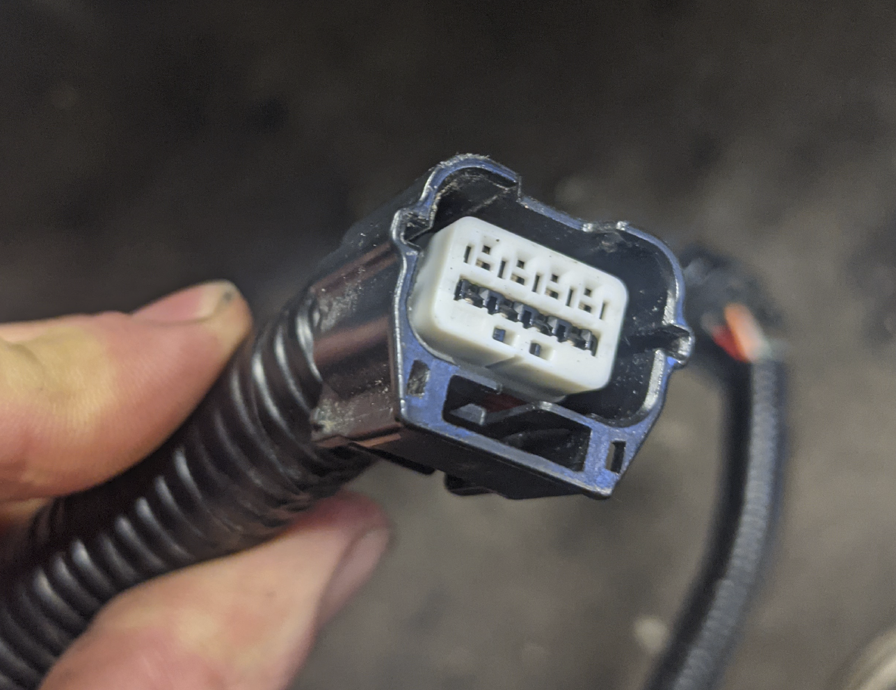

Does someone have a part number for the connector that goes in the socket?
It looks like this on the EM57.

Re: Nissan Leaf EM61 resolver wiring
It looks similar to some Yazaki plugs that they also use for A/C and various other peripherals
https://www.auto-click.co.uk/6-way/yaza ... 83-8850-30
Thanks johu, I have looked high and low to find that plug and I believe this is the correct part:
https://www.auto-click.co.uk/7283-8855- ... 83-8855-30
I had to bodge something up using molex connectors so these will be a huge improvement.
I have ordered a few and will report back once they arrive.
Plugs arrived from the UK today and I can confirm this part is correct for the EM57 motor and certainly looks identical to the EM61 part.
