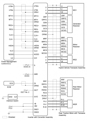

will the openinverter.org Brain Board Rev 3 - community edition control my RX450H inverter or is there a different / better option out there.

You'll need the GS450H VCU (here) and I recommend you read the the BEXUS project thread (here) and watch Damien's videos. Lots GS450H projects in the works so you'll be in good company

I don’t think anyone has tried RX inverter yet. Transaxle though should be pretty easy, it’s a larger variant of the Gen3 Prius transaxle. The inverter could be similar to RAV4 that I believe Damien has on his shelf for future reverse engineering.

You could run the transaxle from the GS450h inverter with the VCU from Damien. This would mean purchasing another inverter. Unless you’re willing to reverse engineer the RX inverter I’d say this is the safest bet.

First step would be to look at a wiring diagram for the rx450h inverter and compare with the gs450h regards signals. If they are the same then the hardware in the gs450h vcu should be compatible. The next problem then will be the messages between inverter and vcu that will need to be coded in software.

As posted by xp677 in another thread :
"Visit https://www.lexus-tech.eu/ you can pay EUR6 for 1 hours access to the manual. "

Saved you the trouble (and 6 blips). Looks like the same interface as the GS450h. Now to see what else is on there ...

Slightly easier to read version

Full pinouts and signal description.
rx450h.pdf- (290.16 KiB) Downloaded 331 times

Firstly thank you, I will have a more detailed review tonight on my dessk PC.
So reading inbetween the lines it is fairly positive in terms of the degree of cominality between the Gs and RX.

I'd be careful mixing gearboxes and inverters. Unless the motors have the same characteristics and resolvers etc could be trouble. As a first step I'd suggest someone connect a gs450h vcu to a rx450h inverter and see what happens. It probably will just sit there doing nothing but it will give us a starting point. Ideally we would then need someone with a running rx450h to do a data capture.

Different messages for the RX inverter. It has a 100-byte HTM packet, as it has a third output (the RX h has three motors).
You'd need to decode and figure it all out. Best would be to buy a working car to test with, then sell it on after.
Hardware-wise, the GS450h VCU should work fine for the inverter control. Would be good to see inside one to verify the same components as the GS (likely so). Other parts of the VCU (transmission solenoids, etc) might be relevant, might not, you'd need to compare service manuals.
