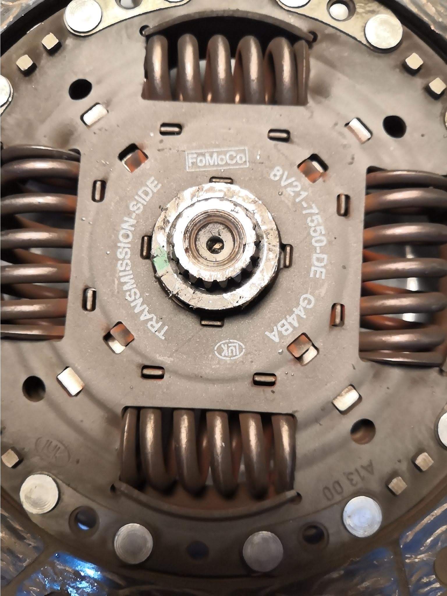

Just an FYI for anyone playing with the Outlander motors. I noticed Fiesta clutches had the same bore and spline count so grabbed one out of the recycling bin at my local garage today. Sure enough, it's a very good fit with very little play.
I've added this to the wiki here along with the model number: https://openinverter.org/wiki/Mitsubish ... put_Shafts
FYI: Fiesta clutch fits front motor splines

If you wan't to find out which other cars clutches might fit as well you can search on the number here:
https://aftermarket.zf.com/go/en/sachs/catalogs/#/
Then you will find that the following part numbers should also fit:

That's brilliant! So, plenty of options in short. Shall add these to the wiki later.

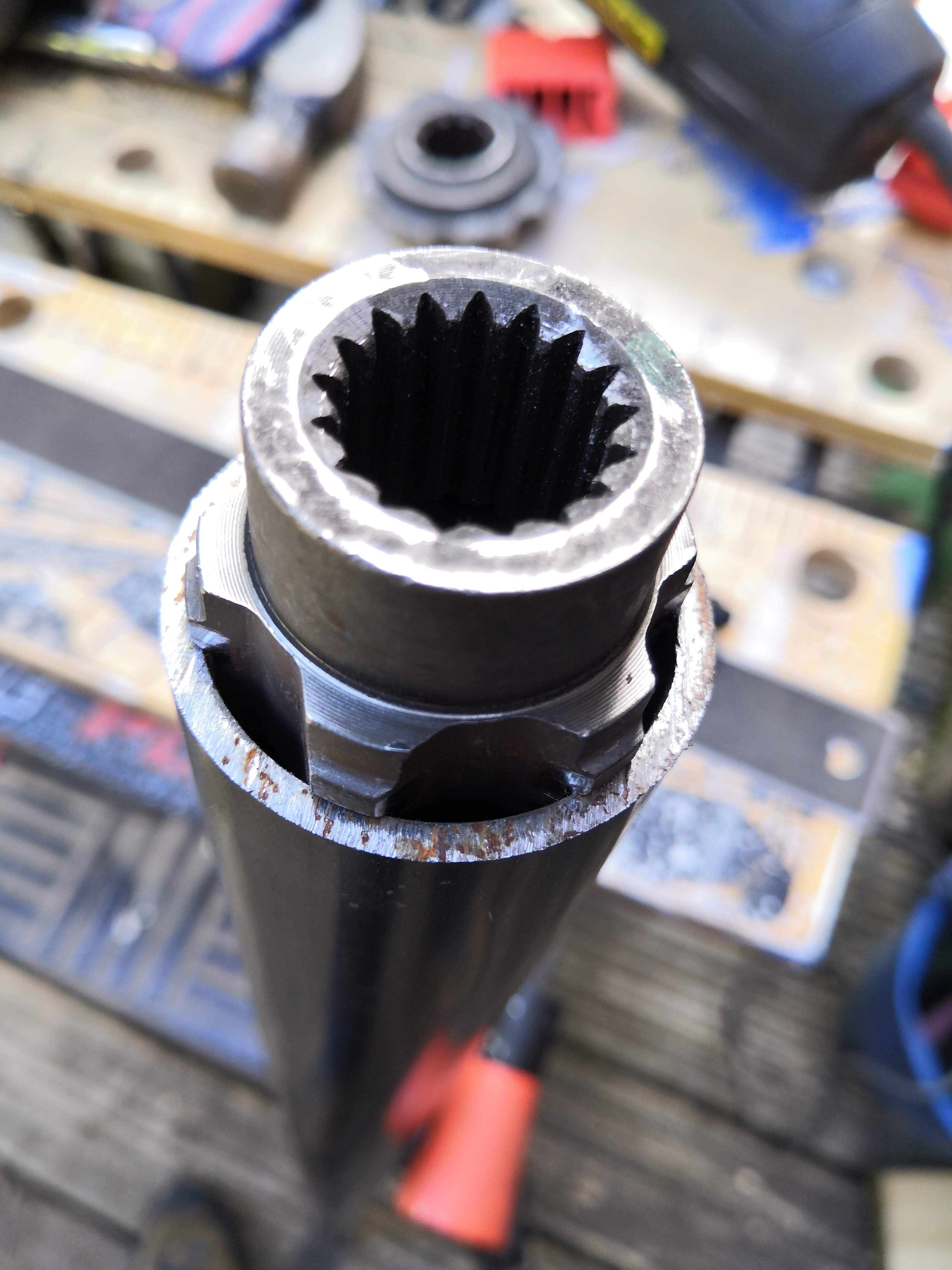

I cut down the Ford clutch today. The centre piece actually drops out - it isn't welded to any of the arms as it is on my BMW clutch plate. Should make it a little easier to weld into a coupler. In the photo below it is partially in/partially out of a 37mm i/d tube.
