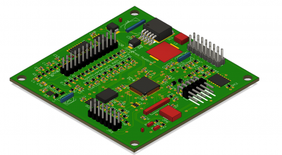

Here's a screen grab of what we have so far. The boards are on their way from China after Chinese New Year.

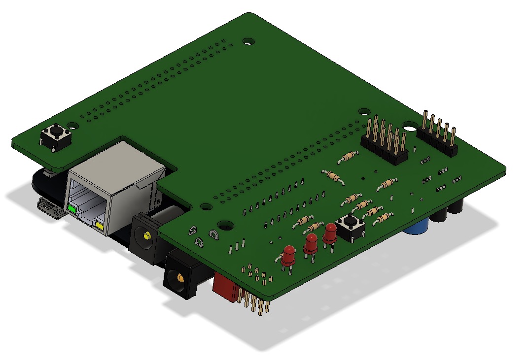

Also been working on some enclosures for the various modules that can be 3d printed. Here's one for the battery measurement module:
There's a few tweaks then I'll put the stl files somewhere in case anyone wants to make ...

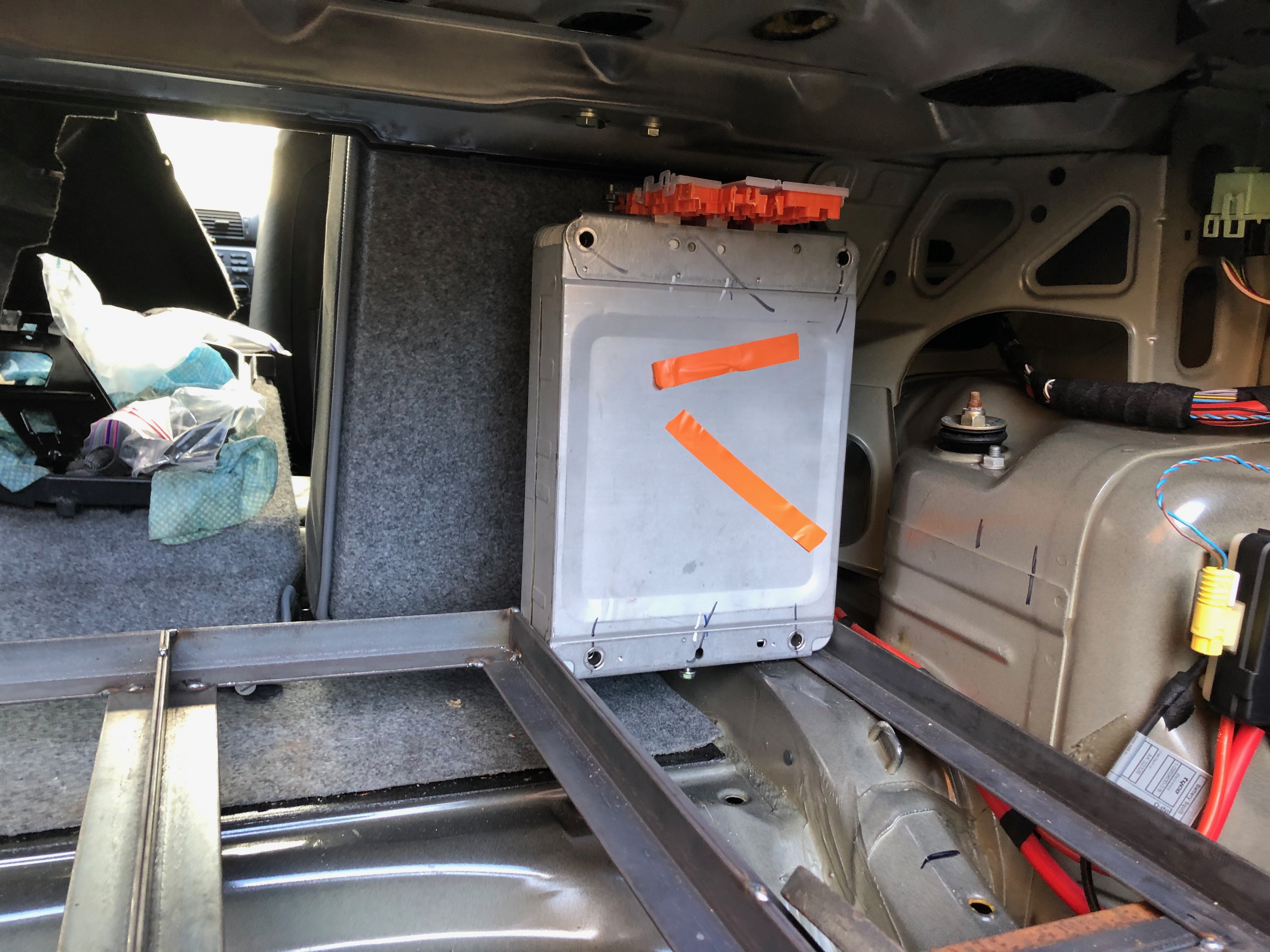

There are some days when you suddenly feel like you're making some progress and I have a couple of those this weekend!
Got the front motor mount sorted. Zafira PAS pump installed and running. No leaks!
And made a mounting frame for the inverter:
