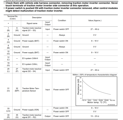

I have been using this image I posted below as reference. Also as I noted above, I measured these pins and got what I felt was appropriate "~40ohms for sin/cos, 20 ohms for exciter, and temp sense was 15k-ish. No shorts to case. Seem about right?"

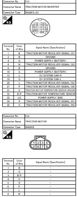

As I understand it, here is the correct wiring I've conjured up from the sources I could find. Maybe I got the connector backwards, as the pin numbering on the connector is reverse the manual. Note: when I disconnect HV and spin the motor by hand, I can see speed go up to a positive number, and when i spin it opposite direction, it goes to a negative value (on the gui) - spot values.
PDM Pin / Resolver Pin & ID / color
1 / 1 Sin + / Black
6 / 8 Sin - / Green
20 / 7 Cos + / Pink
27 / 6 Cos - / Blue
31 / 4 Temp gnd / Orange
32 / 3 Temp / BLK&PNK
34 / 5 EX / Red
35 / 2 ! EX / Green
